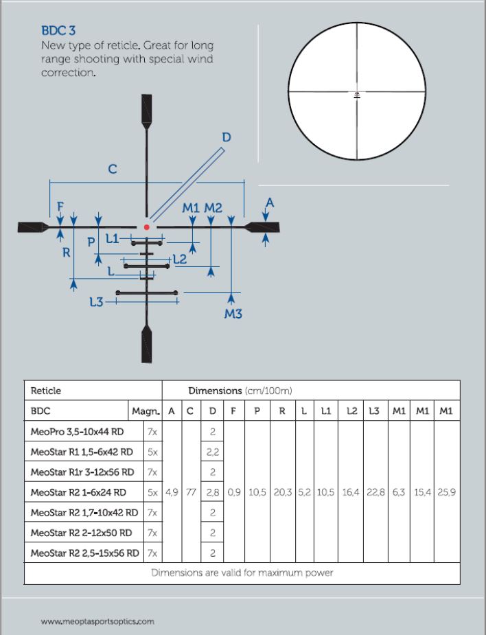

BTW, I was asked by a member here:
"I'm interested in the SFP 4.5-27x50 version. Do you have the subtensions for the BDC3 reticle? I'd like to find out the size of the center dot for both the mil and moa versions (if it comes in the two different formats). "
I reached out to the Meopta Tech Rep and he replied:
"The BDC reticle will only be in MOA format and in the preproduction sample I have it is the BDC-3. The subtension drawings I have are attached (they are metric but can be converted pretty easily). With the 4.5-27x50 he is referring to being a FFP reticle, the data in the chart will be true for all powers."
I hope this is helpful
Doug

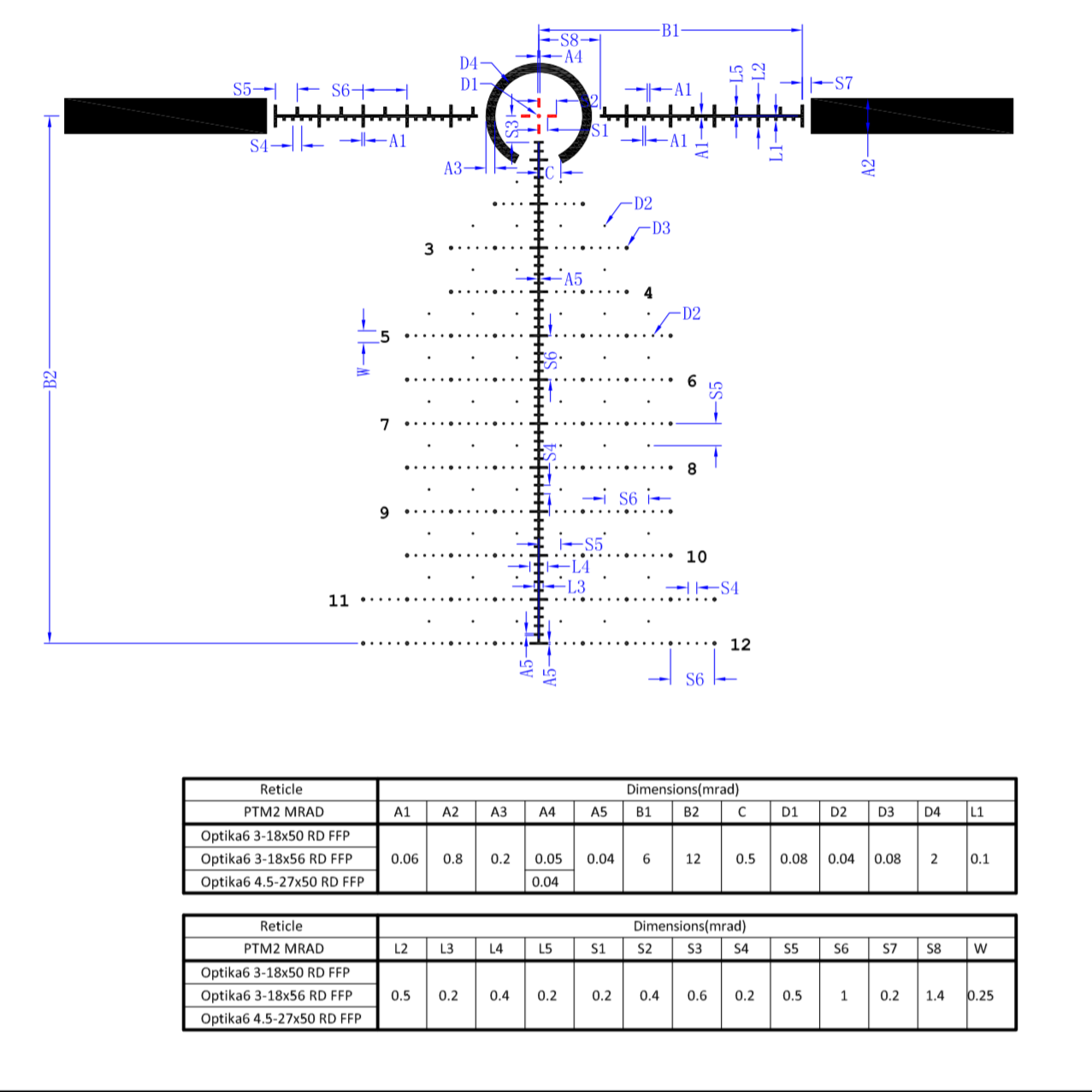

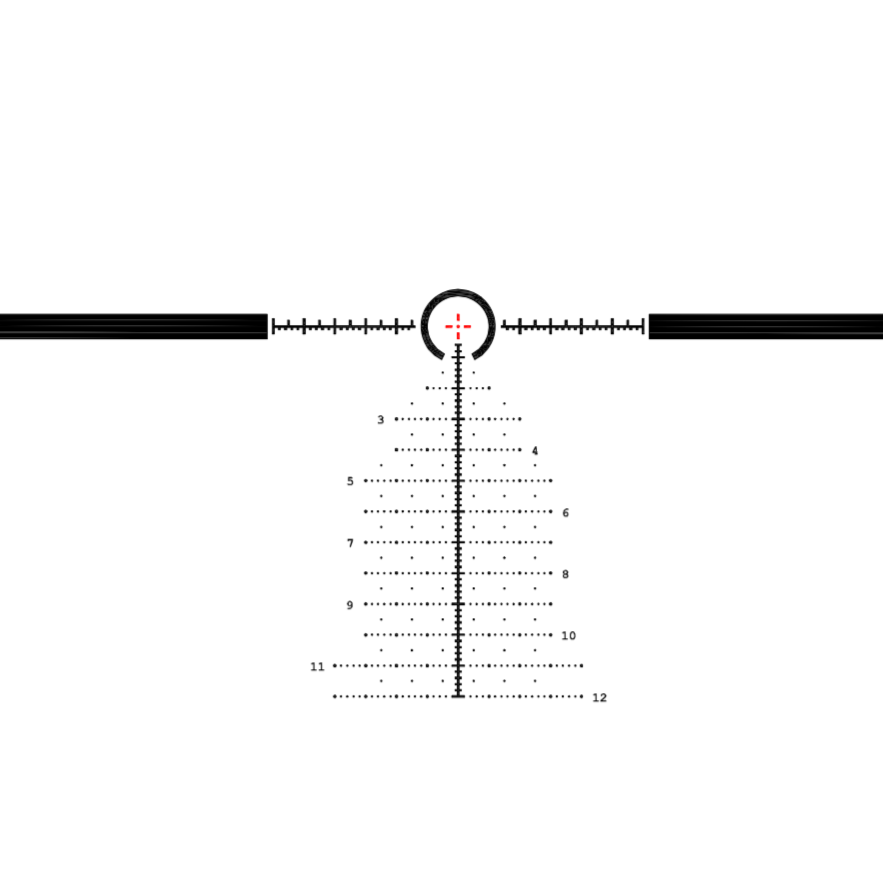

I am trying to get good reticle images from Czech Republic for the new reticles (.223, .308, 6.5, MRAD) so as soon as I have them I will try to post as well.

Scanned through the thread but did not see an image of your reticle ILya, are you able to post and share the design? Of if I'm blind and did not see it, which post # is it :)
