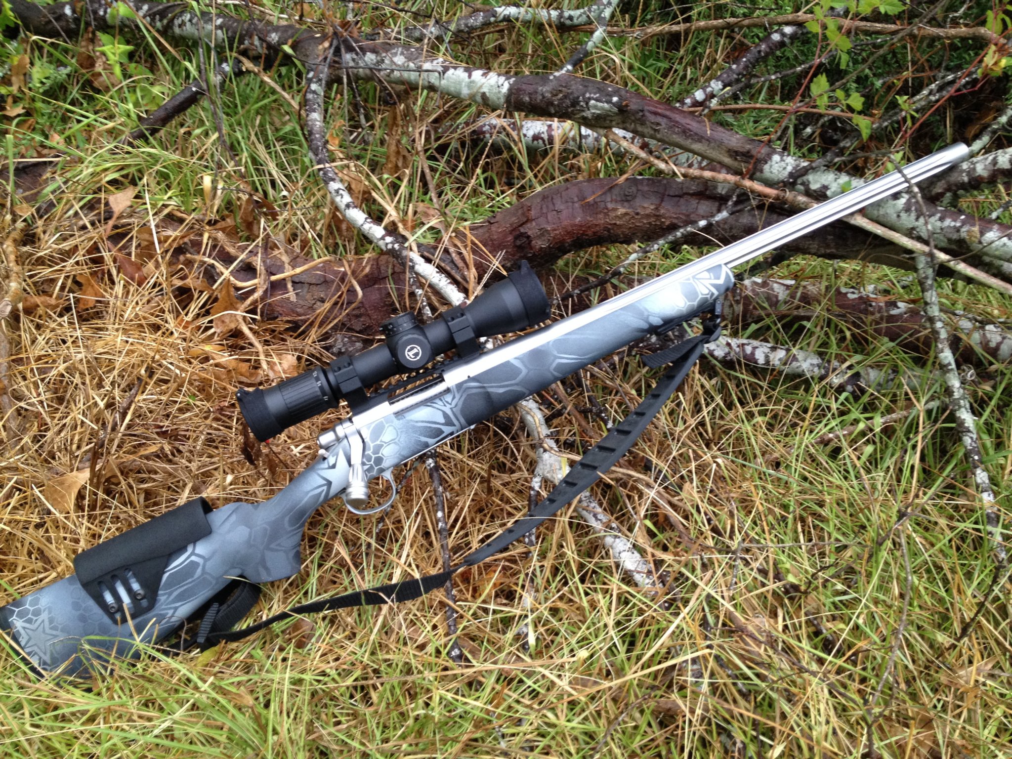

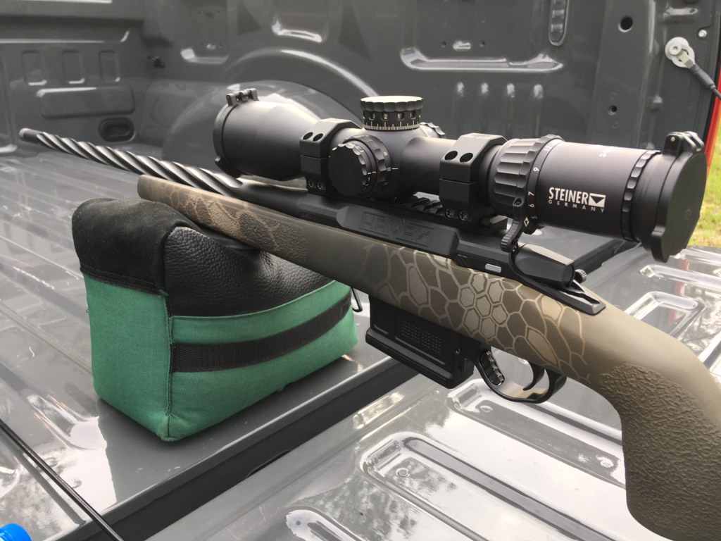

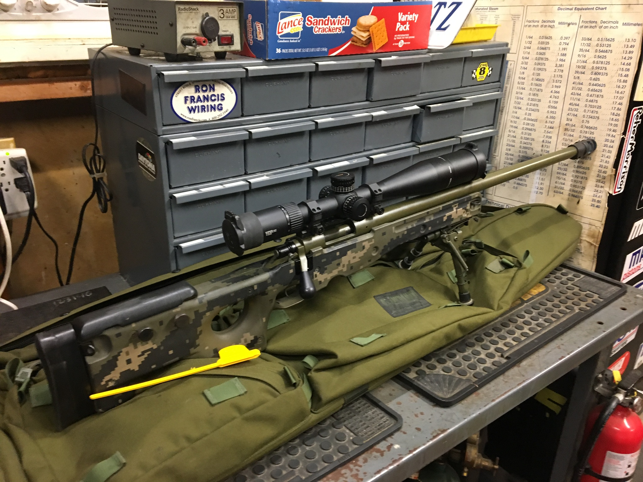

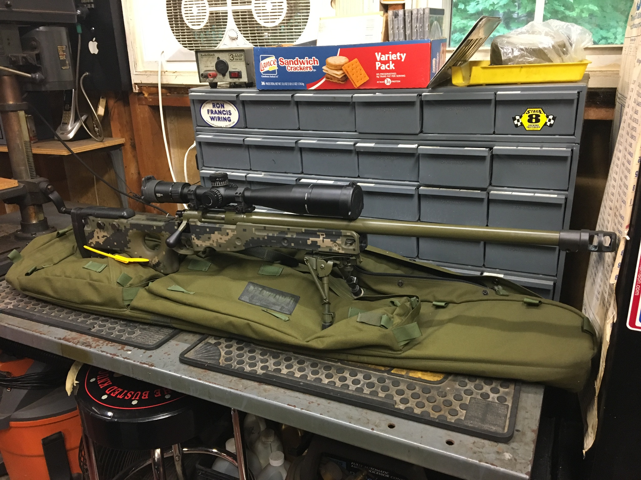

Rattle can/sponge job.

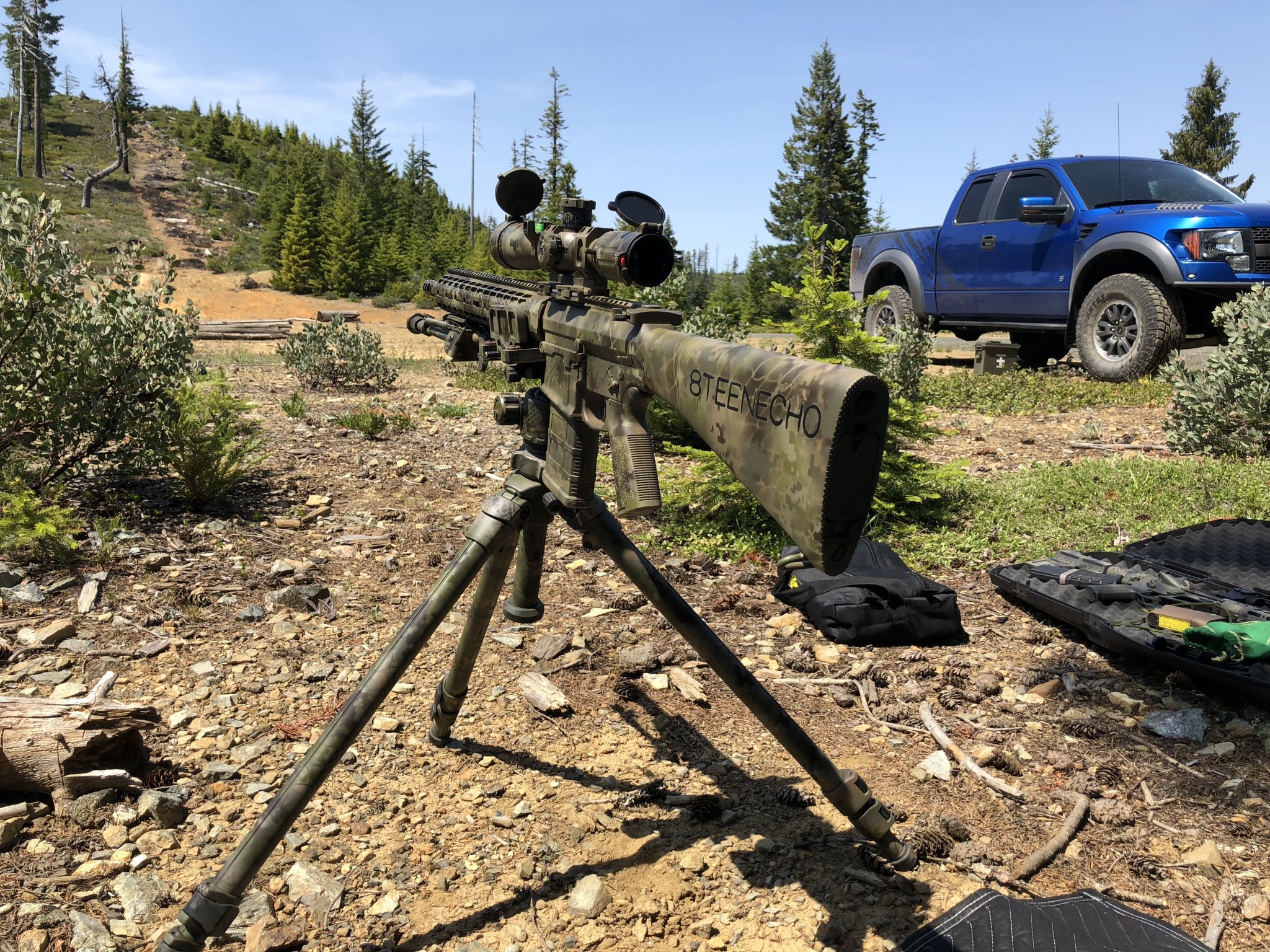

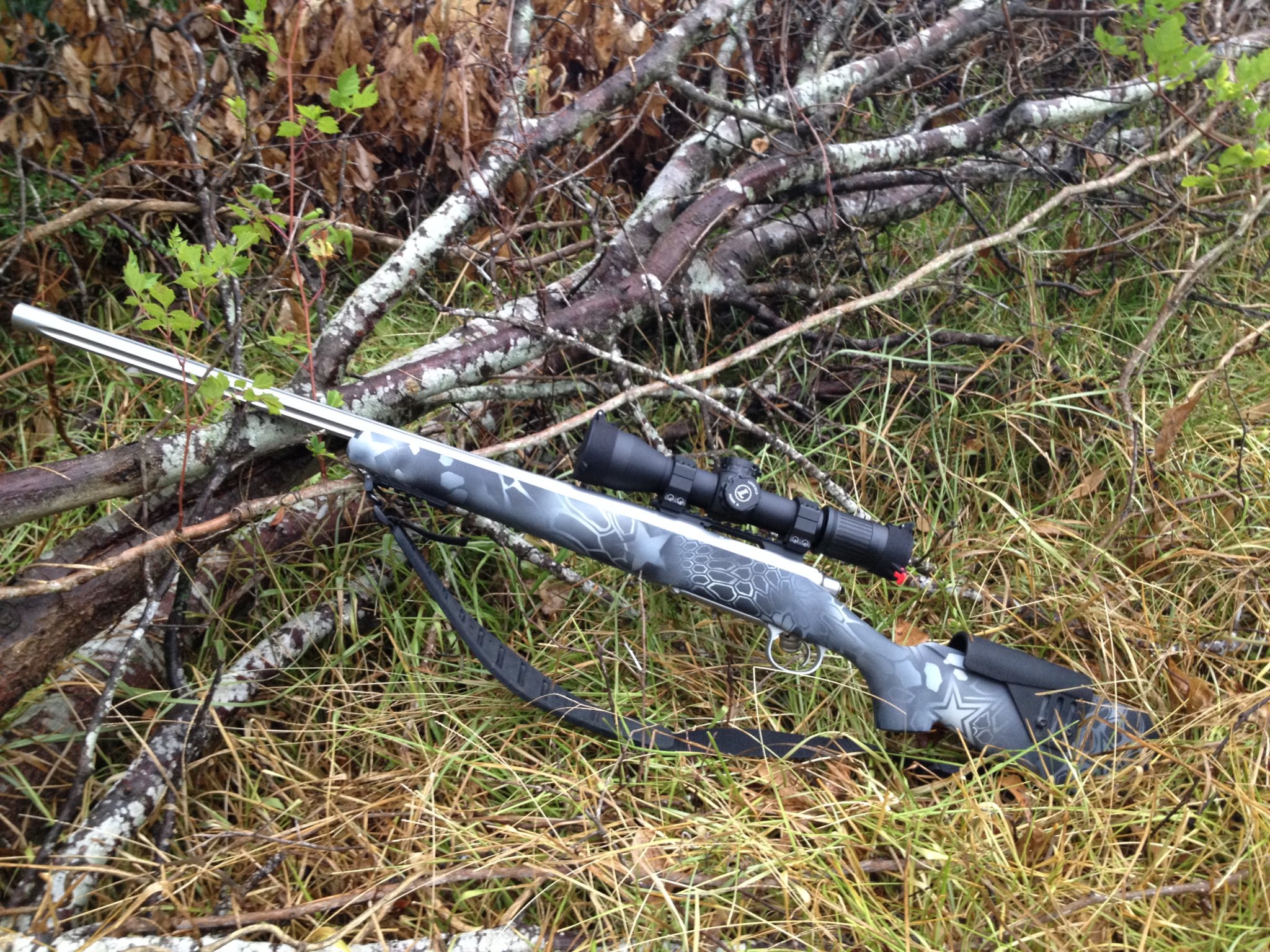

Slightly different finish on the tripod, but both “patterns” seem to be effective in my neck of the woods.

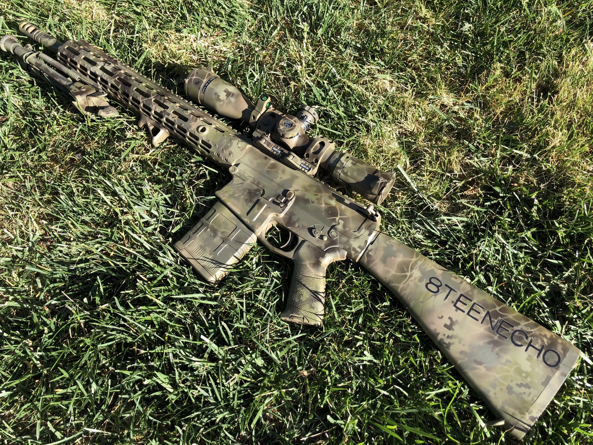

Start with light colors then move to dark. I freehanded a base camo scheme, then laid out stencles over that, then reversed the previous “pattern”.
Brake cleaner will reverse any huge errors, but the whole point is randomness, so just go with the flow.

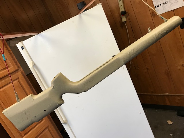

I hung this rifle up for the initial coats, then laid it flat for the finishing touches.
I tape down everything off using frog tape and a razor. Then filled the scope with cotton balls and taped over the end. Pulled the bolt and inserted rolled up notecards to fill the gap. Degreased with Alcohol and laid down two base coats of rustoleum khaki then hit it with stripes of rustoleum dark earth or dark brown. Then went back on the dark brown with a piece of mesh and shot some more khaki.

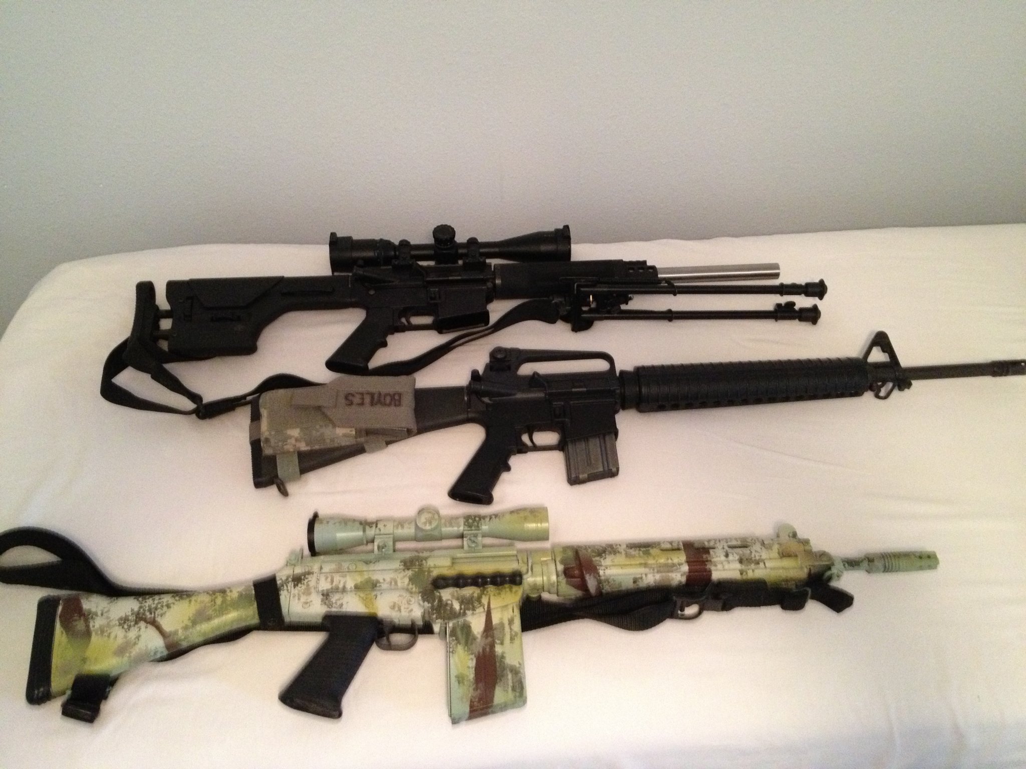

I once had a chance to visit the USMC RTE (Rifle Team Equipment) Shop at Quantico at the Garand Road compound back in the mid-1990's. They had a newly completed M40 that was ready for issue to a new Scout Sniper. It had been sent out to a retired 8541, and he had done a custom woodland camo job on it using Polane(?) and an Air Brush. It was a true work of art, and the thing that especially caught my eye was the tiny subtle highlights with a light spring(?) shade of green.
I think that all camo is local and that the Operator needs to be capable of redoing their camo on their own; things change a lot, and often.
I toyed with the idea of a two layer camo, with a near impervious epoxy under layer of the grays, repeatedly being touched up to reflect changing local camo needs using a translucent acrylic top layer that could be stripped periodically using the Castro Super Clean. I would use a low luster acrylic floor wax as the top coat medium, tinted with acrylic enamels. I never got to actually try it.

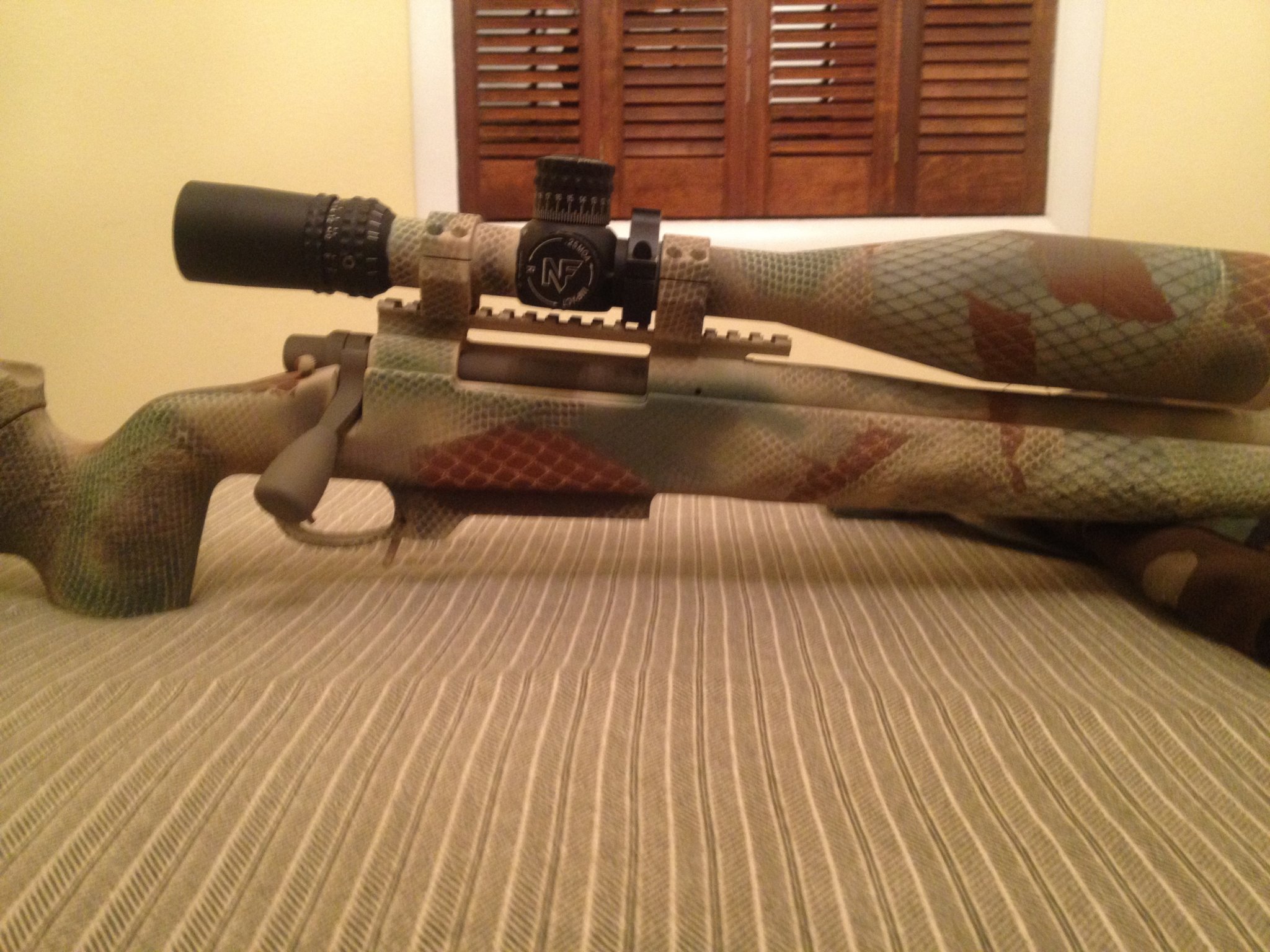

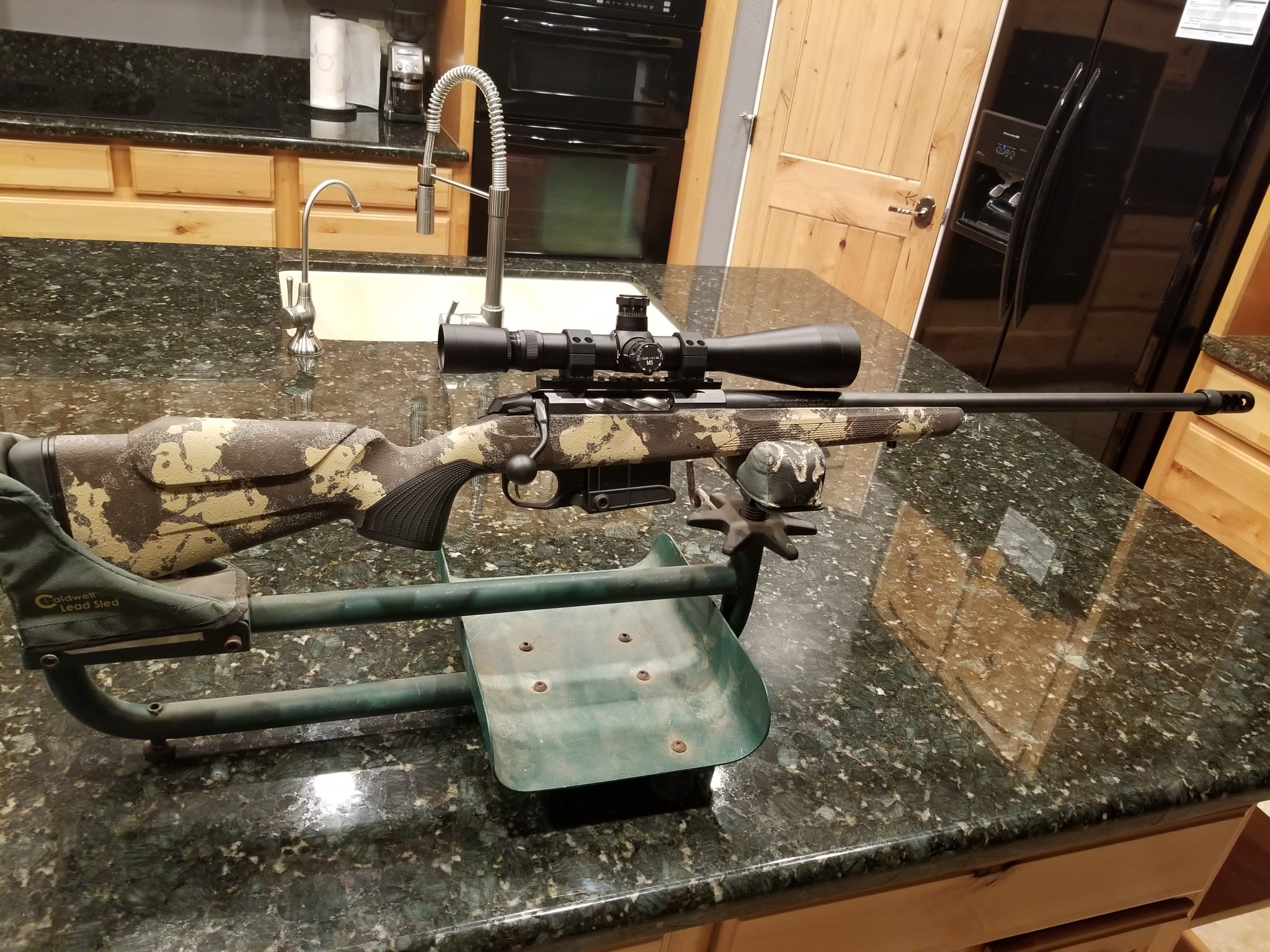

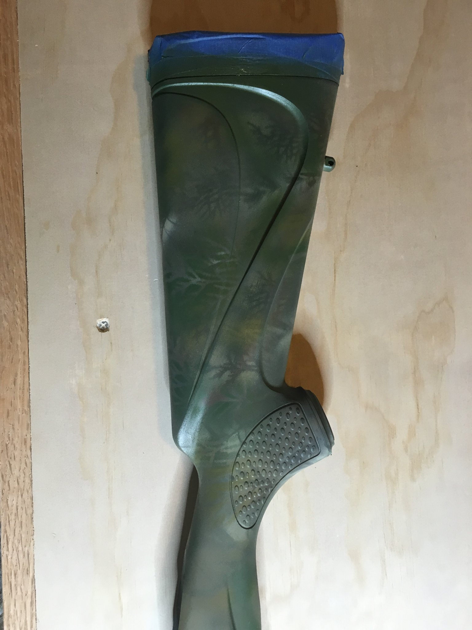

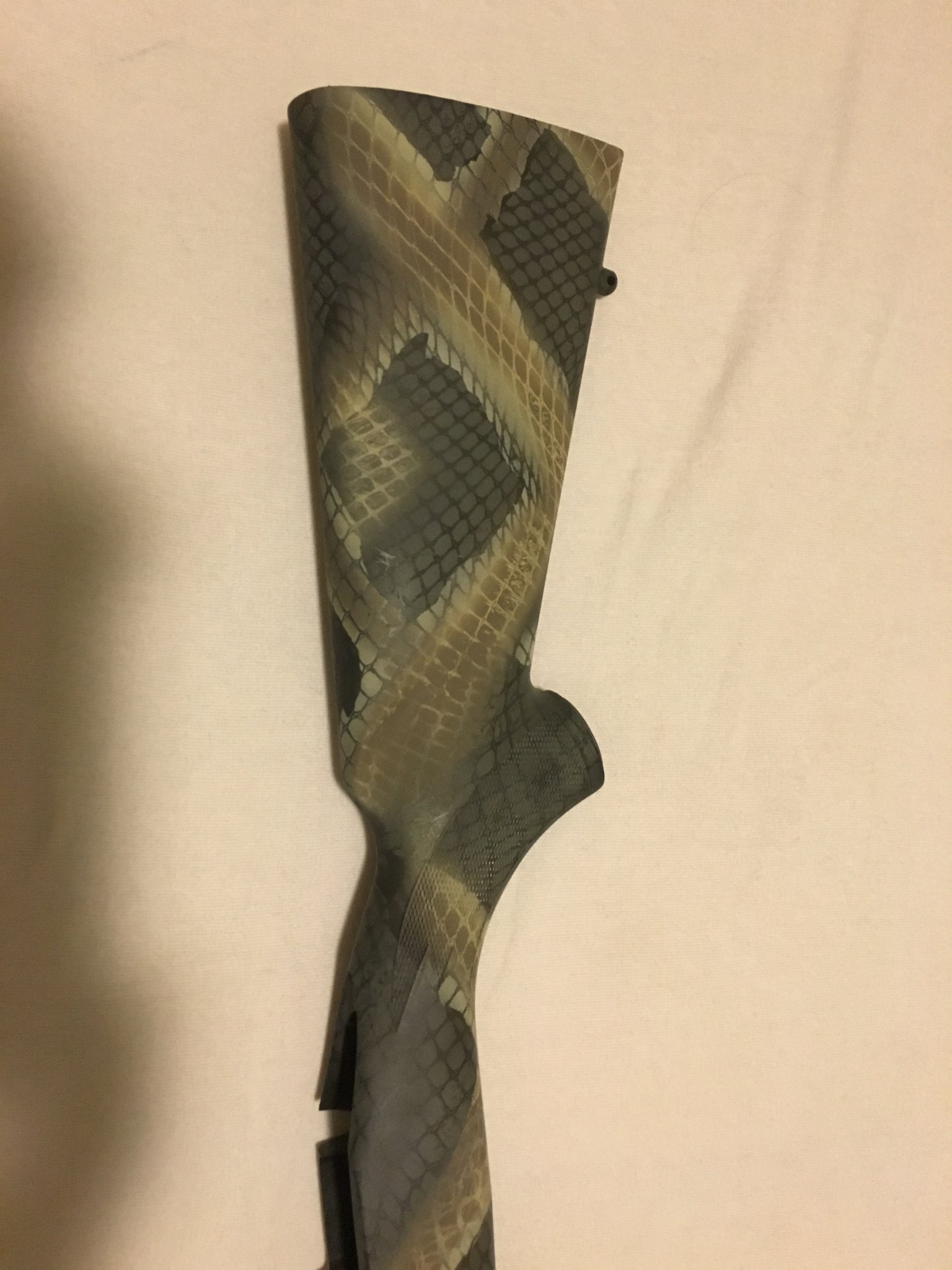

Krylon's base plastic primer is great for adhesion after roughing the surface and degreasing. I like their textured paints for basecoat after adding devcon where I want a bit more bite. The I hit it with the sponges for your camo blotches and several matte clear sprays to keep thing where they are. The rifle below has been handled pretty rough and I haven't noticed any wear yet, but it is only a matter of time. Everything on a stock can be removed with some elbow grease...
This is from a long time ago but here is a Savage I did. I did a base of textured tan then I draped it in a laundry bag to give it the scales using brown and a few different greens to spray blotches. And finally I printed off some B&W pictures of leaves that I cut out for stencils and used the same browns and greens to fill in the open areas.
I used krylon for all the colors and one of the green colors had a sheen to it. It blended really well to my east TN surroundings.

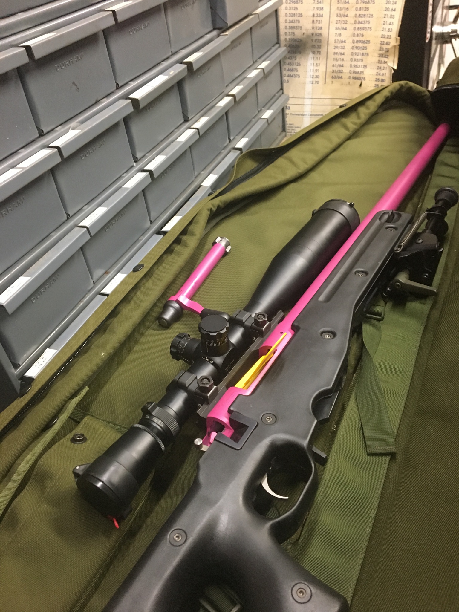

This was supposed to be “Barney Purple” on my 6.5CM:
I called LCW to complain and they said, sometimes it dries pink.....

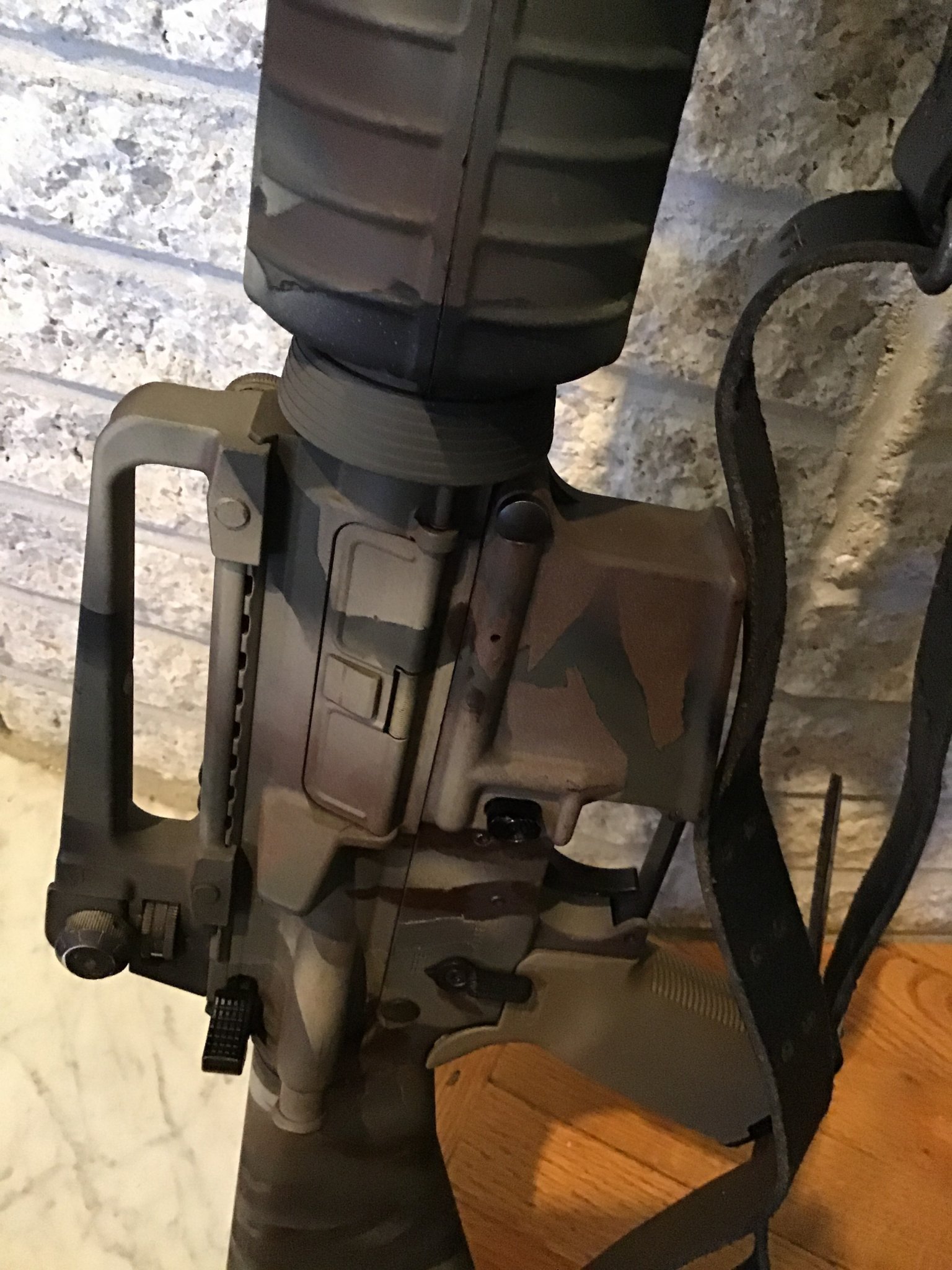

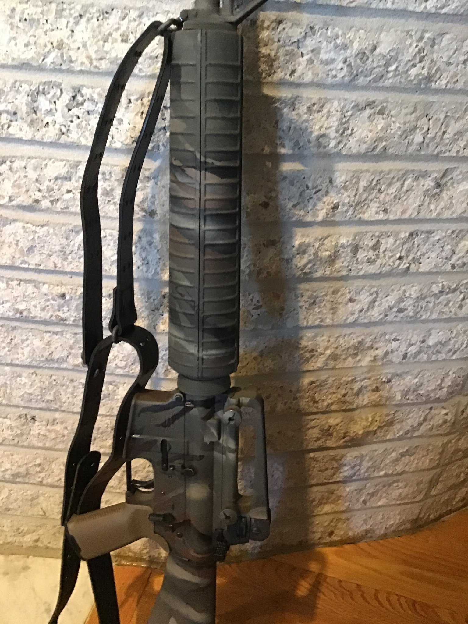

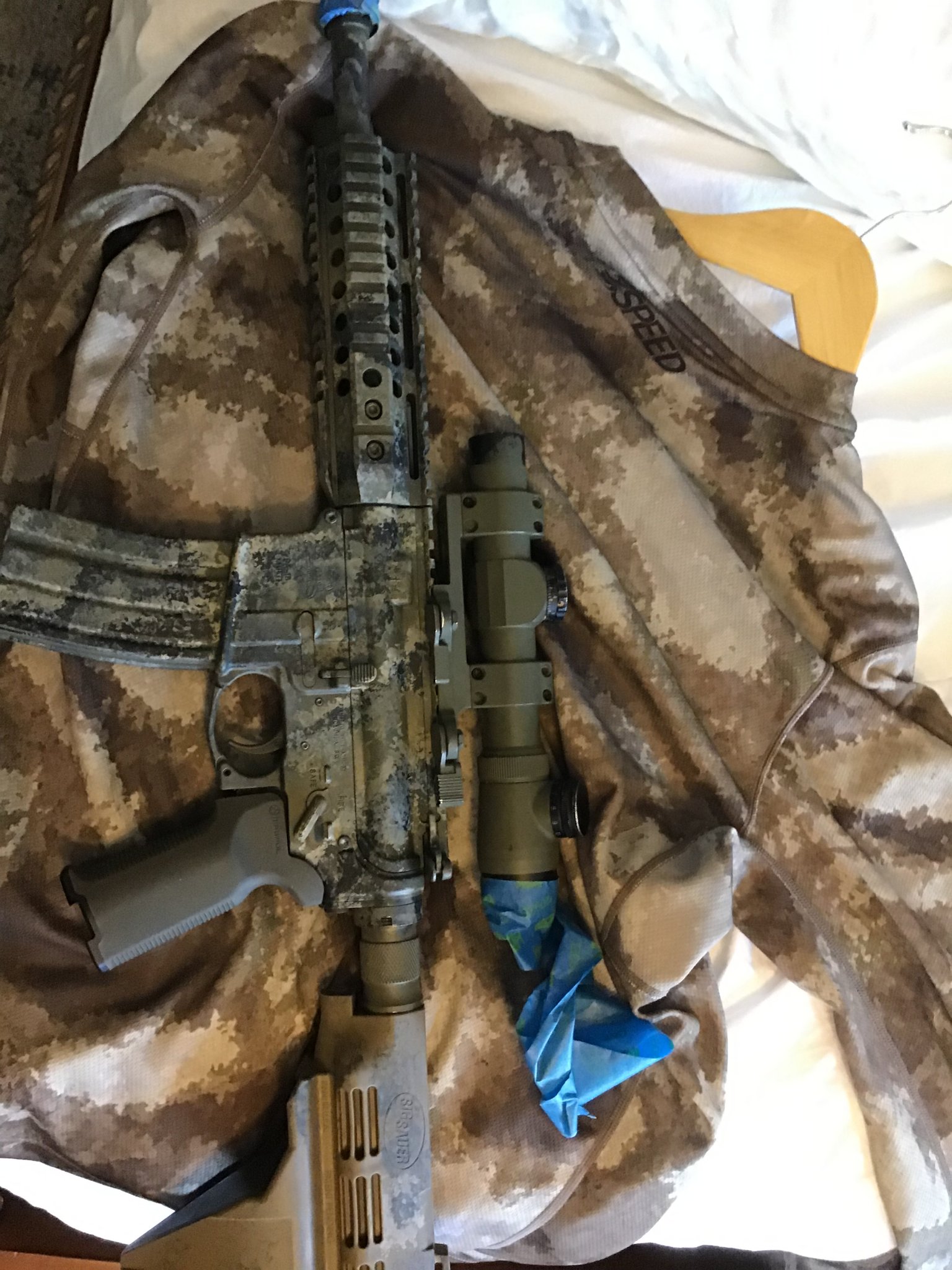

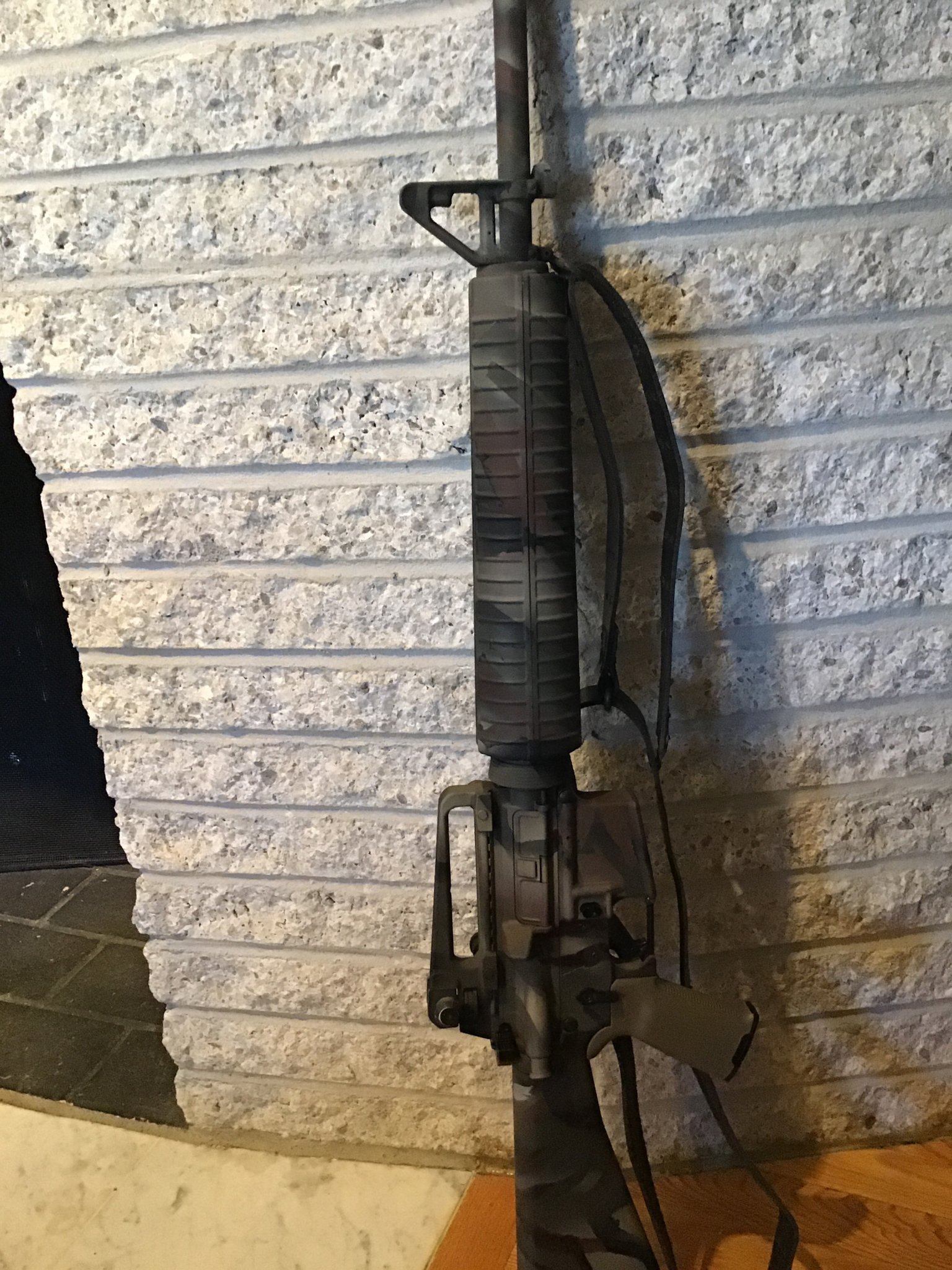

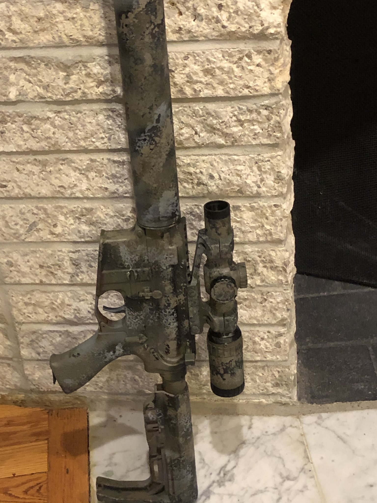

Here is my first attempt at a semi pro finish
Good degreasing alcohol prep
Brownells alumahyde 2
Hit with heat gun first and after every coat

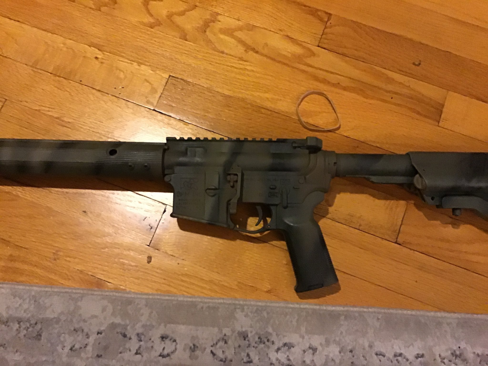

I think whole rifle fde, with 4 or 5 brown stripes
Taped of 1/2 with eyeballed bdu or tiger frogtape pattern
Then Od with different brown
Then added blk sqiqqles.
I tried to do 1/2 sharp edges , half blended transitions
It’s a PSA premium 20” a4 with colt surplus carry handle, mbt trigger
Should be a fun useful addition esp for $.

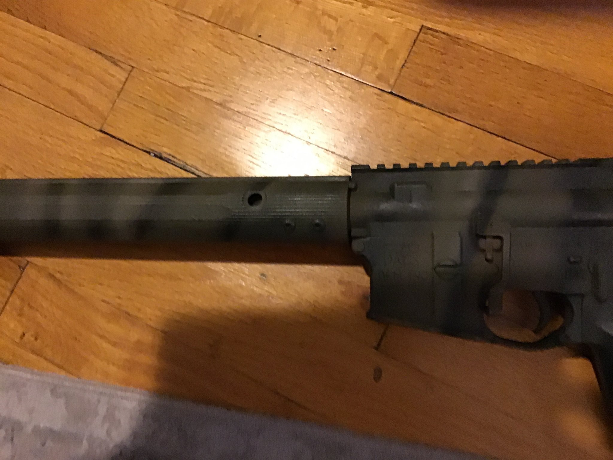

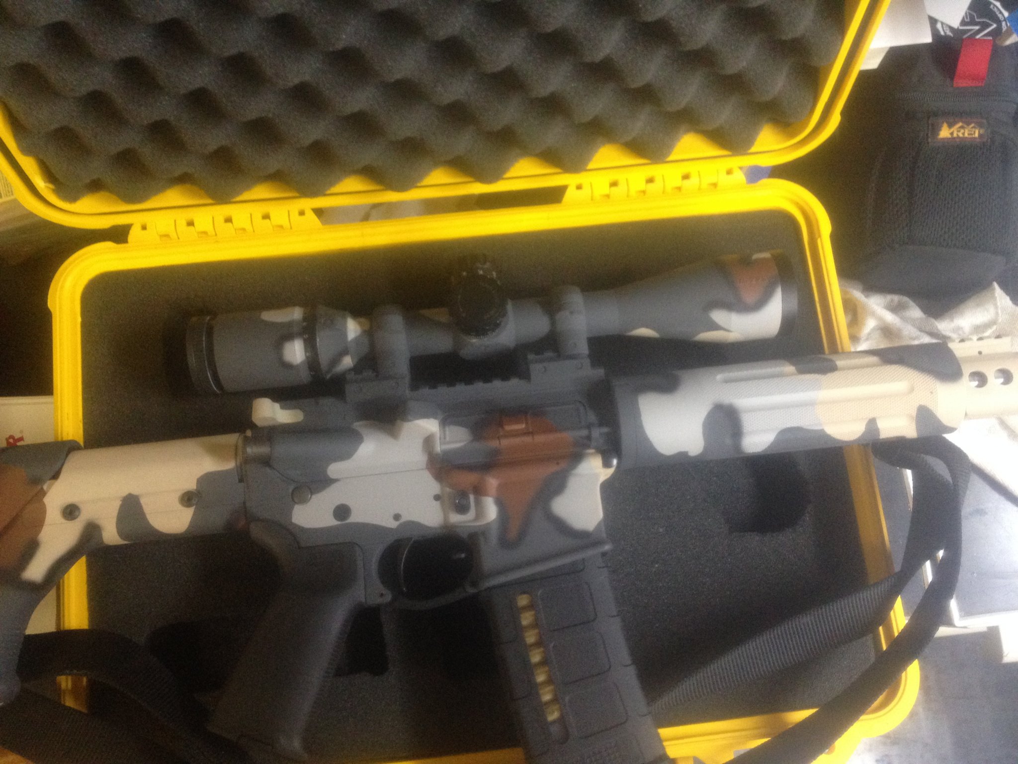

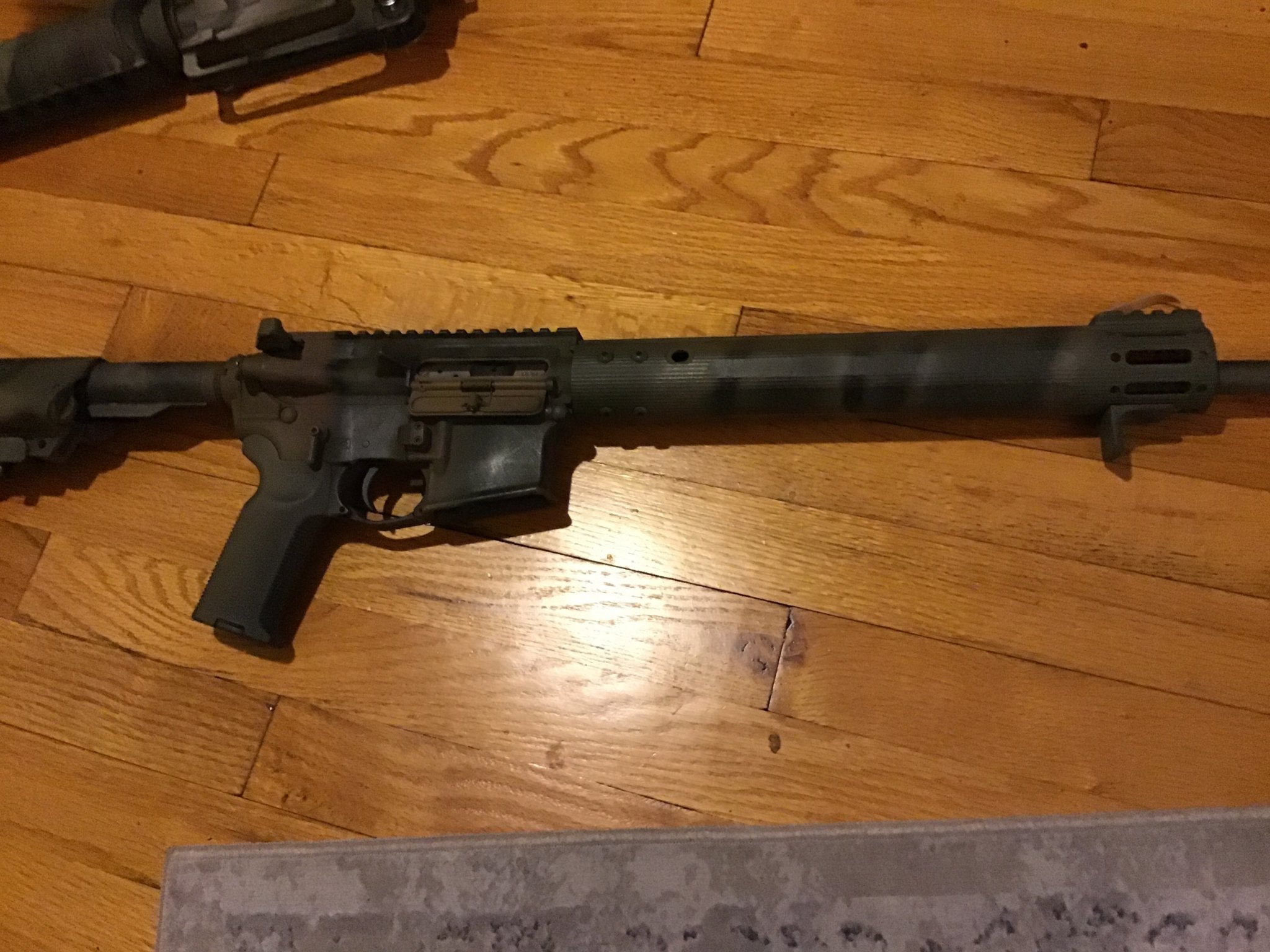

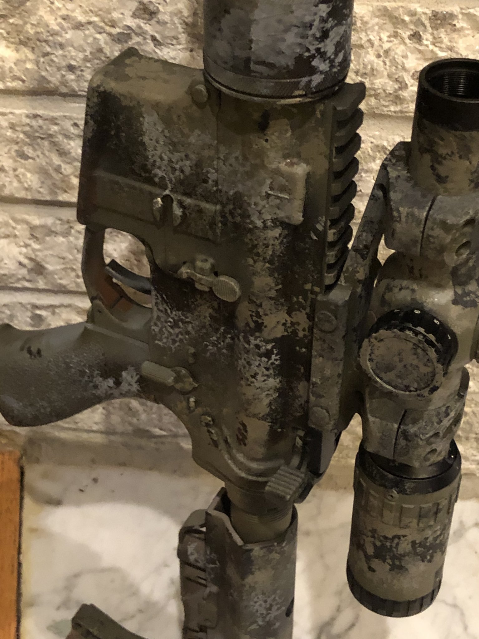

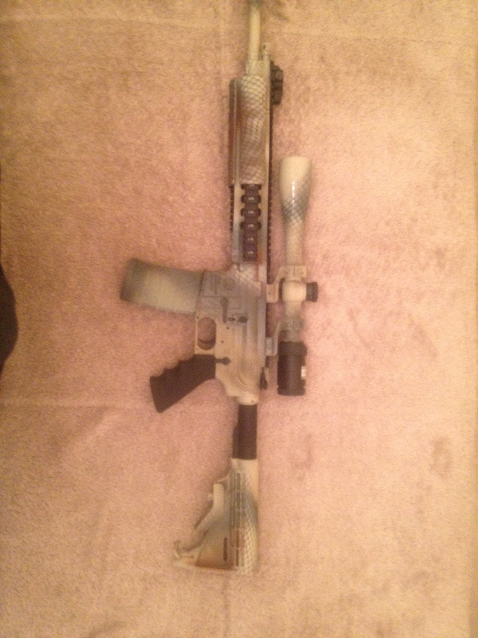

Here’s another same prep. Same product/ colors. Done at night with no tape just diagonal stripes
It’s a sweet bpm (Barnes Precision Machine) 16” hyperfire trigger. Vltor a5, Alg handgaurd , radian ch,
First owner had painted it with 4 colors of mud brown. Needs a little more woodland
Heat gun is good and friend of the impatient man. I think it’s functionaly as camo but I did in 1/4 time. Contrast was a little bold, I dusted the whole thing in OD prob in overreaction to the brown.

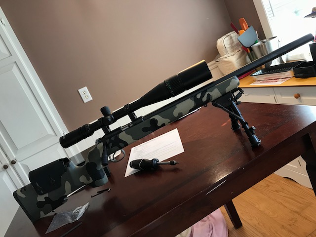

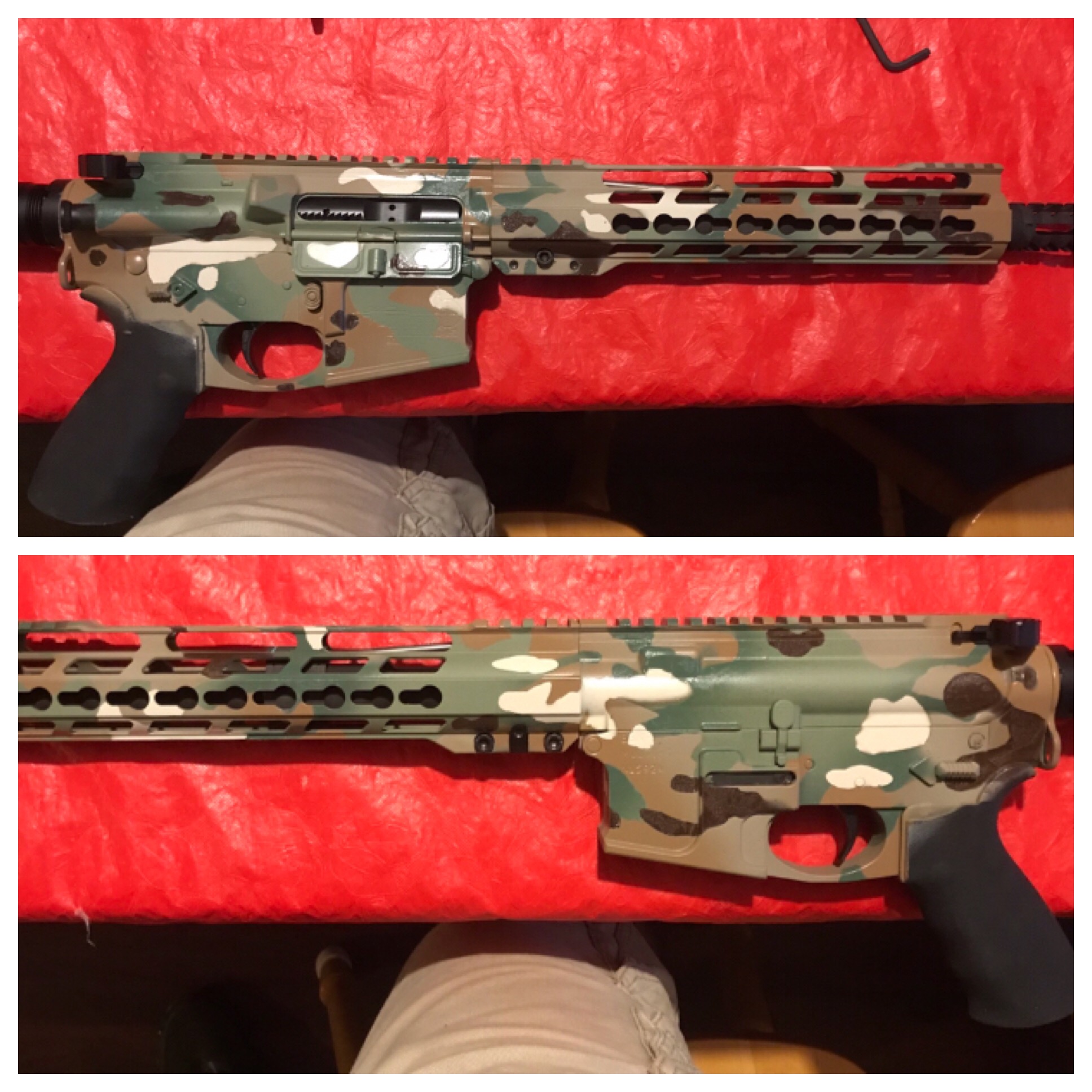

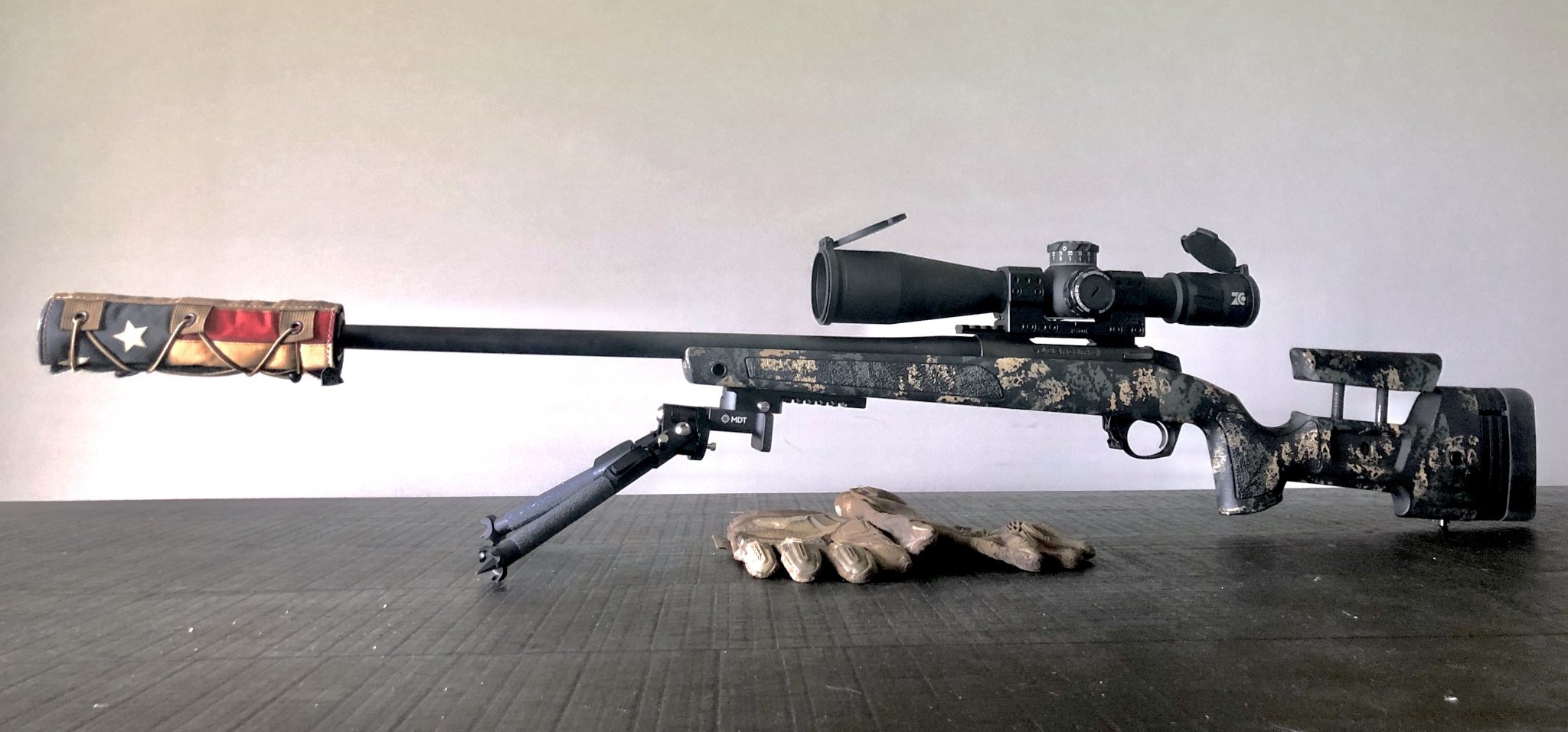

Two that I’ve painted. The bolt gun was sprayed black and then sponged. In order to sponge I just sprayed some cardboard dipped the sponge in the paint and applied. The ar10 I used primary arm multi cam stencil. Same rustolem camo paint
