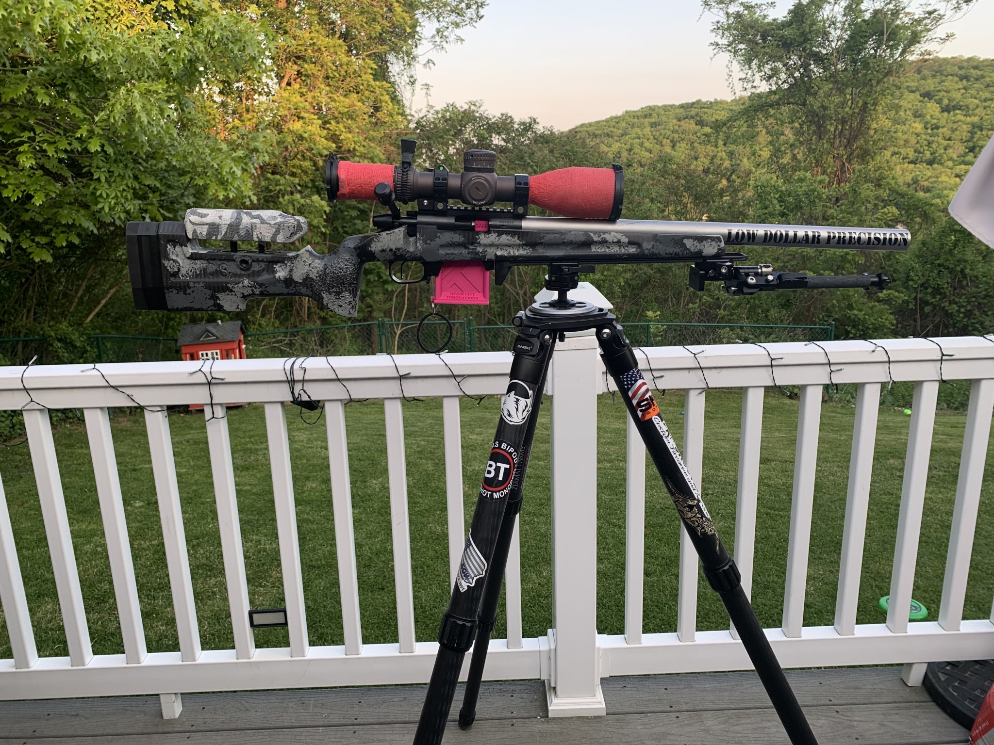

I went with the RimX, particularly because I liked the features they offer with the action like the ease of getting prefits spun up, the adjustable mags and the feel of the cocking cycle. Also I have a soft spot for stuff from Zermätt since I’ve got an origin and TL3, so the RimX is a great addition to the family

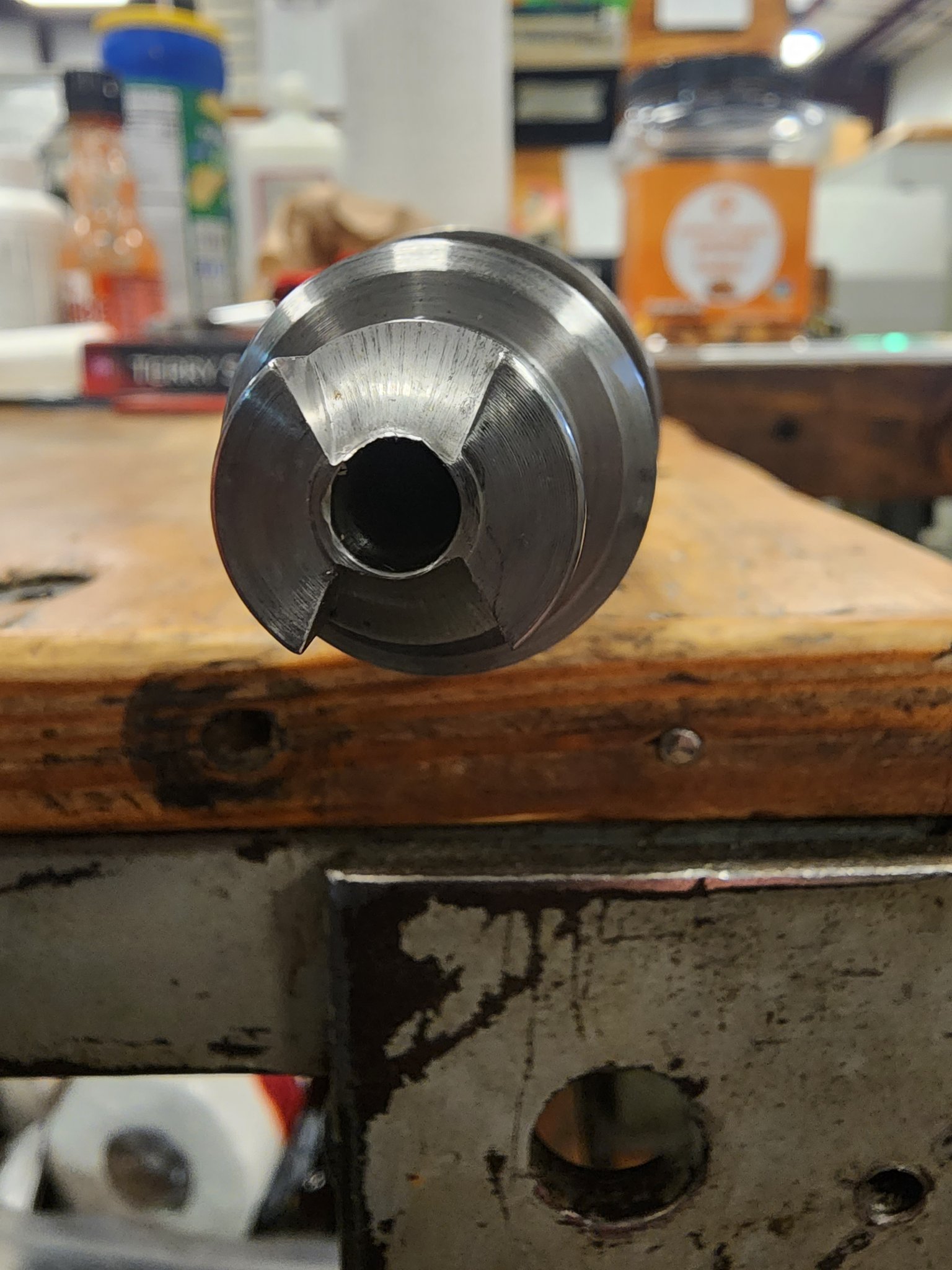

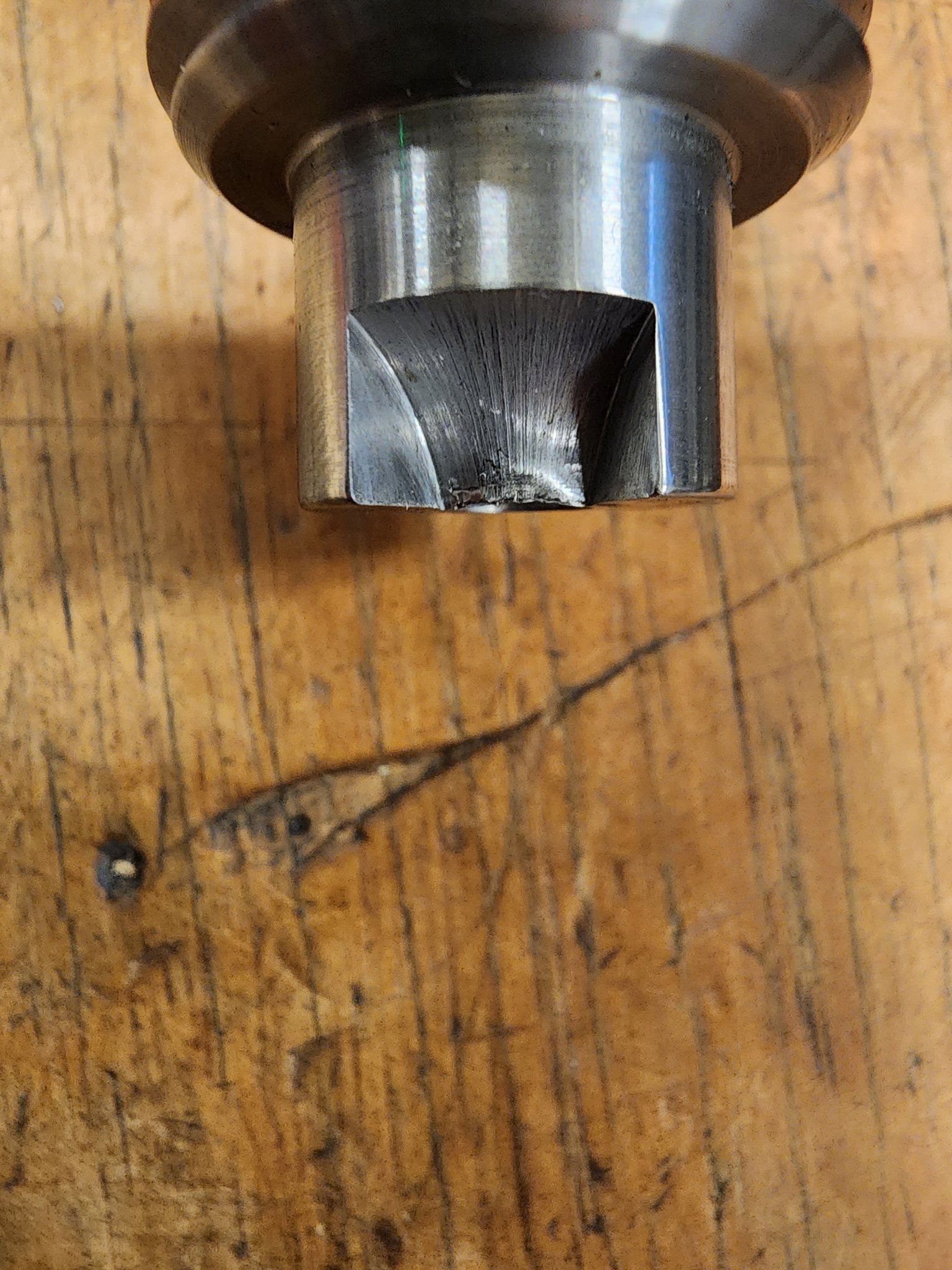

I know this thread is a few months old but for information purposes, this is my 2nd barrel from ibi. I had to send the first back because of loose chamber. You could drop a round in and shake it and it was really loose. This one.. well I think you can tell by the pics.View attachment 8261820View attachment 8261821
That’s seriously shoddy looking. How could that pass any QC check?
I haven’t heard great things about their prefits with the barrel nut, I’ve heard of a number going back because of thin spots getting banged up around the chamber mouth or just messy chambers.
Reactions: DH302
seven axis dremel magik going on there

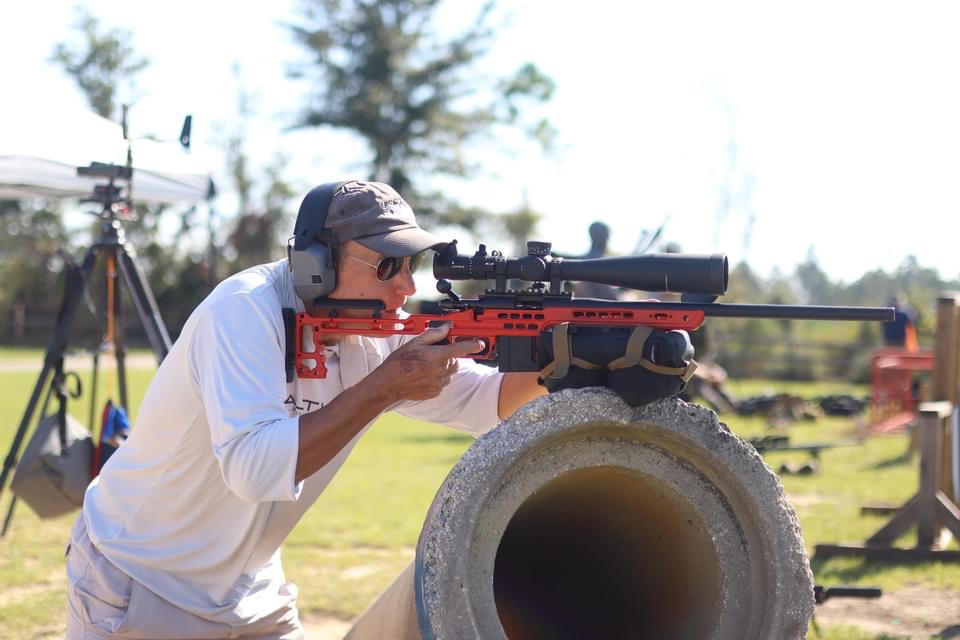

Vudoo. Why? I just started shooting 50 yard benchrest, first 2 matches I placed 2nd. Third match came in first with a 250 and 17X score. Oh and my target was not staked down correctly and was moving in the wind. Mine likes Lapua Center-X and I have went through just about every brand of ammo currently available including Midas+. Placed 2nd with the rifle after only 50 round break in. Really there was no break in. It shot well after the first few rounds. Topped with a Nightforce NX8 4x32x50 FFP. I also love that scope. I have Vortex Viper PST 5255 5x25x50 and a EOtech 5x25x50 both FFP. Nightforce wins on clarity and Parallax down to 11, Vortex is close at 20. There's a couple RimX at the Matches so first I'm scoring higher and speaking with the owners I only heard about feeding issues. I didn't ask about details. In the Match that I shoot in best so far has been 250 and 20X, 17X is awesome and I think a 25X is possible!!

No tuner needed. Photo is from last practice, it groups better if I do my part.
Vudoo Gun Works Apparition .22 LR V-22 360 Gen 3 30 MOA
Lrg Bolt Knob 20" Threaded MTU Contour Black Bbl Rifle w/
MPA BA Comp

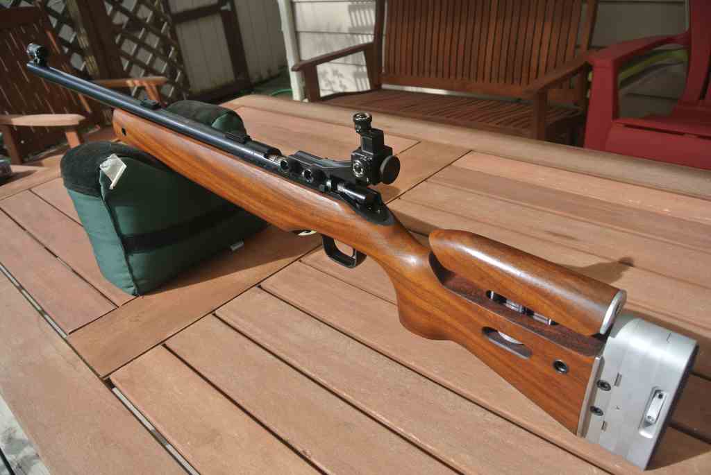

Unlimited Kimber 82G late 1980s
Love the surplus Kimber 82G in here with all the multiple thousand dollar rifles. They were $400 with a nice diopter sight included when the last ones were sold in ~2012 btw. For what it is worth, my best 82G out shoots my Anschutz 54. My Vudoo is better than both though. I do not think this sort of performance is anywhere near average from an 82G. I bought a number of them back then and there was a good difference in perfromance from rifle to rifle. They could be pretty sloppy with the barrel crowning and the barrels were not top tier blanks to start with. They also culled out some of the best barrels for their star grade civilian rifles. Still, all the CMP 82G's were spectacular for the price and I dont' think they got all the hummers. My best one averages truely excellent sub .4" groups at 50yards with quite a few different lots of match ammo. Also, my Anschutz 54 is not a particularly good shooting Annie. Still, its fun to see an 82G shooting with the big guns. I did a little extra work on mine back when I had time pre-kids.
