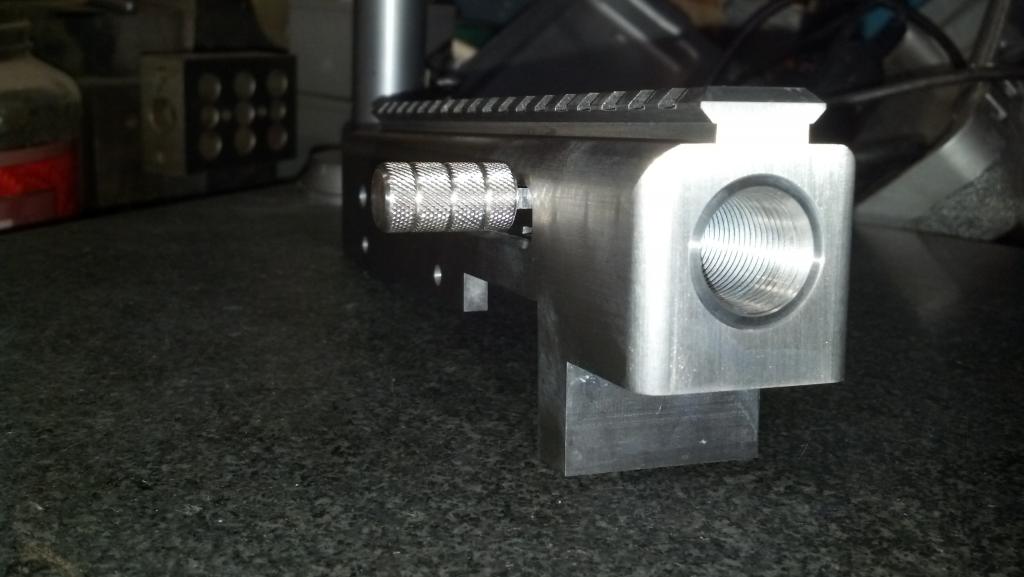

I built three of them from blank receivers for less than 650 each. Blank receiver at brownells, 89, trigger, bolt/charging handle pins and bolts on ebay 90, Stocky's has a titan stock/barrel combo for 260, looks like were at $440. For another 200 you could have the trigger tuned by Brimstone, http://brimstonegunsmithing.com/tier-3-basic-ruger-10-22-trigger-work/, put a rail on it and upgrade to a JWH bolt and charging handle and still be under that price. It's easy to put them together. I'd love to build another with a feddersen receiver, https://fjfeddersen.com/product-category/receivers/, but there's already 5 10/22's in the safe. :)
Ok, it can be done. Kudos to you for figuring out how to do it, and accomplishing it repeatedly. If I need another, I might hit you up for links. That acknowledged, I didn't do it because at the time I bought it I didn't have the time to invest that way, and I'm really happy with what I got for my money. Since this is a thread about a particular make and model of rifle, and not about building a clone, could we return to our regularly scheduled programming?

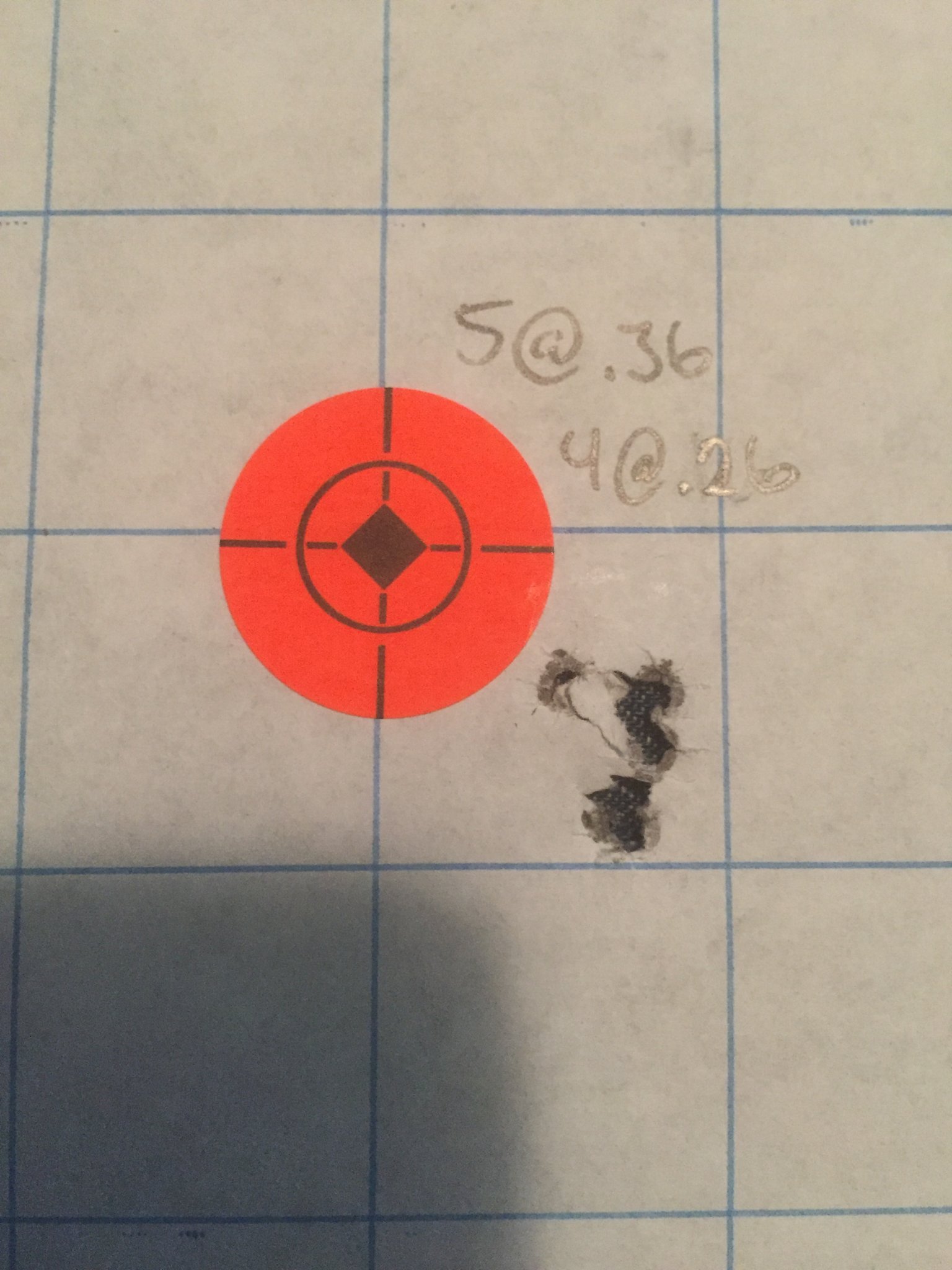

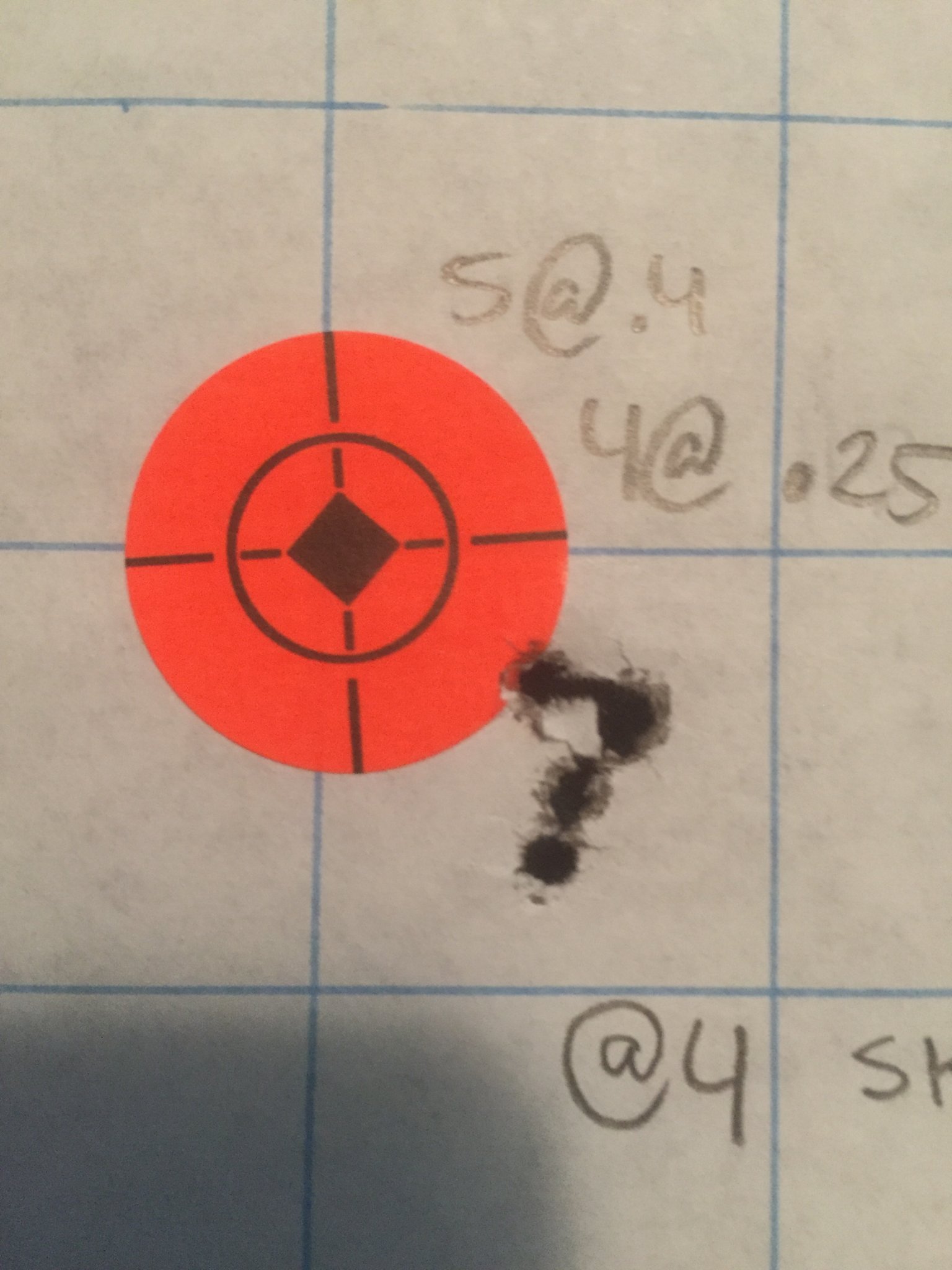

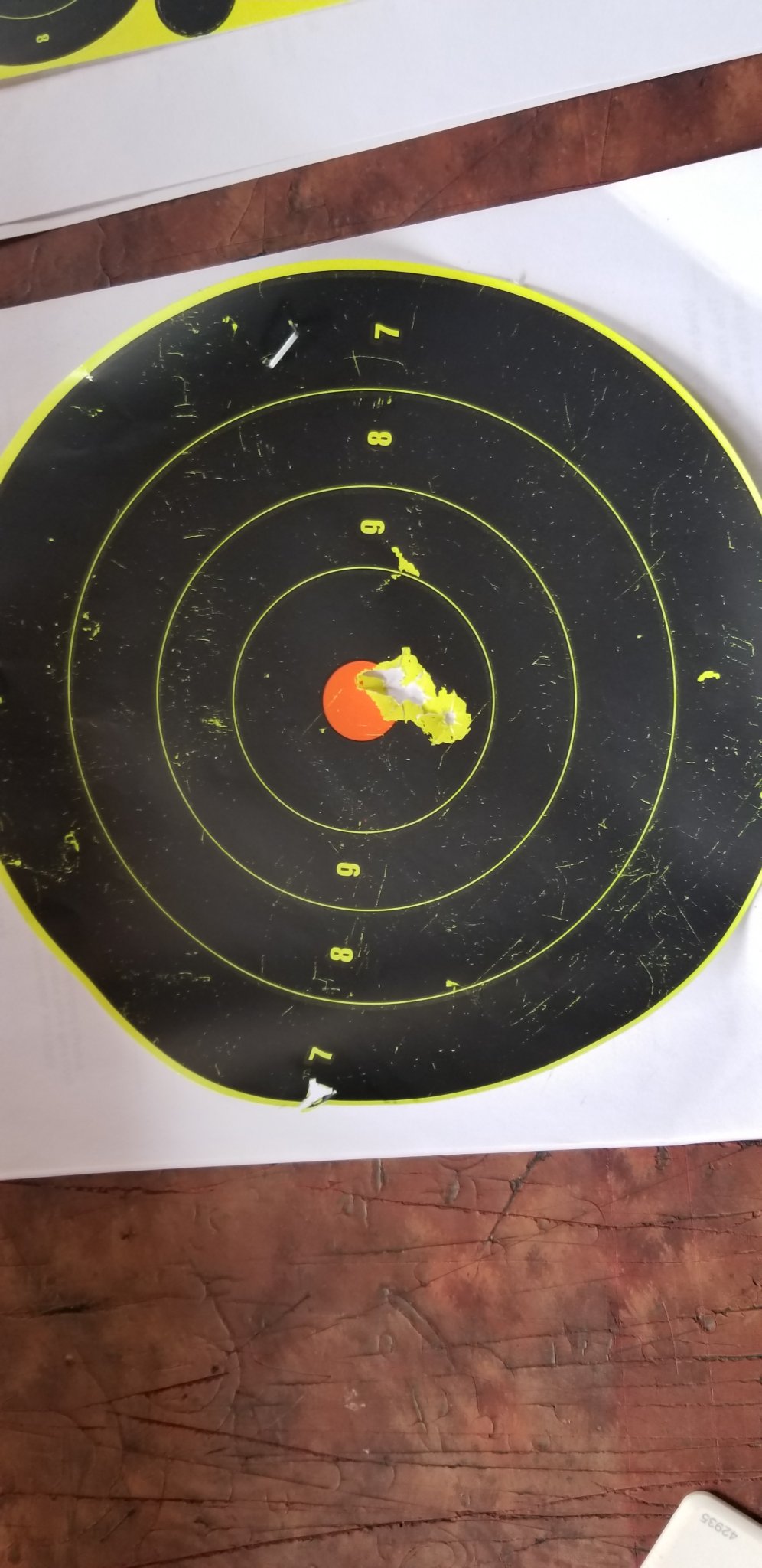

Let's see some groups, I'll start this off with 50 yard KIDD shot targets. The two smaller groups are SK rifle match at 5 shot groups.

I posted some groups above. I don't have calipers so I didn't measure them, but you can see what they were. The reactive targets are three inches across. (The streaking is because I managed to stick that sheet to the back of the larger 50 yard target when I went to recover them, and had to pull them apart.) I'm not going to begin to pretend that all of my groups look like these - they don't - but I did shoot these with this rifle, and one after another. I just got good conditions; happy ammo; and, a good mindset, all at the same time.

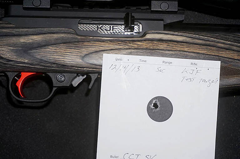

The attached photo is a five shot group after zeroing the scopes at 25 yards on the rifles I built for my nephews. Each one got the "test" target in the case with their rifle as a Christmas gift. Rifles were built from blank receivers, JWH bolts with their initials, GM barrels, I cleaned up the triggers, raptor stocks, 4-16 ffp scopes. I also added pillars and a rear anchor that indexes with the cleaning hole in the back of the receiver.

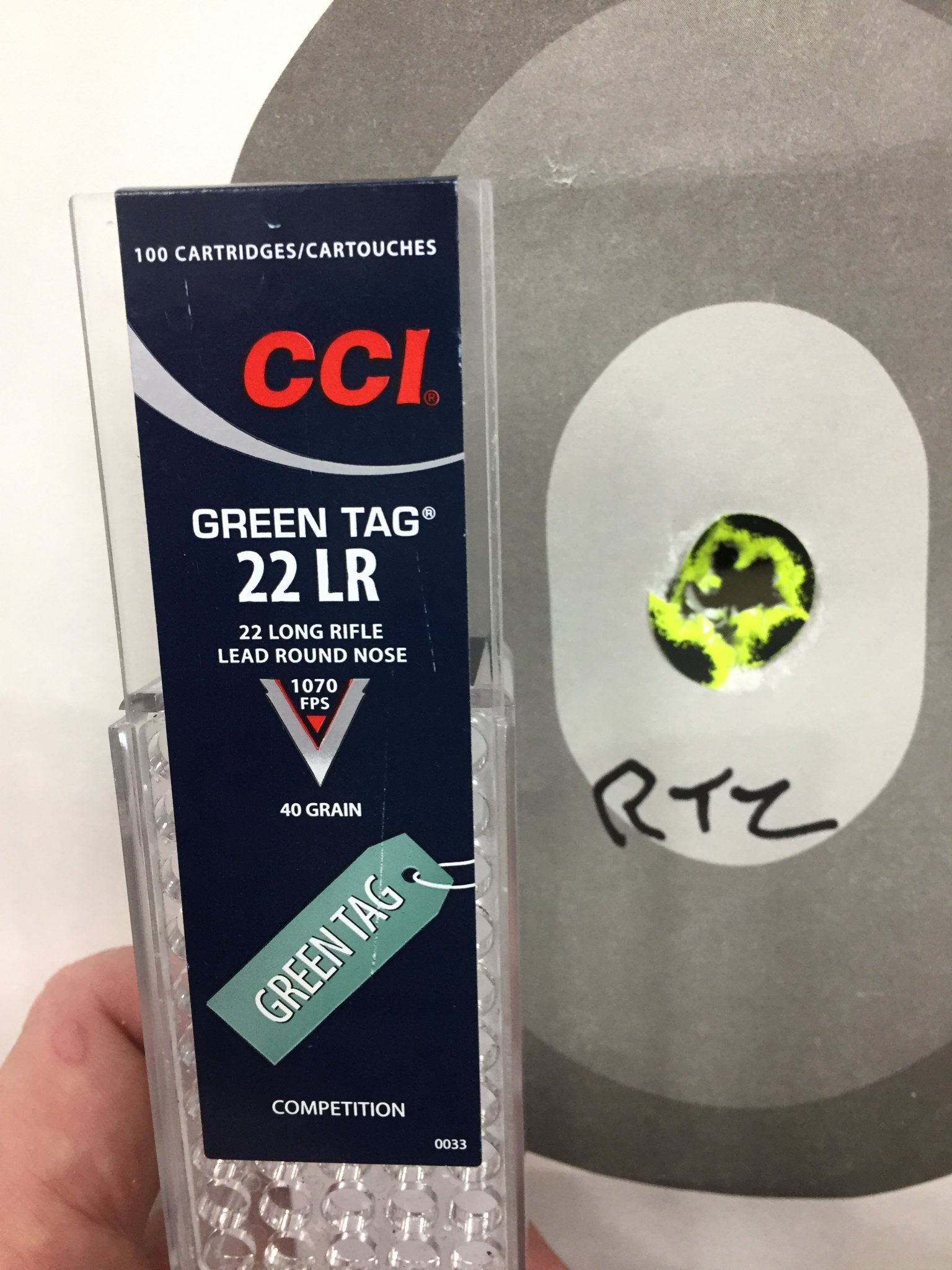

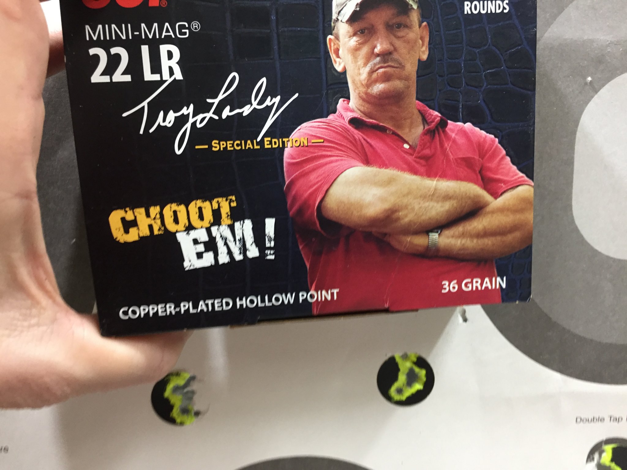

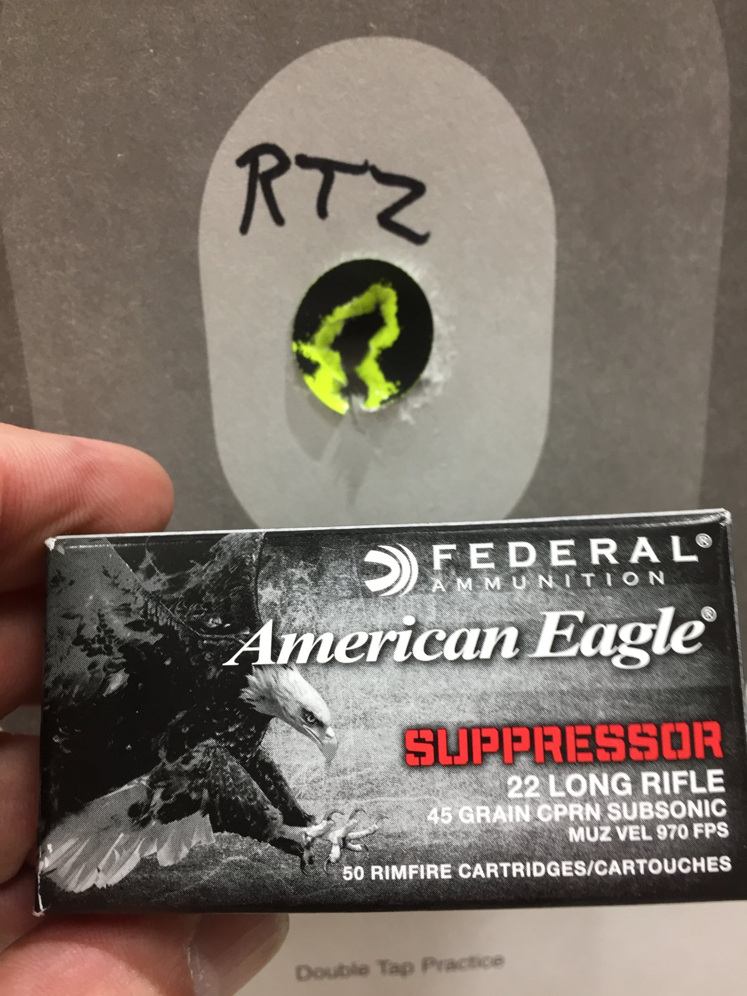

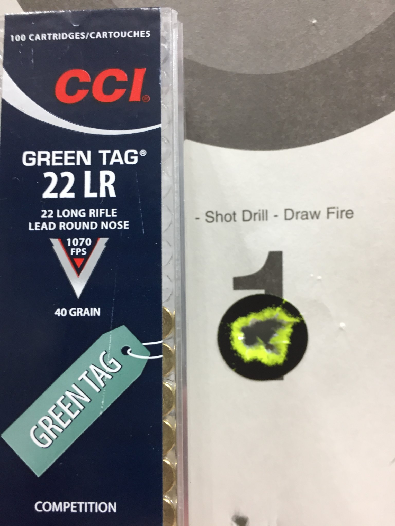

Hi all, I have been lurking for a while, and decided to join you. I have been interested in the subject rifle, and was looking for field reports. Two weeks ago, my wife caught me looking at the Ruger website and said just get it.........what more reason should I need, right? I topped it with a Leupold 3x9-40 VX Freedom Rimfire with Warne QD rings and went to work using the free LGS range time. Granted, 25 yard indoor results are not ideal, but I am impressed anyway. I have been working to zero the scope, and test function with varied ammo. The gun hates all things Winchester, runs well with Federal and loves CCI, even the bulk stuff. Perhaps when the weather permits I will have 50 yard bench results to share. For now, these are 10 shot groups shot from a poor crossbar rest and a sandbag.
704020570402067040207
Reactions: Rebels010
Winchester (not-so) super-x would not chamber at all..... It’s not the bulk stuff, and can’t remember which trays I used, but I know I’ve used it in other rifles with no issues. I had two CCI standard velocity fail to fire (they worked on subsequent attempts) and one not quite chamber fully (bolt needed a nudge to close), but the groups were about the same as the Mini-Mags. The high velocity Mini-Mags fed, chambered and fired without a single hitch, and their accuracy seemed good. All the above was done on day one, with a Leupold Rifleman 3-9x40 that I had available. I ran several rounds, then pulled a bore snake through-I’m not a big barrel break-in nazi, but thought it deserved more care. It became clear on day one that the rifle was capable of more than the 150 yard parallax adjusted scope was going to give.
I considered stealing a VX2 4-12x40AO from my #1V, but decided to get the Rimfire scope w/BDC reticle instead. With it’s 60 yard parallax setting, I could definitely see improvement on target during day two work. I have a set of older Warne mounts on an M77mk2 target, and love their return to zero after being removed and replaced on the rifle. That is why I used a new set of them here. Below, RTZ labeled groups-return to zero after removal, allowed rifle to cool, and reinstalled scope and fired 10 round groups.

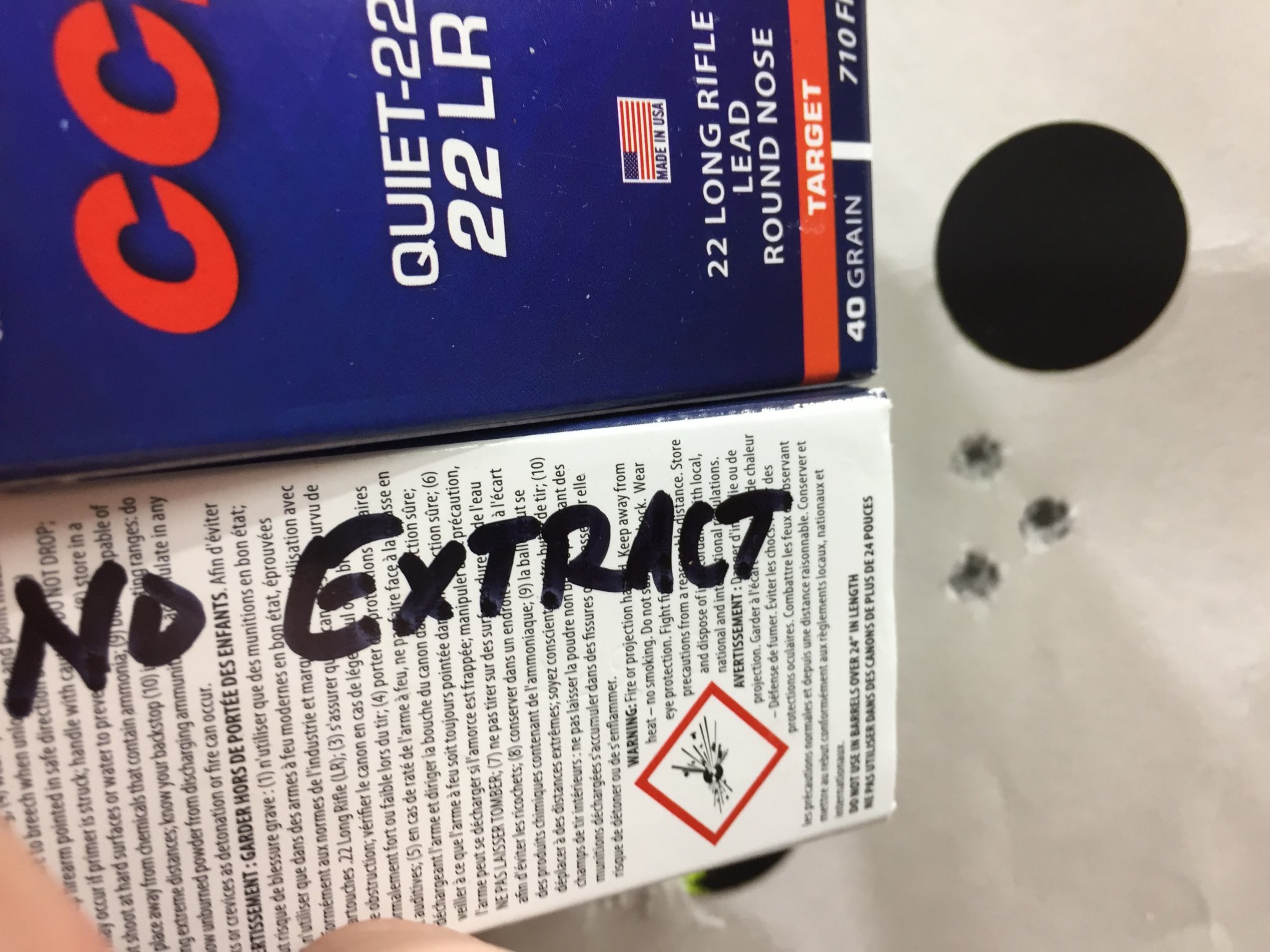

In addition to the fodder listed earlier, I also tried CCI Quiet suppressor rounds, and they failed to extract on three rounds..... Their group did not give reason to try any more. The Federal 45 grain subsonic Suppressor rounds functioned well with good groups, so if my desire to get a can comes true that is what I will start with.
.704104770410467041045
Sorry for the winded reply, but I really enjoyed my range time! I have one more free range day where I bought the rifle, so hopefully I will have more to post soon.........
Ya know, I’ve been geeking about groups, and forgot to mention that the gun attracted a lot of lookers at the range..... The stock alone triggered quite a few questions and comments. Have I mentioned that I’m really happy with it???

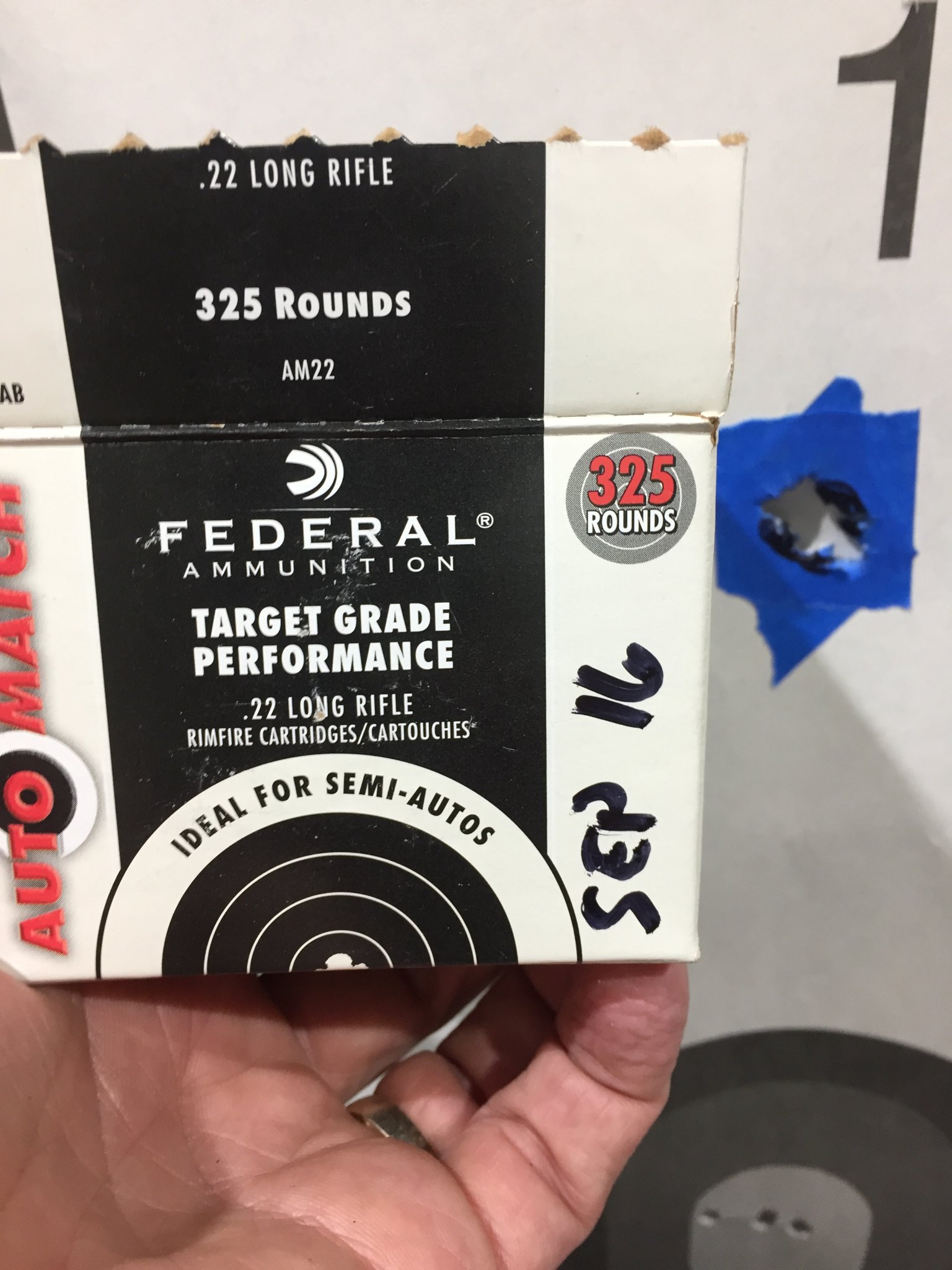

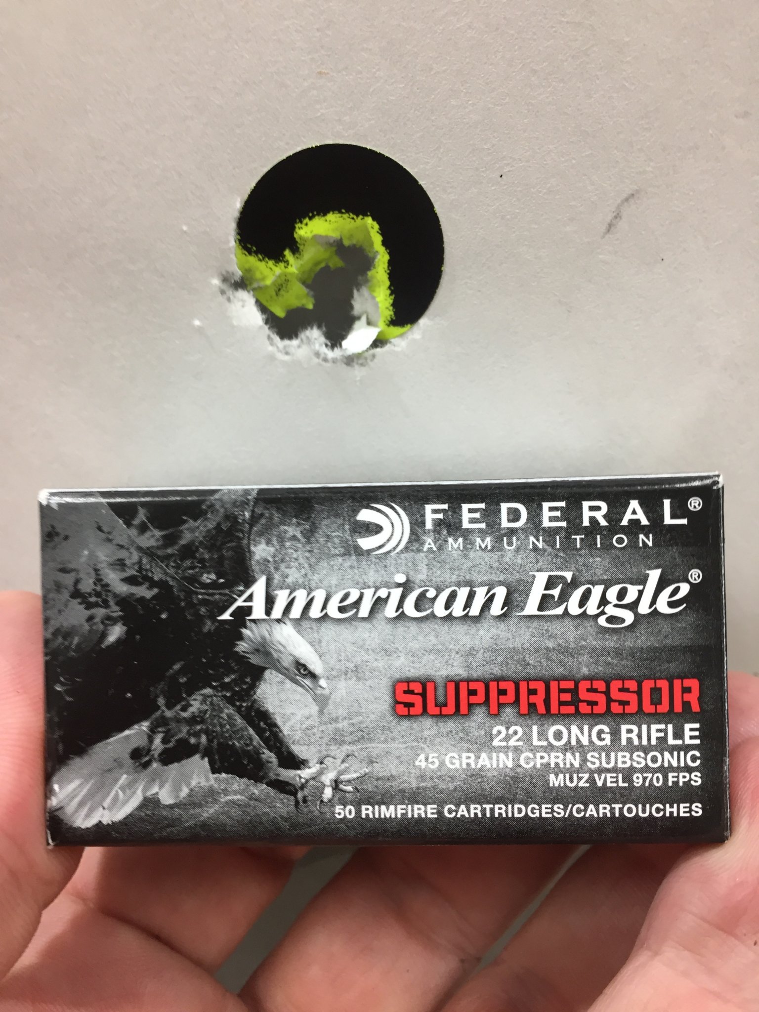

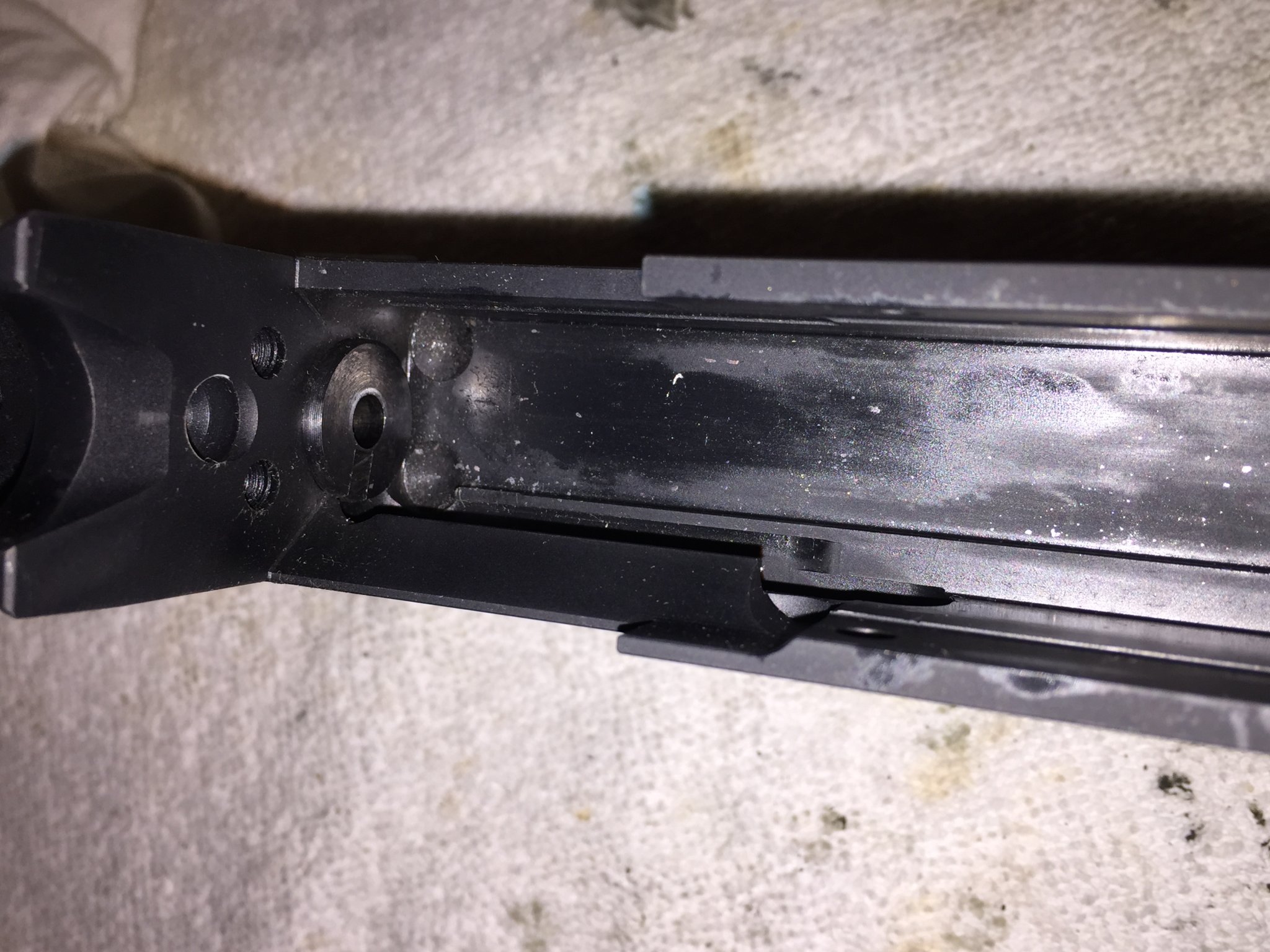

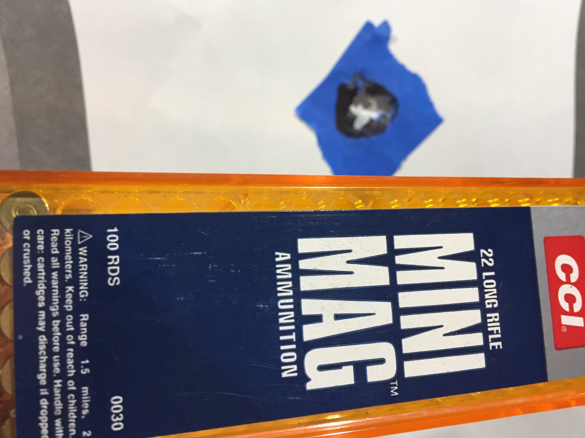

Burned up my last freebie at the gun shop indoor range today. Had multiple fail to fire with CCI standard velocity, and they always fired on the second strike. For giggles, I ran the remainder of that box through my MK2 pistol, and they ran fine. It seems my rifle just won’t run them reliably.
I also shot Mini-Mags and Federal bulk, all chambered, fired, and extracted flawlessly, ten-round results below. Hopefully soon I will have 50 yard results to share from a good bench.
70436067043607

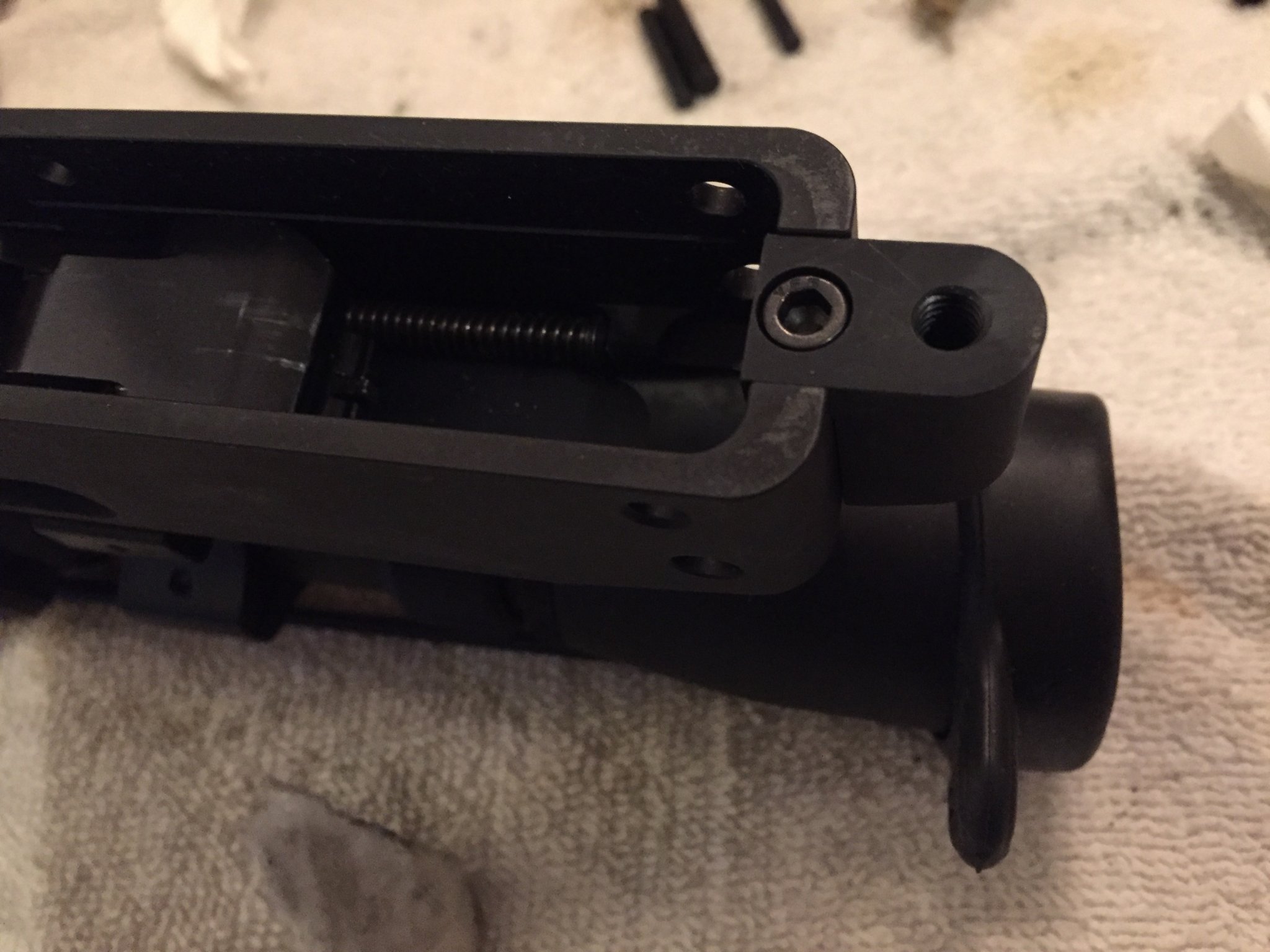

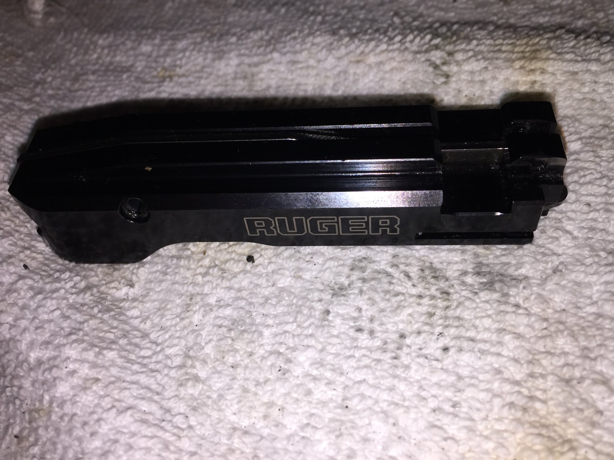

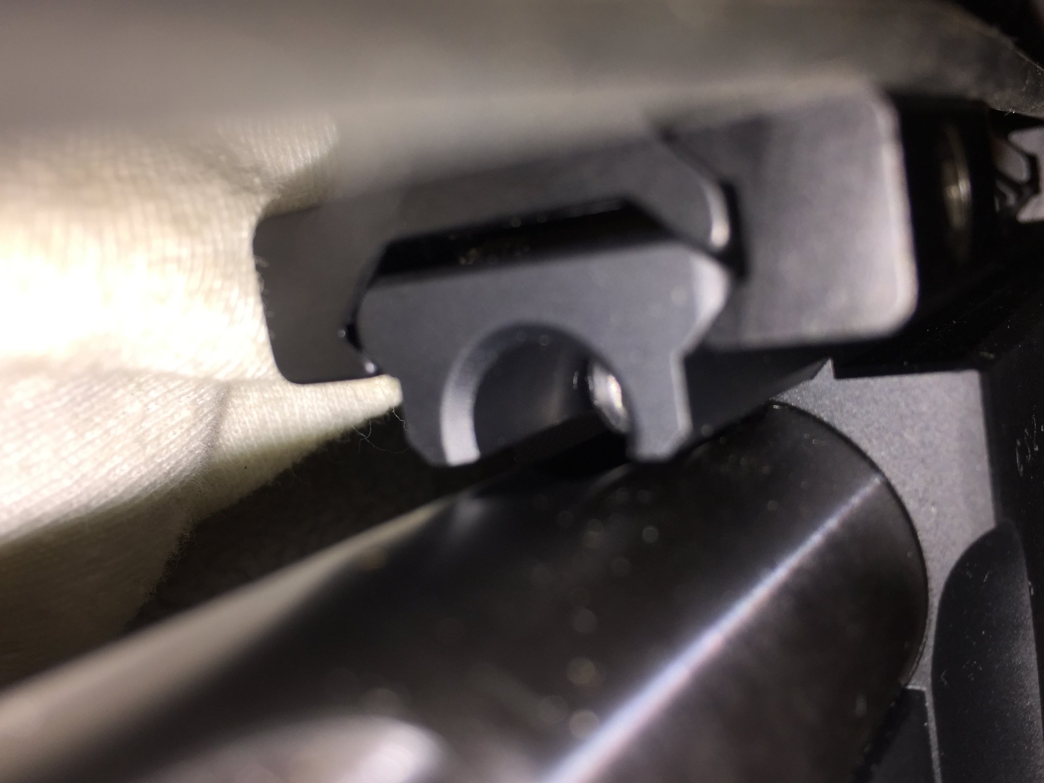

I have not removed the barrel, with the cleaning hole in the back of the receiver I see little need. The barrel has a notch at the top which a screw head catches where it threads into the receiver’s top. It is cleanly concealed by the forward extended rail. The rear tang is a block screwed into the receiver bottom, removal allows access to the cleaning hole, and with it off the barreled action will (supposedly) fit in any 10/22 heavy-barrel compatable stock. Pics below, some are hard to see because everything is black. The rifle’s receiver is fully milled inside. The bolt is entirely different, nicely milled with the firing pin retained with a transverse roll pin instead of the usual top peening. Even the bolt handle and recoil spring are different from the usual 10/22. The departure from the typical construction was a big attraction for me.
287B5913-B4F0-4334-8D32-4B1F17E47289.jpegDB7DB25E-A092-40B3-8EDD-F4DA92A6EC93.jpeg3FA97D99-EF5A-4074-8AE8-C46D5F308117.jpeg861B879F-976C-4243-B02D-FED074F813D4.jpeg
