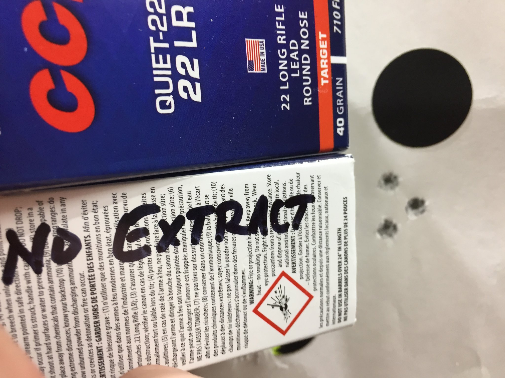

It has a very tight match chamber. I can't even extract live rounds of CCI SV. CCI SV is generally fatter than most match ammo. I switched to SK Standard Plus for the Ruger 10/22 Competition and it's shooting sub 1" at 100 yards. Mine is liking SK ammo a lot more than Eley ammo. Yeh SK Standard Plus is $5 a box versus $3 for CCI SV, but oh well, match rifle, match-ish ammo :)
That's good news, I have several variations of SK so will give it a go - thanks.
I'm seeing same thing, thanks for SK tip!

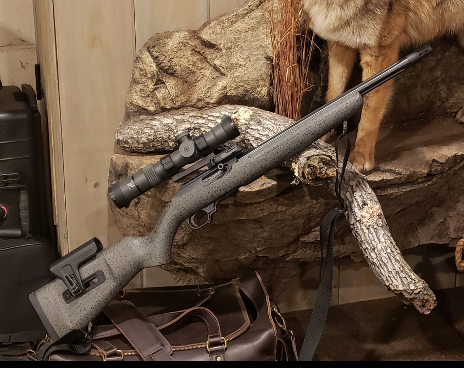

Hey guys, I'm new to sport but I'm all-in. After shooting PRS for 2 years, I wanted a 22LR match gun so I can shoot positionally more often at local ranges and private property. Yadayada...
I landed this gun for 700, could have done it for 650 on gunbroker but I decided to support a local shop.

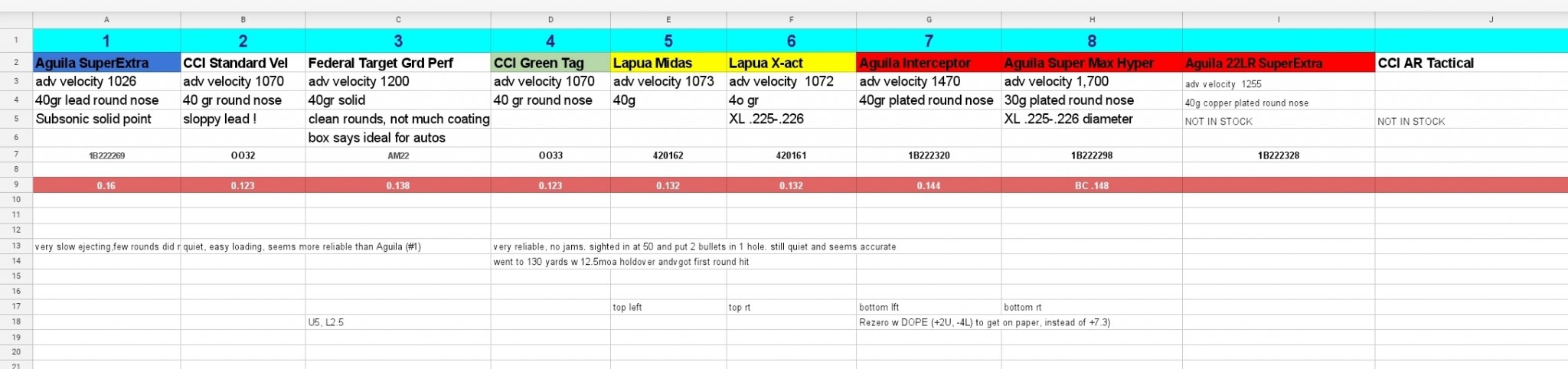

I have tested tons of ammo.
Aquila supermax ( wont cycle)
Cci standard (FTE often, FTL sometimes as well)
Federal target (97% good cycle, pretty accurate)
Cci green tag ( very accurate, but sometimes wont cycle)
Lapua exact ( this stuff was insanely accurate, almost perfect, wont always cycle)
Lapua midas (not as good as exact)
Aquila interceptor (sprayed like a shotgun)
Cci stingers ( ruger manual says not to shoot these so I never did try these)
Aquila supermax (sprays like a shotgun)
Federal champion (as good maybe better slightly better then fed target)
Prime semi auto (shoots well,also great cycling)
I believe this chamber is a match chamber and not everything feeds nicely. Also ruger manual says not to shoot CCI stingers because they are loaded w longer COAL and not good for this match barrel...again more evidence of tighter chamber toletances???
I did learn that any 40 gr round at 1200fps or better has pretty good performance and will cycle pretty well. Lighter than 40 and/or faster than 1500fps...results go in wrong direction.

You may be correct. Somewhere above someone else commented that this was a rifle for someone who wanted to buy not build. I replied that I preferred to build than to buy, but did not have the time to spend that way last fall when I bought this rifle. I am not a fanboi. There are many better rifles than this one. I'm just trying to document my experience for those who might be interested in buying one for themselves.
That said, I could not build this rifle for less than I paid for it. I got it for about $650 delivered to my local FFL. I could not start with an empty bench and build this gun for that. If I factor in the cost of my time, its not close. I'm not saying you couldn't do it; but I for sure could not.

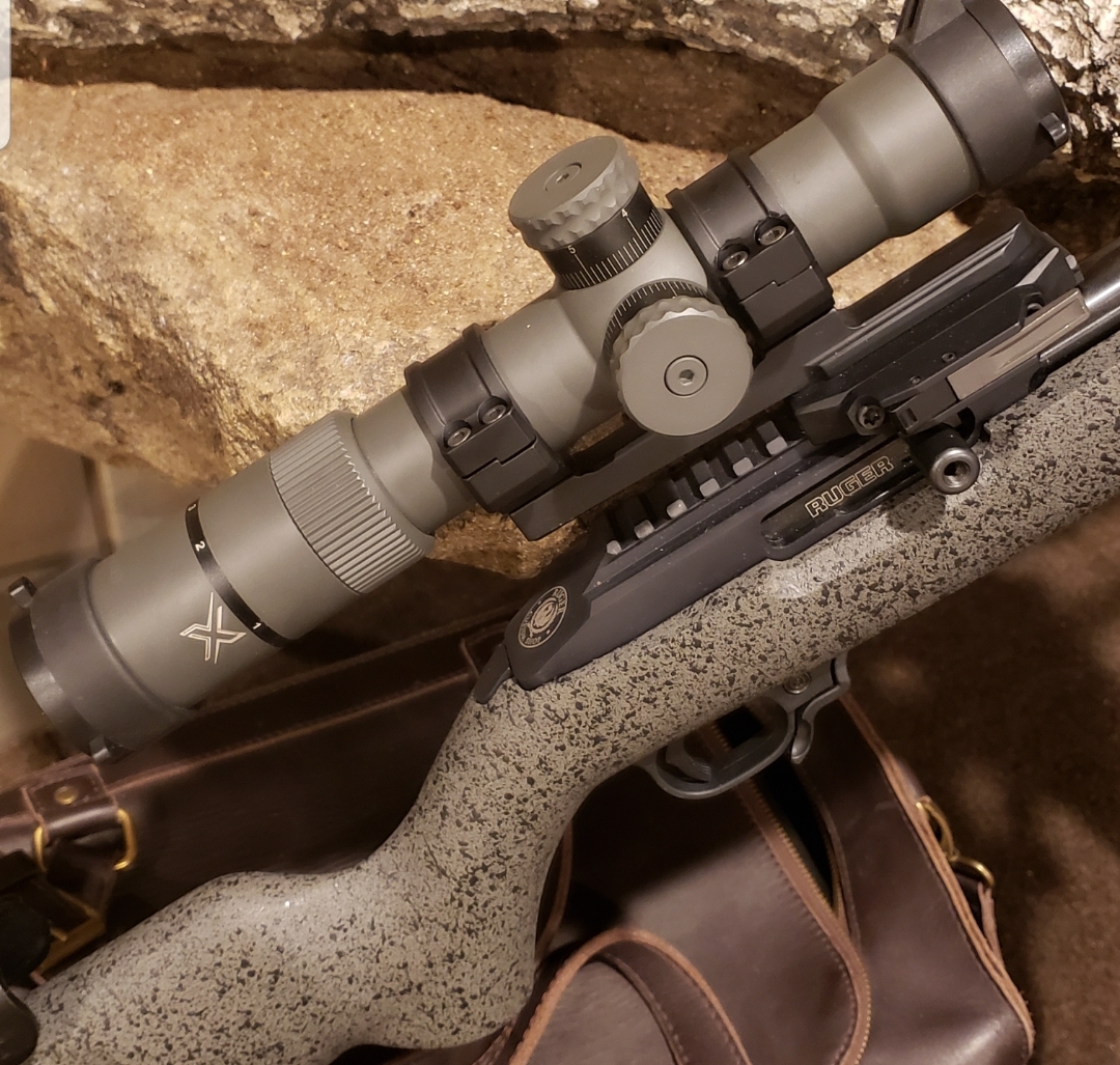

I considered stealing a VX2 4-12x40AO from my #1V, but decided to get the Rimfire scope w/BDC reticle instead. With it’s 60 yard parallax setting, I could definitely see improvement on target during day two work. I have a set of older Warne mounts on an M77mk2 target, and love their return to zero after being removed and replaced on the rifle. That is why I used a new set of them here. Below, RTZ labeled groups-return to zero after removal, allowed rifle to cool, and reinstalled scope and fired 10 round groups.

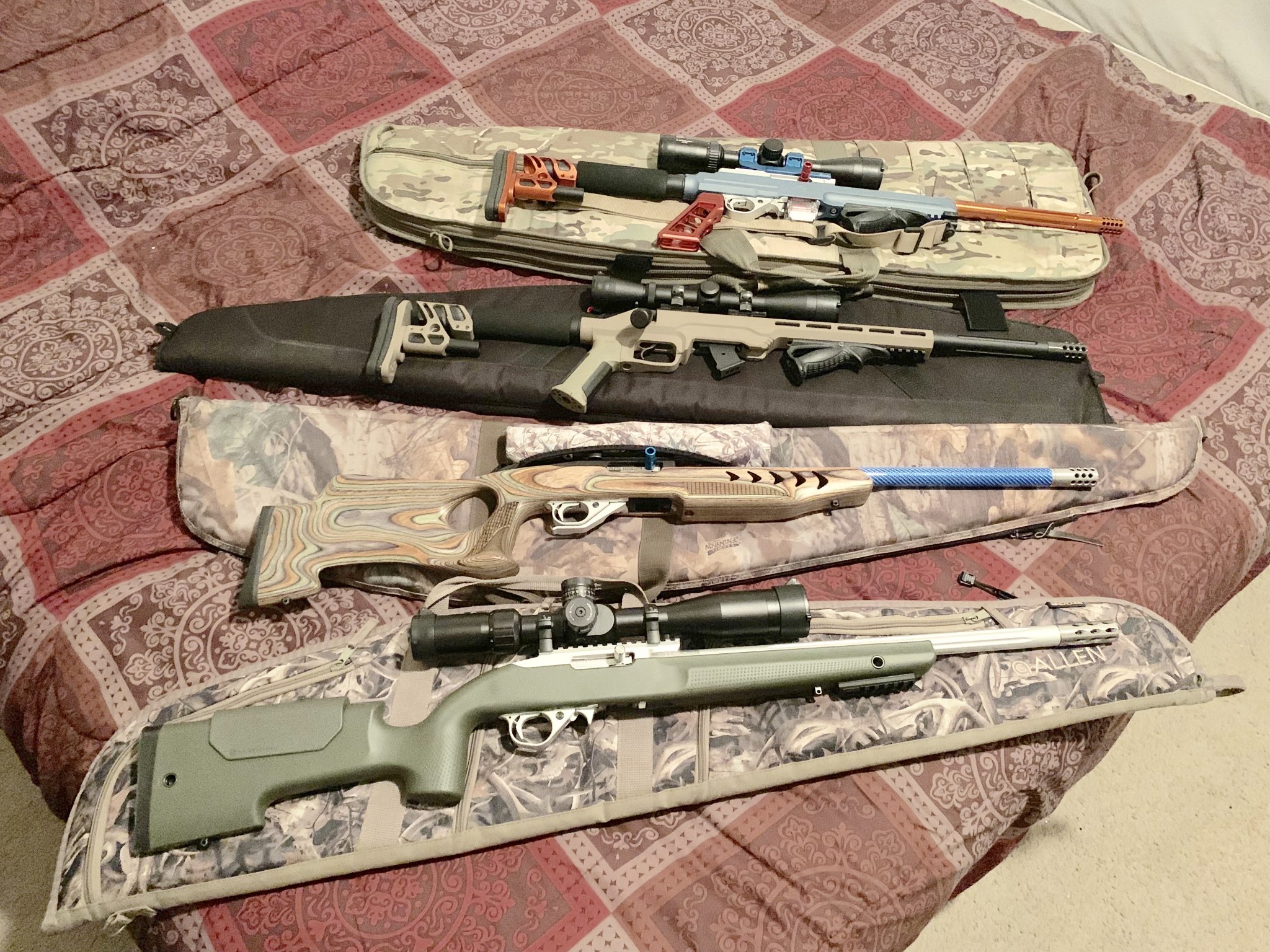

I have a boyds at-one for a standard 10/22, non thumbhole. I was less than impressed with the way the stock felt especially around the grip and forend replacement pieces, sharp edges and doesnt line up very well.

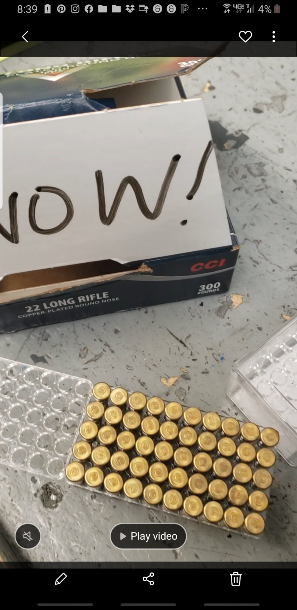

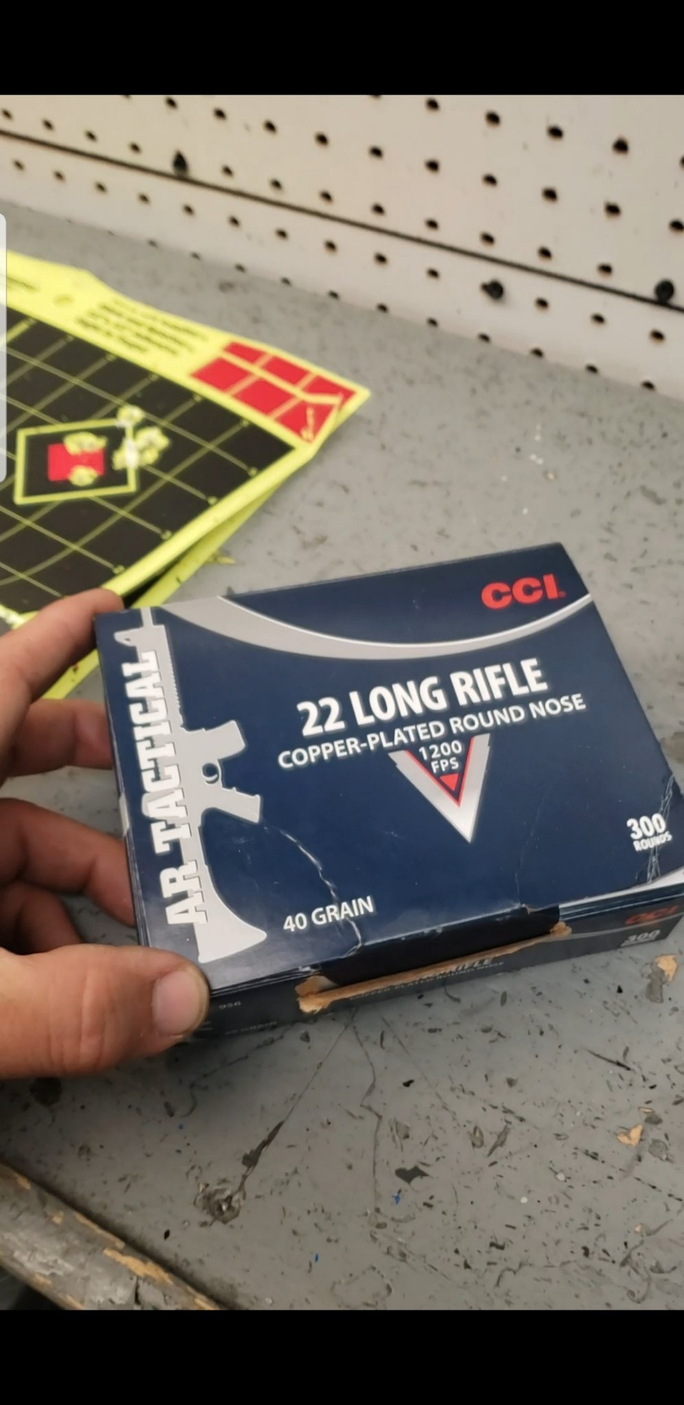

So far, cci green tag is great and anything rated 1200 fps seems very reliable as far as feeding,cycling. The cci green tag is, so far, the only really reliable ammo just below speed of sound. CCI quiet is also cycling great, but I did have couple fail to fire. Those are 45 grain and they seem very promising... I'm not done with that round. Will try shooting that one for groups soon.
CCI tactical was very reliable, and like I said earlier, anything 1200 cycles great. These rounds might make the cut once I test them for group size.

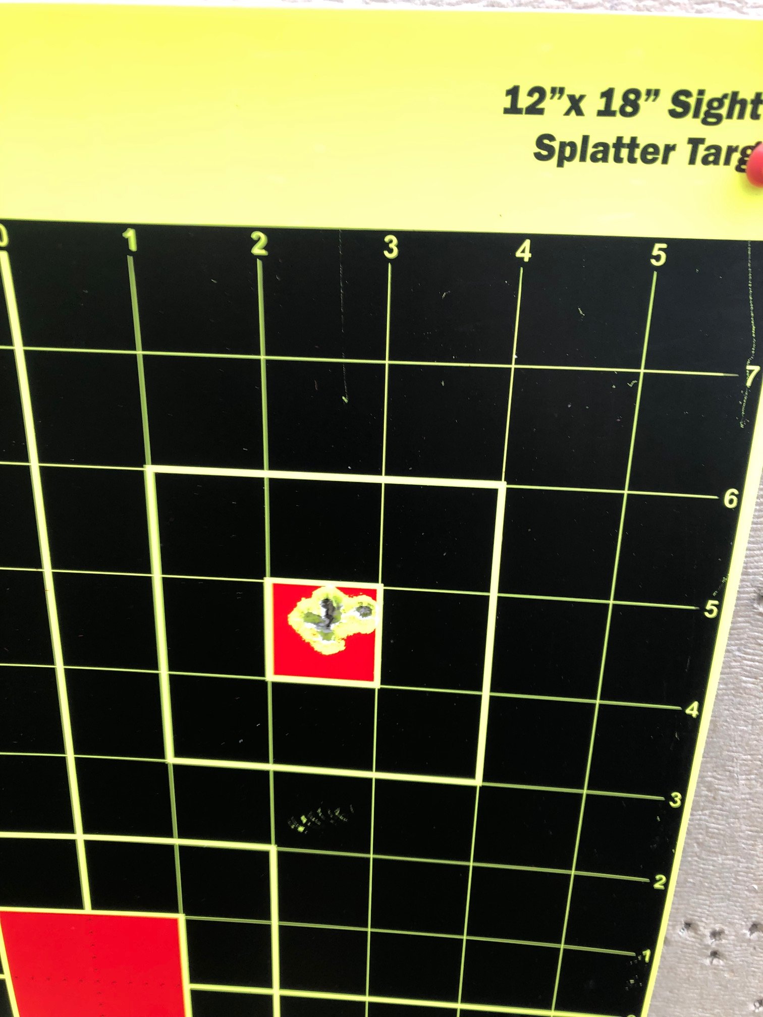

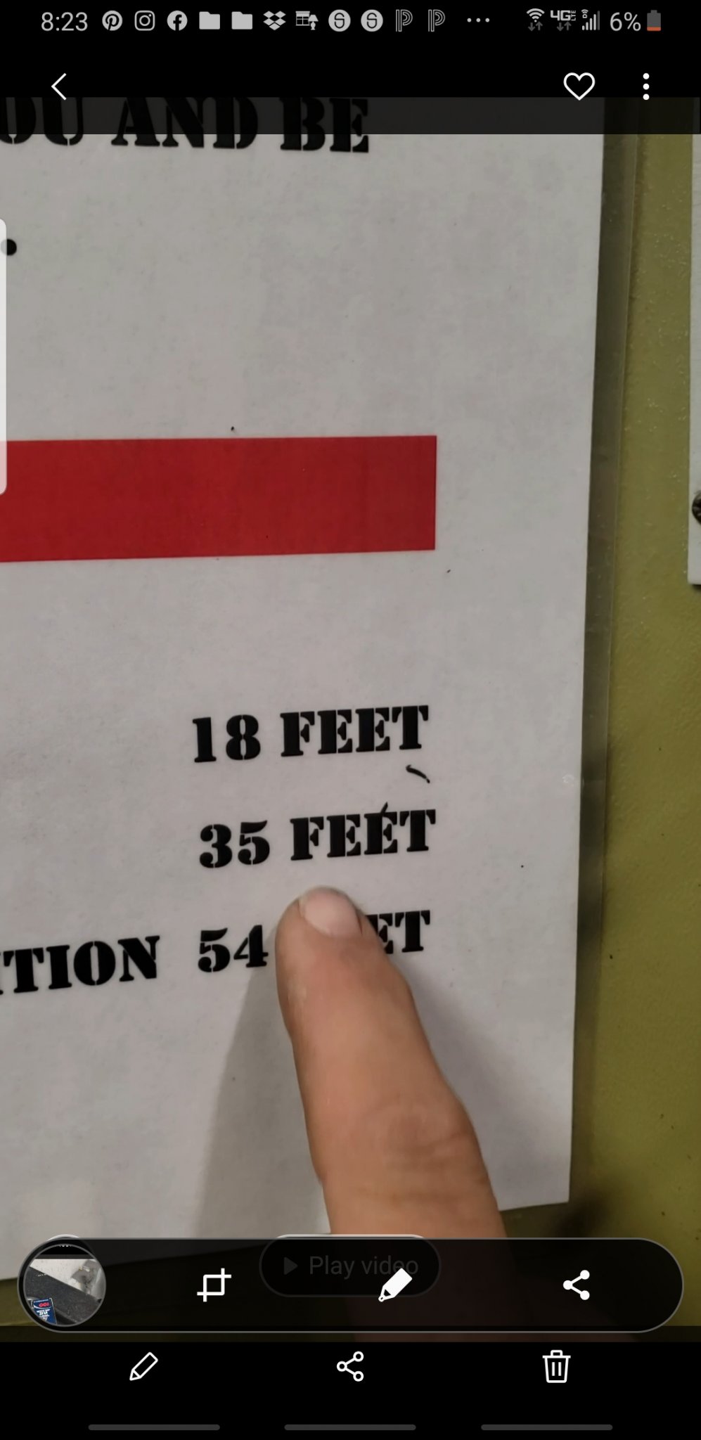

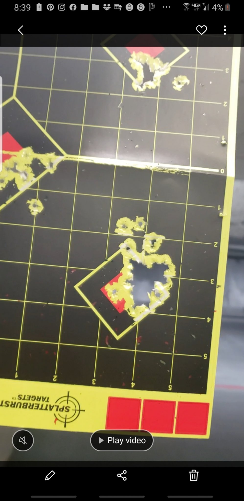

See attached groups, from 53 feet, free standing w no support. Greentag performed with no feeding or firing issues.
Screenshot_20191204-202302_Gallery.jpgScreenshot_20191204-202305_Gallery.jpgScreenshot_20191204-202321_Gallery.jpg

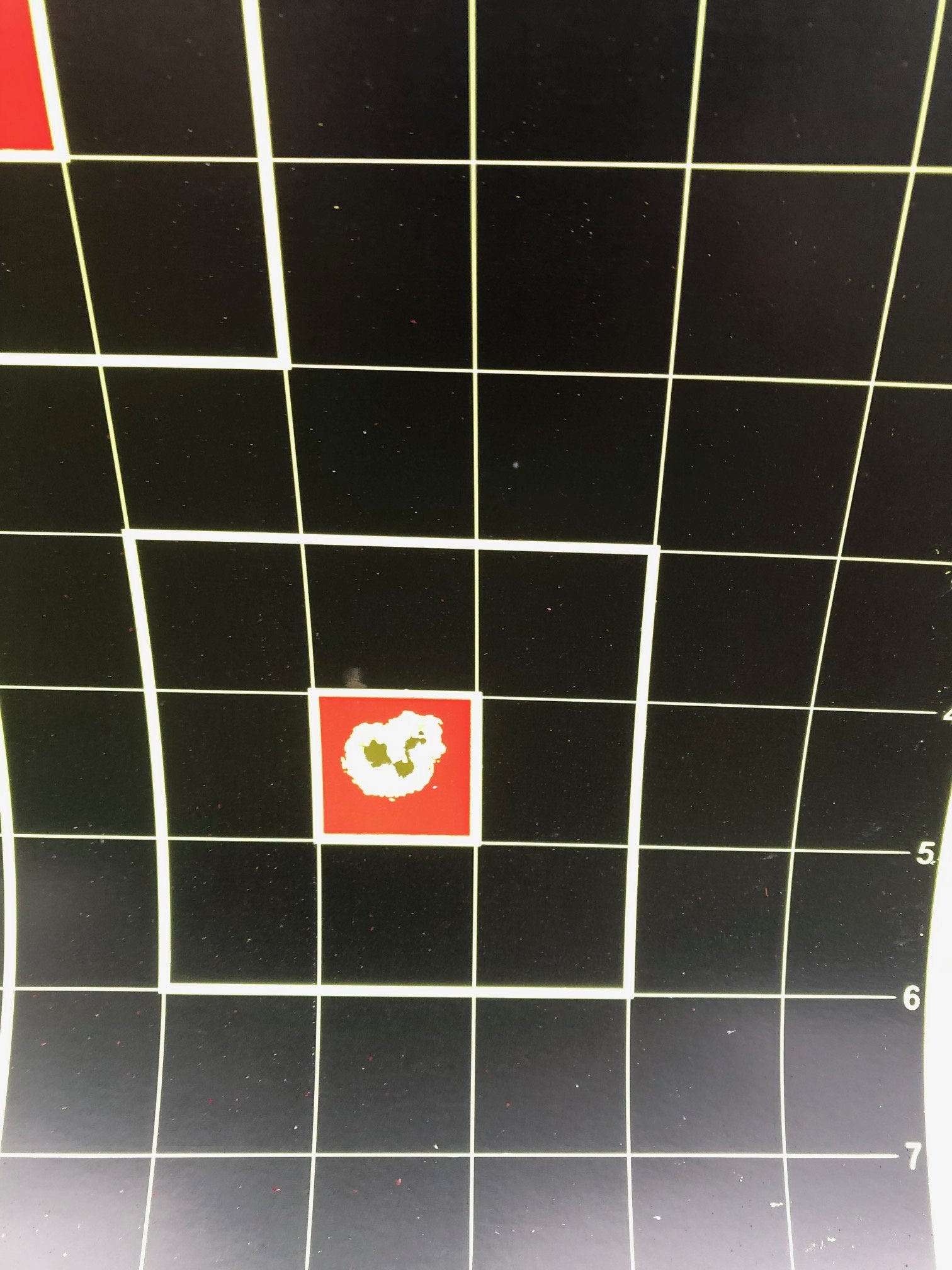

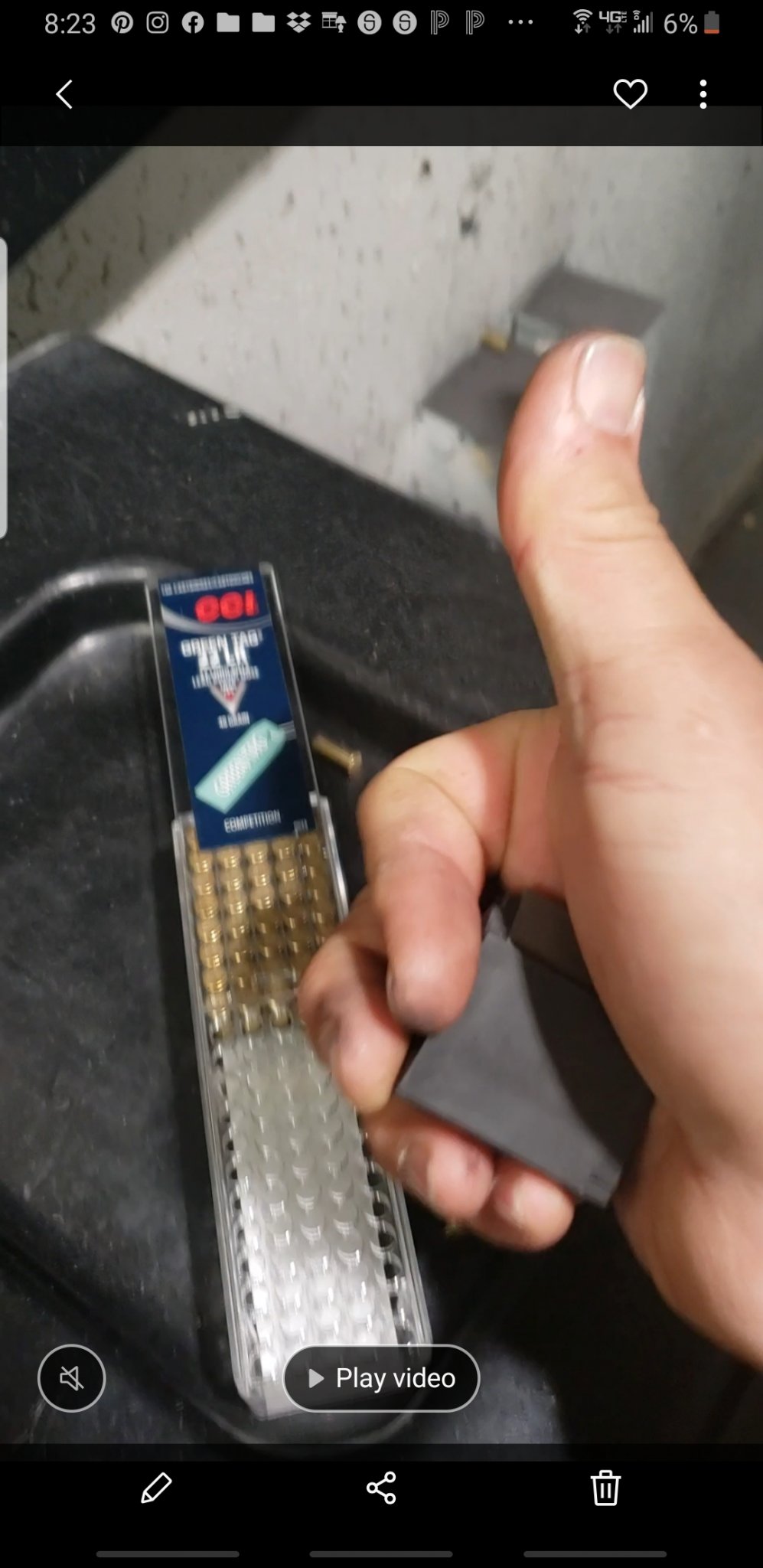

Next, heres 40 shots of CCI tactical w no cycling issues. Same distance, free standing. 4 mags

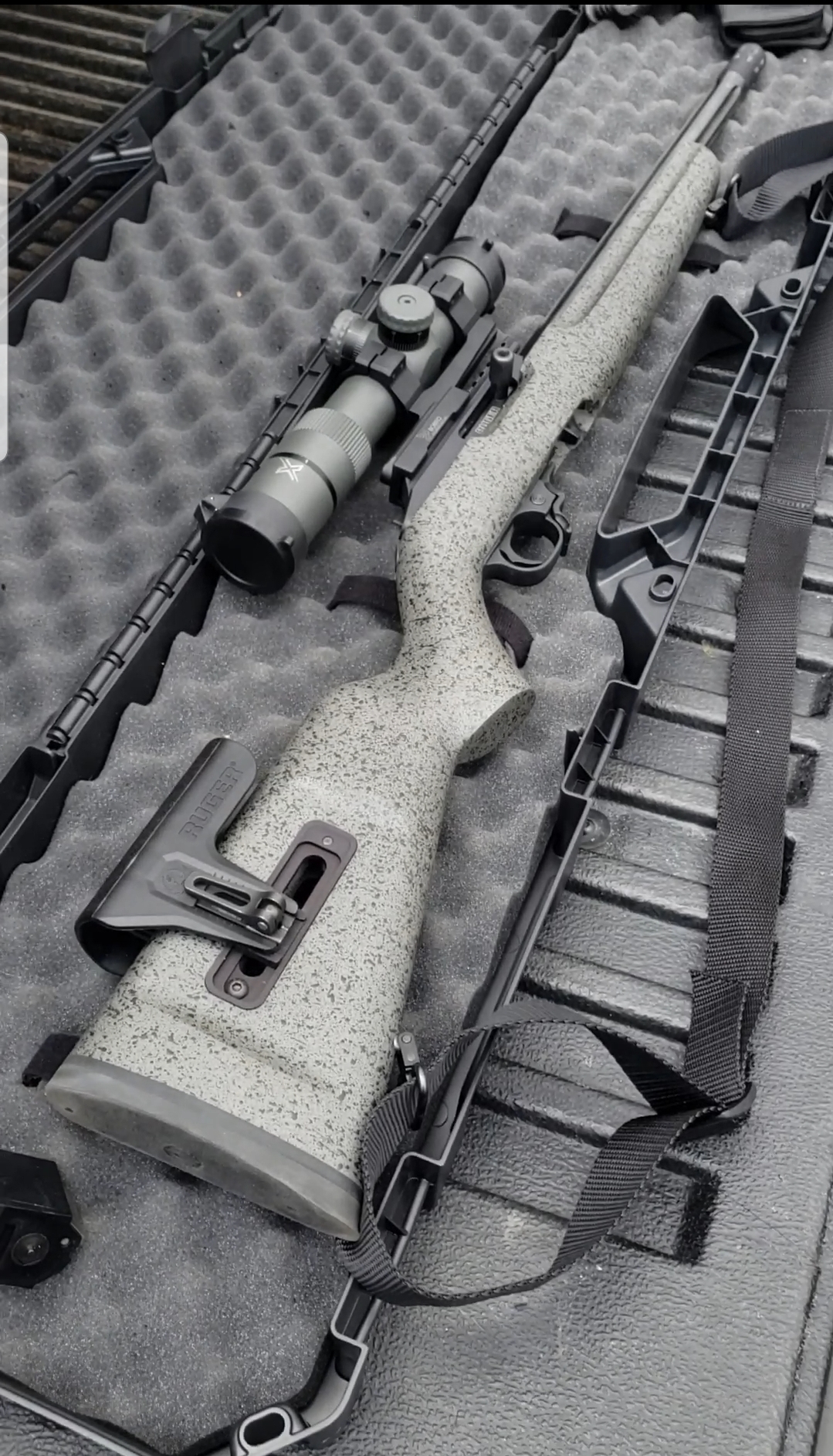

Ruger is offering a 10/22 Competition Rifle from their custom shop.
https://www.ruger.com/micros/customShop/1022.html
  • Model Number31120
  • Caliber22 LR
  • StockSpeckled Black / Gray Laminate
  • SightsNone - Optics-Ready, 30 MOA Picatinny Rail
