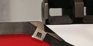

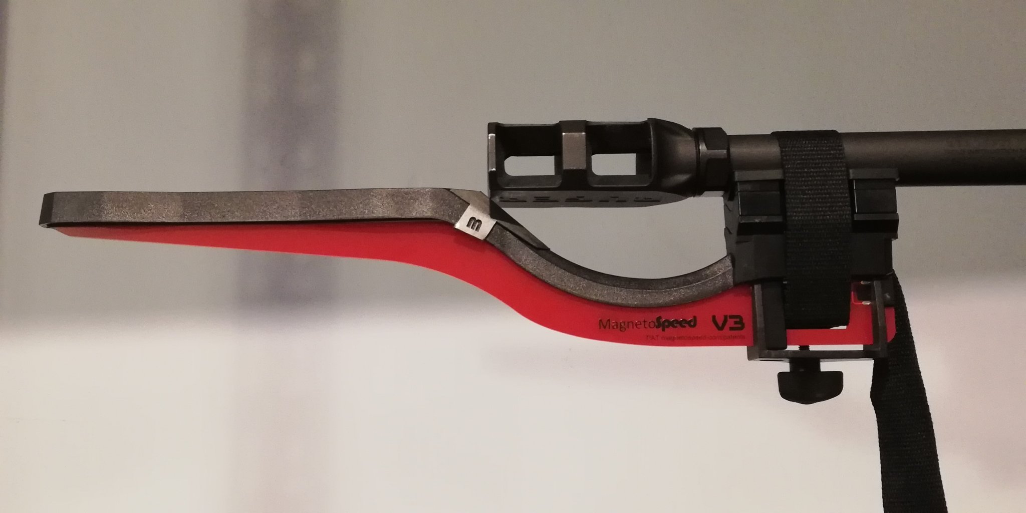

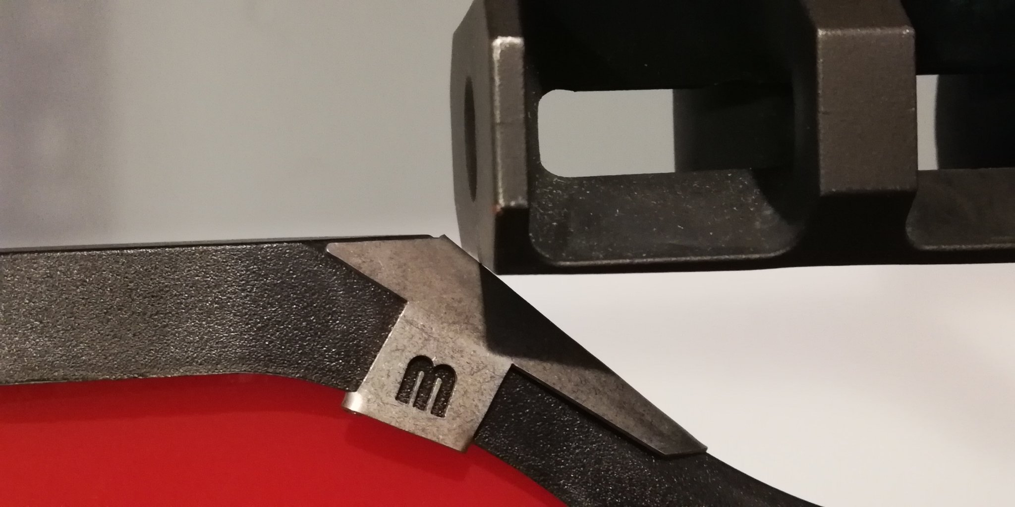

I have tried the V3 with the 338 lapua muzzle brake.
Then I preferred using to extend the hand-guard with a metal plate rail, where on the end to fix the v3 keeping it more distant from the muzzle blast and vibration.

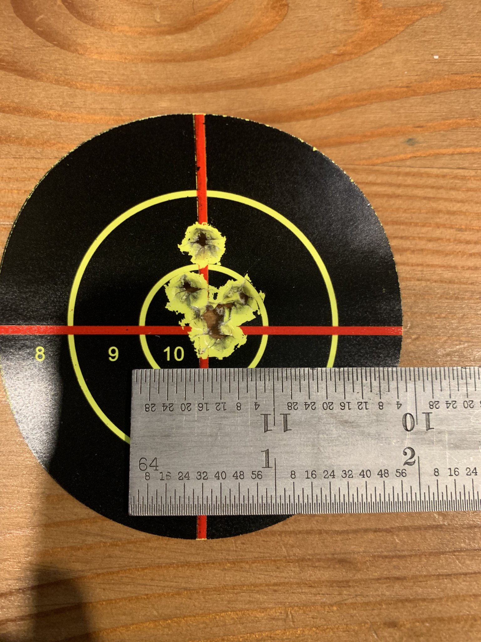

One of the things I found that really works well with a factory barrel is by conditioning the barrel with Tubb's Final Finish bullets. They fire lap the bore and smooth things out nicely so that the barrel doesn't foul up with copper so bad and makes cleaning the bore much easier. I've done this on both my RPR's factory barrels. For the most part I feel the fire lapping helped some too with accuracy, though I can't say it did a lot with regards to accuracy. But it sure helped with cleaing.
The groups are getting better. I started with like 3" groups and yesterday I was down to like 1 1/4 I think but the total round count is still like 90

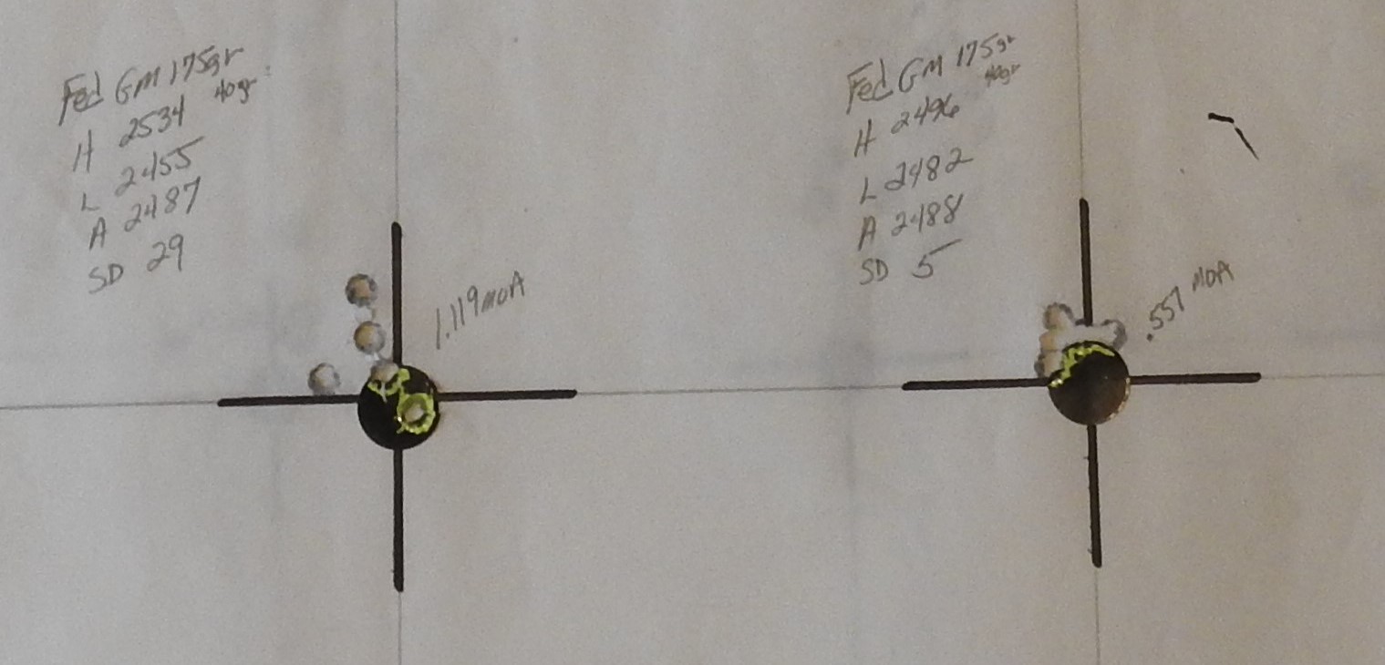

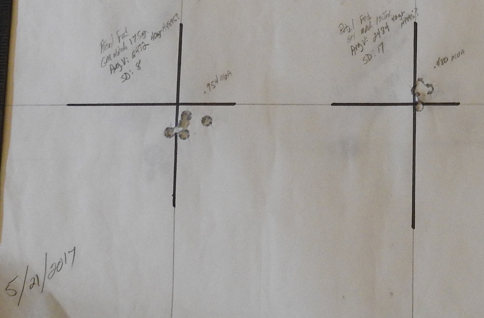

Here are some results from my original factory .308 RPR barrel firing Federal 175 SMK's back in 2017:

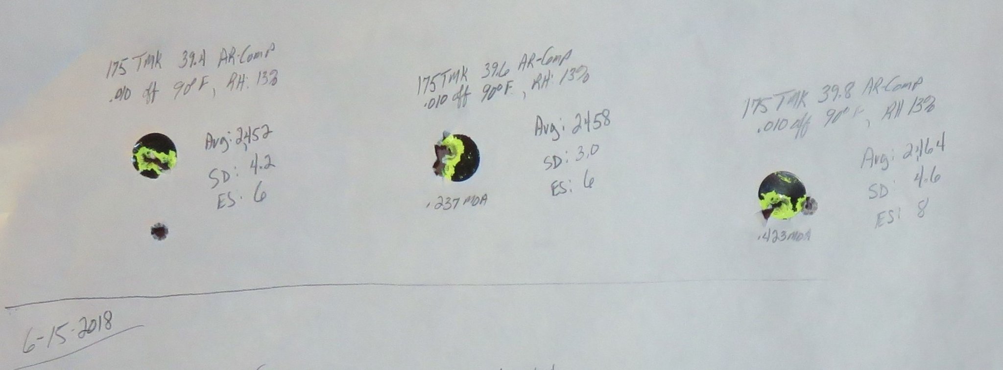

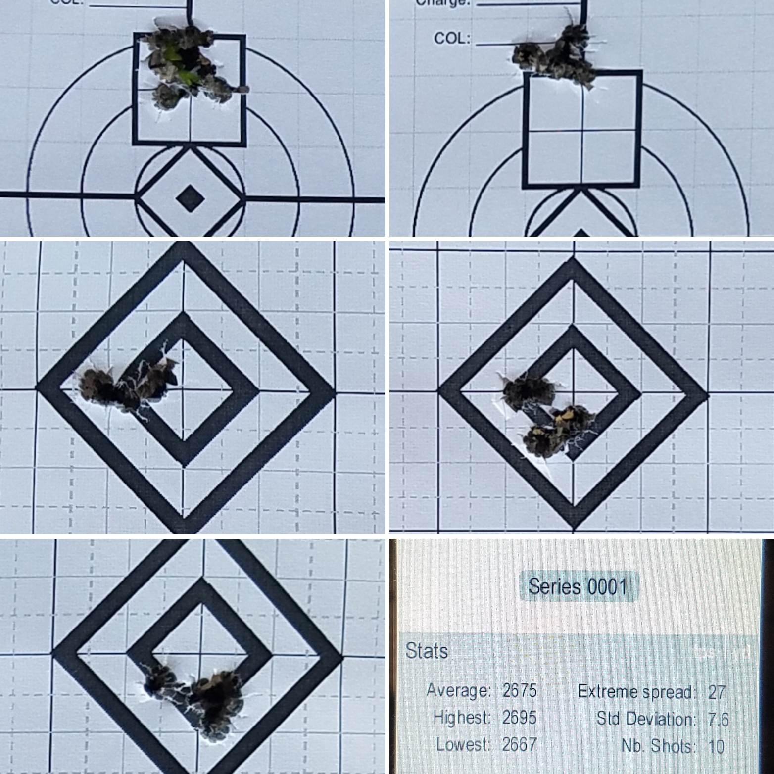

And here is some results from the that same barrel but with some precision reloaded cartridges:

Wait. The top pics of factory stuff, did it improve to those numbers?
No. The factory stuff did not improve from what I showed. Some lots of the factory ammo did better than others, much like barrel do. When I replaced my factory barrel with a Krieger barrel, there was a substantial improvement using factory ammo. But, I don't use factory ammo any longer and since I used up what little I had on the new barrel.

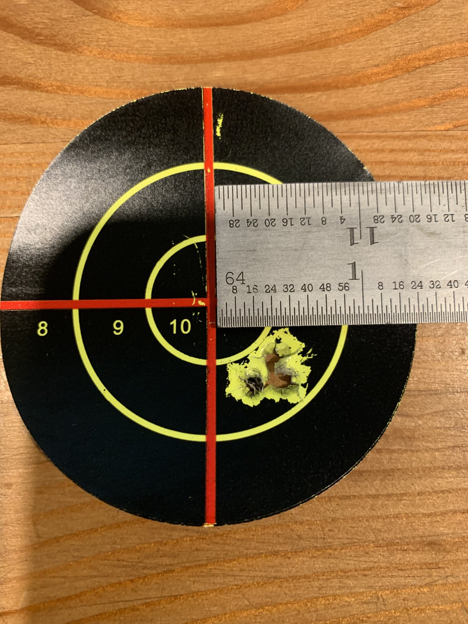

I have a Gen3 6.5. I run Berger 130 AR Hybrids at 2.800". After about 500 rounds through the barrel, my jump to the lands is .060". I run 2.800" because its the default short action mag length and I only have .170" of bullet bearing surface into my necks. With 140s, it would be easier to seat out longer and still have enough bearing surface into the neck. Since Hornady 140gr factory loads were the rage around the original inception of the RPR, Ruger definitely made sure their chamber could accept 140gr and heavier bullets.
I started load development from a brand new rifle. I chased my ass trying to make sense of the speeds vs charge weights for the first 100-200 rounds as I found the barrel kept speeding up. After 200 rounds, my speeds leveled out pretty good to where load development started making sense. If I had to do it all over again, I would have bought some factory ammo loaded in a top shelf brass and just have fun for the first 200 rounds while the barrel settled in. The 1x fired brass would then have become my load development brass and successive reloadings.
With all that being said, my 130gr load pushed by RL-16 runs at a mild 2850fps. It is 1/4 MOA at 100 yards. I have routinely had 3" five shot groups at 800 yards with this load. During load development, I explored up to around 2950 fps with groups opening up accompanied by a little stiffer bolt lift. I figured I would just hang out at the wide accuracy node I found between 2820-2880fps and enjoy the long brass life. These hybrids definitely don't mind jumping. They feed like butter from my ARC 10rnd mags.
I really favor the 130s for the flatter trajectory and lighter recoil. The Berger 130s don't give up much at all to the 140s against wind inside of 1000 yards.

In my case, I needed brass, so I bought a case of Prime 130 gr 6.5CM and shot that to break in the barrel and get to know the gun.
Once I started my load workup, I use a bullet comparator to measure CBTO, going for 2.198” which translated into a 2.820” COAL with the H140ELDMs. The big limiting factor on length was what COAL fit in the mags. I ended up using the Magpul AICS mags that allow a little longer COAL than the basic Magpuls that come with from the factory.
Found my node at 41.8 gr H4350 with the H140ELDMs (or at least that’s when I quit messing around with it).

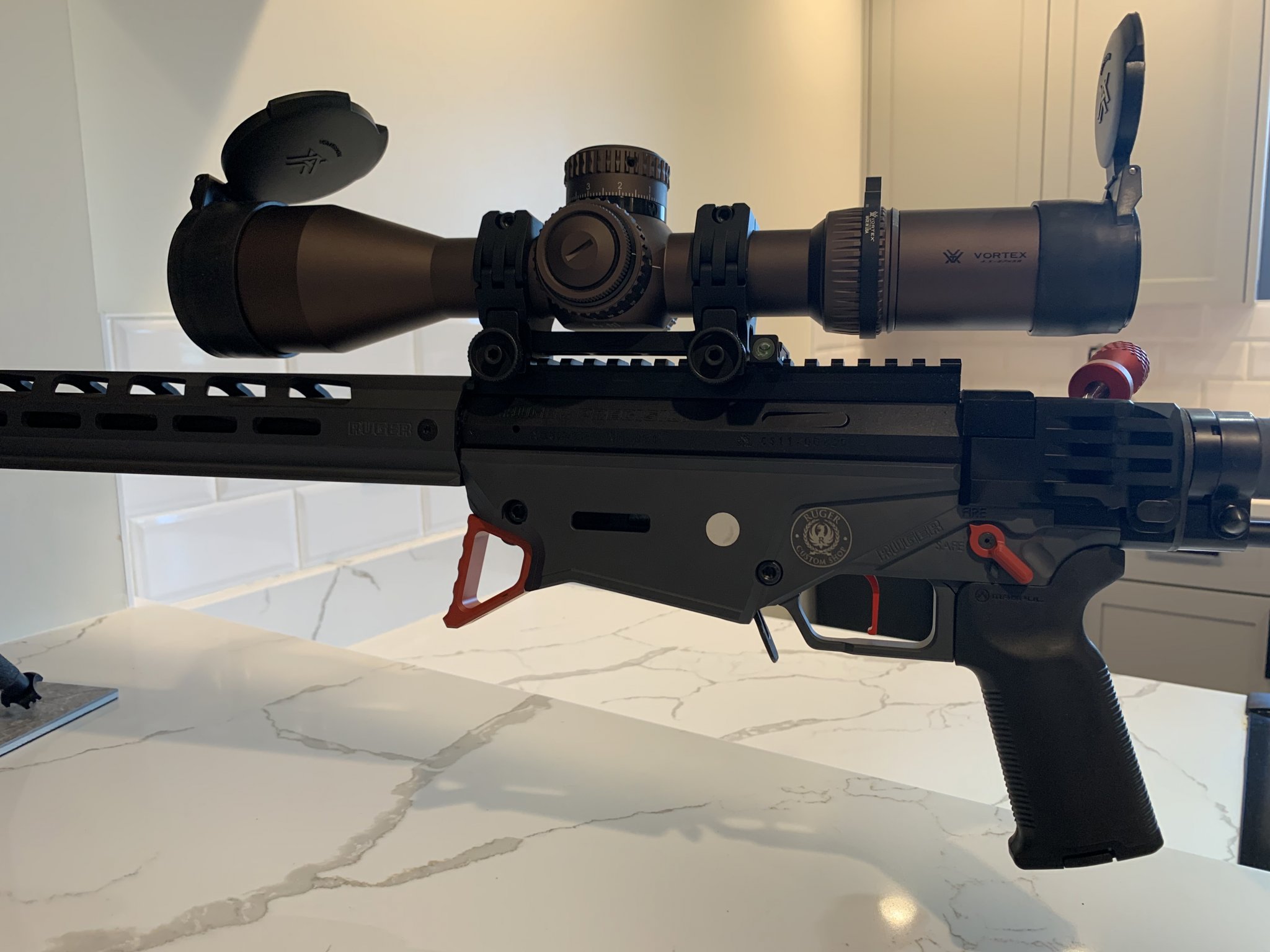

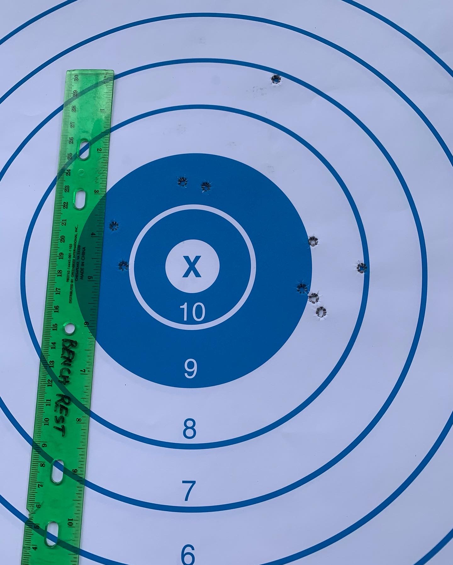

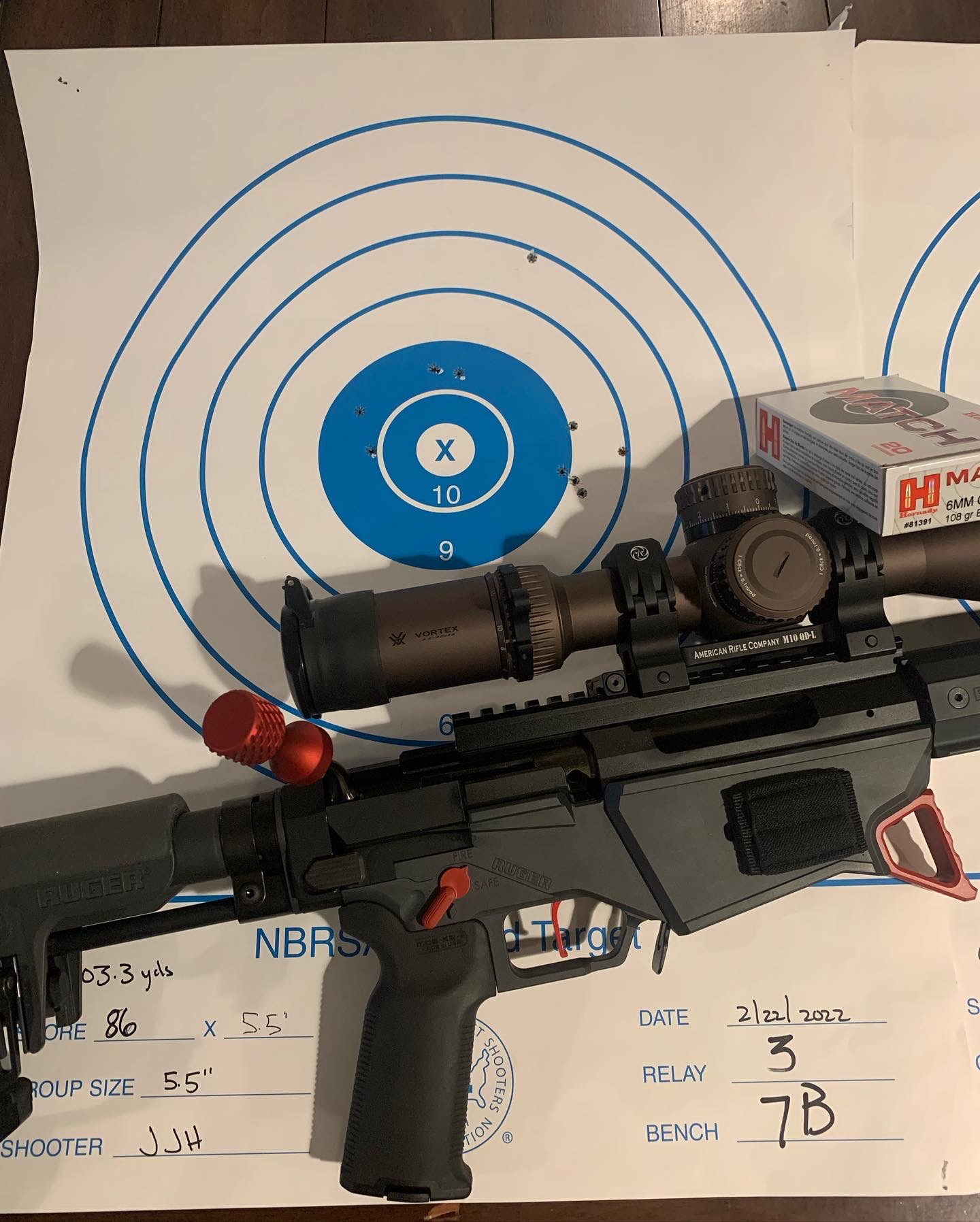

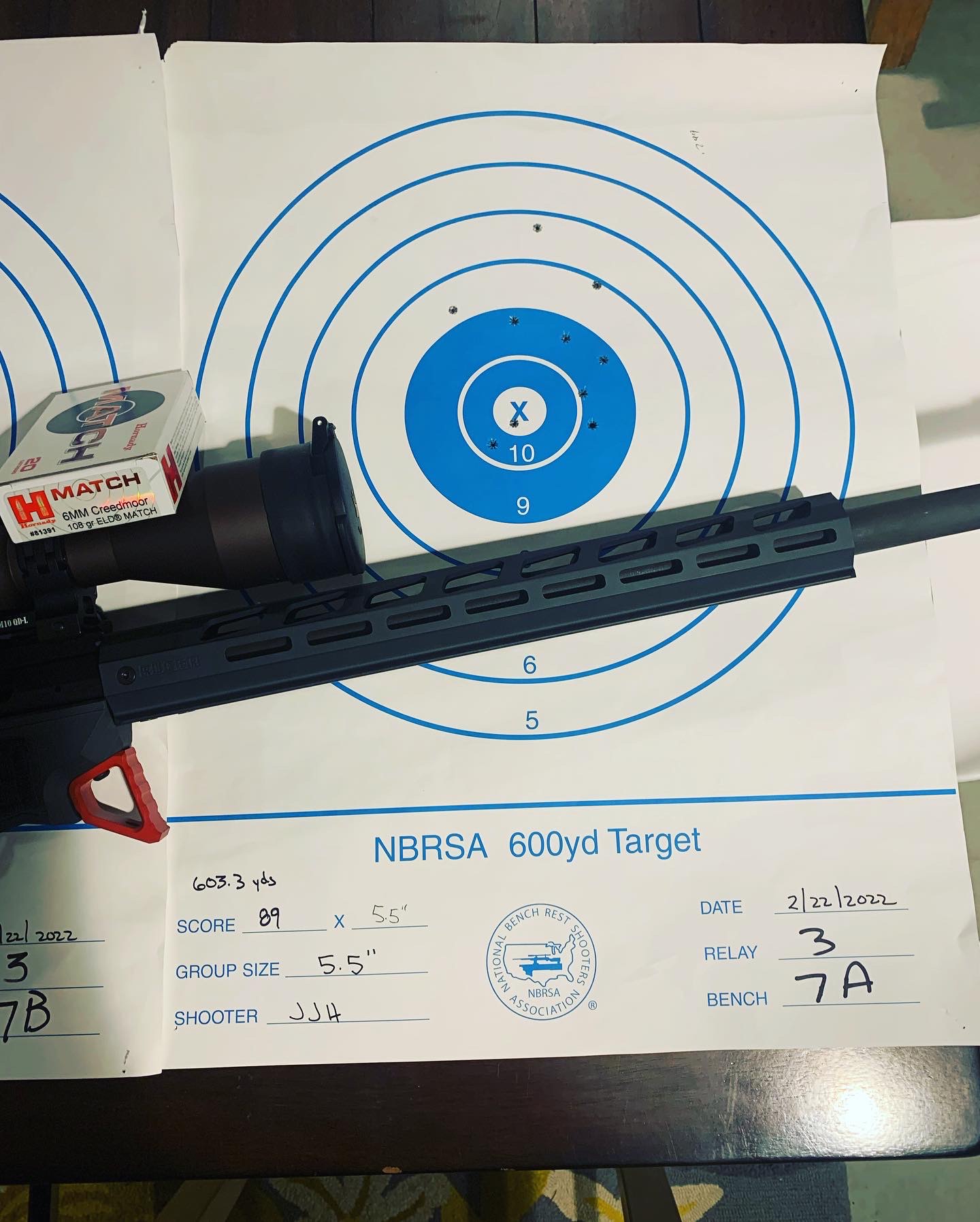

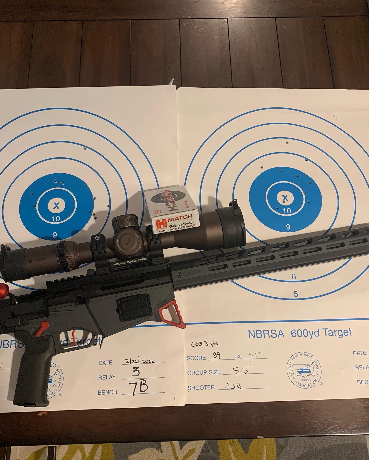

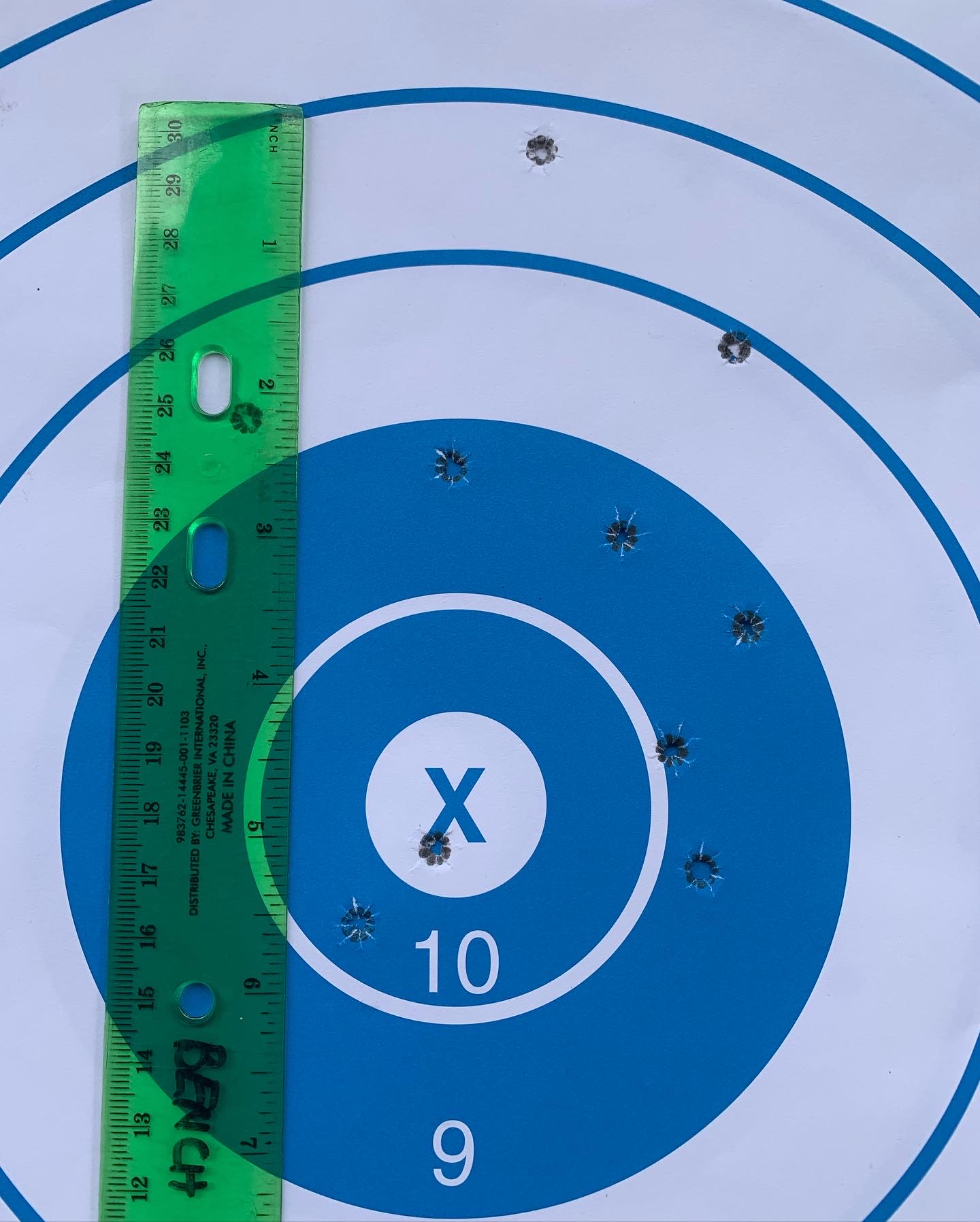

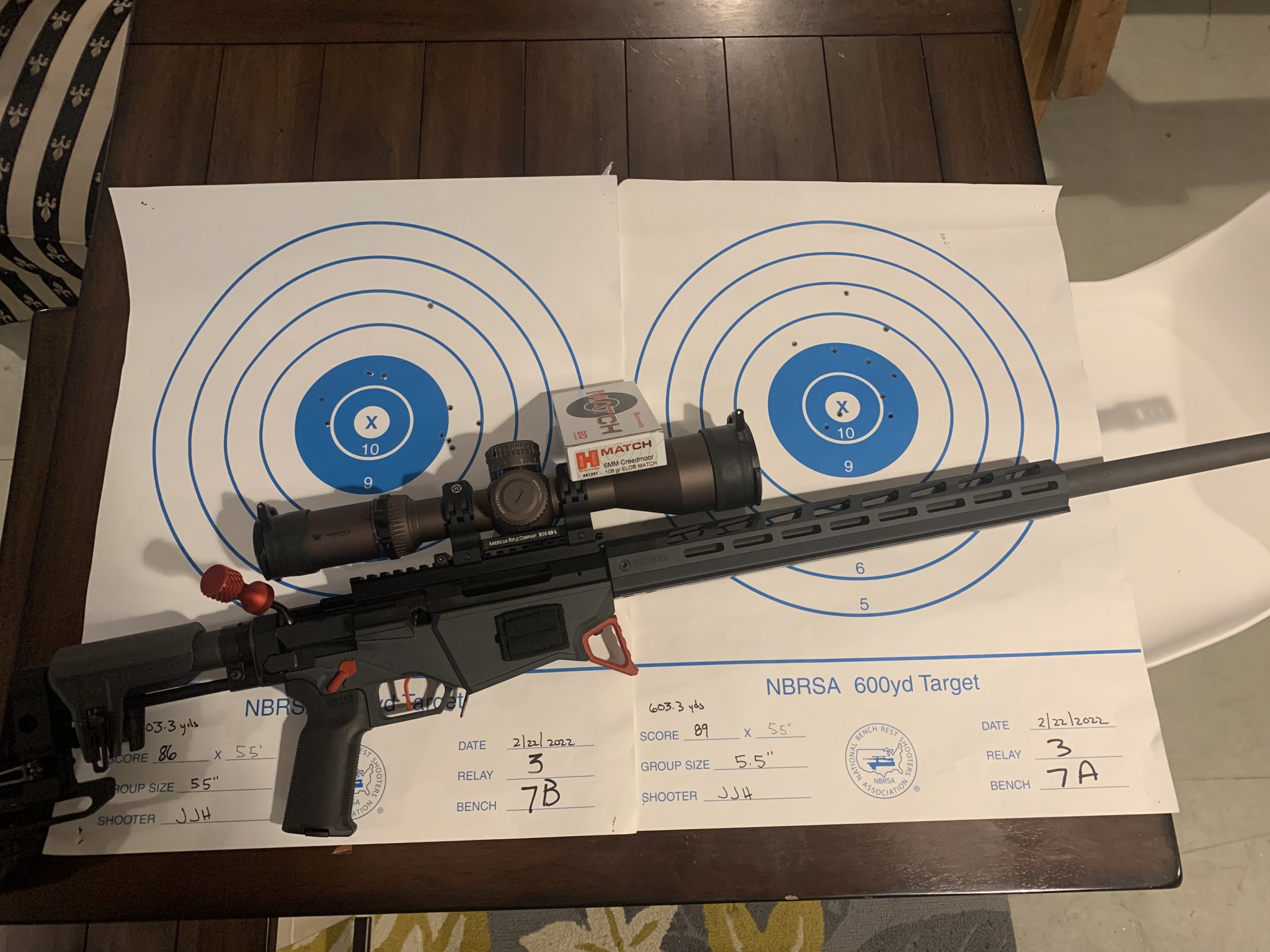

I’ve made a few updates to my Customshop. I updated the optics to Vortex Razor Gen 2 4.5-27, ARC M-10 QD-L 0 MOA base, pic-mount scope level, MDT Ckye pod, match saver, and Atlas mono-pod. I also added a dot of reflective vinyl to the left hand side to keep it from getting scratched when the stock is folded.
Going to participate in a 600-yard bench rest match on Sunday.
View attachment 7808597View attachment 7808595View attachment 7808593I’ve made a few updates to my Customshop. I updated the optics to Vortex Razor Gen 2 4.5-27, ARC M-10 QD-L 0 MOA base, pic-mount scope level, MDT Ckye pod, match saver, and Atlas mono-pod. I also added a dot of reflective vinyl to the left hand side to keep it from getting scratched when the stock is folded.
What do you think of the TriggerTech trigger?
I like the trigger thus far. I dialed it down about as low as I could go. Interestingly, the “first stage” has no break/set, rather it’s just an adjustable take-up pressure. From there, the 2nd stage break is clean and repeatable. The flat shoe is nice and provides plenty of contact and control.
I have been waiting for TriggerTech to release their RPR trigger. I am dying to try it out.
Why did you swap the 20 MOA rail out for a 0 MOA rail?
Very nice!
But, since you're going to participate in a bench rest match, you should seriously consider ditching the Atlas mono-pod for the match. A good rear shooting rest will serve you much better . . . maybe something like this:
I did not swap out the 20 MOA rail. I changed my optic mount from a ARC M10 QD-L 20 MOA 1.57" height to an ARC M10 QD-L 0 MOA 1.38" height; the rail is still 20 MOA.
The scope I purchased (here) included the ARC M10 QD-L 20 MOA 40mm/1.57"mount. I was then able to purchase an ARC M10 QD-L 0 MOA 35mm/1.38" mount.

Agreed. I have a rear squeeze bag, as well as an Anarchy Gear Schmedium shooting bag that I'll be using.

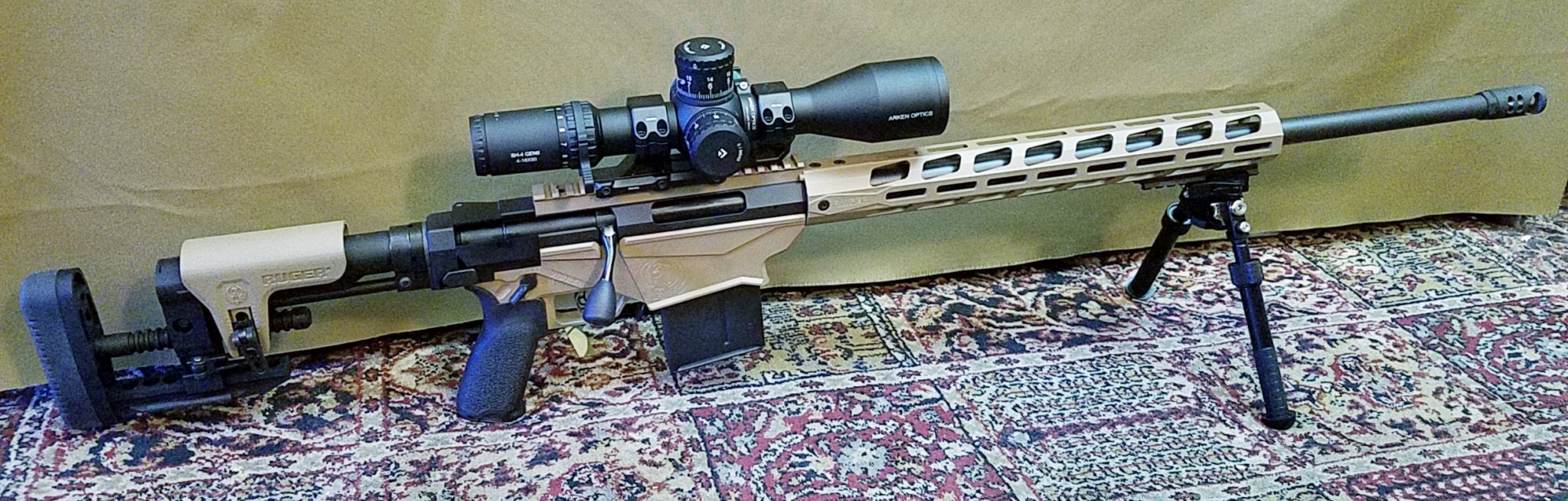

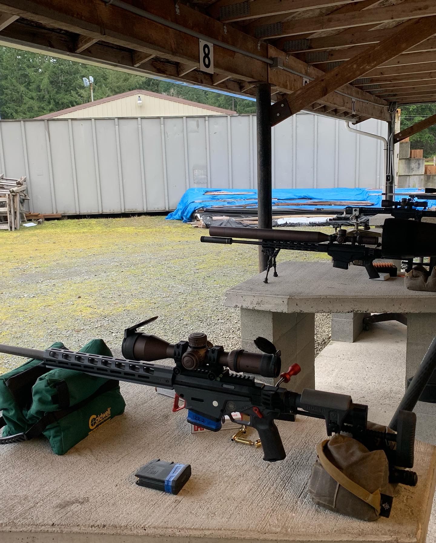

Picked up my RPR 6.5CM today and got the scope mounted up.
Trying out the Arken SH4 4-16x gen 2 and accompanying mount.
Took a bit to set lop and cheek rest.

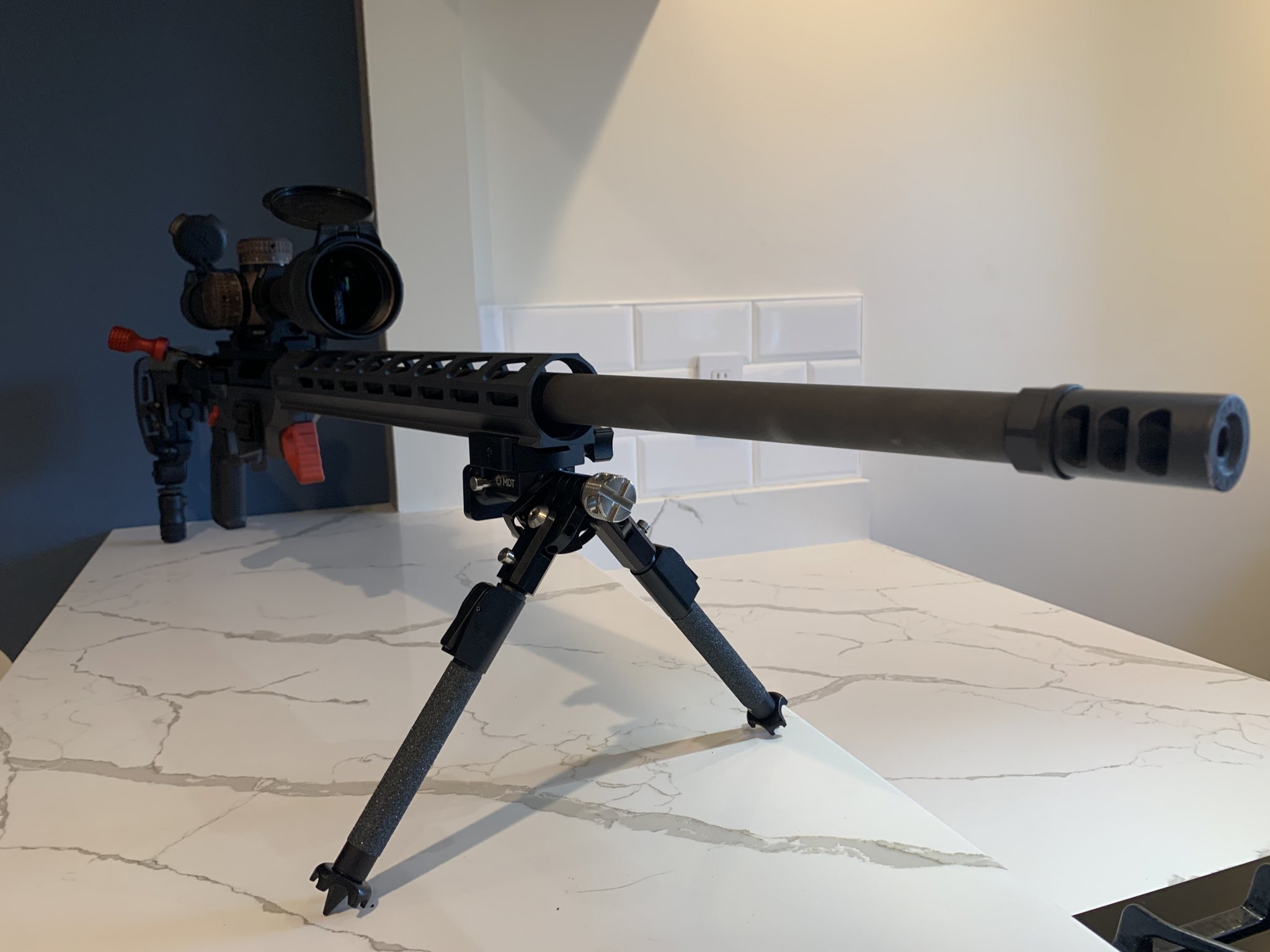

Took even longer to set the scope up and level the reticle.
I was aiming for a balance between bench and prone positions while doing so.
Got a handful of rounds loaded up to get it zeroed on Sunday and fireform some of my lapua brass.
Loaded up a few hornady cases so I can fireforn and use those for checking length to lands. Will probably make a modified case as well.
The trigger is way lighter than I expected it to be. I don't have a pull gauge, but it feels way under 2lbs.
Did the Davidsons edition come with a different trigger?
Congrats on the purchase. It doesn't appear that the Davidson version was different from the others, outside of the FDE treatment. Hopefully you have the same experience of accuracy as most of us have enjoyed. I can tell you my CS 6mm shoots ridiculously well, when I do my part. Here are a few from Wednesday’s sighting-in (new scope and mount). One is a 5-shot group with one flyer, the other is a 4-shot group. Both at 97.1 yards (according to my Sig Sauer OpMod 1400 rangefinder).

Got out to play with the rpr today.
Very happy with the results.
Still need to work on the load for it, but choose this to start.
41.5gr h4350
140gr eldm
Lapua brass
Cci 450 primers.
It seems to like more bullet jump than O thought it would have.
These are all between 2.815 and 2.830" oal.
I need to get a better scale too. My old gem pro 20 lacks a little.
10 round group on top left. All the others are 5 rounds
Reactions: DubfromGA
I shot my first 600 yard bench-rest match today. I’m happy to report that I managed to get the highest score, and “closest to bullseye”. At 603 yards, my RPR maintained a 5.481” grouping on two targets. I was using factory Hornady “match” 108 ELD. These guns can shoot, when we do our part.
