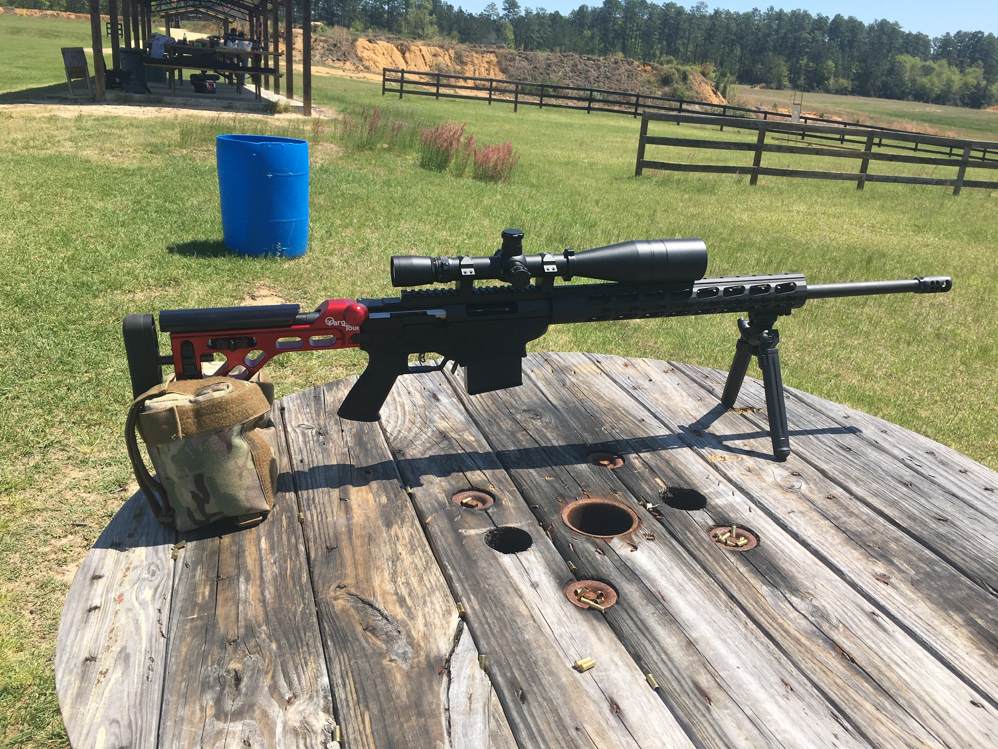

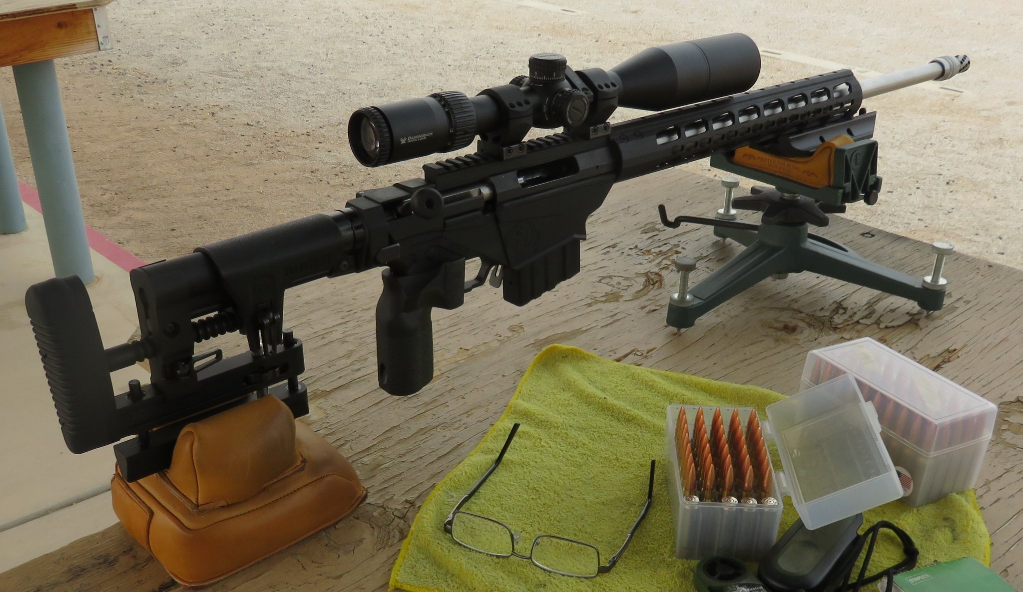

Here's a pick of my .308 with Krieger barrel:
It's a .308. I recently got a 6.5PRC RPR that I just rebarreled and in the process of getting it broken in. Certainly, I don't expect barrel life of this PRC to be anywhere near that of my .308. We'll see how the rest of the gun hold up.
Yes, that's 11,000 firing on my .308 . . .but as I said, I'm on my 3rd barrel.
Being that I do almost all my shooting here in AZ, I keep a close eye on my barrel heat and seldom let it get over 122°F, which makes it really slow firing during the hot summer days (early mornings, actually, when it's not too bad). 2500 is not a bad number for a 6.5CM and I think if one can get to 3,000 their pretty lucky, especially if its a factory barrel.
I think you'll really like a Krieger barrel. They're really a well made barrel . . . top quality!

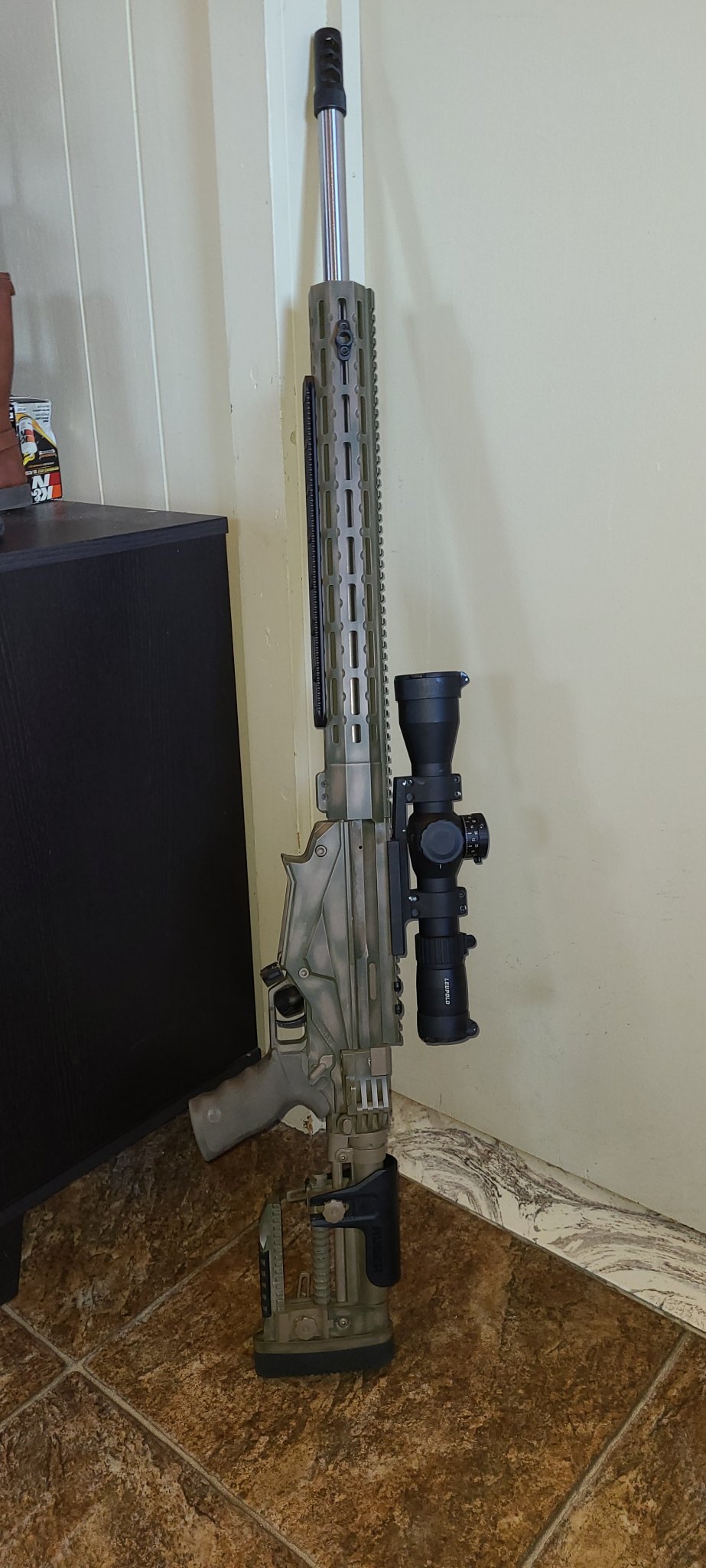

Found this deal today
300 Win Mag Ruger Precision Rifle. Vortex Strike Eagle zero stop and its Illuminated 5x25 FFP seems Nice. Not like my Leupold Mark 5 but nice. Vortex Bubble level also. With
Warne Scope Mount Skyline 1 PC Precision​
The Atlas Bipod PRS adjusts all over the place took some figuring out with the forward backward legs etc... Also New Soft case that fits it.
Scoped barrel looks clean and nice left 1 mag full of 215 bergers
Pulled the bolt Like New so I assume the 20 round cnt is close also found out he is the Firearms Manager at Sportsman Warehouse might come in handy to locate some powder and primers. Said he would get what comes in.
For 1,550.00So I am pretty happy
What do they say Blind Hog finds a acorn every now and then. LOL

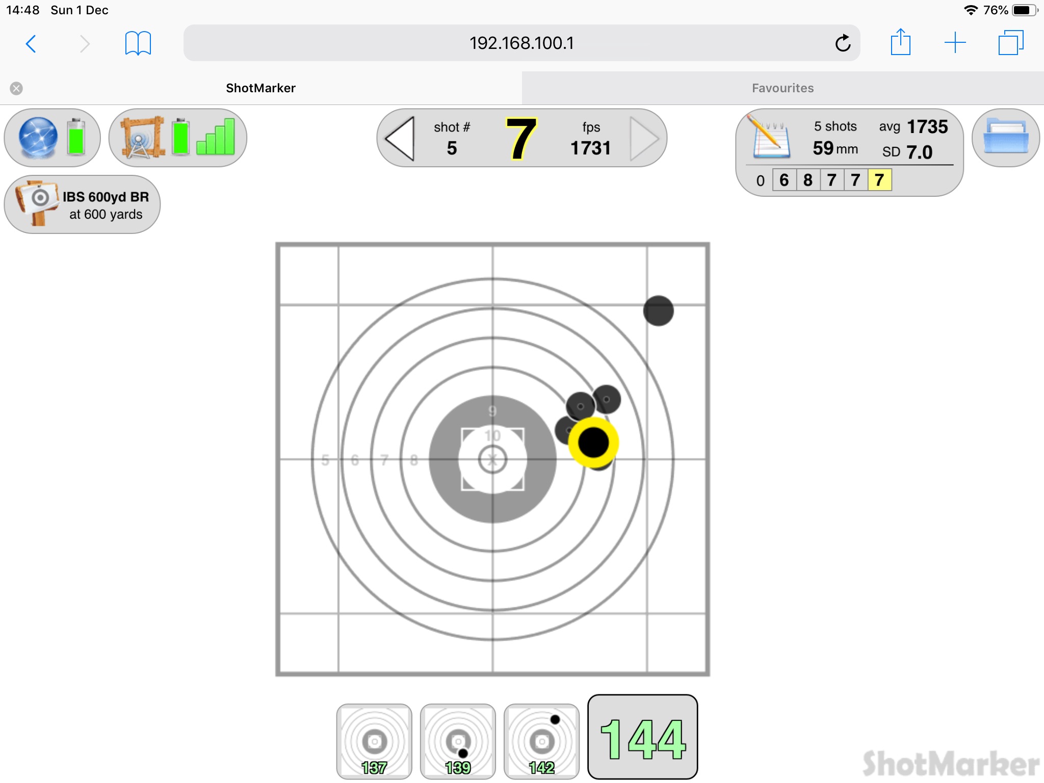

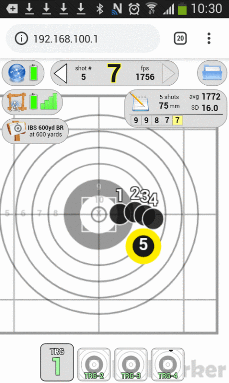

Agreed, this was shot by my Son (he was age 16 at the time) using my RPR (6.5CM), 600 yards five shot group of 59mm (the flyer is the sighter which doesn't score for the competition).
Wow! That's really impressive shooting.
Thanks, he usually (but not always) out shoots me most times now and I use an AI AT (.308/6.5CM), must be the better eyesight.
He was the club 600 yard benchrest factory champion (2019/2020) using the RPR and he is currently third in the 600 yard 2020/2021 championship. He was also third in the 1000 yard 2020/2021 club factory class benchrest championship (he got his medal on Sunday).
He has also managed numerous small groups in competition (in his class - factory benchrest], hit the 'fly' (500 yards [you get three five shot groups] and hit a hens egg (500 yards [one shot allowed at the egg]). The fly and egg shoots are competitions our club runs on an annual basis therefore the patches you win are prized since they can only be won once per year.
He also shot the group below (2020), whilst it's 75mm overall, the first four shots are just over 24mm. he just 'messed up' the fifth shot (wind change?), therefore, he was on for a sub one inch group at 600 yards!
As you can tell, I am proud of him.
In summary, in my opinion, an RPR can shoot well!

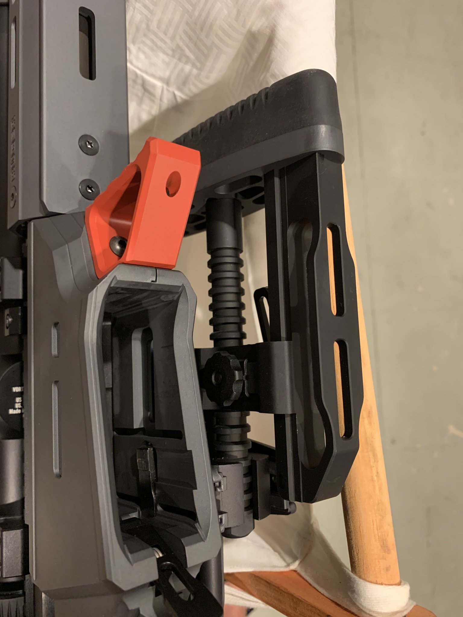

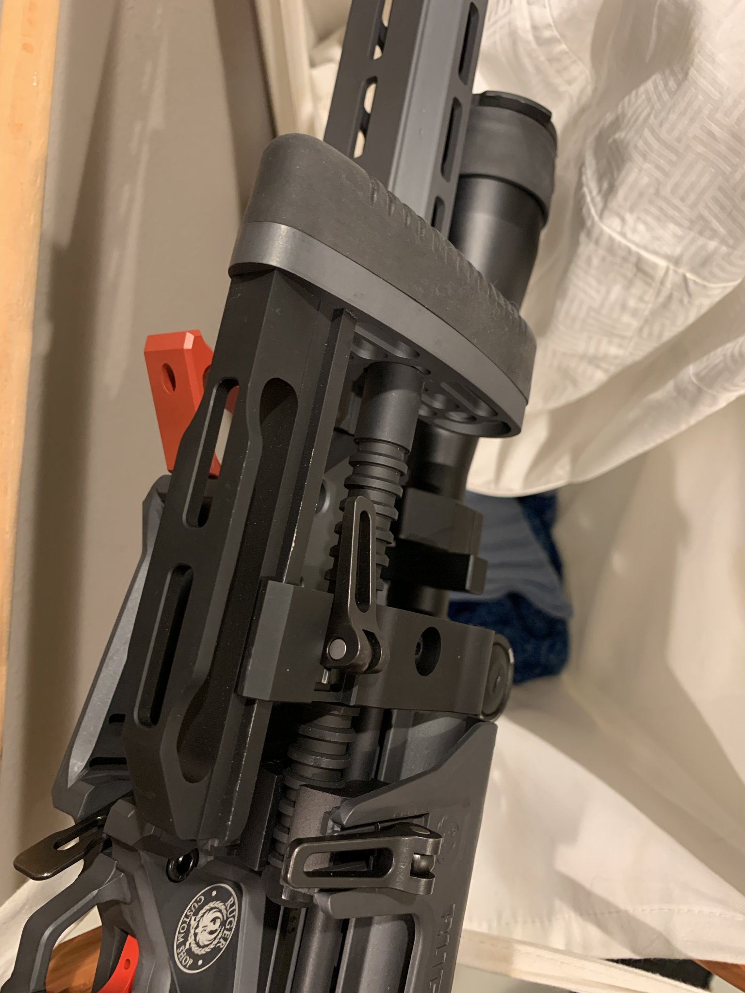

I put an M16A1E stock on my .223 and it works great. Thought I'd try one on the .300WM. It does not allow the bolt to fully retract so it is a no-go for magazine feeding and extracting live rounds unless I cut a notch in the buffer tube to allow clearance for the cocking piece. Cutting a 3/8 x 3/8 notch through the buffer tube threads doesn't give me a lot of confidence. It does allow the rifle to sit lower though.

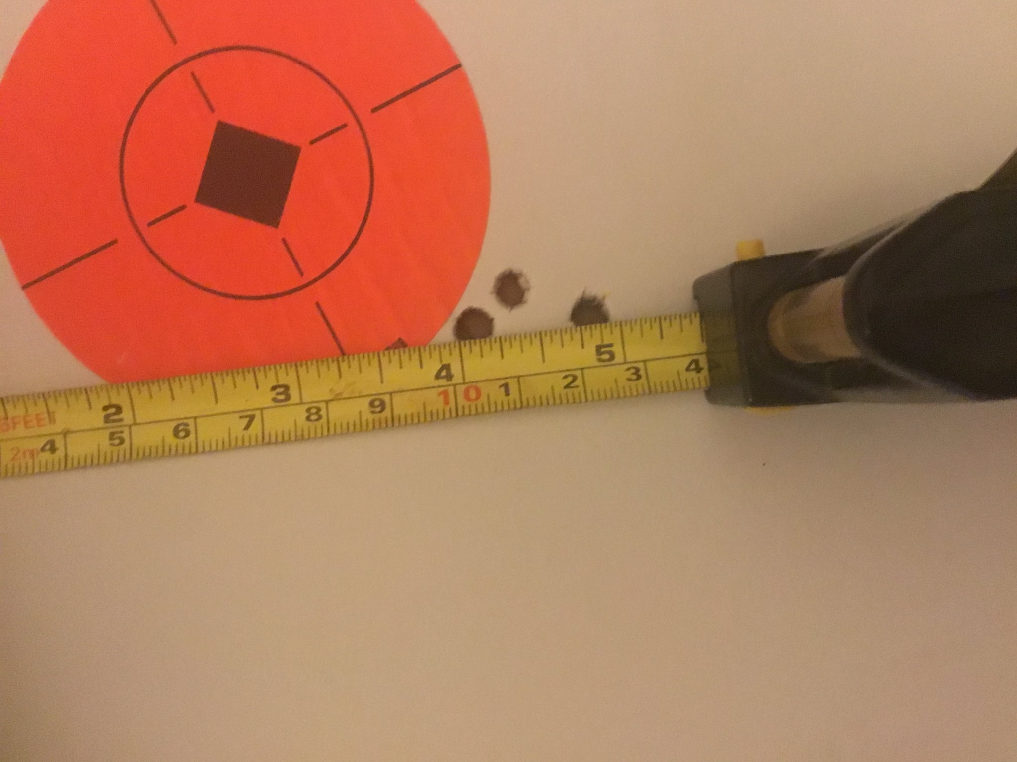

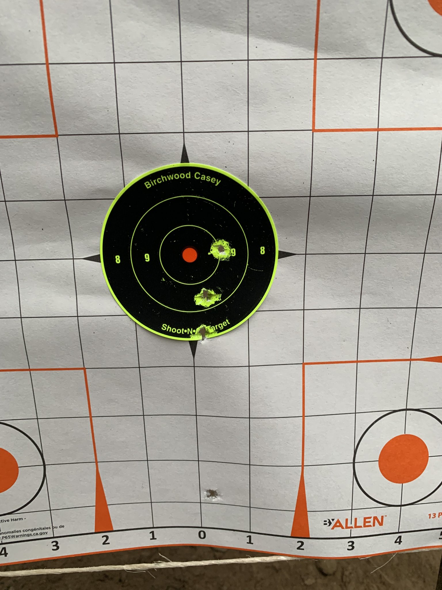

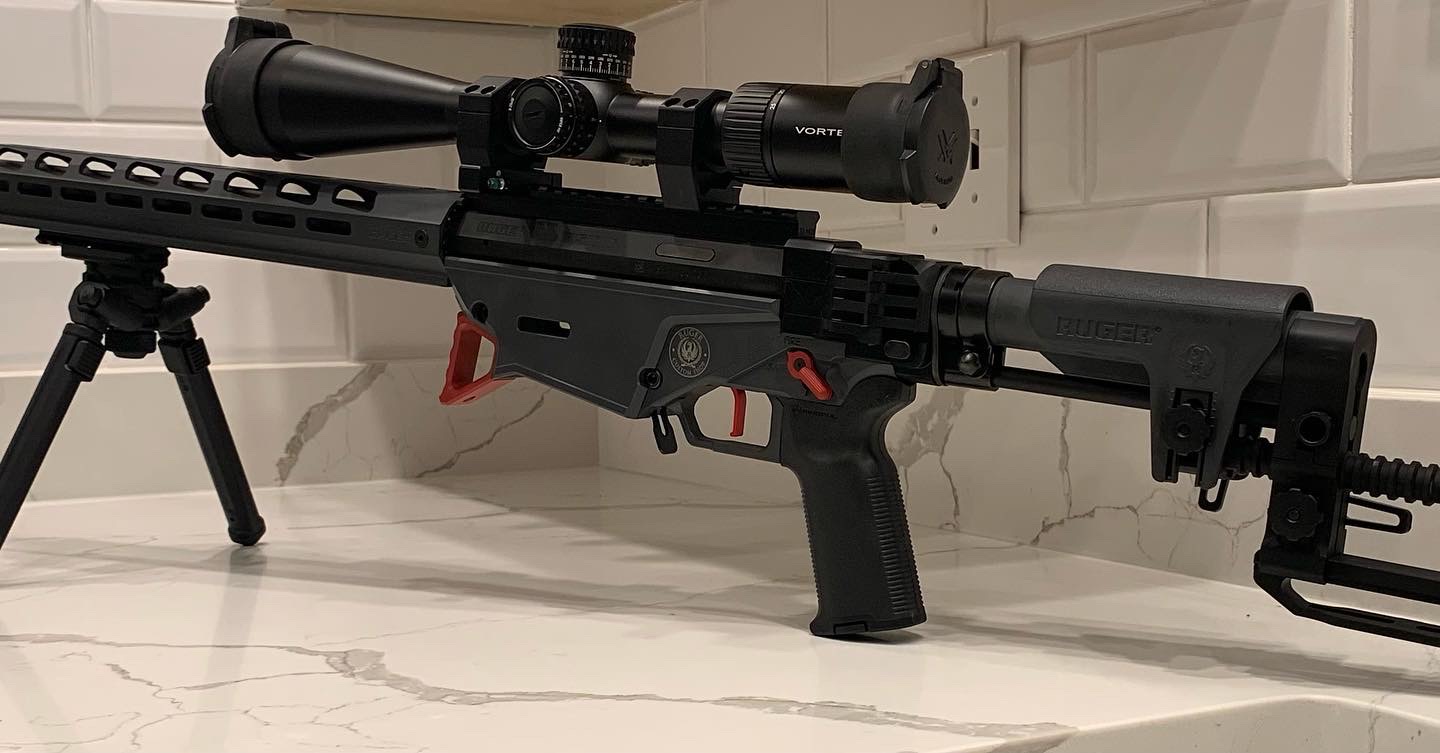

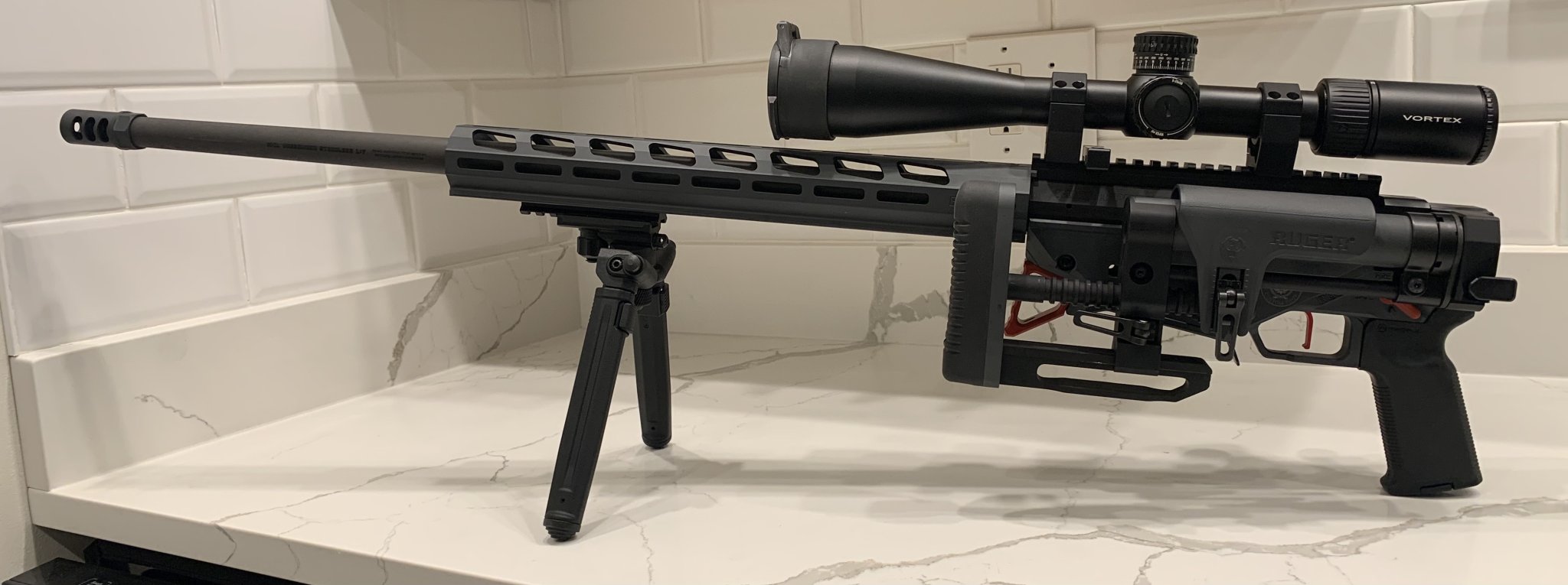

Upon the suggestion of a friend, who owns a Gen 1 6.5 Creedmore, I picked up the 6mm Creedmore and opted for the Custom Shop version as I wanted the upgraded trigger and heavy barrel. I am using a set of Vortex PMR rings, with a Vortex Vioer PSTii 5-25x50 w/ EBR-2C reticle (MOA), and an MK Machine aluminum picatinny mounted level.
I have only had it out to the range once. I put 10 rounds through it. The first 4 were off paper, the last six (once I dialed in the scope) were pretty good. Then my 15 year old daughter did another 3 (the first one didn’t hit as she wasn’t ready for the trigger), and my buddy (Keith) did the last 3. My buddy is a far better shooter, and took the time to setup his bags.
These shots were at 98.2 yards using Hornady 108 ELD Match.
I am going to get some other match grade bullets to determine which variety this barrel prefers, but for now the 108 ELD seem to work well.

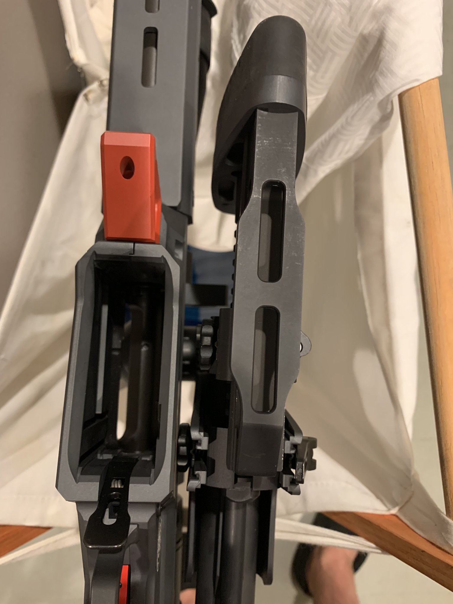

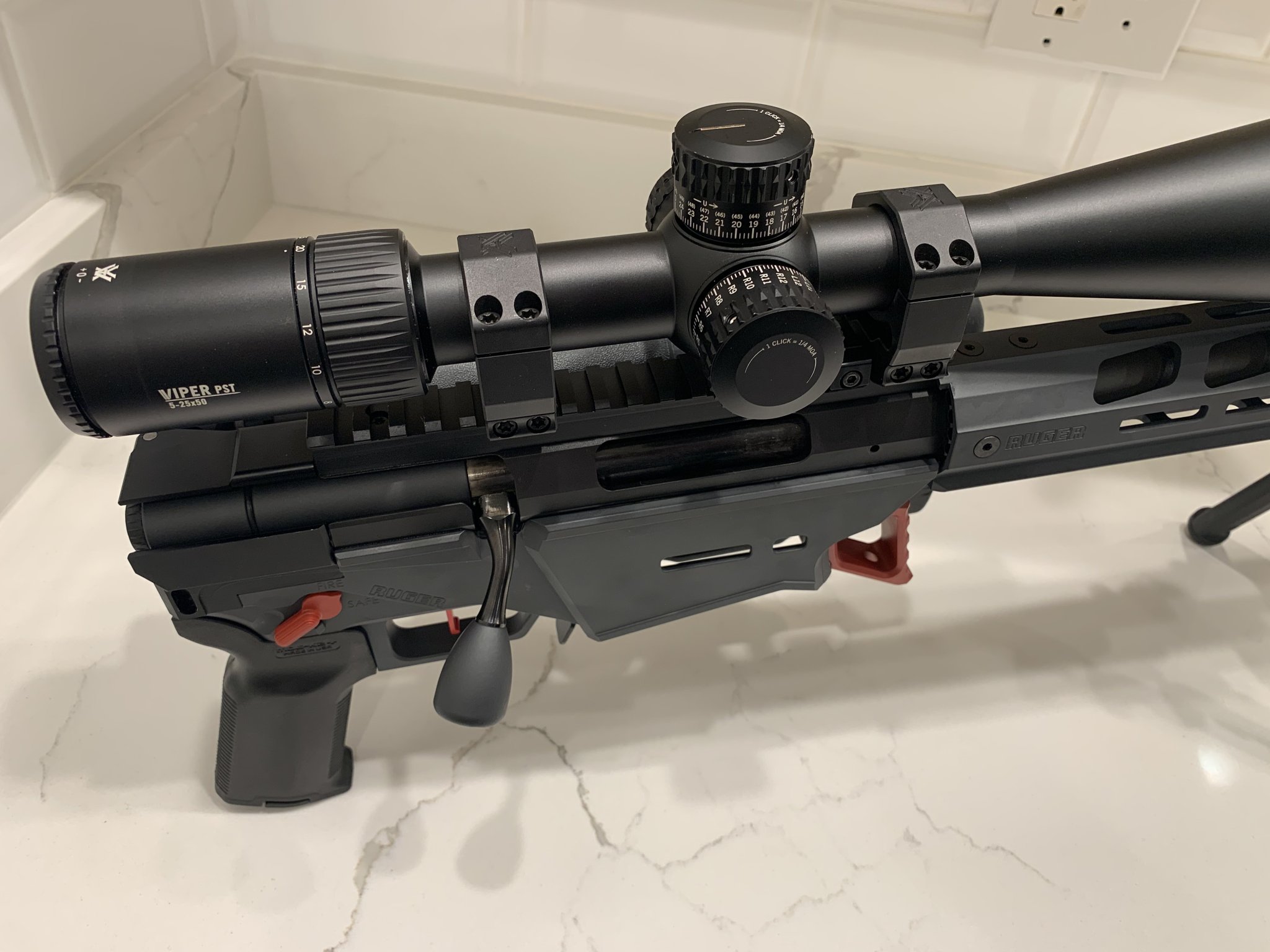

Hi, I am new to this forum, have really followed the creedmore forums closely , really helped out a lot, right now I am replacing my RPR barrel with a Proof Research barrel, in the process I could not get the barrel nut off my gen 3 barrel, bent 2 barrel nut wrenches with heat and cold applied, called Ruger to order a barrel nutreplacement, told me that the barrel nuts are fitted and need to send my barrel in for them to fit my bar
Both mine came off with a bump from a deadblow. Invested in the reaction rod. Money well spent.
