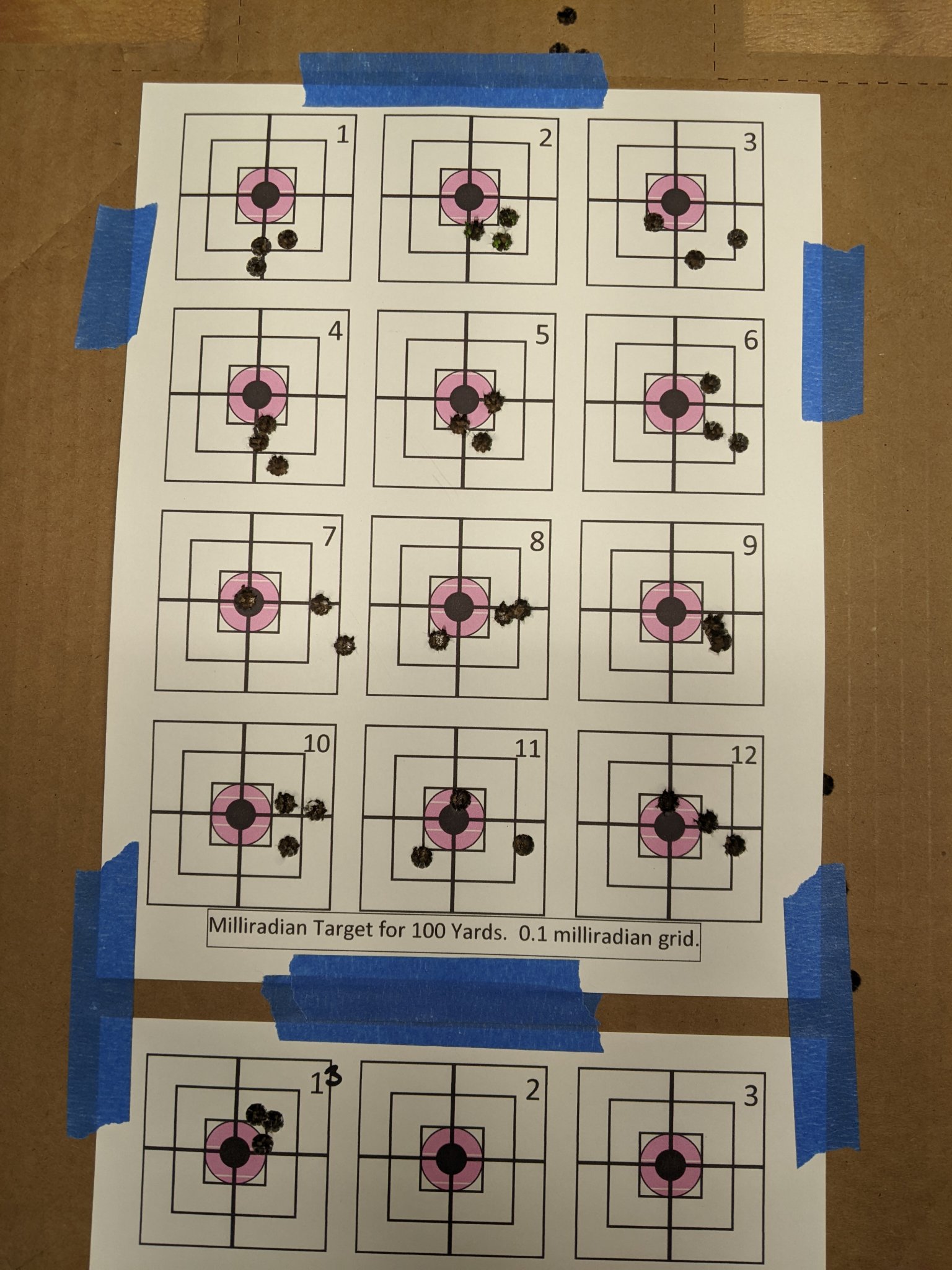

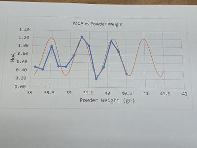

I started load development with H4350 powder and 140gr ELDM bullets. Working with 3-shot groups from 38.1 gr to 40.5 gr from target #1 to target #13. As for COAL I used 2.828” - just shy of the max mag length. Results were interesting - getting anywhere from 1.25 down to .2 MoA. Target photo attached. Lines are .1 mRad. A pattern was pretty obvious which made me feel better that it wasn’t just crappy shooting on my part. So, I plotted the data as MoA vs. powder load (blue curve) In the attached graph. The result suggested a sinusoid, so I curve-fit a sine wave to it (orange curve). The fit is pretty good in the middle. The data suggests another accuracy node at 41.4 gr and a bad spot at 41 gr. I’m hoping to validate my prediction a couple days.
I’m thinking that the weird data at the left side might be evidence of other factors like neck tension or seating depth having a greater role - or maybe my shooting sucks; I only have 70 rounds through the rifle. Anyway, I’m gonna rerun some of those loads.
Sorry to blab on, but I’m new! One other bit I found interesting in the targets is how the POI’s rose and drifted to the right as the powder charge increased.

Were you getting consistent results when you shot those (40) rounds?
I remember it took a while for my RPR's barrel to settle in.
Unfortunately, I don’t know. I was shooting at a variety of targets and a friend of mine also shot it. My goal at the time was to just get comfortable with the gun & sight. I shoulda paid close attention to shot grouping as well. Opportunity lost! Good note for the next new guy.

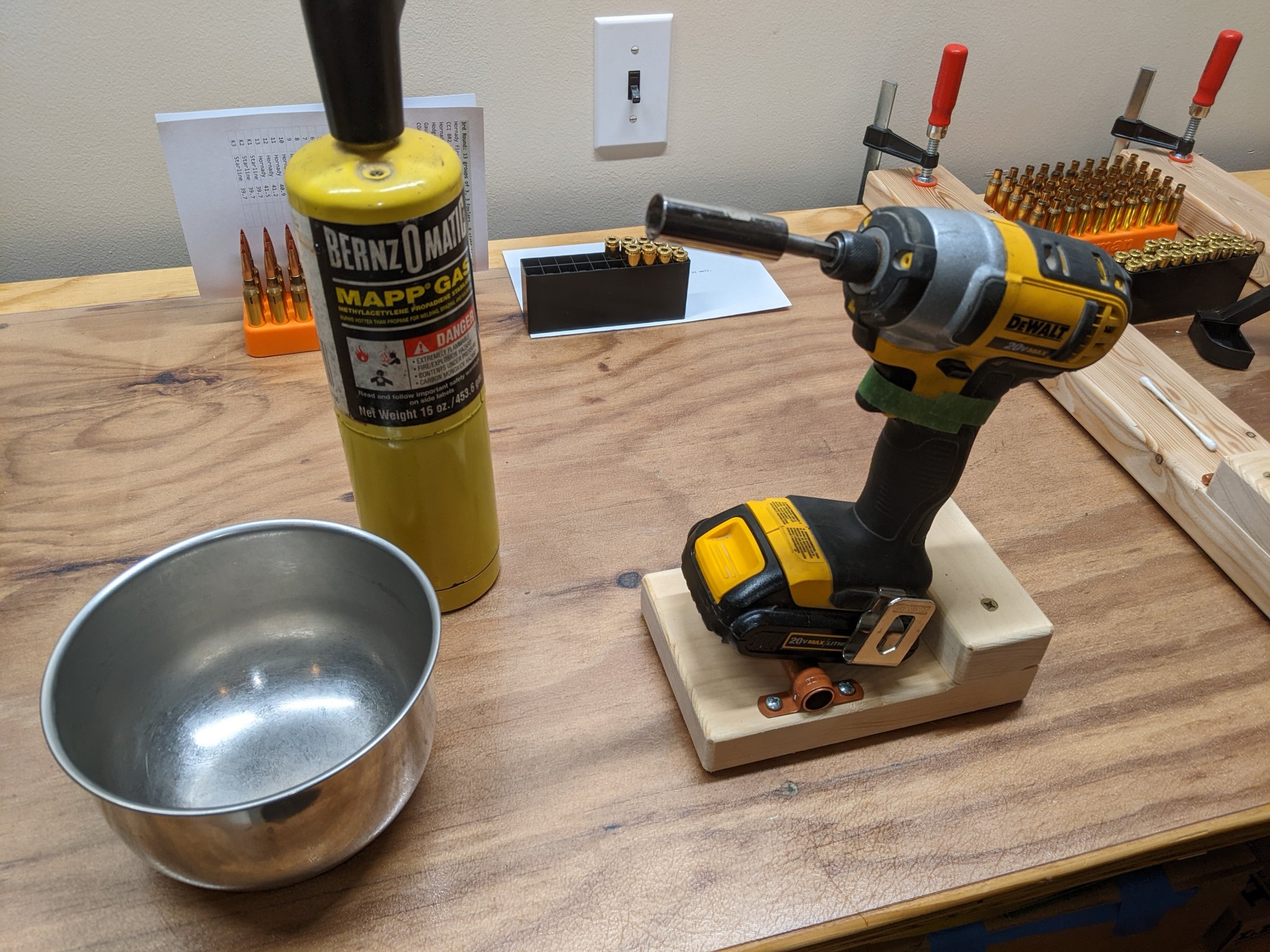

I anneal after every firing and built this jig. That’s a 1/2” deep socket and a hex to 1/4” square drive adaptor. 1/2” copper pipe makes the fulcrum and Velcro keeps the driver running. Fill the bowl with water and go. The time per case is about 8 seconds - ~3 to anneal and ~5 to load/unload.

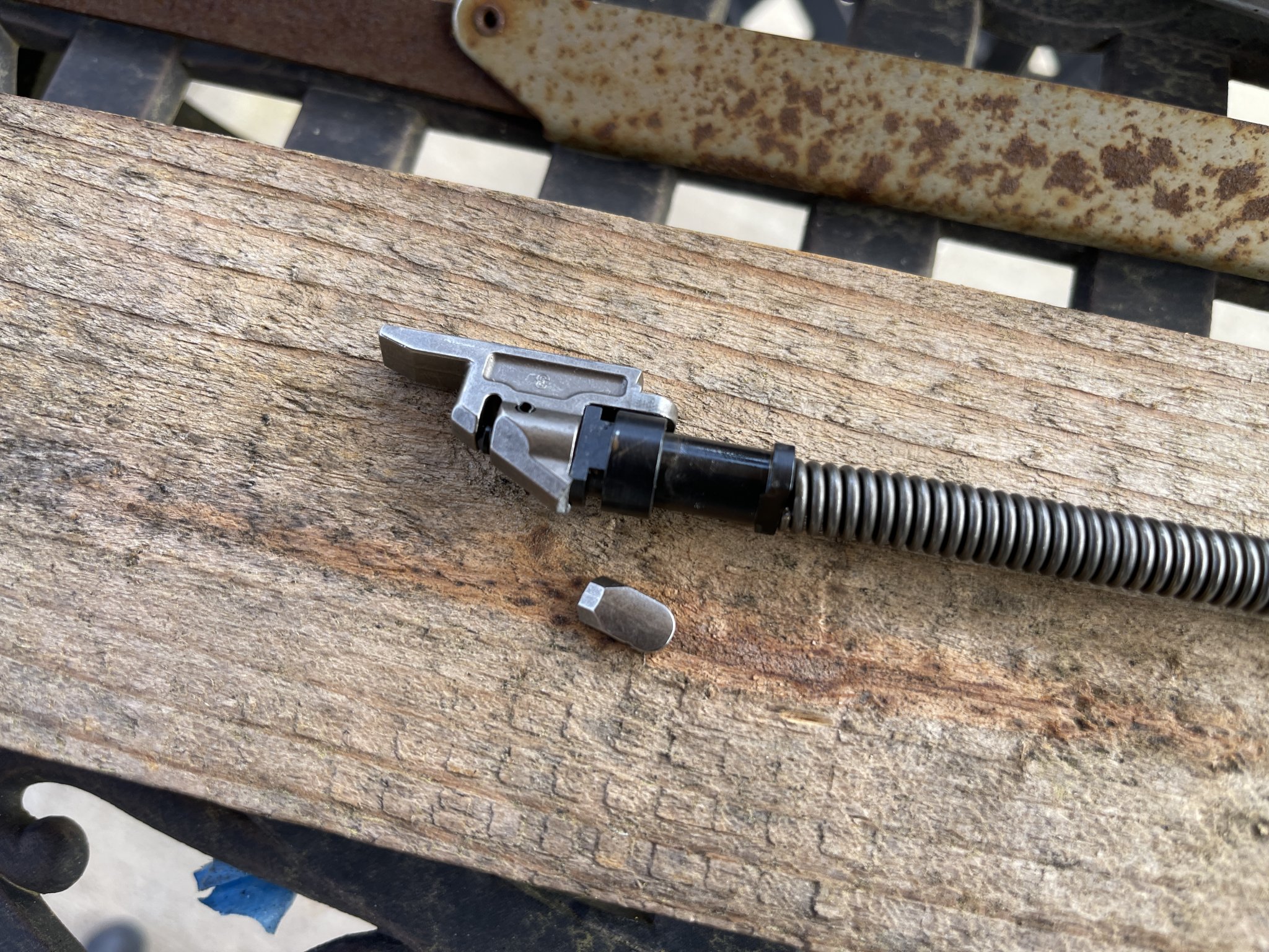

The inevitable happened to my Gen 1. During some dry firing I felt a different lift. Yup. Exactly what I thought. I already reached out to Ruger and they are sending me a replacement piece as well as a new spring per their emails. Am I essentially swapping in the same inferior part or have they revised it? Sorry I haven’t combed through all 114 pages.

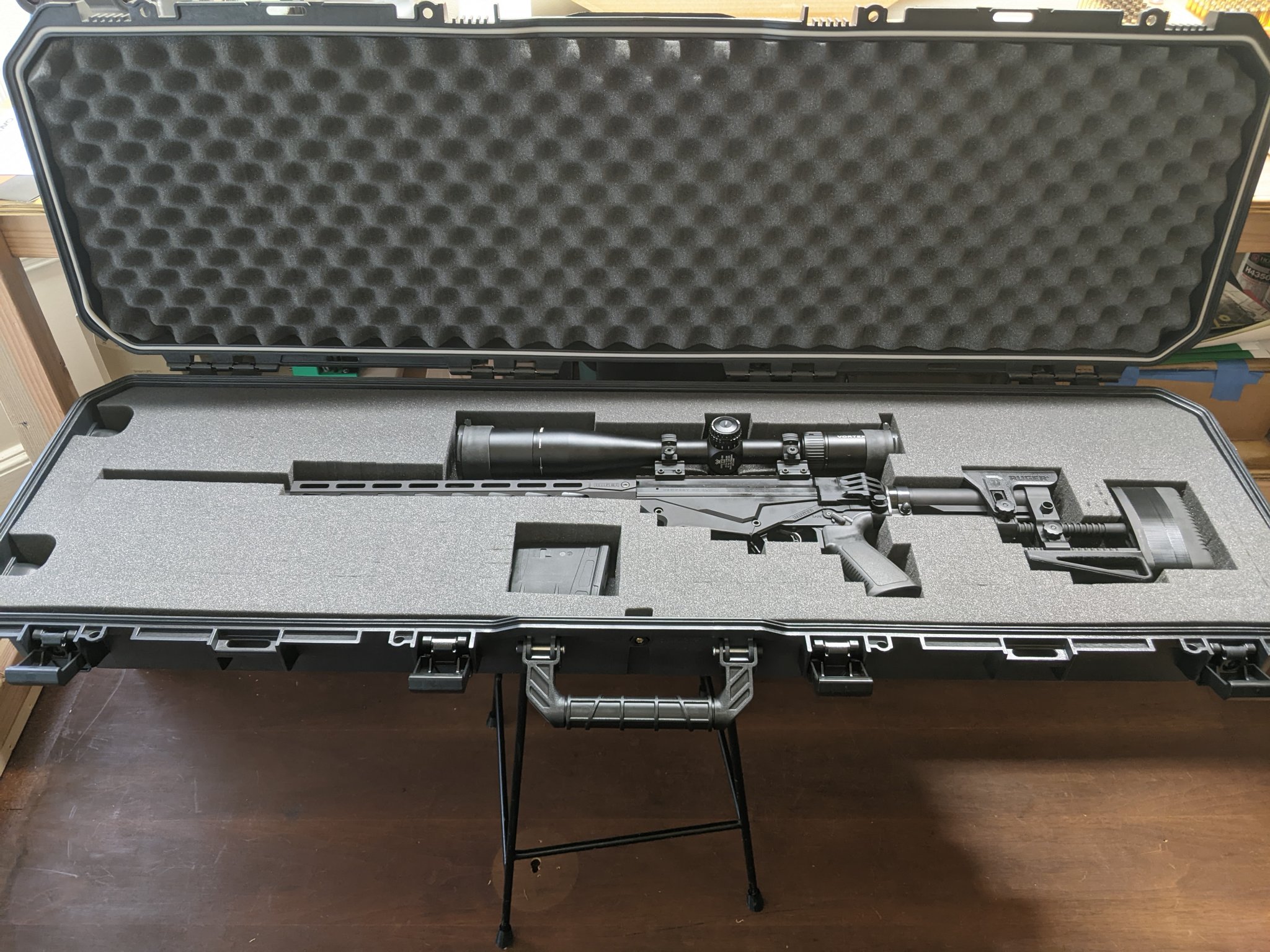

The Storm 3100 has an interior length of 36.5" and exterior length of 39.8". My 6.5CM fits in there with about a half inch to spare. Muzzle brake selection and optic placement might rule it out for some. It goes in and out of my Corolla's trunk very easy. I have used it to go to the range and driven around the country with it in my trunk. I would not fly with it though. I would be afraid there is not enough cushion if it really got thrown around.
The Pelican 1720 has an interior length of 42" and an exterior length of 44.3". Lots of room there and it is not too bad to get in and out of the trunk of my Corolla.
An ideal case IMO would be in between those two.

Care club sells them that have laser cut foam for the RPR. I have one.
It’s the exact same case as the Apache case at HF, but with much nicer foam
