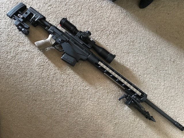

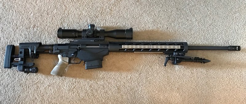

Just got my gen 2 baby yesterday, mounted the rail, scope, and qd sling cup. I was using an ms3 magpul sling and the qd cup failed and my rifle fell off my back and slammed the muzzle break on a Larue lt104 mount :.( luckily I didn't have the scope in the mount or it would've been a disaster. I replaced the grip with a Larue APEG, and angled the butt pad to the left. Can't wait to shoot it.

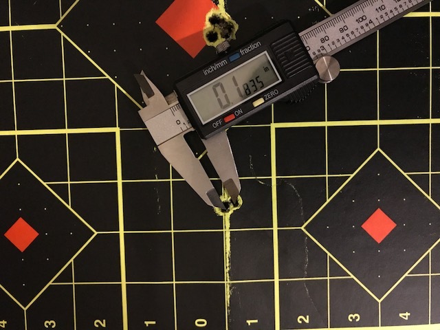

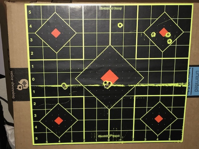

Started the break in process today, had to cut it short unfortunately but got 25 rounds in and 8 cleanings. Boresighted at about 30ish yards, just had to drop the sight down 20moa and I let if fly. Hit was 3.5 inches to the left. My reticle showed 10 moa so I moved point of impact 10 moa to the right, next shot was dead center about a half inch low, I was satisfied with poi. First five landed in the same hole, mind you this was with a cleaning in between every shot (I know 30ish yards, but still) I then decided to go for a 600 yard shot just for fun, wind was blowing from right to left, first attempt at 600 landed 12 minutes low and 2 minutes left, I held over using the reticle and WHAM impact! Again, same hold, impact! After hitting 10-15 shots at 600, for fun I decided to go back to my 30ish yard target, I put 7 rounds in the middle and 3 on the very first hole, cleaning after every 5 rounds. Rifle recoils like a pussycat, muzzle break isn't very blasty either, loving this rifle so far.
In the picture the left hole is .183" (3 shots) middle hole is .301" (7 shots) top right holes were from my son shooting a marlin 795 .22. I was shooting the 129gr interlock hornady's.

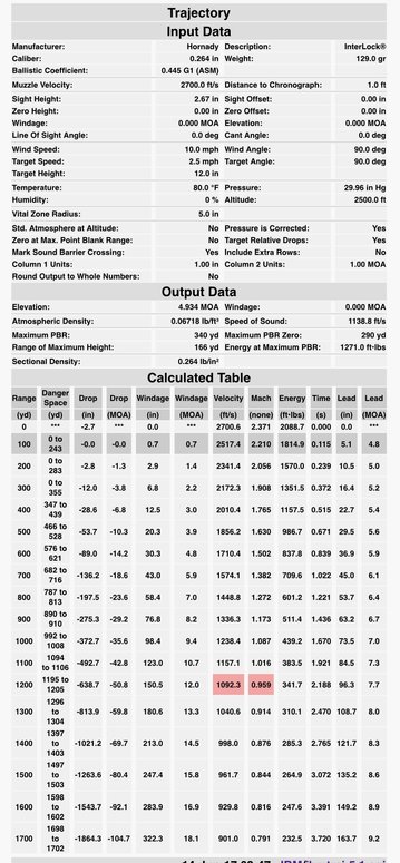

Yup, still have 30 rounds of it too, I probably will rezero with 140 then go for 1000. I don't have a chrono but judging by my holdover at 600 the 129s are doing 2700fps.
