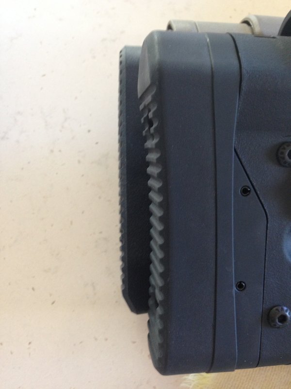

Could you give me some idea of the LOP adjustment available? I need about 13.5" LOP if measured from the center of unpressed trigger to butt.
I'd strongly consider it if I was sure I could fit it too me. I just saw a post on it somewhere that said it had made the LOP too long for them but didn't specify.
mine is 15" from middle of trigger to butt. that's almost fully collapsed. so for you it may be too long. maybe a gen 2 would be better or if someone is using a standard receiver extension instead of the full length it may come in shorter, the gen 3 is compatible with both.

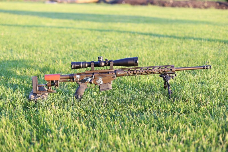

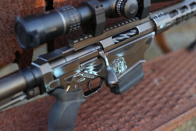

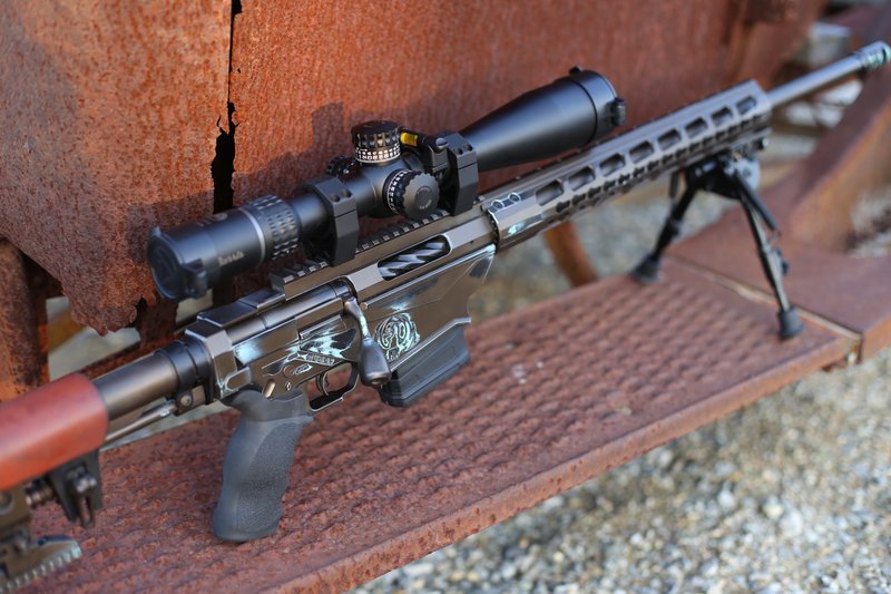

A few post back some of you guys were talking about cerakoting your rprs. My wife just got hers back so I figured I'd let you check it out.
It was done by Bell Precision Rifles in Indiana. Its a 3 color mix of graphite black, midnight bronze and tiffany blue. She liked the distressed look. She also was not fond of the cheek rest so he covered it in saddle leather, also distressed. He changed out the grip and installed an extended safety.
. Thought it turned out pretty damn good. Hope the pics show up. 46B3B483-151F-4A62-99D8-8EF7D69125EC.JPGB640049A-7B15-4E48-B49D-013A36303F47.JPG

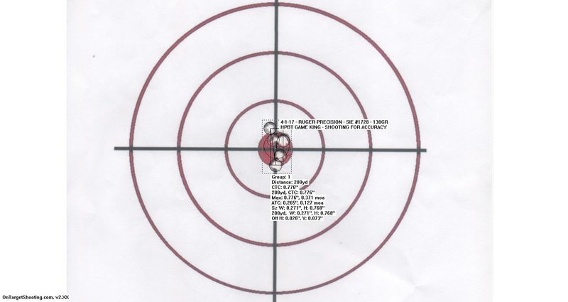

I have settled on the 130gr Gamekings (#1728) for my "GO TO" hunting load. With 43.0gr of RL-17, 2850-2900 FPS and out to 200 yards, minute of squirrel brain accurate. At <300 yards, they are just as accurate, (a little more consistent) than the Matchking 140's. Could be because of the weight, I don't have enough data yet to determine that.

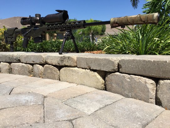

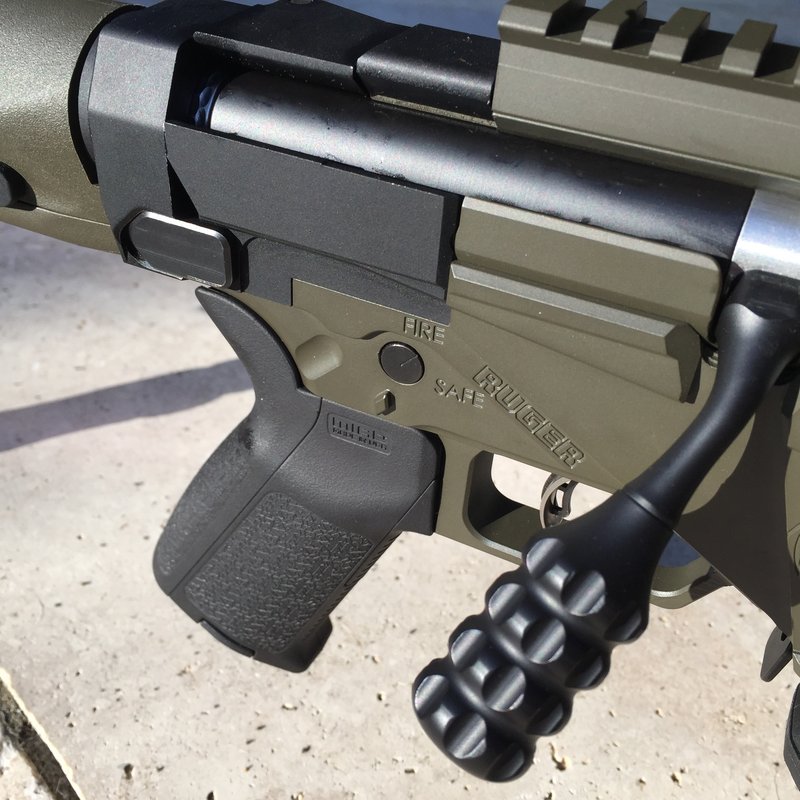

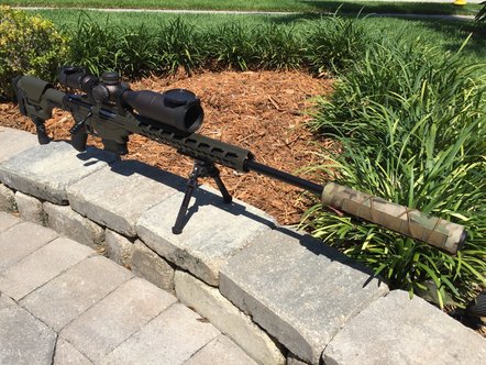

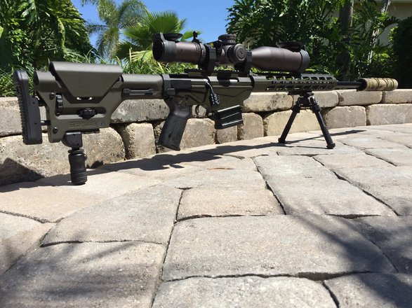

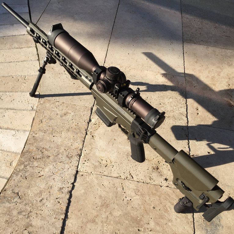

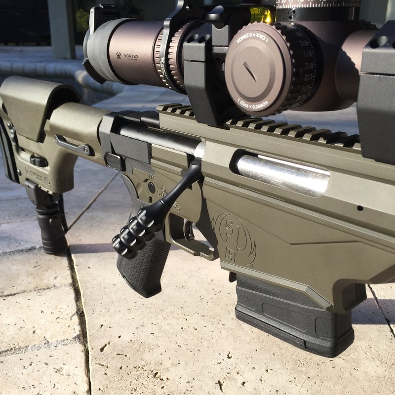

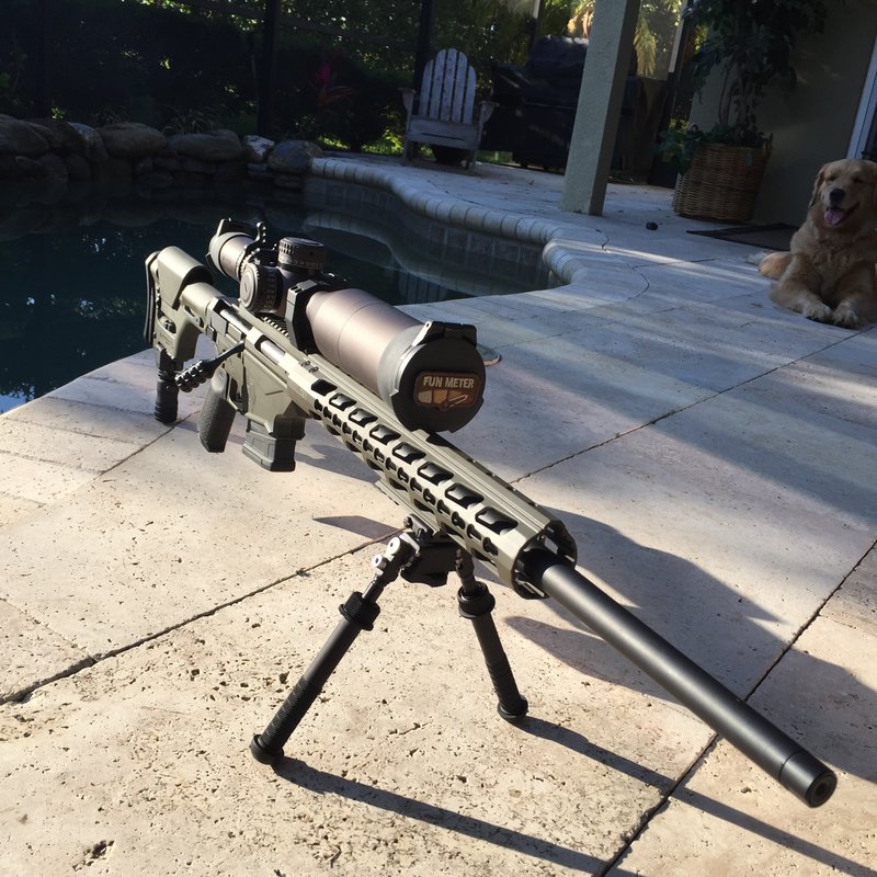

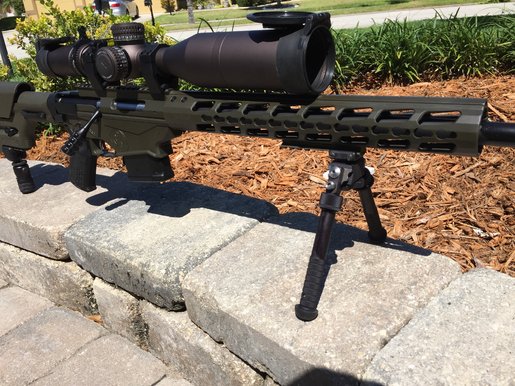

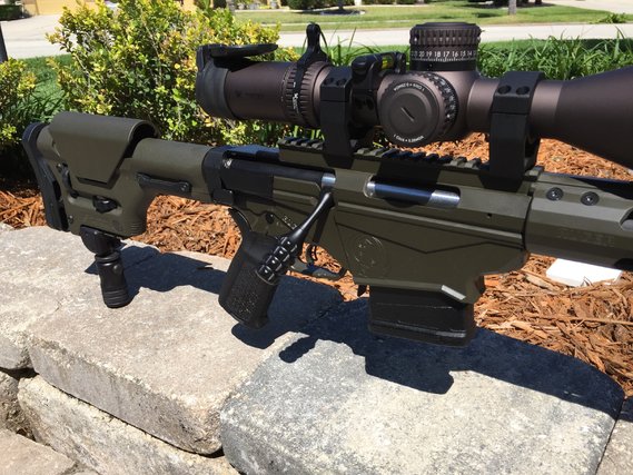

I just got my RPR Gen II back from Rampart Gunworks where I dropped it off to get it sprayed with Magpul OD Green Cerakote to match the Magpul PRS stock I added. I think it came out great!

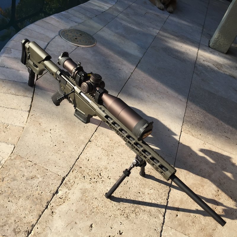

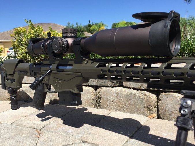

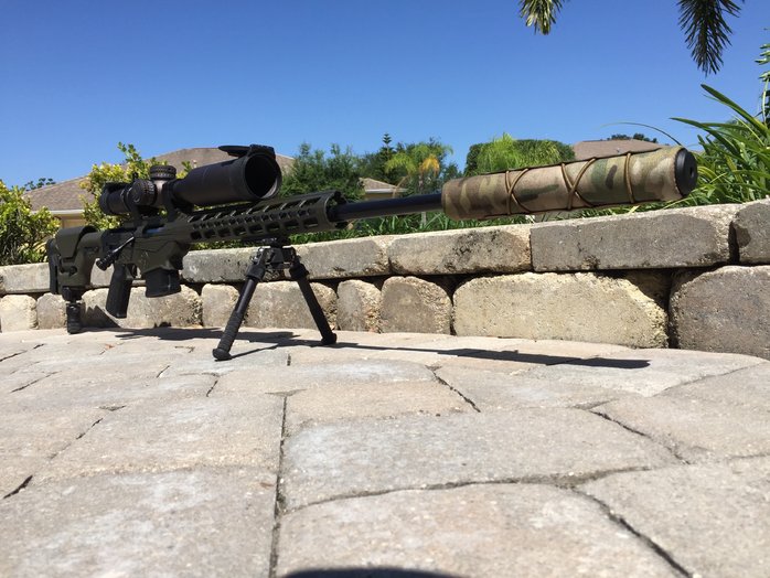

I got my RPR back from Rampart Gunworks where they sprayed it with Magpul OD Green Cerakote and Armor Black. Take a look:

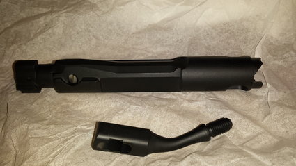

I had my bolt body and bolt handle Micro-Slicked (black) by Zephyr Defense to get rid of the "zipper" sound. I think they have a web site (I had mine done through the Ruger Precision Rifle page on Face Book, good info there). Micro-Slick is made by Cerakote and it is sprayed on and heat cured. I did both the bolt & handle so the color would match. It was in the $45 - $50 range including shipping. Picture attached.
