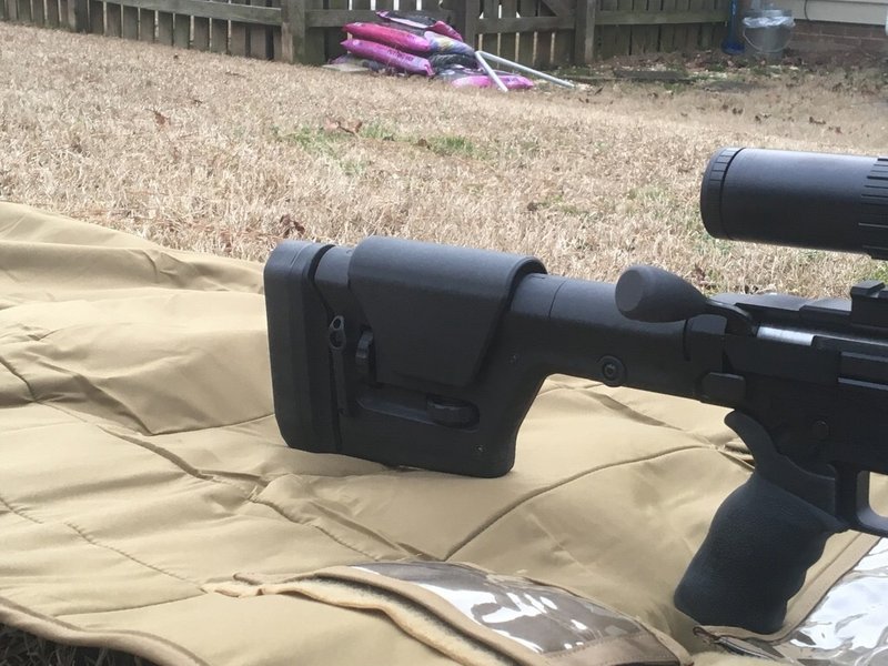

Chef, definitely go with the PRS. My gen 3 is arriving today to replace my current gen 3 in OD green. Who knew magpul had such a shit color that nobody can match cheaply.
