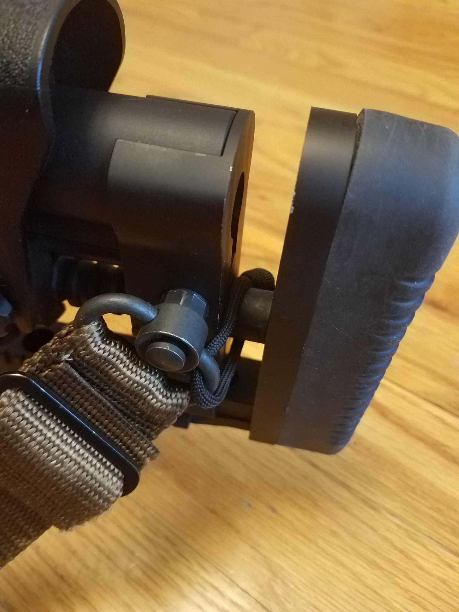

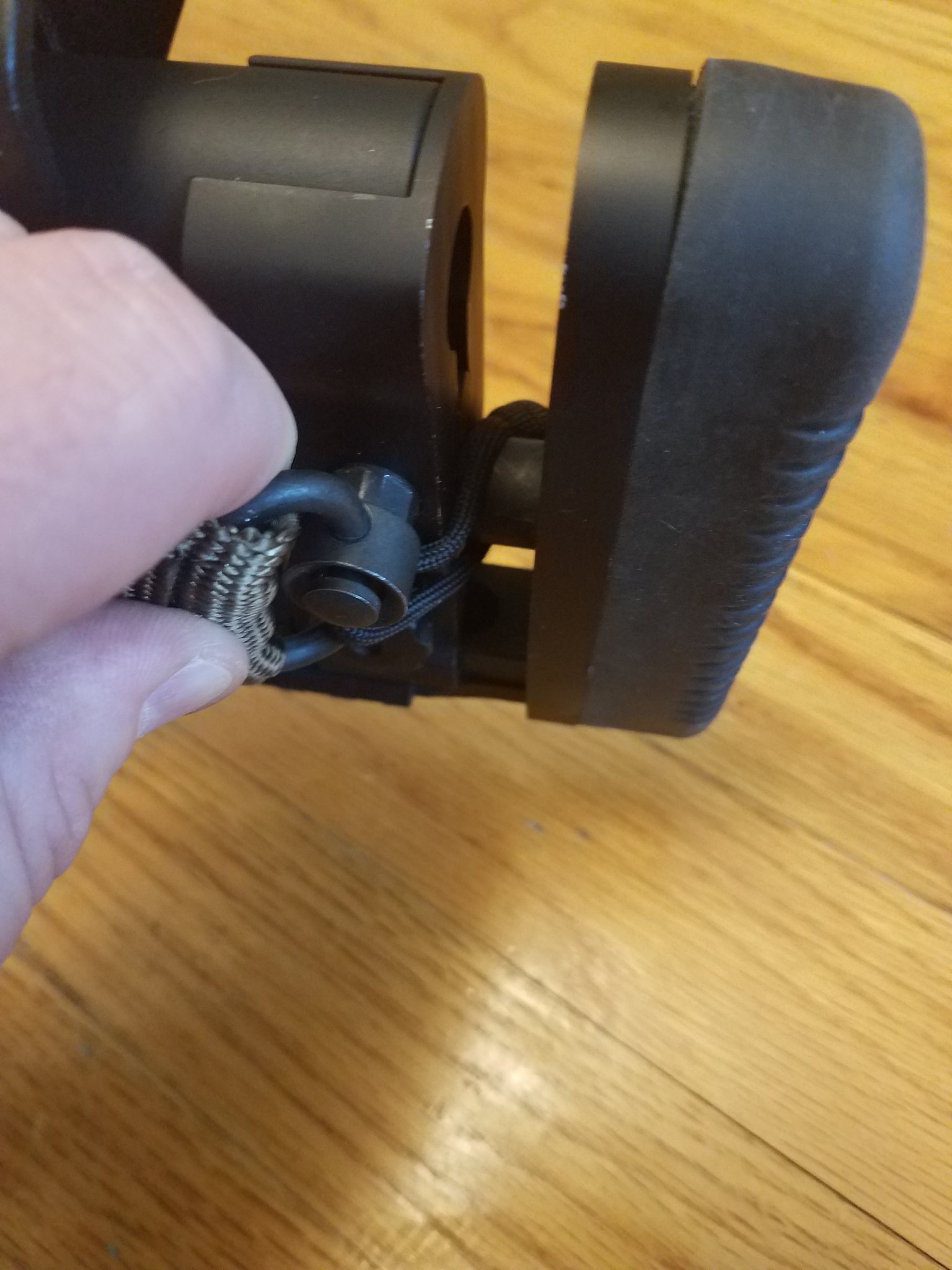

Hack for non-rotation limiting rear sling swivel on RPR stock.
Tied with sling dettached from stock, because the loop is too short to be tied well when attached to the rifle. Once tied I had to remove the adjustable portion of the stock to get it through the loop. All said and done, happy with it so far...no twisting?

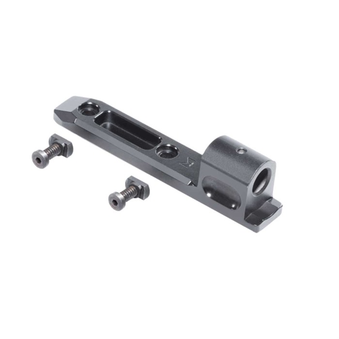

Ended up going with this mount from Badger. I have the Harris on order with a pod loc. Now I can mount directly to the rail. Didn’t want all the extra mess in between to get a secure fit or worry about loosening as others have stated. We’ll see how it goes.
That’s a superior mounting option over factory Harris (y)
