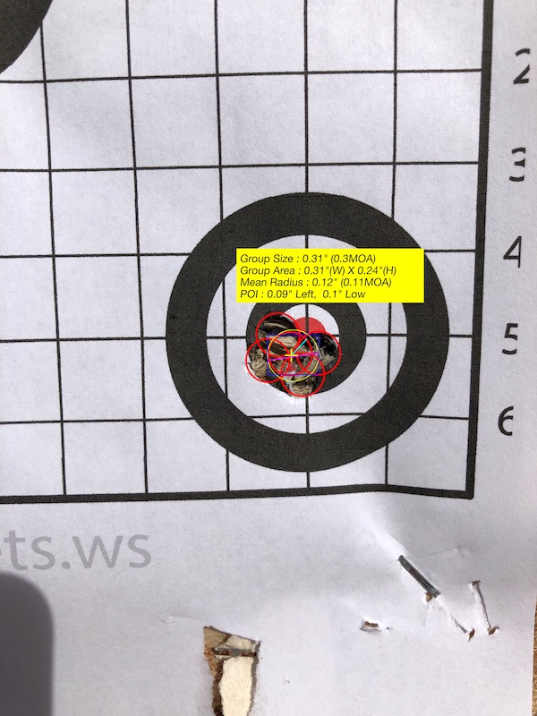

I've had my RPR a week now and I love it. I was just about ready to drop coin on a custom action, but thought for the money, I'll give the RPR a try first, even if it doesn't shoot well, with a new barrel I know it will, and I'd still be in it considerably less then a custom build. I've always like the way they looked, the price was right, and they've made some significant improvements since the launch. Rifle snobs will cry foul at the way the bolt cycle feels, but no denying they shoot!
1). Mine loves 140g ELD Match - see below. 5 shot at 100 yards shooting suppressed
2) Seem to be. Including mine, I've looked at one other in the last week and everything looked good. I've had mine a week now, so these were recent shipments.
3) I'm not a believer in barrel break in, even on factory rifles, your opinion may differ. I cleaned mine before the first shot and haven't touched it since. 100 rounds down the tube now, it's consistently shot 1/2 MOA and less with no "break in."
4) A friend is working up a pretty hot load with the 147's right now. Initial testing at 200 yards looks very promising, but we haven't pushed it out to distance yet to see how they hold up.
5) Redding Competition Dies here.
The one thing I've noticed with the RPR though is the groups start to open up when the barrel gets warm. Much more so then with the Savage 6.5 that I had prior to this.
Enjoy!

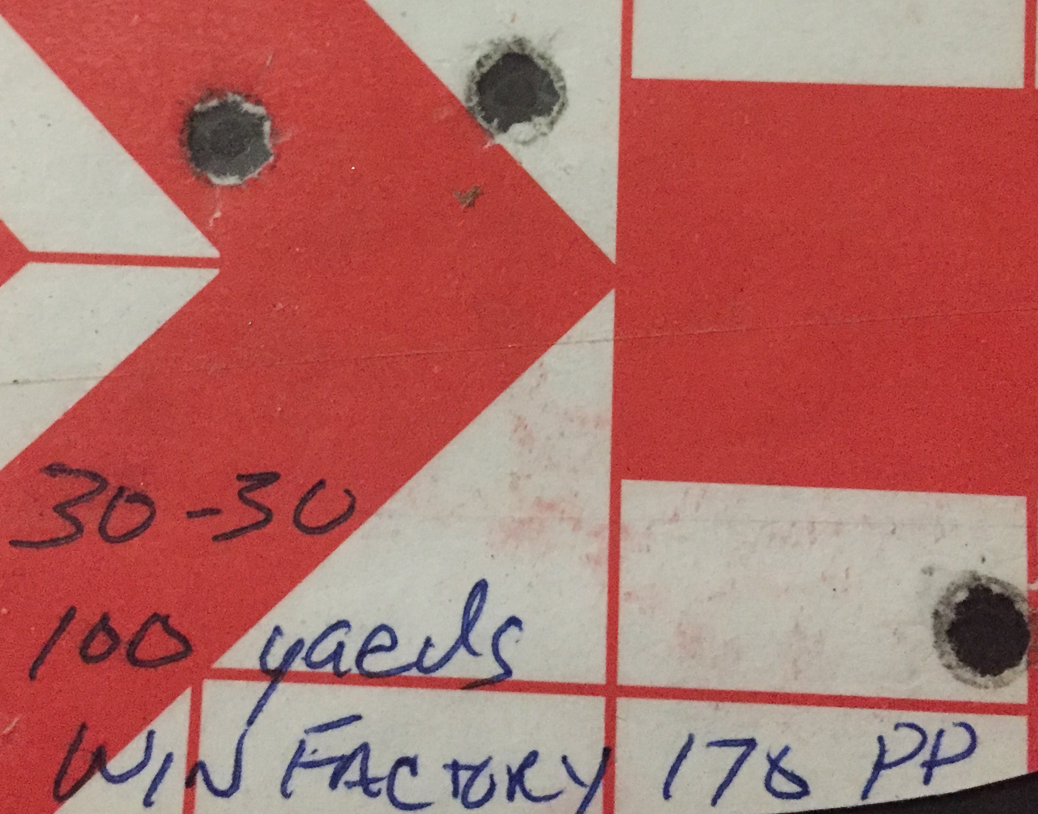

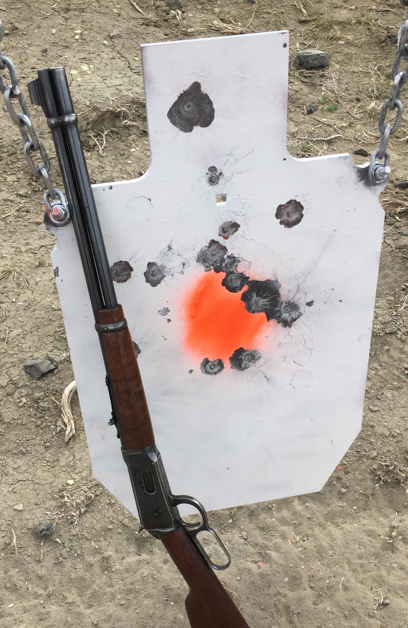

Well after all that I wanted to show off my 1954 30-30 100 yards one and only attempt at a 3 shot group and some steel whacking from 50 to 300 yards. Yep it shoots a little to the right, but it works for me just it is.
