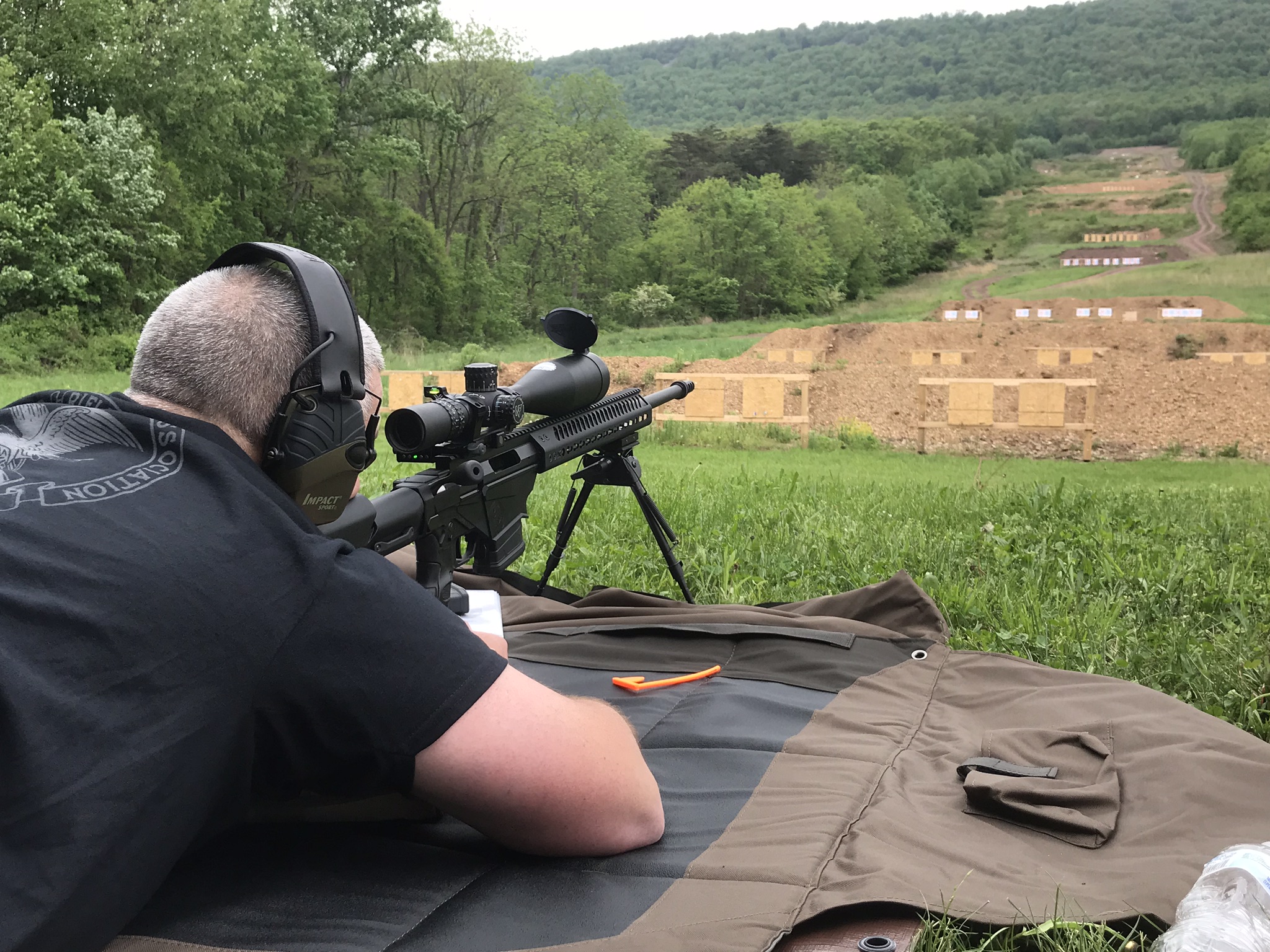

Finally got her out to a 1000 yard range! Didn’t disappoint

The RPR has proved to be a very predictable rifle. It does well with factory ammo but really shines with handholds. The factory barrel does well for a long while as well. The one thing I found over the past few years was that you will want to keep the barrel somewhat clean. Once it gets overly copper fouled the accuracy goes away fairly quickly.
Going to 1000y and beyond is very doable with the 6.5CM on a regular basis.
