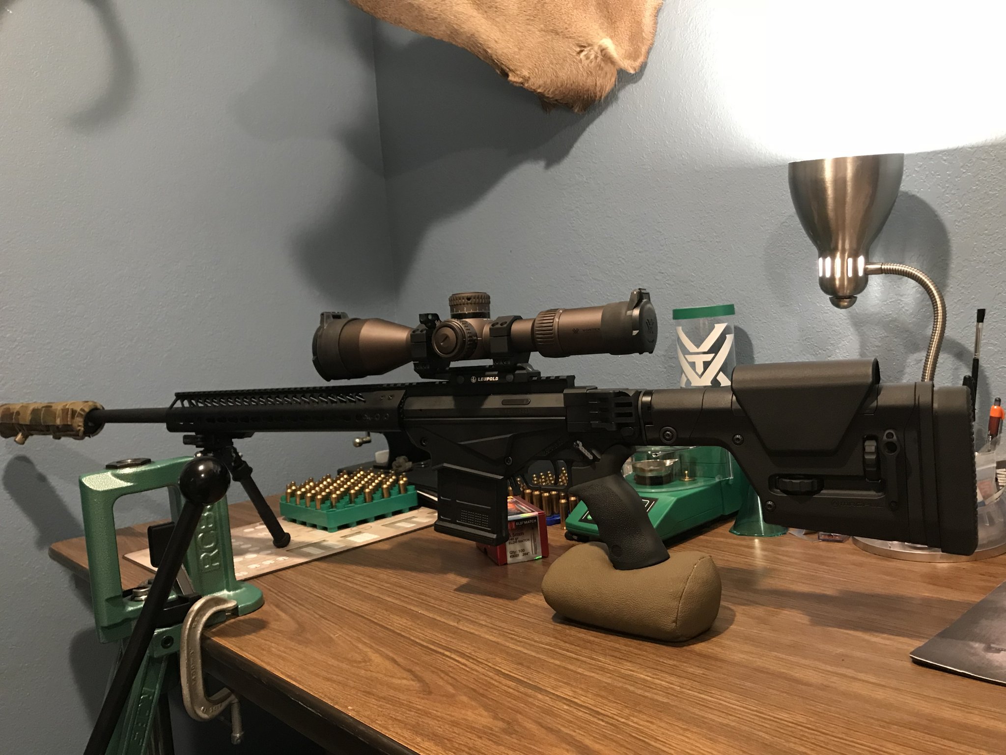

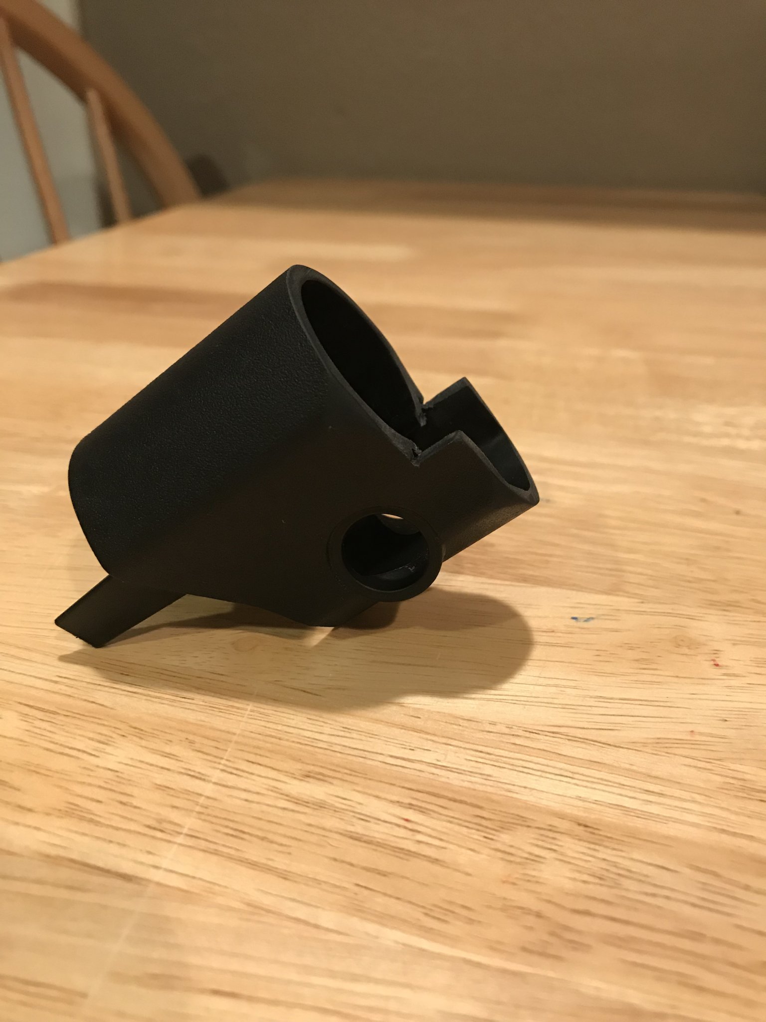

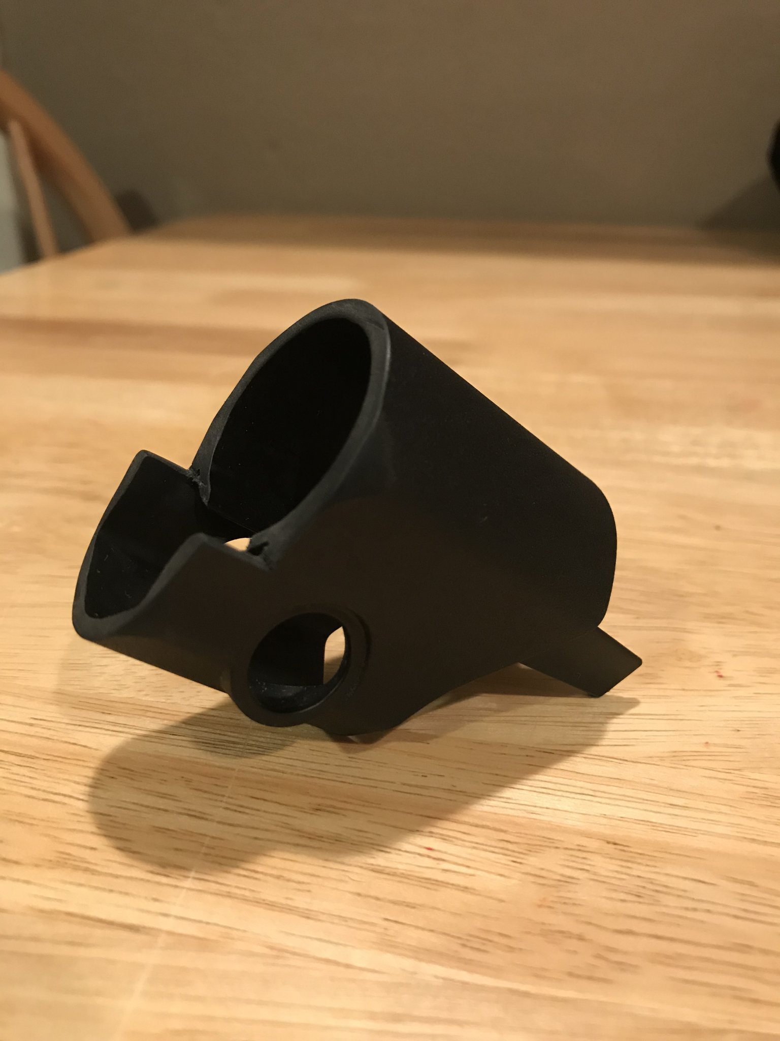

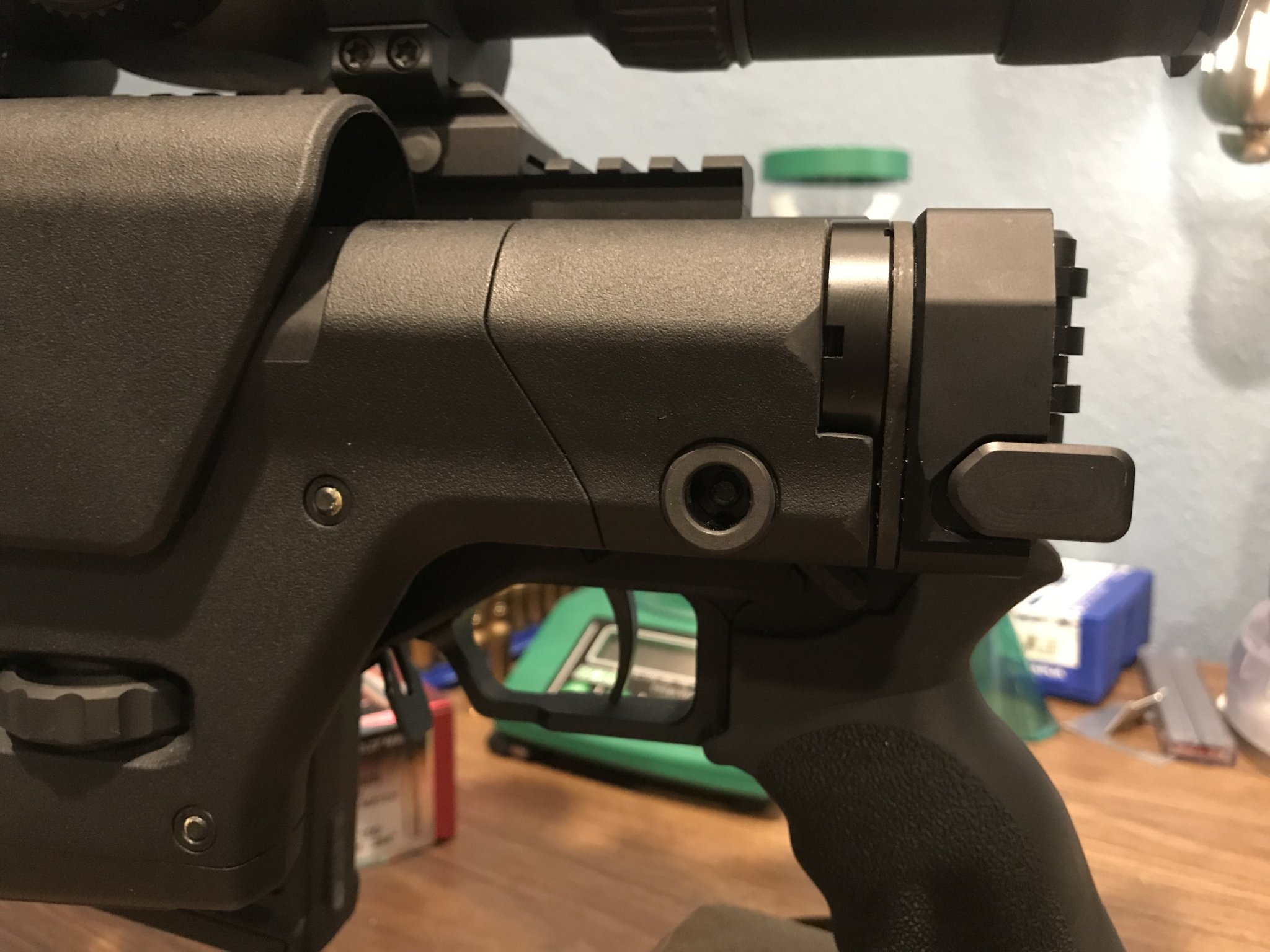

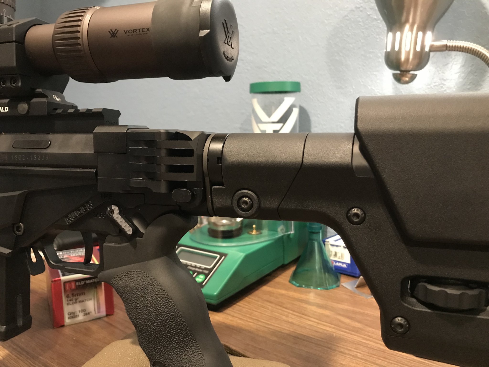

I posted this in the main bolt gun form but figured I post it hear too since it’s the magpul PRS stock is popular on the RPRs. I have hated how long the Gen 3 PRS is on the RPR, but I really dig the stock itself (like the fully adjasble butt pad and overall feel) so a buddy of mine that has the same issue on his RPR googled it and found a picture on another forum of a guy chopping the carbine tube adapter for the PRS. Brainstormed for a day or two on how I would do it and wah-lah. Lost just under an inch of LOP with a fairly simple mod (chop and recontour) to the carbine tube adapter. You could probably take it down shorter with some modding to the stock adjustment lug on the carbine tube by the looks of it. Here’s some pics of it finished.

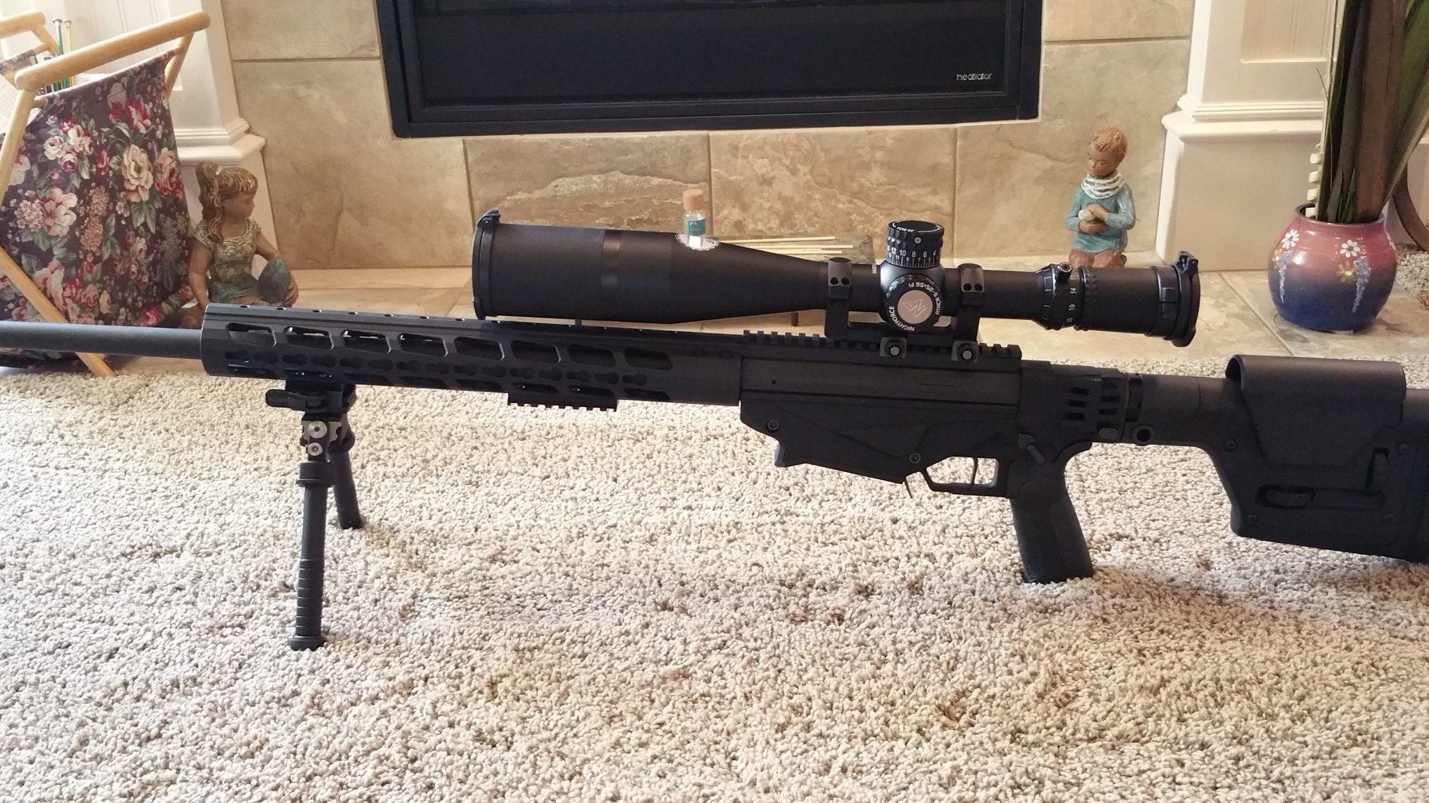

I love the purple. Have a picture of the rifle itself? I was actually thinking about getting mine done in a purple and would love to see how it looks
I have a purple thing going on for sure. I have a ton of stuff this particular color. House of Kolor Passion Purple Pearl. I 2 toned it with straight black. I'm using Cerakote MC-161 matte clear over top.

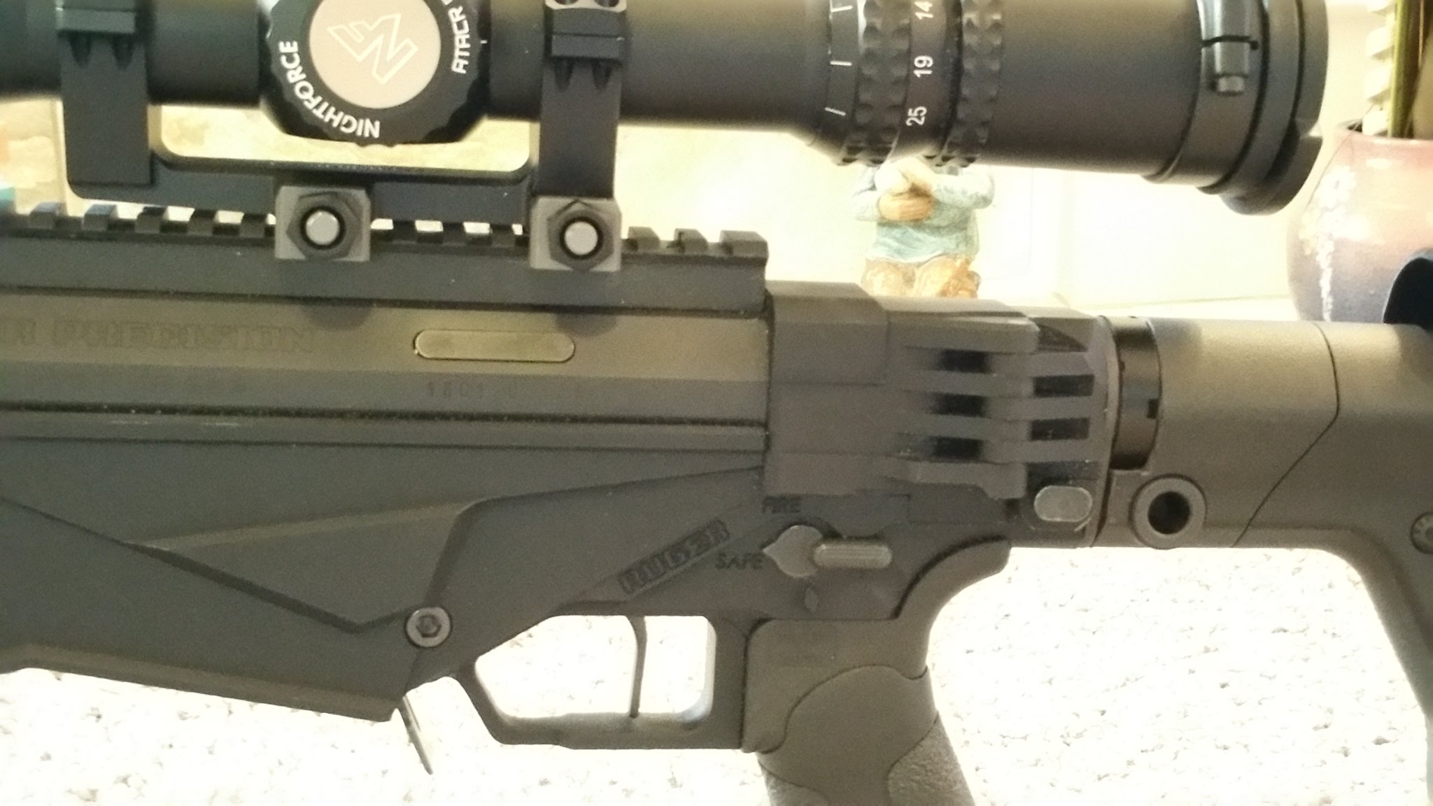

So I tore mine down to the bones to finally clean out the Colorado dirt from shooting with @Lowlight and after I put it back together.....the safety doesn’t work. It won’t go back to safe. I use a seekins ambi safety and I also put the factory one back in and the same thing. Anyone see this before? Trigger still functions and I can move the safety with the lower off but when it’s assembled it doesn’t work.
Any possibility you put it in backwards. When I first installed mine I went with the direction the exterior parts were mounted. Turns out they were backwards, so I installed the whole assembly backwards and it would not move to safe. Once I turned it around everything works fine.
I did the same thing...Only I didn't chop off the buffer tube, just 'sanded' it down enough it fit.
