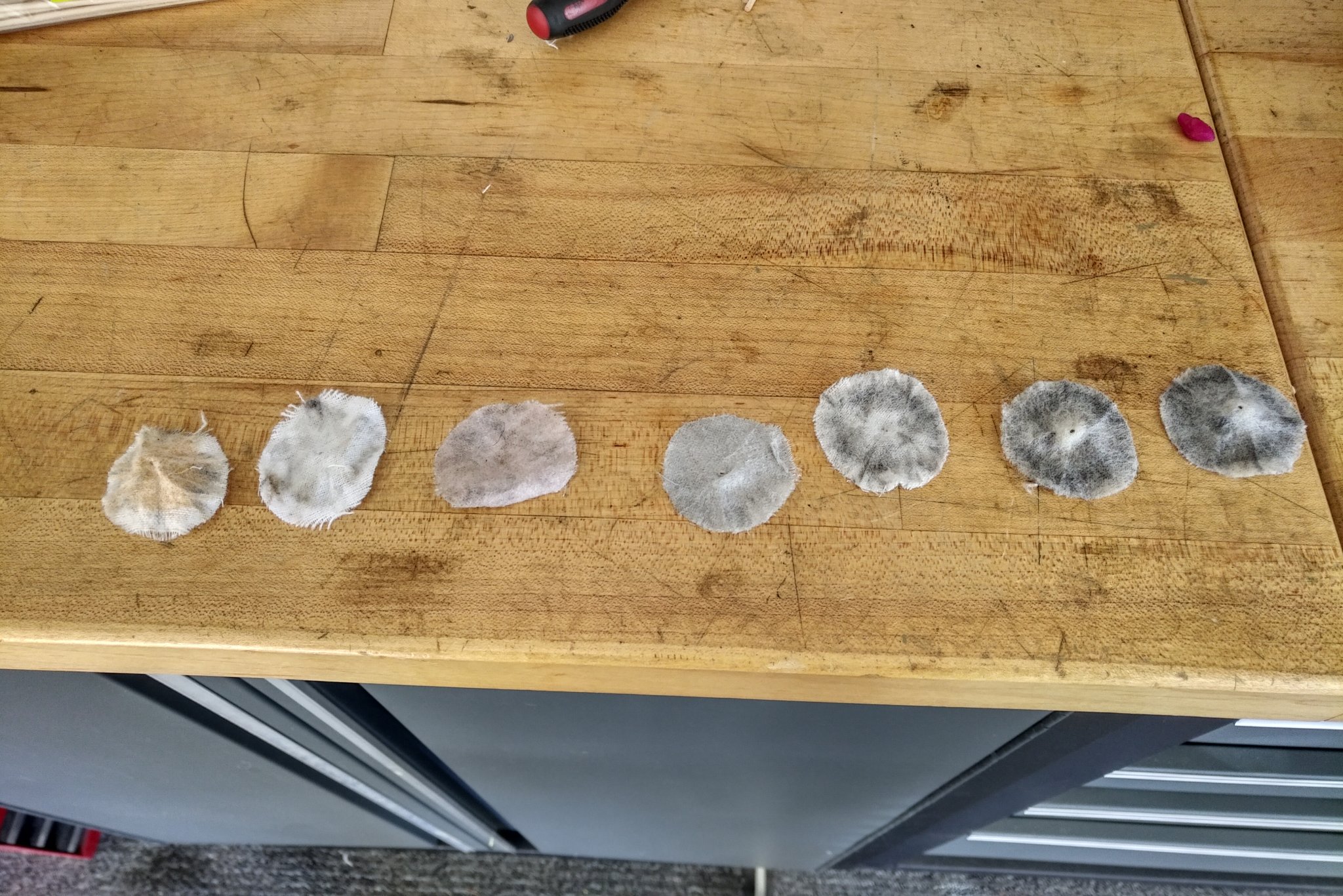

Total unexpected consequence of a Proof Barrel....
After firing 20 rounds the other day, after the warranty-recommended break in process. Here are the cleaning patches:
From right to left: 2 with Hoppe's #9, 2 more to clean that out, 1 with little bit of Kroll, 1 to clean that out, last one with a light bit of Militec-1 before I put her away in the safe.
So, 6 to clean it, 1 to throw some oil up in it.
The factory barrel would have had all kinds of blue copper fouling on the Hoppe's patches, tons of carbon, etc...

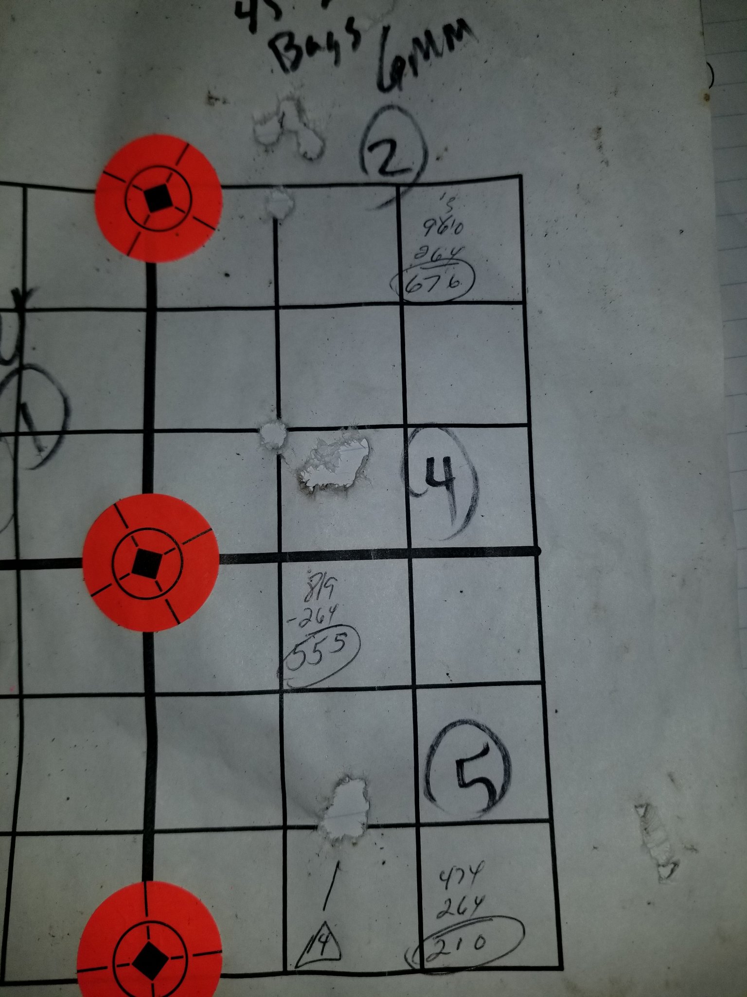

Nailing down a load. The Sierra's group better than the Hornady. The bottom two groups consist of H4350 with 39.0 and 40.5 respectively. .614" and .314" respectively. The lower left is a tight group and the one out of the group was my fourth shot I would call a choke. May go with this load to save barrel life. Again no chrony this day. No concerned with speed just accuracy. next step depth test with Sierra 107 and 39.0 gr h4350
Sierra groups better for me than anything else I’ve tried even if it was same design and weight

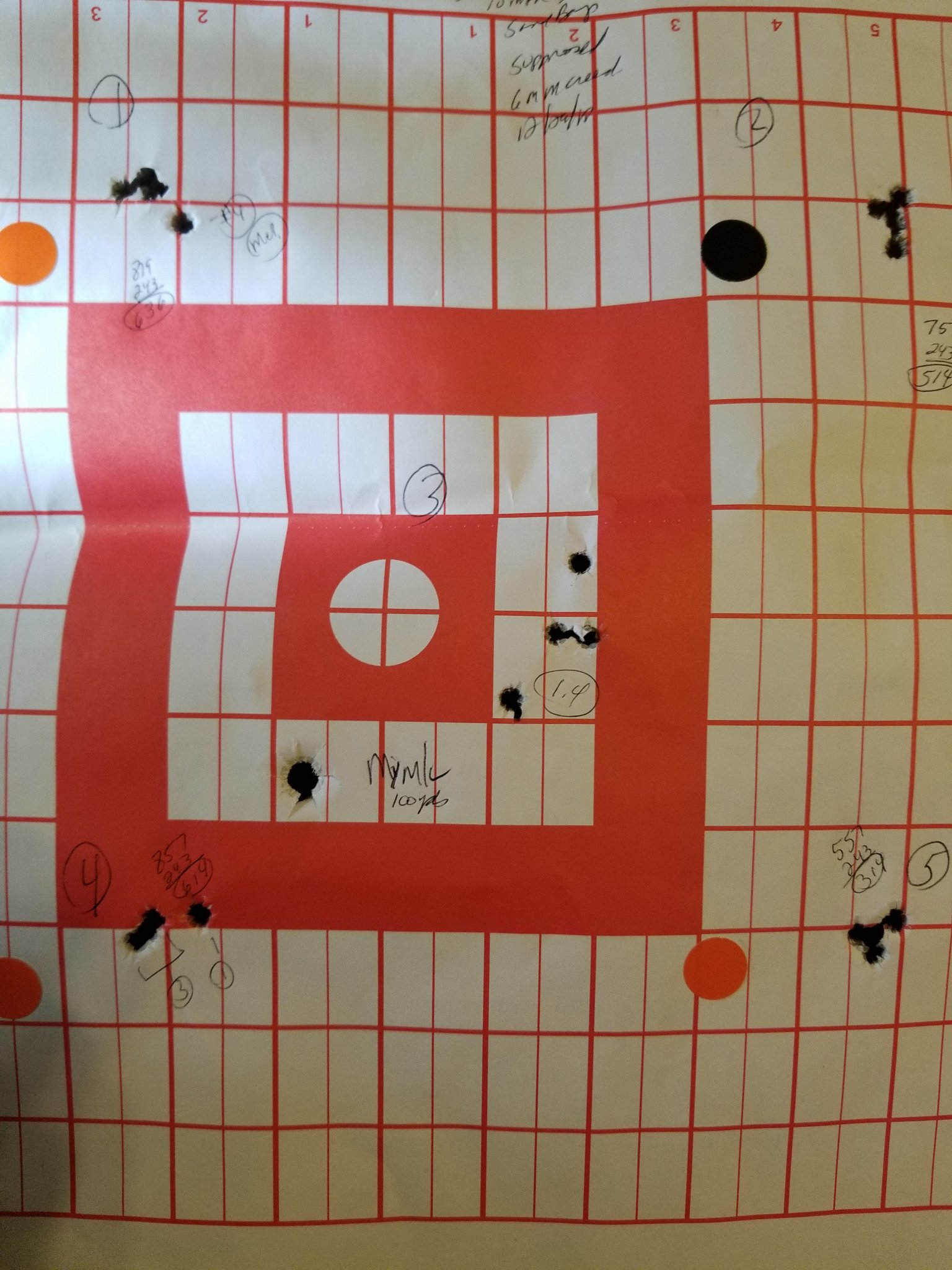

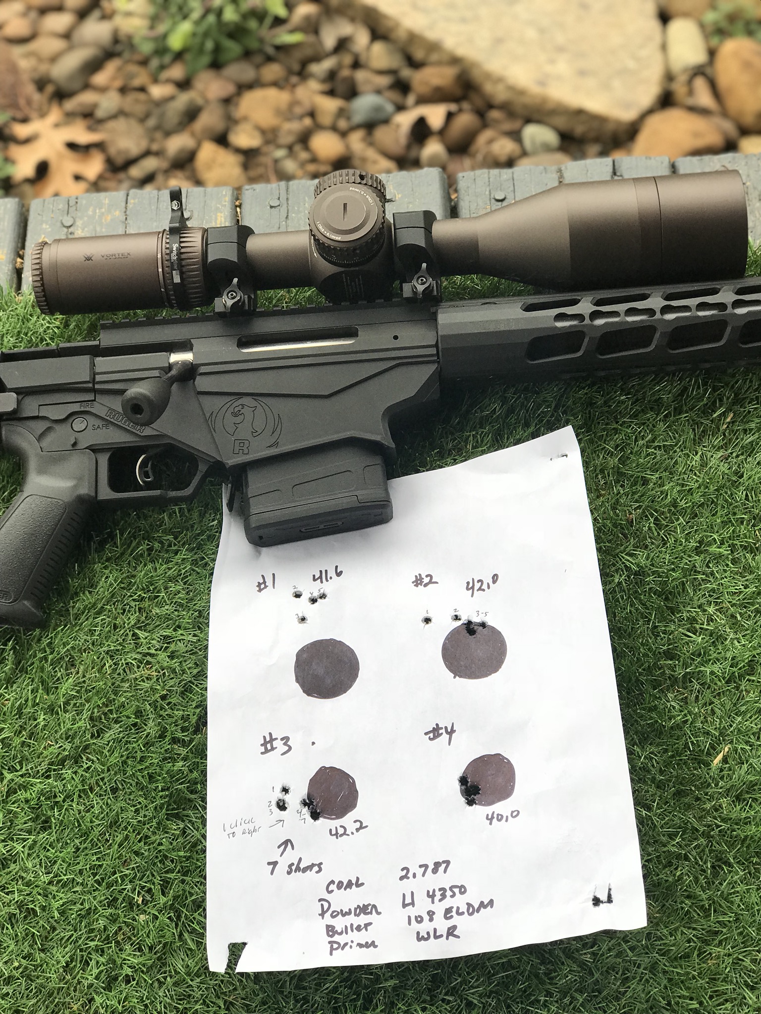

Today was my first load work up session for my RPR 6 Creedmoor.
I have scoured the loads others have had the best results. Used that data to start. Also looked at Hornady data too.
Note these are the first rounds through this rifle with H4350.
First five rounds were fired through the rifle using 41.6 IMR 4831. Group was very good.
I’m not sure if the barrel is settling down as I progress through the loads or if the loads themselves are rising to the top.
I put the COAL, bullet, powder and primer on the target.
I cleaned the barrel in between the loads with the exception of load #4.
Hornady Brass was new. I prepped the case mouth and nothing more.
I will put the loads through a chronograph in the next couple of days.
That is pretty sweet that 40.0 and 42.2 give the exact impact location. Is that approx. 0.5 MOA for 5 shots right out of the box? My 6 CM arrives in 2 days:)

Brent and netman. Gotta try the load components I show above. H4350 and Sierra 107. I tried the hor108 and gave a load shooting in the .6s but the Sierra's basically cut that in half before a depth test. Worked this combo up across 3 gr using 0.5 gr increments and the Poi is virtually identical. I have never experienced this before. The poi was within 1" across that testing
10ring I grabbed three boxes of the Hornady 108 just to get started. I really like the Sierra bullets for steel targets. My plan is to grab up some of the SMK 107’s soon and have them worked up before my first match the end of January.

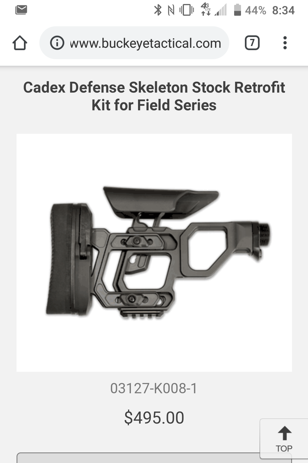

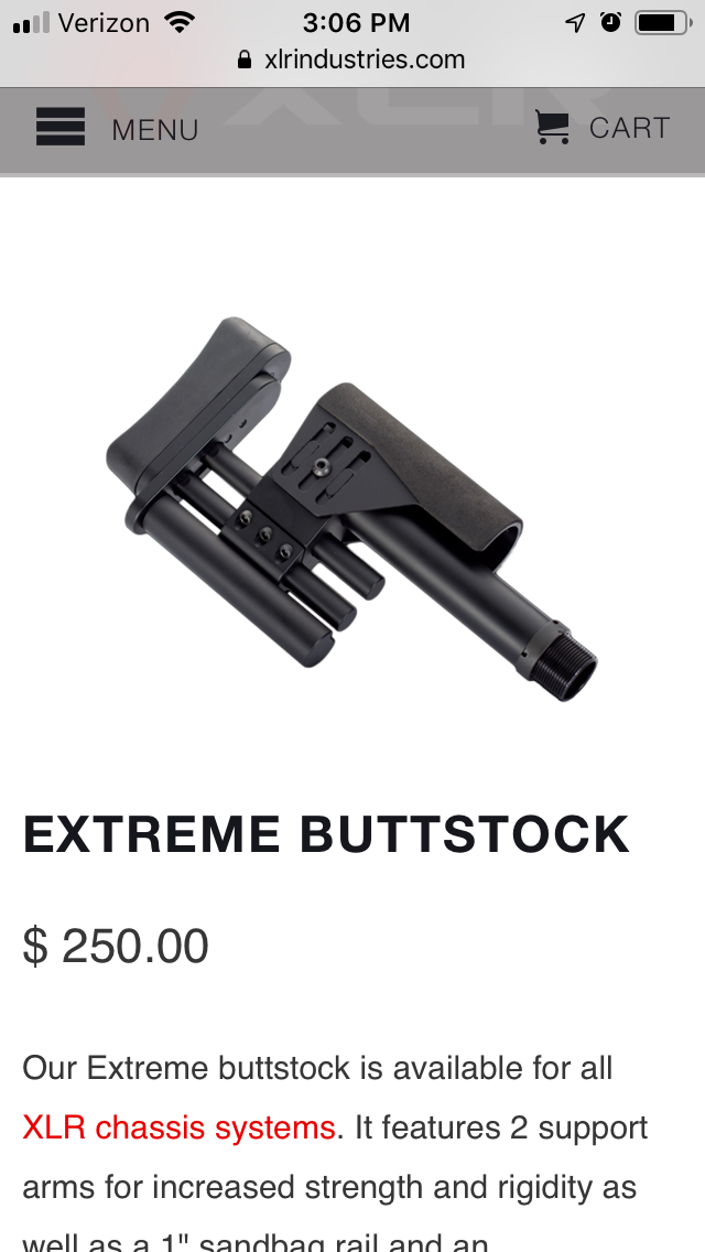

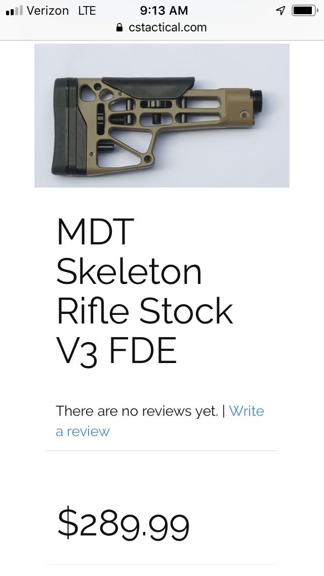

That MDT looks cool! And the price is much better than the Cadex, very close to a PRS gen 3 stock.
I am wondering whether MDT skeleton stock V5 works the same? Need an adapter?
Ruger should really change their design with that stock.
^ Thats badass. I like the MDT as well except you have to buy the bottom rail attachment separate
