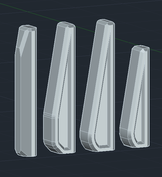

After some suggestions on RPR Bag Riders, I added two designs to the Cheapskate Precision lineup. The one on the left is the original design. The middle one is similar, but I rounded off the sharp angle on the bottom. The right one is a thicker option for a flat bag rider. There is also the low profile flat bag rider I designed earlier (not pictured). What do you guys think?
After some suggestions on RPR Bag Riders, I added two designs to the lineup. The one on the left is the original design. The middle one is similar, but I rounded off the sharp angle on the bottom. The right one is a thicker option for a flat bag rider. There is also the low profile flat bag rider I designed earlier (not pictured). What do you guys think?
DOOD! A+ and well done. If I run into anyone asking about my bag rider sending them to you. Rick's Ruger Riders!

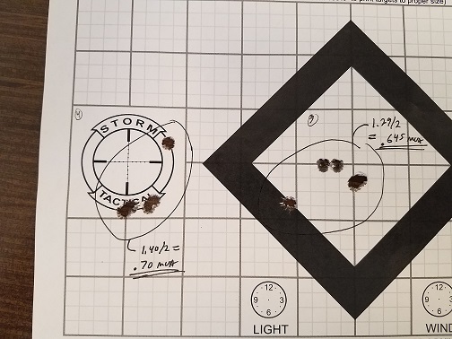

As I mentioned ^^, here are my results from yesterday out on the 200 yd range (most I can get to without driving out to the West Virginia PNTC range - I would like to get out there eventually). I shot twelve 5-round groups, with an average of .872 MOA once you converted the group size down.
The first group was the best for the day (.625 MOA) and were to get on target. Used the BallisticsARC app, and it had me at .4 MIL elevation to get there. Based on the group, went .1 MIL back down, and .2 MIL to the left, that's where the .8 MOA group went. Brought it back .1 MIL right, and didn't change the scope for the rest of the shooting.
6.5CM, using Hornady 140gr. ELD-M. Gun really seems to like the cartridges. Now has 220 rounds through the barrel.
This thing is a beast. I can honestly attest that all of the above 1 MOA groups I shot were totally the shooter's (my) fault. This was only my third time at the range, and I can consistently shoot at or below 1 MOA, even out to 200 yards. That can almost all be attributed to the gun/scope/system, and not the shooter!! The RPR makes precision shooting almost look easy. ;)

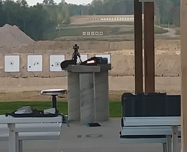

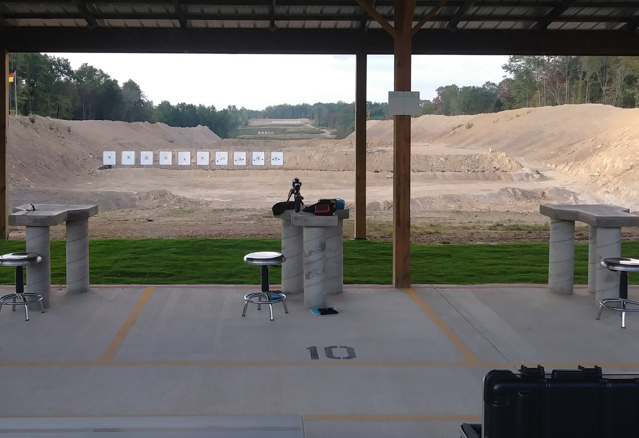

This is my home range Dead Zero Spencer TN
This is the rifle portion of the range. It's brand new and uses the Shot Marker electronic target system the target frames in the pic are at 100, 600 and 1000 yards. The only draw back is the the round has to be supersonic for the sensors to pick it up. But it will give you shot placement, group size and the velocity the round was traveling as it passed through the frame.
  • Wow

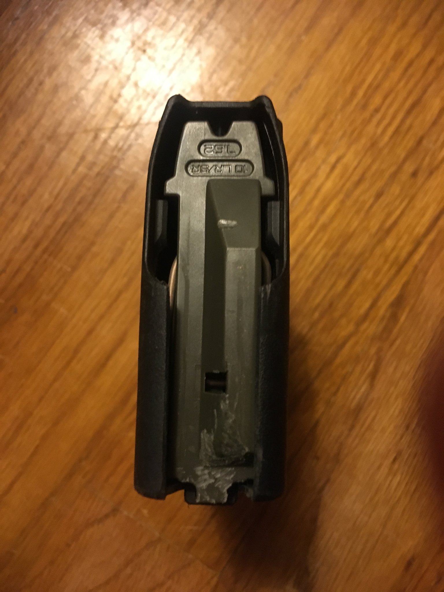

Could a PMAG follower be sacrificed to eliminate the last round hold open?

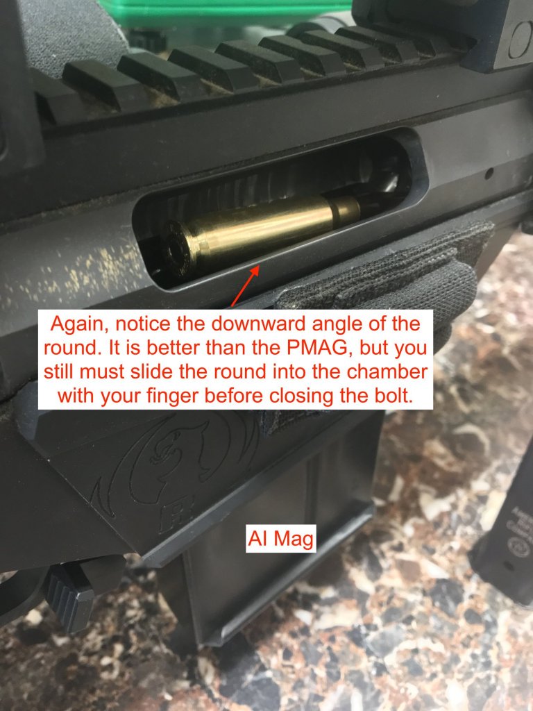

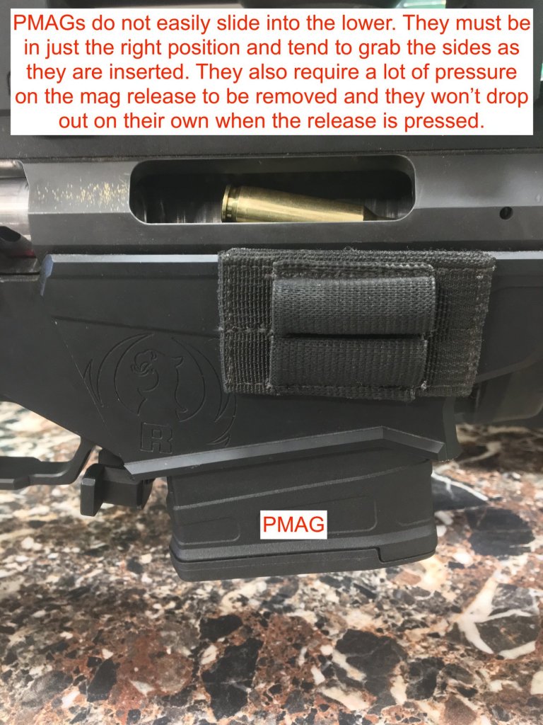

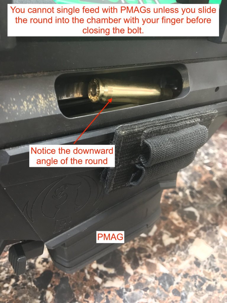

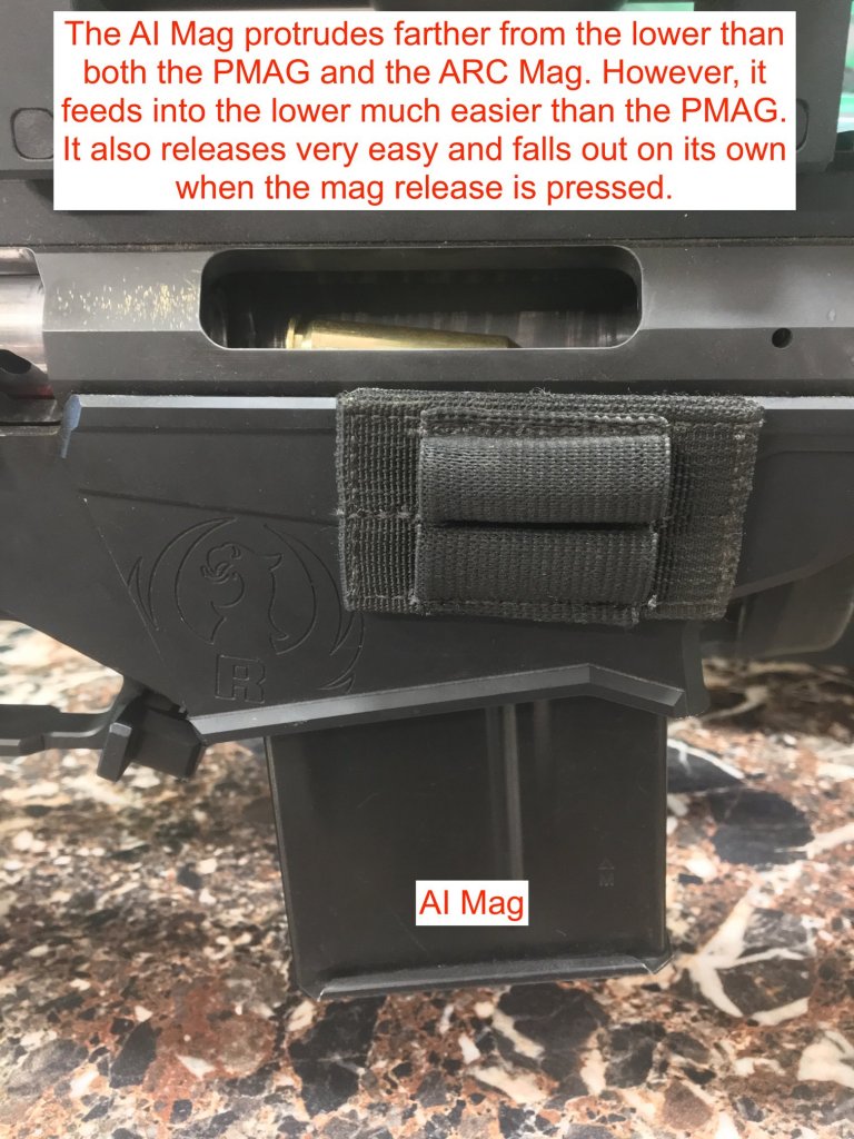

I actually did a write up about this issue on Facebook a while back. The PMAGS are terrible for top loading. It is possible, but you have to make sure the round is tip-up and then close it really fast so it doesn't nose dive. That's one of the reasons I didn't want to use the PMAGS anymore. I tried some AICS mags as well and had problems top loading those too. I finally found a solution with the ARC mag. They are perfect for top loading as they keep the tip of the bullet up all the time, preventing it from nose diving. Here's a link to the write up I did (it has some pictures to describe what I'm talking about):
https://www.facebook.com/groups/1615893251996077/permalink/2035312010054197/
Or just search "Thought I would do a little mag comparison" in the search bar on "The Ruger Precision Rifle" Facebook page.

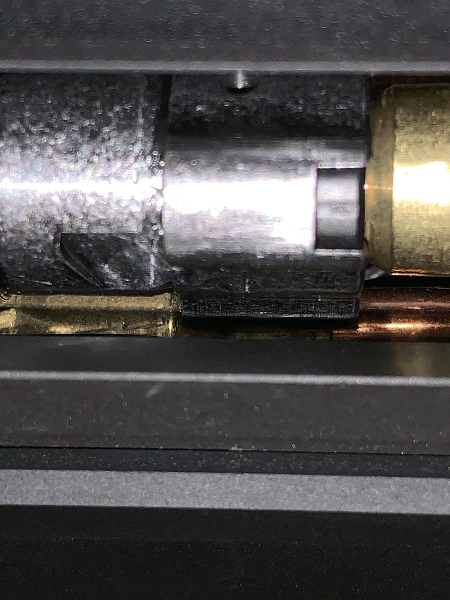

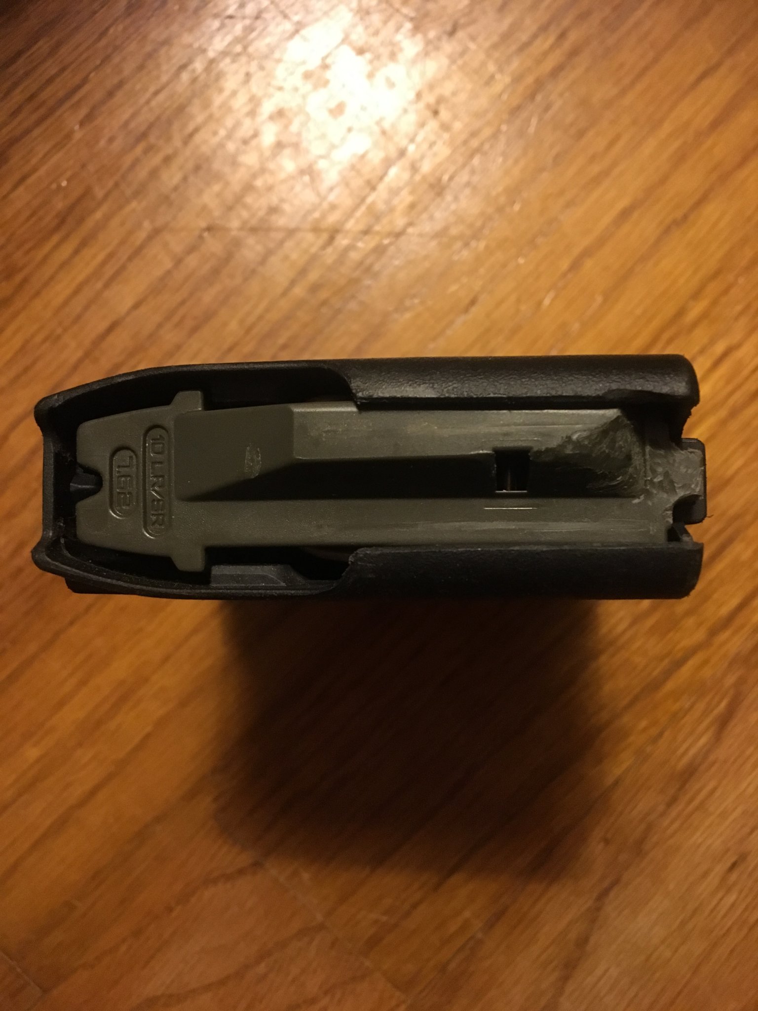

Yes. Like Blitzy said, take a file or dremel to this corner here and you’ll have no more last round hold open. I’ve done this to all of my mags

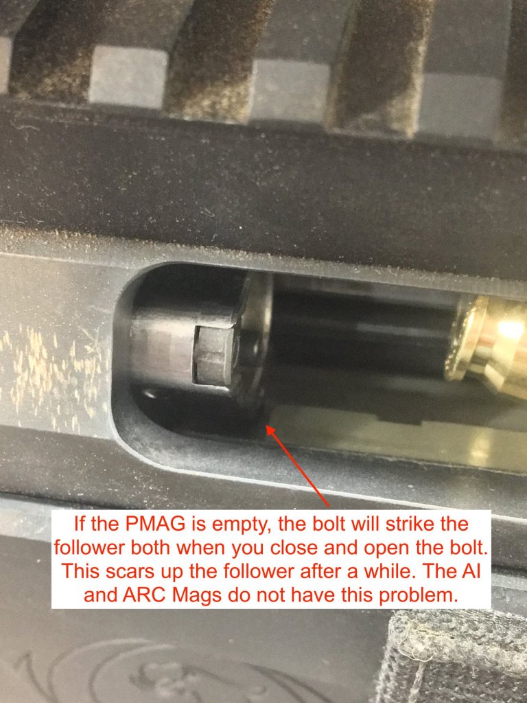

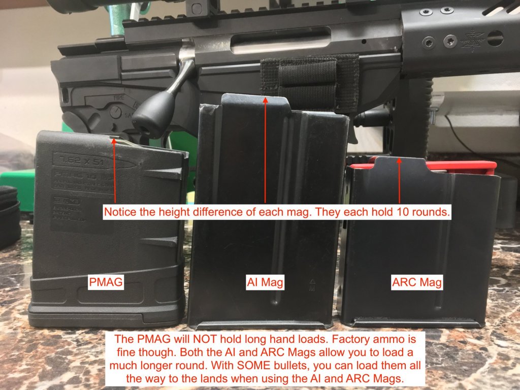

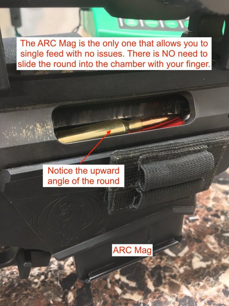

Here's a copy of the write up I was talking about:
"Thought I would do a little mag comparison for anyone wanting to know what some of the other mag options are and how they compare.
The P MAGS that come with the rifle are nice if you are shooting factory ammo. They will not hold some of the longer hand loads, which was an issue for me. The P Mags are very easy to load and are fairly compact. However, they do not slide into/out of the lower as easily as other styles of mags. They mag release has to be pressed a little harder and further to drop a P Mag than with other mags. If you attempt to cycle the bolt with an empty P Mag, the bolt hits the follower in the mag and roughs it up. Top loading with a P Mag is very difficult. You have to slide the round into the camber with your finger before you can close the bolt.
AI STYLE MAGS hold longer rounds than the P Mags do, which is why I bought one. Unfortunately the mags are quite a bit longer than the P Mags and the ARC mags. They are a little harder to load than a P Mag. These mags slide into/out of the lower very easily. The mag release does not have to be pressed very hard to release these mags and they drop out on their own which is nice. The AI Mag has the same issue with top loading as the P Mag. You have to slide the round into the chamber with your finger before closing the bolt.
ARC MAGS are my personal favorite. They are short like the P Mag and hold longer hand loads. The ARC mag slides into/out of the lower very easily as well and releases easily with the mag release. These are the only mags that I have been able to successfully top load with. you can drop the round and top of the mag and close the bolt without any jamming or other issues. You can also buy a 4-round mag extender for these that makes them as long as the AI mags, but they hold 14 rounds, which can come in very handy on 12+ round stages if you don't want to do a mag change or top load.
I also purchased one of the polymer AI style mags from Ruger but I sent it back when I realized it wouldn't hold long hand loads.
All in all, ARC mags are the best all around mag in my opinion. Obviously everyone is entitled to the own opinion, but I hope this helps.

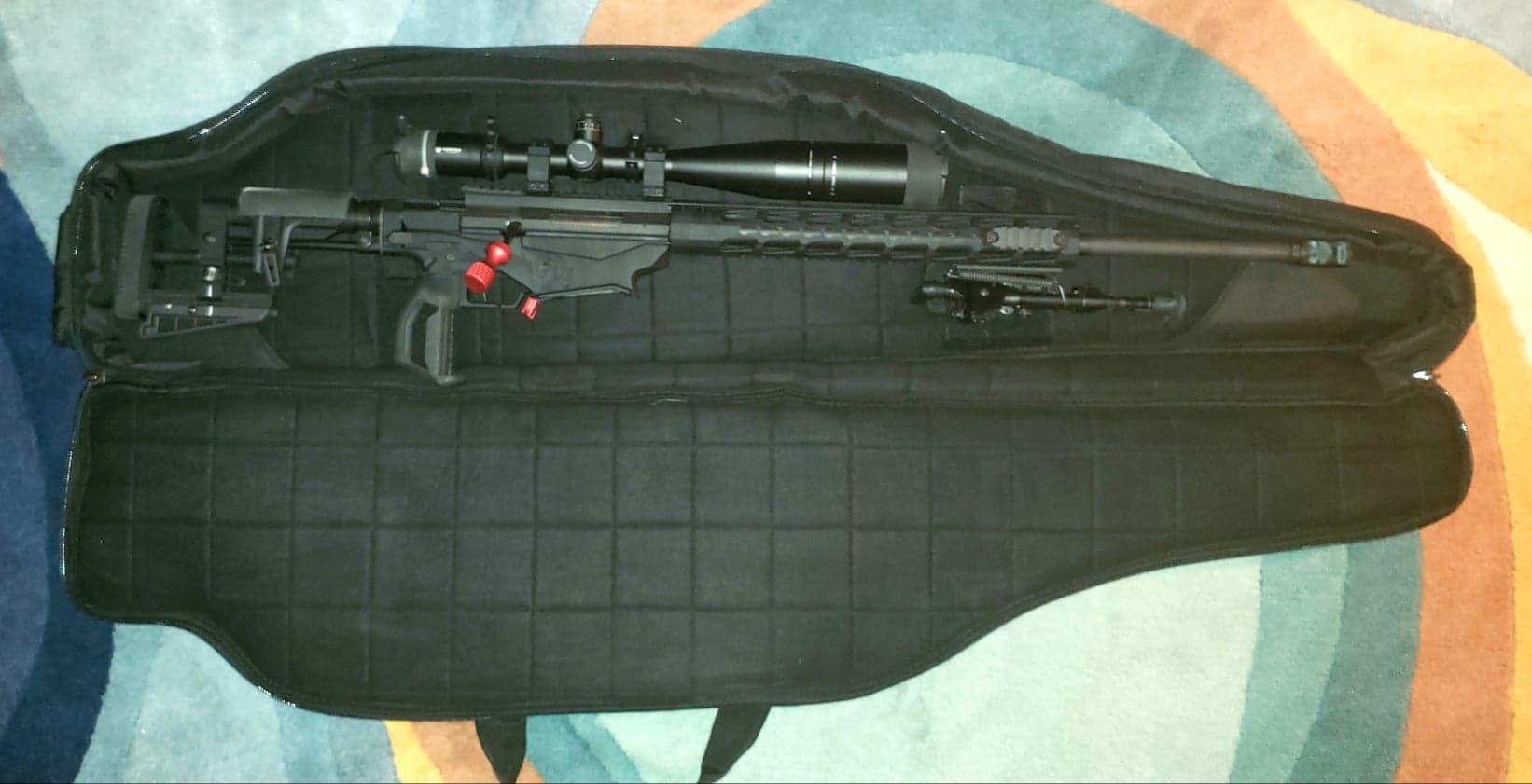

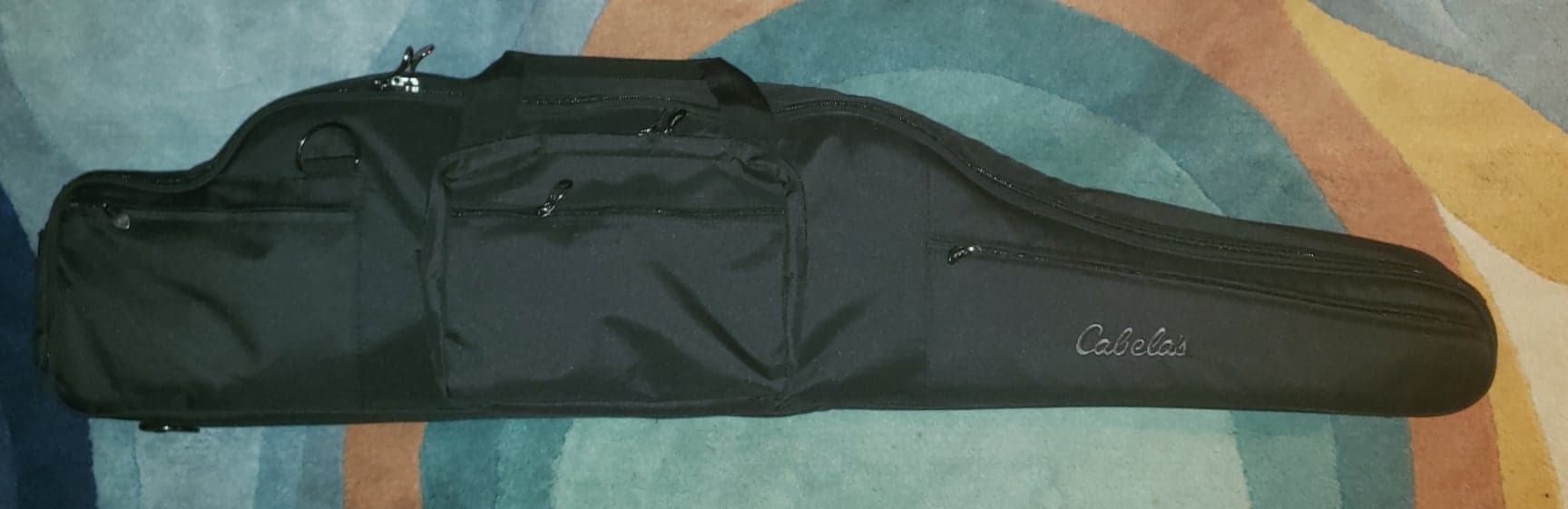

For anyone who has an interest in a soft case which doesn't require any break down at the range I have had this Cabelas for awhile now and I love it. RPR 6.5 with 24" barrel and have an 8" can on the end and it closes just perfectly, no stress on case or zippers and I can easily leave the bolt in. Conversely if you feel some need to fold it or have a can longer than 8" the case will accommodate the RPR folded as well with bolt in. Sturdy zippers too.
Got my case and "tried it on." The RPR fits perfectly with room to spare. No stress as 8pointer said. Zippers, which ARE robust (also as 8pointer pointed out) were easy to close around the rifle, even with the bolt in the closed position.
For $70, I think it's a good deal.

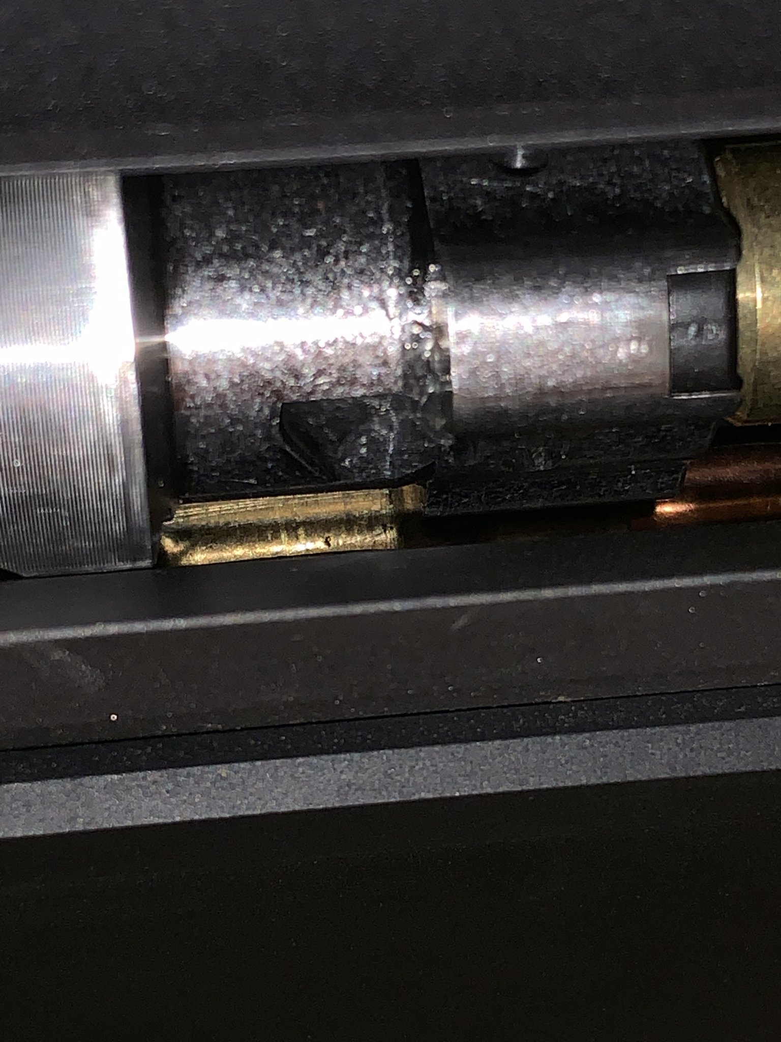

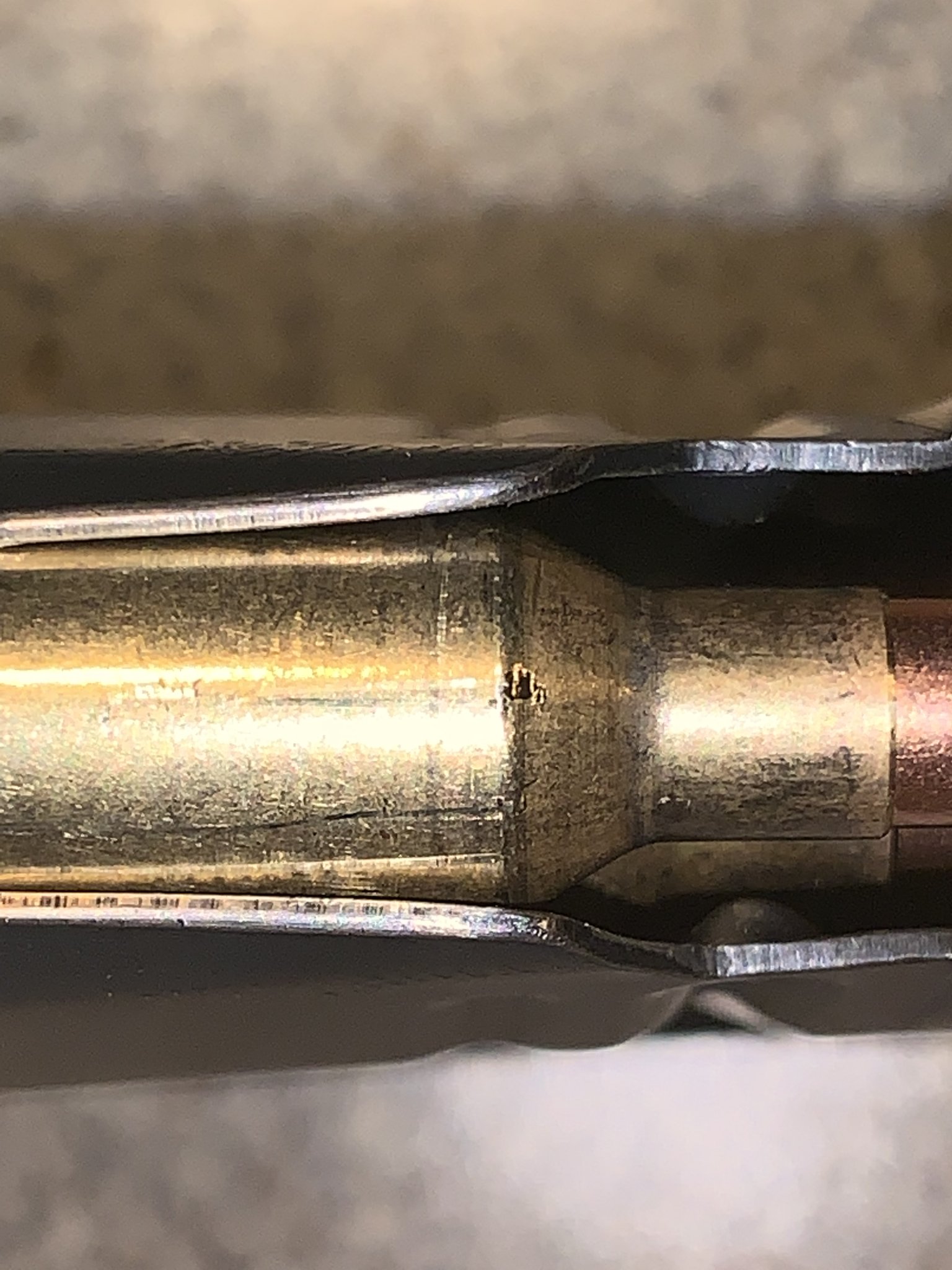

question: why does the RPR 6.5 CM not like an AICS center feed mag? My problem is the 3 lug bolt. It the back of the lug catches the crest of the shoulder of my cartridge when extracting the spent round. The mag below is an MDT AICS mag. You have to be very forceful to get it past the shoulder.
