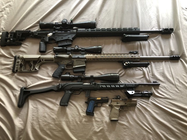

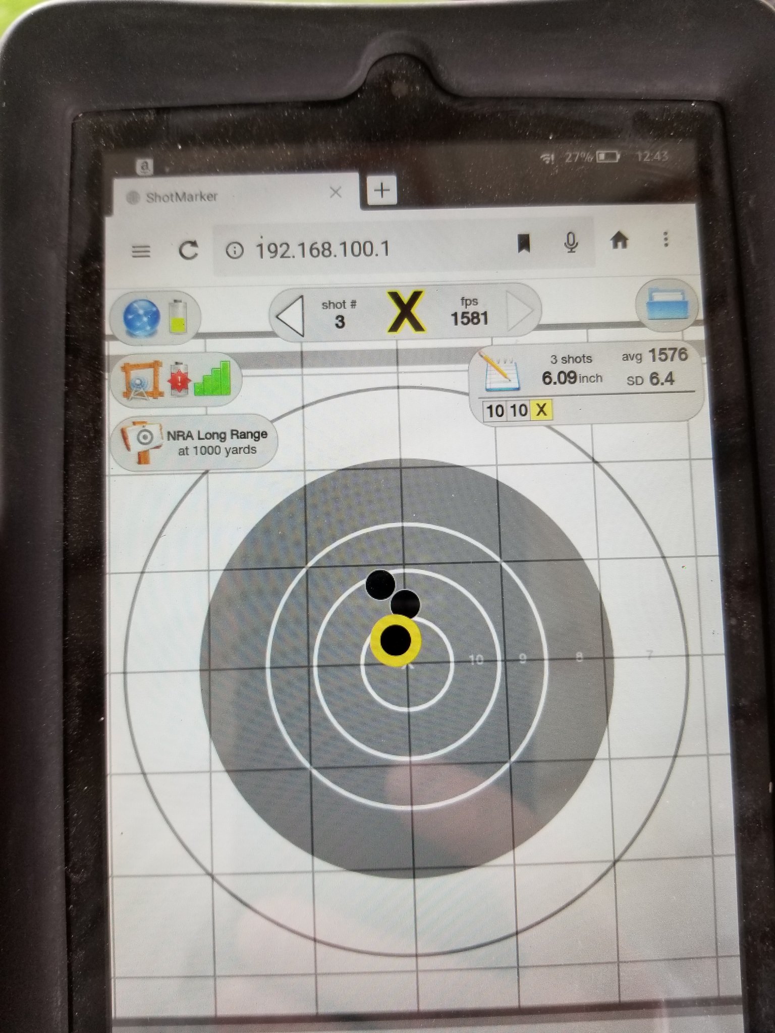

Here is mine in 6.5 Creedmoor a few weeks ago just getting warmed up at 1000 yards. The hole at the top of the group was the cold bore shot. .58 MOA with the first 3 shots of the day at 1000 is pretty good I think.

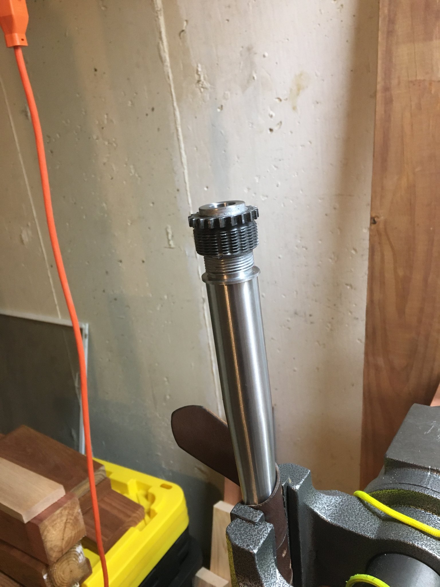

Hey guys, I could use some help with barrel removal.
I ordered a match barrel for my RPR magnum a few months back, going from the stock 338LM chambering to an Ackley Improved version. Anyway, it should be showing up here in few days so tonight I figured I would attempt removing the stock barrel. Unfortunately, this did not get off to a good start, as I was not even able to remove the handguard nut. This is the part below circled in red. If I understand correctly, this nut threads into the thermal bushing, and once removed the thermal bushing slides off, revealing the barrel nut. Is my understanding of this correct, or am I missing something? When trying to remove this handguard nut I was using channel locks with a rag wrapped around the nut (I know, I know..). Is there a trick to doing this, or do I simply need more leverage (and a proper wrench)?
I’m not familiar with the magnum version so take all this with a grain of salt. The barrel nuts are always waaaaaaaaaaaaay over torqued at the factory. Channel locks and a rag aren’t gonna cut it. As it happens I’m in the process of reassembling my rifle seen 2 posts up. I was looking at action wrenches and came across a product from anarchy that I use in my AR’s. It’s For all intent and purpose a reaction rod. This is what you need to support your action while removing the barrel nut and installing your new barrel.
now for your specific problem, find the right size wrench and some good leverage. Also, heat isn’t a bad idea either

Okay I got the handguard nut and thermal bushing off and then moved on to the barrel nut. It appears that a standard armorers wrench is not able to even reach the barrel nut as it can’t slide over the first portion of the nut. Anyone else have trouble with this? I can post pictures tomorrow to clarify.
I had no problem using a standard armored wrench LRI does make a tool that will help though if you can’t make it work.
I have seen the LRI tool and will likely purchase that if I can’t figure something else out.

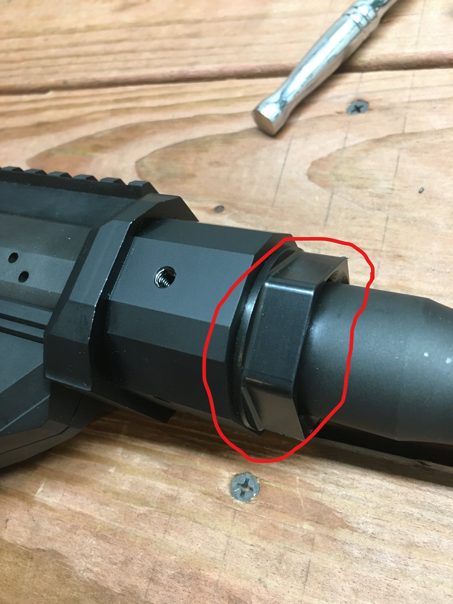

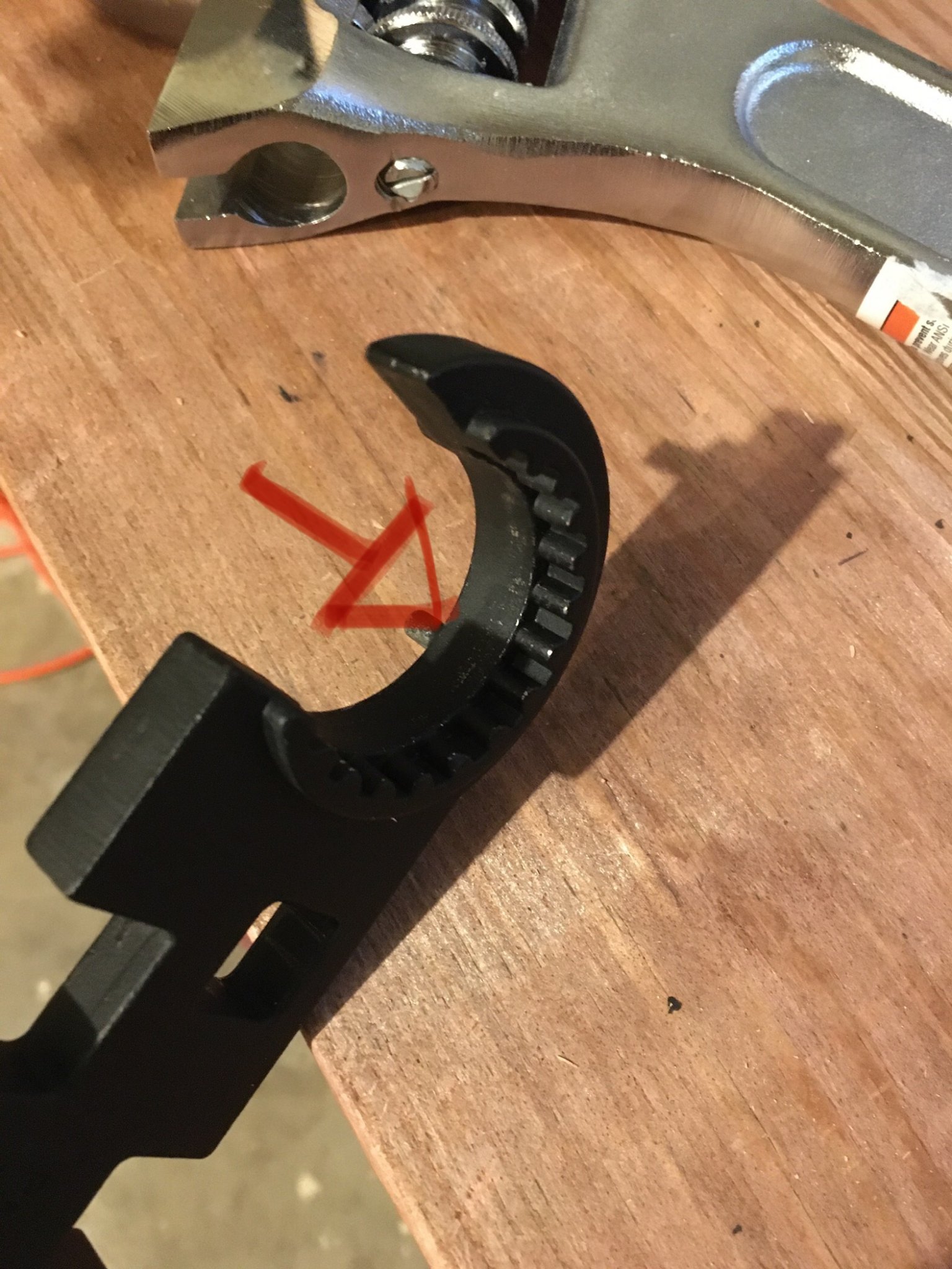

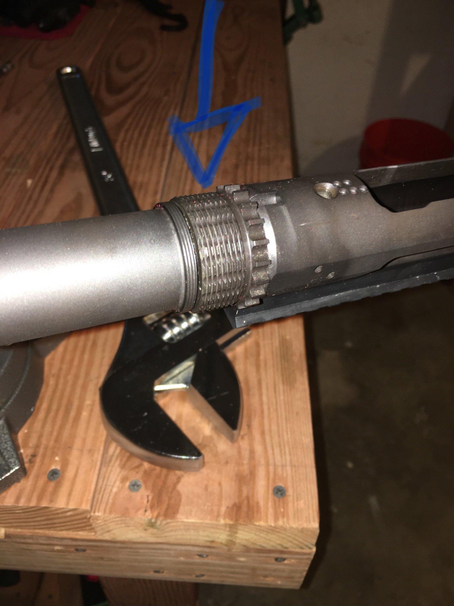

Here are a few pictures to clarify. In the image of the action and barrel, the blue arrow is pointing at the external threads that the handguard nut attaches to. This is what does not allow me to get my standard armorers wrench into the barrel nut. In the other image, the red arrow is pointing towards the flat part behind the splines (not sure that’s the correct term). This is the part not able to slide over the external threads.
Any thoughts?
Any thoughts?
Is this a magnum?
As far as the barrel nut goes, use some heat. A small propane bottle will be a big help. Heat a little and keep it moving. Only heat the nut. I would think less than 30 seconds.
Invest in some rubber vice jaw covers with V grove and a large adjustable wrench. With heat it will come off easier than you expect. It has 75 ft/lbs of torque.

Can anyone confirm for me that a standard AR armorers/barrel nut wrench will not fit onto the RPR magnum barrel nut? I would like to be sure I'm not missing something before spending money on the LRI wrench.
I have seen the action rods as well and purchase if vise blocks are not sufficient.
The shank on the magnum is 1/4” larger than the short action. An ar15 armor tool isn’t going to work.

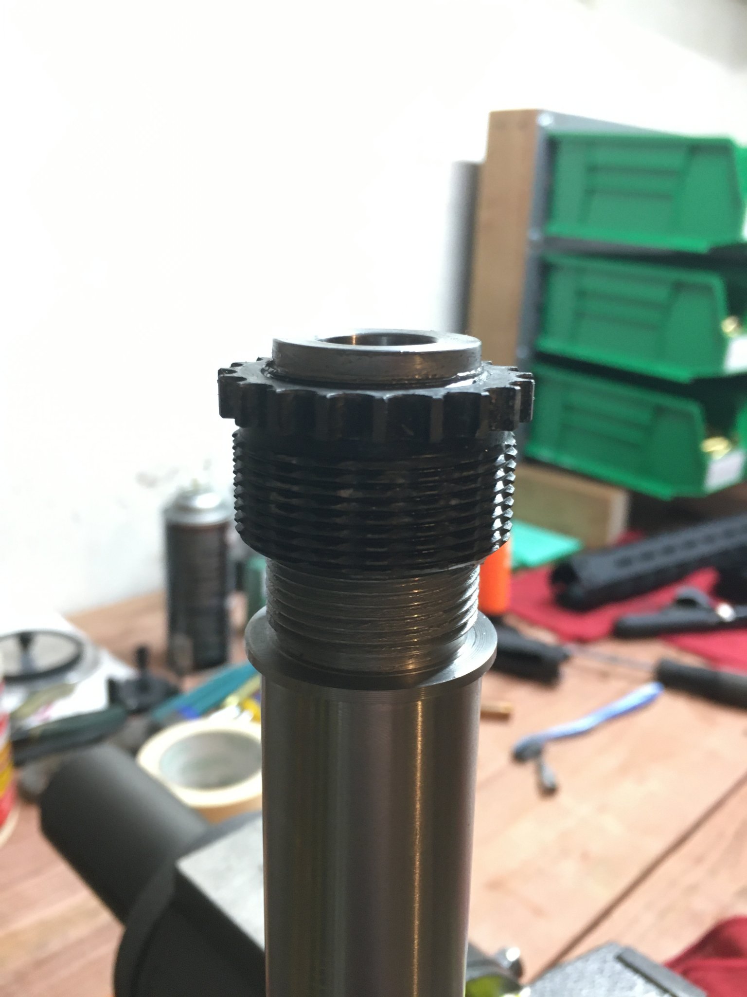

I apoligize in advance for the long post, but I need help and wanted to give as much detail as possible.
Okay so both my barrel and my LRI magnum action wrench showed up earlier this week. I WAS able to remove the stock barrel. It took about 3 hours, a vise, 36" breaker bar, some heat and an impact wrench, but I got it off the rifle. My problem now is that I am not able to thread the barrel nut onto the new barrel OR thread the new barrel into the receiver. When trying to thread the barrel nut onto the new barrel, it seemed to turn freely for about 1 revolution, and then I felt friction and could not turn anymore... I put the LRI tool onto the nut and tried to continue turning by hand.. was able to go about another half turn.. then friction again. I put my 36 INCH BREAKER BAR onto the LRI tool and made it several more revolutions, but then.. so much friction that the barrel began to spin in my vise. At this point I stopped (probably should have sooner), and removed the barrel nut from the new barrel. This required the use of the breaker bar to do.
Then I got the idea to try threading the new barrel into the receiver without the barrel nut, just to see if it would work. Same thing happened again.. made it about half a turn, then friction. I wrapped a rag around the receiver and put my whole body into turning it onto the barrel.. no go. I then removed the new barrel and stopped for the night.
Does anyone know what would cause this? My only two thoughts are that the new barrel is either threaded incorrectly (which I find hard to believe), or that the threads on the barrel nut and receiver yielded and were permanently "bent" from the amount of torque used to put the factory barrel on (also find hard to believe as they are different materials which would leave one set of threads to yield significantly before the other ). Any help would be appreciated with this problem. I am running out of patience trying to rebarrel this rifle.

Did you inspect the threads in the receiver and the threads on the barrel you removed? If so, what did you see? How did you clean the threads?
Pictures would help.
Here’s a few of the pictures I took. I can take more tomorrow, just let me know specifically what you would like to see.
Also, I did visually inspect the threads on the receiver, the barrel nut and both of the barrels. I’ve seen my fair share of messed up threads, but nothing about these ones jumped out at me.
Also, I did visually inspecte the threads on the receiver, the barrel nut and both of the barrels. I’ve seen mare fair share of messed up threads, but nothing about these ones jumped out at me.
What did you use to clean the threads? I assume you removed ALL the gunk from the receiver's threads?
What anti-seize grease did you put on the threads of the new barrel?
Pictures of the threads of the receiver would be good, if possible. (Easy to do if you have a borescope. ;))
PS: I didn't have any such issues when I switched barrels on my RPR, though getting the initial bread on the barrel nut was a little tough. But wen smoothly from there for me. I took me about 30 mins to do the whole job. So, I feel for yah having this big of an issue.
I used a brass brush with some WD40 to scrub the threads. Then some hard parts cleaner and a rag to dissolve and dry off. Next a small amount of Permatex evenly on the threads of the new barrel before attempting to install.
I’ll take some more pictures tomorrow. Thanks for the reply.
EDIT: I just remembered that I am still able to re-install the barrel nut onto the OLD barrel. Thought this might be relevant.
I used a brash brush with some WD40 to scrub the threads. Then some hard parts cleaner and a rag to dissolve and dry off. Next a small amount of Permatex evenly on the threads of the new barrel before attempting to install.
Frankly, it sounds like the threads on the new barrel are off speck and the fact that the barrel nut can be mounted on the old barrel strongly suggests that.
I also agree barrel threads must be tweaked I would check the stock barrel will thread back in receiver if so then it must be defective LRI barrel threads
Stock barrel does indeed thread back in. I took a quick measurement this morning and it appears that the major thread diameter on the new barrel is .006” larger than the factory barrel. Going to call McGowan later and see what’s going on.
