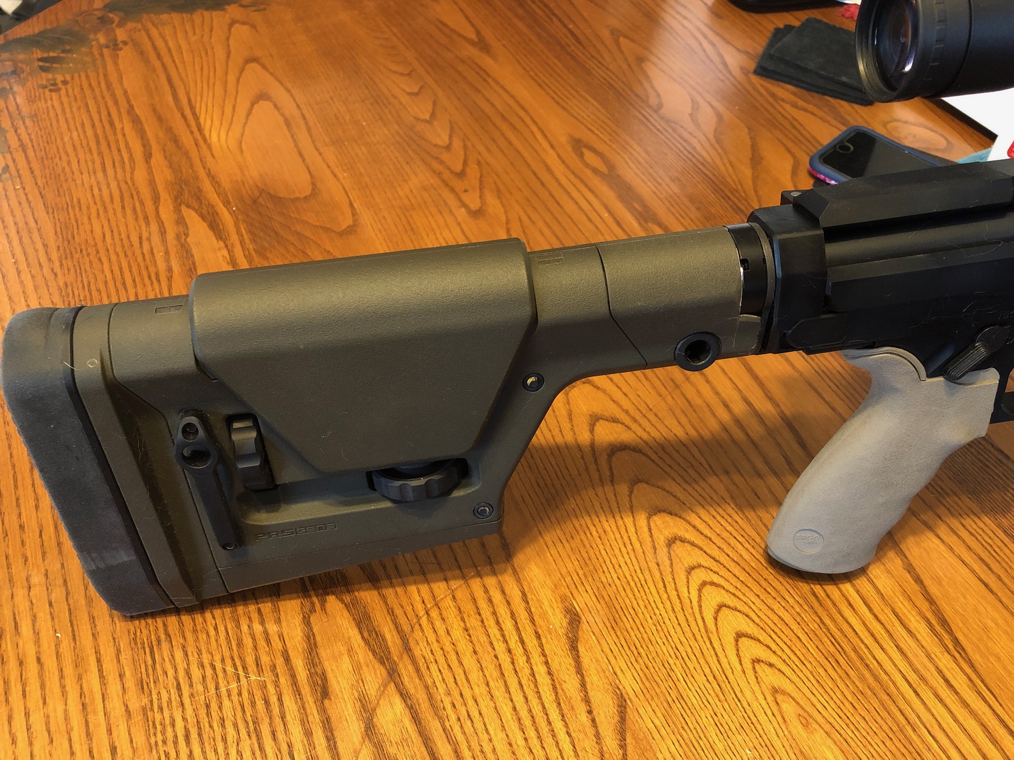

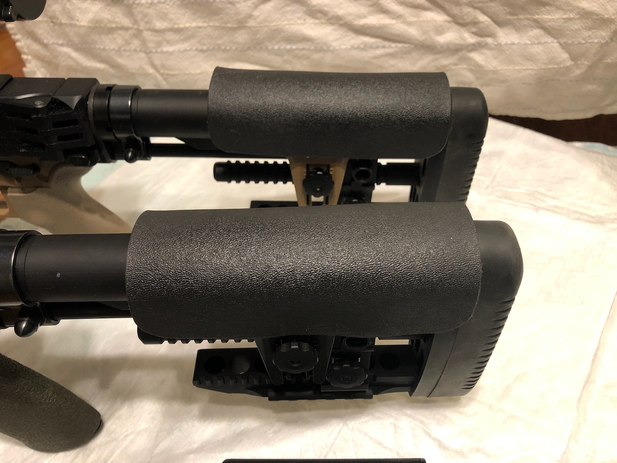

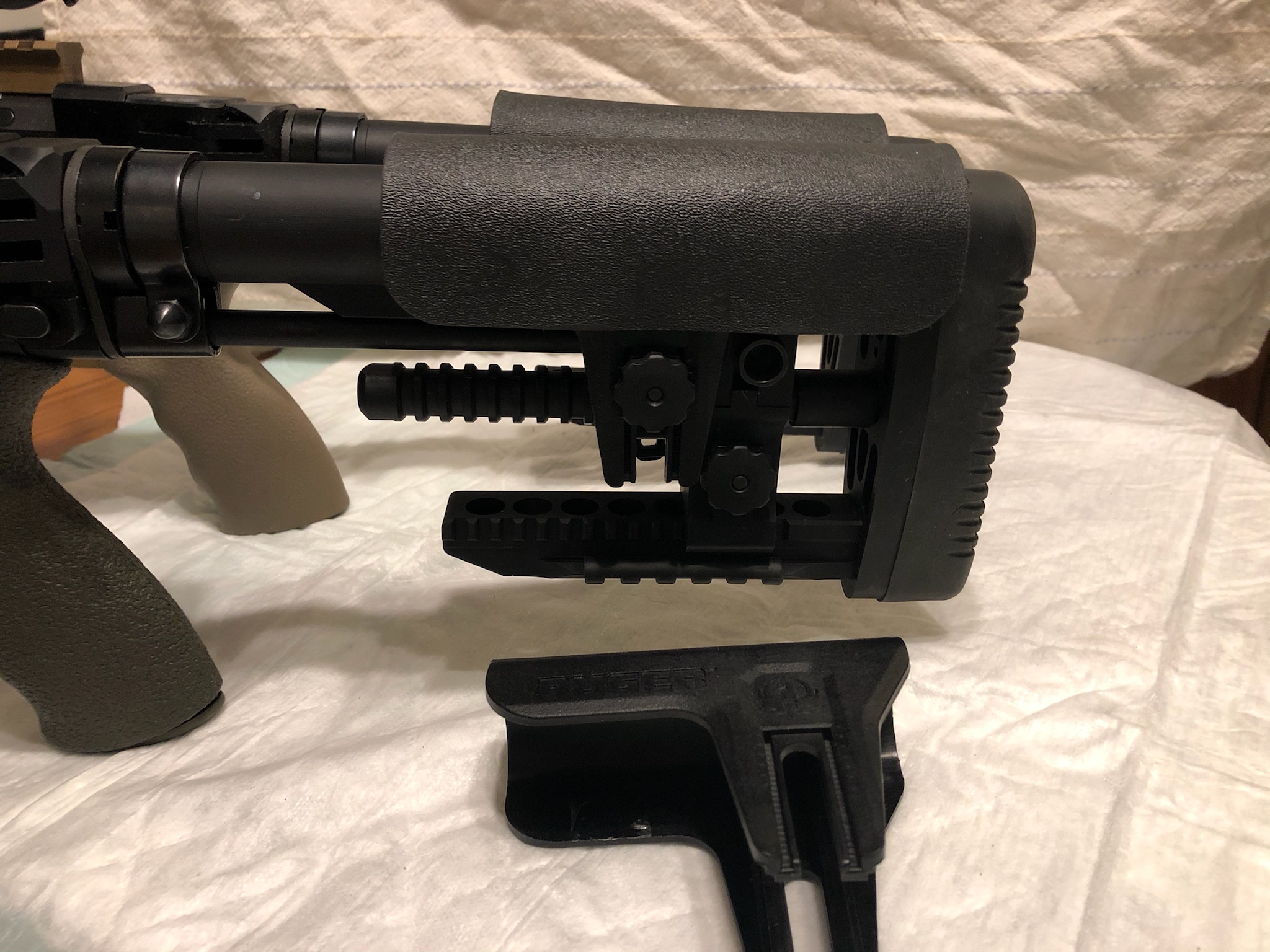

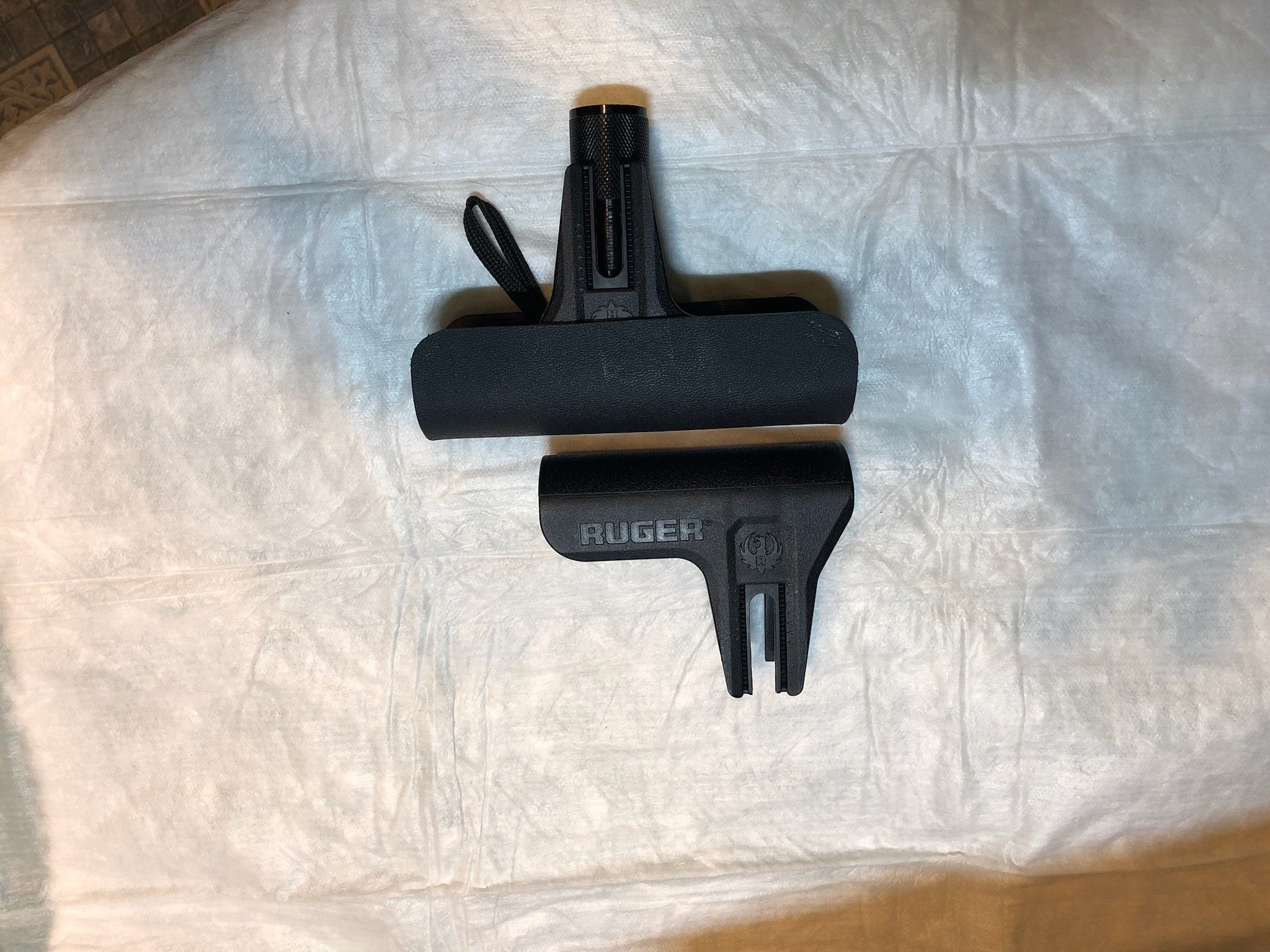

For those of you that are having LOP issues with the Magpul PRS Gen3 stock, you can trim one of the adapters. You can see here where I fitted one to a .300 PRC. It now wears a black one and I painted that adapter black to match.
I found the solution doing internet searches. I did some very careful measuring. Due to the tube bottoming out inside the stock you can only go
so far. A shorter tube (or the end moved towards the receiver) would allow a better fit. Eventually I might try that. Basically you bottom the stock out on the buffer tube, back it off say 1/16" of an inch (or put a 1/16" or whatever) spacer on the end of the tube) then get the measurements that are needed to cut the adapter to.
I used a small Dremel cut off wheel and then filed to fit. Giving some clearance gives you some wiggle room if you are not 100 percent on the adapter. Once I started fitting it, I used a black marker or something so when it touched I could see the high spots to file until I got contact all
around.
I tried to tell Magpul that they could make an adapter for the RPR but "we don't do custom work", "it wasn't invented here" blah blah blah blah blah.
The next project is to make a pattern and cut and mold a better cheekpiece overlay for the 2 other RPR's I have acquired out of Kydex. If it works out I will try and remember to post up a picture of the pattern (with dimensions of course) and the finished project.
around.
I assume you are using a carbine buffer?
The tube that is on the gun, as shipped. So it is carbine length. I simply took the factory stock apart, leaving the tube installed and fitted the Magpul stock. Even though I have longer arms, I am 5'6" tall and my knuckles don't drag the ground. Without this modification, the LOP was too long for me to be comfortable.

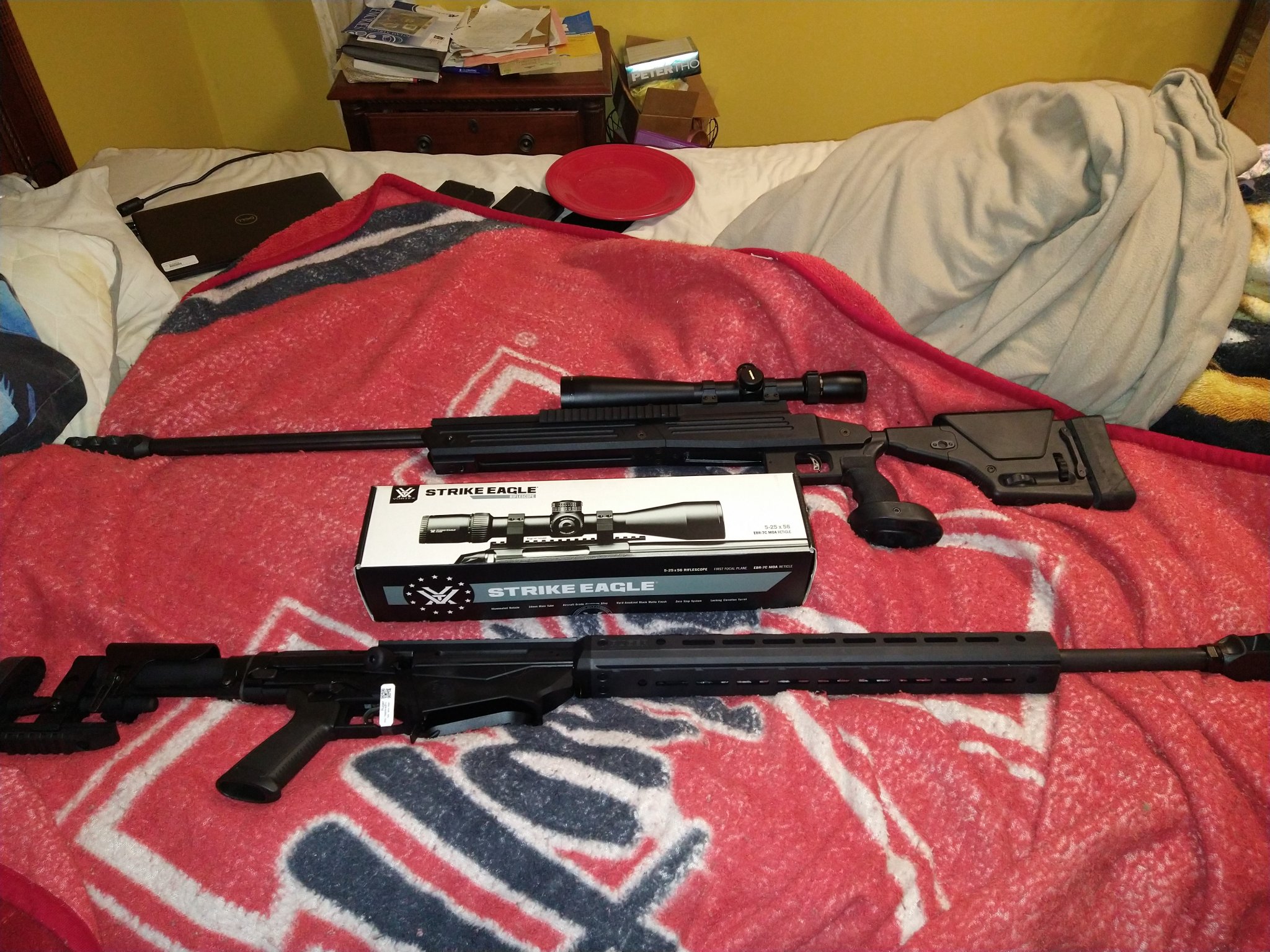

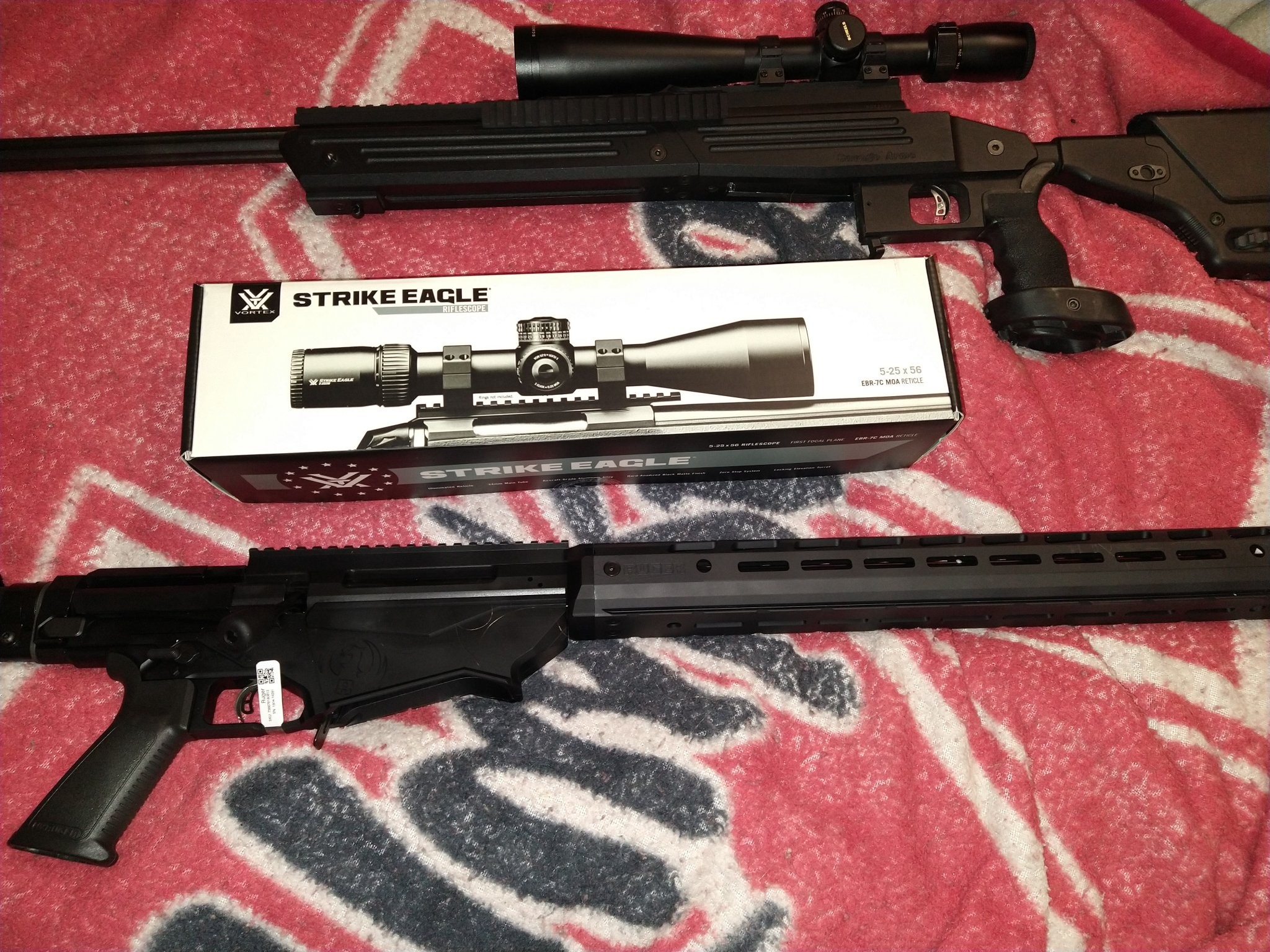

Hello!
Just picked up a RPR in 300 win mag. My wife owns a savage ba110 (pictured) she has had for 12-13 years so we have all the stuff to reload for it already which is why I went with this caliber. I wanted a RPR for 4 years and of course I wait until they go up in price, because I guess when there is a shortage that is when I decide its a priority.
I picked up this vortex scope as it was cheap and 34mm (military discount). I really liked the FFP and the reticle. I have some vortex PMR 1.45 height rings on the way too.
Note: We plink for fun. My reloading is not atomic accurate but it is safe, and I dont shoot a lot. Id say the savage has probably has 600-700 rounds through it in all those years nearly all of those were reloads.
Our range is 600 yards max, and Im not real proficient. I practice with a lot of 150g bullets as I shoot 300bo and 308 as well. I do plan to increase my skills and have picked up some new brass and heavier bullets. Im open to comments on my choices.
Question:
Anyone run a suppressor? I have some NFA items already so I know the process. I think it is a good candidate for a suppressor given how loud the savage is and people comment at the range. Curious if it is effective on this gun and if there are any suggestions. I know a suppressor contradicts "for fun" but really it is practical to reduce the noise. Im thinking a 30 cal supressor I could use on my 300bo, 308, and 300Wm would be ideal if thats possible.

Hello!
Question:

Good luck. Junk. When it happened to mine, the bolt hung up in the action. I got it out. I had fired a round and then when I lifted the bolt handle the firing pin would not re-cock. Once I got the bolt out of it, I couldn't get the shroud off of the bolt. When I got home, I cut the shroud off, re-cocked the firing pin assembly with the tool and put the firing pin assembly back into the bolt. Rifle still drops the firing pin assembly every 30-40 rounds on lift. At least without the shroud you can pull the bolt out and use the tool to re-cock it.
There is some older posts on here and over on the Ruger forum about it.
I extended the cheek piece with some Kydex. The 2nd one worked out better, eventually I will make a good mold and recast the first but it is very usable as is. Extending the length 1 1/4" ish sure changed the feel. We got a little curl on the first one, there was a learning curve for working with the Kydex and heating it with a heat gun.
I wanted to try this before investing in another or 2 Magpul PRS Gen3 stocks. It was a success.
The extension is held on with 2-sided tape.

That is good to know. I have a .300 PRC I have not shot yet and will watch out for it occurring with mine.
