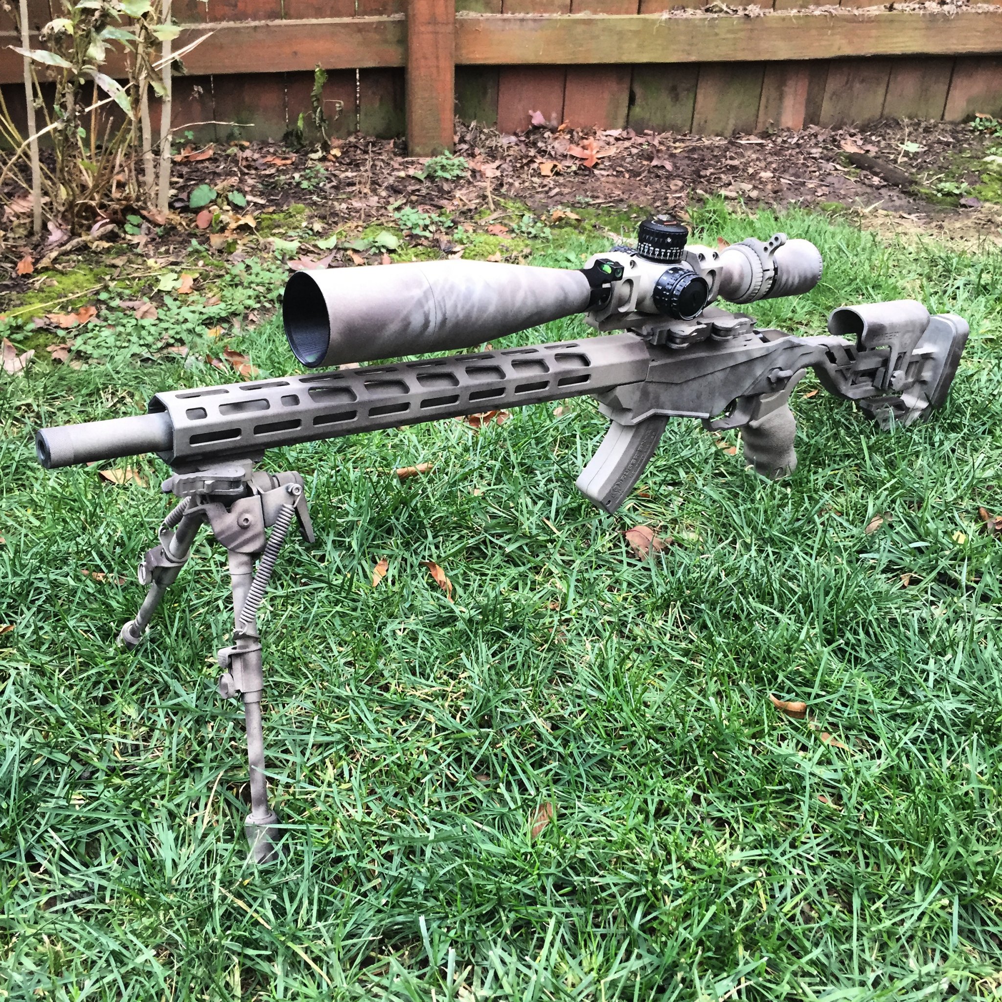

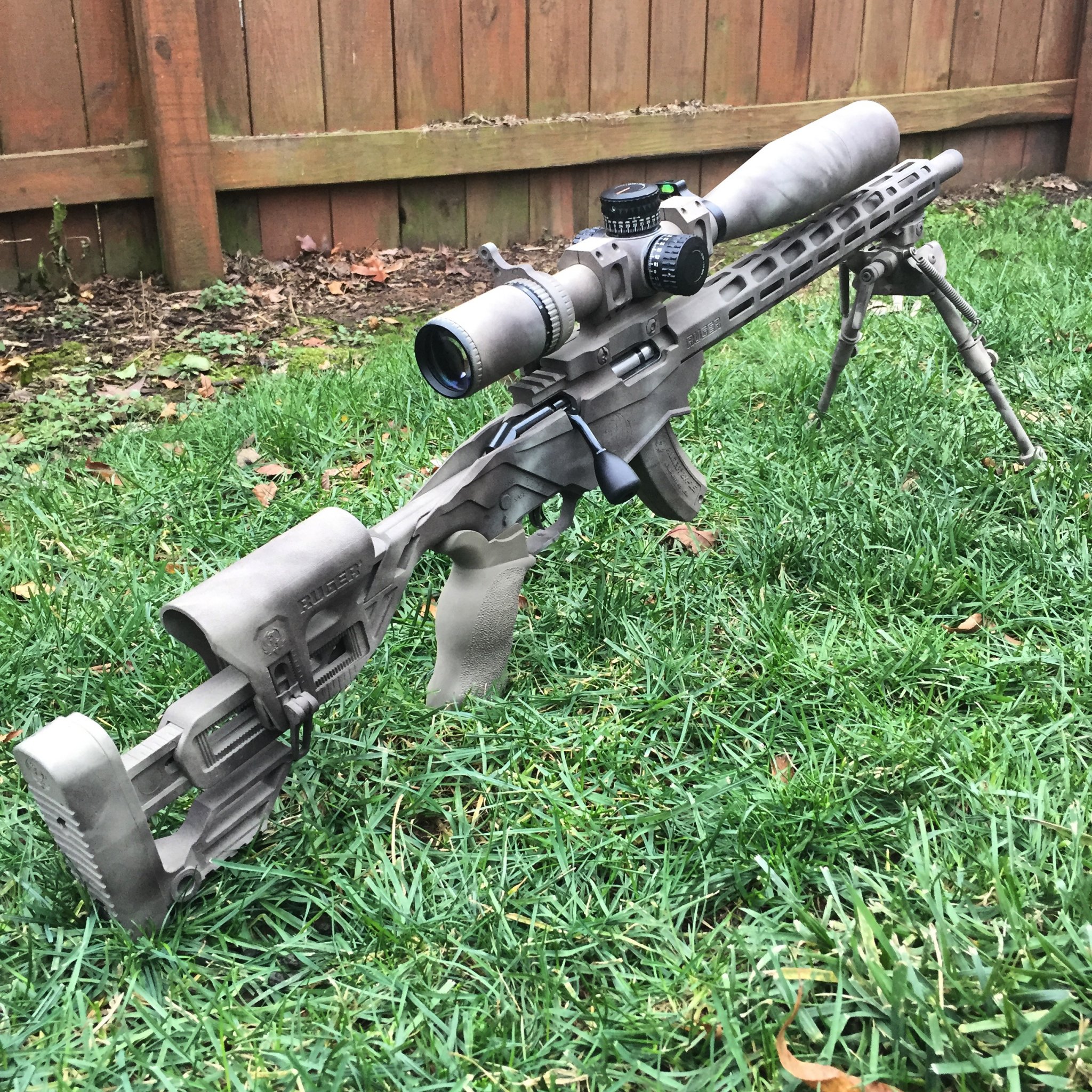

Decided to paint the rimfire! Used rust oleum camo colors and a fish net to texture

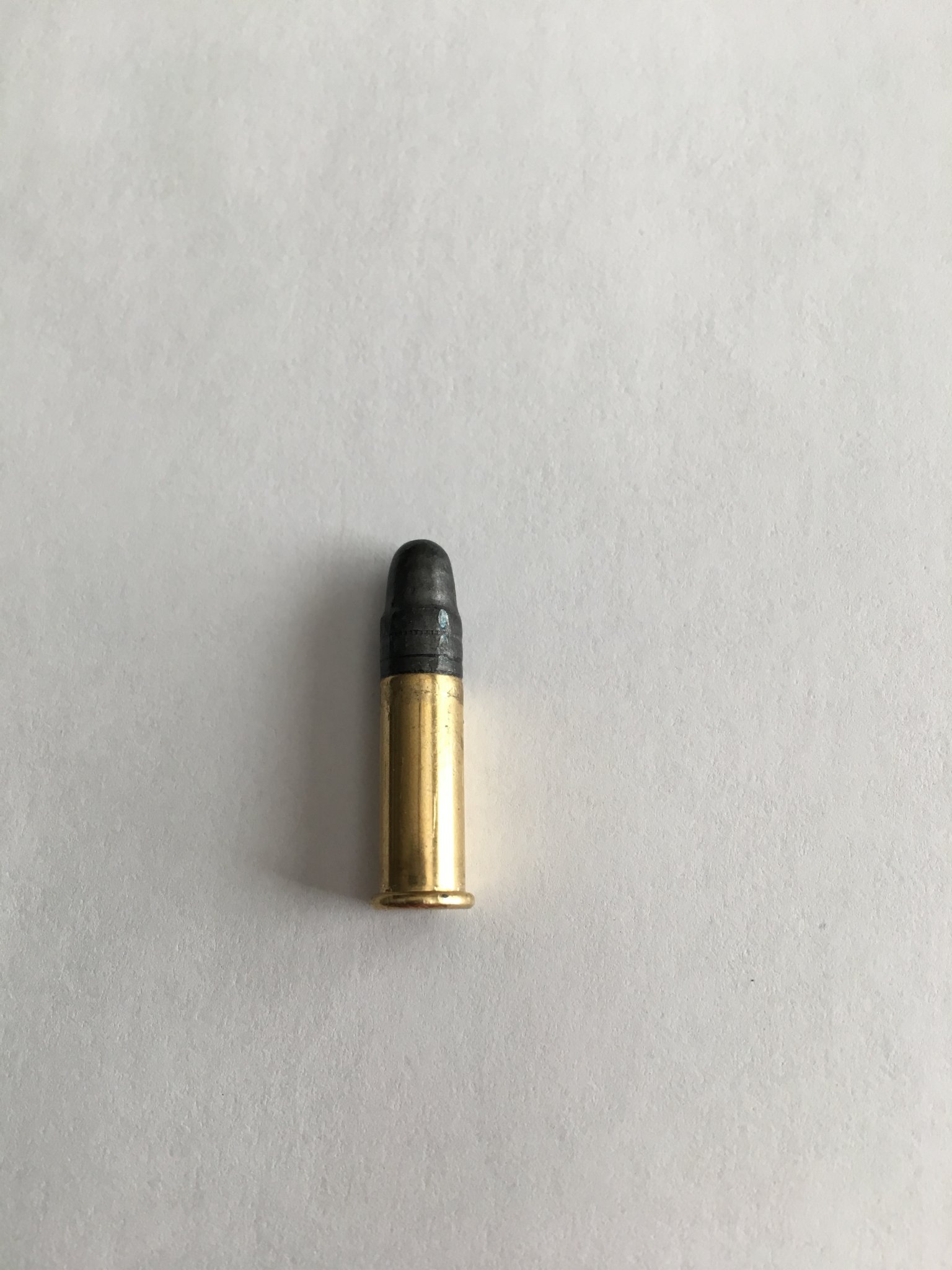

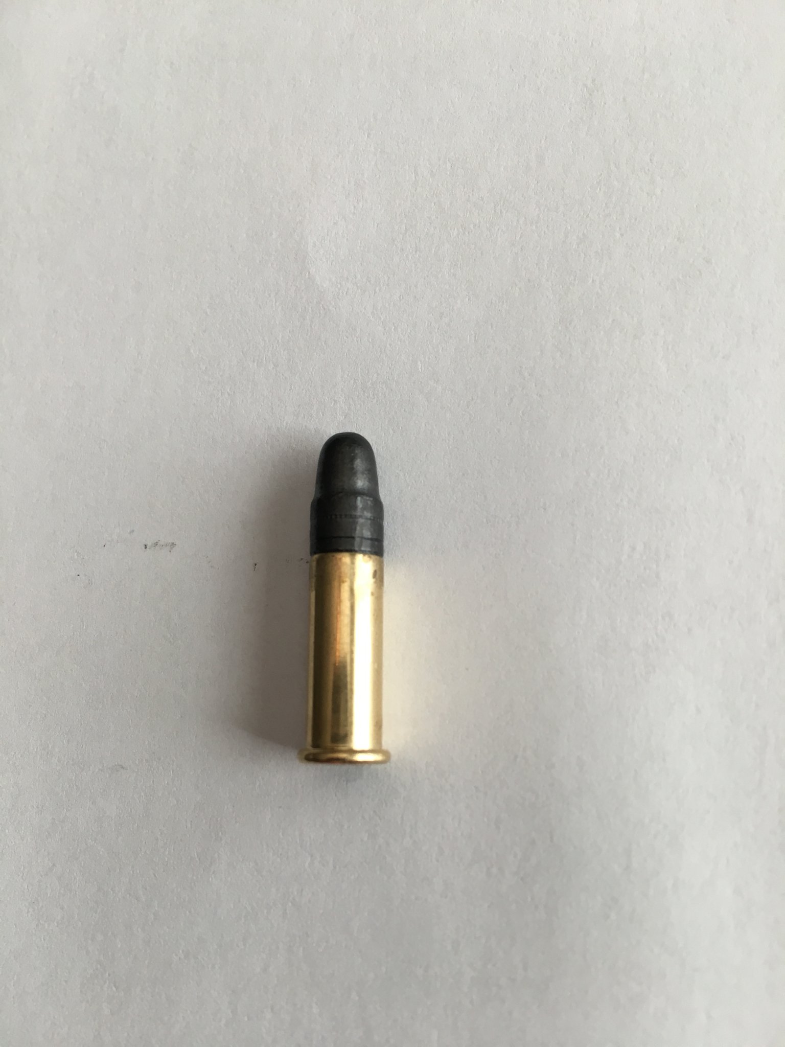

I have an RPRR that also suffers from magazine induced bullet mutilation (mostly shaved lead). I've tried many different magazines, cycling through the shells to examine the effect on the bullets. There doesn't seem to be any consistency to the issue. I've done some tape bedding, etc. I also use a 3D printed single shot sled and thst seems to help a little with consistency and accuracy. I think it desperately needs an aluminum chassis. (MDT, are you listening??) I've put the gun on the back burner for now while I play with my new Tikka T1x and wait for an aluminum chassis to drop that addresses the issues.

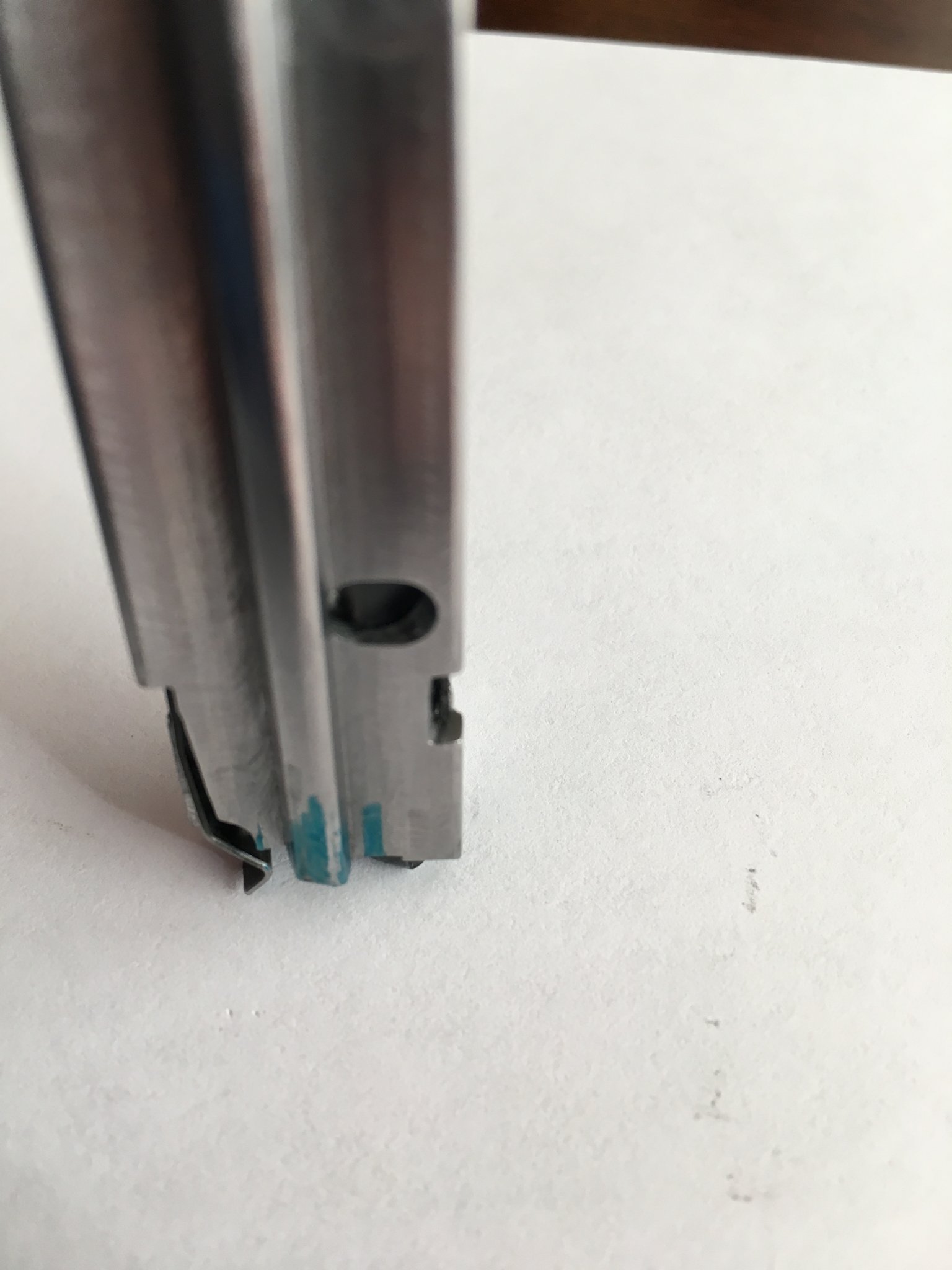

I’ve had some time over the last few days to tinker around with this rifle. I’ve been happy with the gun so far but there’s always room for improvement. I bedded the front block with aluminum tape and started taking a closer look at what the rounds look like after being chambered. There is a distinct line on each chambered round. This mark is coming from the bottom of the bolt. I polished the bottom of the bolt and this decreased the mark left by the bolt. The first image is the mark left before I polished the bolt and the second is after polishing. You can see in the third image where the bolt is scrapping the bullet. Is there a way to eliminate this contact? Is this caused by the way the mag fits in the receiver?
15 or 10 round magazine? I personally don't use 15 rounders; the range I shoot at has a 6 round max so I use my 10/22's 10 round magazine. I havent looked at the bullet after chamberin to see if there are any marks on it. I'll have to check on that and report back.
The 15 rounders. I’d be interested to see if the 10 round mags have the same results. Maybe the the 15 round mags are putting too much upward pressure on the rounds forcing them into the bottom of the bolt. I’ll try to take some tension out of the mag spring to see if that changes anything.
Tried my 10 round magazines earlier today loaded 5 rounds; chambered and ejected all 5 rounds. Did not see any damage to the bearing rings on any of the rounds. I should mention that I unwound the magazine spring a little to take the pressure off the rounds while loading. When using the 10 round magizine the spring tension is calibrated for the simi automatic 10/22 which means that the next round in the magizine must be ready to chamber then the bolt recoils back. I believe that that tension is not needed for our bolt action rifles.
