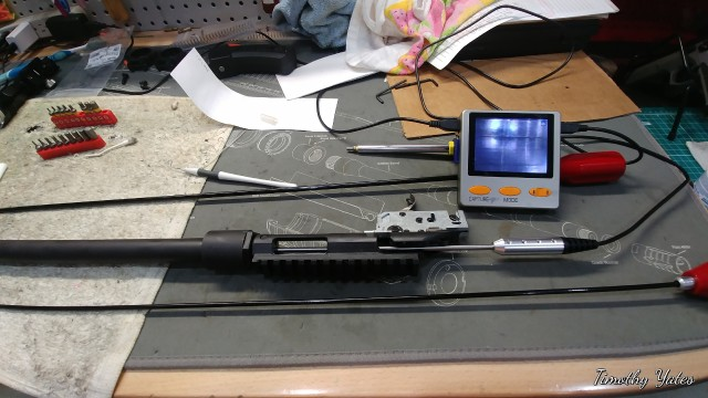

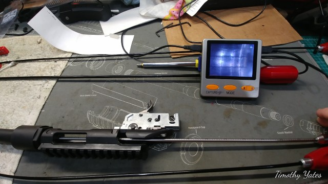

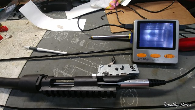

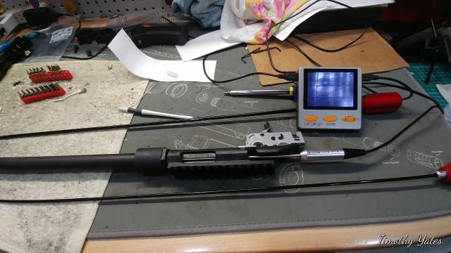

Took apart my Ruger Precision Rimfire today. Cleaned the factory barrel thoroughly and here is what I seen with the bore scope after cleaning. Does anyone else have a bore scope to inspect their barrel? Does it have these circular marks? The marks are 360°. Notice these four photos are taking at different areas. The entire barrel length is like this. I will have to double check but I don't believe my $210 Savage MK II barrel looks like this. This gun has never shot that good. When I was cleaning the barrel I noticed the patch on my Parker/Hale jag was not as tight on any of my other 22 rifles. Anyway, since this thread is about the Ruger PR I thought I would share this. One reason why I am so interested in the Shaw barrel.
I may contact Ruger and show them these photos and ask if this is normal. If the guy/gal says yes, then I will tell them I'll never buy another Ruger product because their quality cannot be trusted. I mean you can't deny the photos, the probe is sticking in the Ruger barrel.
View attachment 6969700View attachment 6969701View attachment 6969702View attachment 6969703
I have the same bore scope and have done the same test... Looks like yours. While mine did shoot pretty well, it's not a great looking surface and can't be that helpful to precision or SD over time. I put over 1000 rounds through it before swapping to ER Shaw and scoped it after pulling it from the rig. Not that impressive.
The Shaw barrel on the other hand looked like a silver mirror. Very clean and very smooth.

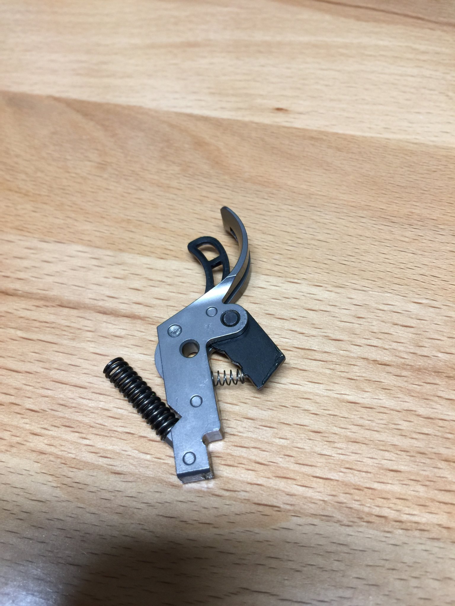

I took out my main trigger spring (5mm x 18mm) and replaced it with a spring from a bic pen slightly stretched to 18mm. The safety works as it should. The rifle will not fire unless the safety blade is depressed. The trigger pull is 1 pound. The rifle would not cock upon bolt lift unless the bolt was opened briskly. I tightened the trigger adjustment set screw a few turns and the rifle cocks with the gentlest bolt lift and is still at 1 pound. It feels perfect.

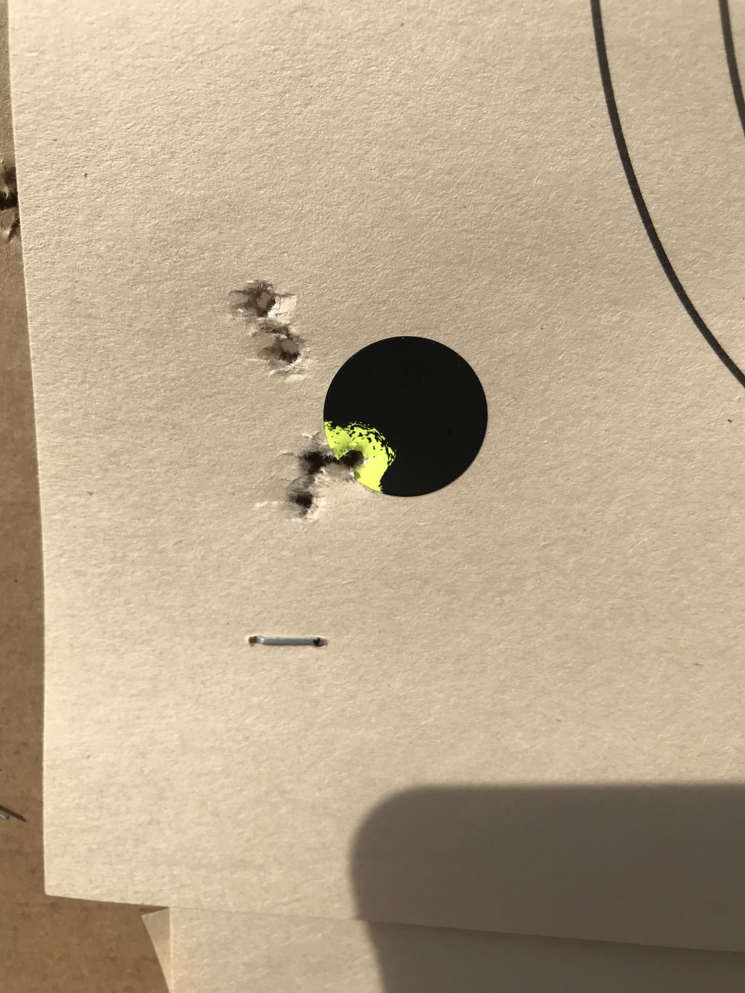

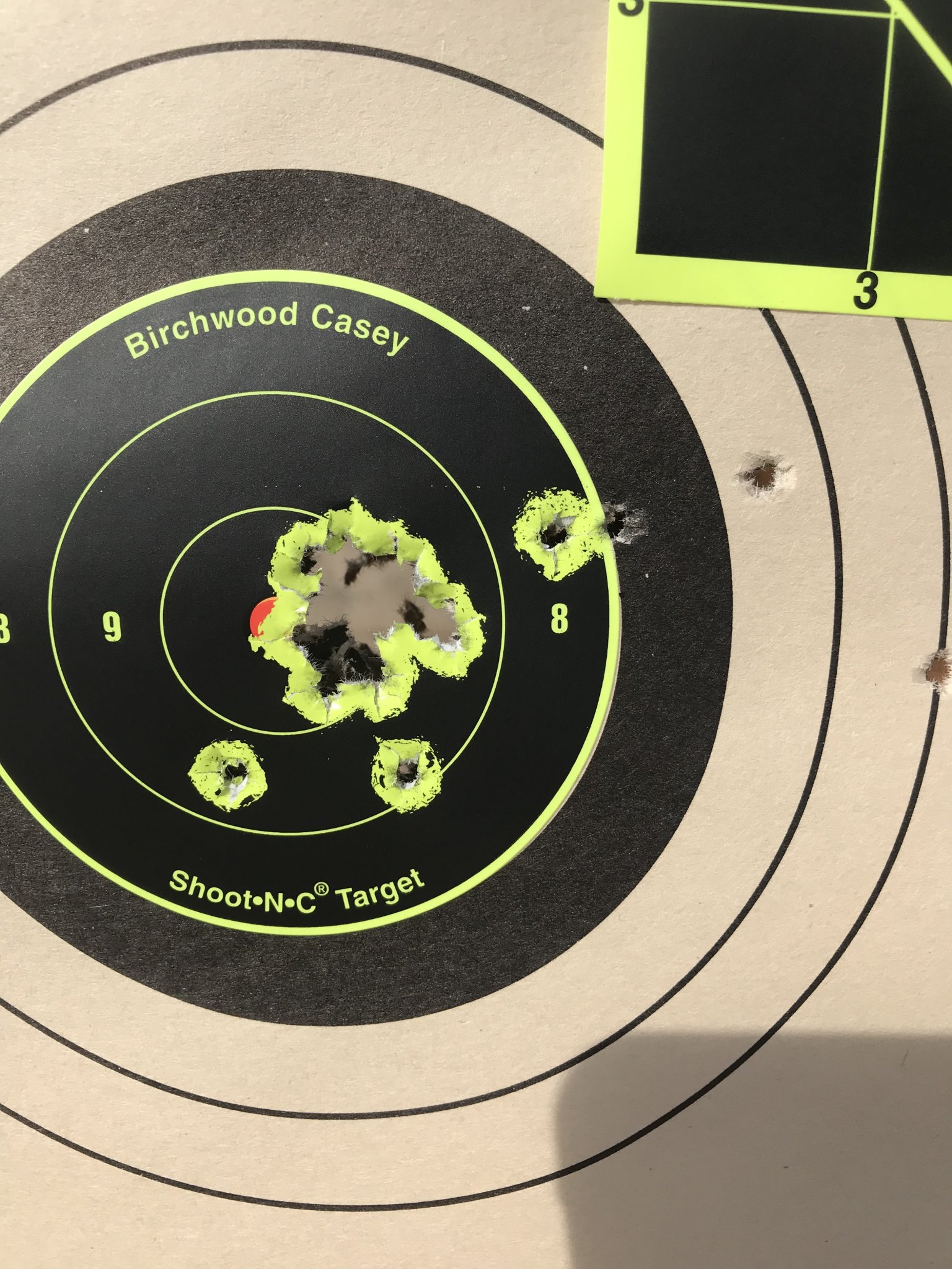

I installed and shot my Shaw barrel today. Also filed off the burrs on the bedding block and put aluminum tape on the entire top, sides, and rear. Its super tight now. Need to use a delrin punch to tap out of chassis tight. Also a tiny single strip at front of chassis.
Shot 100 yard 5 shot groups of 1.07" with Wolf Extra Match and .88" with SK Rifle Match. Had 50 yard 5 shot groups in the .25" to .45" range with the same ammo.
Reliability went down. Needed to ensure I pushed forward on the mag to cock the rounds more upward to get reliable feeding. Before I just needed to not pull the mags to the rear and point them down but leaving them alone was enough to ensure reliability. 100% reliable with mags at correct angle. Need to find a way to make them always stay at that angle.
I also feel like my stock trigger and Athlon BTR 6-24×50 Argos are holding me back. I think consistently shooting 3/4 MOA is a realistic goal now. Its nipping at my stock RPR 6.5 Creed accuracy finally.

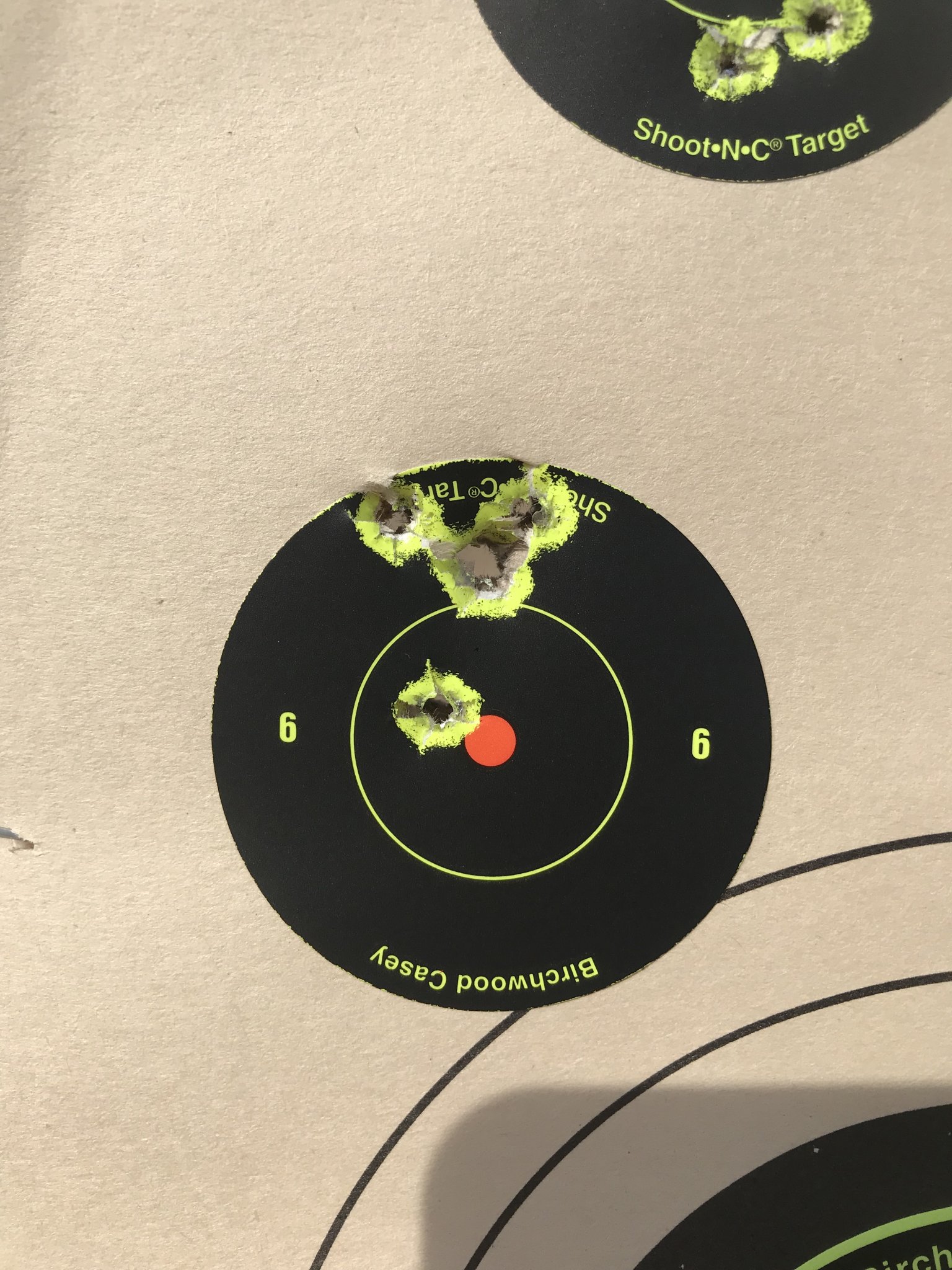

Three 5 shot groups and 1 20 round group all at 100 yards with federal automatch
