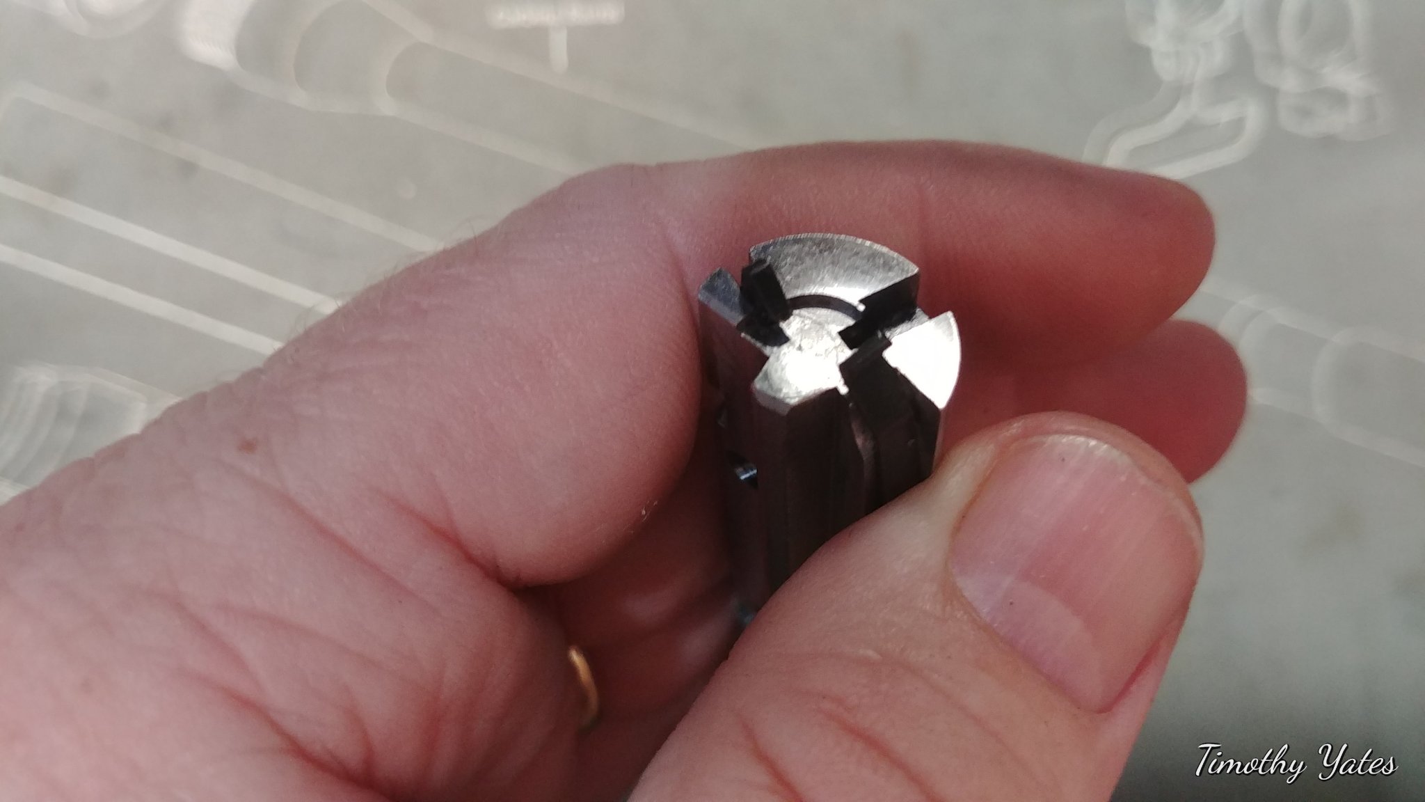

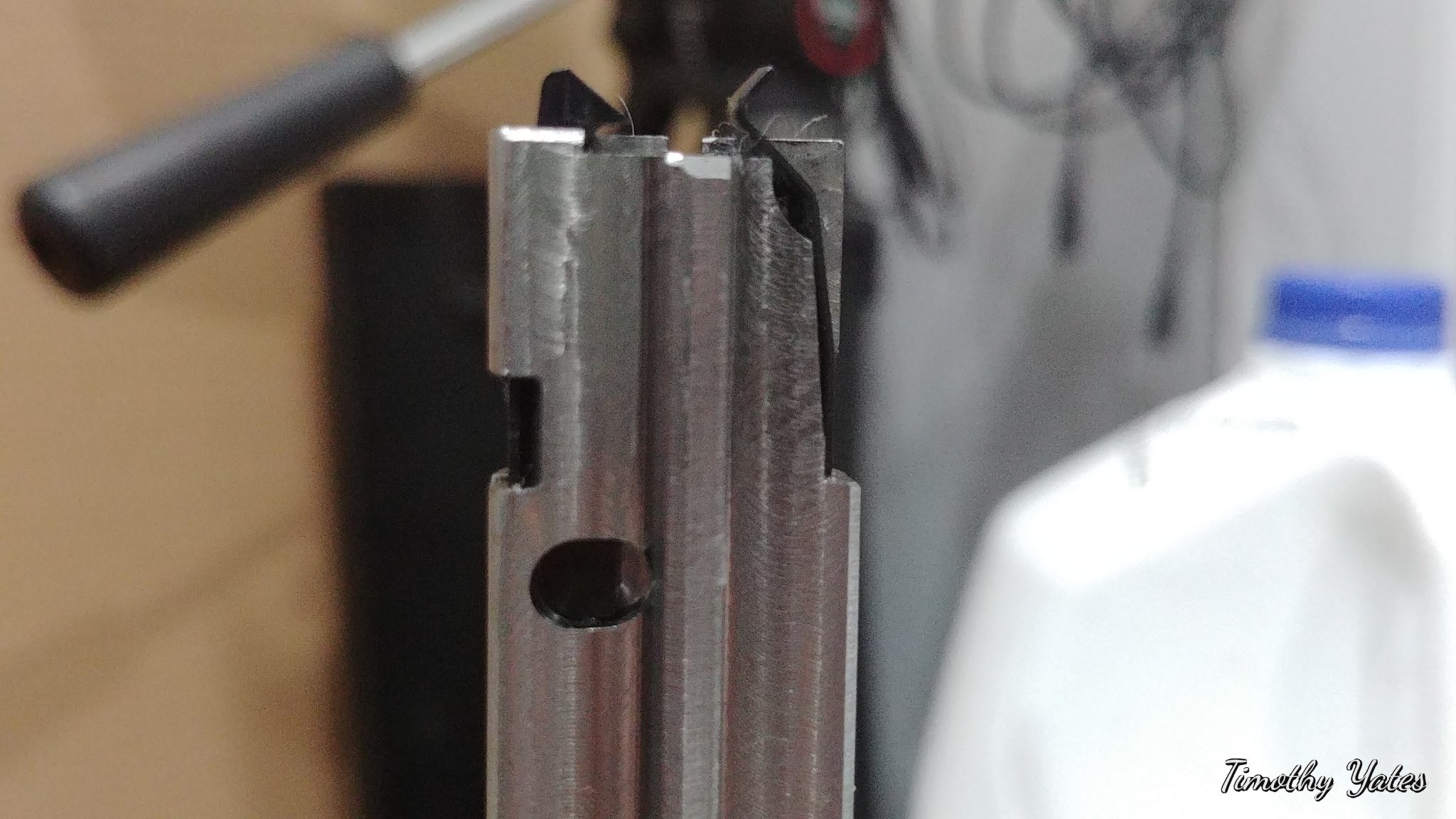

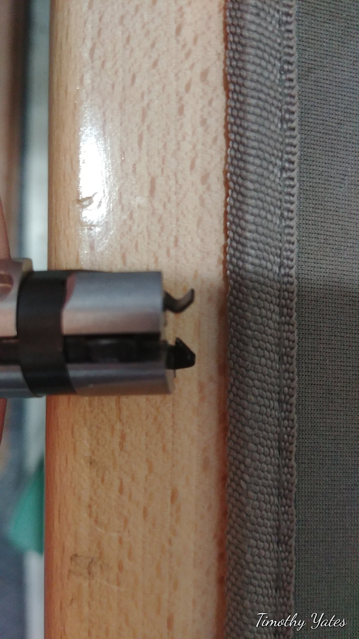

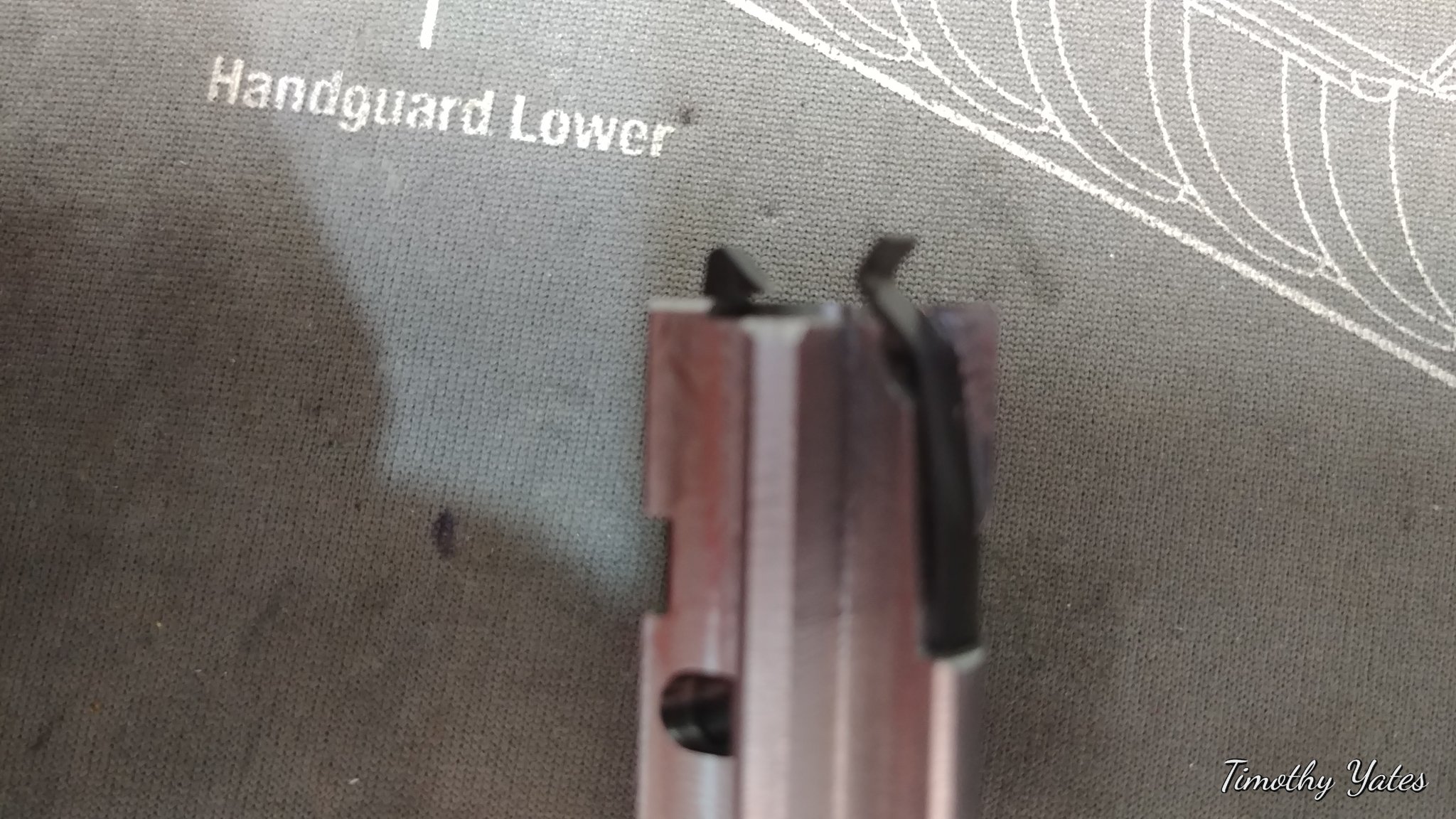

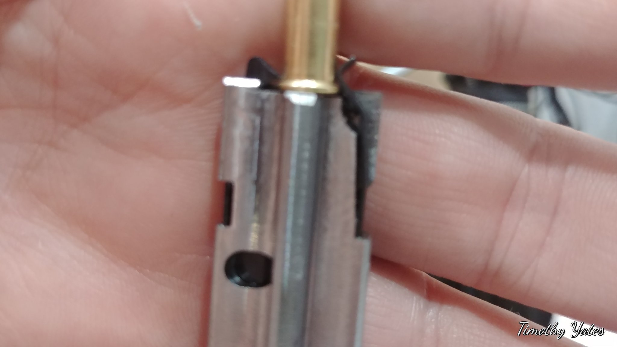

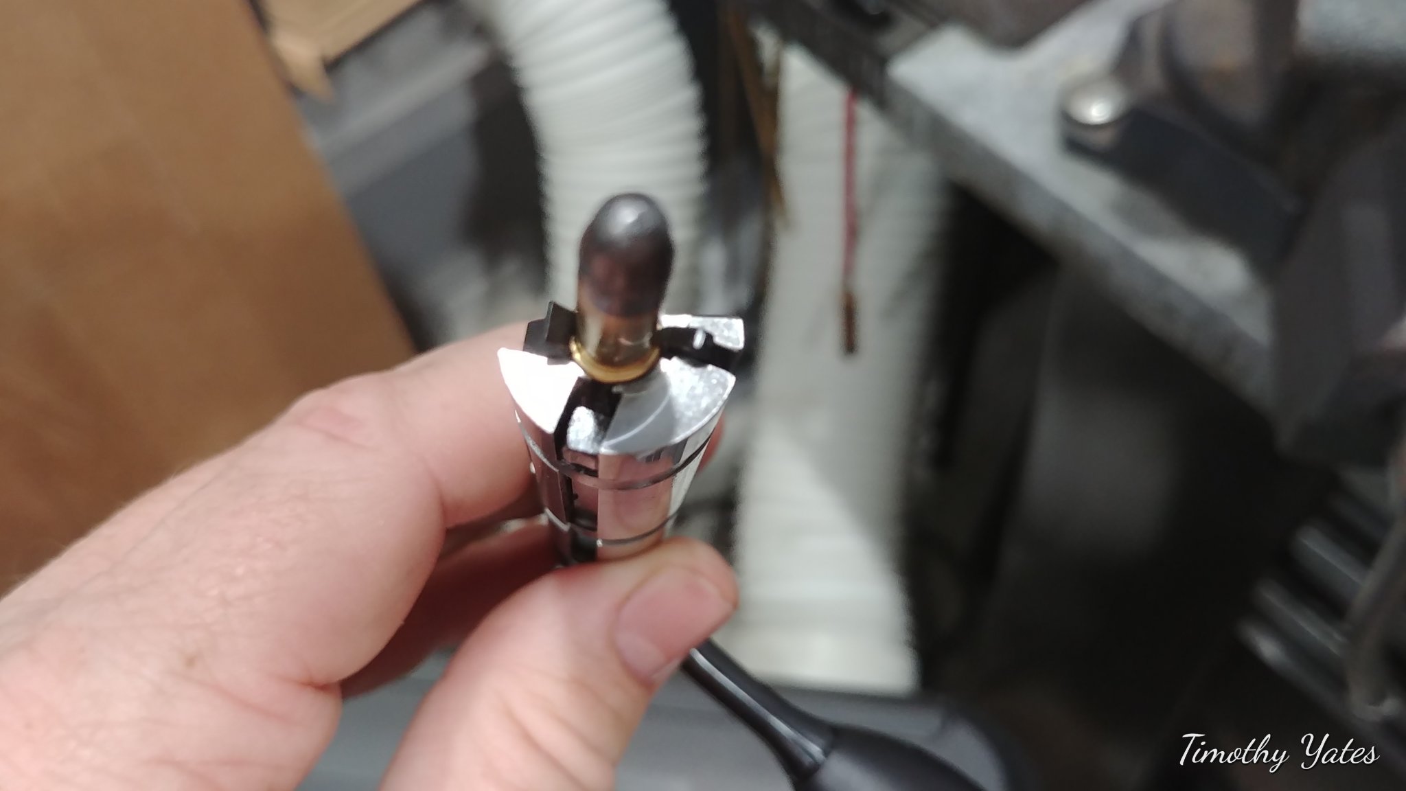

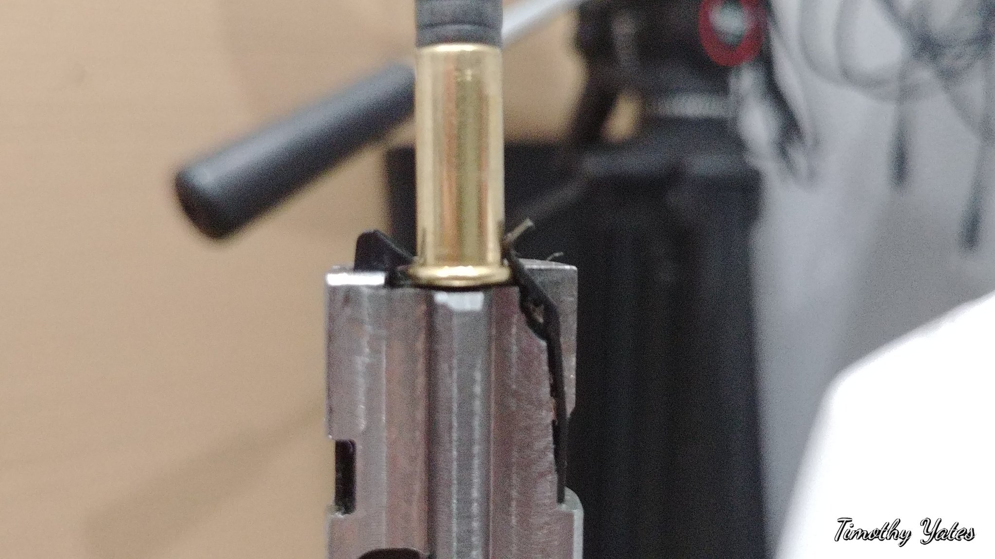

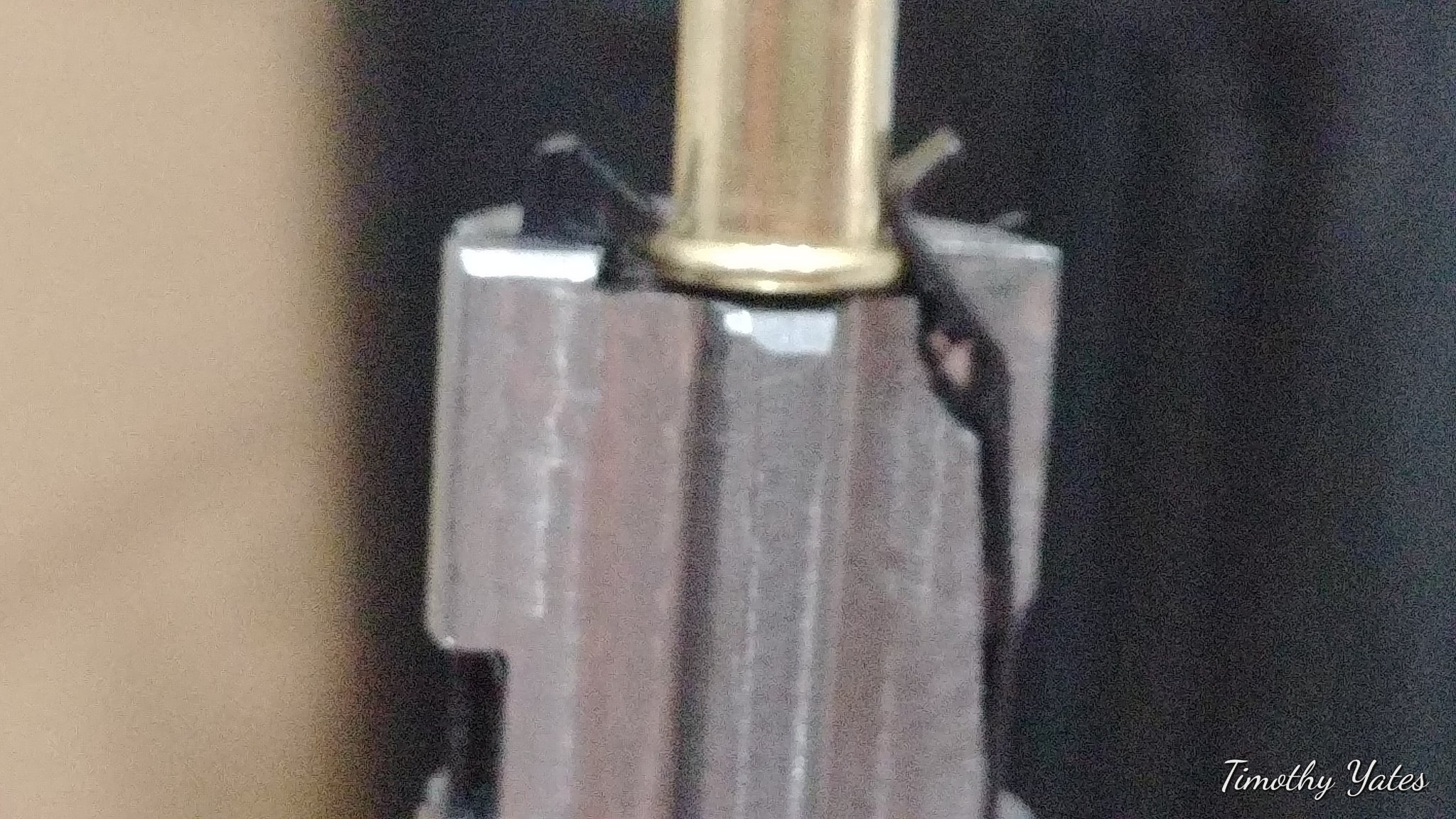

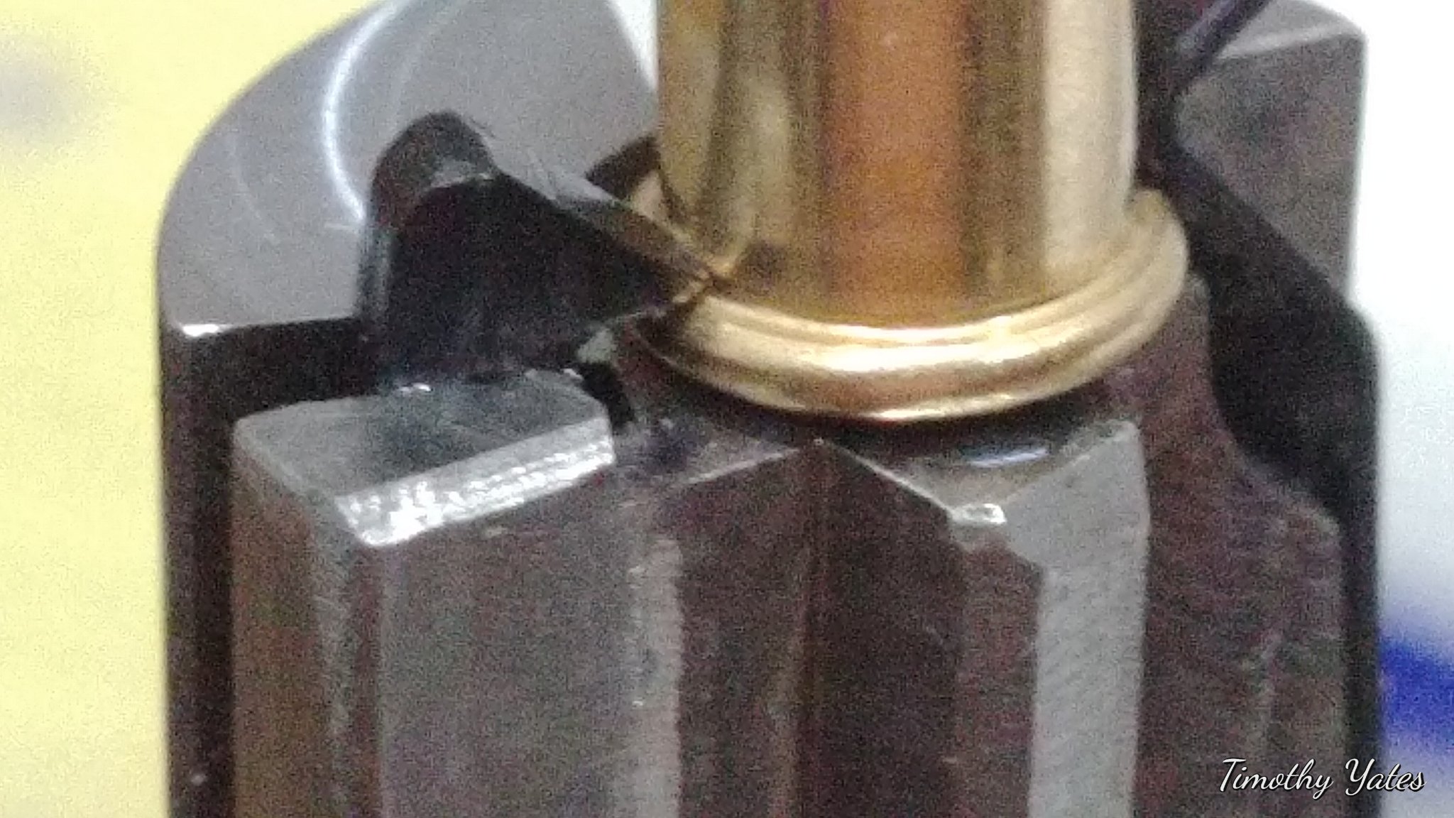

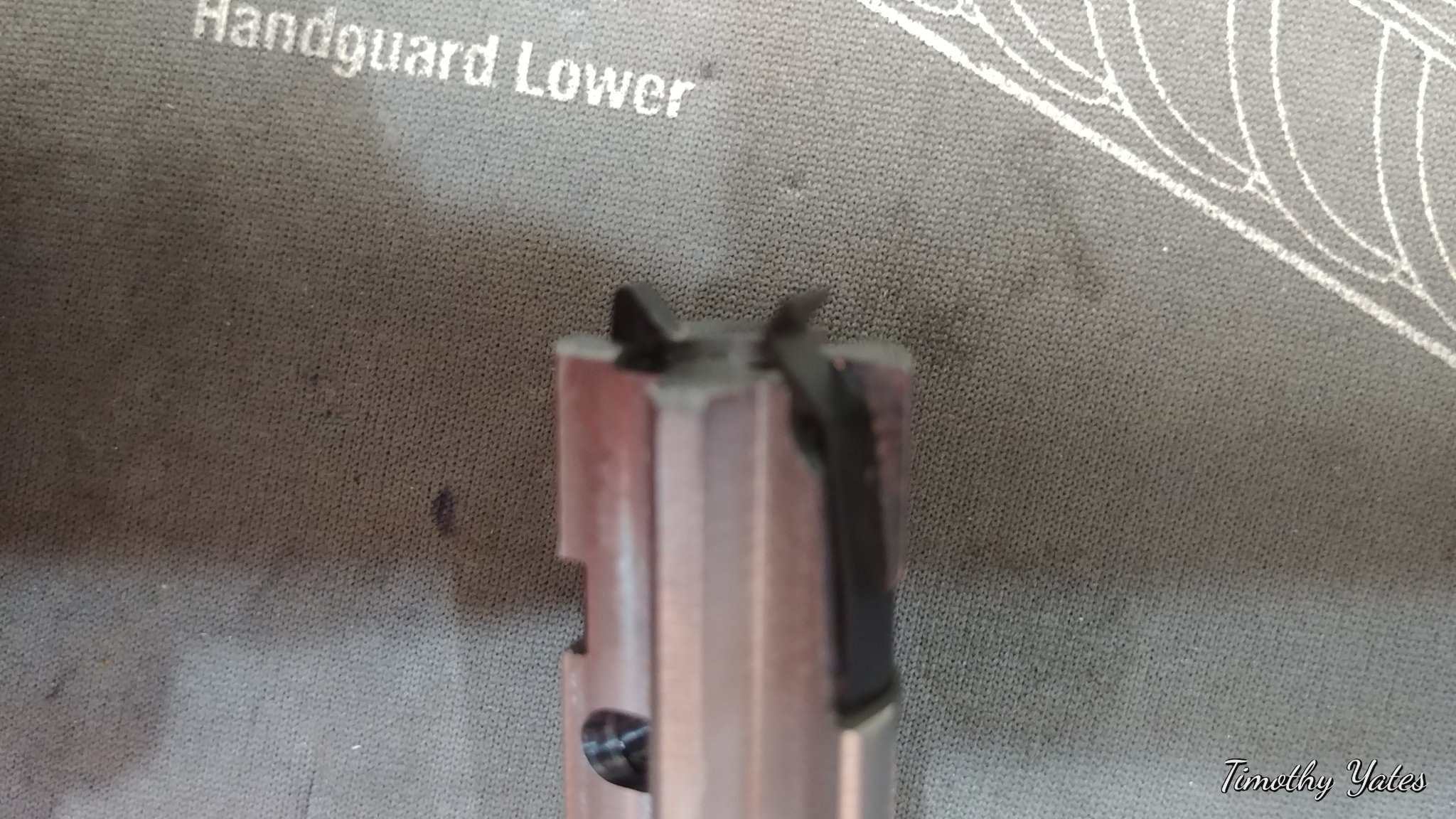

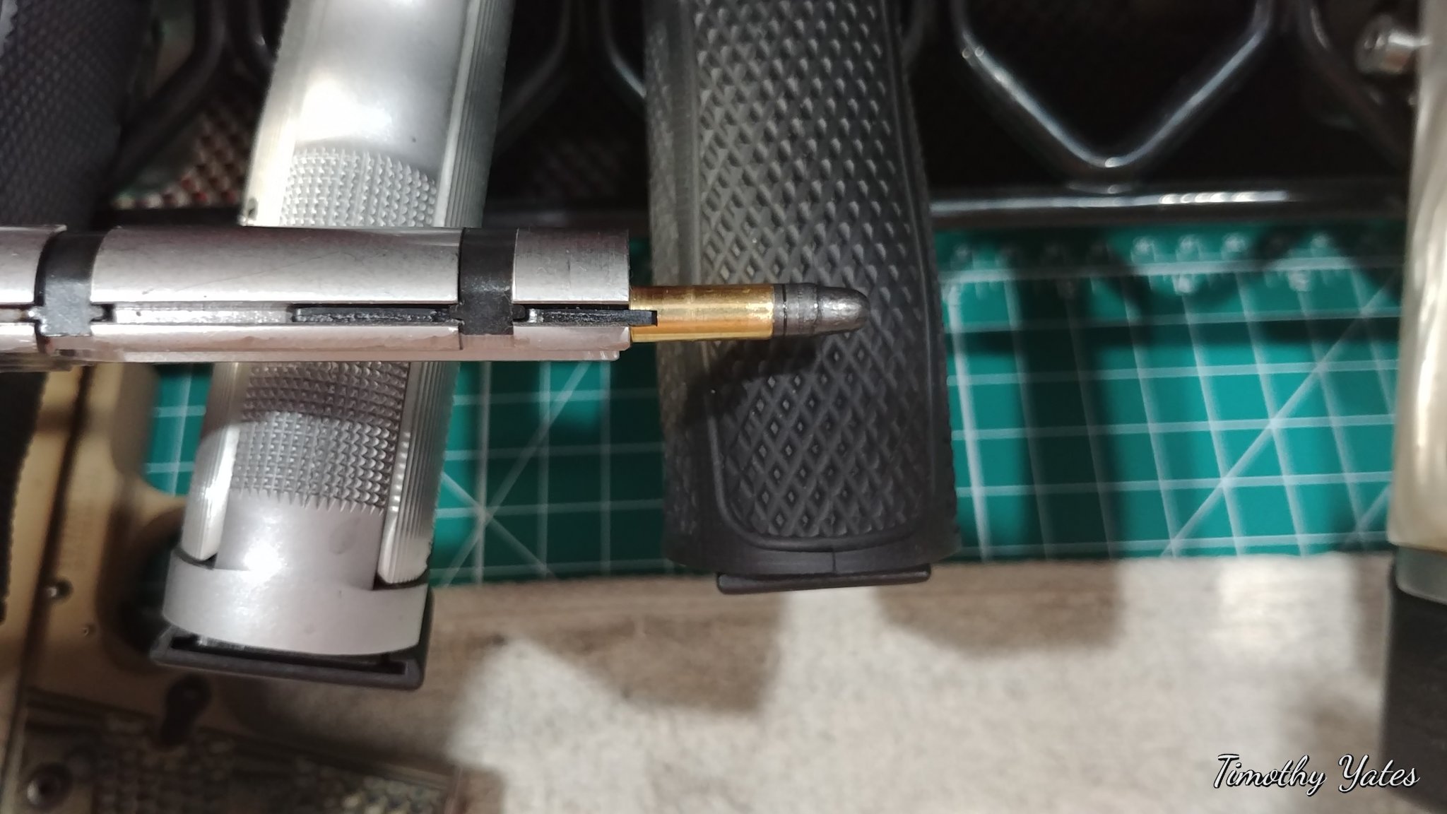

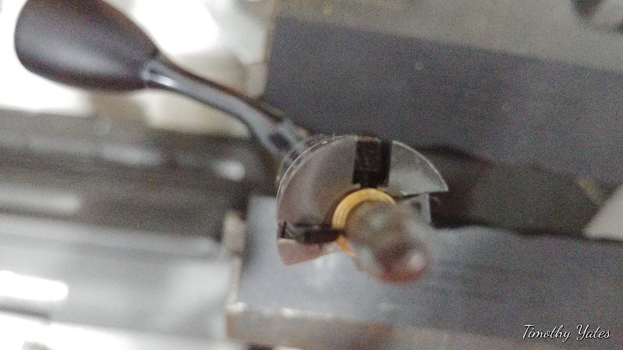

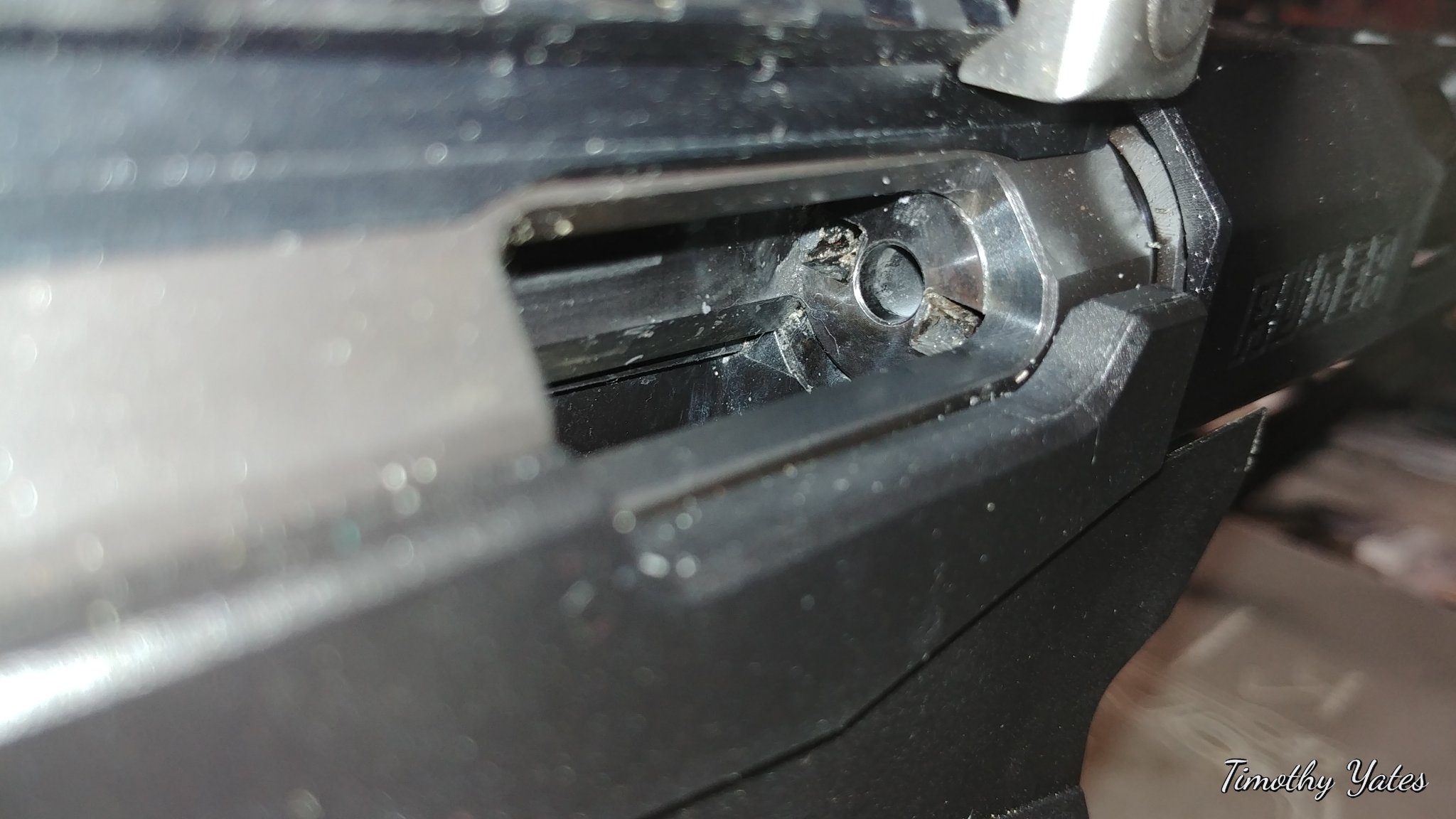

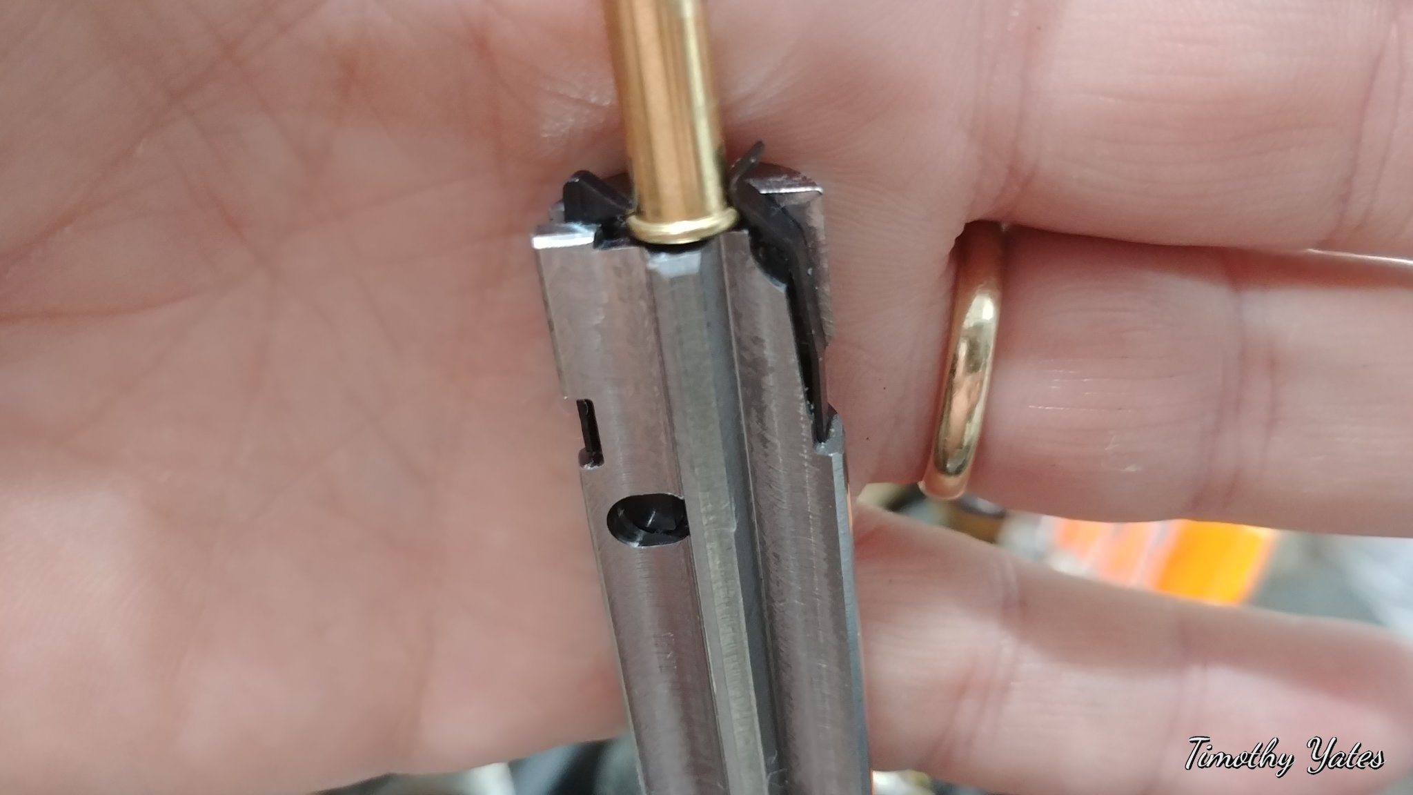

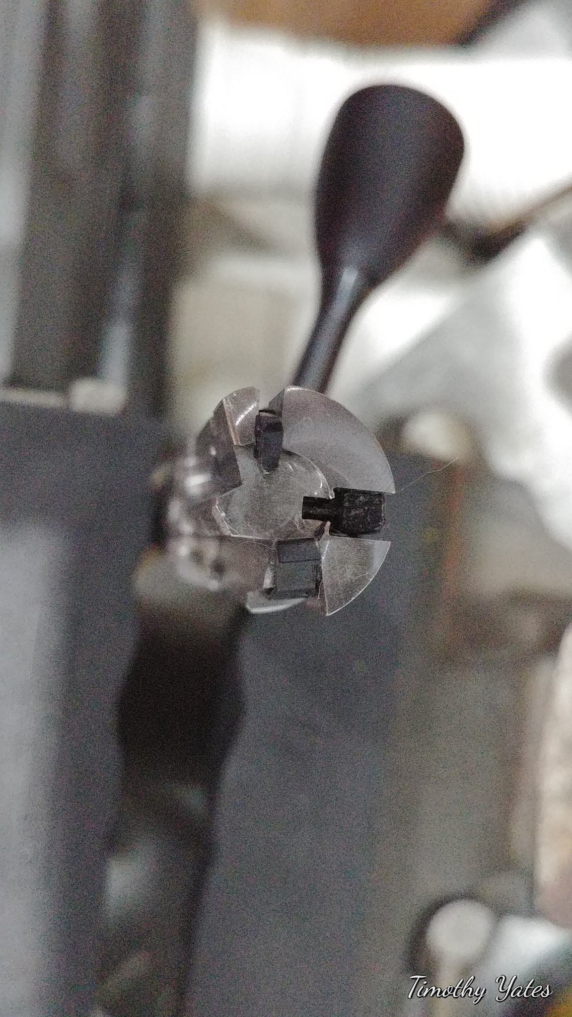

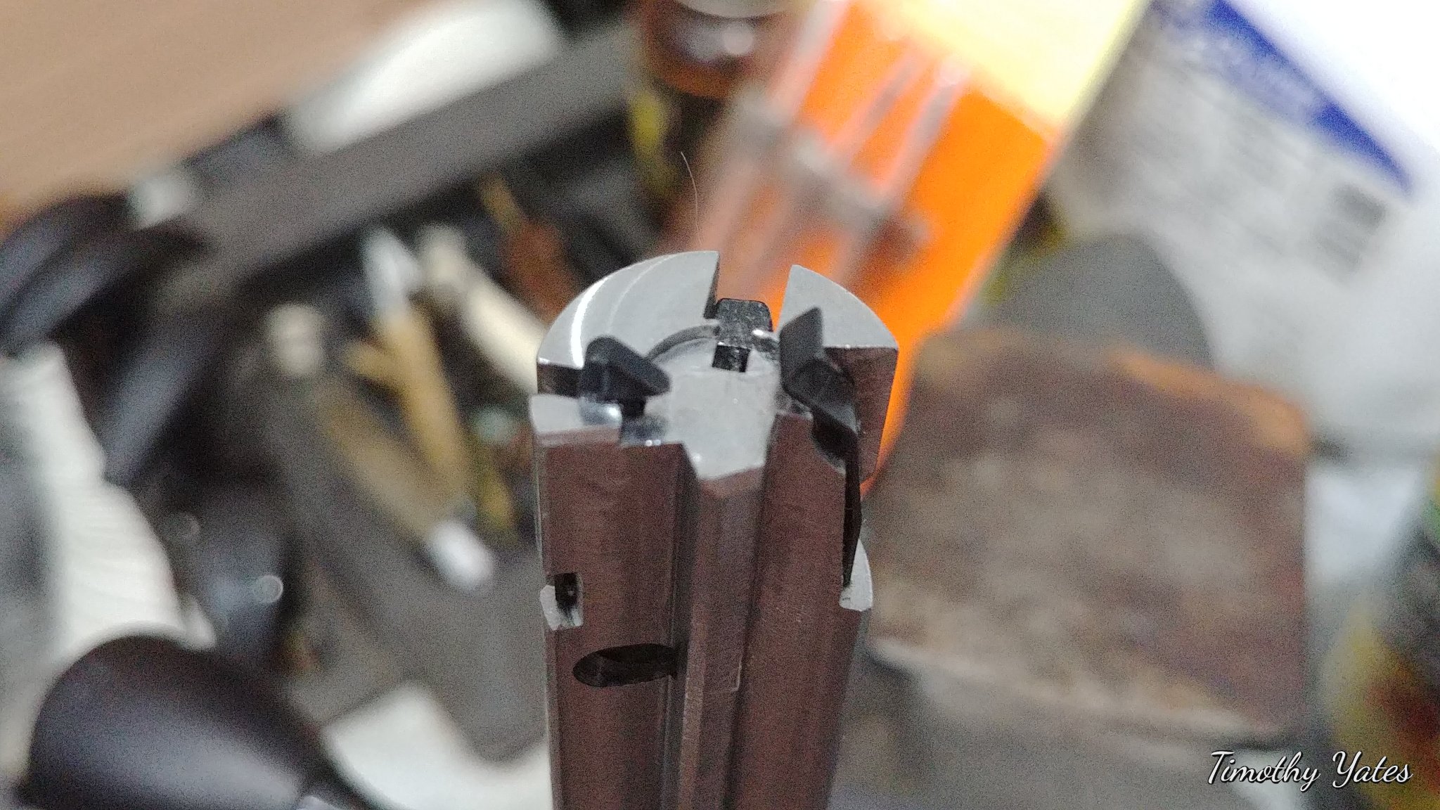

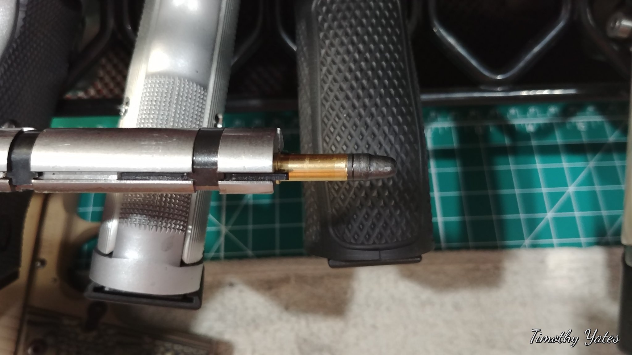

I would appreciate pictures. Put a round in it so I can see how much your spring engages. Also how rough your surfaces is.
Guys, my photos didn't turn out as well as I thought they would. Looked good when I was taking them. I'll post what I have and if you see something specific you need to be more clear then let me know and I'll target that area.
1029182046.jpg1029182046a.jpg1029182047.jpg1029182049.jpg1029182049b.jpg1029182050.jpg1029182051.jpg1029182051a.jpg1029182052.jpg1029182052a.jpg
Reactions: CatnDoo
Don't take this the wrong way but you couldn't have like it to much since you bought a Shaw aftermarket barrel?
I like it fine. I was never expecting a factory barrel with sport chamber on a $400 rifle to shoot MOA or better. I bought the gun for the platform and ergonomics. This rifle is designed to be, and I believe it will be, the 10/22 of bolt-action rimfires. The barrel comes off more easily than a 10/22. Triggers will be easy to develop and Timney has one almost ready. GM, ERSHAW, WHISTLEPIG already make barrels. The function was flawless and that is what I was looking for primarily. Barrel performed as expected, I did not get lucky. No big deal. Barrels, chassises, triggers, scope rails, etc will be supplied as nauseum by the aftermarket. I will be like a pig in shinola kitting out a couple of these in the years to come. I enjoy such foolishness.
rimfire22lr, the Ruger PR is a great platform to build off of. It does have a lot going for it. I like mine and I like shooting it.
John_Vinblad, glad the photos helped and you got the Ruger functioning as it should.

After making adjustments to the extractor spring I still would have occasional stove piping and week ejection. After looking at this I starting taking a closer look with a magnifying glass to try and understand why so many of us are having this kind of issue. So, with I put a case into the bolt face I noticed that it was being held there rather loose by the spring. So, I bent the spring in a little more and sure enough, it held the case much firmer. But then the case wasn't getting ejected from the bolt at all. So I focused my magnifying glass (need a magnifying glass to help these old eyes) on the ejector in the magazine assembly. And sure enough, the ejector was rather loose and hardly engaging the base of the case. So, I pulled the magazine assembly out and bent the ejector in and reassembled it all. Ejection work much better, BUT . . . I had bent the ejector a little too much and it was rubbing on the bolt making the bolt not slide smoothly. On making further adjustment to the ejector so that it's really close to the bolt but not rubbing, it's now ejecting quite well. But, I haven't tested it at the range yet to see it this is truly a fix during live fire conditions. Will be going out soon for a good test and see if I've eliminated the problem.
Note too, I'v taking all the play out of the magazine assembly putting polyethylene tape (the kind used for drawer slides) in the sides so that it seats firmly in the stock. I think this may also be a factor in the ejection issue since the ejector is part of that assembly.

Try puttinmg one or two strips of tape on the botton of part #57. This will lift the ejector and should solve your problem.
That's a good idea.
In my case, the ejector was and is high enough, but was too far off to the side where it would barely make contact with the casing. And when giving that configuration with the looseness of the Magazine Latch Assembly, I can see why there would be inconsistency with proper ejection.

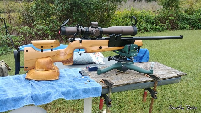

I received the ER SHAW barrel. It looks very well made. Installed it and will test it today.

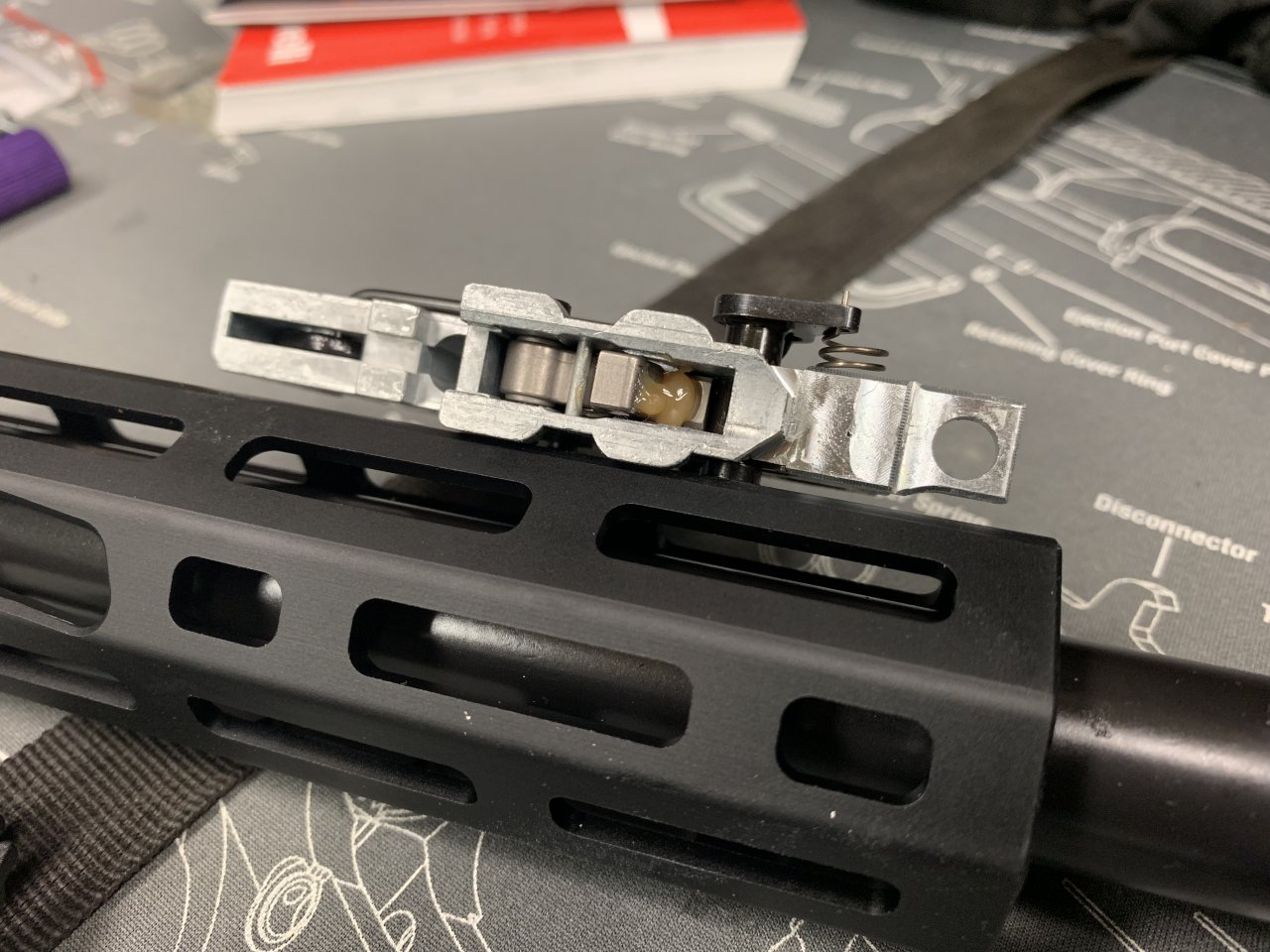

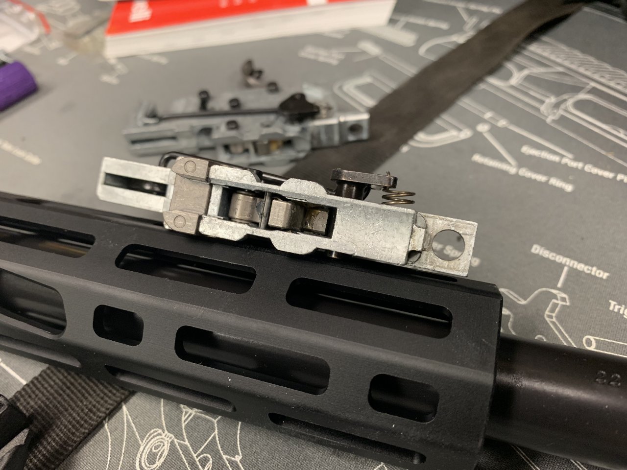

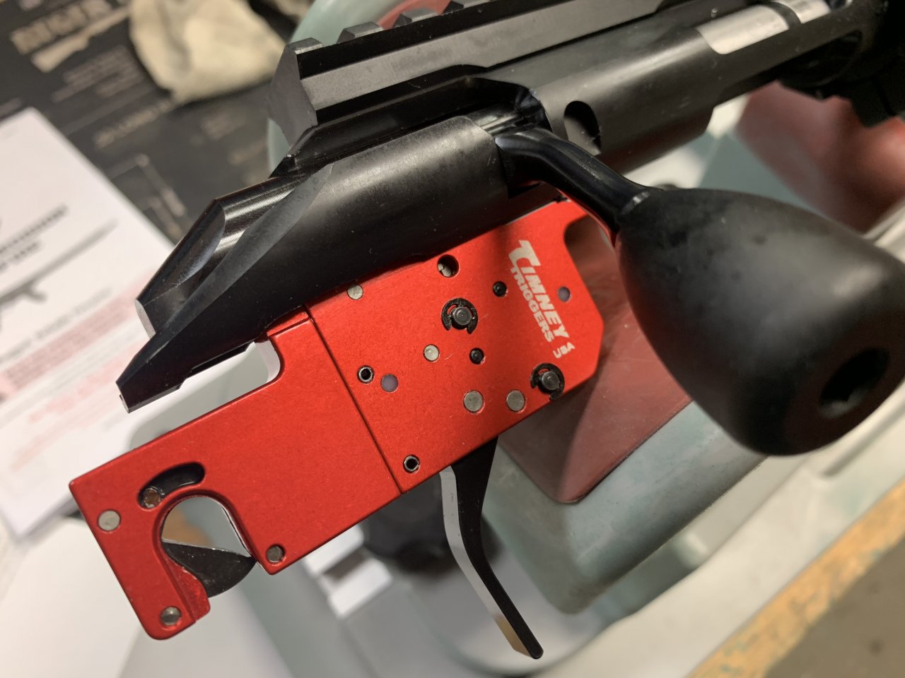

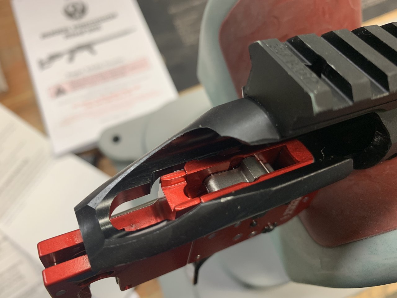

I picked up a RPRR yesterday. I’ve have a RPR that I’ve been shooting for a couple years now.

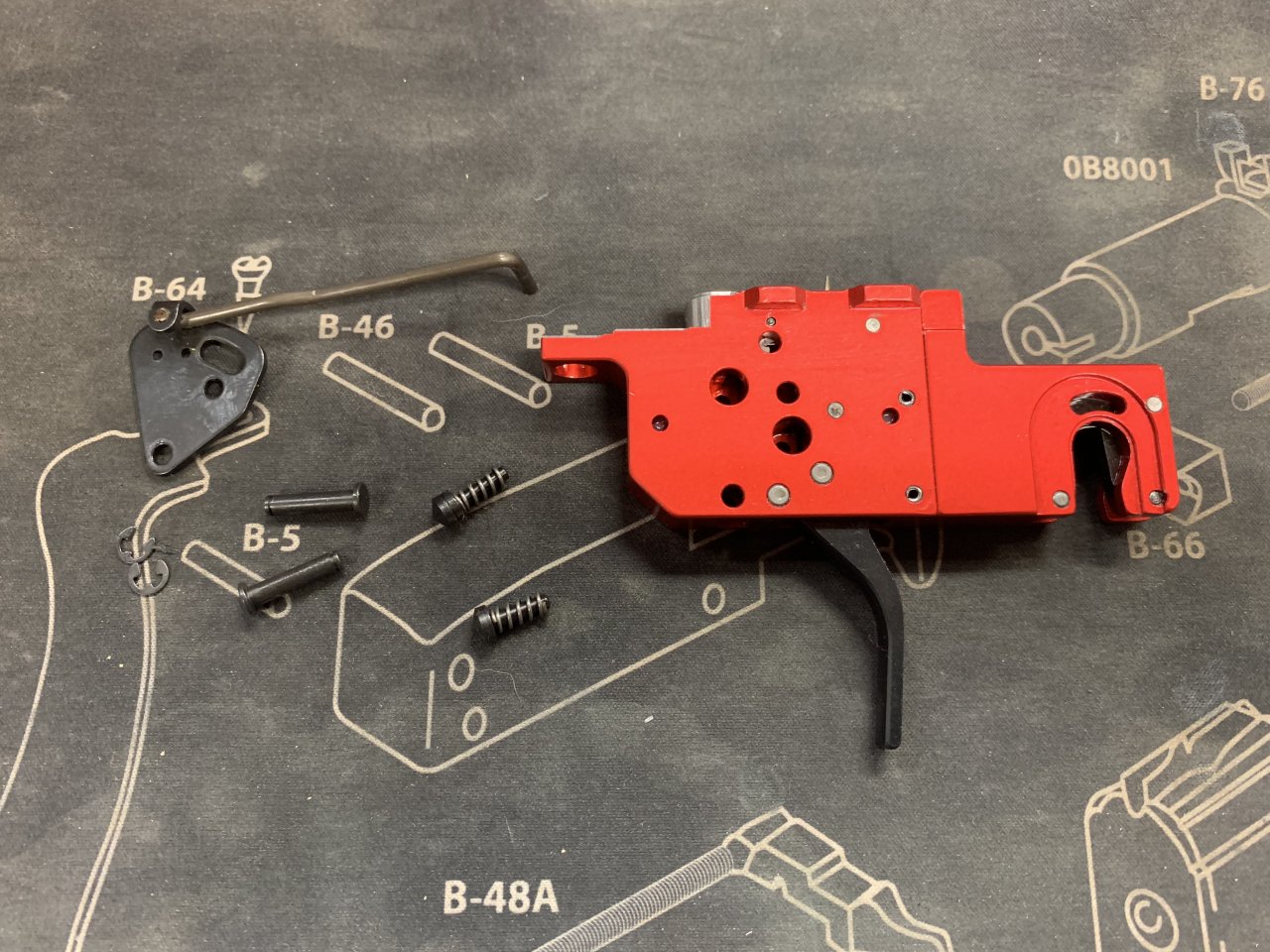

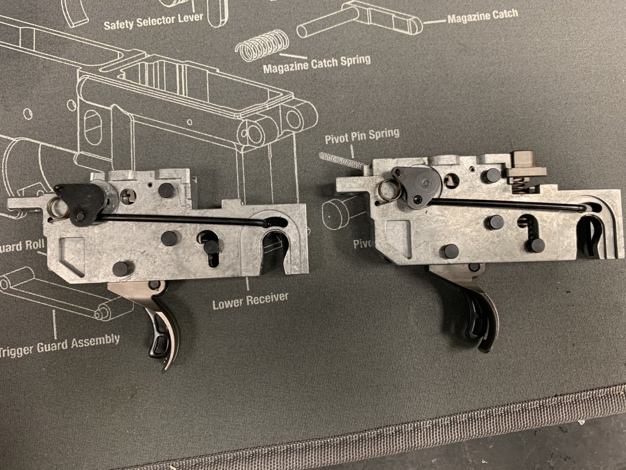

First thing I did when I got home was tear apart the rifle. I picked up a Timney trigger for this rifle as it’s similar to what I have on my RPR.
It’s not a drop in mod as most of you know. I’ve seen people mod the Timney trigger for this platform. Here is my take on it.
As you can see the RPR and RPRR triggers are identical with the exception of some additional machining to get it to fit to the RPRR receiver.
Stock RPR Trigger
full
Stock RPRR Trigger
full
Side by side, RPRR on the Left and RPR on the right
full

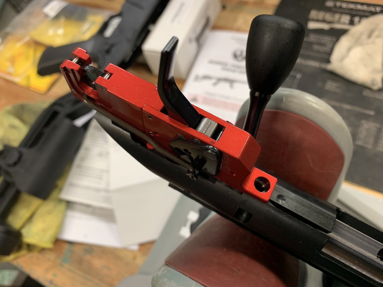

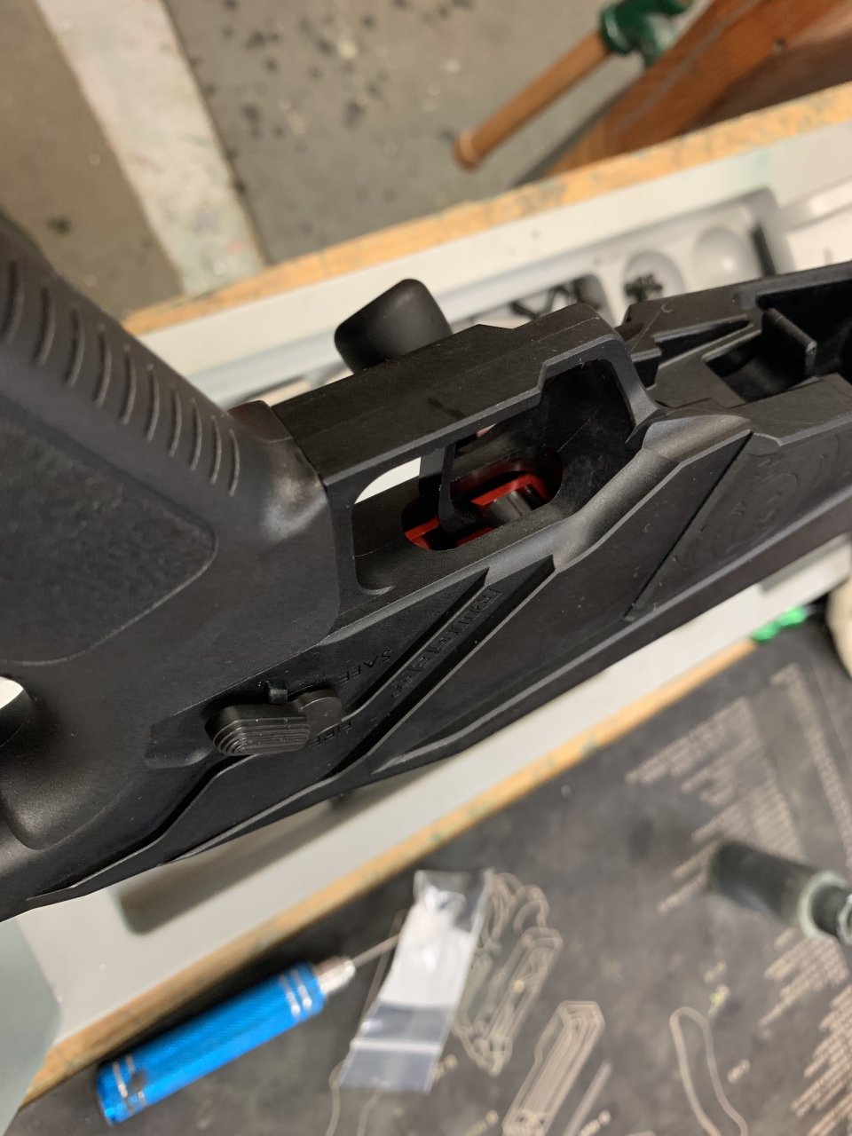

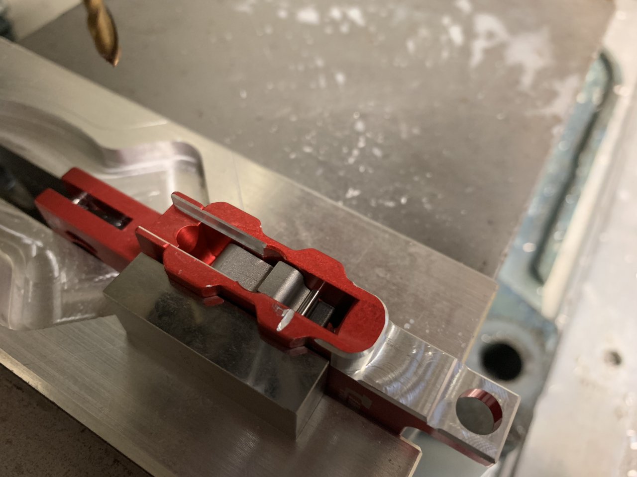

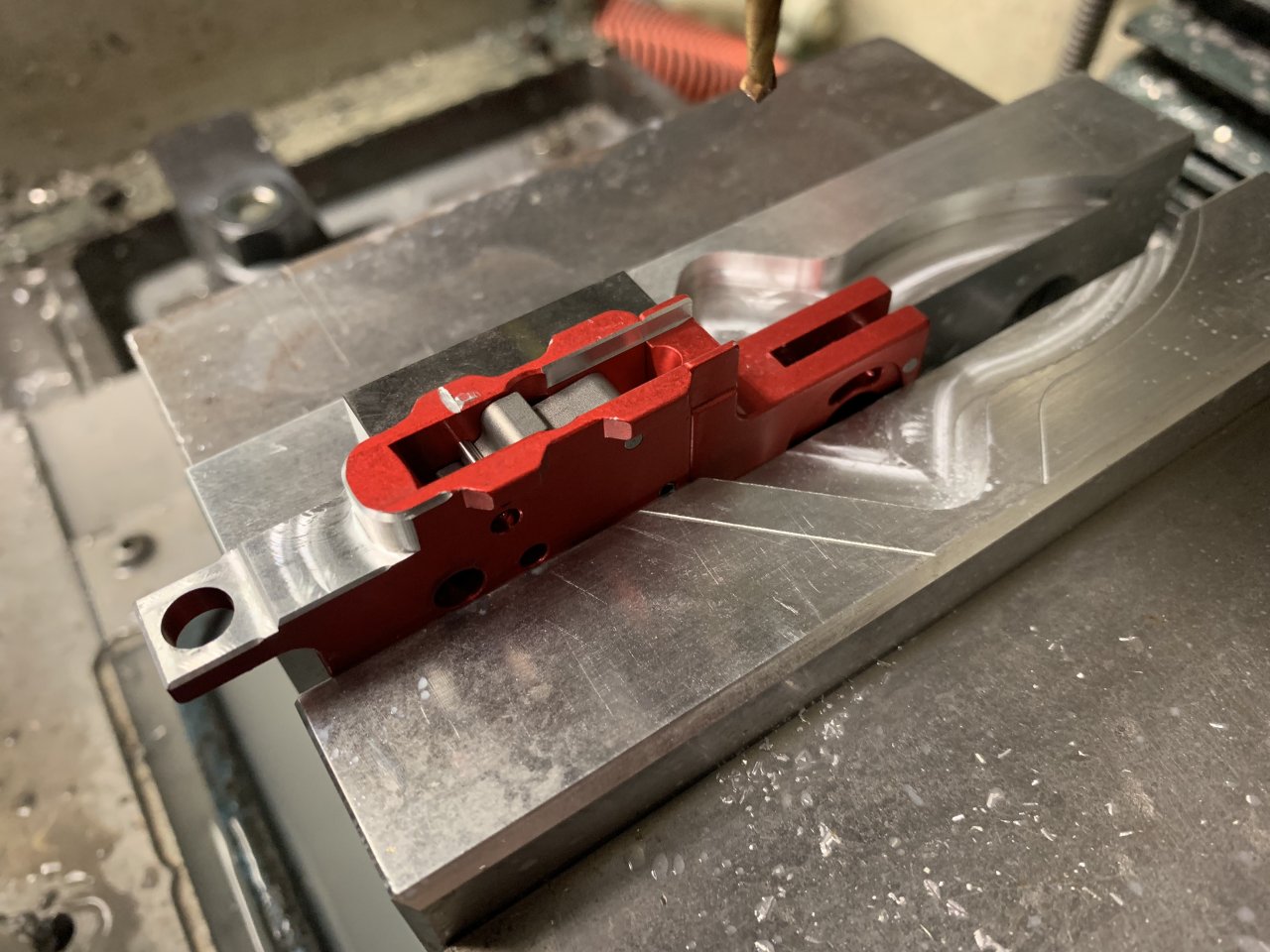

I have a small CNC in my garage. I was originally going to do this on the manual mill but I thought I would just do a quick CNC program.
The first step was to strip down the safety mechanism that protruded from the side of the trigger
full
Then, onto the mill. It took three trips to get it right. In then end it came out OK and if I have to do it again the program is there.
full
full
Here it is fitted up to the receiver. It looks like it should work. It certainly feels better than the stock trigger. I will be testing it this weekend
full
full
full
full
full

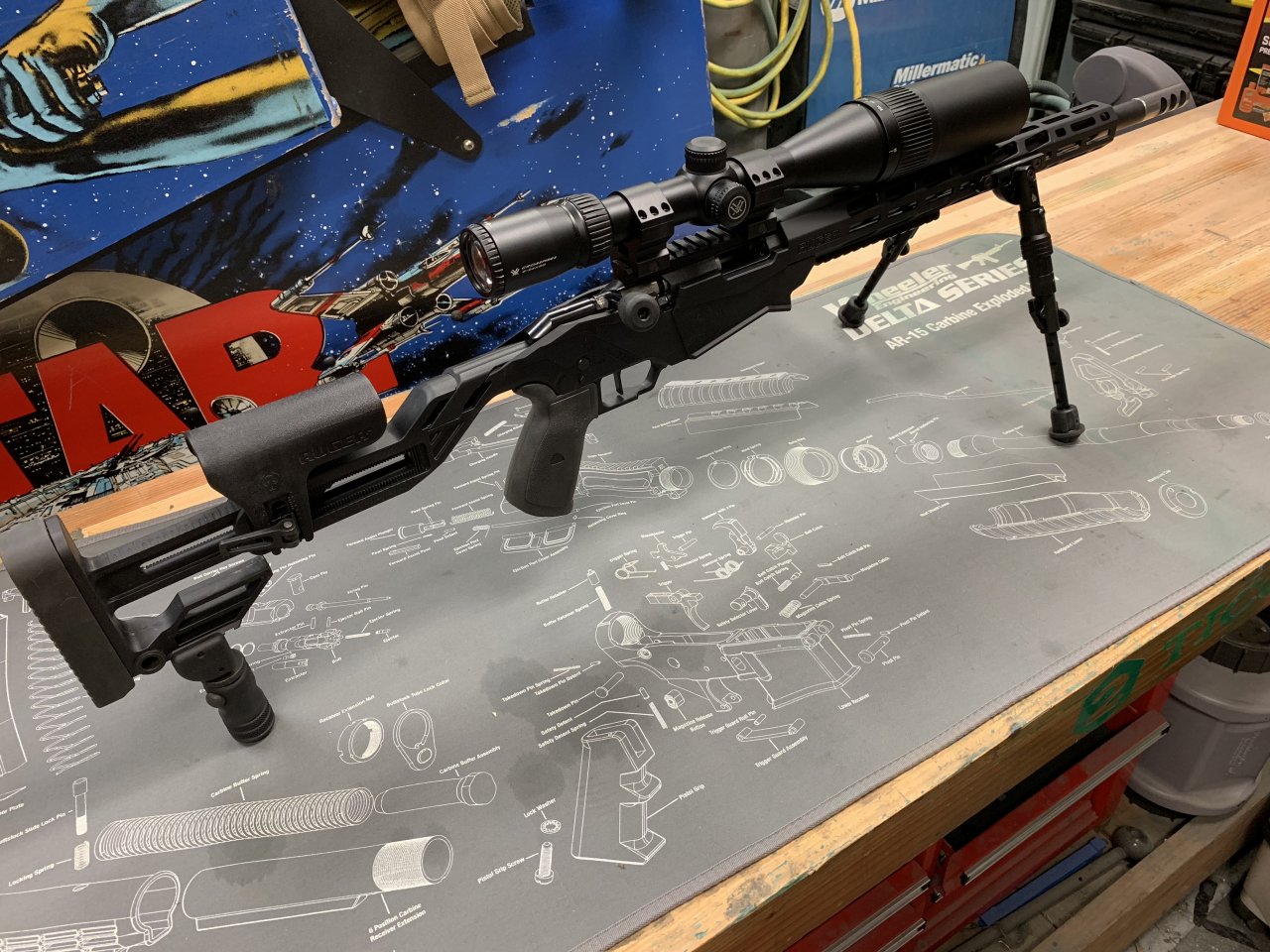

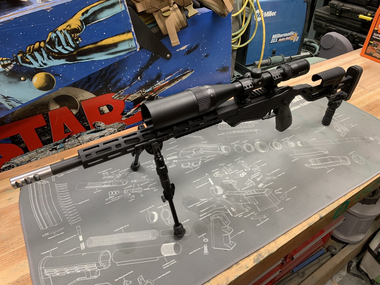

Overall I am happy with the setup especially for the price tag. I spent more time with this rig than my 6.5 this weekend because it was enjoyable. It really is a fine fun to shoot. And, I have never taken 22lr out past 150 yds.
Here is my setup. A couple of notes; I’m not a fan of UTG products but I do like these bipod legs. They are affordable, the design is novel (vs ripping off someone else’s design), they have a slightly wider stance than typical Harris style bipod. Most importantly, they performed well! The rifle felt stable on the bench.
I threw the muzzle break on for cosmetic value and to try and help trigger my lab radar. I was not able to get the lab radar to trigger and need to investigate alternate methods.
