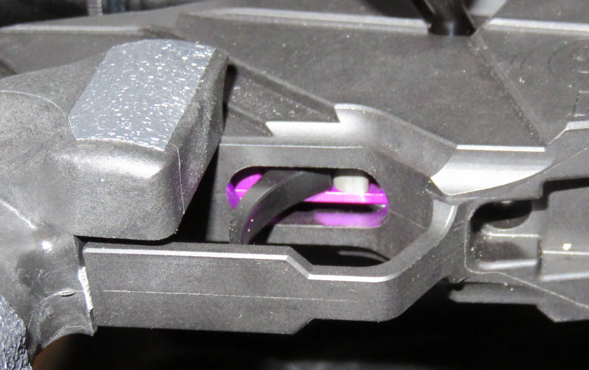

Timney was good enough to send me one to beta test a couple months ago. So, now I've fired it just over 1,200 rounds and it feels really good.

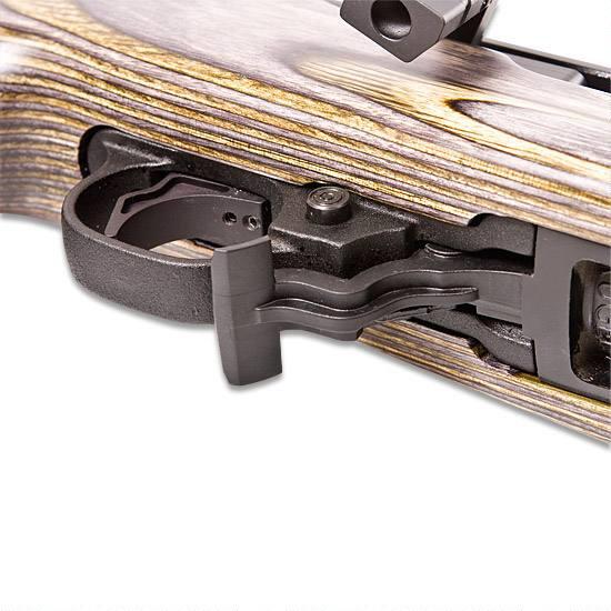

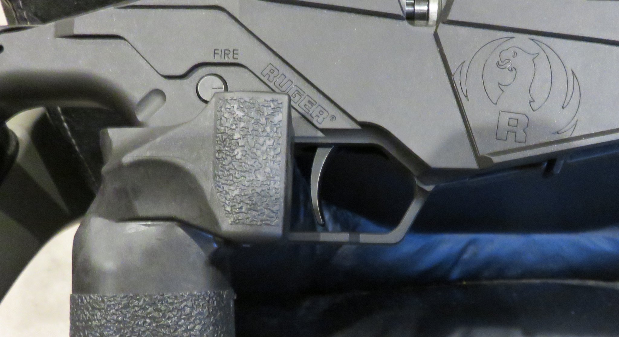

When I first got my Ruger Precision Rimfire I modified the trigger to 12 - 14 oz like I did on my .308 RPR to that the trigger would feel the same. And it pretty much was identical in feel. And I really liked that light trigger pull as it helped my with my consistency. So, I've actually been pretty happy with my factory triggers and wasn't really looking to replace them. But, I really wanted to try a Timney to compare with my factory settings to see just how much more of a difference there might be.
I was very pleased when Timney sent me a trigger to beta test in my Rimfire RPR and when I got it I play with the range in adjustment to see what the limits of that range was and how it felt at different setting. It came to me set at 1lb 5 oz to 1 lb 6 oz. So I began reducing the settings, first to 14 oz, then 12 oz, then 8 oz and when I went below 8 oz, it would no longer function. Then I went the other way going to 1 lb 8 oz to 1 lb 13 oz and finally to 2 lbs (which was 3 full turns of the adjustment screw from the factory setting) and beyond that 2 lbs it no longer functioned as it did when I went below 8 oz.
Setting it up at 12 oz to be pretty much the same as my factory trigger setting, I wanted to see just what difference I might feel. Dry firing a few times I switched back an forth between the two trigger to get some idea of the difference in feel. I found that there was a definite difference in favor of the Timney trigger, though I wouldn't say a great different at this setting. But I have a feeling that if one uses a little heavier pull, one would probably find a more significant difference. It did seem that the lock time was quicker with the Timney, but I really have no way to quantify that, so it really just a guess the way it felt. The Timney also felt just a little smoother to me and it breaks nice and crisp. . . as one might expect.

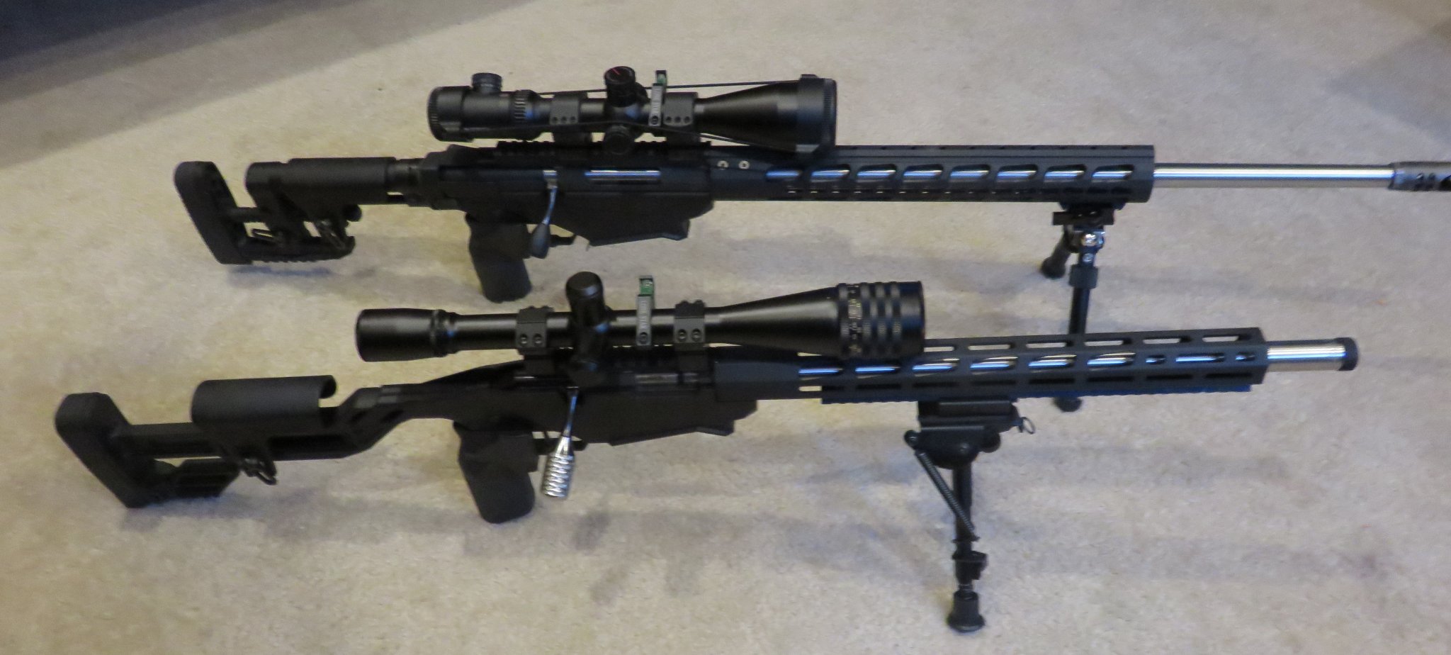

After doing some range shooting for a while with the factory grip and the Timney, I recently installed a vertical grip and with that along with the Timney trigger, I really like the feel and it's all really helped my consistency. When the weather gets better, I'm hoping to really run the system through its paces.
Great summary, defiantly looking forward to the final review, also is that an MPA grip on your rig?

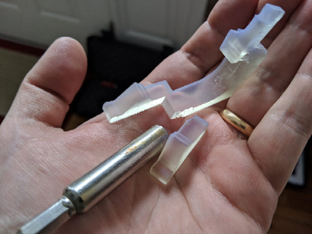

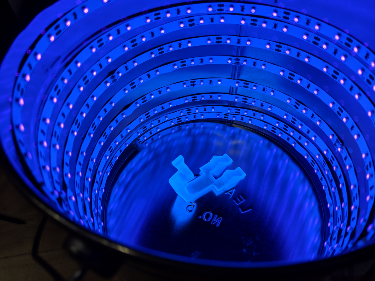

Here is my resin printed mag extender curing under ultraviolet lights. We added some slight reenforcment lines, but we are not sure this will be strong enough. Another one is going to be printed the regular way as well.
One of the guys in the shop told me about a site that will 3D print anything, in almost any material and its pretty inexpensive:
https://www.shapeways.com/create?
I'm having fun messing around witht he shop guys, but that might be an option for others without a 3D printer.

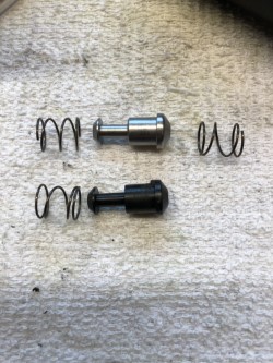

Parts from Kidd came yesterday and I got them in today. Using the stronger spring the amount of pressure required to start the plunger moving went from .75# to 1.75#. The OEM spring is shorter and of course a bit weaker. I did not test the standard spring that came with the plunger from Kidd.
Then headed
to the range for a quick lunch break shoot. Ran 3 10 round mags of Eley Club starting with a clean bore. Shooting 50 yds off a UTG bipod. Left to right in order the groups tightening up with a little fouling but I ran out of time. 104 rounds on the barrel so I expect it will improve a little bit. I'm having fun with it. Cheers!

I filed down the burr in my BETA Pita Sled, and I installed the stiffer magazine spring from KIDD. The sled is now a FIGHT to get out. It is very tight. No, I mean like HOLY CRAP I can't get it out! Until I figured out the best way to work it out repeatedly. So this is good. I'll test at the range when it isn't covered in snow. The 10 round mag is tighter. The 15 round mag... IS NOT TIGHTER. It made almost no difference in wiggle. IMHO, abandon the 15 rnd mag, and buy a few 10 rond ones and a sled. The stock mag is a lost cause.
I also installed my resin printed etended mag release. It fit perfectly! It worked perfectly! And then... I BROKE it! :( It was not weak, but my fault. However I didn't see a way around it. There is NOT enough space to get the torque wrench in between the finger release to tighten the action bolt to spec! I tried al sorts of ways. My options were to guess and hand tighten, or slowly try to work the extension bit in between the fingers. This put unplanned force on what I now see as the weakest part of the mag release extender.
7035894
Since we have the file for it, I may have the shop make some adjustments and reprint. I'll let you know. If anyone else has tried this extended mag release, how did you torque the action screw???

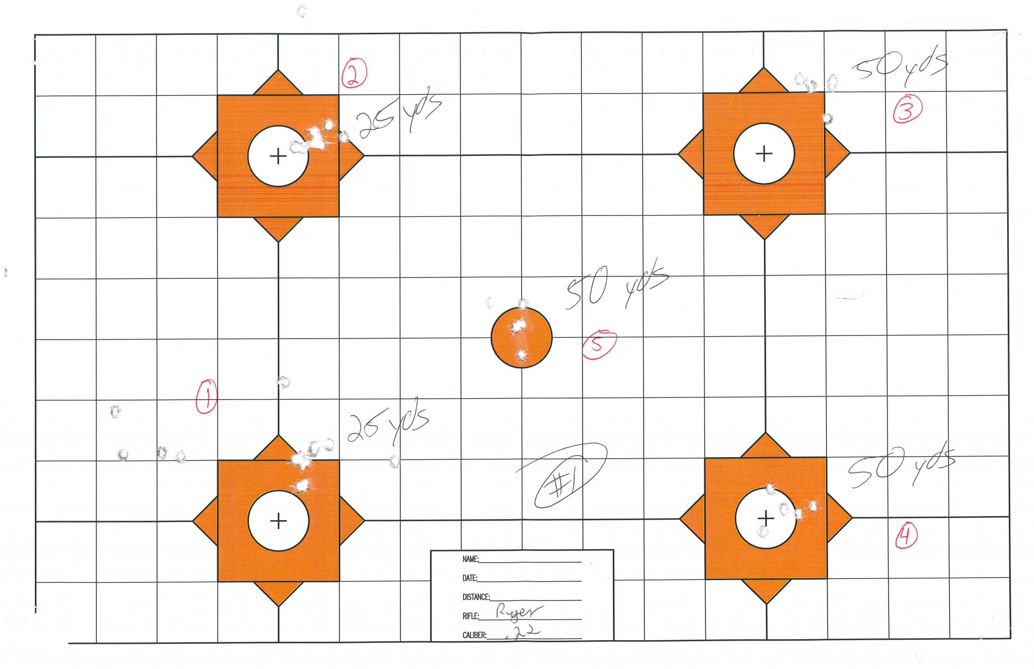

Upon sighting the gun in, I got a really good group once I got it zeroed (see 2nd group photo, target 1). I was pretty happy with that, however then I continued to shoot and noticed my groups opening back up and starting to string mostly in the vertical direction. I remember reading a few reviews of people that had that issue with the scope, so I instantly assumed it was the scope, took it off, sent it back, now I am waiting for my store credit which I plan to use to upgrade to the 1-6x instead since I have had such good luck with it on my remington.
In the meantime, I am not wondering if I made a poor purchase? I really did not want to spend $600+ on a CZ as I plan to do mostly plinking with this rifle, and if it shoots well enough, maybe some local .22 competitions at our range. It seems my action and everything is all tight, unlike some of the posts I have seen where people are doing bedding jobs and stuff. I live in NY, so I already have the 10 round mag that people have had better luck with it seems.
My question while I wait for a new scope, do these targets look like a rifle issue or a scope issue. I am hoping for the latter of the 2 because I really dont want to deal with the headaches others have had to deal with that I have been reading.

Thanks everyone. Your comments have been duly noted. As for your suggestions @DownhillFromHere , i will keep all that in mind as far as trigger control. I am by no means perfect with that nor will i ever be, however I can say i have good trigger control. I shoot a pellet gun in my back yard for training and do a lot of dry fire training with my pistol. Both of those should be helping. Pellet guns are much more finicky when it comes to gun holds, tigger pull, follow through and the like. The groups posted above are the worst groups i have ever shot from any gun at 50 yards, so something def wasnt right that day. Maybe a mixture of things such as a crappy scope, ammo choice and gun issues. Ill never know, but taking one variable out of the equation by replacing that scope is my first step. Ill shoot your guy a message though and see what he says in regards to scope options! Thank you!
I will say when I first got my RPR it drove me crazy, but I trusted Ruger because of the guns I'd bought in the 70" and 80's. The manufacturing quality is far from what it used to be.
First issue was it wouldn't extract reliably so I reworked the extractor which helped but it still required deliberate quick pull on the bolt to not leave a casing laying on top of the magazine.
I reworked the stock trigger to 1lb 6ozs, though it still has a little initial creep. I tested all types and 100's of rounds of ammo, with and without suppressor and thread protector, action torques between 12 to 34 in lbs all at 50yds outdoors. I shoot CCi SV, SK Std+, SK Pistol Match, and Lapua Center-X, though I've also tested Eley Tenex, Federal Ultra Match, SK Pistol Match Special, and SK Rifle Match in the gun.
I also smoothed the irregularities on the bedding block and magazine mating surfaces. It consistently threw a flyer. I only used 5 or 10 shot magazines.
I finally called Ruger and said this is not a precision rifle and shouldn't be marketed as such. Per SOP they sent me an RA and I shipped the gun back. It came back with a replaced barrel and new bolt. The barrel was scratched in two places and the machining on the bolt appeared it had come loose in the fixturing during machining. But the accuracy/consistency has improved though the ejection is still an issue.
I haven't put enough rounds through it to thoroughly test it, but it shows promise now...…. I bought a Vudoo so I can blame myself for poor accuracy now.
Last target, note this was CCI SV shot over SK lube which once fouled produced decent groups, then Federal Ultra Match over the CCI lube which didn't seem to care.
Disclosure - My primary intention for the RPR was to convert it to a .17 Mach2 for controlling and explosion of digger squirrels in the orchard behind my house, basically an effective field tool. I gambled on the fact that someone would make a barrel for it due to the design. I ordered a barrel yesterday and should have it in a couple days.
Bottom line, if I wanted it to be a .22lr precision rimfire I think an aftermarket barrel is required. My first reasonably priced choice would probably be Green Mountain.
The functionality of the design is very good IMO, sadly the execution of the build falls short.
Hopefully Ruger can get a group of executives that will restore their brand reputation. (y)
