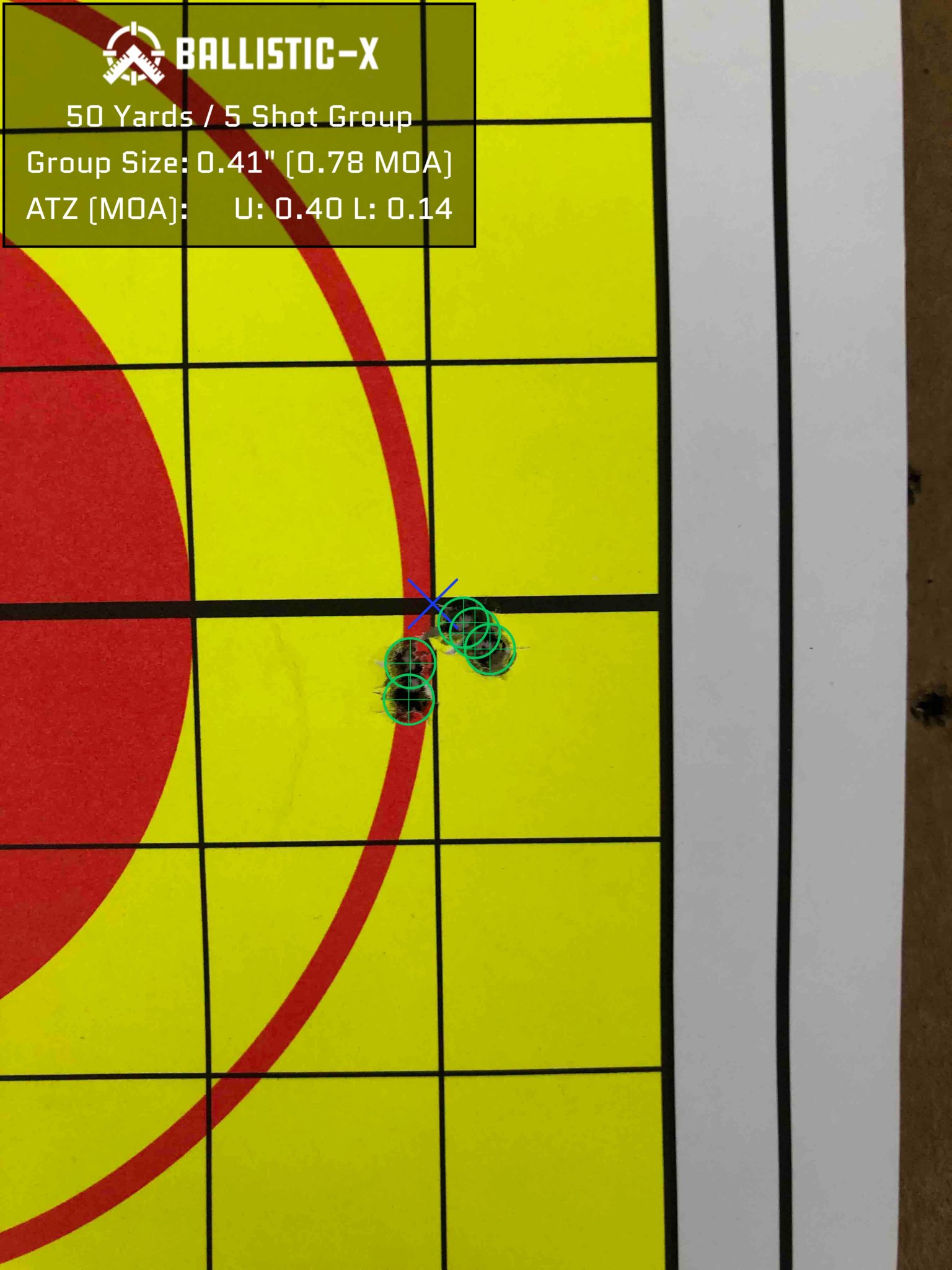

I hadn't shot the RPR in a while since the barrel and bolt were replaced by Ruger. My goal when initially purchased was to hopefully convert the gun to .17HM2 for controlling digger squirrels in the filbert orchard behind the house. Threaded barrel was mandatory so it took a while to find a barrel.
Before the barrel swap I shot the .22lr barrel one last time yesterday. A gusty 7-10+mph wind chill that made for sub 30's temp and an occasionally moving target stand.
Full disclosure 50yd target, 3 diamonds were shot with my RAR .17HMR, the other were the RPR with 3 different brands of ammo.
Stock trigger with some creep. Both rifles use Vortex Diamondback HP 4-16 scopes w/ BDC reticles.
The notes on target clarify the mess. But typically the two factory barrels I've had on the gun consistently toss a random flyer.
Before I'm targeted for sub 5-shot group, I had 8 rounds of SK Pistol Match left in a box so I chose 4 & 4 vs 3 & 5.
When I arrived home I cleaned it up and prepped it for the new .17HM2 barrel.
This barrel mount was a primary reason for purchasing the RPR and after performing the swap this afternoon it was a simple and quick swap. The rifle concept has potential, sadly Ruger's build execution lacks manufacturing attention to detail...… IMO. The flexi factory stock might be the weakest link in the design.
This design makes a barrel swap a quick and easy procedure.
Hopefully the .17HM2 barrel and ammo will produce Minute of Squirrel groups from 50-135yds and all will be good. (y)

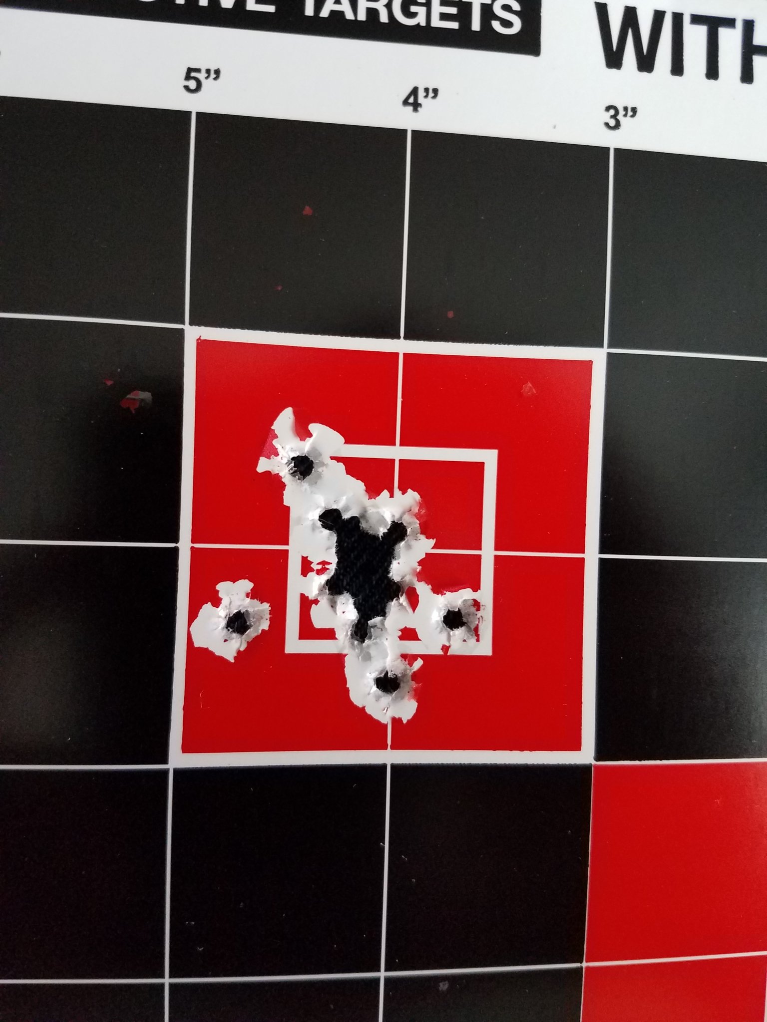

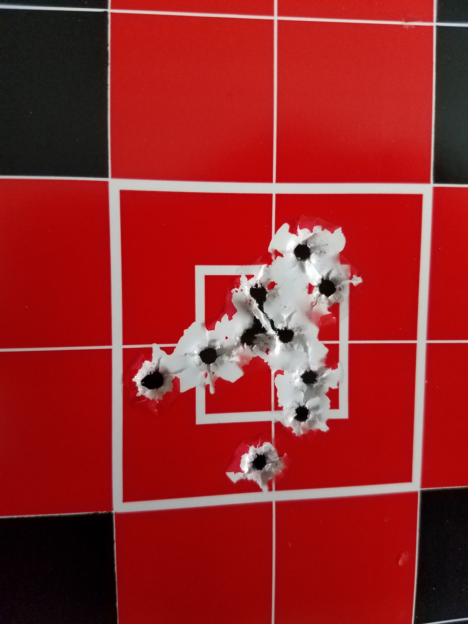

here you go YOU sumbitches!
Why not make it be required 10 shots? If you can't do it with a full 10 shot mag, keep trying. (Brand new 10/22 Competition w/Nikon 3x9 40 and CCI Mini Mags @ 50 Yards). Now, for most of you this might not be impressive at all but for me this is after a first trip to the range for a few minutes of fire - pry out the non-extracted case - reinsert the mag and repeat four times before quiting. So, for my first ever Ruger thingy - I'm pretty damned happy.

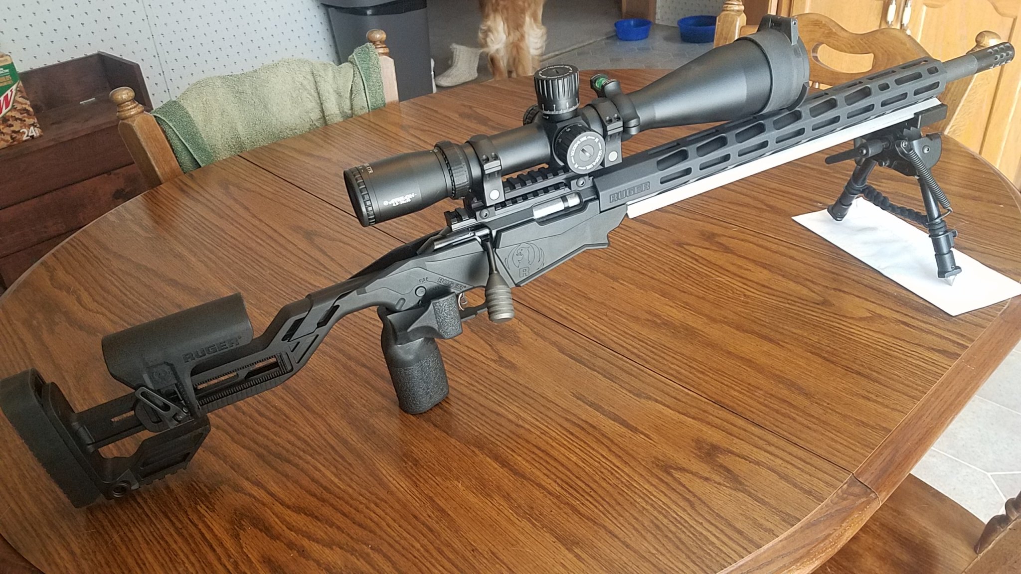

I have one of the first, if not the first 22lr RPRr barrel from him.
Bought it for the same reason (my boy needed a lighter barrel).
Only been out once and it shows promise but weather and schedule has precluded from testing more.
One thing to note is the theads on the barrel are too long if you use a SiCo sparrow.
My Tactical Solutions Axiom can fits nicely.
This was Sunday in challenging swirling wind conditions @100yds w/ Hornady HM2 17g.
Barrel has just over 200 rnds through it. Axiom suppressor, Magpul bipod, 16X Vortex Diamondback HP optic.
Action torque 22 inch pounds front and rear.
Barrel to action 35 ft lbs.
15 @50yds during initial break in.

Tried a few more ammo types today... basically what I listed above... CCI SV, FGGM, FGGT, Aguila SP, Aquila Eley Prime...
To be honest, none were horrible. Aquila "Eley Prime" was a ragged hole at 50yards, but CCI SV was pretty close to that as well. Both Gold Medal rounds (the older White box style, not the newer stuff) did great as well. The Aguila Super Prime was the worst of the bunch, but still not terrible by any means. I grabbed a brick of CCI SV at the range shop on the way out though :). (Limit 10 boxes, or I would have probably grabbed more). I also picked up some Eley Target that they had to try also, but really if I can group CCI SV like I did today at longer distances I prob won't bother with anything else, esp for the money.
Got home, tore the rifle back down - no issues, just wanted to do the foil bedding deal. Also torqued the screws to 20 in lbs, which is not very much at all. I am kinda dissapointed in the trigger though, low as I can get it is 2-6. I keep reading about all these 1lb + stock triggers but mine isn't having any of that. Still may need some more break in maybe. I also stopped by the Sporting Goods store again and grabbed 3 more 10rd mags - for $32 I figure might as well have a few more.
Here's the Aquila "Eley Prime" on the left - not sure exactly what it is - I assume Aquila branded Eley or they licensed the name maybe? Anyway it shot great, but I think it's discontinued - now they only list Aquila Prime. I can get more of the older stuff, but it's kinda spendy compared to the CCI.
