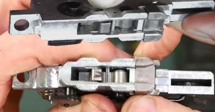

Just a note that the Ruger American Rimfire, Ruger American and the RPRs are all different triggers on Timney's website. The RPR rimfire is not listed.
Ruger American Rimfire: Trigger housing stamped RF - differnt hole paterns
https://www.timneytriggers.com/shop/Assets/ProductImages/640R-1.jpg
Ruger American - Ruger Predators, Ranch, Crossfire and compact: Trigger housing stamped CF - differnt hole paterns
https://www.timneytriggers.com/shop/Assets/ProductImages/641C-Front.png
RPR Centerfire: Completely different than either of the above
https://www.timneytriggers.com/shop/Assets/ProductImages/650-Front.png
Don't have one, but the sources I trust from SHOT are saying it is not the same as the RPR.
They are indeed very similar and will likely operate/feel exactly the same, but RPR triggers won't drop in. If the one in video is a production version.
Go to 3:15 of video, then compare to timney trigger. Notice the front edge by the screw hole. Rimfire is notched much further back vs RPR.
Thats what I expected as the bolts are small on the rimfire. But no harm in trying.. I could not find any info on them.. but of course, I didn't search you tube.
I really appreciate the help thanks! triggerS usually can get wacky with to much work these are very different - To bad Ruger didn't make it clearer.
Posted your screen shot next to an RPR (I've never seen and RPR trigger)
Thanks again!

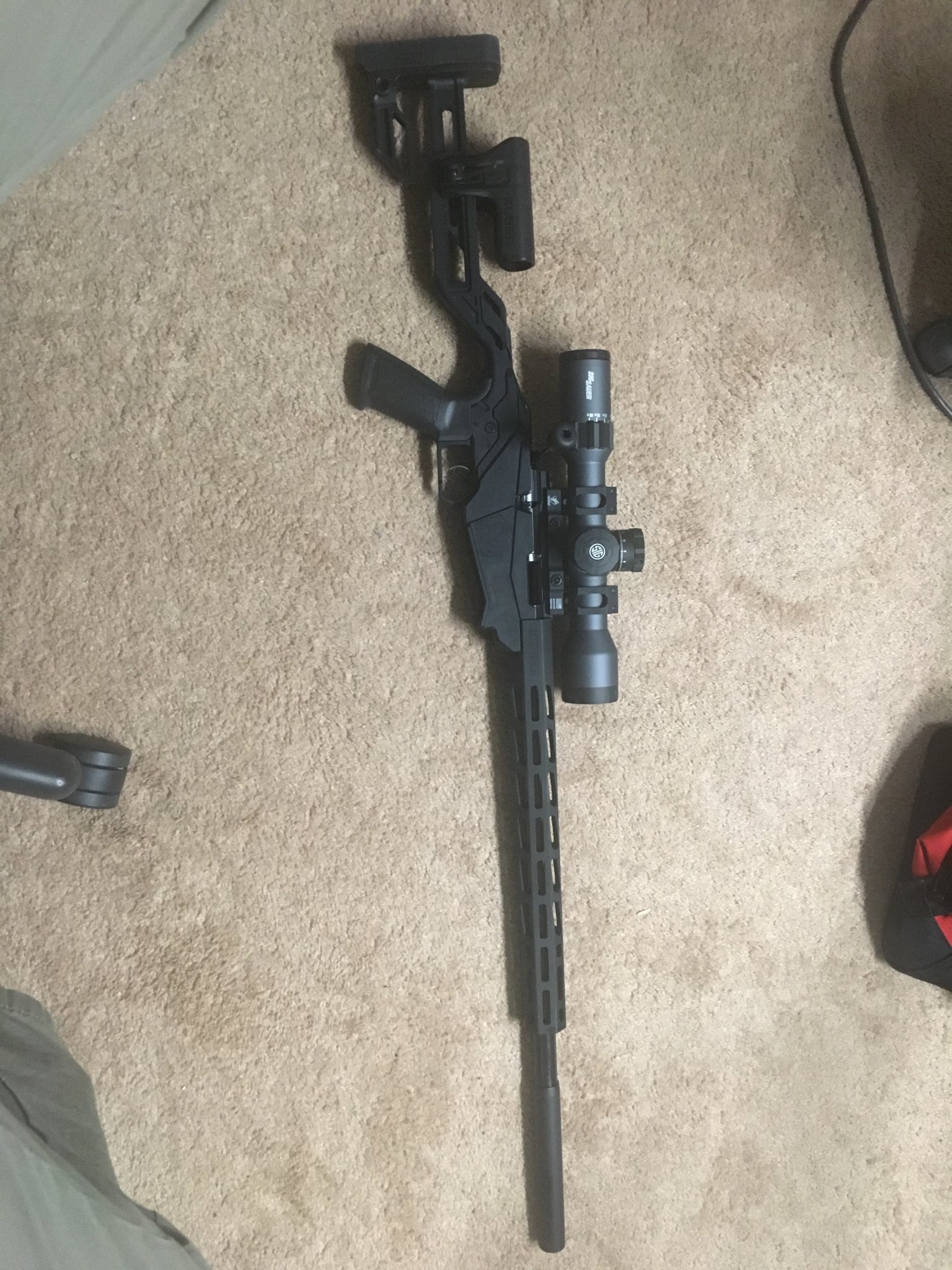

Last night, my dad sent me an email inquiring about the RPR Rimfire, which I hadn't seen yet. It just looked like a great rifle, especially since it is modeled after the RPR. So I went skiing today, and on the way home, I stopped at Kittery Trading Post. When I picked up the rifle and pulled the trigger, I just had to have it.
An issue I have with the rifle is that the rail is smaller than average, which makes it tough to get the correct eye relief. Even mounting all the way to the front, I am too close to the ocular unless I rest my cheek all the way to the rear of the comb. I think they should have made the stock another couple inches aft, and extended the rail another couple inches forward. So I would recommend to anyone getting this rifle to use a cantilever mount if you can. I tried a Hensoldt in a Near mount, but the 56mm objective was too big and the bell was pressing on the aluminum handguard. The next thing I tried was a Sig Tango 6 3-18x44. Scope had no problem with clearance, but the ocular was too close and the mount had 20 moa in it. Combined with the 30 moa rail, I would probably not be able to get a zero at a reasonable distance. So for now, I am using an aimpoint in a cantilever mount with a magnifier until I decide on a new piece of glass.
The trigger is super crisp, and the gun feels really good, even holding offhand. I shot a few rounds of CCI Quiet ammo with the muzzle indoors out a window, and the report sounded like a loud snap of the fingers. Outdoors, you would barely hear anything at all. Oh, that's with a TBAC 22L-1.
For the guys shitting on this gun prior to actually handling it, I advise you to at least handle it first. This is a $400 piece, and obviously can't compete with some of the shit posted earlier in this thread. Some guy said (paraphrasing), "don't get the RPR; save up for a 'vudoo'". First of all, stop please. I know there are plenty of guys other than me who aren't quite ready to drop over 3K on a 22 rifle. The rifle has its limitations, but again, we are talking $400 here.

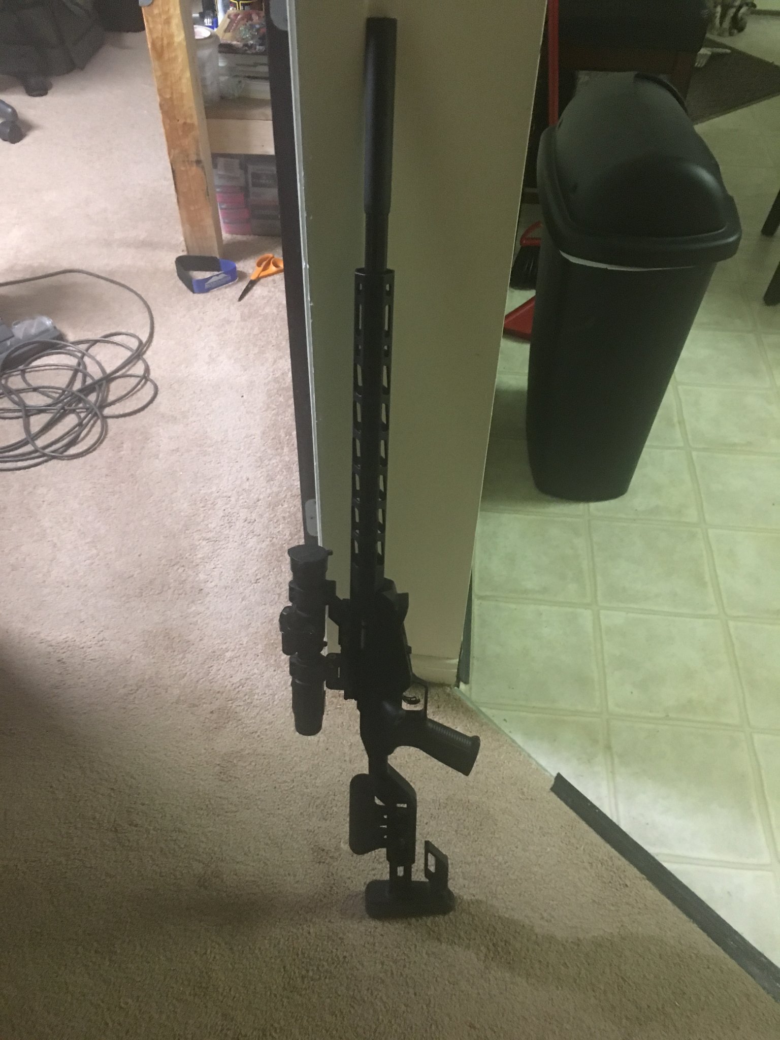

I brought my RPR home today. I tore it down for a thorough cleaning and also hosed down the trigger with some cleaner/lube. I checked it after I got everything back together and it drops at 1.5 to 1.7lbs. This is straight from the factory with just a flush job.
Solid
