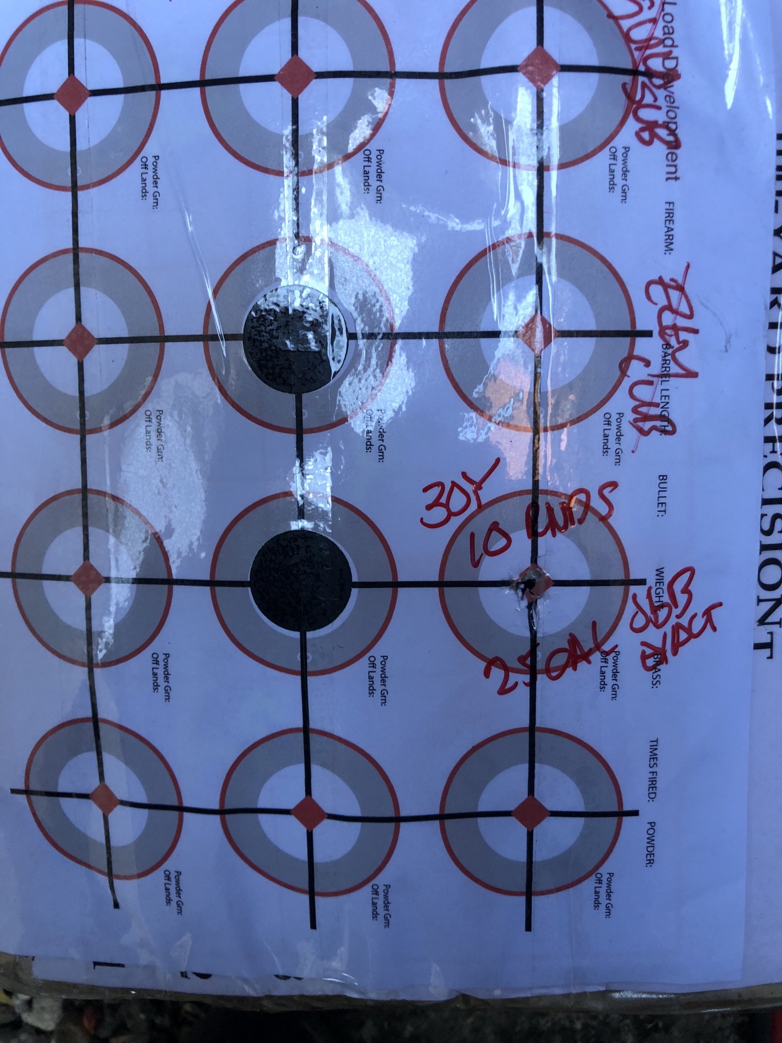

Btw all this 22 grouping stuff including the images I posted had we wondering if I could just use my PCP air gun.
I got the absolutely NOT from our guy that is running the matches.

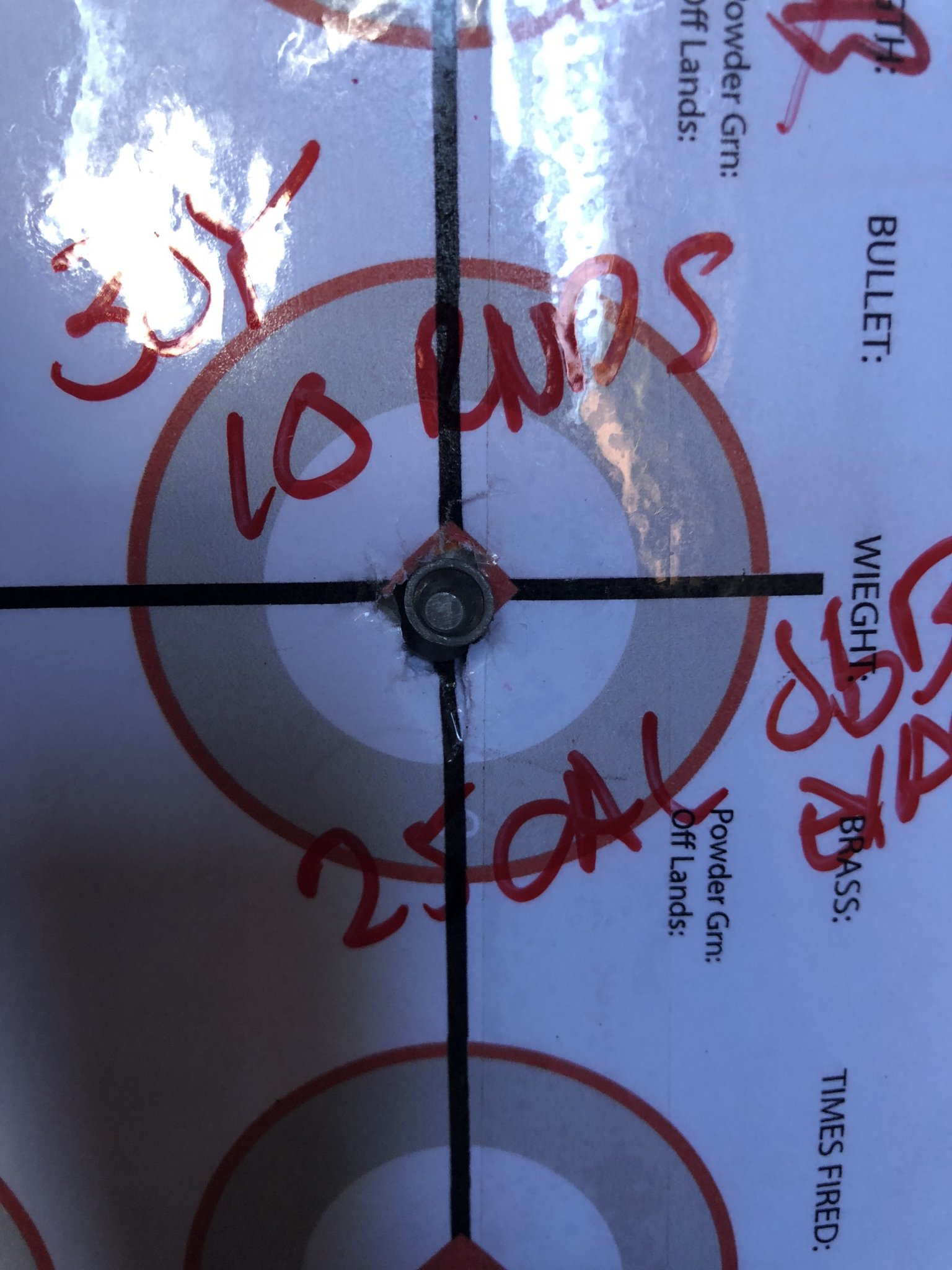

It has been a while sense I shot my PCP, all I have is 30y set up at my house.. but here is the first 10 round group. I forgot how great these things shoot.. I have been only using it for minute of crow.. lots of crows ;)
Close up with pellet in hole for scale.
bipod— prone .. obviously wish the RPR was as accurate..

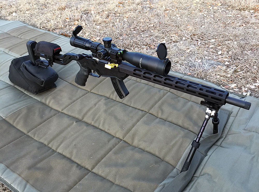

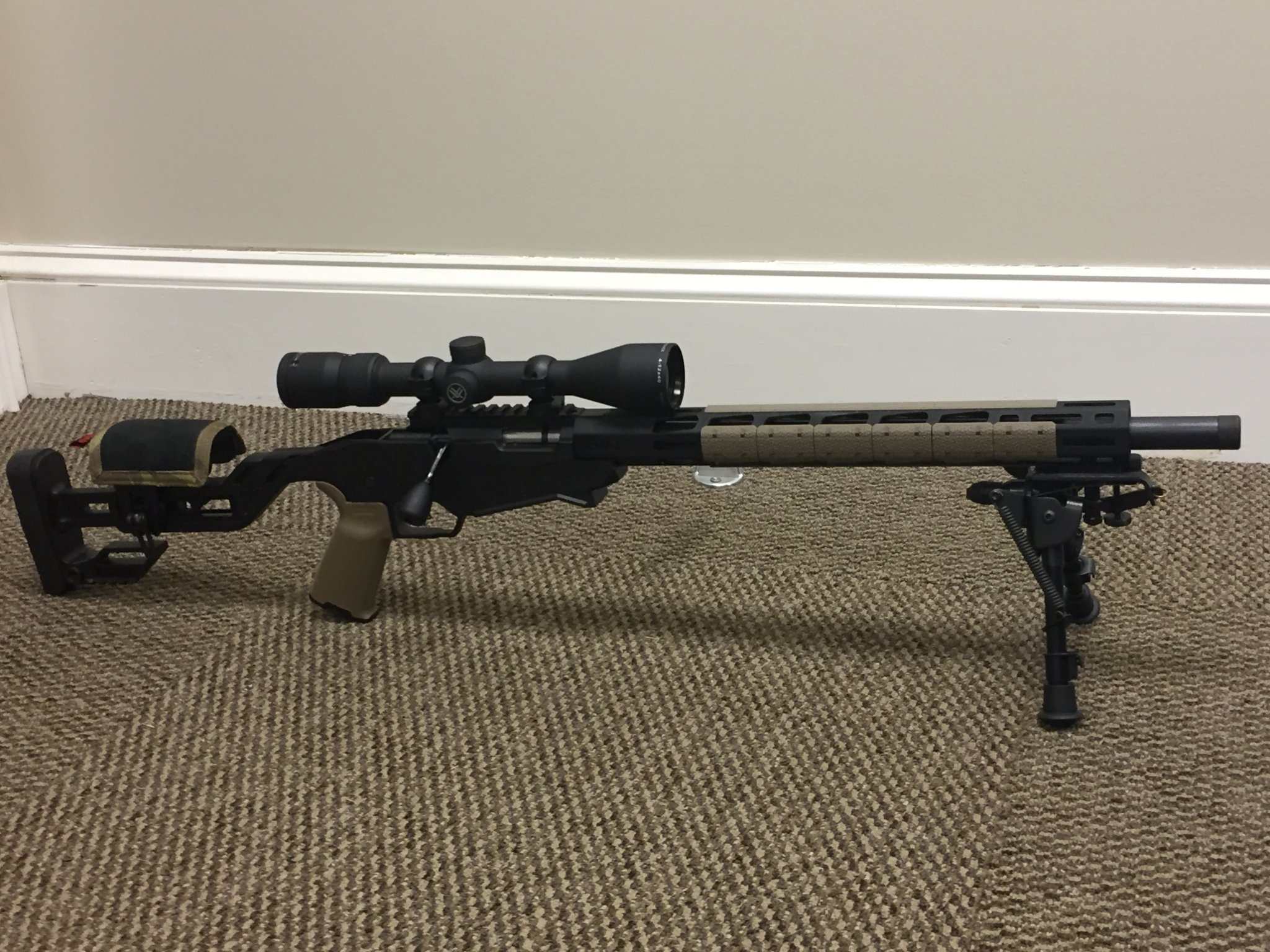

Got mine out today and put some rounds through it.
Ergo grip
Wiebad Cheek pad
SWFA 3-15x42mm SS
Cheap Chinese knock-off bipod (more on that later...)
I did a light fire-lapping of the barrel. I had previous good results from doing the same on my Ruger American rimfire and Ruger Precision 6.5cm, so I figured what the heck. I'm not sure how much it helped, but I don't think it hurt anything.
Cleaning and adjusting the trigger, the pull reads 1.5lb which is below what Ruger specified, but I won't complain! I like the feel of it. It is a significant upgrade over the trigger on the Ruger American. At least it feels that way to me.
I did have trouble with my scope and rings getting the proper eye relief at the LOP I would have normally like to set. I had to extend the LOP a bit which ended up feeling fine so I'm OK with that. I did have a feeling at that point that my cheekbone was hanging off the back edge of the check rest so I removed it and flipped it around backwards and that fixed that.
I also was not thrilled with the stock bottom. RPR has the same flaw. There is just no comfortable place to grab hold there. I might cut a piece of rail cover to fit on there to ride the bag, or maybe try a monopod again.
My biggest problem was with my cheap Chinese bipod. It's well made, but it was too short. I was having to lie lower than was comfortable. It fact I was pretty damn uncomfortable. I'm not as bendy as I was in my youth and it put my neck in a bad place. I have an Atlas on my RPR, so I guess I will swap them and share. That would have been much better. I felt it definitely was hurting my groups. (yeah, thats it!)

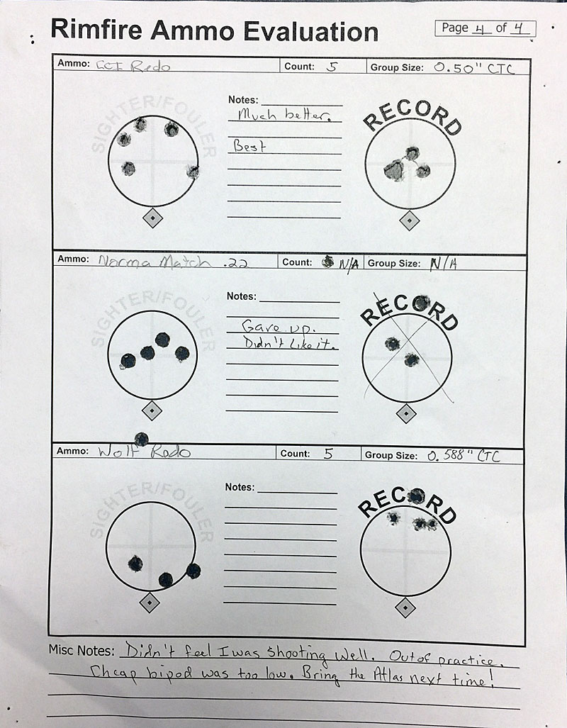

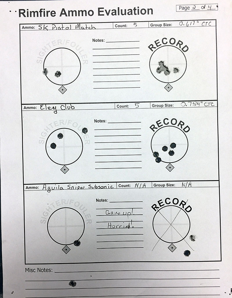

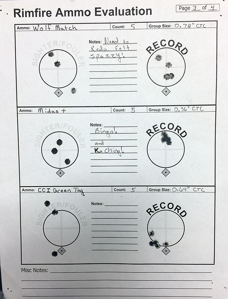

Now, I'm just a casual, hobby plinker. I've never competed, and don't plan too. Still I really felt I could improve upon these groups. I felt like a large part of the group size was purely due to me and my discomfort. Once I get my ergonomics squared away, I feel this rifle will shrink the groups further. So don't over over judge the rifle by my spazzy trigger pulling.
So here are my groups (don't laugh!):
I did a redo on the CCI SV on the last page. I didn't feel I had given it a fair chance. I think with a more comfortable shooting position, I can shrink these groups another 25%.
I think the CCI SV is going to be my best bang for the buck. I might keep a brick of Midas+ around for days with zero wind, when it is really worth it.
$0.02.

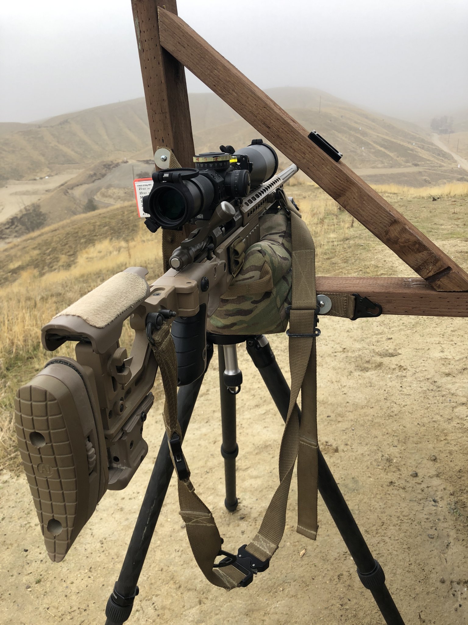

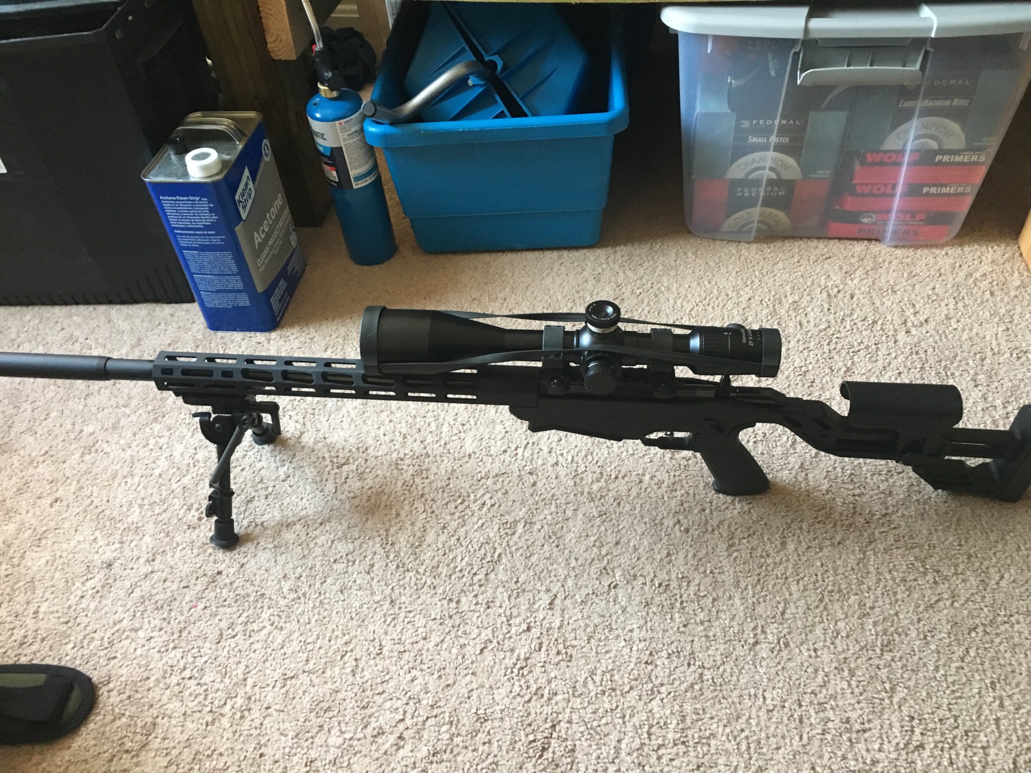

Looks like I spoke too soon. Found some higher rings laying around and I was able to get my hensoldt on top. Eye relief seems ok so far

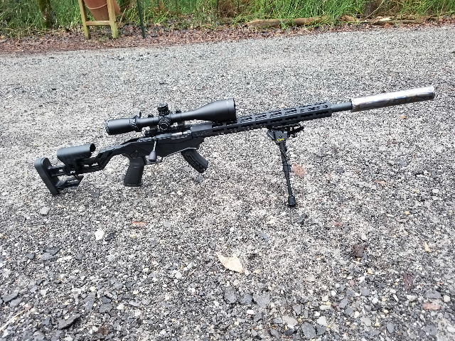

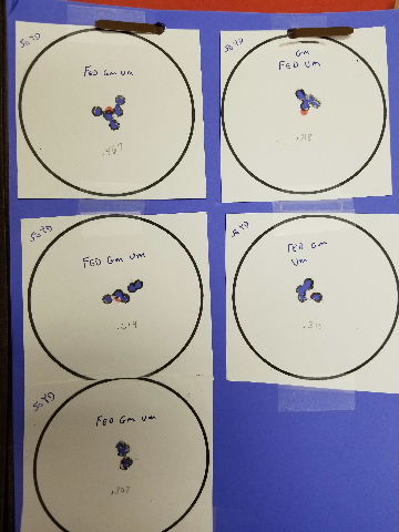

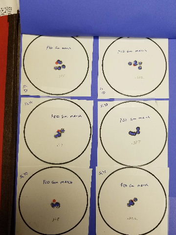

Went and shot 15 types of 22lr this weekend, will do more later.
The RPR rimfire loves Fed gold metal Ultra match and Fed gold metal Match.
50 YD 5 shot groups from .387 to .198( the best of the day was Fed gold metal Match).
Fed gold metal target, CCI std vel, CCI sgb, Wolf match target, PMC moderator, Geco 22 sa, CCI suppressor, Norma Tac 22, RWS target rifle, CCI green tag, Fed auto match, Magtech 22 sv. American eagle suppressor all shot 3/4 to over 1 inch.
The wind picked up and could not do any 100 yd groups.
Picked up some different Eley ammo this weekend to try later.
This rifle will shoot, you just have to find out what it likes
