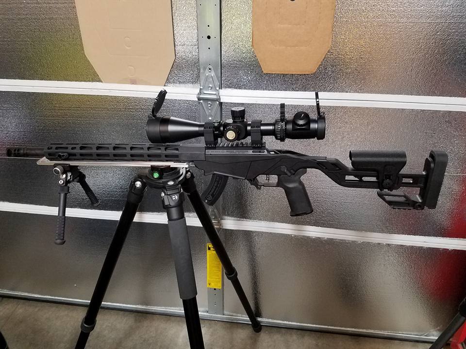

Got the range today with my birthday present to myself, ran 7 different rds through it. With Center X being the best so far. I couldn't seem to get a good sight picture today, it felt like the reticle was moving around inside the scope. But the results are in the pictures below.
1520103295619646328446.jpg15201033430631348339888.jpg15201033789902077621972.jpg1520103419038923828898.jpg

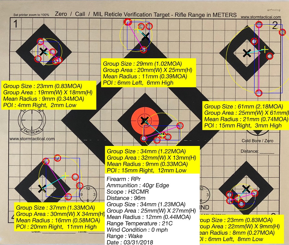

Received the RPRF yesterday and directly went to the range. Not bad with ELEY edge at 105Y indoor range. I believe I can do better if I dial down the weight of trigger pull a little bit.

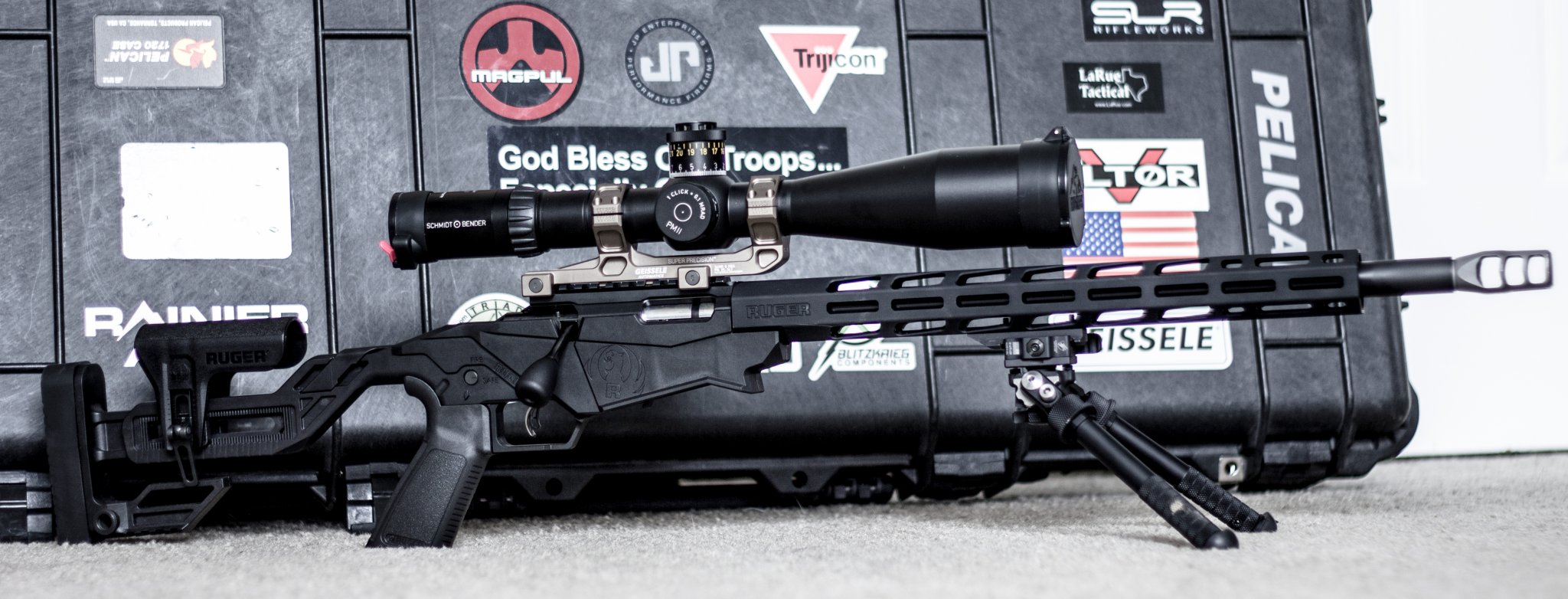

Jesus you aren’t kidding around with that scope setup with the geissele
