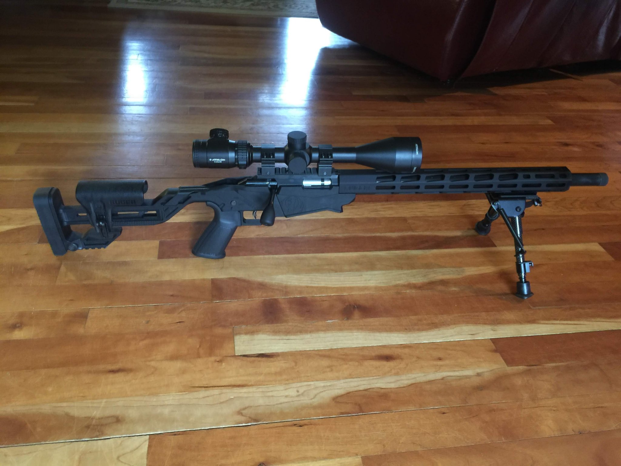

Well got a new 5-20 scope mounted and put back on the ergo grip.

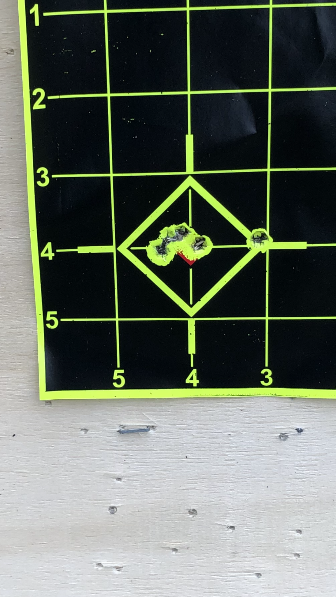

Here is one of the better groups of the day
wind was horrible. At least 10mph constant and 20-30 gusts. Didn’t stay too long because it was blowing sand and dirt all over us.
