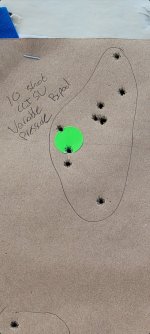

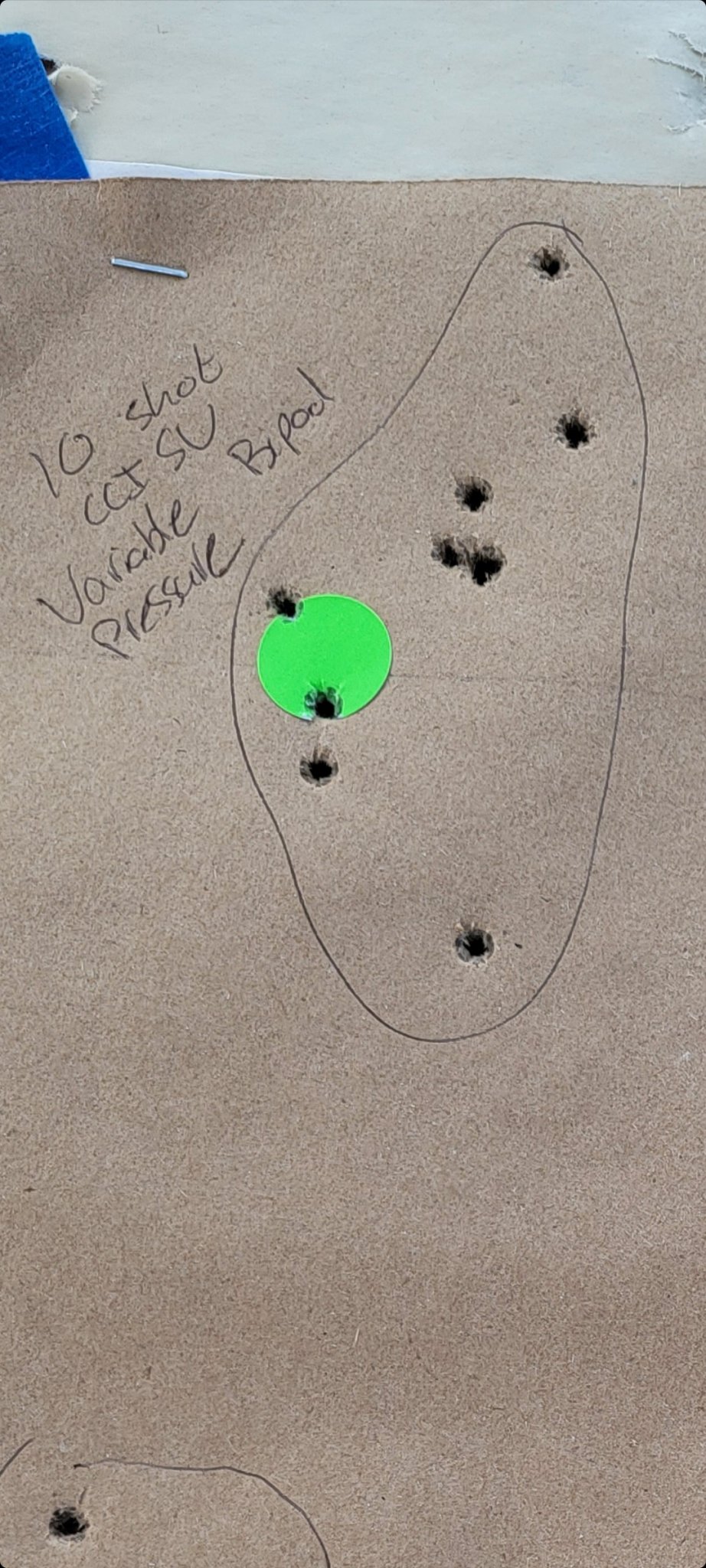

It's just frustrating when very very minor changes in pressure on my bipod can lead to this much variance at 100 yards. It's not confidence inspiring for little 1.5" NRL22 targets at 100. Well see how the NRL22x match goes this month.

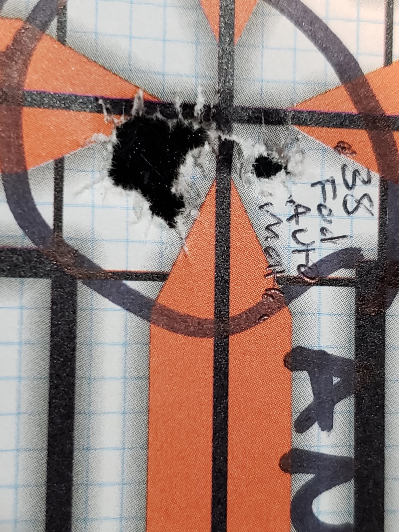

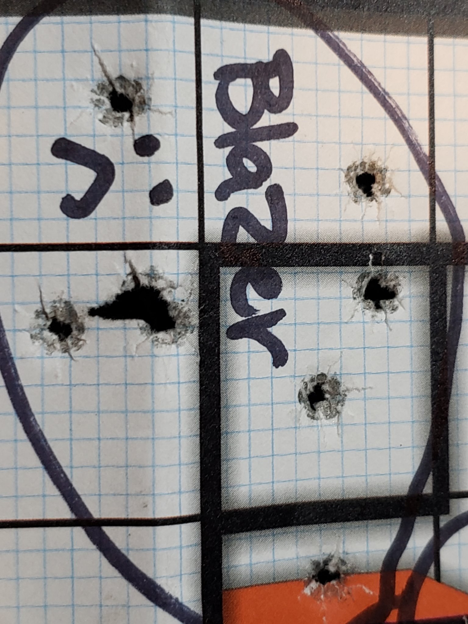

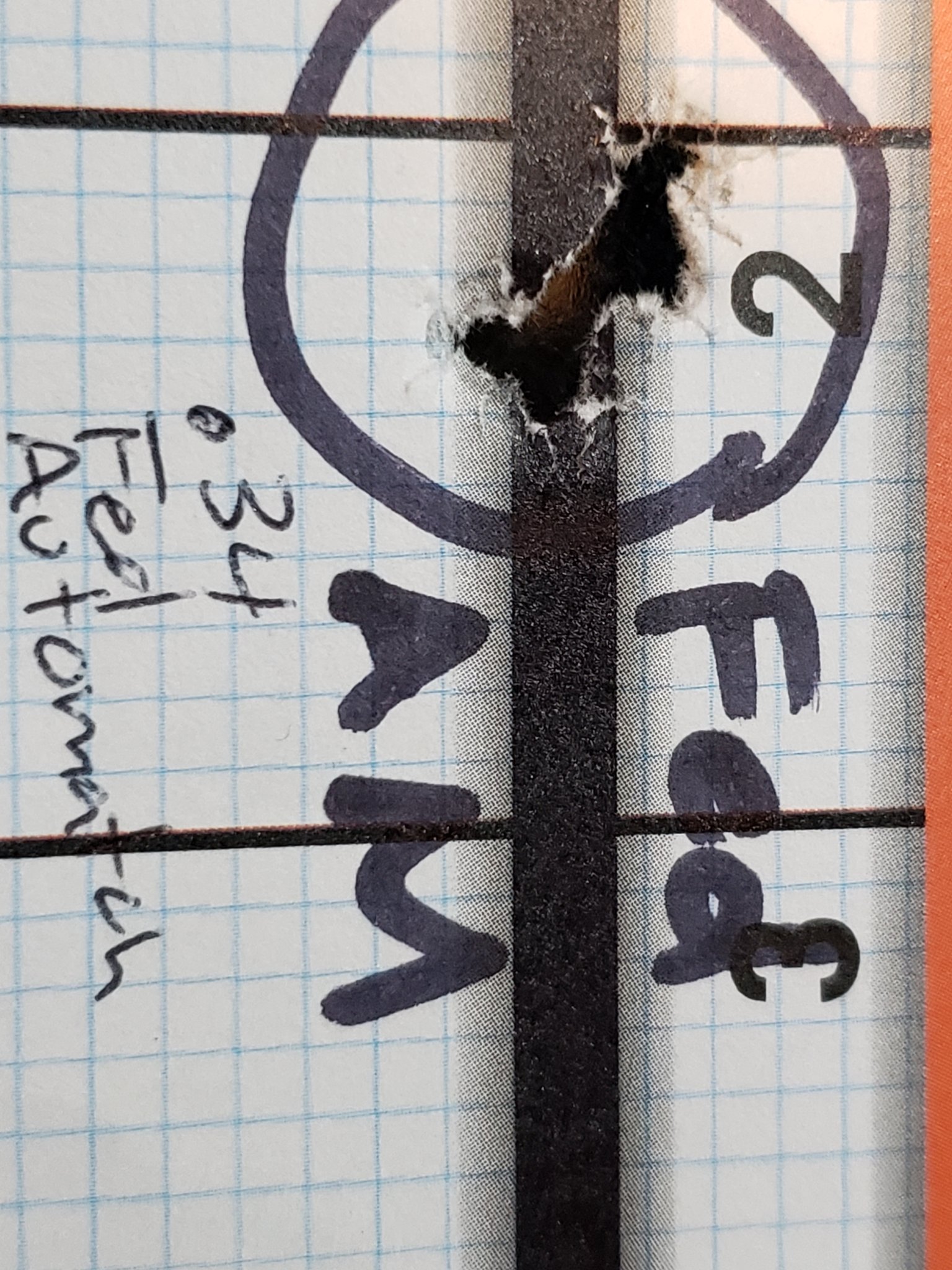

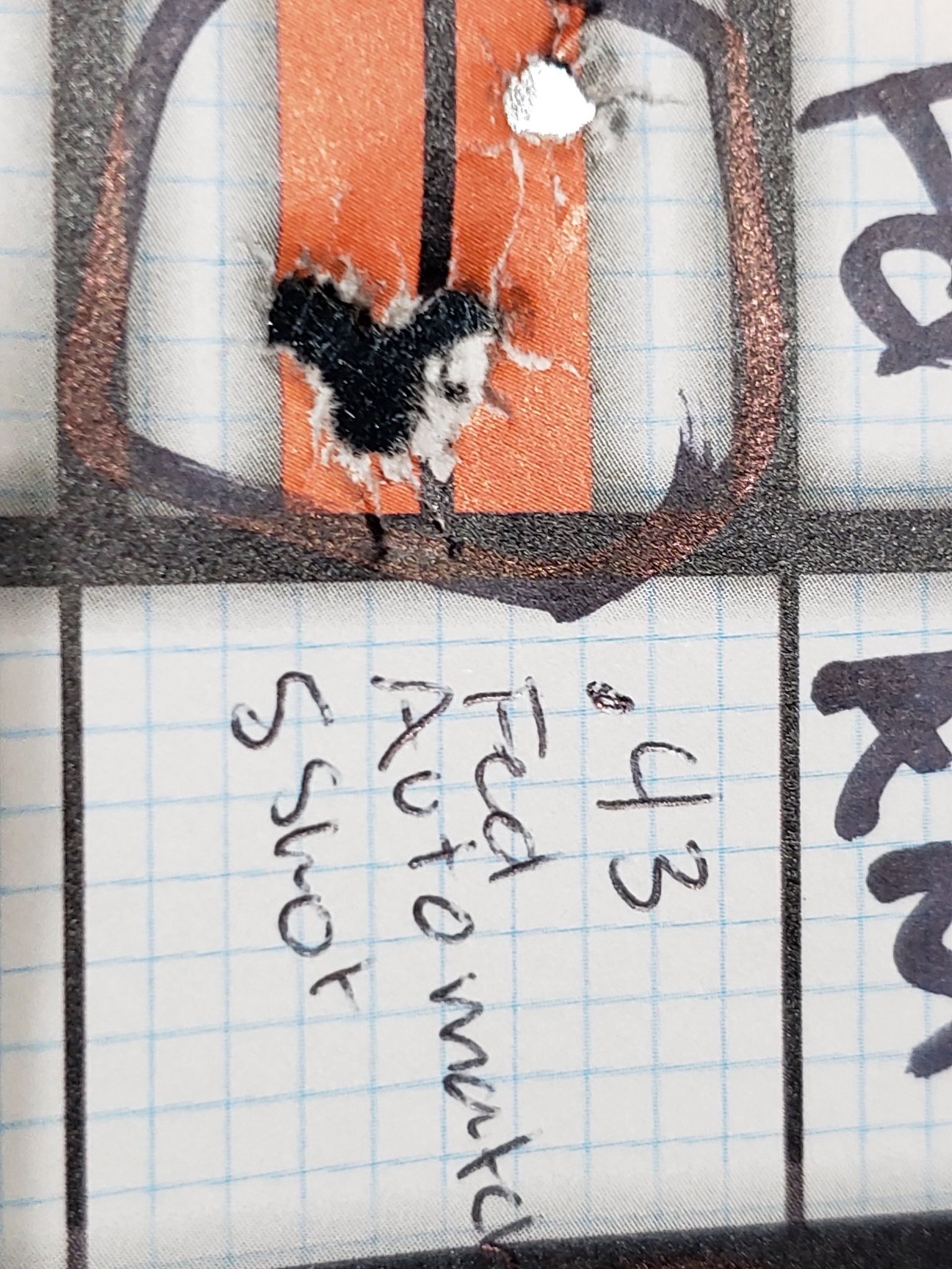

I went to the range this morning, no one else there, I had the whole place to myself for 3+ hrs, got there at 5 am and left at 8:30 am. I shot 4 rifles, the RPRF, RARF, a Winchester Wildcat and my trusty Remington 510 Targetmaster.
I shot 10 targets with the RPRF, (2) 100s, (3) 99s, (2) 98s, (2) 97s and a 96, for a total of 982 out of 1000 or right around my current average of 98.2%. The RARF was 97.2, the Remington was 97.6 and the Winchester was 92.8.
So I blew through roughly 600 rounds, all in all, except for the Winchester, a real good time.

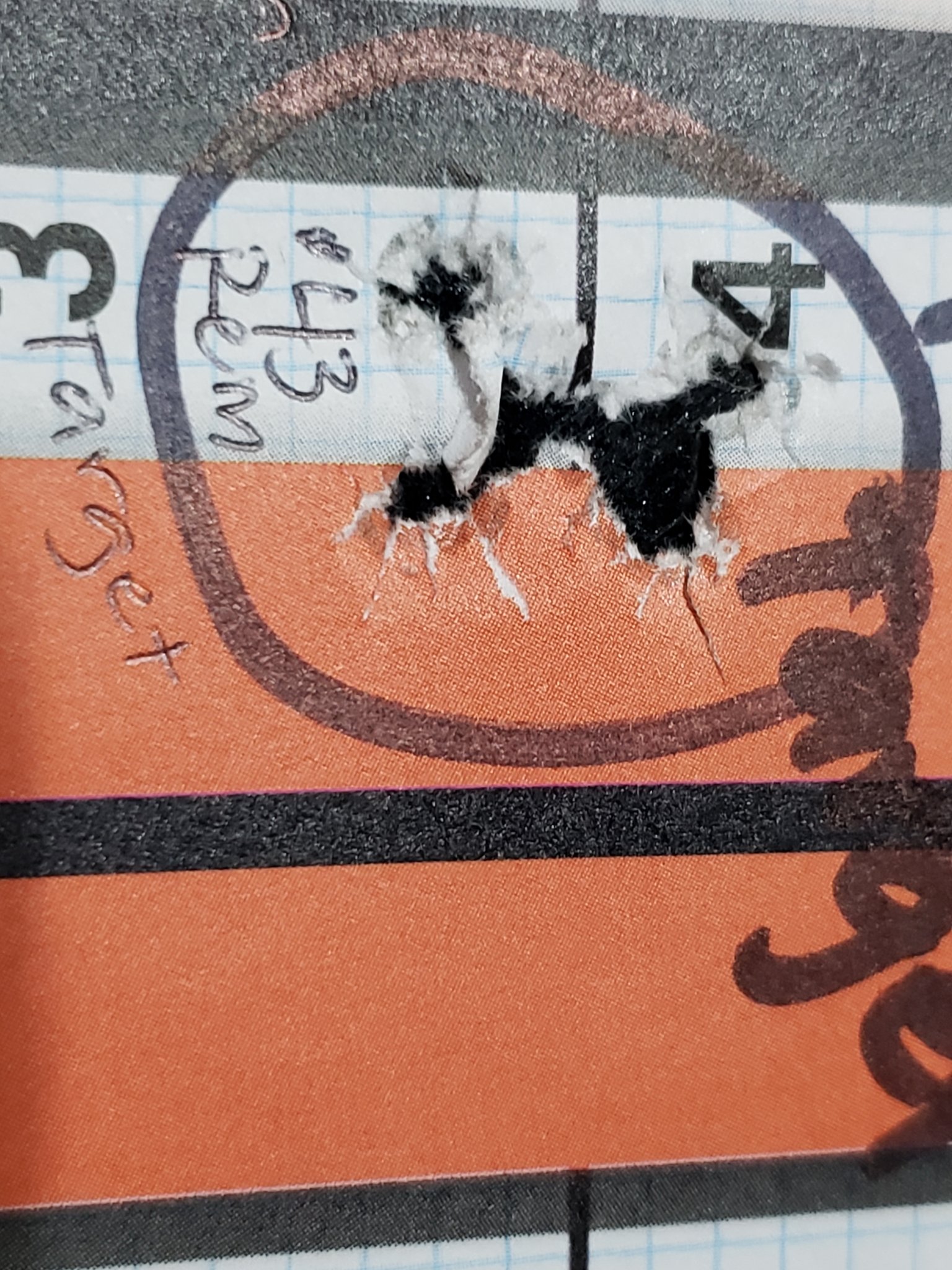

Hey all sorry to revive an old thread but my RPRF seemed to have acquired accuracy issues, like bad. It used to shoot 3/8-1/2" at 50 yards. at that point I really liked it, was having no problem hitting steel at 3-400 yards.
I hadn't shot it in a few months and decided to bust it out, before heading to the range I decided to swap out the shims in my Burris signature series rings to give the scope more angle to maximize my amount of dial (athlon Talos BTR 4-14).
At this point the rifle shot about 2" groups at 50 yards. WTF??? I took the rifle home and checked all the fasteners but nothing was loose so at this point I cleaned the barrel, not completely but ran a few patches. shoot it again, no change. Well maybe something is wrong with the offset shims so I switched those back. I just got back from the range and no change. any ideas?
maybe I should clean the barrel completely and start fresh.
It sounds like it shot great, you messed with the scope and now it sucks.
I'd put the old scope with rings and no shims on it and shoot again.

it's not shims under the rings. They are the Burris Signature rings that have the alignment inserts that allow you to tilt the scope, at any rate the last thing I did was put it back to the way it was when it was shooting good and no change.
Planning tomorrow to take a scope off of a different rifle and try that. Maybe the scope went for crap, kinda hard to believe since its only ever been on this gun and maybe has 1000 rounds on it, stuff happens tho
I will also note that I did try some cci velocitor ammo just to see how it grouped (I think this was the first ammo I fired before realizing the eley stuff that I was shooting wouldn't shoot neither)

everything torqued to spec, action screws. rail, bases, caps.
I can't verify it's the same lot as before but we aren't talking moderately poor groups, I could shoot them out of a sling shot more accurately than this.

I bought this rifle second hand last year so I don’t have the manual but the bore looks fine
Well some say you never clean a 22 and there are all kinds of reasons, my Tikka shot great and all of a sudden my groups doubled in size and I’m like WTF! I found a article that recommends cleaning 22s every 400- 500 RDS so I cleaned it well my groups came back! Now I clean every 300 or so rounds and run one of the most accurate 22 rifles at the club
I deep cleaned it last night, I’m gonna try and shoot it this afternoon. I’m going to take another scope with me also and swap that at the range if it still doesn’t shoot

I would bring a torque wrench with you as well and play with the torque on the action screws
Ya I put it in my bag for scope mounting. I know tuning with the torque is a thing but again, even if it wasn't tuned that way should should better than this. Also yes it has a flash hider on it, I'm not sure if it came on there or if the previous owner put it on but I have never removed it.
If you cleaned the barrel with no change, then the scope/rings are suspect. That's the one thing you changed.
