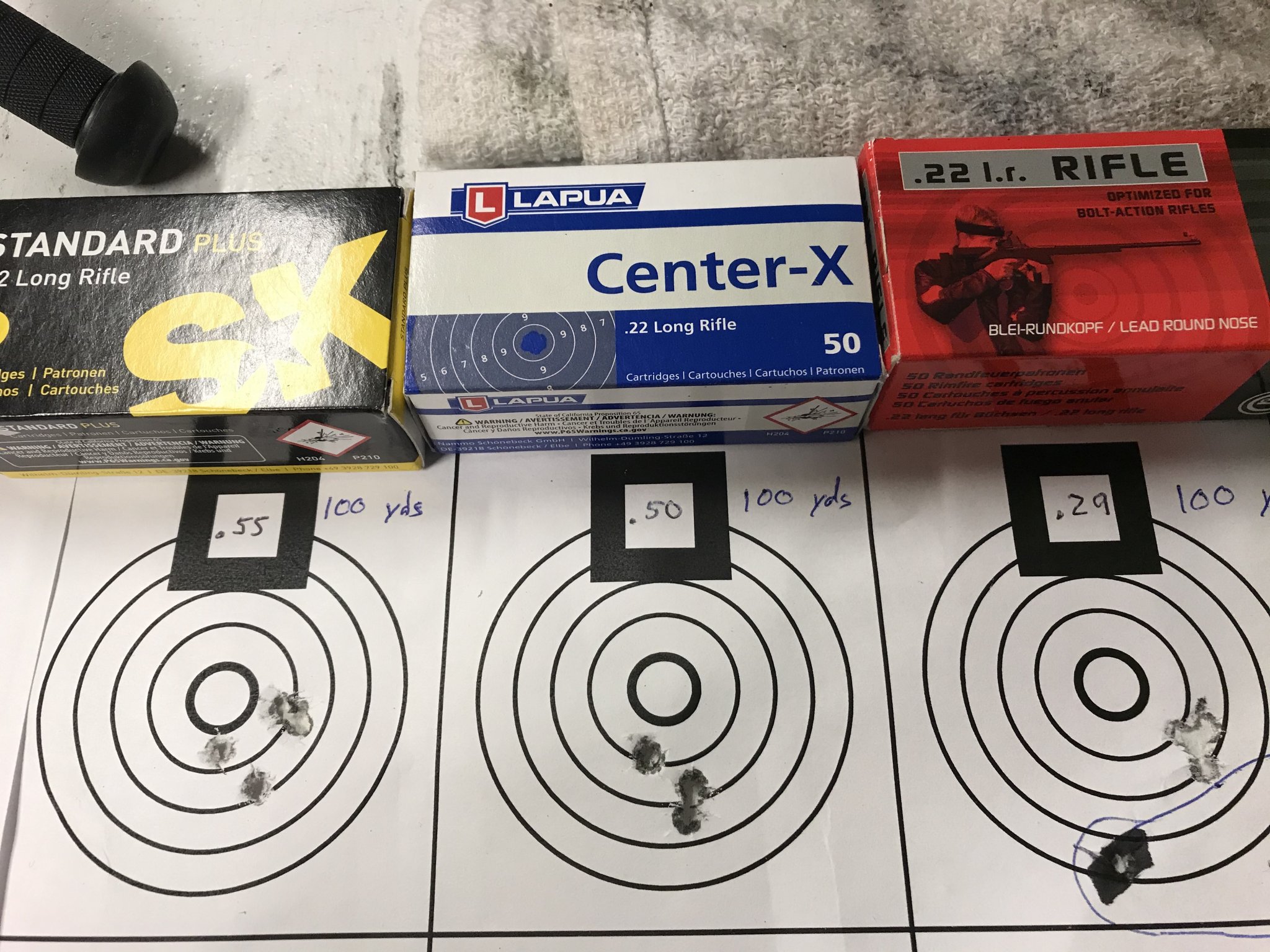

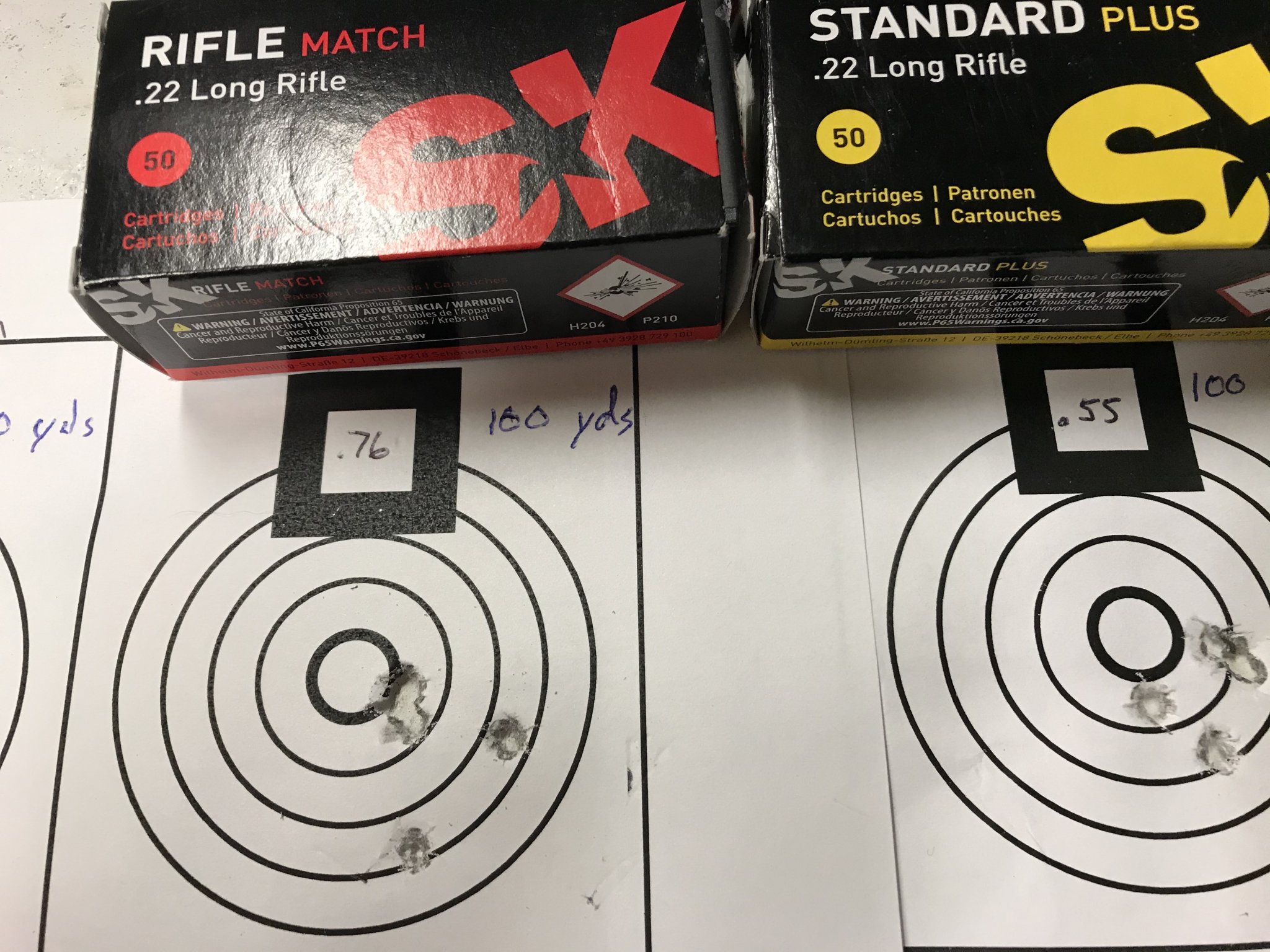

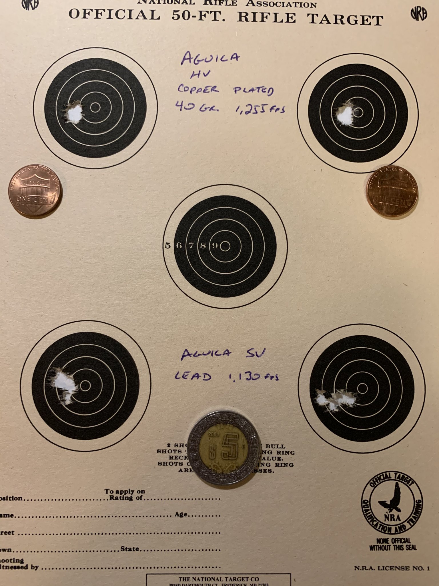

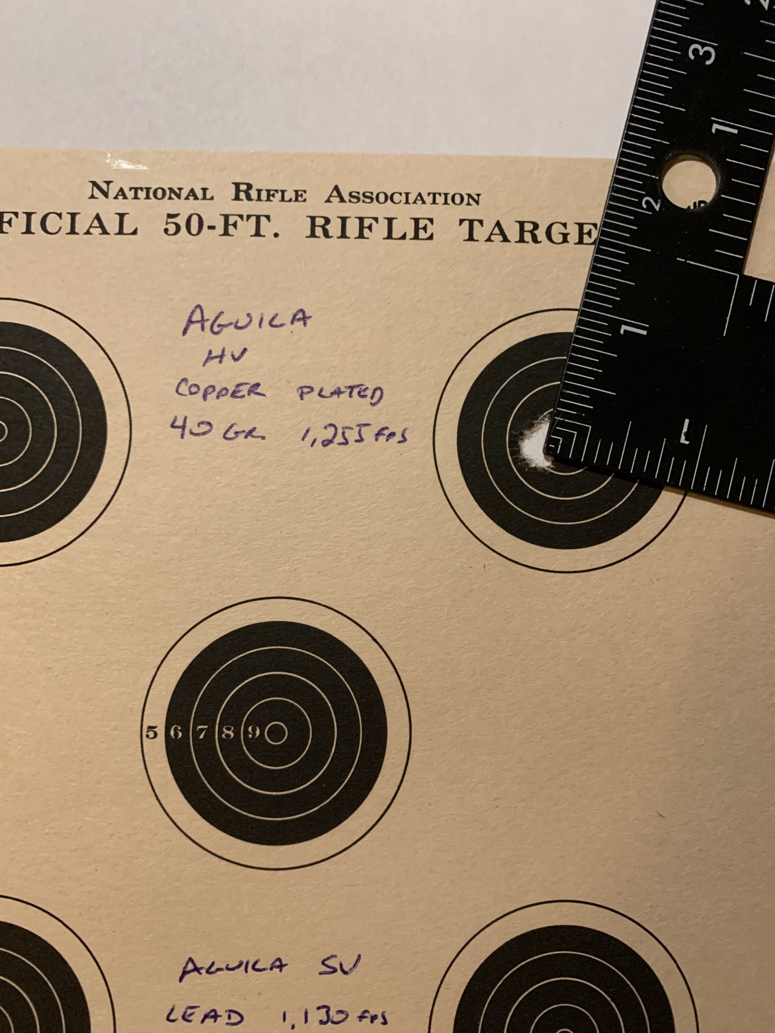

Nice, have you tried it out at 100 yards yet?

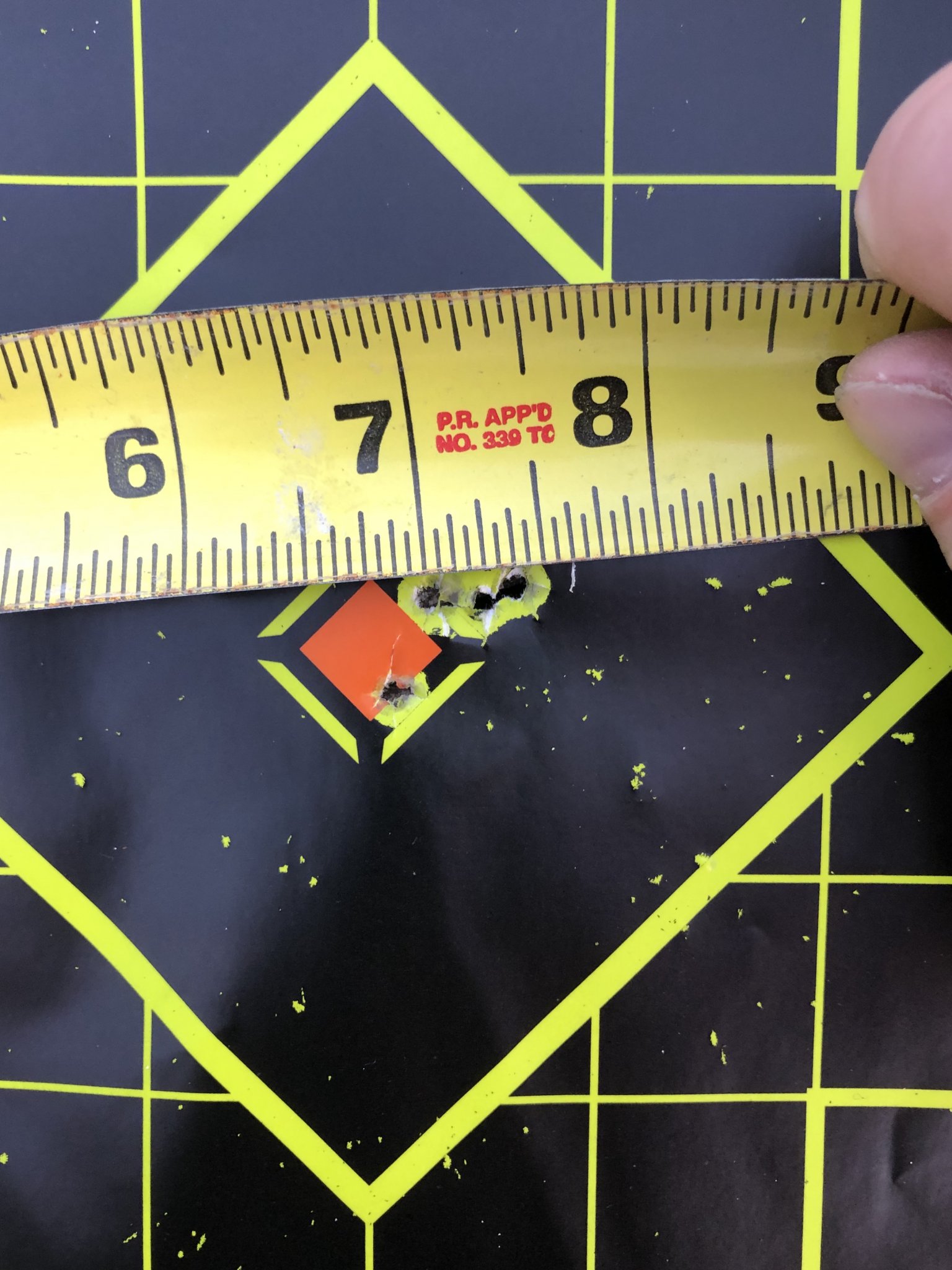

I actually shot it at 50, 100, 200, 300yds

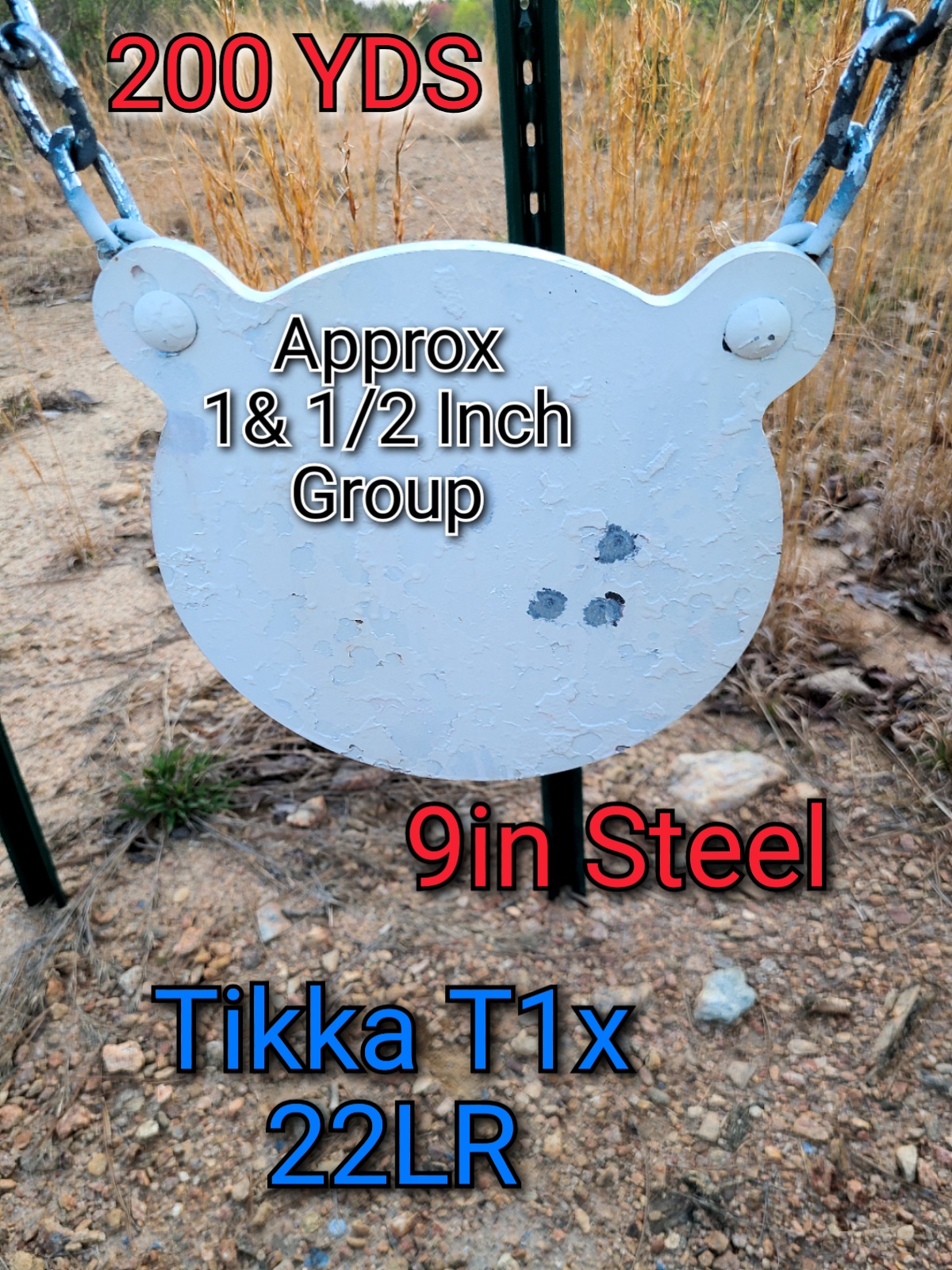

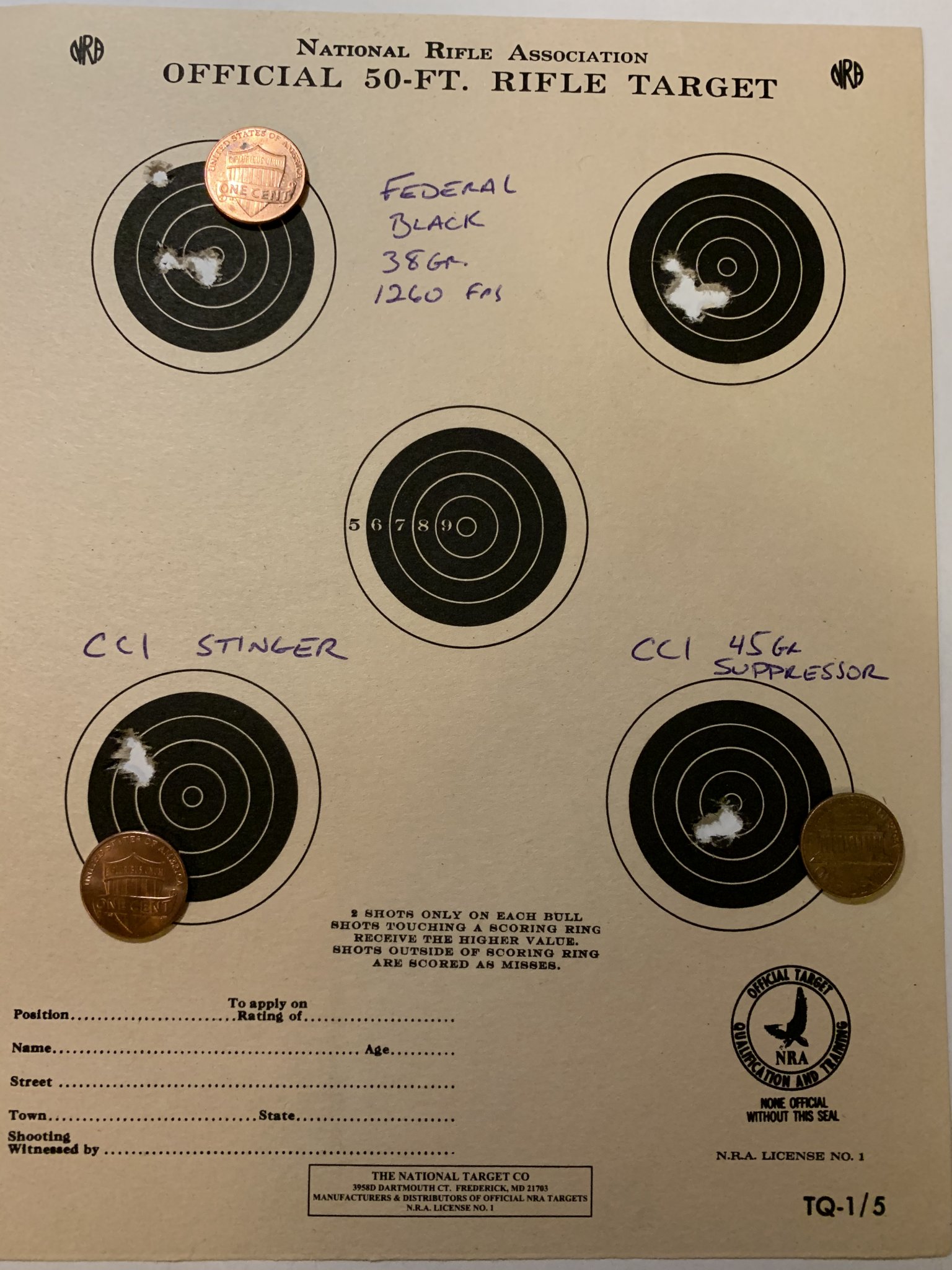

Took my T1x out to 475yds

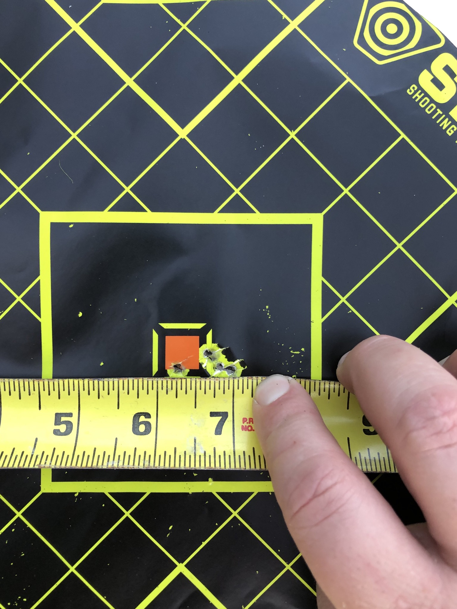

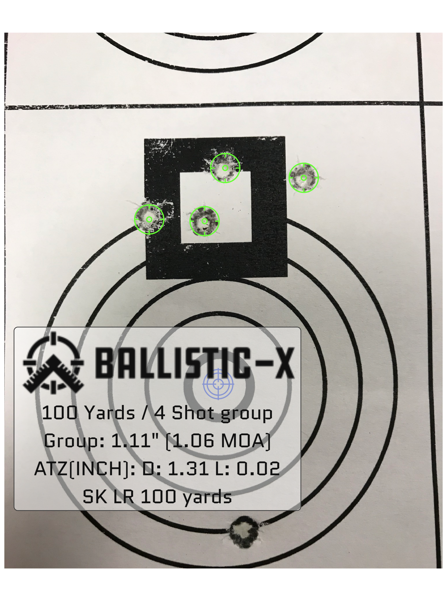

Here's how the T1x did at 200yds.
The RPRR is about the same using Fed HV.

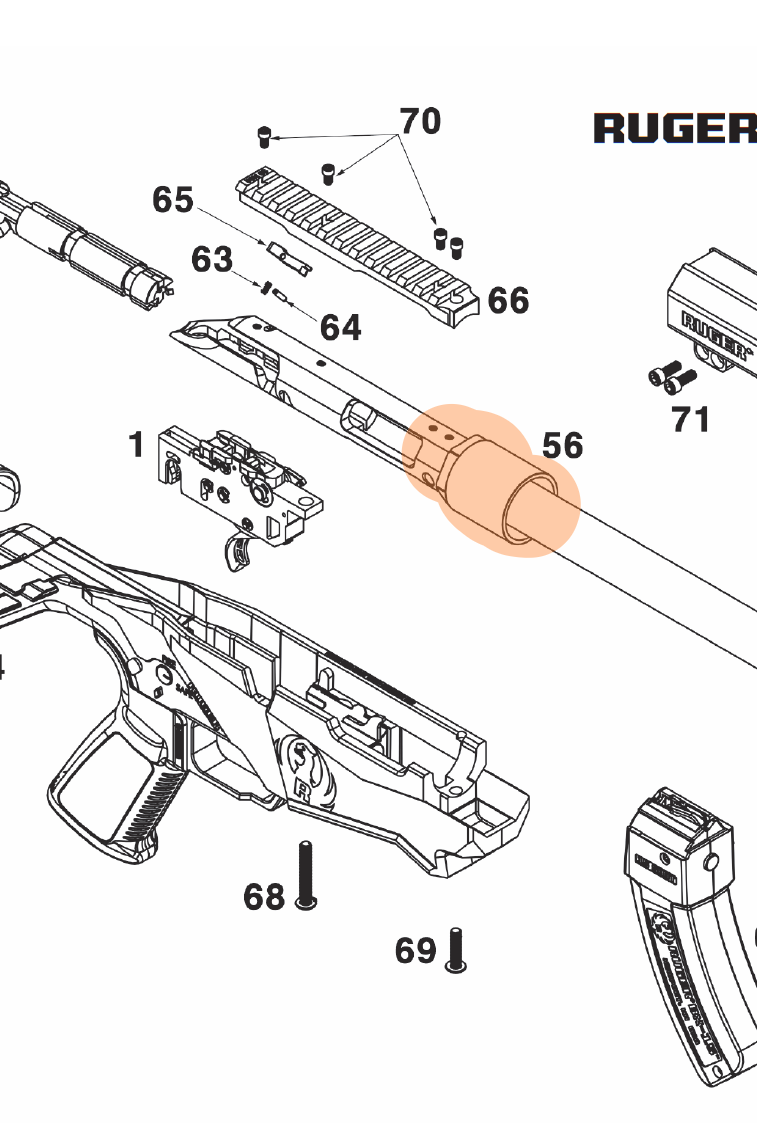

Need some help fellas-
Had my RPRR17 to a local yokal self-proclaimed ex-cop (rifted) Cerakote/gunsmith
'expert' for a coating. Completely disassembled it myself without problem
or incident and got it to him. Said it would be about a month. Almost 3 months a dozen texts/phone
calls later asking for a status, finally got it back with tons of attitude from him
at twice the estimated cost.
He broke the barrel nut loose (part #59) for me at the time of drop off- he kept the upper, lower, and
the barrel nut and I took the barrel home. Notice he scratched the barrel down to bare metal when
loosing the barrel nut even though he assured me he had a barrel vice when asked before.
So after all the hassle, I hand assembled it to see how it looked, etc. Noticed immediately
the barrel nut (part #59) hex face, which Ruger's instruction videos and manuals all clearly
state and show, would NOT thread facing the receiver leaving the smooth rounded part of the nut
to the rear where the barrel shroud screws/clamps onto. The barrel nut hex face would ONLY thread
to the receiver with the smooth rounded portion to the receiver and the hex face to the front.
(180 backwards). Naturally the shroud with the Ruger logo will be upside down when slid and
tightened into place.
Who has a Ruger Precision Rifle (RPR) or other Ruger rifle that may use the same barrel nut
in some of the models as my RPRR17 where this yokal mav have pulled a bait-and switch and returned
the WRONG barrel nut to me? He absolutely refused to tighten the barrel nut and barrel back to receiver
at the time of pick up even though he broke it loose an did so when I dropped it off.
Ruger, in 2 emails and 2 phone calls, would NOT provide any answers, and would NOT provide
any tech support what so ever on this issue. Only the gal CS reps working from home
who don't have a clue and "can't" get you to a tech or engineer.

Can you take a picture and post it? I’ve had mine apart many times did a lot of stuff to it including barrel changes maybe we can see what’s going on here

I do not have pics of mine but I do remember it being opposite all of the early videos, pictures or the ruger schematic for the rifle. I do believe my wrench flats were away from the receiver.

Well the reason I ask is because the side of the barrel nut with the hex is the collar that holds the barrel in place you can not install it the wrong way
Agreed, and on this rifle it will only go on one way as the threads are not all the way through the barrel nut.
Should have cropped the photos, but was kind of a quick go pull it apart thing... Hope this helps
That looks about right, what is not happening? Can’t tighten up the barrel shroud?
I think the concern is that he had a smith/armorer pull the barrel nut and the online videos, pictures and ruger schematic show the wrench flats facing the receiver. I believe BRRBshooter is wanting to verify orientation before installing, but I will let him respond to that.
Below is attached the page from the schematic, marked in orange is the offending image that leads to believe that the barrel nut is backwards.

This is incorrect! It is very possible the first model was built this way but there has been a few modifications and the other thought is it’s a typo but I assure you this is wrong
Reactions: heartburn
Thanks guys.
Finally got a email reply from Ruger in the 5th email with a generic statement: "See page 43 changes and modifications are subject to change without notice".
They would NOT confirm, in 5 emails and 3 phone calls, why every bit of info in the schematics, videos, etc all show the hex side of the barrel nut has to face the receiver. See Heartburn's 1625 post and pics above- mine's exactly like that. I'm confirming that this change, with the hex side facing away from the receiver does not center and firm up the shroud as well as the runs that have the hex side facing the receiver. Again mine is a .17HMR version. I'm just glad it wasn't a bait-and-switch from the hack Cerakoter..
Thanks again fellas!

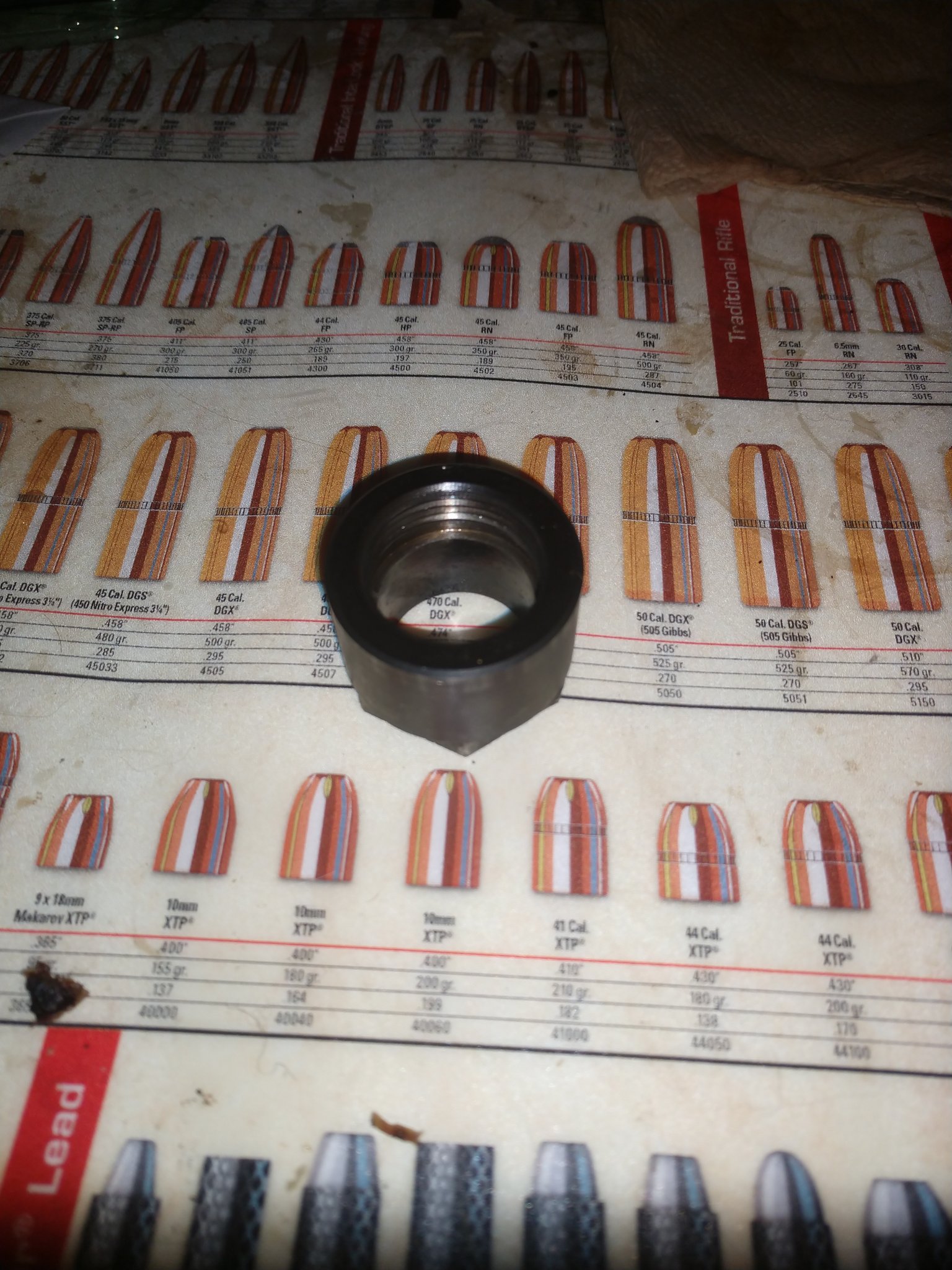

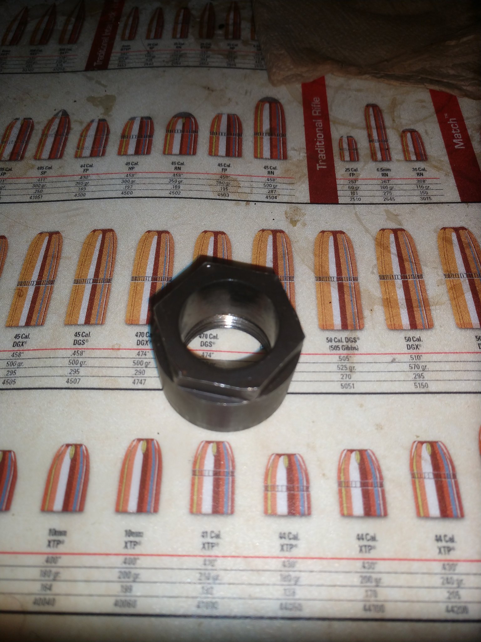

Well photos speak volumes.
Only threaded on one side.

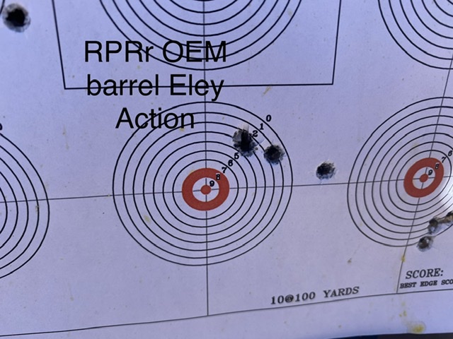

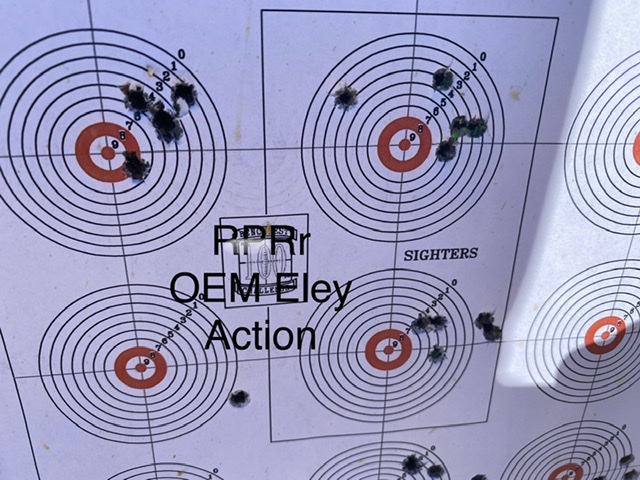

Small update:
put back OEM barrel on my boys RPRr and took two of my kids out shooting today.
still had extraction issues but not nearly as many. Didn’t seem to matter which ammo (surprisingly bulk ammo had the most).
OEM barrel was brand new and shot surprisingly well for a mass produced barrel.
It seems to like Eley Action. Below are some groups at 48 yards and decent breeze that would play havoc with the groups.
Can’t get rid of the gun because it’s my boys first gun and surprisingly my little girl loves the gun. I pulled out my Cz 457 MTR and a custom 10/22 in a chassis and she didn’t want them but said the RPRr fit her better.
She was having a hay day shooting old oranges that we had.

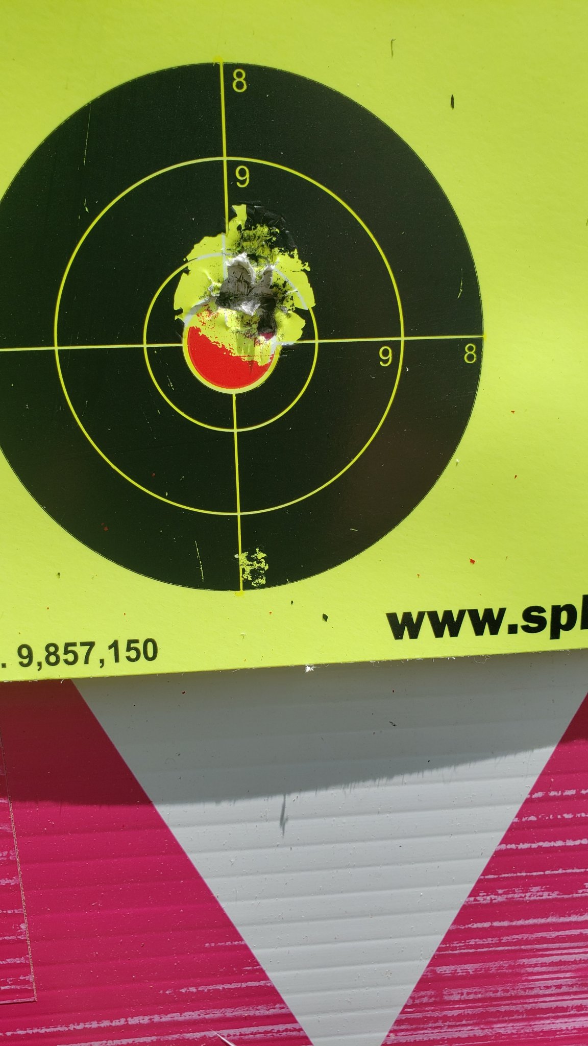

Seems like it’s getting better. The stock is where my fliers are coming from, would be nice to put an aftermarket stock on this thing.

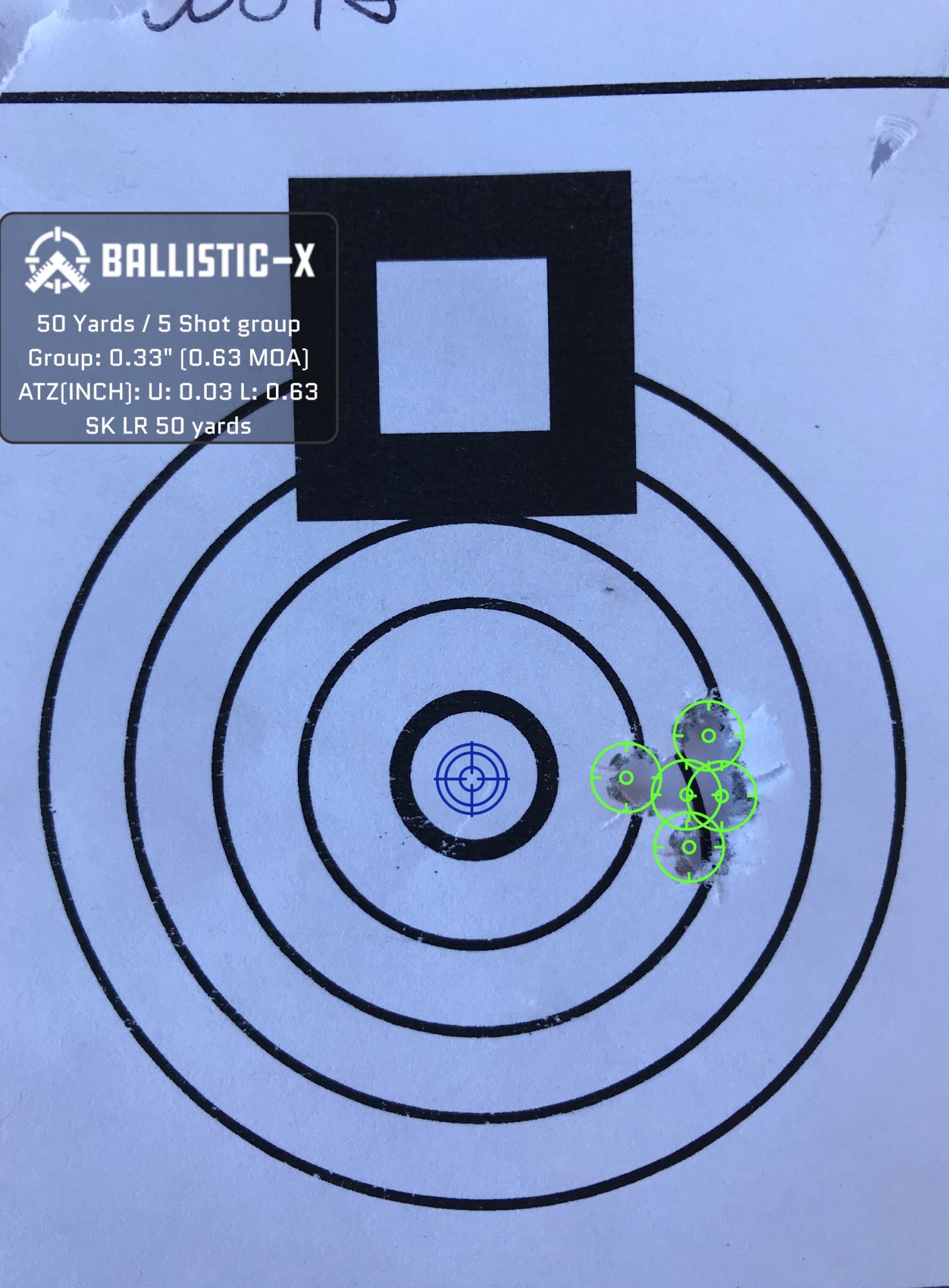

5 shot group this evening. Fed GM Target ammo, 50 yards. I believe on a better rest setup I could get it a little smaller.

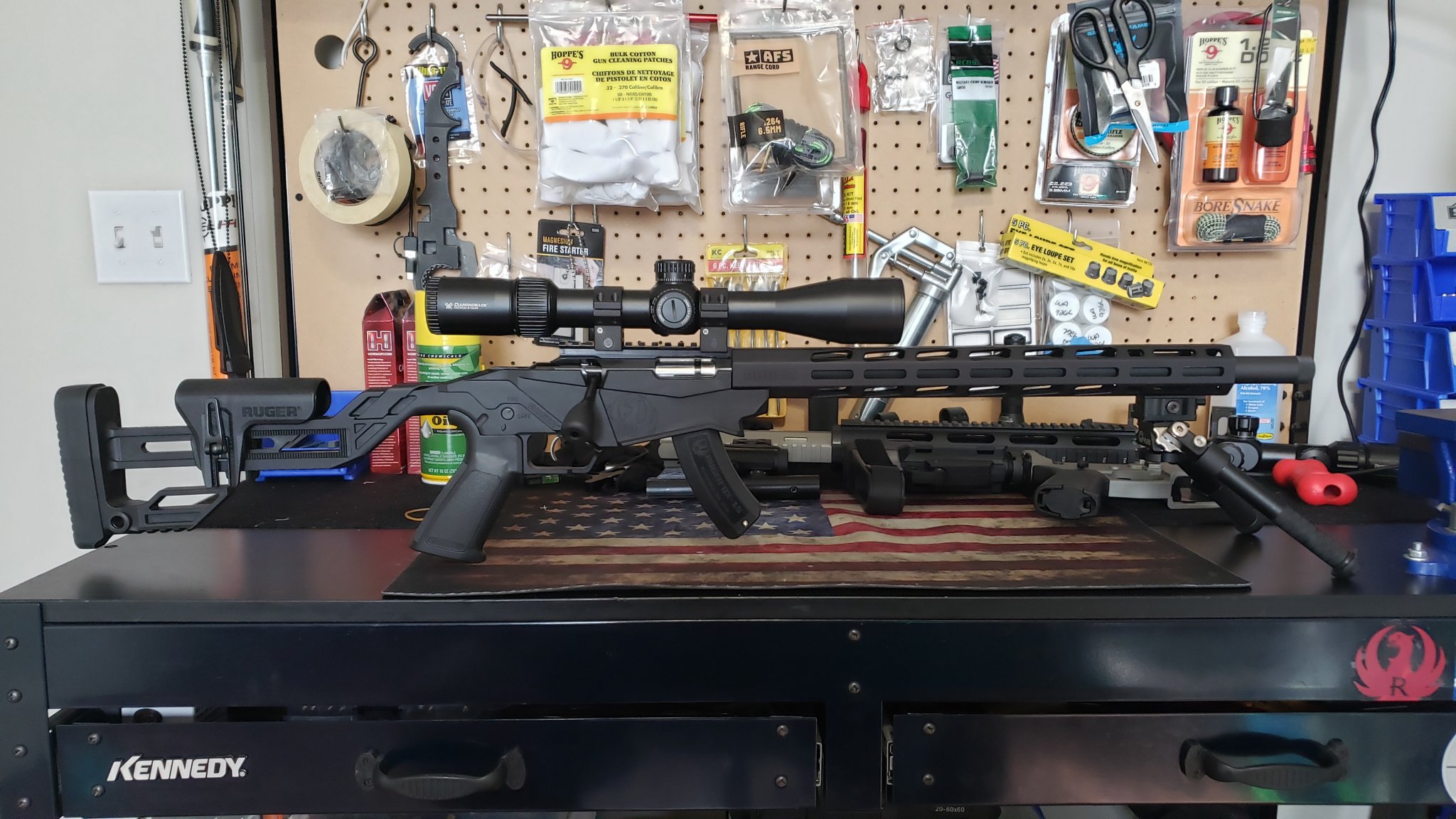

Apparently I got lucky and received a gem out of the box. Purchased early this year. Recently got around to finishing it up and shooting it.
Specs:
Ruger Precision Rimfire 22LR
15 round stock magazine

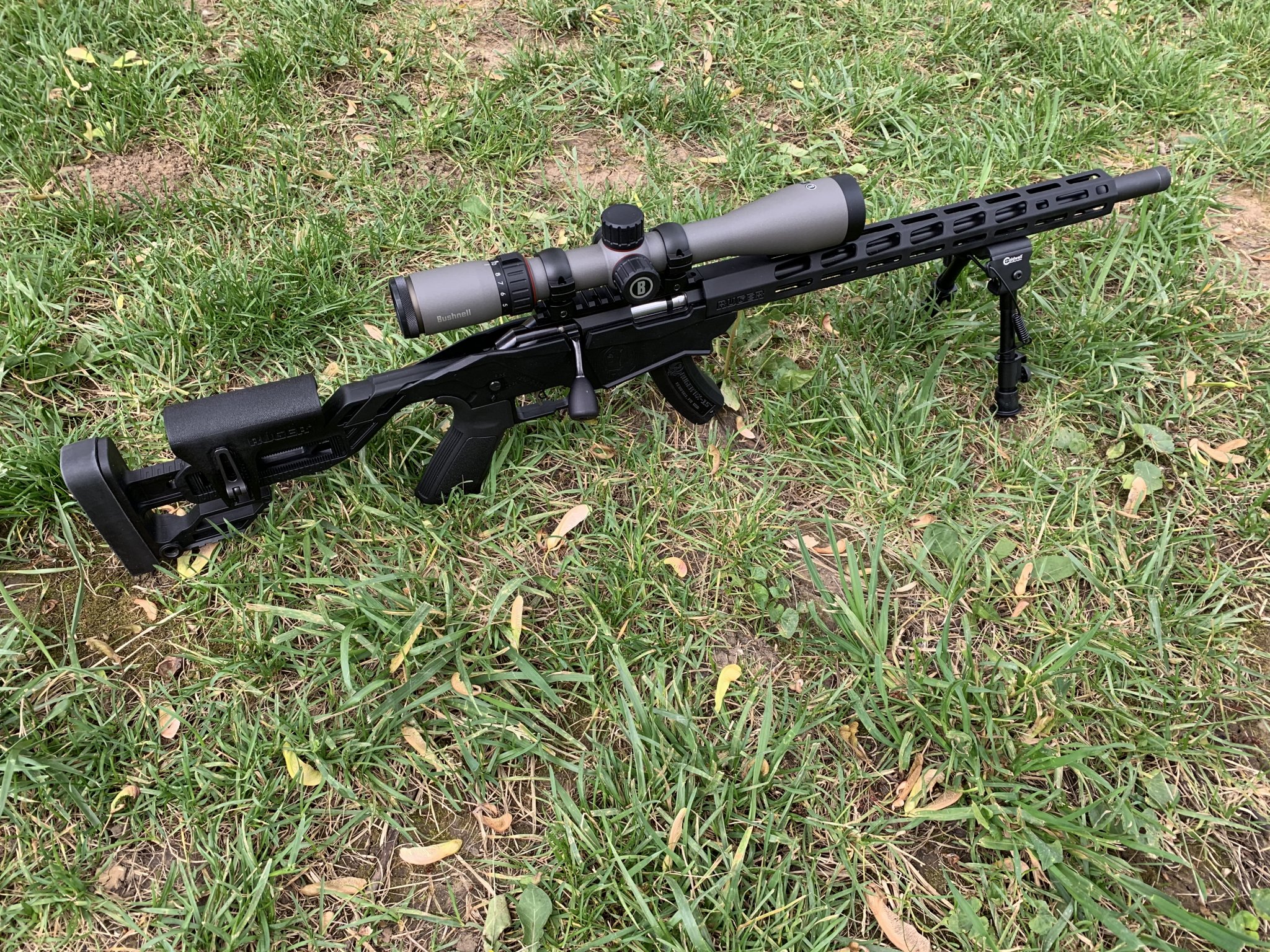

Specs:
Ruger supplied 30MOA base
Vortex Med rings (1-2mm objective clearance)
Bushnell Nitro 5-20X44
Caldwell bipod
My rifle came clean and free of manufacturing oil, gunk, and debris. Everything was properly tightened down. No action movement in chassis. Trigger is ok for what it is. It’s not a match trigger, but innovation and technology has come a long way to offer adjustable triggers as good as we can get now on firearms $400 and under. It will suffice for my purposes. The optic I chose wasn’t my first choice. But I caught it at CameraLand for $199 with no tax and free shipping. Hard to beat for that price. I have 65-70moa in my elevation turret and an additional 25 on the deploy moa reticle. I haven’t heard used this optic. But I did max it in all directions a few times and it has returned to zero flawlessly each time. Enough about the Nitro, I will post a brief review in the appropriate section when I have some more experience with it and have tested the reticle for holdover accuracy.
The bolt on my RPR is very tight to close. This is with the factory barrel. I read this entire thread and noticed that was a problem after installing match chambered aftermarket barrels. Mine isn’t uncomfortable or extremely difficult to close, but I wouldn’t want it any tighter. At this point given the accuracy I have achieved, I do not consider this a negative. I will keep an eye on it moving forward. My safety is very tight. I am hoping this wears in and loosens up some. This is really my only complaint as it is very difficult to manipulate with my hand in the shooting position. I don’t like breaking position to engage or disengage the safety.
I am using the factory supplied BX-15 magazine that came with the rifle. Magazine play is minimal, cartridge feed into the chamber is consistent and does not mark the projectile at all. My bolt cycles without marking the round on top of the magazine as well. Speaking of the bolt, yes there are some machining marks visible. Nothing to impact performance in any way. I seen some complain about this, but it’s a ~$400 rifle. If you expected everything to come beautifully polished with zero machining marks, that was not wise of you. I find the stock magazine release to be slightly uncomfortable, but I am getting used to it. I may add an extended one in the future. My hand guard is centered around the barrel. Mounting hardware for bipod is not contacting the barrel. So far so good. It shoots well. Very well. I am going to try some Eley, SK, Wolf, Lapua, and other ammo before settling on what I will use consistently. I will make sure to update as I go along.

Testing at 50 yards now. After I narrow ammo selection down to the best 5-8 I will shoot them at 100, 150, and 200 to determine accuracy at those distances. After testing I plan to shoot out to 400.
Good for you! Good luck it looks like you may have received a good rprr, I had done extensive work and a ER Shaw 20” barrel and with good ammo hold a 1.25 MOA average At 100 yards so I’m going to Tikka T1X see if my groups will be better.

Took out the RPRr to try different ammo. Also had recently installed a Timney trigger. On about every tenth round or so, I’d get a dead trigger. I’d have to lift the bolt handle and close it again to re-set it. Anyone had similar experiences? Any thoughts on how to fix it? Seemed to happen with Eley and Norma match. Might have just been a coincidence but no failure yet with American eagle plinking ammo. Groups were far better with Eley and Norma though.
You may want to recheck your sear engagement adjustment, or your trigger spring is to light and will not always return your trigger when cycling the bolt.
So, I finally put my first rounds down range. After zero, able to put 10 rounds inside a nickle at 25yards with a wsw wind at 23mph using cci mini mag, in a bipod and rear sandbags. Before I put any rounds down range, i bedded with foil tape, put a kidd plunger and spring and torqued everything correctly. Thanks to all for some great advice.

I had changed my barrel to a ER Shaw 20” and with SK Long Range was able to do the below at 50 yards and 100 yards, but I had played with Midas+, center X, all of CCI stuff and found the best was SK and was the most consistent

Nice day so I didn't put out windflags. Shot SK Rifle Match, SK Long Range Match and Lapua Center-X. My gun does not like Center-X. Both of the SK offerings were in the mid 4's at 50 with a few groups in the low 3's. I shot about 500 rounds. Extraction and ejection were perfect.
The gun needs a bit more scope. I'm going to put one of my NF 5-25's on it. I do not like the trigger. It's about 2 lbs. and I don't like the feel of the blade. A Timney will be here on Tue.
Bottom line...I like the gun. It's no Vudoo or Anschutz, but I didn't expect to it be.

I got my RPRR about a month ago and have had it out 2 times. Day one I tore it down and did a complete clean. Took apart the trigger, removed the blade and installed a ink pin spring( now reading a lot of people do this) lol. I did find some vids of people " bedding the action" with aluminum tape and I had some in the shop so I did that and torqued lock tighted everything to spec. I tossed on a primary arms scope with a HUD 308 retical. I tried several different ammos's and the best I come up with that day was Federal gold metal target with Federal auto match coming second. I havent found anything CCI that was good. I tried mini mags,std velocity,select and velocitors. They were all garbage but I'm still going to try green tag when it comes in. The second time out my Vortex diamondback tac 4-16 had come in. I tried some Eley target this time and it shot awesome 10 shot groups. I then went to the rifle range and shot 100,200,and 400 and the Eley target killed the Federal gold metal target as far as consistancy and there was hardly any wind when I started. I now have the trigger at 1lb 3oz and have the gun settled in and shooting absolutely awesome. I also smoothed out the bolt and polished the cocking piece to smooth the bolt throw. I would still like to make it just a little easier. All and all this gun is much better then I expected out of a 400 gun with a 300 scope. I have since had 2 friends buy them and were going to get them going this weekend. I have shot next to a Tikka t1x and a Ruger american target and did as good if not better then both. The red circle on the targets are .5 and all groups shot at 50 yrds.
Hmmm??? I don't know of that many that have moved the blade. Typically, I know people have removed and/or replace the trigger adjustment spring. Without the blade, the gun is at high risk of slam firing. You should test the for yourself by kinda letting the gun drop onto its butt and see if the firing pin stays in place or not. I've tried it and without the blade both my RPRR and RPR will release the sear getting a slam fire. So, please be very careful now that that safety blade is not in your gun.
In both mo RPRR and RPR I have completely removed the adjustment spring, but left the safety blade in place. Without any adjustment spring I get 12 - 14 oz of trigger pull for both. My RPR is a .308 and has over 7,000 firing now (3 years + of firing) and have not had any issues with the trigger and pretty much the same for my RPRR.
