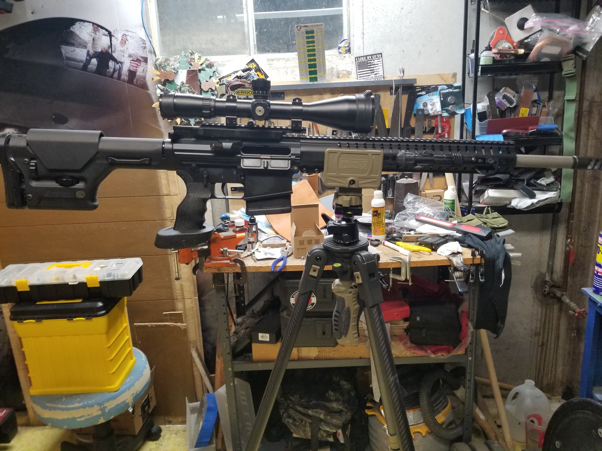

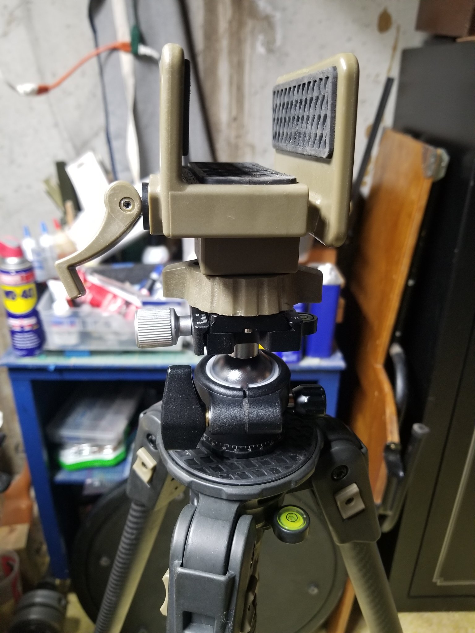

Used?
yeah, the feel is why I keep working on it, if it was even a pound heavier I'd have sold it already.
$180 demo from the bushnell outlet store. Took the clamp off and installed the arca rail that came with the ball head on that so it clamps in if needed for a rifle without the adapter. Allows the tripod to still fit in the bag.
Holds a 16# dpms sass solid.

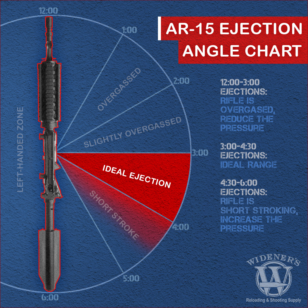

What's your ejection pattern look like?
Are you sure it not just that you're super over gassed (not surprising with the port size!) And your brass is being thrown forward and occasionally hitting the side of the opening on it's way out?
It was ejecting around 3 o’clock but I use a brass catcher so don’t see them now. Nothing has been altered since then but they’re definitely getting rammed into the receiver.

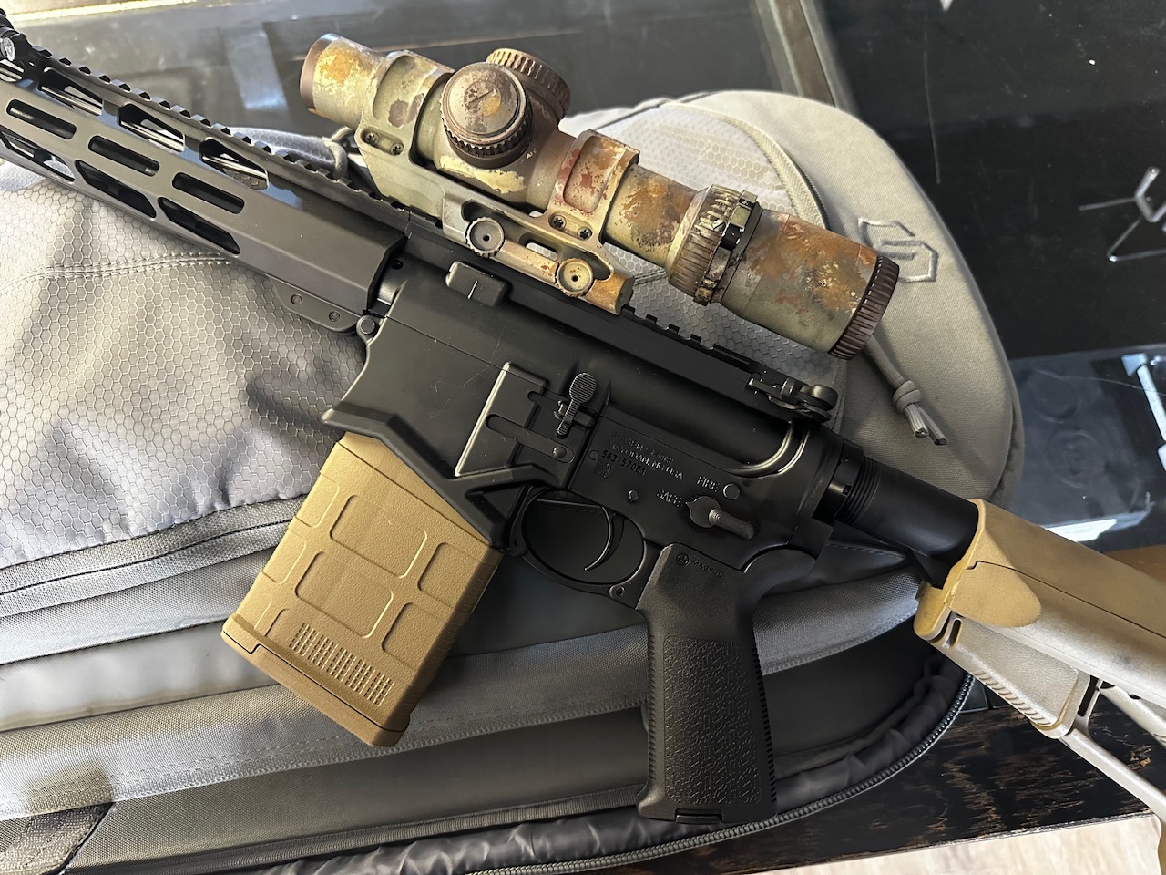

weighs 10lbs with optic and suppressor ready to rock. not bad.
I will say it’s rough in operation. Running the charging handle is brutal - a sign of low quality factory finishes during machine operations.

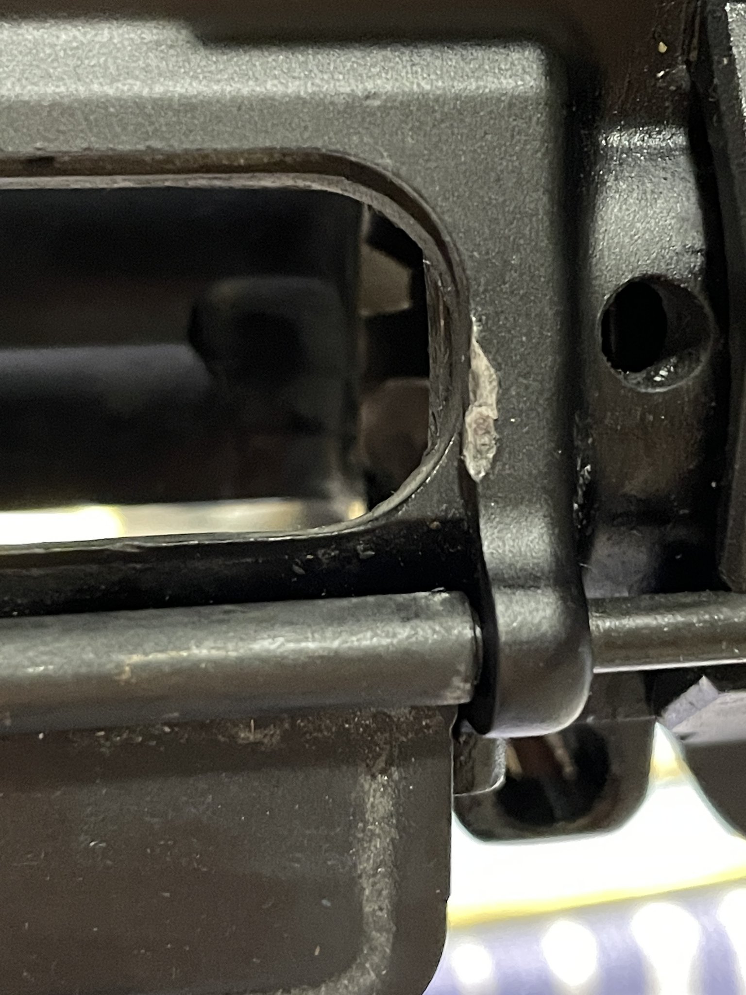

Not yet. ... sign of low quality factory finishes
If you snapped a picture of the port with the Teslong we can guesstimate it based on it's size/position between the lands.
But since you're breaking it down a quick caliper will tell the truth.
On my 308/20" the machining tolerances were pretty tight but the edges on almost everything were sharp, almost burred. I'm assuming pretty much machined then jammed together.

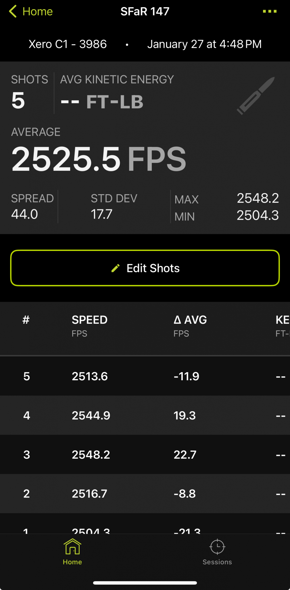

3. Velocity:
So Ok with 147s.

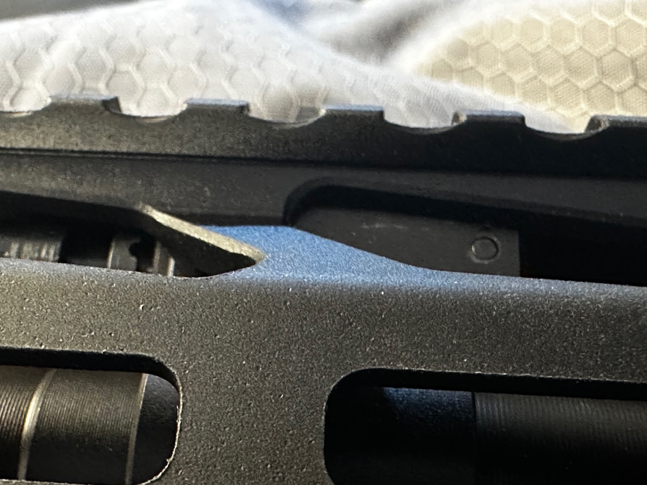

4. The gas block was in contact so hard with the rail that when I changed it to a SA blow off job, it changed the zero by 5 mils. 50 clicks.
5. There was no acceptable suppressed setting on the factory GB. The SA was run in restriction mode.

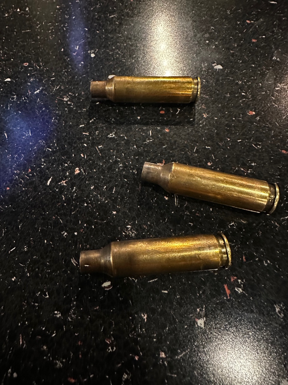

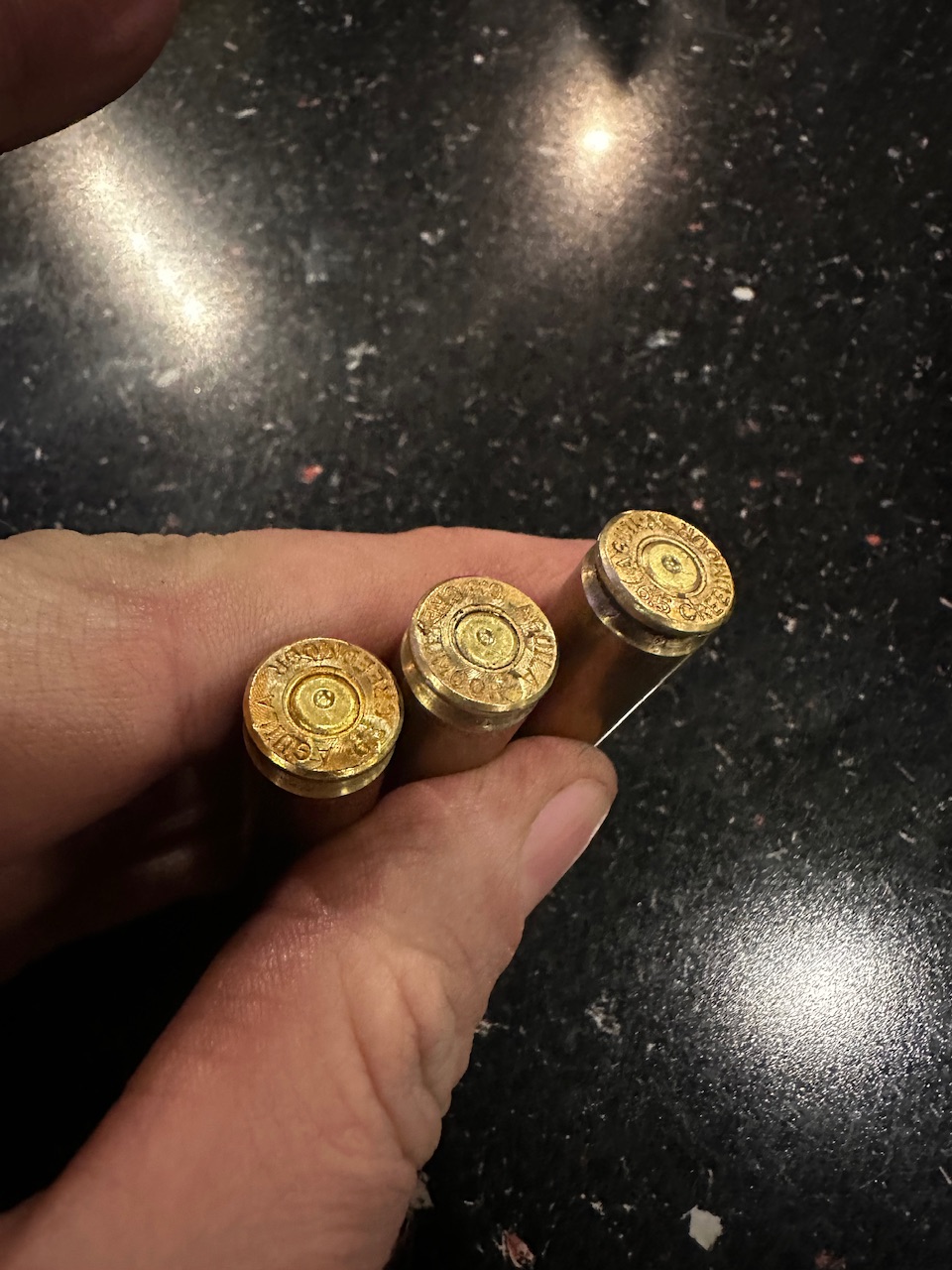

6. Brass with the SA:
Nearly completely destroyed with factory GB.
View attachment 8334357View attachment 8334358

I may need to look harder for a handguard with better clearance. This is the only sporter/thin barrel rifle I own, not used to these kind of shenanigans.
If you haven't already, change your gas block. It solves the contact issue and gives you a whole lot more options for tuning. In my opinion the GB is the single biggest design error Ruger made with the SFAR.

It tamed things down quite a bit, or the rifle "got broke in", because the brass looks better now.

I *think* the block (clamp on type) may have been contacting the bottom of the guard on the SFAR. The set screw version has more clearance so I swapped it with the one on my AR-15 ... so now I have two rifles that couldn't hit water if you threw them out of a boat.
