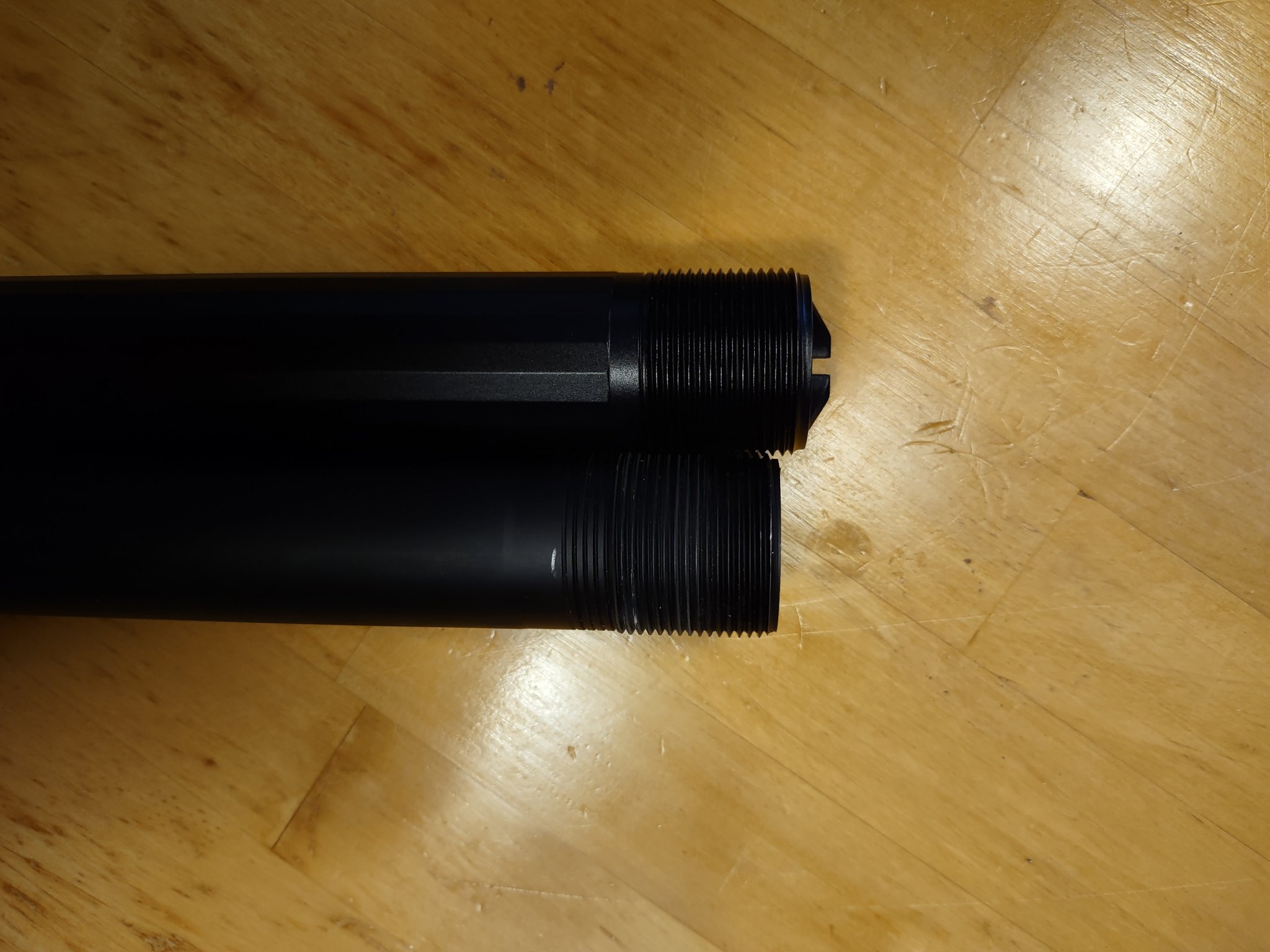

The internet says it’s just an Armalite/VLTOR A5 length tube. Not “mil spec” but certainly not unusual.
The Internet is wrong.

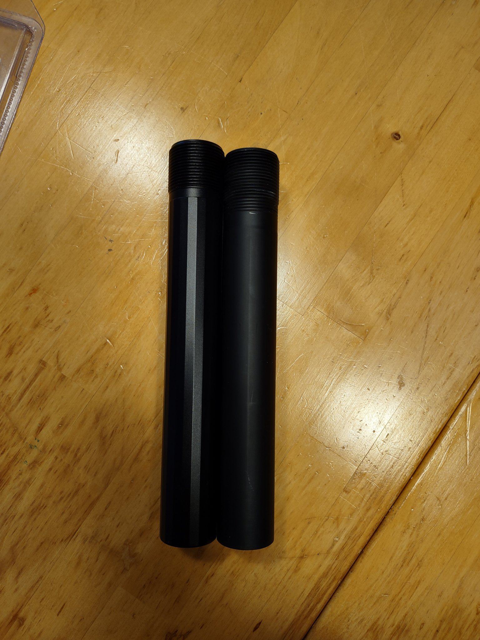

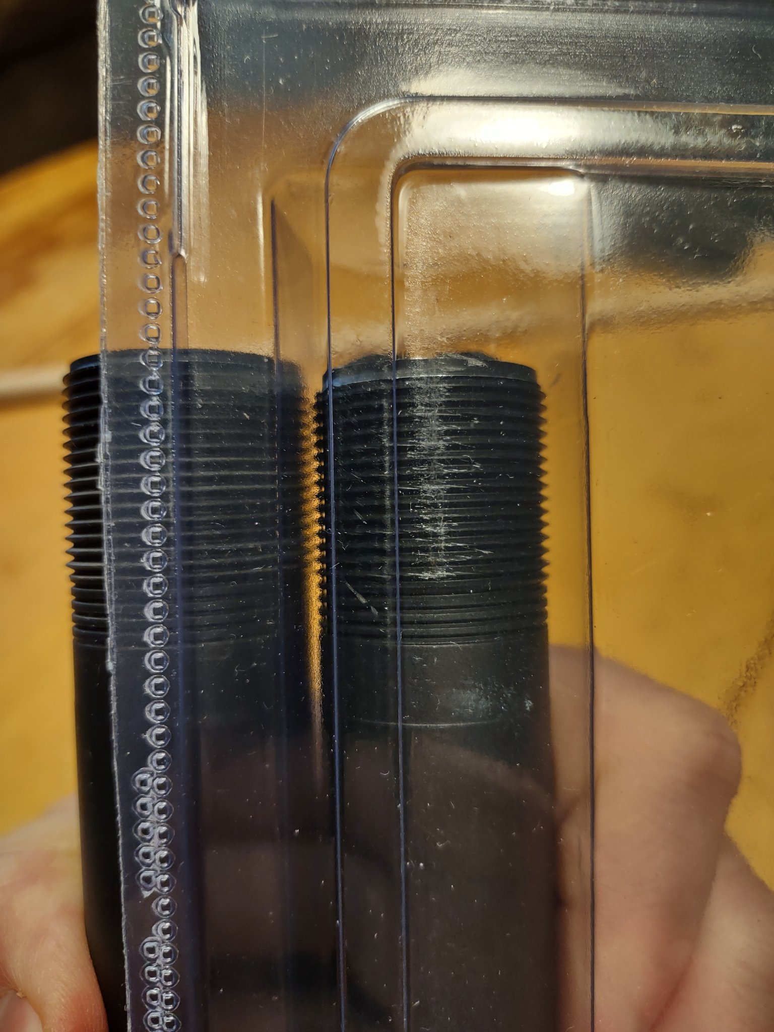

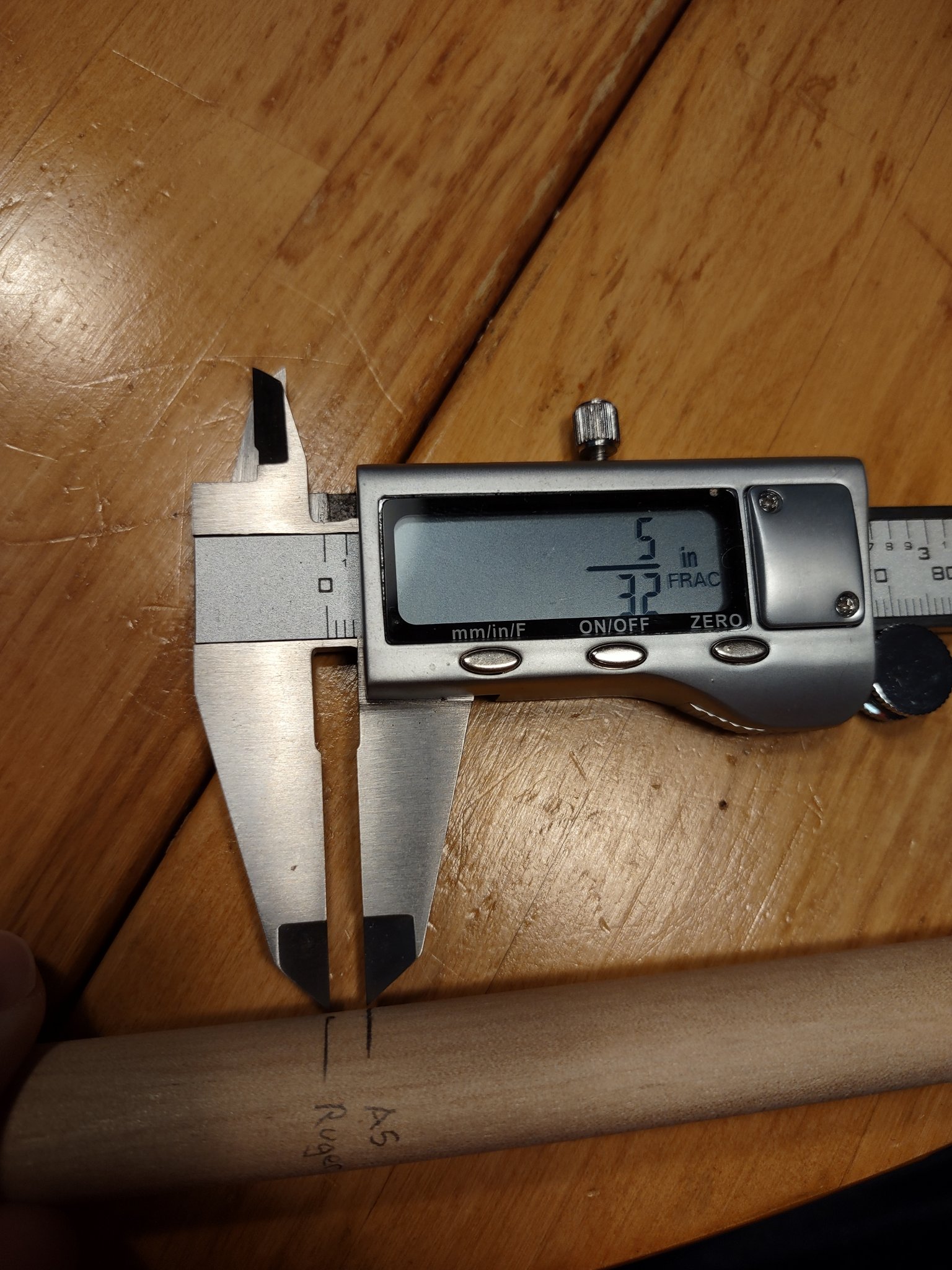

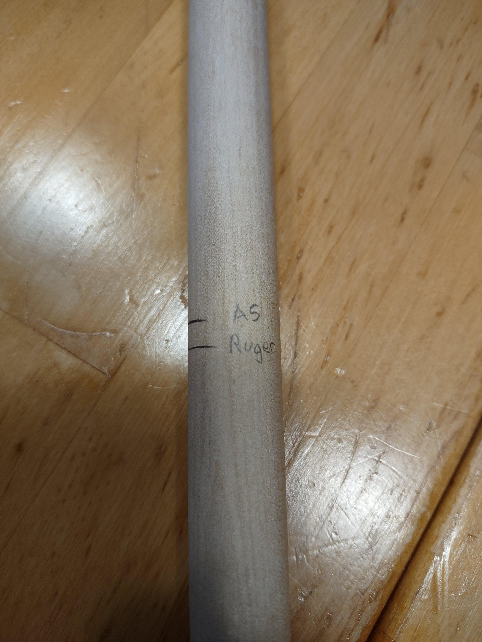

Shown is a Dark Hour Defense A5 and a SFAR tube compared. Lines on dowel to compare internal depth.
As I've stated several times, the A5 is longer...5/32in externally and internally. The closest match to the SFAR is POF's Rogue/Revolution tube (maybe a tube thread shorter....and considering their design parameters..not surprising).
Again, I'm sure you could make an A5 work...but just be aware that they are not directly interchangeable

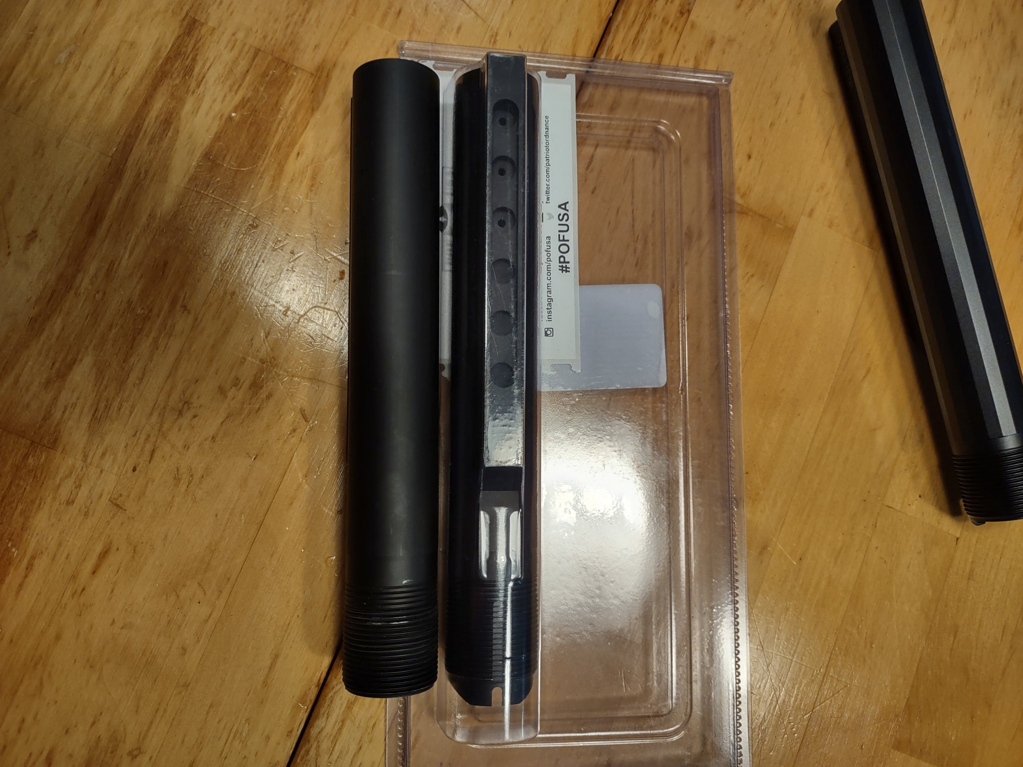

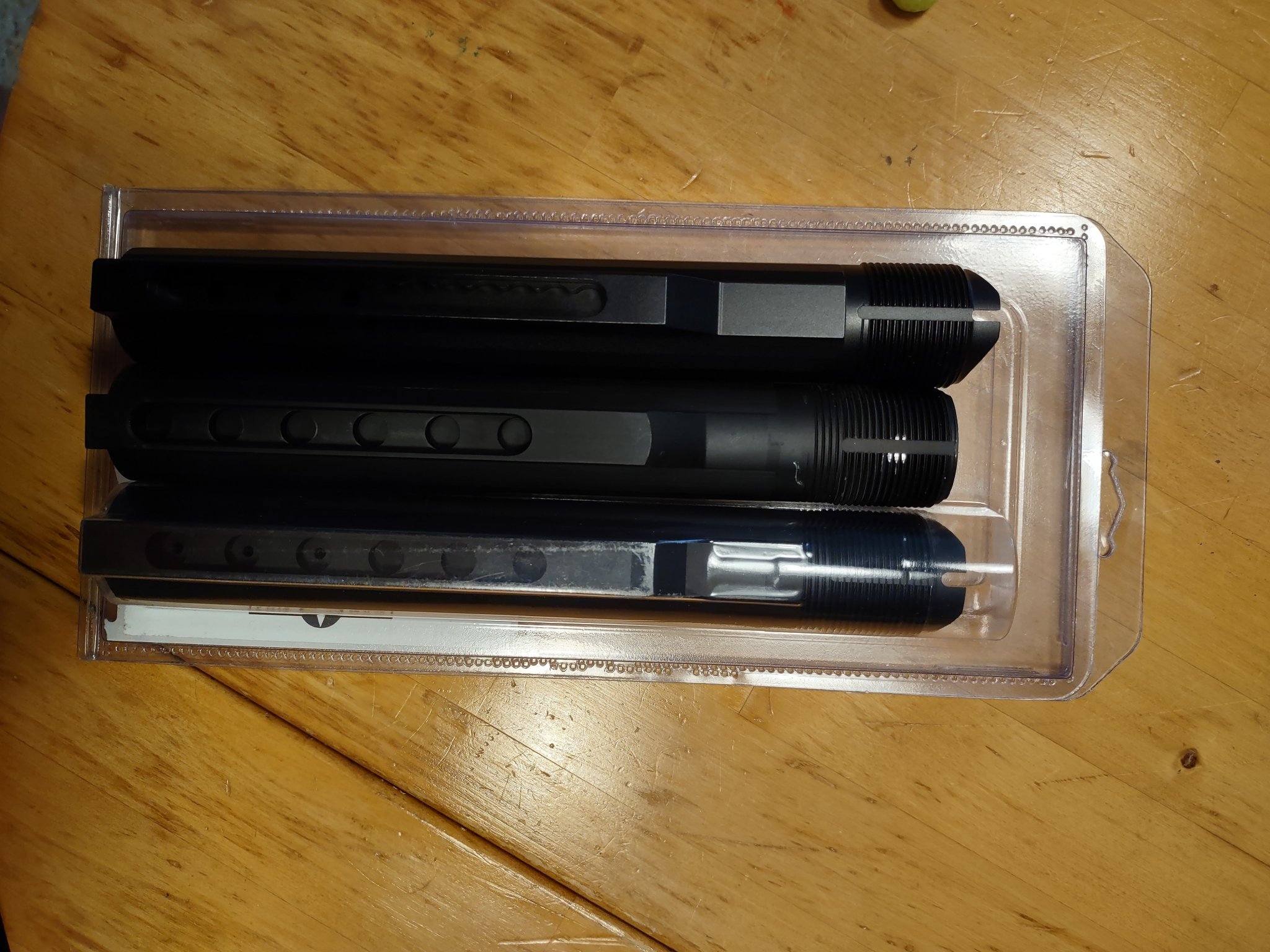

Here's the POF and Ruger tubes compared. The Ruger is marginally longer...maybe 1/16". Not taking this one out of the package...but I bought 2 and my other one is on my SFAR and working well.

Yeah, IIRC the spring in my LR-308 was shorter and stouter than the standard rifle spring in my AR-15 and it took a couple three more pounds to compress the LR spring to tube length than the AR spring.
But the SFAR spring was a beast compared to both.
Yeah, that's partly why I'd worry about the longer tube with no spacer. AR10's and Blowback PCC's in particular are known to shear bolt stops over time if there's too much of a gap (between the bottomed out bolt and the back of the bolt stop)...so with the SFAR's extra heavy spring (and potentially a heavy buffer if you add one like I did) and too much of a head start...you might run the risk of breaking the proprietary bolt stop (which you can replace with a lighter duty AR-15 or a modified AR-10 stop...but still a situation I'd avoid)
Reactions: doubloon
A properly functioning rifle should have the bolt carrier press back slightly upon the buffer when the upper is closed. You can watch this occur as you close the upper. The buffer should never touch the buffer retainer, except when the upper receiver is open…
Reactions: doubloon
I agree, but not sure how that's relevant...I'm talking about the BOLT stop.
Reactions: doubloon and mtrmn
It’s relevant because I can’t read… 🤣🤦🏻‍♂️
That said, you can adjust how much “over travel” your carrier experiences by dropping a quarter (or 2) into the bottom of the receiver extension.
Yeah, as an easily available spacer, a couple quarters should be pretty close.
Reactions: MadDuner
