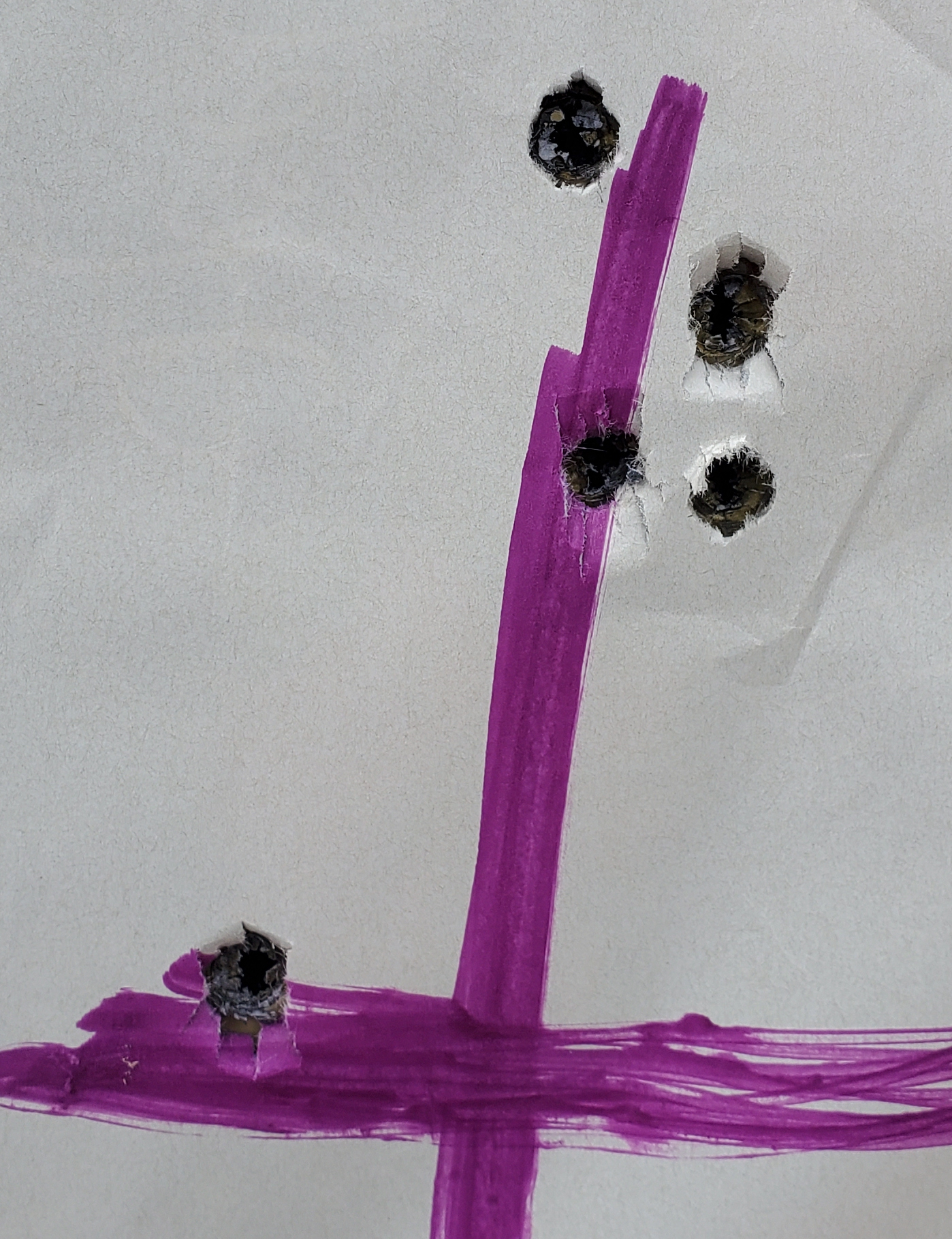

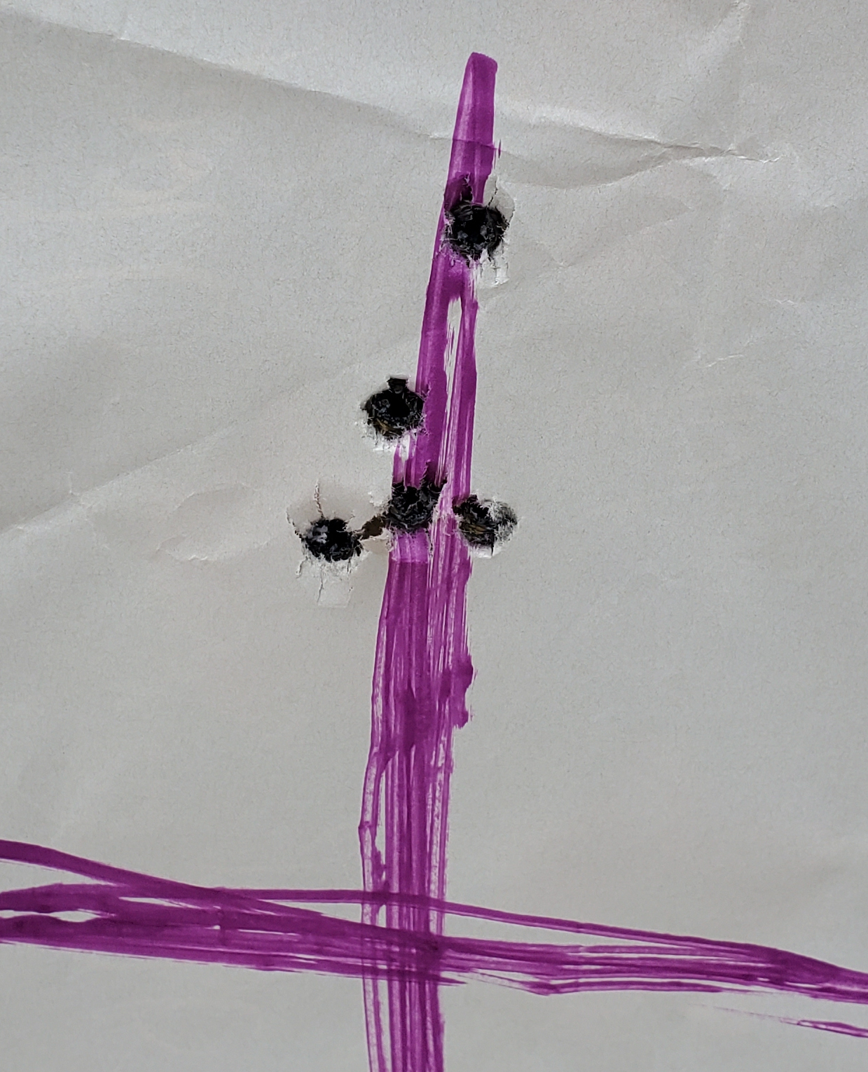

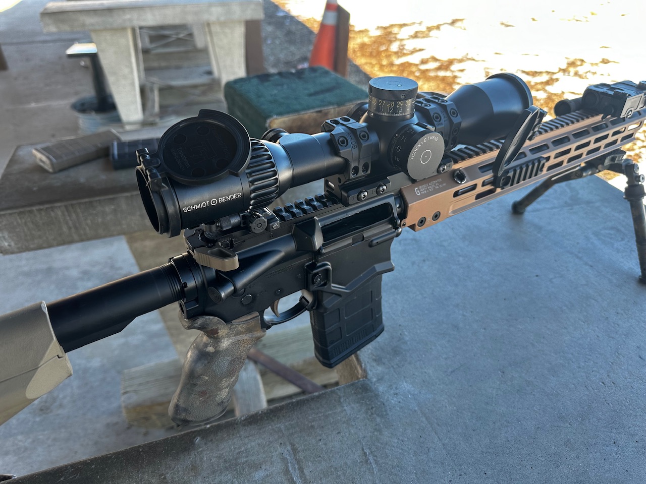

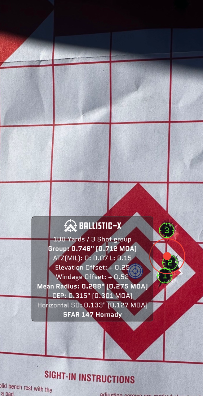

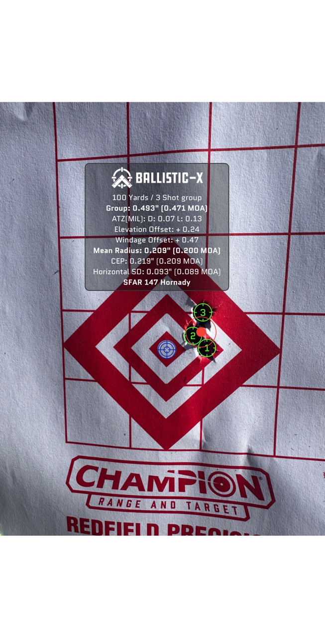

More troubleshooting today.
1. The bcg is hitting my Radian SD charging handle. It doesn’t have enough relief at the rear for the SFAR bolt throw.
2. My vortex 1-10 gen3 packed it in. Replaced with a known good optic. I continued troubleshooting as this barrel scoped good and had good es/Sd. Usually indicates it will shoot.

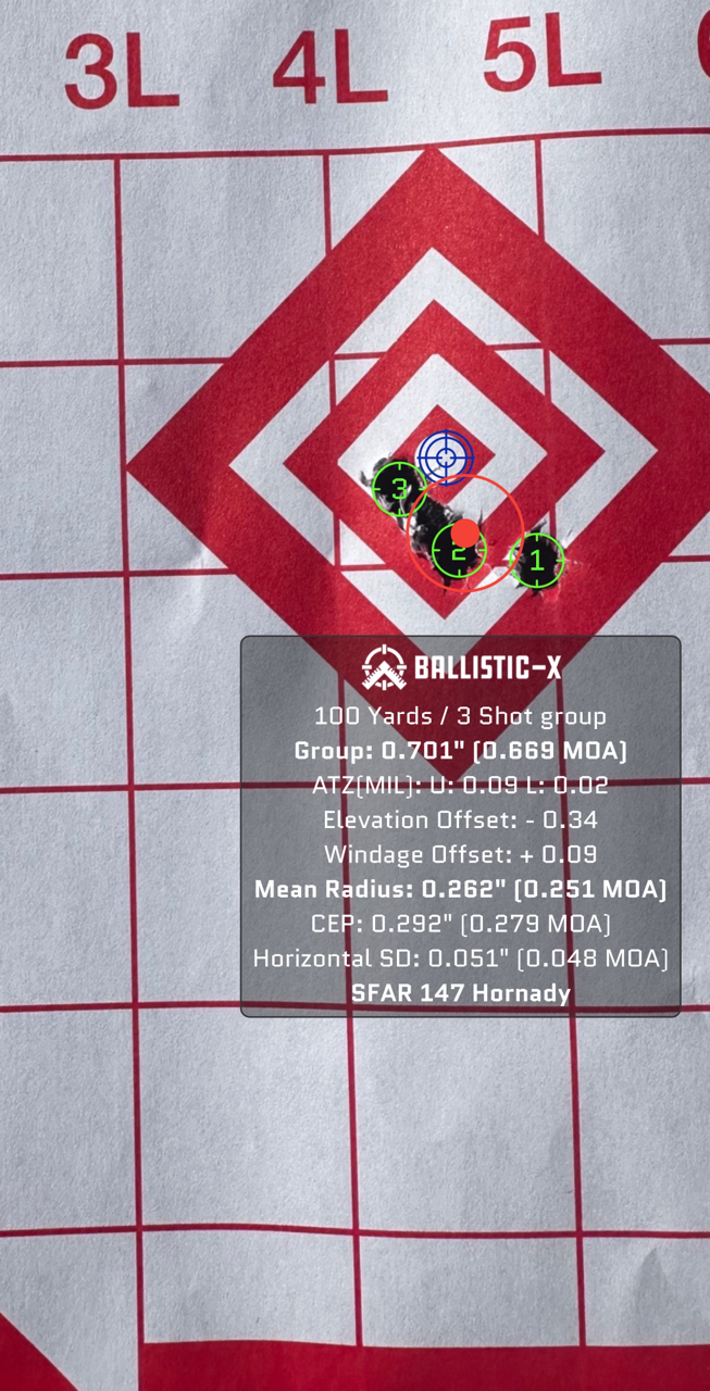

After changing the optic:
Ballistic-X-Export-2024-02-04 13:15:54.134184.png
Ballistic-X-Export-2024-02-04 13:17:29.155058.png
Ballistic-X-Export-2024-02-04 13:14:07.924408.png
View attachment 8341017View attachment 8341018View attachment 8341020
Nice shooting. Will your charging handle not latch?

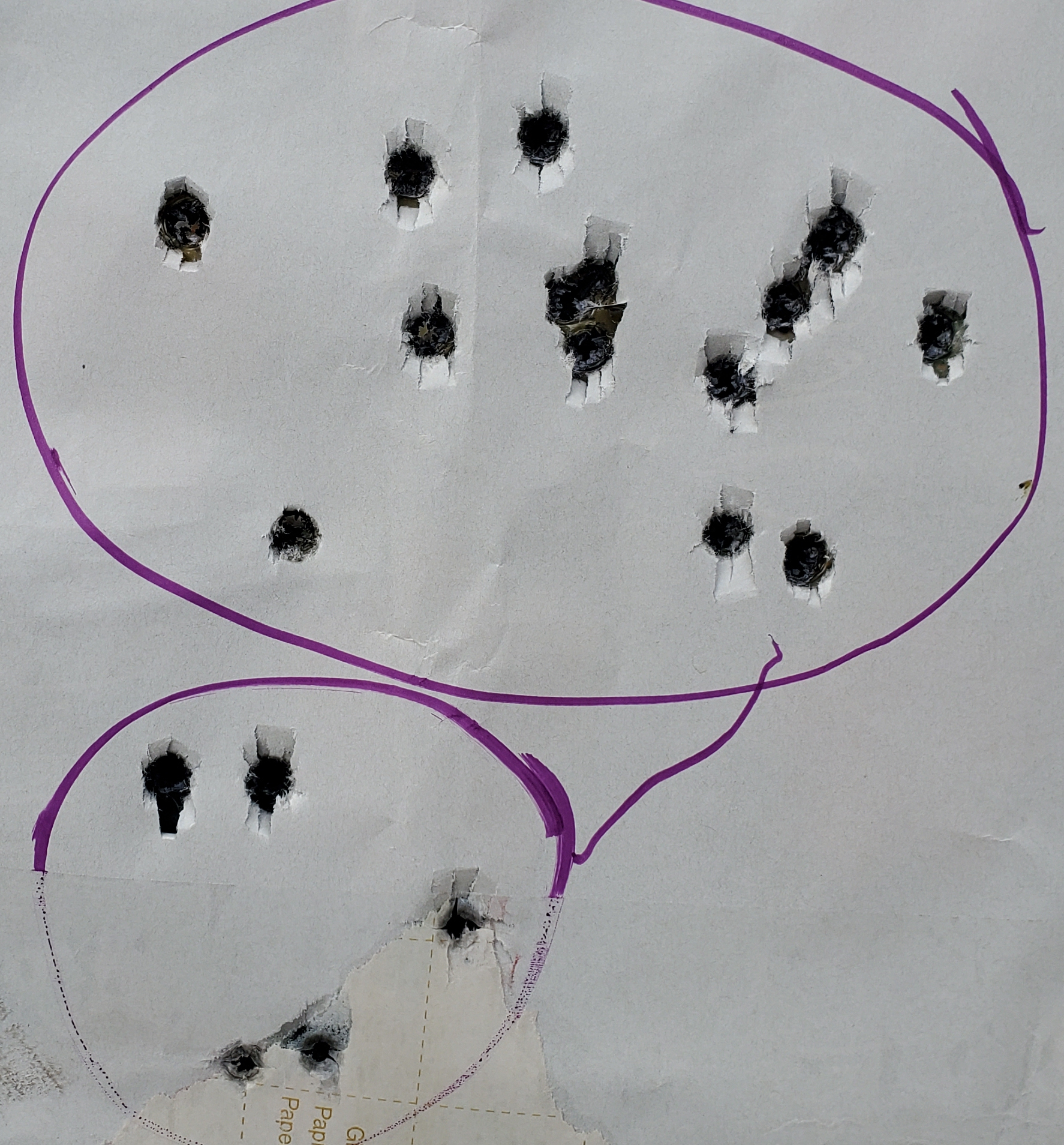

I finally made it back out. I'm pretty sure my most recent accuracy problem, minute of Tuff Shed at 200 yds, was due to the bottom of the superlative clamp on gas block contacting the bottom of the handguard.
I swapped in my LR-308 spring and a heavy AR-15 buffer before running the Tubbs through the barrel based on the assumption of what could it hurt. I ran the first 10 rounds of Tubbs with the gas completely shut off. Manually cycling the bolt it was obvious the LR spring didn't have enough oomph to reliably return the bolt to battery. It would chatter and stick then break itself loose and lightly click into place. So I swapped the Ruger spring back in. Near the end of the first 10 rounds cases started sticking making it a PITA to cycle so I opened the SA block 3 full turns and everything seemed OK, even the brass looked good.
I haven't looked at the bore yet, no idea what Tubbs did or didn't do for it but at one point I was ready to swear the bore was made out of copper for all patches I went through between the 5 round sessions.

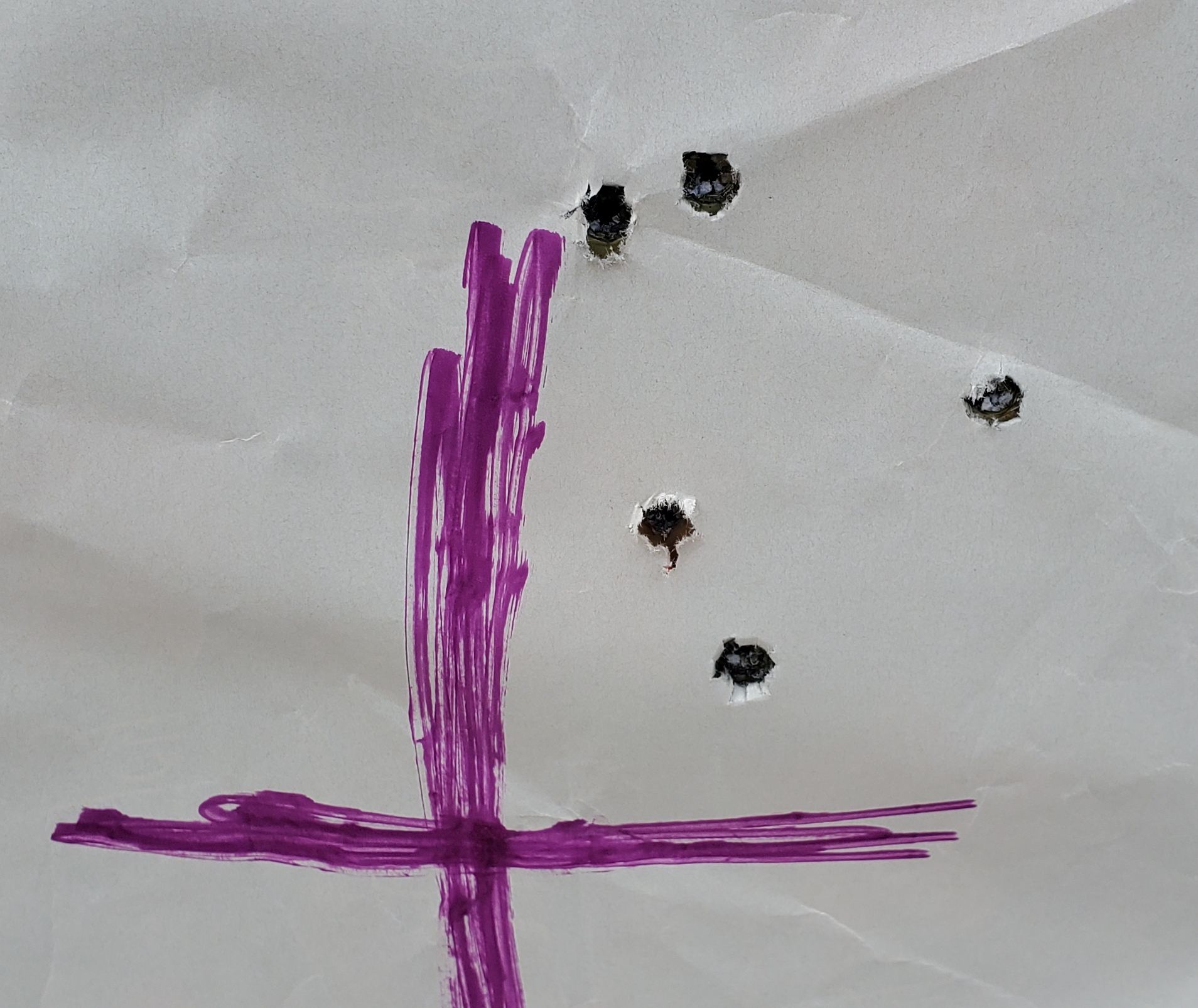

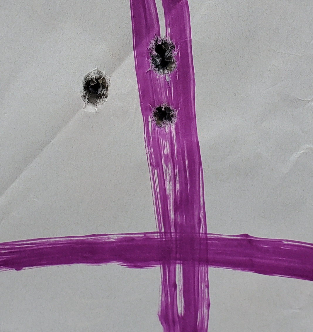

I put 15 rounds of PPU 145gr (FMJ) range fodder barely on paper at 100 yds resting on a single soft bag with a 3-9x40 scope that wasn't nearly zeroed but was good enough to get a grouping, it made a fine shotgun pattern. I spun a bunch of clicks and put 5 PPU 165gr (SP) Rifle Line on paper below and left of the 15. Marginally better but not exciting.
I spun a few more clicks and sent 5 rounds of PPU 165gr (SP) "Standard Rifle" rounds downrange. It may seem silly but one of my rifles can tell the difference between the two. The result was almost encouraging, probably mostly because I was finally hitting POA. Those are not keyholes, that's just completely unsupported christmas wrapping paper catching a bullet.
Clicked it up a bit and tried 5 more Standard ... OK but not exciting.

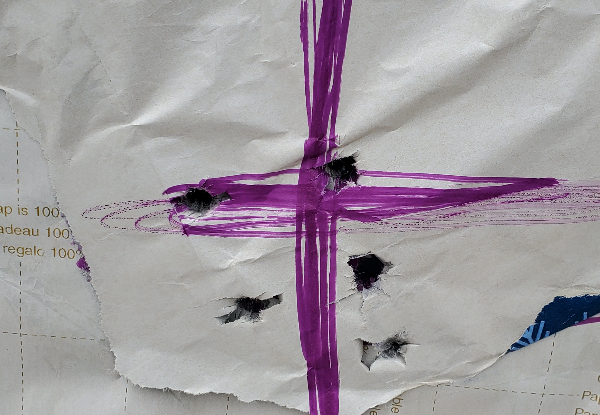

What the hell, why not put the suppressor on it.
That can't be right ... try it again but concentrate a little this time.
Hmm, maybe this rifle likes copper in the bore. Rifle line? The "flyer" is probably on me.

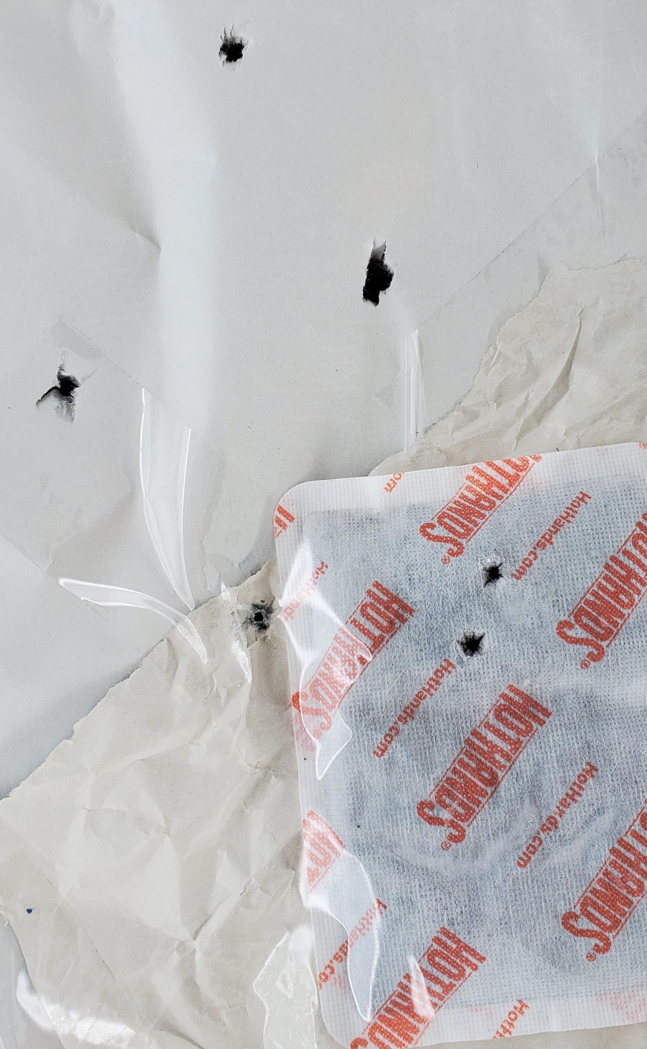

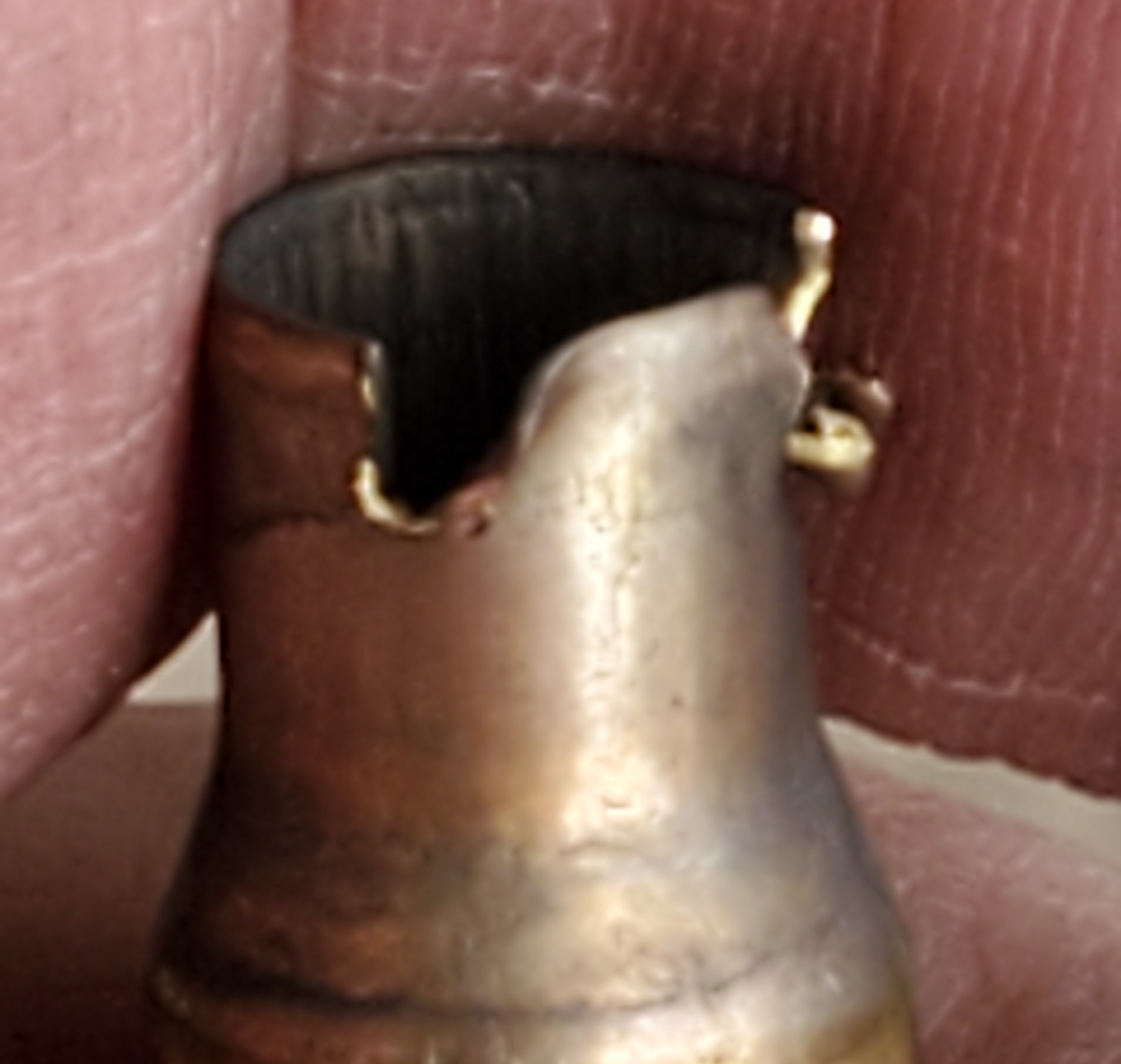

I'm pretty stoked now so I decide to switch to the thermal. By now I've got 40 rounds into it after the last cleaning from the Tubbs experiment. While I'm printing my version of the Big Dipper on paper because I forgot, for just a minute, how the Thermal sighting worked I got a couple three feed issues so I upped the gas two clicks and then this happened. I had to tap the case out with a cleaning rod. Obviously, now, it was an extraction issue not a gas problem and I managed to mangle one empty case mouth and crush one soft point because I was just clearing jans letting the brass fall into the catcher and not paying attention.
But I did manage to get a couple hits on the Hot Hands before the case stuck. Don't pay any attention to those 4 wandering jews out in the desert, they were following the wrong star.
I feel like I'm comfortable with the accuracy now. It's at least headed in the right direction. Superlative gas block and heavy buffer are the sum of my mechanical changes right now. Recoil was not bad at all with this ammo in this configuration.

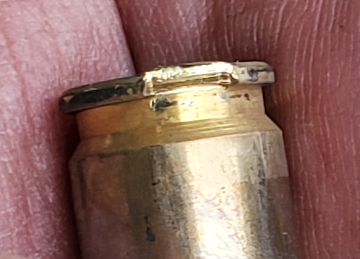

The case rim being ripped off is over gassing.
You tune a gas system like this by turning it off, then open it 3 clicks and fire 1 round with a mag in it. Keep opening it until the mag locks back the bolt. Then open it 1-2 more clicks and that’s generally the setting.
When the rifle fires, for a moment the case is stiction jammed in the chamber at 55,000 psi of pressure. It’s completely immobile and can’t be rotated or pulled out.
If the bolt tries opening in the stiction time zone it’ll rip the rim off not eject it. More gas makes this more likely.

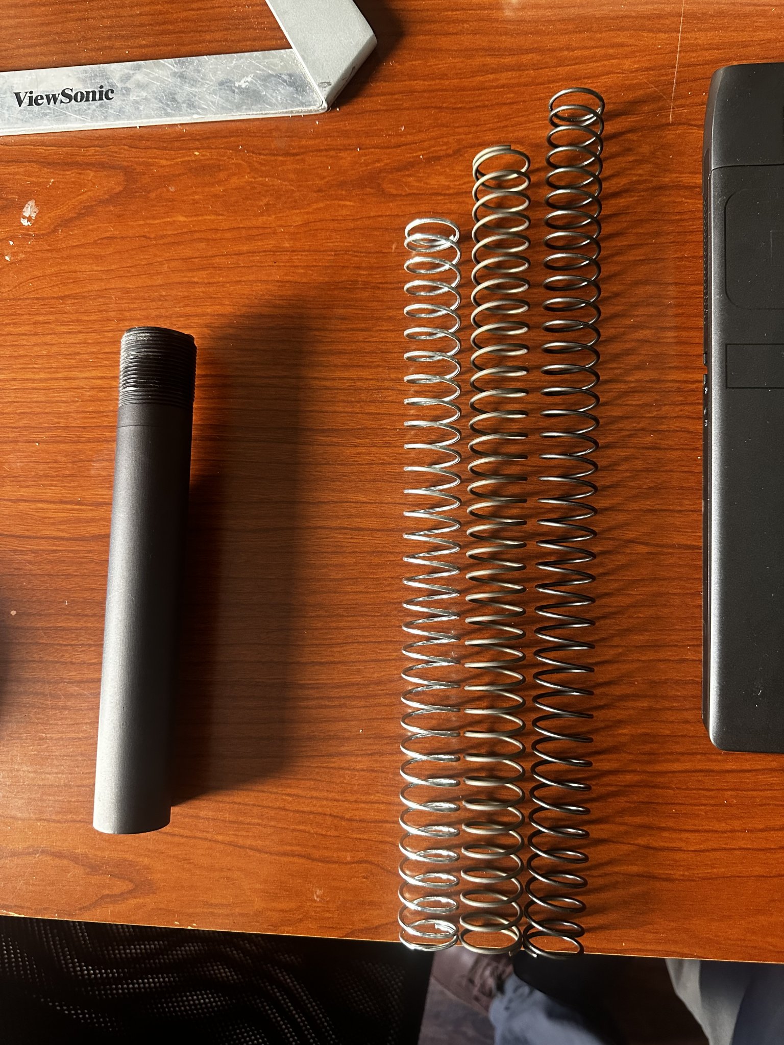

So I got the POF buffer tube. Its interior is completely smooth and well made - the outside has poor surface finishing due to machining on a worn/improperly setup machine. It is within spec and my stock is tight and works good on it.
This is the sort of part I don't mind seeing - its functional areas are like a mirror and its cosmetic stuff doesn't warrant a premium price. And a $50 buffer tube isn't a premium part.
Its certainly going to work better than the cosmetically more attractive Ruger tube with awful critical surfaces.
Also, JP extra power AR15 (not AR10) on the left,ROGUE spring in the middle, and Ruger on the right.
Reactions: AXMC and doubloon
My understanding is that Ruger's spring is longer than rifle or carbine?
Basically yes but some brands of rifle springs are pretty long ... close to or right at 13", "most" are around 12" maybe less and some are pretty short but still called "rifle" springs.
The guy in this video covers some decent ground on bolt/spring/buffer differences between several AR-10s at the beginning of the video ... he's pretty chatty but still good info.
ETA: If you watch this video long enough to get to him shooting his SFAR both unsuppresed and suppressed you'll see the brass ejection rotate back and forth between around 4:00 to 2:00 within 20 rounds from the same magazine. This is one of the things I experienced early on with my SFAR but I've been using the brass catcher lately so I don't know what it's doing now. When running hotter hunting loads like Core Lokt the recoil would change dramatically between shots ... one relatively normal, the next kicking like a mule.
Reactions: Charmingmander

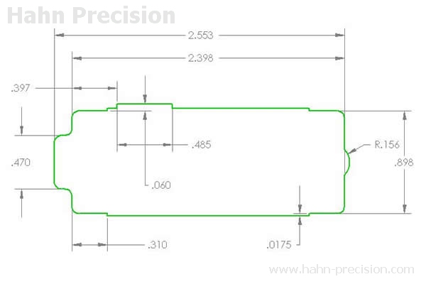

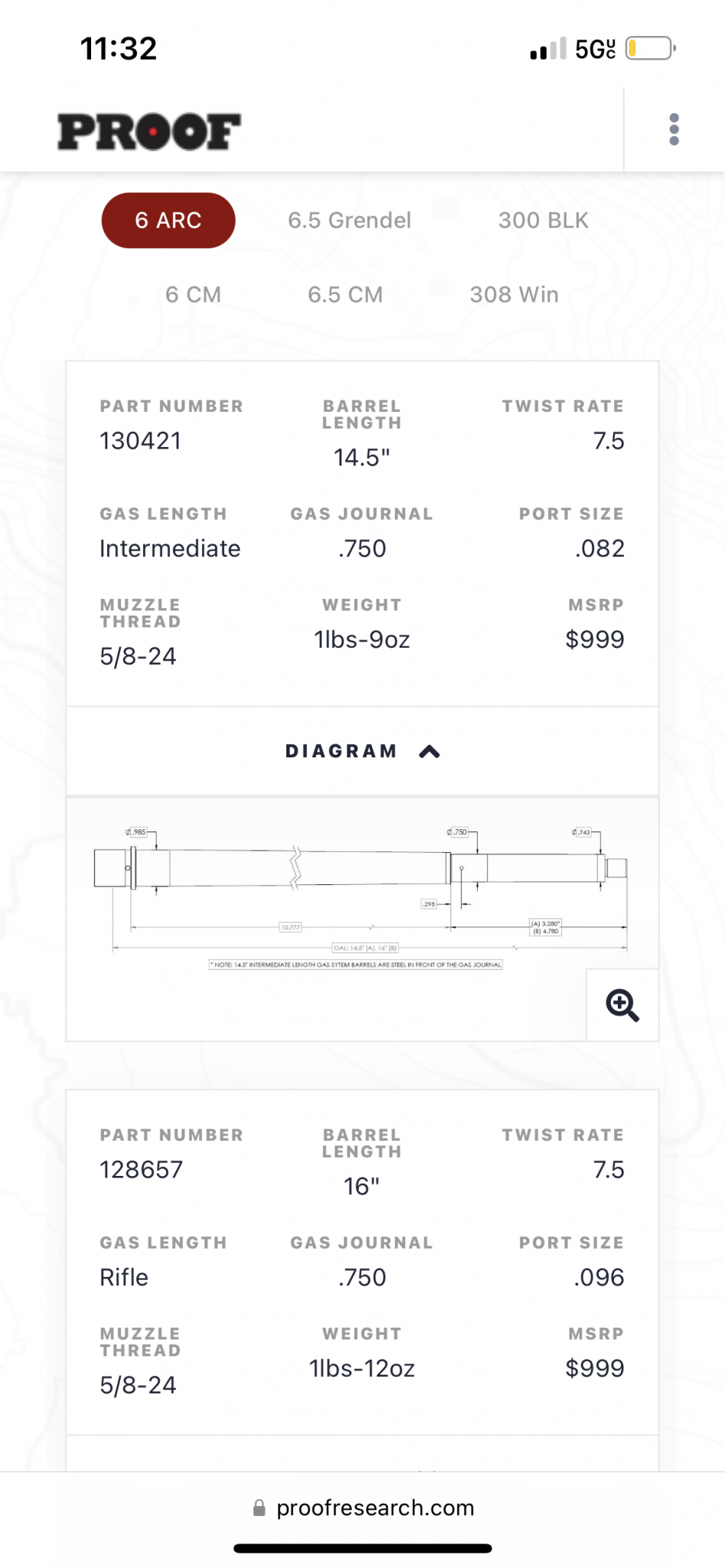

6 ARC is AR-15 mag well, small frame, .441” compatible Grendel bolt face, Grendel mags, 2.260” Cartridge Overall Length (COL).
The Ruger SFAR is designed around .308/.473” case head cartridges and magazines with 2.800” COL. It’s basically an AR-15 sized receiver set with an AR-10 magazine well incorporated into the lower receiver, with the FCG moved back ~.625” like POF did with the Revolution and Rogue. The upper receiver mag well orifice is elongated slightly to the rear to accommodate AR-10 mags.
The Revolution, Rogue, and SFAR use fatter magazines with feed lips designed to contain .473” diameter case head cartridges with .470” bodies.
If you wanted longer COL in 6mm based on PPC/Grendel cases, you would be looking for the smaller .441" width mags/magwell, with 2.500” COL.
If you work out the trajectories, you’re looking at very marginal improvements for pretty significant back-end efforts in receiver and magazine design, testing, development, and evaluation before going into production.
An easier solution is to make magazines with thinner walls up front like PRI and get 2.300” COL. These are the AR-15 magazine well specs as seen from above:
You can see the maximum absolute internal length for double-stack, alternate feed presentation is 2.398” for a press-fit, stuck magazine, not taking into account the wall thicknesses. Once you account for magazine wall thicknesses and variations, slip-fit clearance and drop-free on its own weight, you realize why we’re limited to 2.260” COL for the loaded cartridges in the AR-15. You can load Grendel, 6mm AR, and 6mm ARC longer in some mags like from ASC and CProducts, but others won’t allow it like Elander.

Good info! Wouldn't that make it a "perfect" 6 creed candidate?
It becomes a different rifle from an engineering perspective due to the significantly reduced bore volume. From a schematics approach, it looks like the exact same rifle, but bore ratio makes it a different animal.
Shooting lighter weight bullets in 6mm, it would be easier to get it to run reliably, like what we see in .243 Winchester box ammo. With the longer bullets common to 6mm Creedmoor, you have a long bore plug in a tight bore, with high chamber pressure and high case volume.
This means you’re going to hit the gas port with really high port pressure and a lot of expanding hot gas volume behind the bullet trying to get out, with a bullet that doesn’t like being forced out. It would take a culture from a company who only accepts top-end performance in reliability to get it to work right.
If I was doing it, I would start off with a port at the calculated port pressure window to be in the happy range of reliability for the system, which means a certain set of pressures inside the carrier’s expansion chamber.
You would want to limit it to a specific and narrow range of bullet weights/lengths as well.
I would personally just shoot 6mm ARC from the AR-15. The juice from 6 Creedmoor doesn’t seem worth the squeeze in comparison when you look at the performance difference between the 2.
