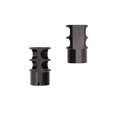

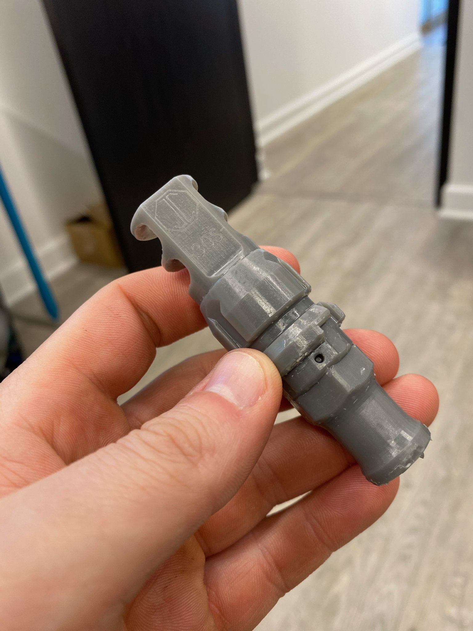

It should work for any 5/8x24 brake or adapter, and fit on your 1/2x28 threads on your barrel. It should even allow you to run a direct-thread 5/8x24 setup if you wanted... Just make sure the adapter is Rocksett'd onto the barrel so it doesn't work-loose under recoil. It essentially just extends the threads just beyond the handguard allowing any type of 5/8x24 mounted suppressor or muzzle brake to be ran on the SA Saint 7.5" 5.56 pistols.
Basically, that handguard and barrel length is very unique, so nothing on the market works to extend that thread distance to allow you to run a suppressor on that pistol and still look "slick" and high-speed, without a custom unit. You can buy long extensions, but they'll look goofy. And most of them are too short, because of the handgaurd is a weird length.
This is why I had this requisitioned by professionals. I came up with the idea, we collaborated and took all the measurements, JMac made the prototypes and finalized and perfected it, and we are all now just waiting on machine time for production. It won't be long...They are coming. Have faith. Like I said, call them and email them every week. The more they hear about them from the general public, the more it pushes them higher on the priority list. 👍🏼

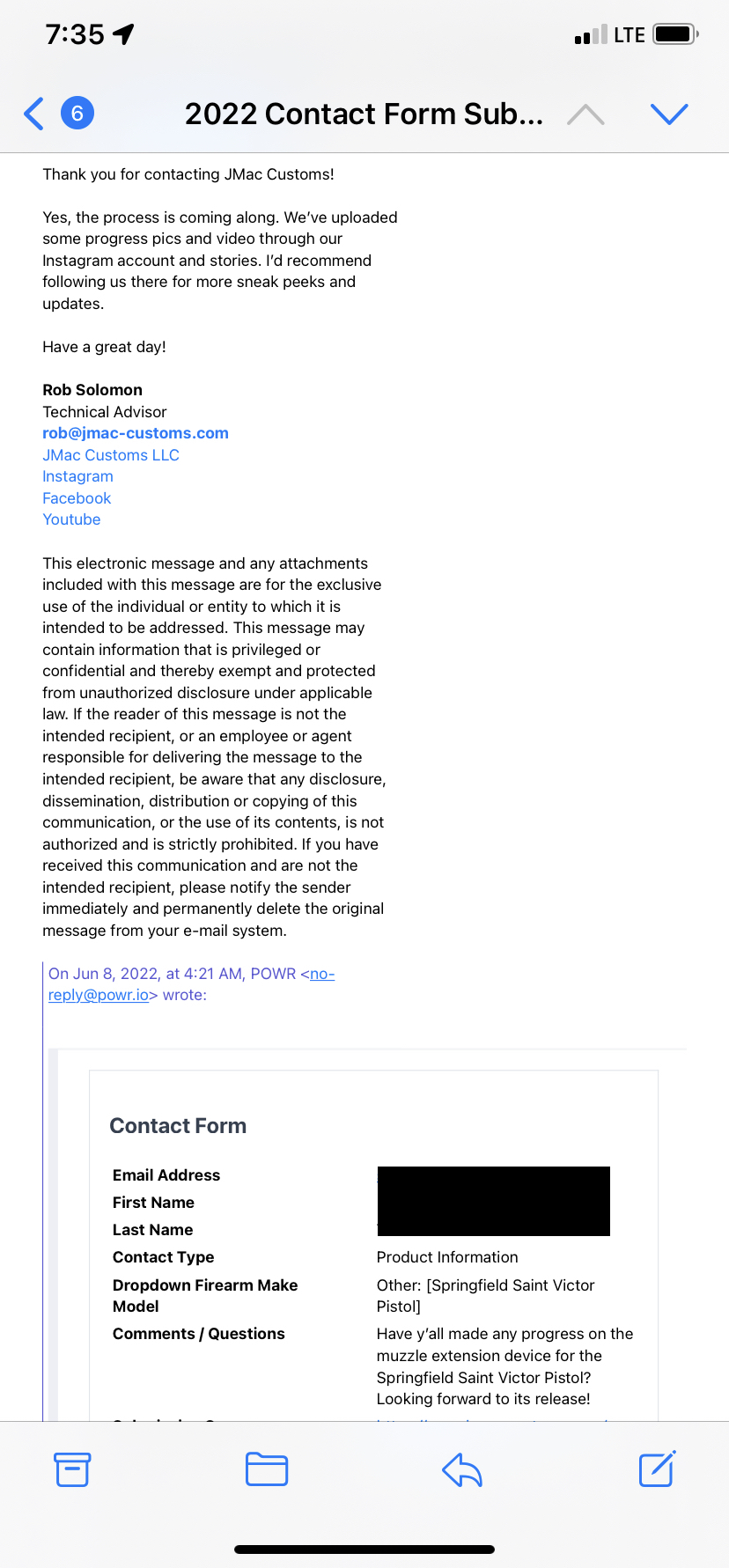

I got a reply from JMac on my email. They said they are planning on making it but there is no estimated time on production yet.

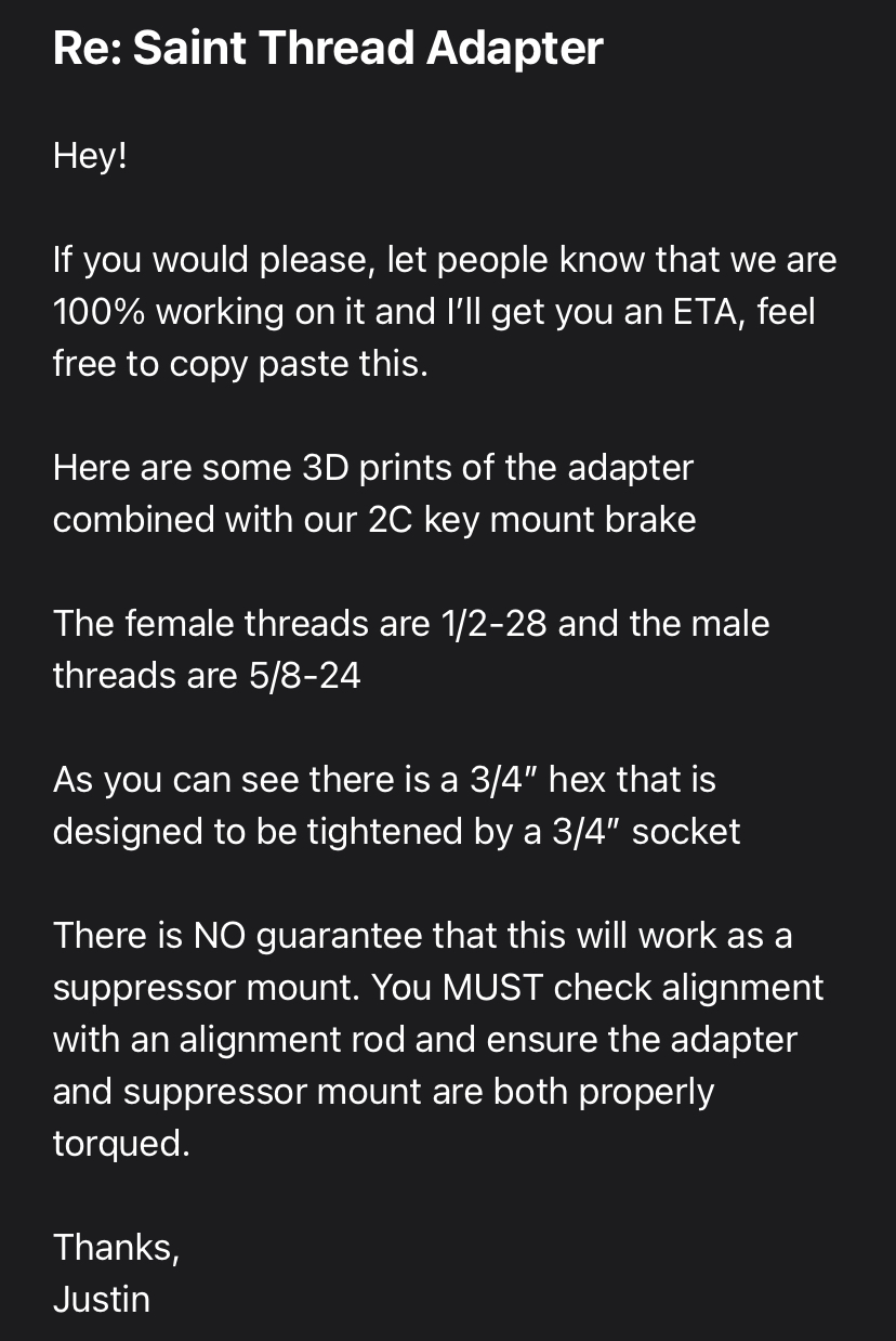

I received an email from JMAC last week and wanted to share. BLUF it sounds like there still is not an ETA on production.
From talking with him further it sounds like they are swamped right now.
Also thank you everyone for starting this effort, I was about to get rid of the Saint due to this.

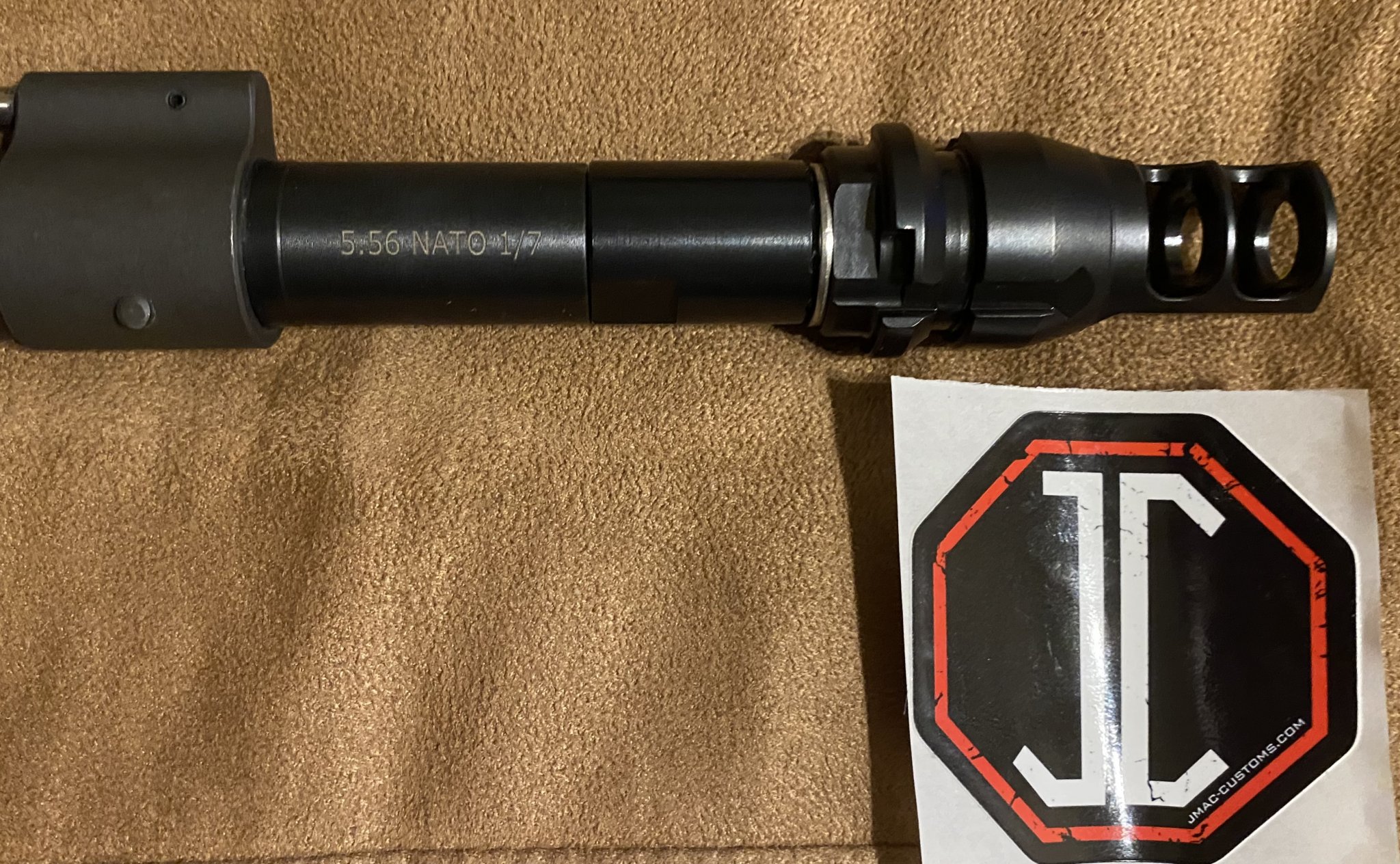

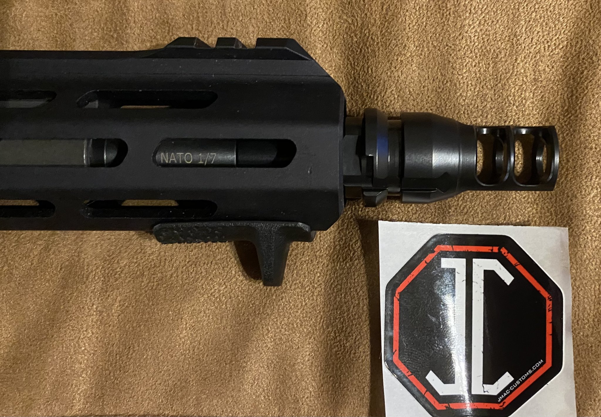

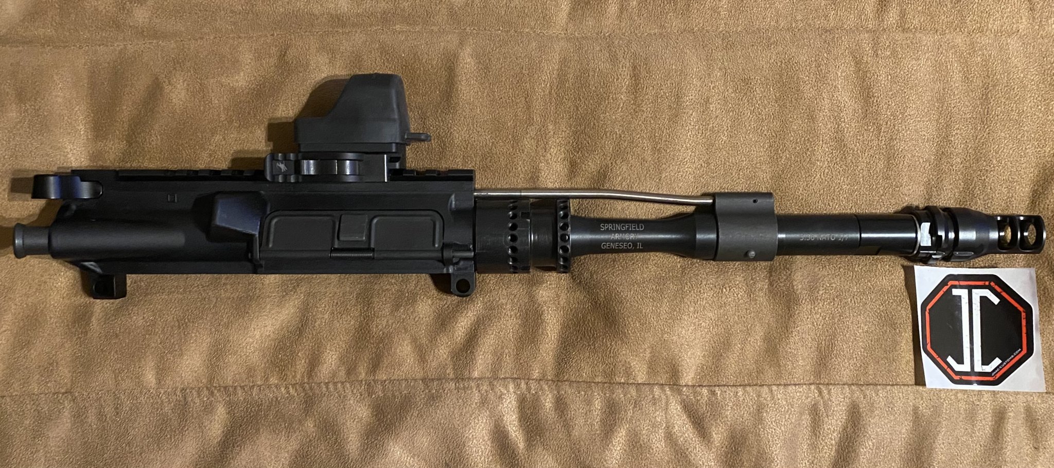

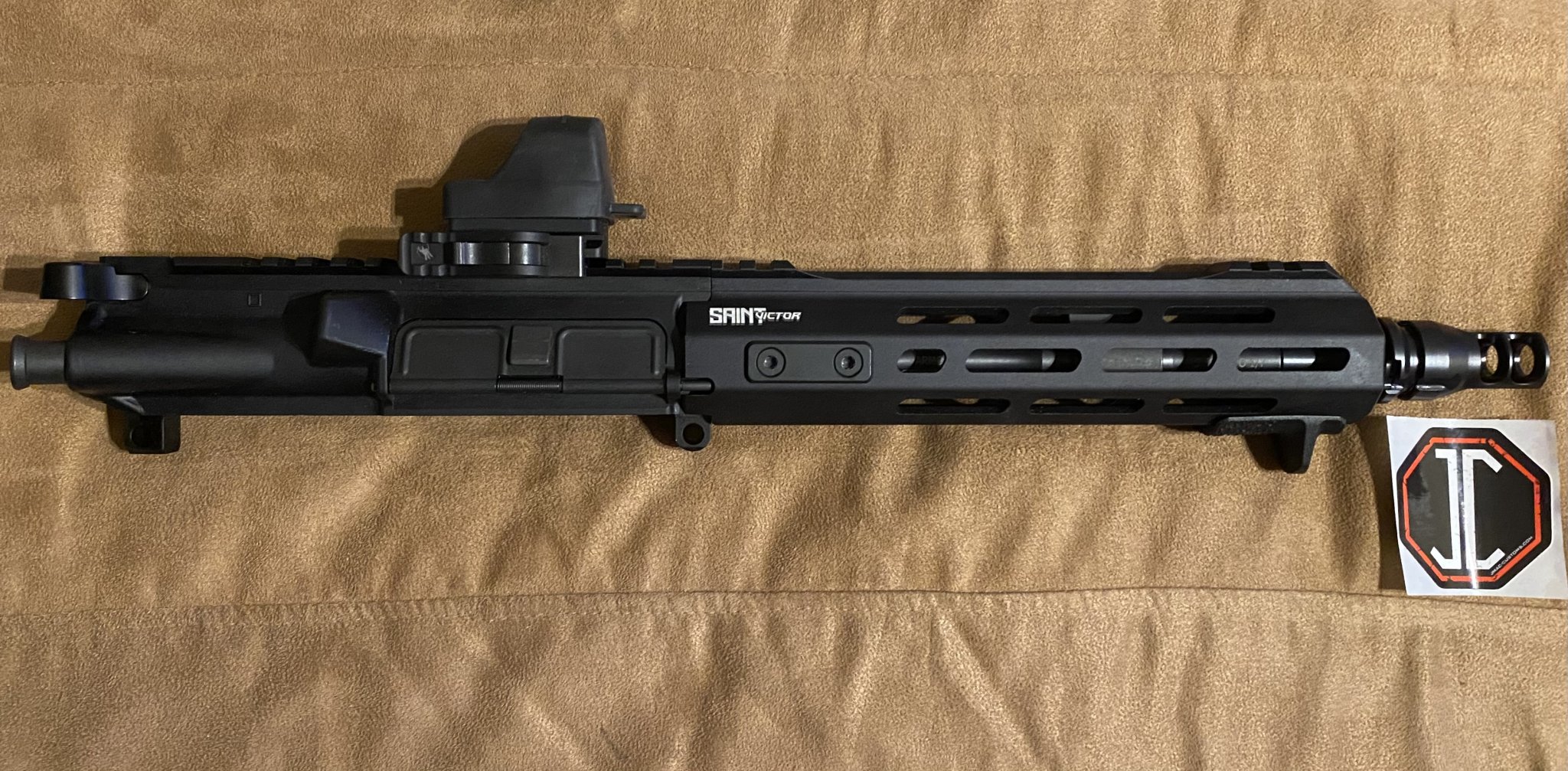

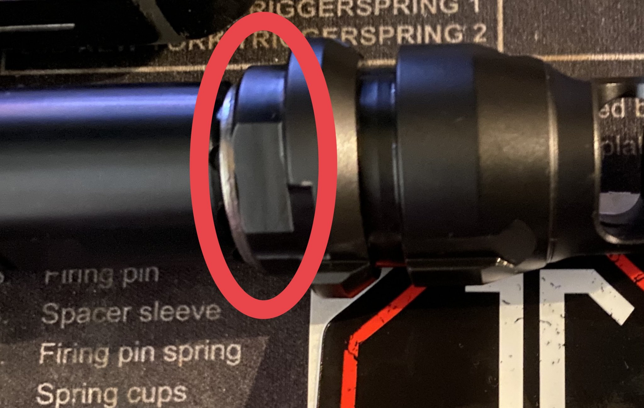

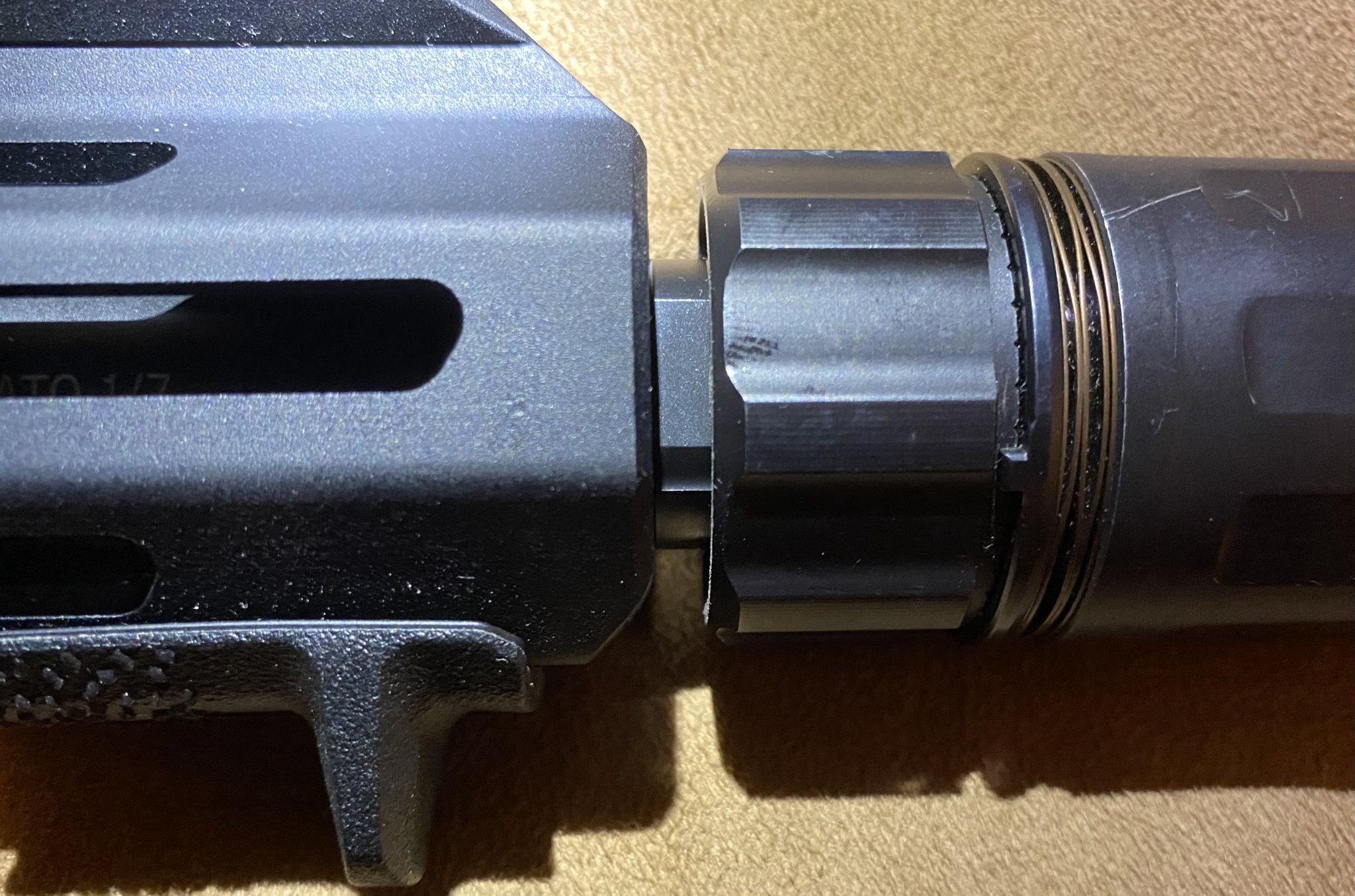

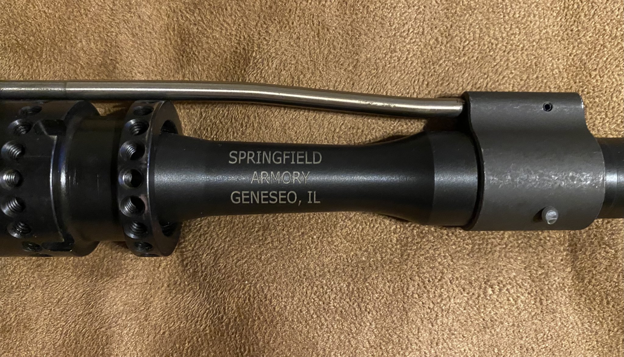

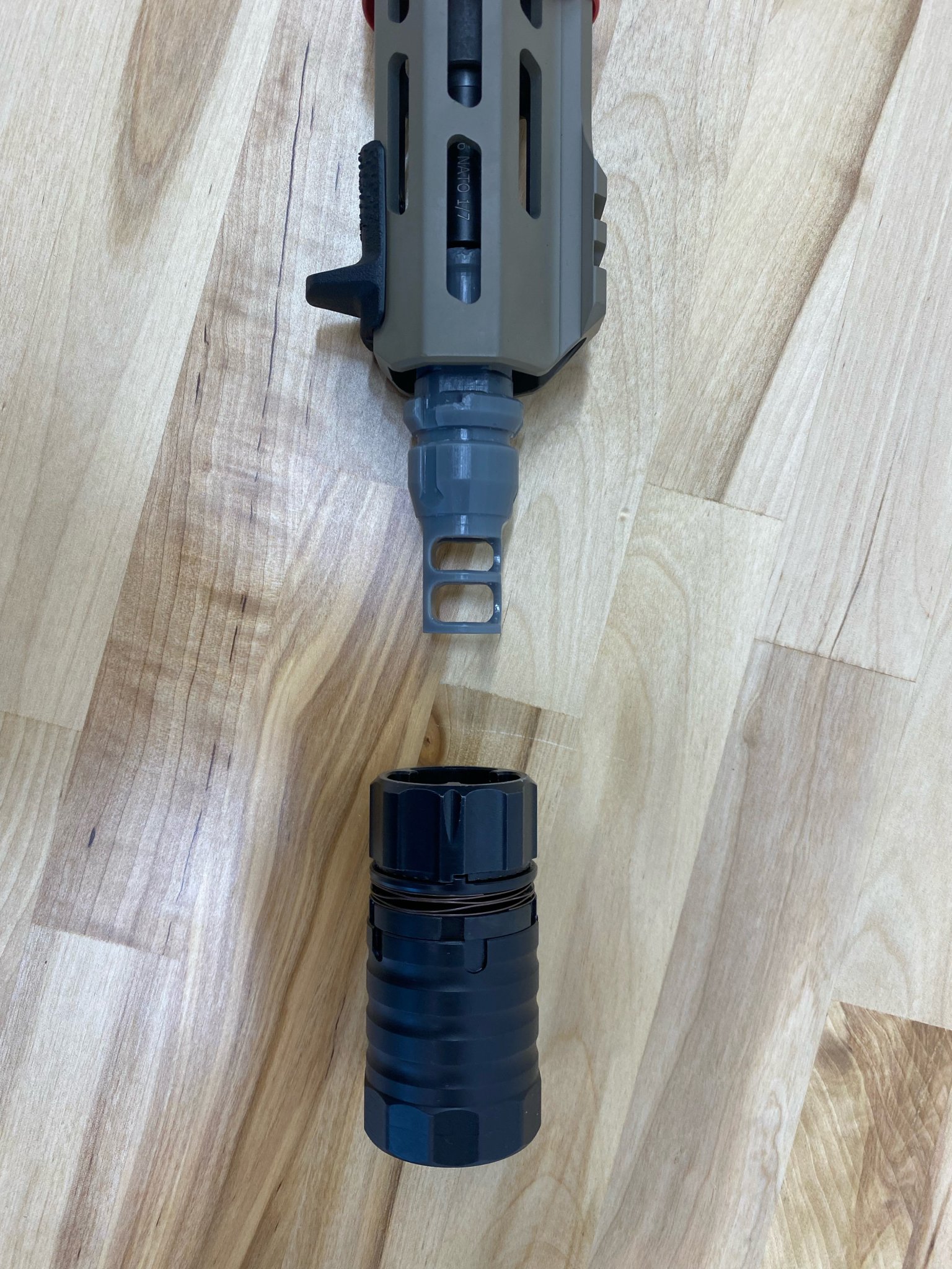

Ok, so I have a postive update...
Here's what you need to make your 7.5" Saint Victor 5.56 able to accept a suppressor... Now, I have not shot this yet, and won't be able to until tomorrow, as you need to let the Rocksett cure in the threaded parts for 12-24 hours before shooting the gun or moving it around a lot. I let it cure at least overnight, but I try to go at least a full 24 hours before shooting the gun.
You will need a KVA (Kaw Valley Precision) 1" barrel extension with 1/2x28 to 1/2x28 threads. And a JMac Customs or Dead Air KeyMount muzzle brake or flash hider. It MUST be the the standard model that does NOT have a "flush" or "face mount" option. It MUST be a model with the small bit of metal after the back locking lugs. I will post a picture showing what I am talking about. Rocksett is available on Amazon for $10.92 for a 2oz bottle...Which will last you a LONG time, just keep the lid on it. 👍🏼 I've been using the same 2oz bottle for almost a decade, and built A LOT of guns, and thread-locked A LOT of parts, and it's still 85% full. USE IT SPARINGLY! If you put too much, it will be nearly impossible to remove without boiling the muzzle device in hot water for hours. Trust me on this.
You WILL need the optional 1/2x28 JMac shim kit for this, to time your muzzle brake.
5/32” gap is perfect!

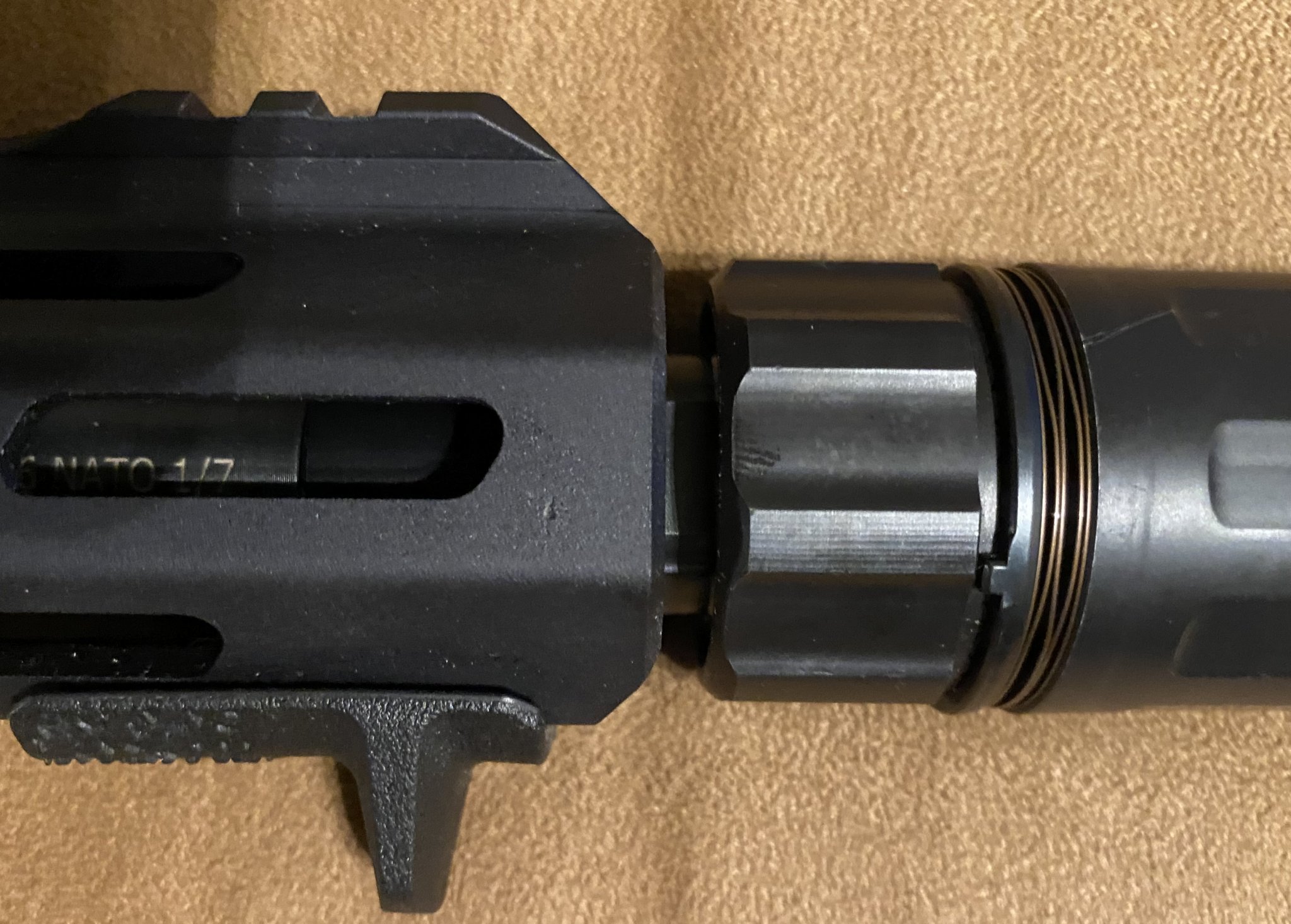

This is the extra thread portion that I was talking that about your KeyMount needs to have, or your suppressor will not fit.
Final product! 😈😈😈

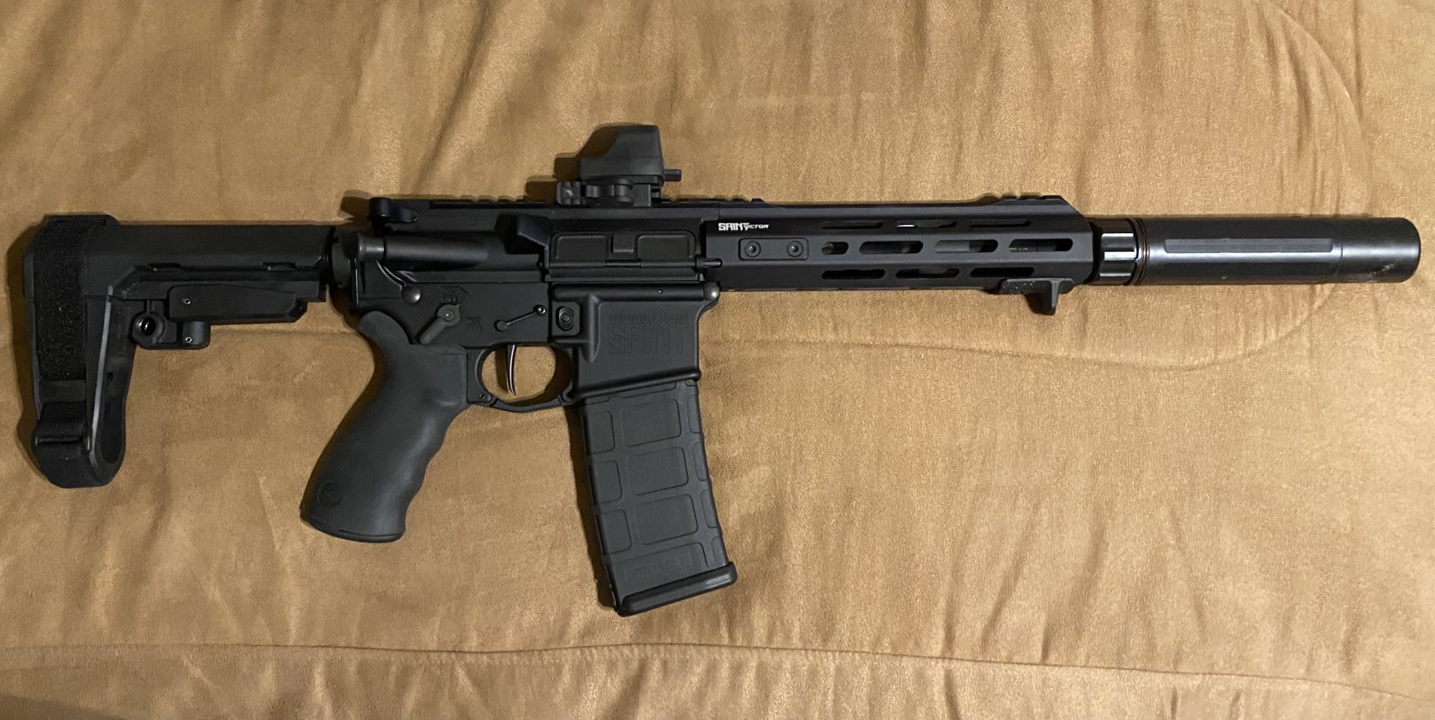

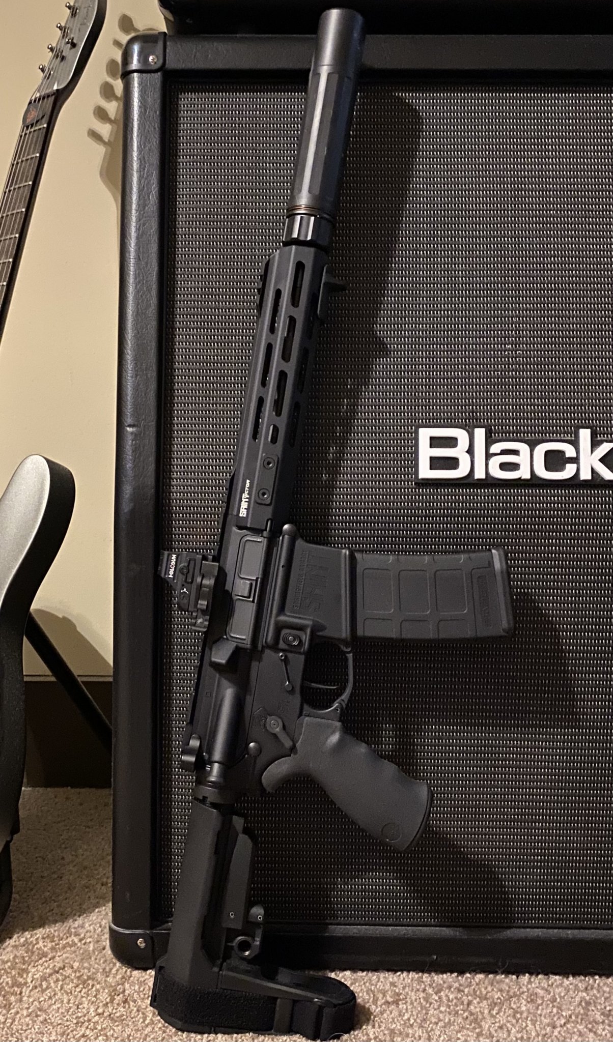

Looks even better with a suppressor than I thought it would!!
