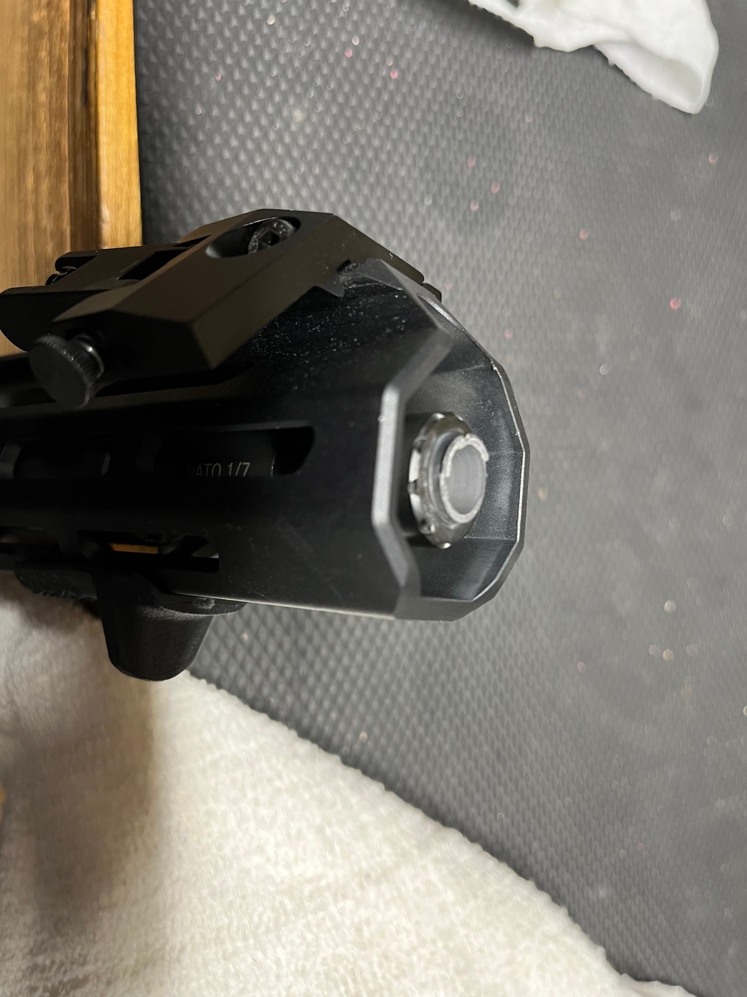

Here's what you need to make your 7.5" Saint Victor 5.56 able to accept a suppressor... Now, I have not shot this yet, and won't be able to until tomorrow, as you need to let the Rocksett cure in the threaded parts for 12-24 hours before shooting the gun or moving it around a lot. I let it cure at least overnight, but I try to go at least a full 24 hours before shooting the gun.
You will need a KVA (Kaw Valley Precision) 1" barrel extension with 1/2x28 to 1/2x28 threads. And a JMac Customs or Dead Air KeyMount muzzle brake or flash hider. It MUST be the the standard model that does NOT have a "flush" or "face mount" option. It MUST be a model with the small bit of metal after the back locking lugs. I will post a picture showing what I am talking about. Rocksett is available on Amazon for $10.92 for a 2oz bottle...Which will last you a LONG time, just keep the lid on it. 👍🏼 I've been using the same 2oz bottle for almost a decade, and built A LOT of guns, and thread-locked A LOT of parts, and it's still 85% full. USE IT SPARINGLY! If you put too much, it will be nearly impossible to remove without boiling the muzzle device in hot water for hours. Trust me on this.
You WILL need the optional 1/2x28 JMac shim kit for this, to time your muzzle brake.
5/32” gap is perfect!
This is the extra thread portion that I was talking that about your KeyMount needs to have, or your suppressor will not fit.

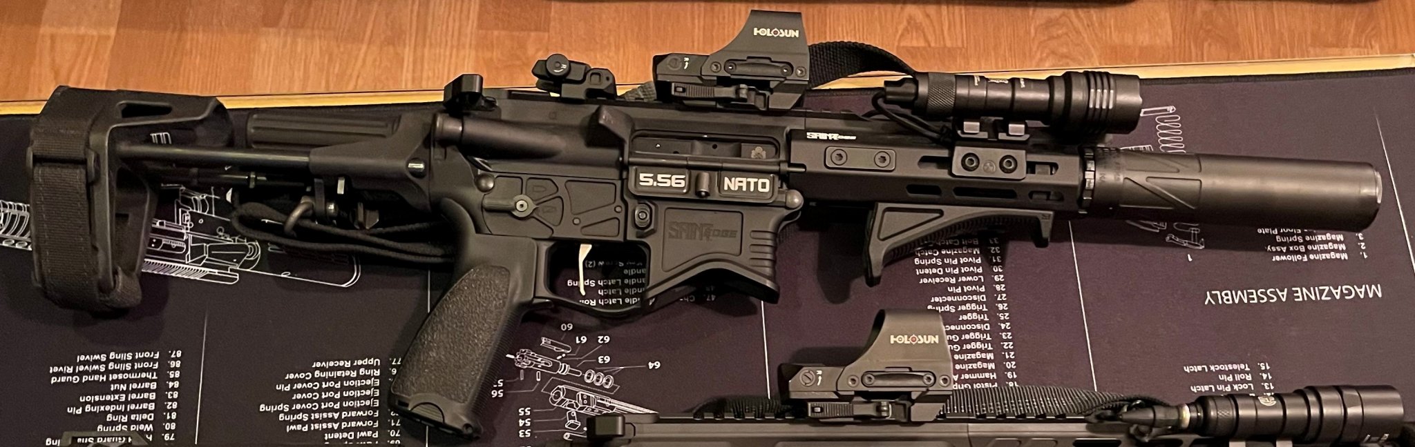

I am running a DeadAir Sandman-S on my AR pistol and after adding DeadAir's E-Brake to the Sandman it almost eliminated the gas coming back in your face without having to change out the gasblock. E-Brake is also supposed to help with decibel reduction as well.

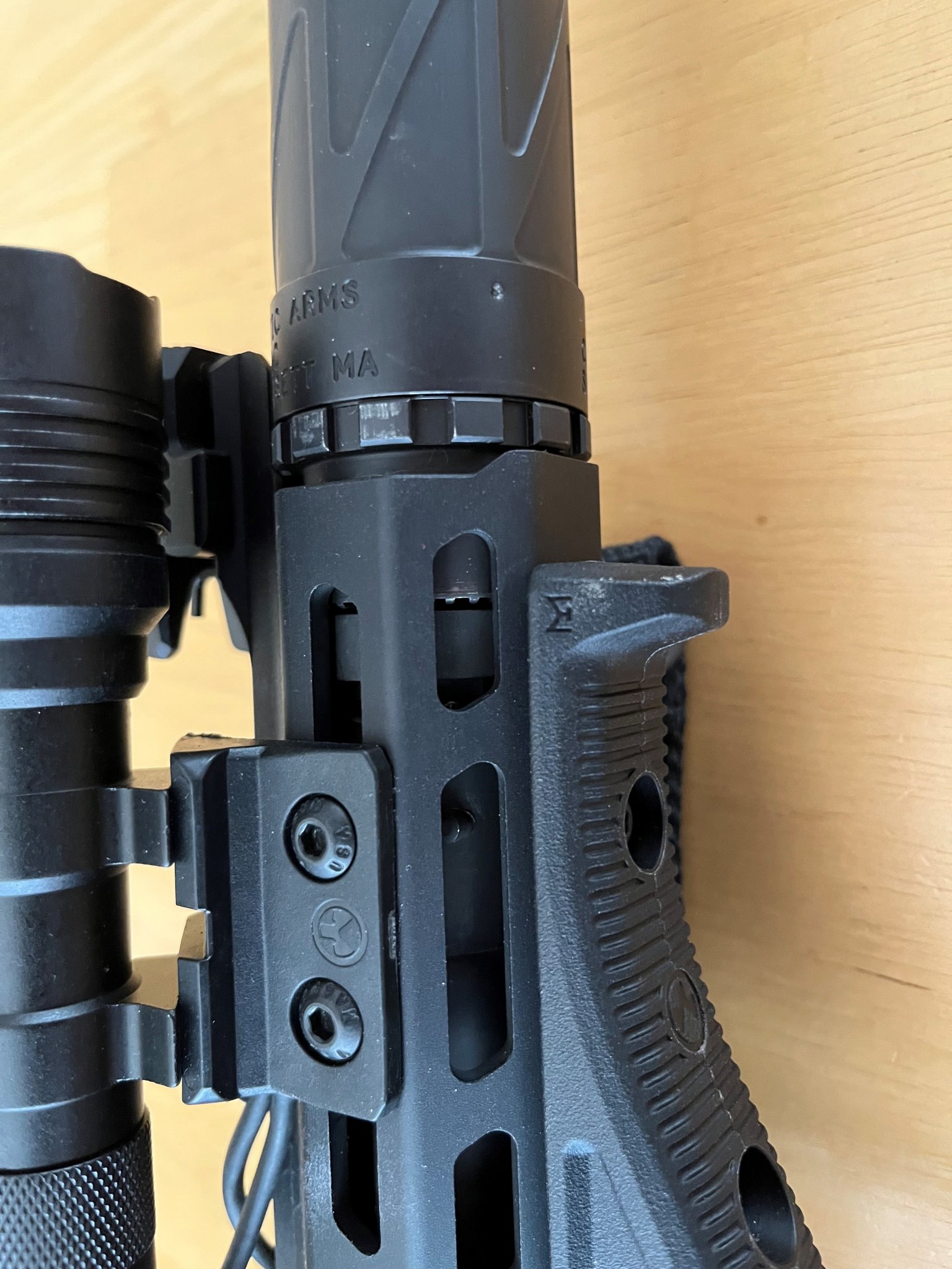

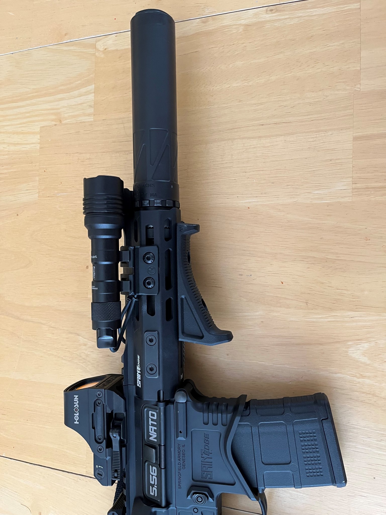

I have the Saint Edge PDW and had the same query about mounting a suppressor. I ended up going with the Yankee Hill Machine Phantom QD Adapter with a YHM phantom QD flash hider. The adapter utilizes 1-3/8"-24 threads so you have lots of options for a suppressor. I opted for the EA Vox-S. The flash hider and the adapter both fit under the factory handguard and is just long enough to clear the end of it.

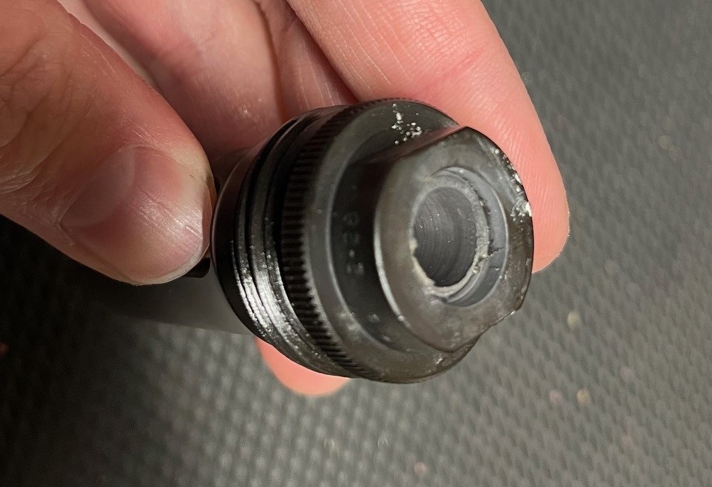

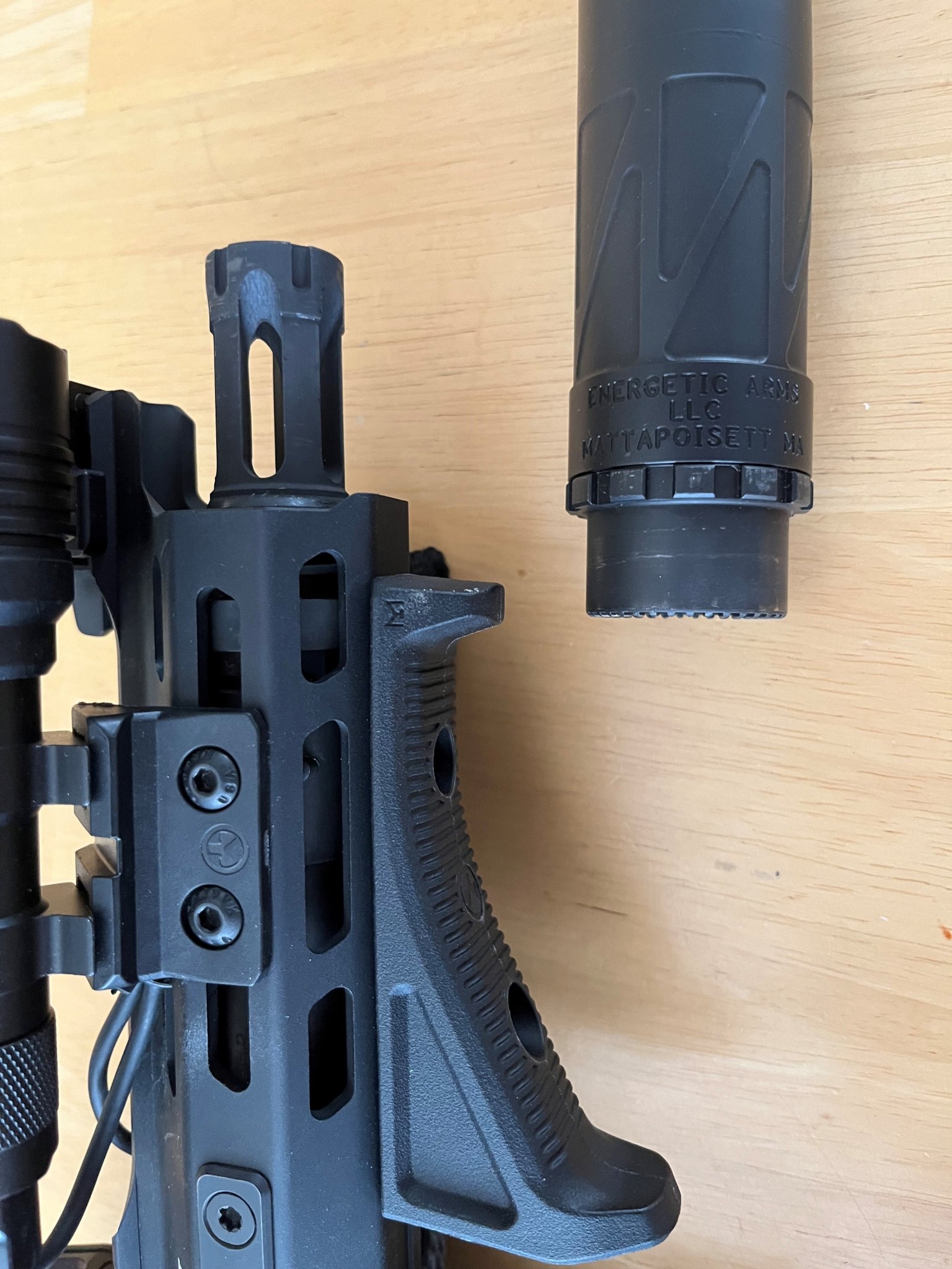

Just wanted to reply back this for anyone looking to go this route and reading through this thread in the future. I have a Springfield Saint Victor Pistol (converted to Form 1 SBR) that decided to suppress with a Silencerco Saker ASR 556K. I bought the KAW Valley Precision 1/2 28 to 1/2 28 1" barrel extender to get me out of the handguard area of the Saint. Then attached the Charlie QD mount to the extender. All work performed by a qualified gunsmith.
After about 16 rounds, the KAW Tactical extender ruptured catastrophically. Thankfully the Saker and the Rifle are both ok. The rupture happened right at the male threaded portion (which is incredibly thin at that point). See below:
Rather than going down the barrel extender route again, I have ordered a 10.5" barrel from Faxon Firearms to get out past the handguard. I'm not thrilled about going from 7.5 to 10.5, but considering the 1" extender, it's really only a 2" increase. And there are some ballistic and suppression advantages to the added length as well.
TL/DR version: I do not recommend the KAW Valley barrel extender!

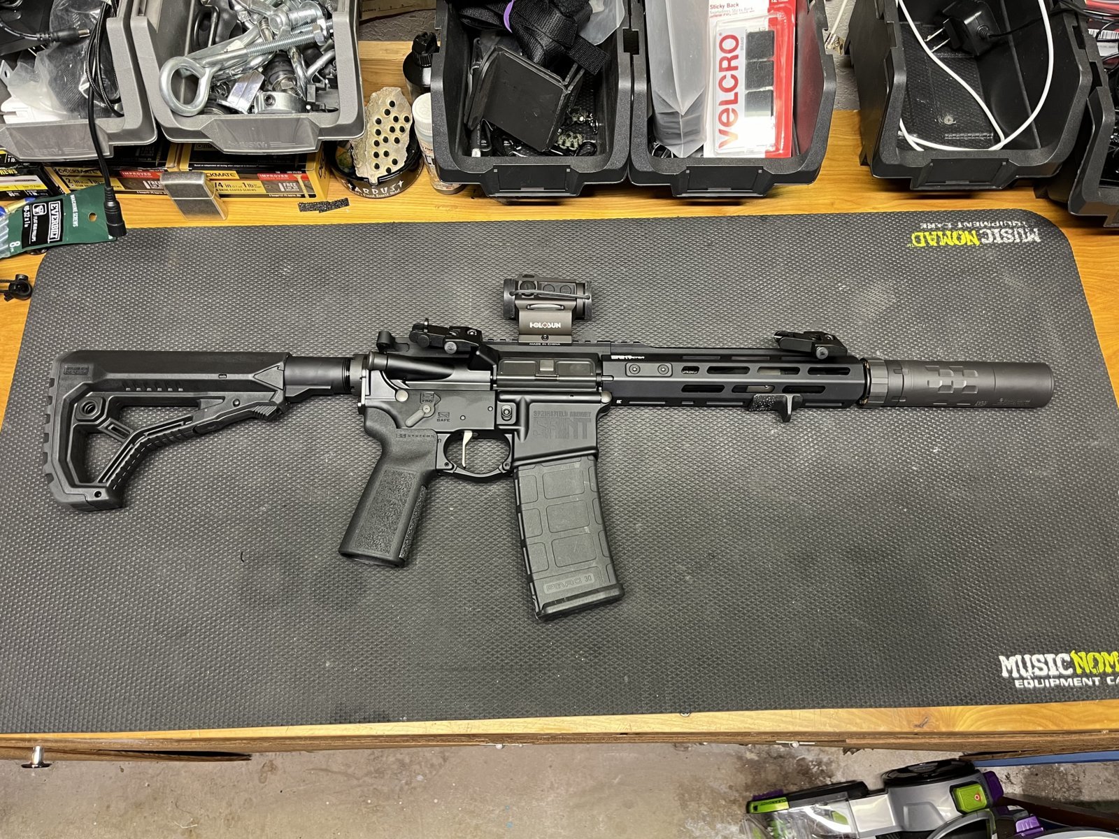

Photos of my setup before everything went south:
That sucks. I still haven’t had any issues with mine. You might have just been unlucky and gotten a lemon that had a defect or void in the alloy. That’s the first one of these I’ve heard of having an issue. 🤷🏼
Does the saint use a proprietary handguard? If not, you could switch that to a larger diameter HG that would accept the suppressor. Or, maybe you could get a slightly shorter Saint handguard? Or, hack saw and rattle can the existing hand guard. All of the above is predicated on wanting to keep the firearm short.
I like the look of a suppressor tucked under a long handguard. But, a thinner HG feels handier to me. I’m in the midst of a build and am currently torn by those options. I have a fat 15” HG and a svelte 10” HG.
Anyway, it’s possible that you could keep the short barrel if you prefer it…
