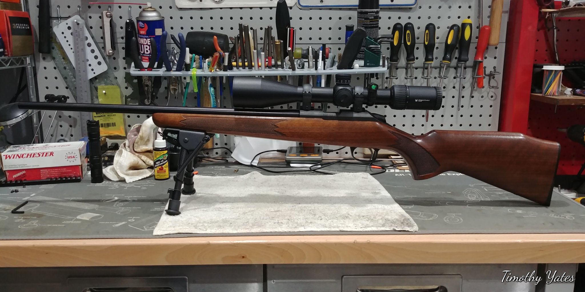

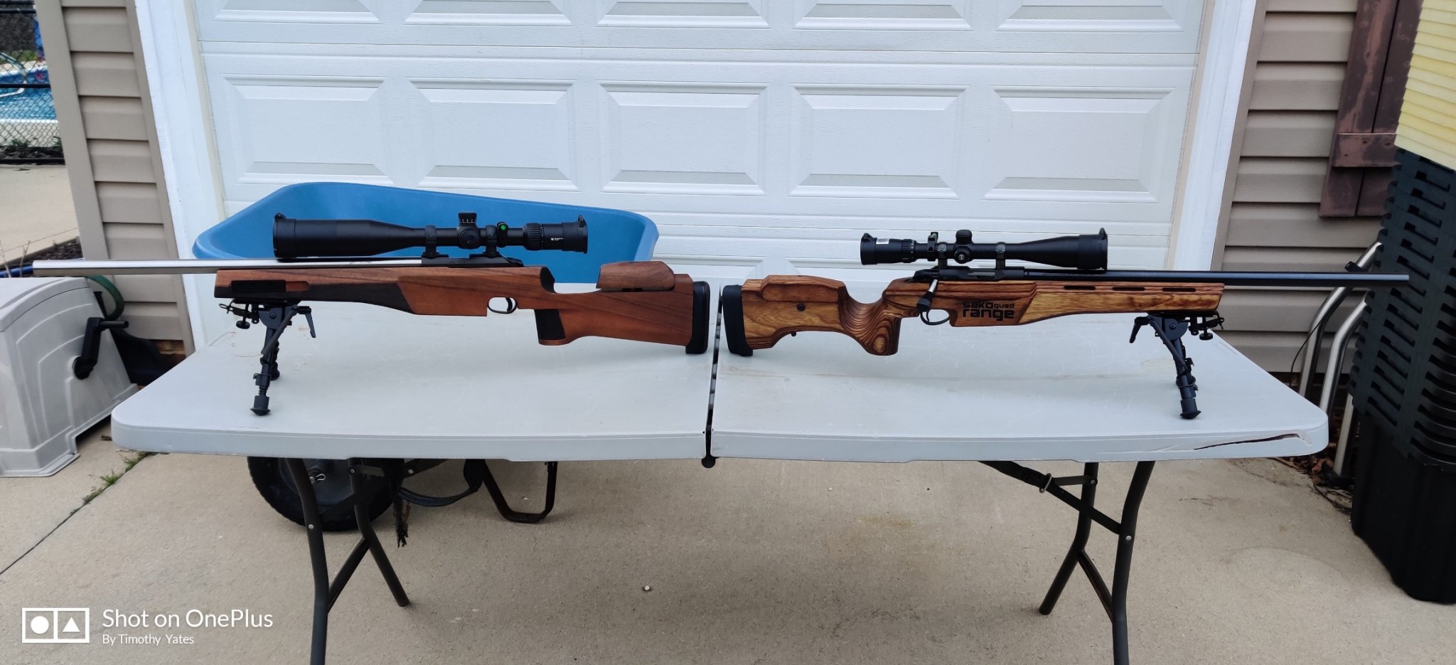

First Finnfire Range I bought.
Second Finnfire Range. Bought this with the intent on putting on a 17 HM2 barrel.
Third Finnfire I bought. This one was missing the magwell and magazine. After buying a magwell I have $570 in this rifle.

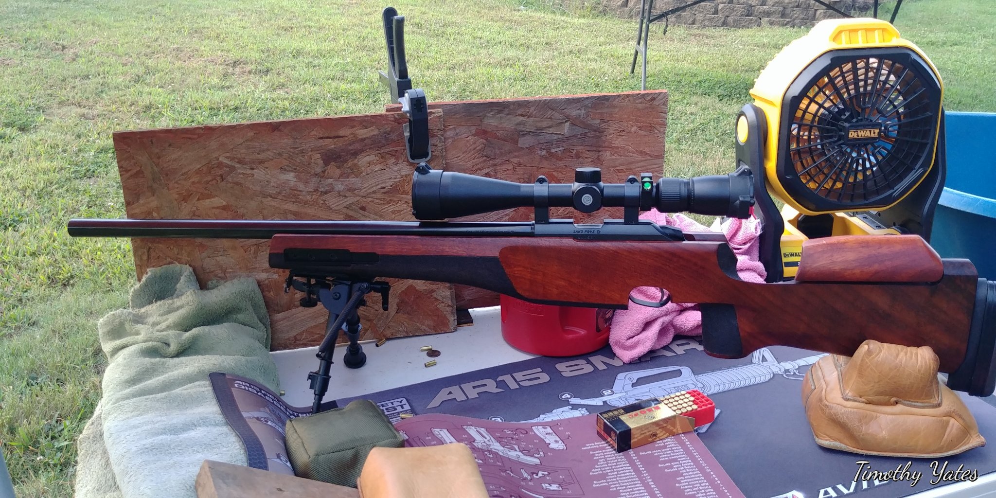

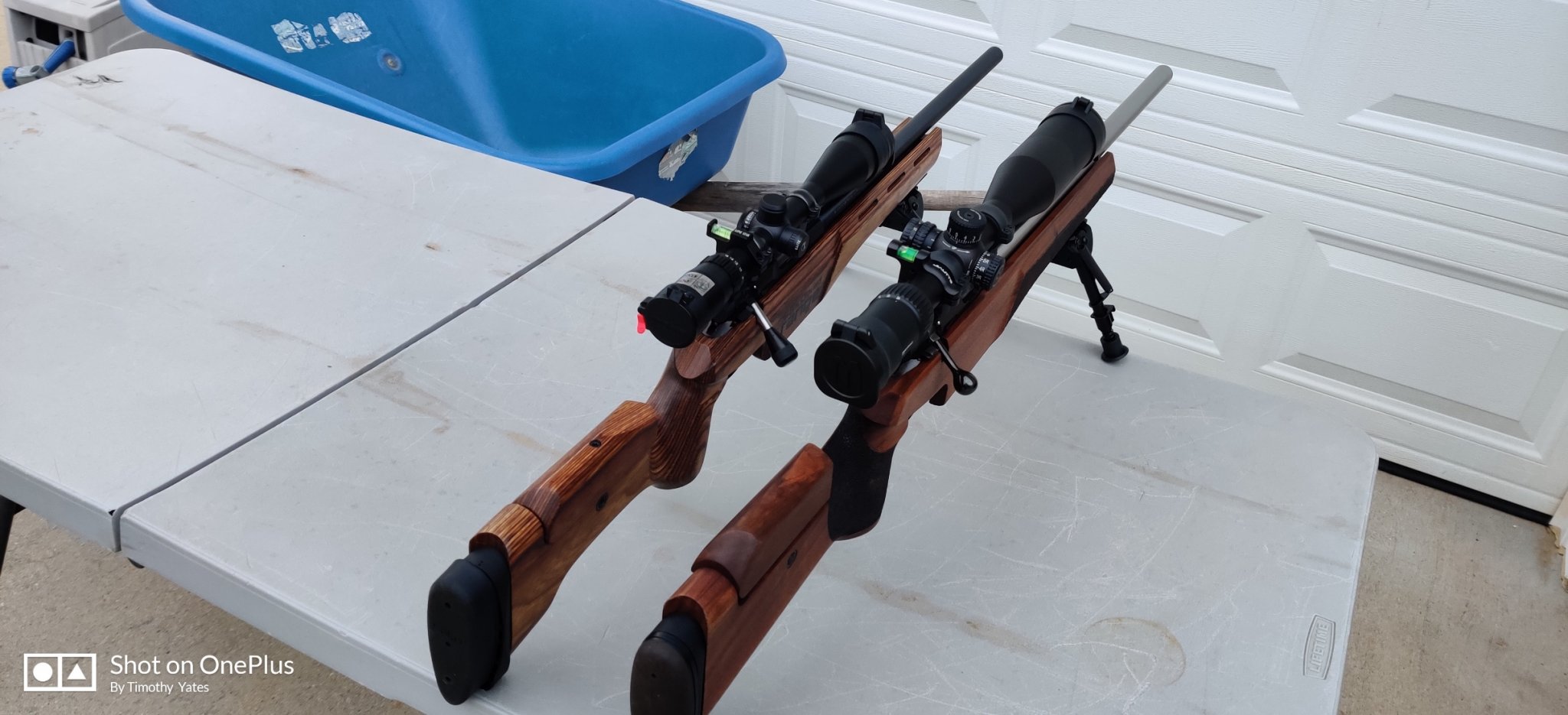

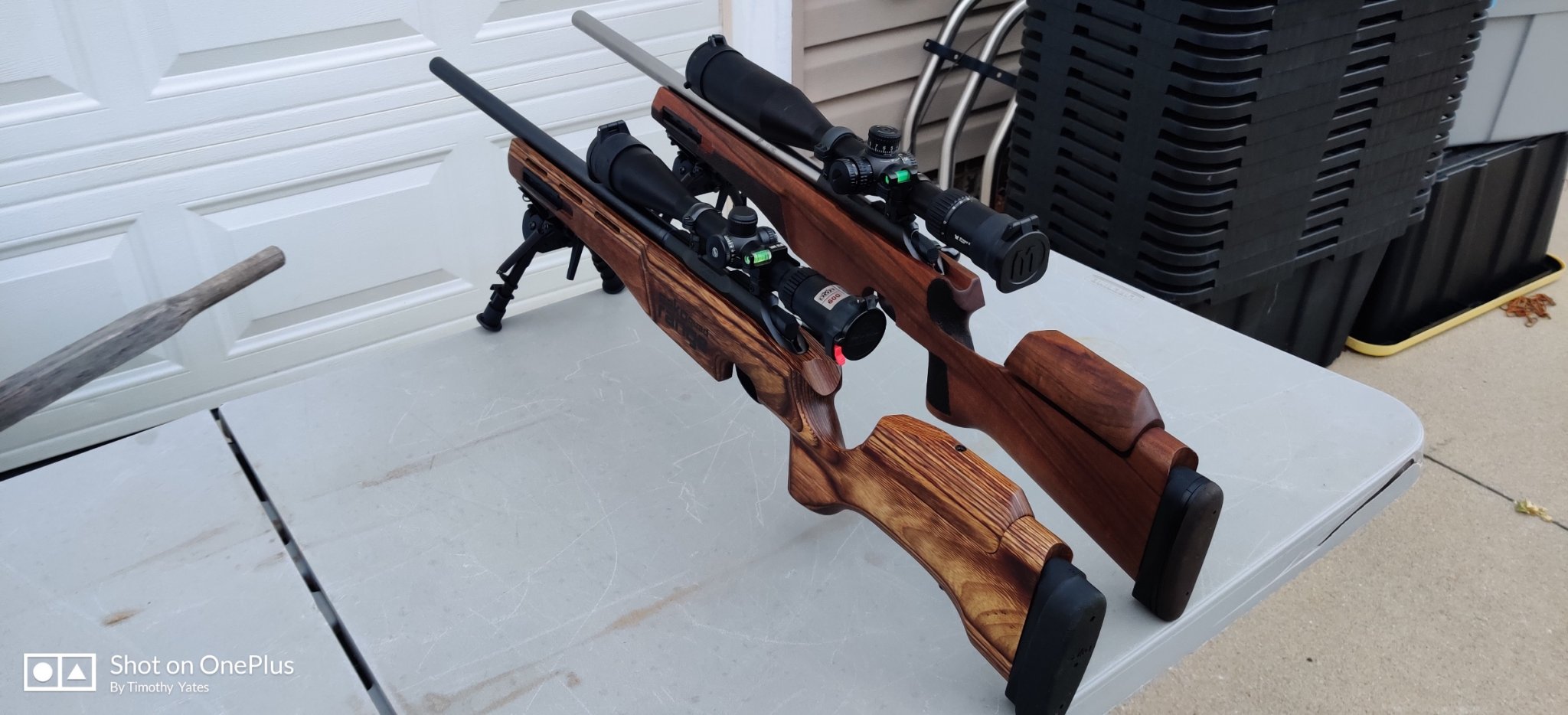

A day shooting the 17 HM2 and Quad Range. Decided to take some comparison photos.

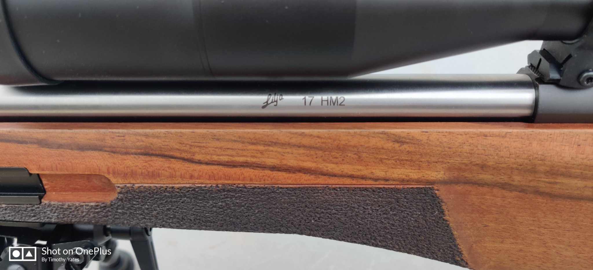

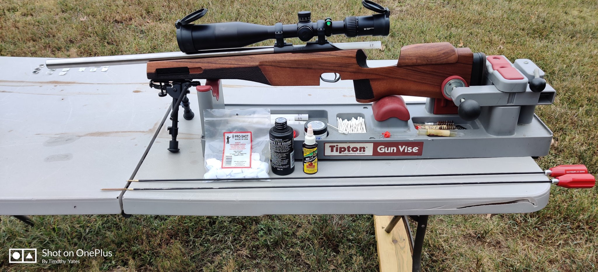

Break in day for the Lilja barrel. Done according with Lilja instructions.

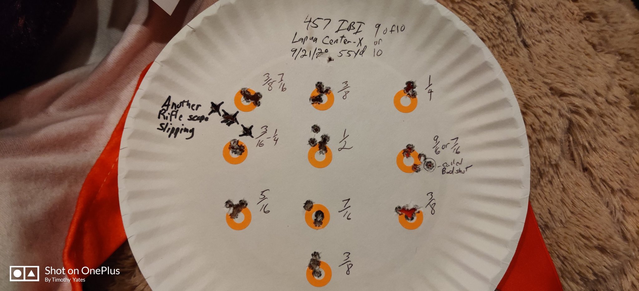

Absolutely. Rimfire accuracy is about great barrels finding compatible ammo
I would agree with Sgeorge. Any quality barrel with the right ammo will shoot right along with the $2,500 rifles. What you get with that $2,500 rifle "IMO" is more opportunity or better odds of getting a better shooter in general and being easier to find great shooting ammo.
For example, late this evening I shot my 457 with IBI barrel. I have approximately $650 in this barreled action with stock trigger, $1,400 with the MPA chassis.
I shot this target this evening with the above rifle. I have three Anschutz with the 54 action that won't shoot any better than this. The difference is if I bought 10 different types of ammo the Anschutz will probably shoot 5-6 types like this where as this 457 with IBI may shoot 2-3 like this. I do have some SK Rifle Match and Lapua Pistol King that will shoot like this in the 457/IBI.

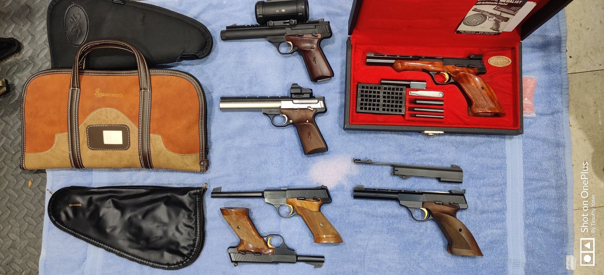

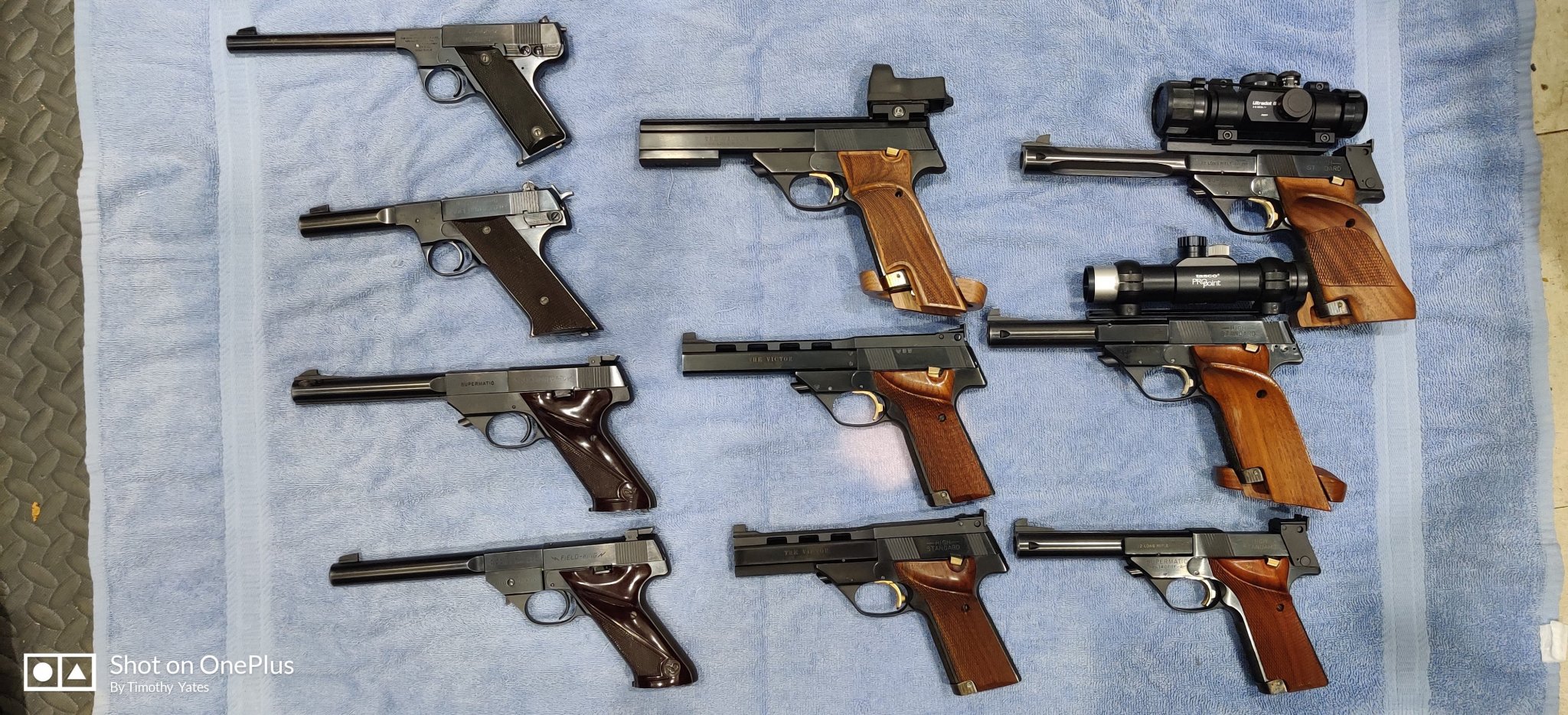

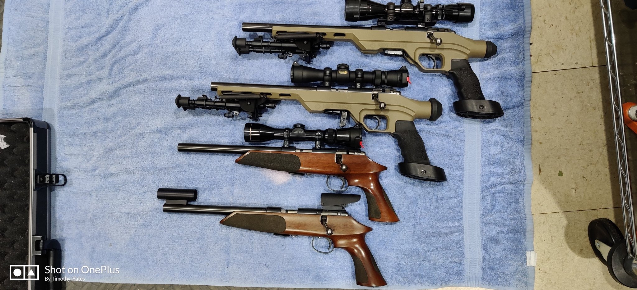

When I took the photos, first I took a collection photo then a photo of each individual handgun both left and right side plus a close up of the S/N if I couldn't read it in the other photos.
High Standard collection.

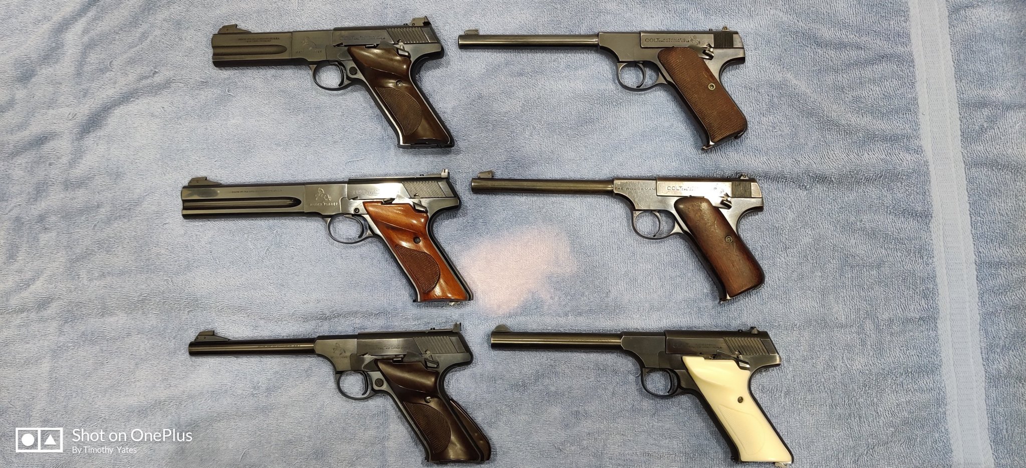

Colt collection.
Browning's

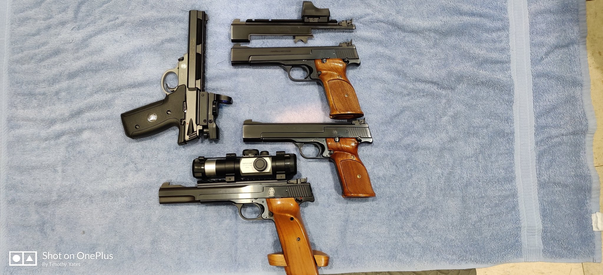

Smith & Wessons's

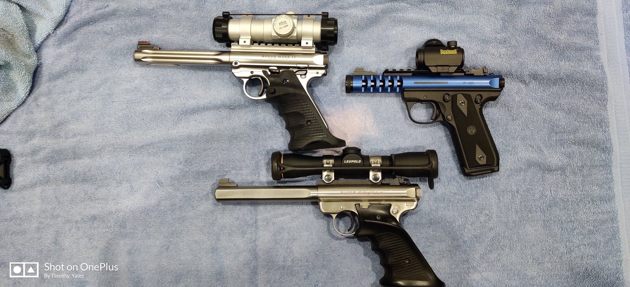

Ruger's

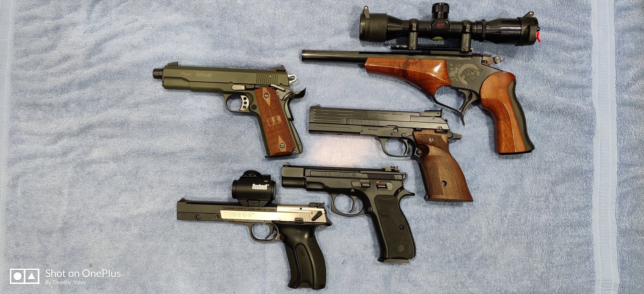

Various one off.

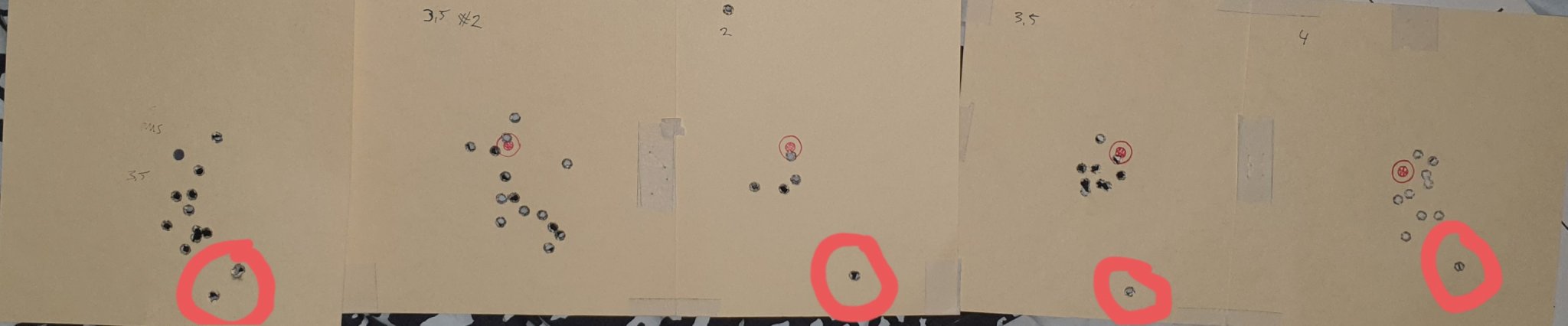

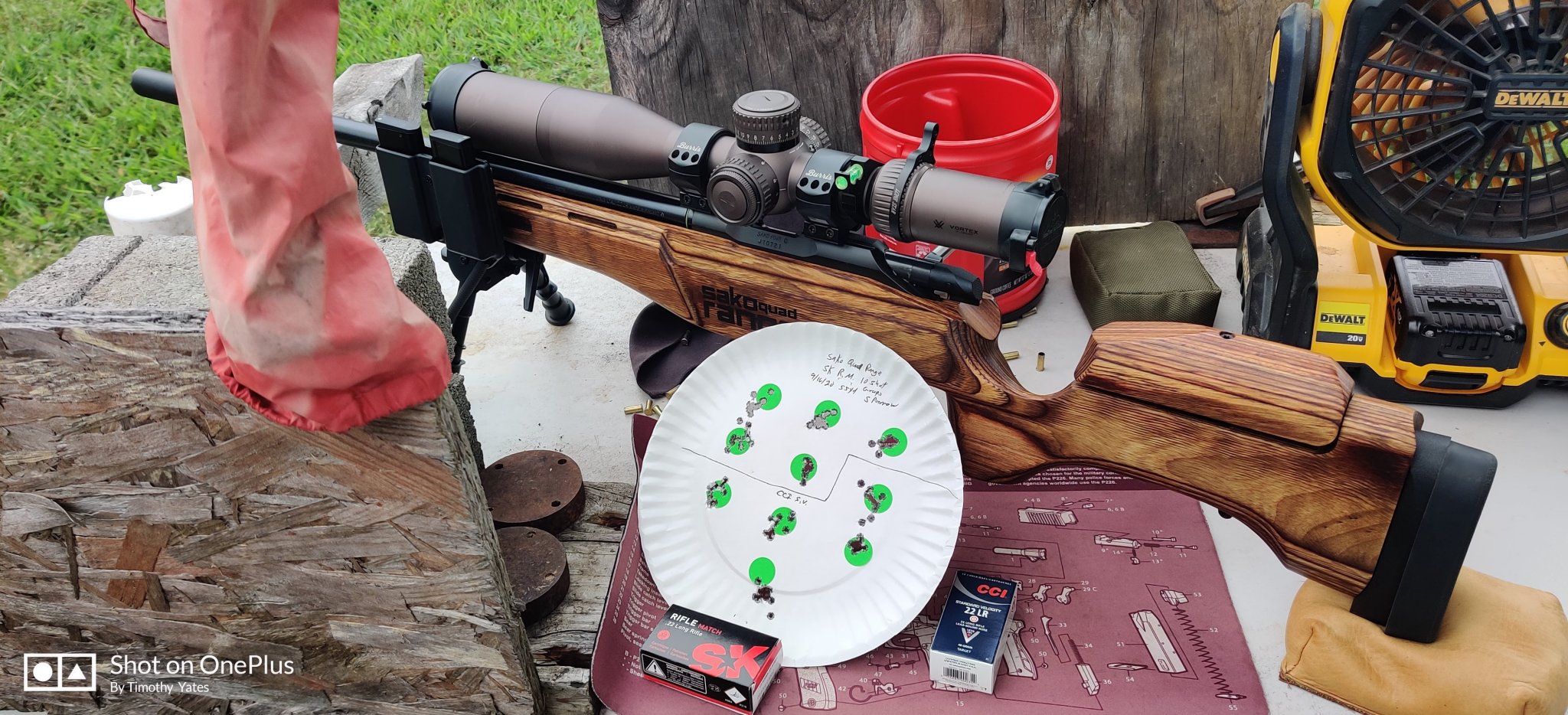

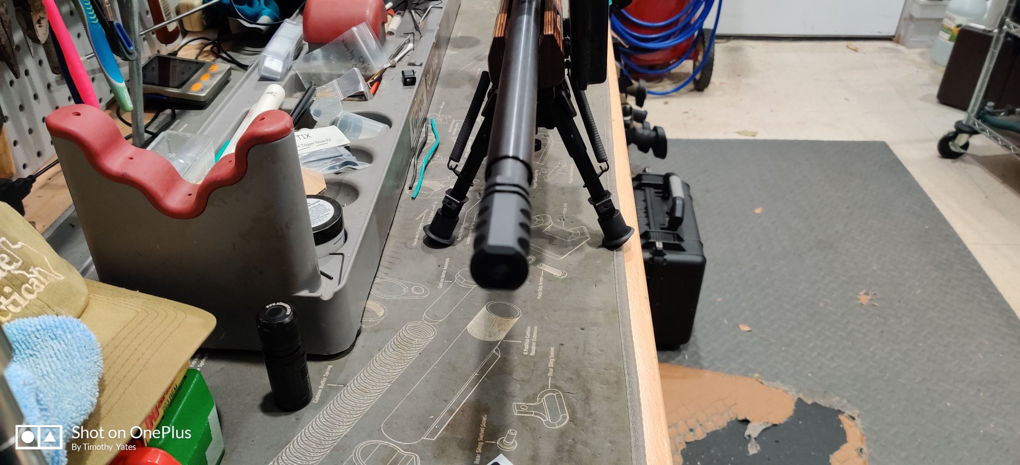

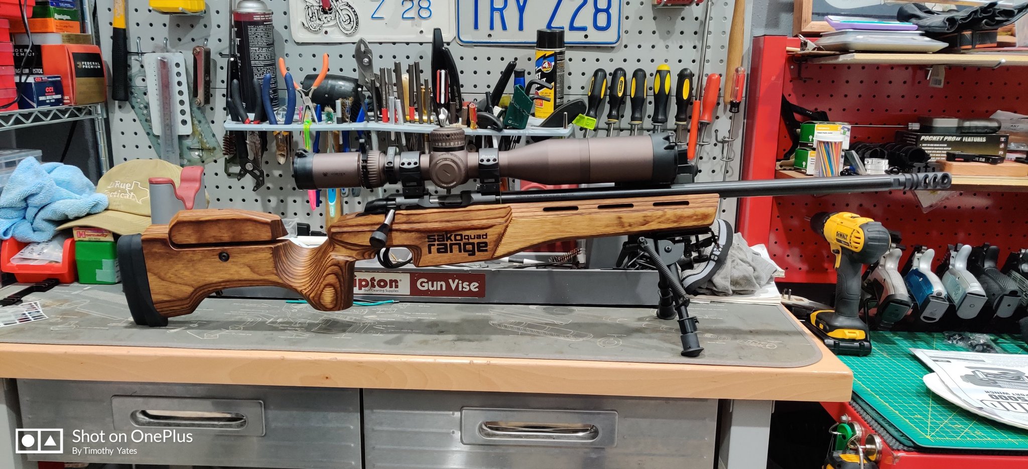

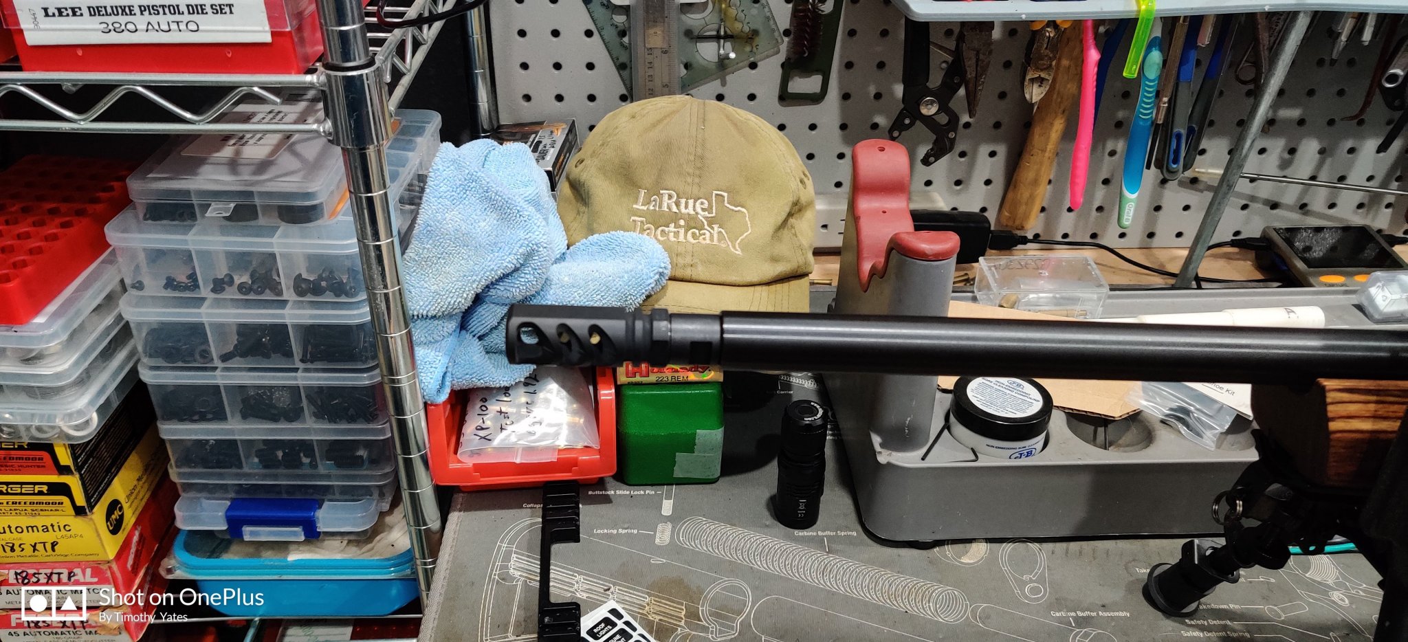

Since we are talking about the Quad Range and muzzle brakes come up I have decided to do a test with mine. All around accuracy has never really been stellar with mine so anything I do can't hurt. Don't get me wrong, it's accurate "it's a 70%-80% 1/2" rifle" but not near as much as my P94S Range and Varmint models or my two M 78's or P 72. All my older Sakos are more accurate.
I'm going to start with my Lantec Dragon first and see how it does.
View attachment 7427110View attachment 7427111View attachment 7427112View attachment 7427113

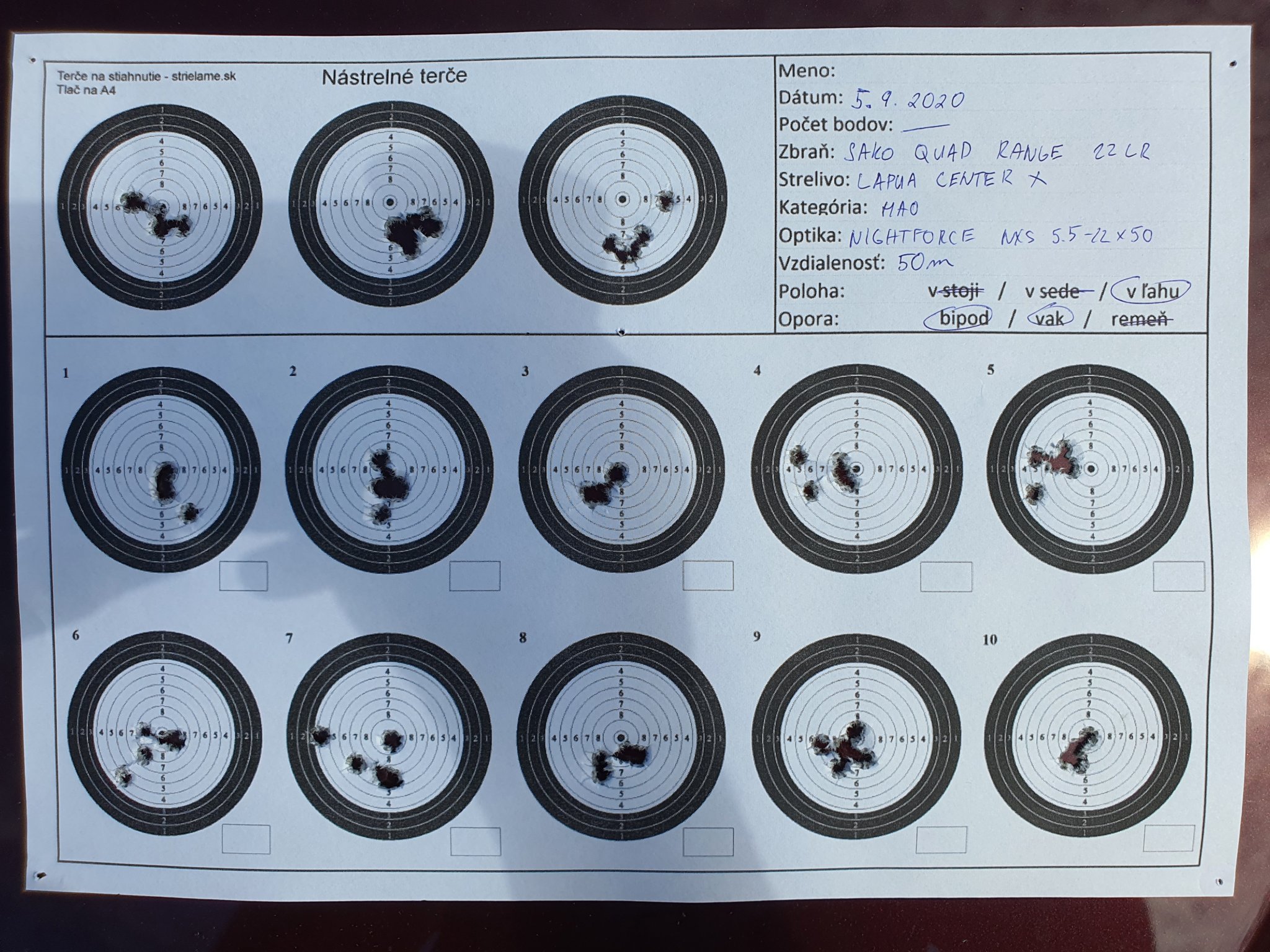

This is the target I want to be better than. This is a typical target for this rifle. How I grade all precision on all my rifles are at what percentage can they shoot 1/2" or better by shooting ten, 5-shot groups at 55 yards. Measured center to center with a ruler. This is a 70% target, hence 7 of 10.
These are 10 shot groups with the Silencerco Sparrow. For some unknown reason I broke my normal way of shooting and shot five, 10-shot groups.

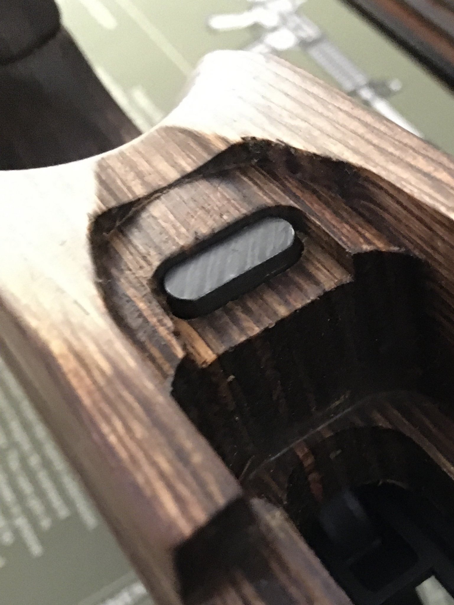

Hi Kisssofdeath,

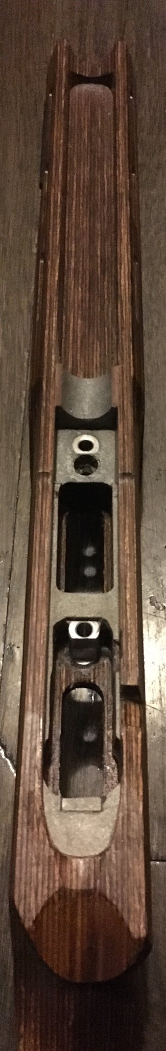

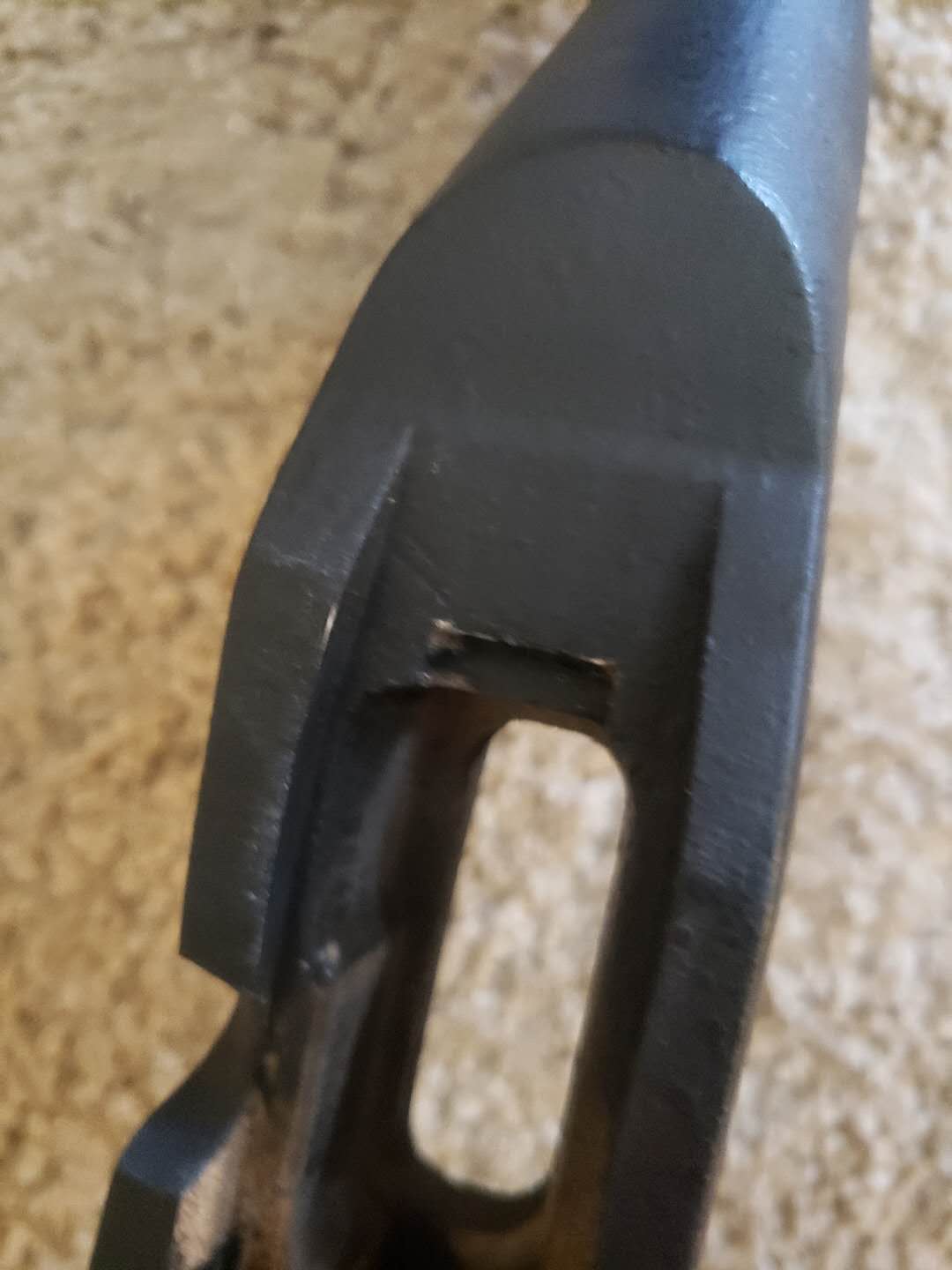

do you know whether the Sako Quad comes with a recoil lug? Saw one in the schematic but never find one in my rifle. Thank you for your help.
Beautiful. Wish I had done more research before impulse doing a 10/22.
Reactions: Easa
If I remember correctly the Quad Range has a recoil lug fitted in the stock, and the action has a cutout for the lug.
That's right, I didn't look at the stock but the lug is small and it's in the stock at the very rear of receiver.
So the lug is limited to Range model only I guess? I ordered a manners stock for my Quad, Brownells has the lug for sale. Not sure whether I have to get one for my new build.
Anyone could post a pic of the lug? Many thanks.
Thanks a lot. Seems mine doesn't come with the lug anyway...

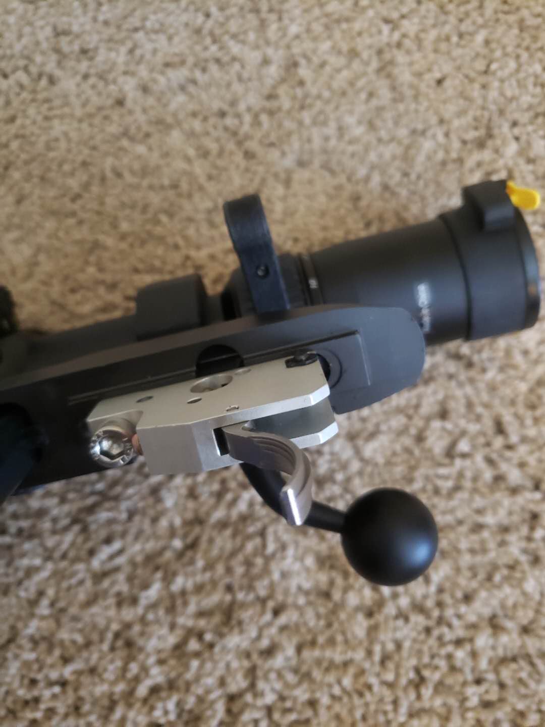

Talking about upgrades, I must say that the Sterk Swept Ball handle was the single most useful upgrade for this gun. For now, it is in a state that I've always wanted, greatly surpassing my capabilities as a shooter, not really requiring any additional work. But you know this sport, so i might eventually get a Lilja barrel or BnA trigger. Was also looking on Accuracy 1st ball level, and I still need to convince Sterk to machine titanium bolt shroud as he does for Tikka's :D
I need to get to a shape when I can shoot 0.5 centimetre target @ 50m/55y with confidence just with bipod and no rear support. Gun is capable of that, I am currently not. 1 MOA or slightly sub MOA is my best score now.
Again, really Nice (Quad) Range you have there, Easa. After I saw the Sterk Swept Ball Bolt Handle on your Range I had to have one. No one in the States had one in stock, so I emailed Sterk directly and was lucky enough to snag the last he had. As it turned-out John was going to be CeraKoting it along with a batch of other parts, and at my request John was kind enough to CeraKote the Bolt Handle & Adapter Sniper Grey but CeraKote the Knob Black. (The finish of the Bolt Sleeve on my Quad is sort of an anthracite, so I figured Sniper Grey would be a decent match). I think it looks pretty good, but I'll let you and the Sniper's Hide' community be the judge. Below are some photos of my Sniper Grey & Black Sterk Swept Ball Bolt Handle on my euroOptic Sako Quad.

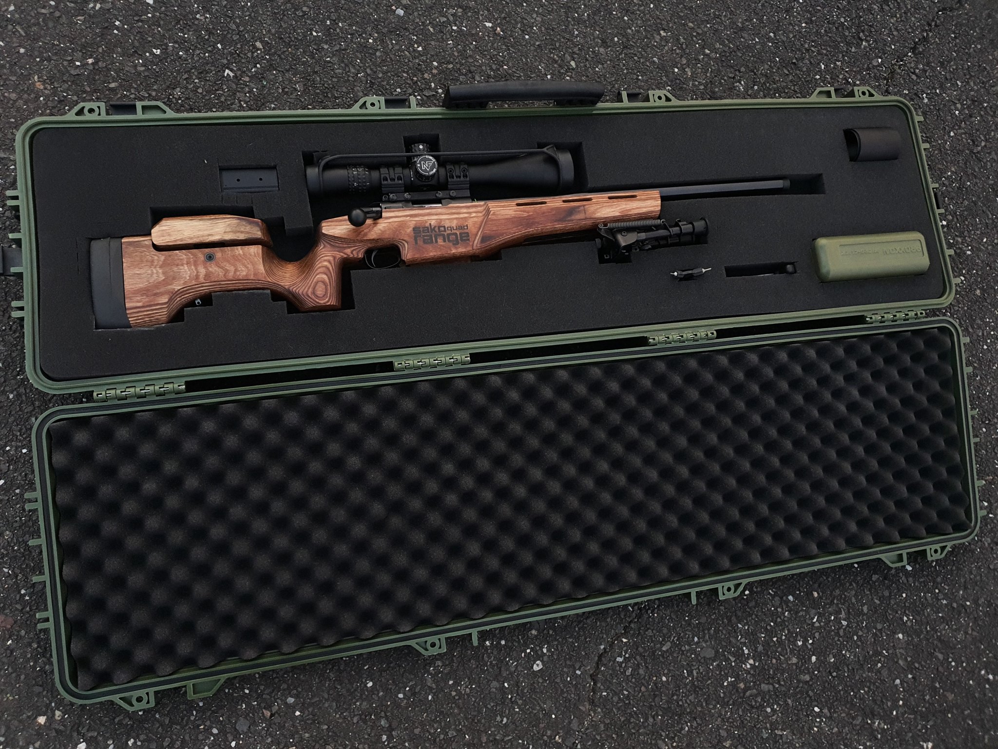

Hello guys, long time no see.
As for me and my Quad, we are still unfinished here. Bedding, ball trigger and a custom barrel from BixnAndy blank is still about to be fitted, but first there was no time and money also had to go elsewhere, and now, due to COVID crisis in Slovakia (the attitude of our government is prime example of dumb) i cannot even visit the gunsmith, so we are somehow on hiatus for now. In fact, i havent even shot the thing since November, had fun with Beretta 92G LTT and a newly acquired Kimber K6S DASA 3" in the meantime.

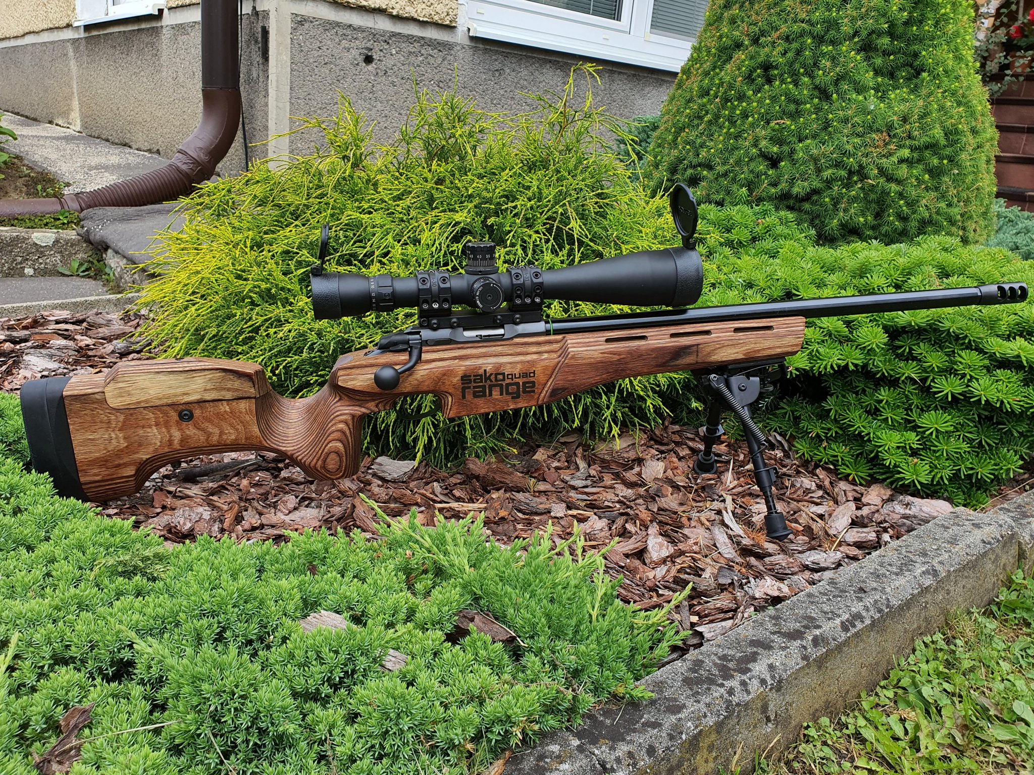

Hello guys,
(First of all sorry for my English, I am not so skilled in English gunsmithing terms, but I guess that you will not have a problem understanding)
A little update about the current status. The gunsmith that I had contacted in the first place refused to make the barrel, as he had no experience with Quad barrel system and rimfires in general. That was unfortunate, as we already had an agreement about this. So, here came a bit of frustration on my side as there are not many skilled gunsmiths in my country when it comes to barrel work. I even thought about selling the rifle and ordering Vudoo from USA, or Anschutz 1927 with its biathlon style bolt.
Eventually i was pointed to right direction and found one, with a fully equipped workshop. I managed to visit him on monday this week, and spent there fair amount of hours. He took apart my gun in front of me, and here are his findings:
1) Front action screw is too short due to DIP aluminium bottom plate, there are several unused threads in the action, so this will be corrected either by milling or using a different action screw.
2) Sako Quad Range does have a terrible bedding from the factory, as the rear action screw is just going through air, and the action is pushing into wood elsewhere. This will be corrected by glass & pillar bedding job that I wanted to do anyways. It will also correct the fact, that the action is quite wobbly in the stock without screws - i want it to come out and back consistently and tightly when doing maintenance or cleaning.
3) Original trigger spring was too stiff, he replaced it with a custom one, trigger was immediately better. There will be an additional tuning of the trigger, so i think that I might even avoid the BnA ball trigger upgrade completely, we will see. I had the opportunity to try the BnA on his Tikka TAC A1, it really is out of this world. No play, no movement, just click. Well, that was his setting. I think that I would prefer a two stage trigger like the TRG has.
4) The most important part, the barrel. First thing, the crown is done very poorly from the factory. Second, those of you that have Quads, do yourself a favor and remove the barrel screw. You might be lucky and got a more fitting piece, but at least on my rifle, once the screw is out, there is a terrible wobble / play in literally every direction and axis. Worst part is the "variable" front to back headspace/breechface play that is unacceptable on the rifle of this level and cost. For example, the barrel of Tikka T1X is held in place by !three! screws instead of our one. I guess they had to make sacrifices for the quick release system, but holy jesus how can I speak of precision when my barrel is relying on one screw and no other contact?
The guy literally took some junk piece of barrel blank, a caliper measuring tool, looked on the Quad´s barrel bedding /breechface/ shape, threw it in and out of the lathe a few times, and in 20 minutes managed to mill out something, that had almost zero play once inserted inside the action without screw. The front-back or "bolt" play was literally non-existent. Needless to say, I had a feeling that I just found the right guy for the job.
So, here is what comes next. We ordered a barrel blank at Lothar Walther, a 26" (you can shorten it anyways, not so easily to go backwards right) long, stainless, Savage 110 varmint contour with match treatment (selected one with bore lap). Once it arrives, he will mill out match chamber with his reamer, crown it, and design the barrel bedding / breechface in a different way than the original is done - the grey pressure plate that resides under the barrel will come out, and the breech will be done as tightly as possible. Once the headspace is set, barrel will be fixed in place by screw with direct contact to the barrel, and loctited in place. This way, the barrel will fit there firmly and tightly (i will never use the rifle for different caliber than the 22LR), but I will still be able to put the rifle back to factory condition.
I expect (and hope!) that with all these modifications, the rifle will finally hit the peak rimfire repeater level of accuracy and performance, and will be able to stand against Annies & Vudoos.
Estimated time is 8-10 weeks. Wish me luck. Be free to post your thoughts and opinions.

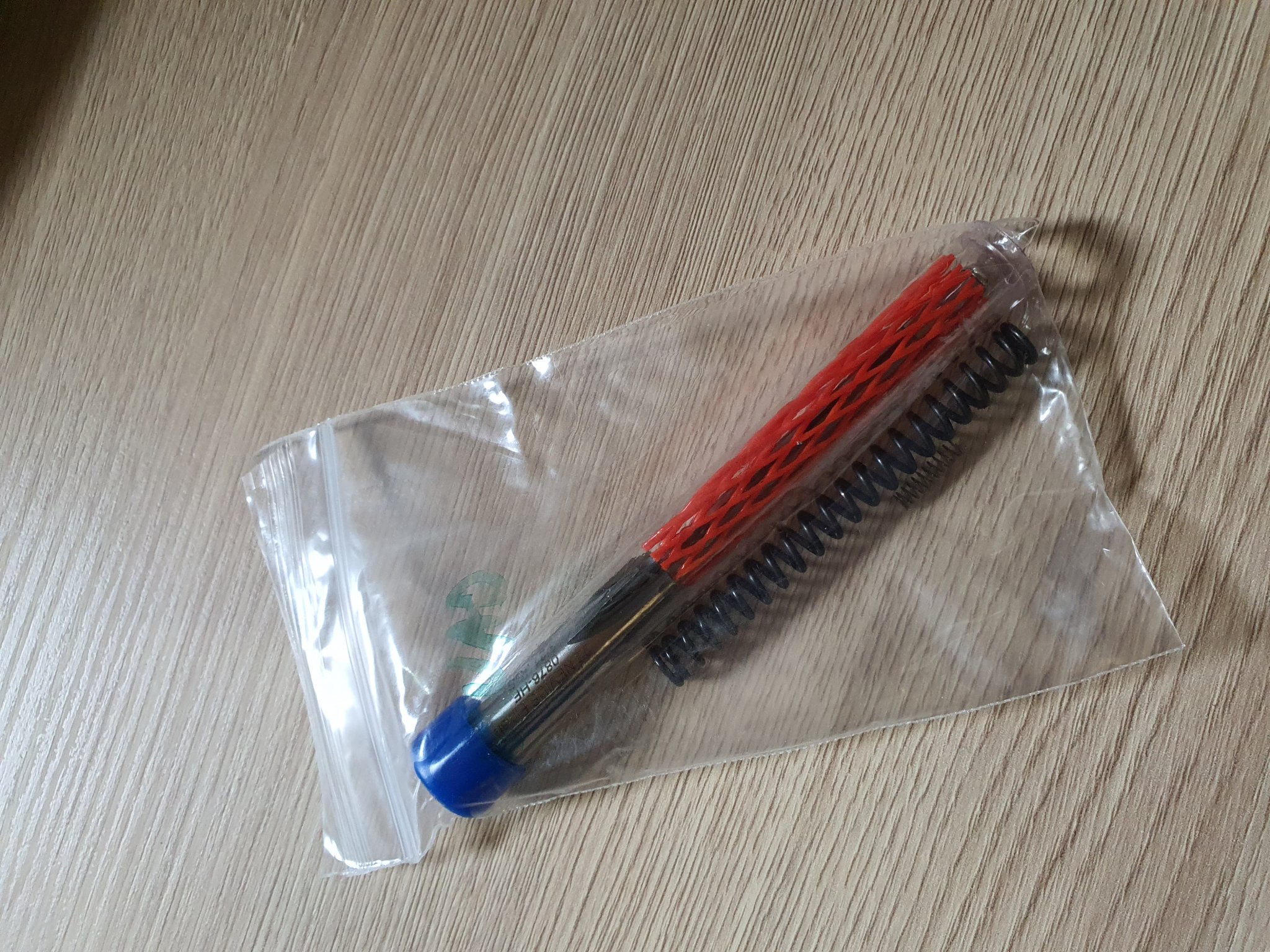

- Ordered a J&P Products Custom Sako Quad Striker Spring Set for faster and stronger ignition. Smells snake oil to me, but at this point i am both curious and desperate enough to try out everything.

I tried the J&P firing pin spring and changed it back to the factory one. It's super strong and increases the bolt lift force which is already stiff.

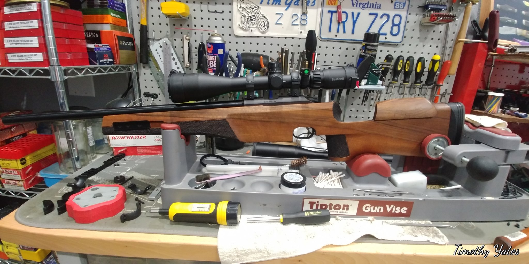

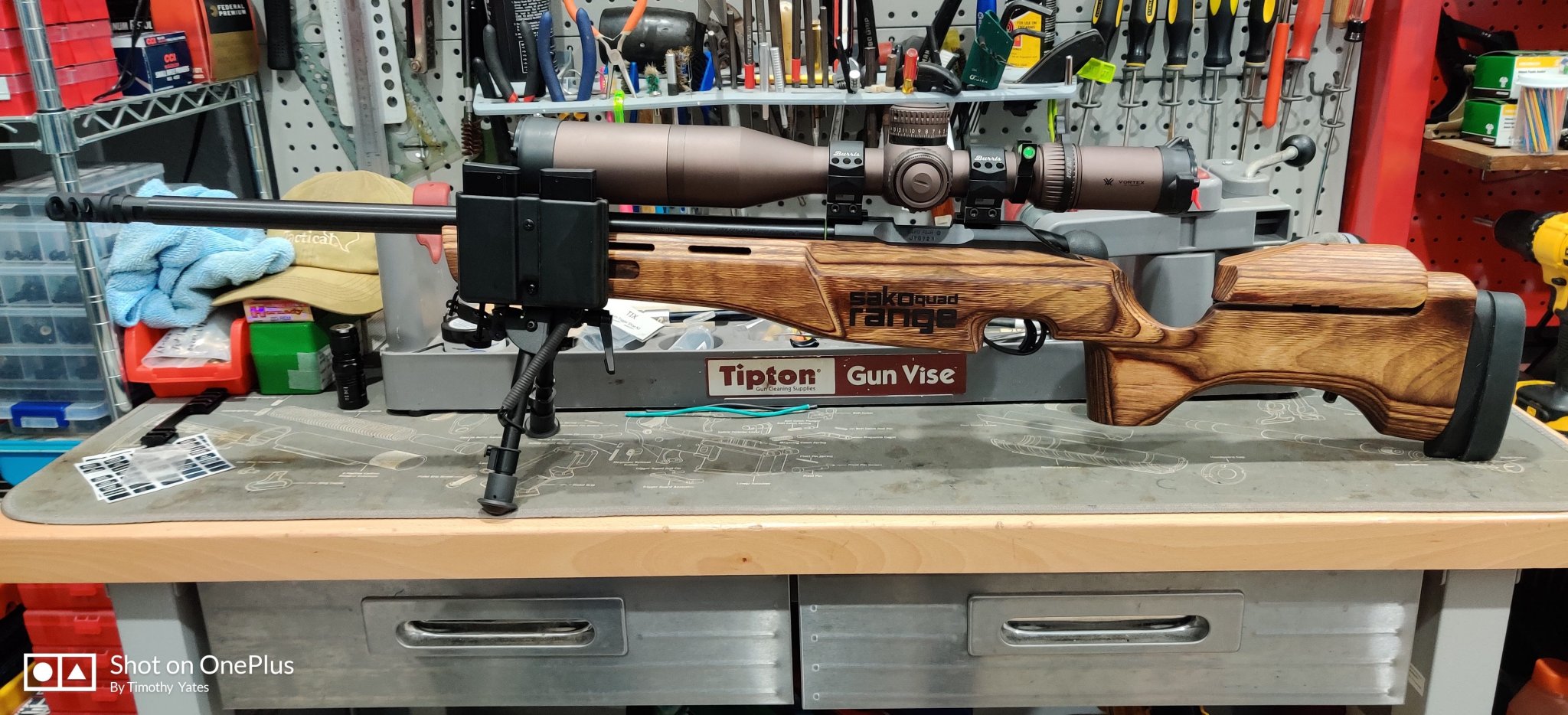

Hello guys,
So, after 5 months of gathering info, waiting, funding, waiting, funding, ordering, and waiting again, here is my rifle build completed.
Rifle: Sako Quad Range 22LR /w Heavy barrel & Set trigger
Glass: Sightron SIIISS 6-24X50 LR ZS FFP / MH
Mount: Spuhr SA-3601
Accessories: Gunbloke Max-TAC2 Brake; DIP Aluminium bottom plate; Sterk Shooting Swept Ball handle; Harris 6-9" Bipod

I see. I have quite similar problem, I can get very good groups but most ammo is quite flier sensitive, like 1 or 2 in 10. I have had nearly 100% flier proof ammo too, all of them top-line or above average but considering how many lots I have tested it is quite bad. Of course, fliers are the nature of 22LR but they should be pretty much be reduced to zero with right configuration?
I cannot complain much, during the course last week the instructors were quite thrilled with the groups. 100m group with 7 or 8 shots nearly in 2cm, ignorant wind reading in 3-4m/s wind made my group like 6 or 8cm as the wind died totally for 1 shot. This SK LR ammo lot was spectacular, I chroned 70 shots and SD was less than 3ms / 10fps.
I could maybe buy or rent the reamer when you are done, I too planned on doing the Nevius chamber but have not decided on which barrel maker to go to yet. Maybe I could get Sako to make one blank for a smith to then work on.
I think (my personal opinion only) that tighter chamber and a properly done crown can compensate for a bit of a variation in ammo lot, at least horizontally. In other words, less quality ammo will shoot better in a precision done barrel, than a quality ammo from barrel with loose chamber and poorly done crown. For vertical fliers, AKA difference in bullet weight / powder charge, there really isnt much that we can do. As I have stated, this is my personal opinion only.
I would not order barrel from Sako, if we are talking rimfire. Lothar Walther offers a match treatment barrels (should be the better ones) which have lapped bore, that is what I ordered. Another option is to wait for BixnAndy, as he told me that he will probably start doing 22LR barrel blanks in 2022 again. I have only heard superlatives about his work, but that was centerfire.
Anyways, wait for my results with LW/Nevius combination, see what happens and make a decision based on that :) As you are from Finland, getting the reamer to you will not be a problem.

Horizontal fliers? Well I can say there are verticals also. See below my stock torque test at 100m in 2ms wind.
Well, those groups are quite nice for 100m i think, but those fliers, i have no explanation for that. Havent you disrupted your position behind rifle before these shots?
Anyways, since you are from Finland, i have a question, PM sent.
Good stuff here! 22LR Nevius reamer from JGS & Set of JP Springs for Quad bolt. I thought i would at least give it a try. LW barrel will probably arrive upcoming week.
