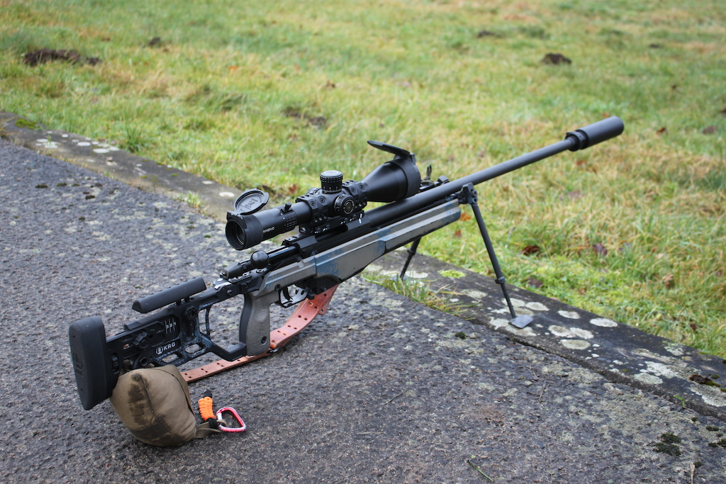

As to KRG’s W3 they still make them, I got mine this past fall. Sign up for an in-stock notification and shoot them an email. I’m sure it’s a low runner for them so they probably don’t put them on the schedule until there’s enough interest. The W3 is an upgrade and makes adjustment and experimentation with rifle setup a much easier. The main reason I got it was because I wanted a flat fore end and the folding stock.
Their TRG stock is almost always available if you just want the adjustability and folding feature for your rifle.

The KRG stock is an awesome upgrade for sure. It is super sturdy, has all the adjustment you will ever need and if you get the folder it is super solid. I have my third KRG whiskey stock, first was on a Tikka, the next was on a Remington 700 and now I run one on my TRG 22. Its my favourite rifle for sure.
