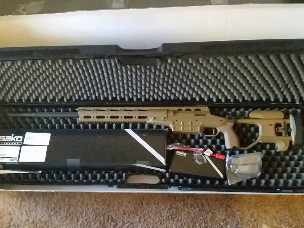

I am about to send a donor M10 barrel and a blank to LRI. I hope during this week. 6.5 Creedmoor.
I presume a barrel extension is threaded.
Sent. Hopes for Chad.

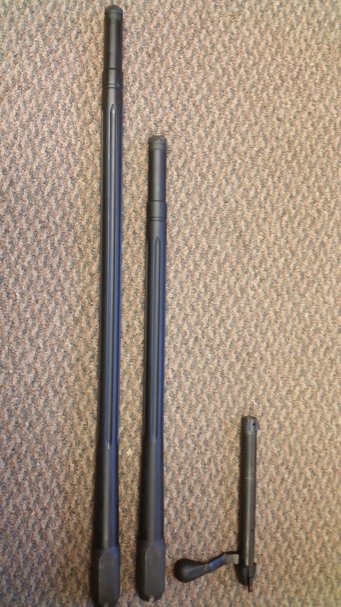

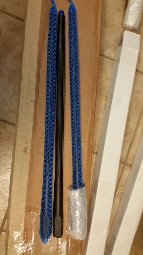

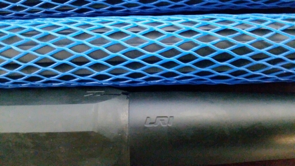

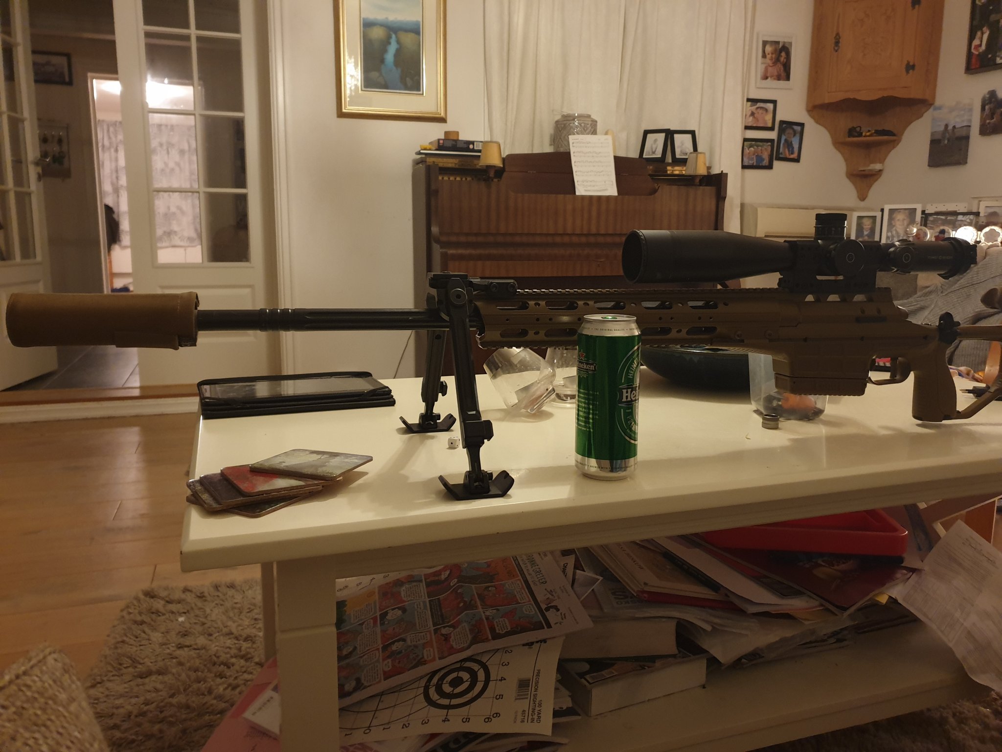

Done...
Now I can call this rifle "multiple caliber" :)
Thanks LRI for the great job!!!
P.S. barrels in the Sako TRG M10 contour, full copy.

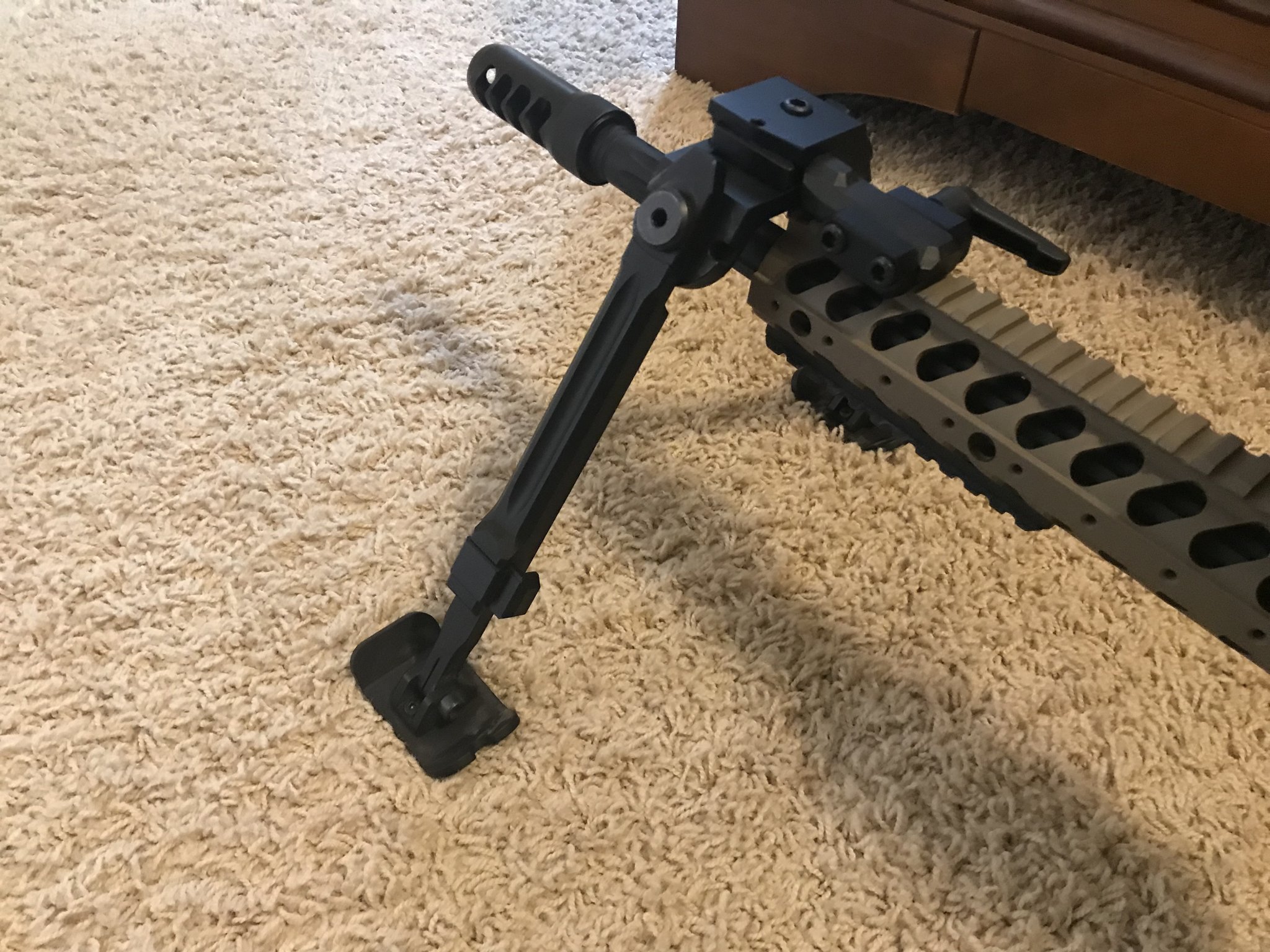

Love my m10. .338 barrel still going strong after 3k. Only minor minus is adjustable stock and cheekpiece is a little sloppy (rattles). Anyone have a fix for this without having to lock it down?

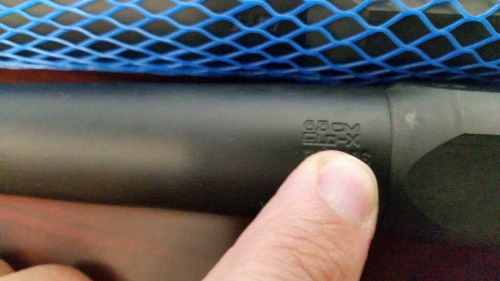

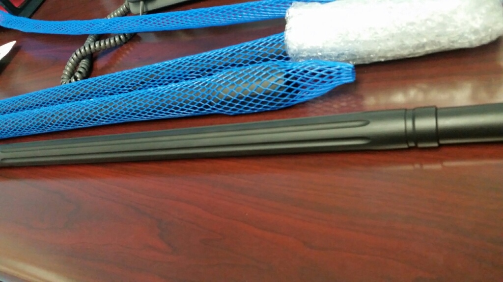

Some follow up. I am loving the M10. I have shot mostly .308 with it. I have not taken it past 900 yetI had an additional barrel made by LRI in 7-300 Win Mag. I had to sacrifice a barrel to have it done so it was more expensive than I would want. I had it chambered for the Berger 195s. They are too long to load magazine length so I single load. (BTW, LRI called me about this BEFORE they did the chambering to make sure it was OK.) LRI did a great job. The barrel is a laser. The 2 fliers were all me, not the barrel.
I found a couple good nodes with H1000. One low, one high. At the high node I am getting 2973 FPS with the Berger 195 EOLs. That should take me to a mile. I have shot 40 rounds so far for load development and testing. I got 2 heavy bolt lifts at the end of the second session so I stopped. Either I need to dial back or I was getting a carbon ring. Anyhow, this is not a reloading thread...
I am in process of working up loads for the 338. I picked up a 300 Win Mag barrel as well. I am going to try the Berger 200.20x. I too get a tiny bit of rattle from the cheekpiece and buttstock extension. It is not bad enough to really bother me. At some point I want to have 6.5 and 6MM barrels made. After that I will probably get rid of most of my other bolt guns.
Also, the story with LRI making the extensions......
Chad said machining them is the easy part. Having them correctly heat treated and hardened is the trick. The Finnaccuracy people put a .375 Cheytac barrel on an M10 extension and it did just fine. That is some high pressure to handle. He was going to model an extension for me so he could play around but he was really busy with something else. I wanted my rifle back so we dropped the idea. Again, if enough of us ask him it might become a priority. Also, if enough of pester the folks at Sako, maybe they will actually sell extensions.
