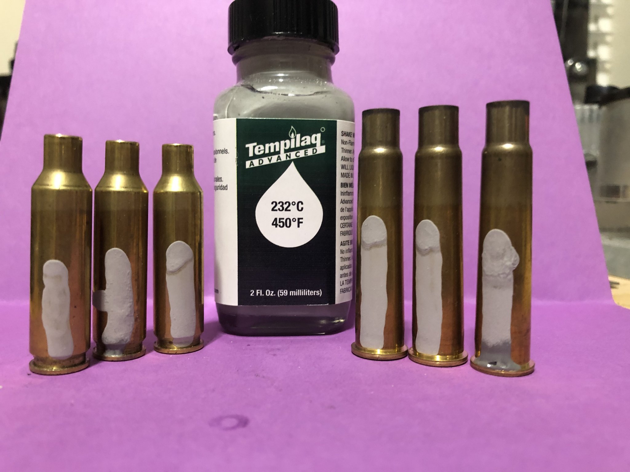

Experimental setup:
SBA with PID, set at 932*F

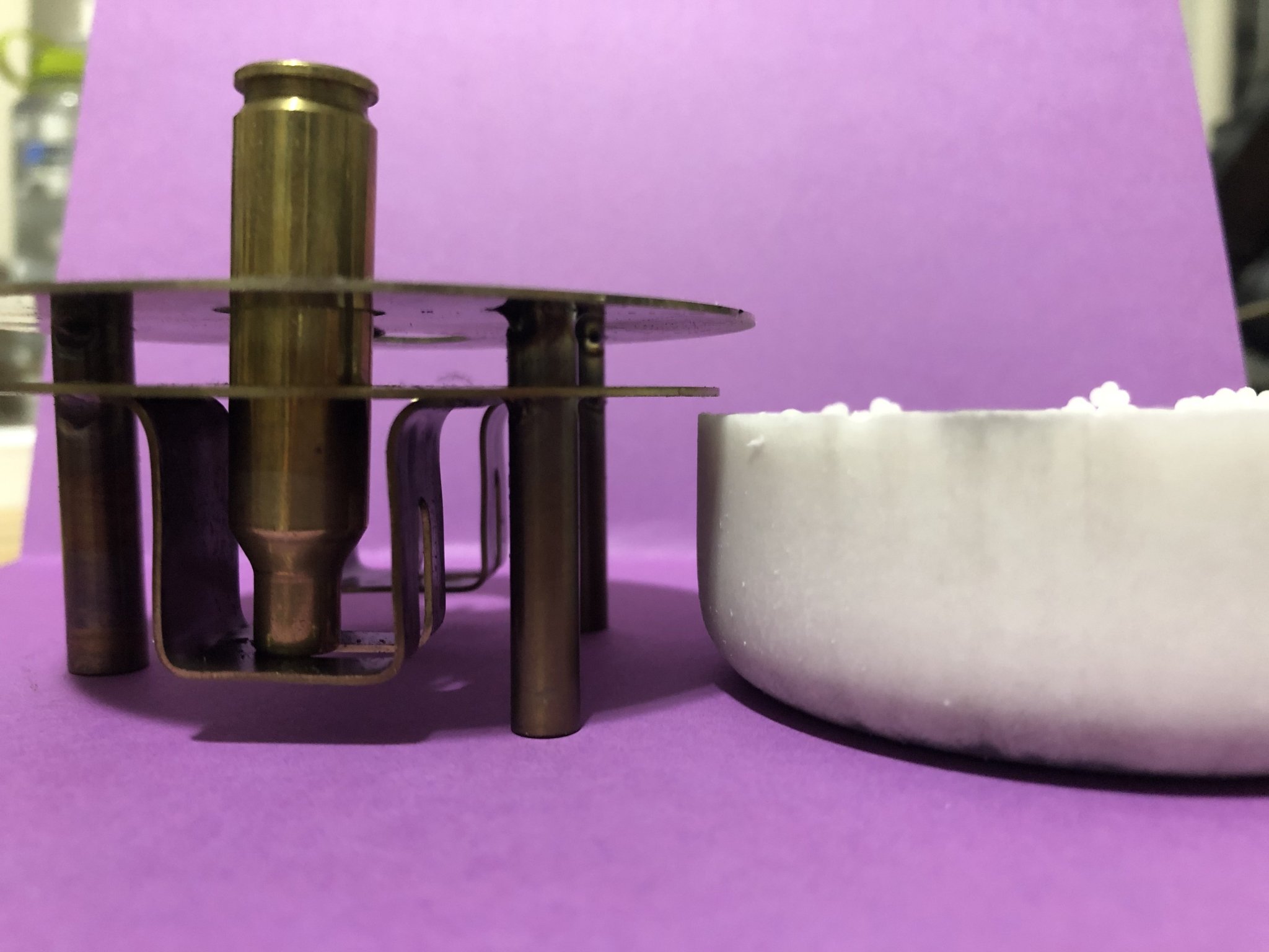

Salt Level just below the bottom of the holder, see first image.
3x S&B 6,5 Creedmoor brass
3x MEN 303 British brass
Tempilaq 450 strips, from 1" above case mouth, down to the head (I didn't want templac in the salts)(Yes, my paint lines kinda look like dicks)
I used a metronome app, set to 60 BPM, to time brass dunks. One each size at 6 seconds, one at 12, and (303only) one at 12 seconds dunk, with an immediate water quench. One piece of 6,5CM had the tempilaq ruined when i grabbed the strip with my glove pulling it out.

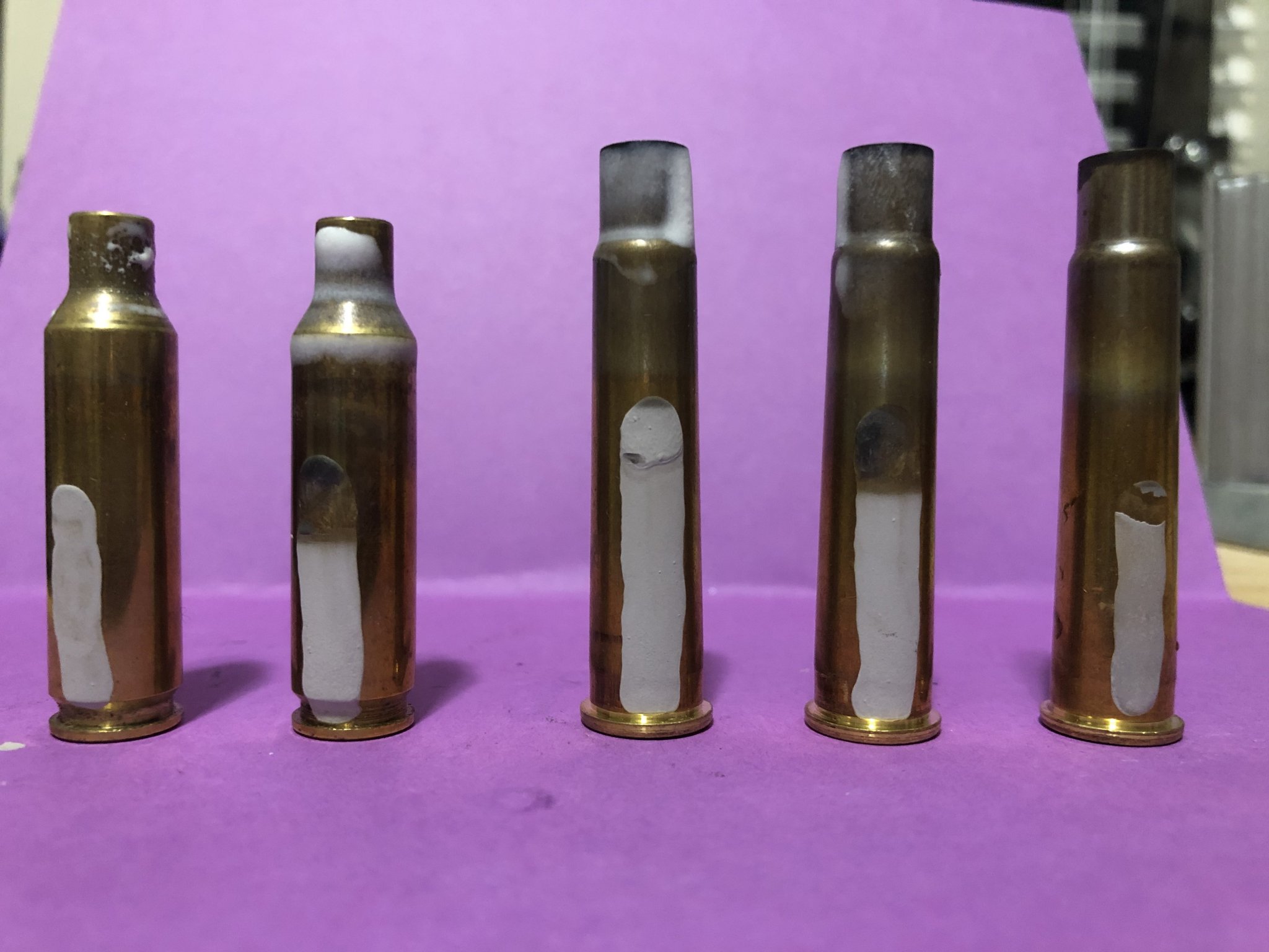

Results
From left to right:
6,5CM 6 seconds, 6,5CM 12 seconds, 303 6 seconds, 303 12 seconds, 303 12 seconds with water quench.
EDIT: Those are 303 cases, not 8x57. I'm an idiot. Guess which akro bins are right next to each other...

Whelp, I’d say it looks like 12 seconds is safe for your case heads

I've not yet started SBA (just ordered the salt and base) so I'm not familiar with the setup. Is that the normal depth of salt to plunge your brass into? I'd think you'd just stick the mouth into the salt, stopping at the start of the shoulder.
It’s about average, with the caveat I just topped up my salts the last time I annealed. You can go as low as you like as long as the thermoprobe is submerged appropriately for temp reading.

It would seem to me, from those pics of the 750f Tempilaq, that 6 to maybe 8 or 9 seconds would be the way to go. The 12 second samples seem to have gotten to 750f a bit low.
Oops. My bad. He was using 450f Tempilaq. I'd like to see the same test with 750f Tempilaq. Maybe 930 for 12 seconds IS the way to go...
