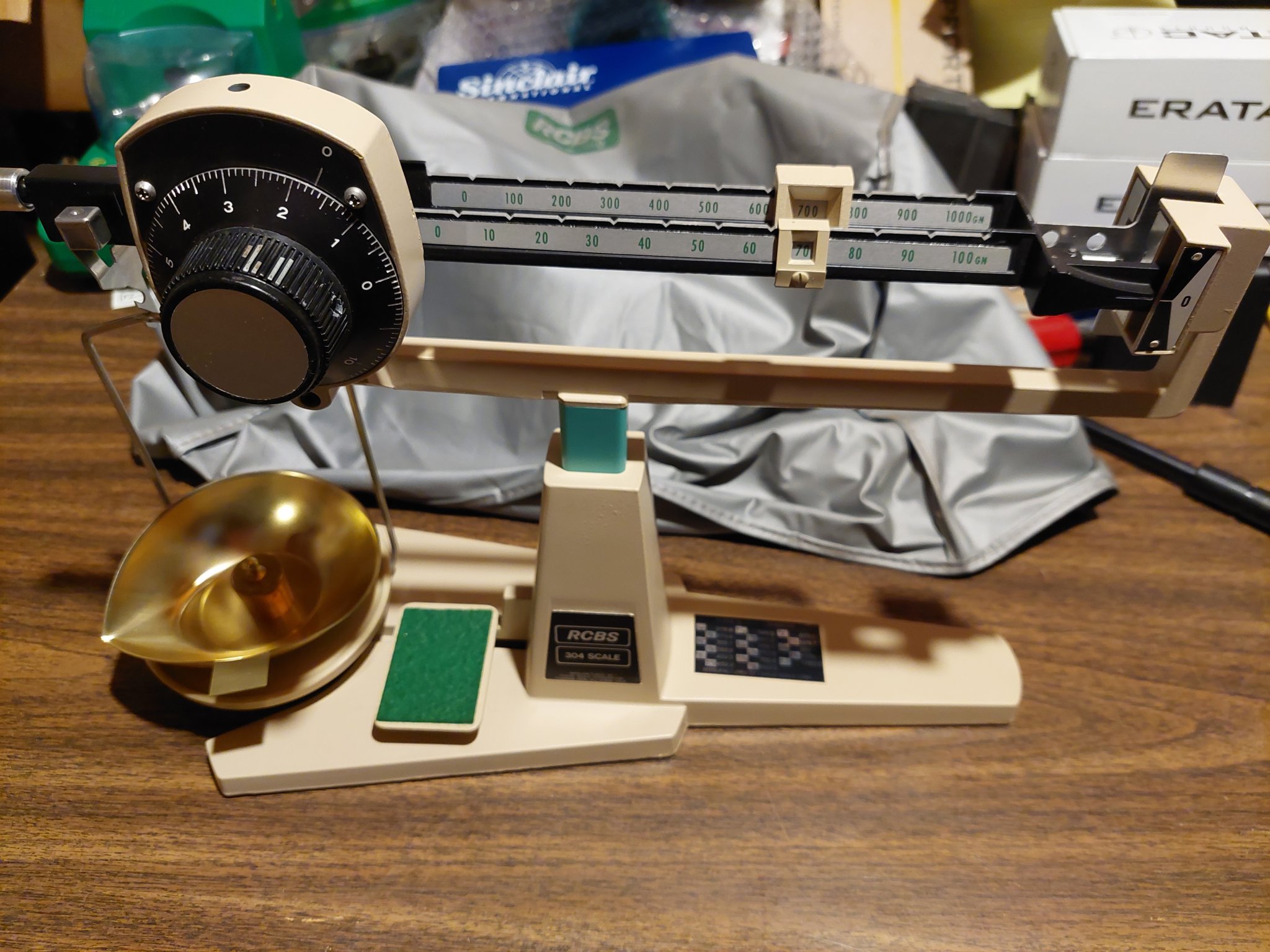

RCBS 1010. Good scale. Older ones are much better quality. I knocked my old one off a shelf and broke one of the pivots off the beam. Sent it in to RCBS for repair expecting to have to pay. They sent me a brand new 1010 no questions asked. Although I'm happy with that, the new one was made in China and is lower quality overall. It's just as accurate as my old one far as I can tell.
If I was in the market for a beam scale knowing what I know now, I'd be comfortable paying as-new price for an older 1010 off ebay.
I have an old RCBS 1010 I bought in 1994 and it is accurate. I purchased a set of check weights and had them verified on a calibrated scale at work and they are right on the money. The check weights confirmed that the RCBS 1010 is dead nuts accurate.

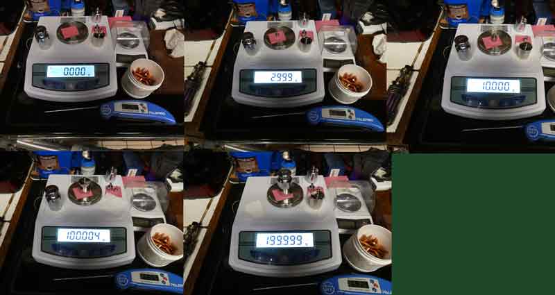

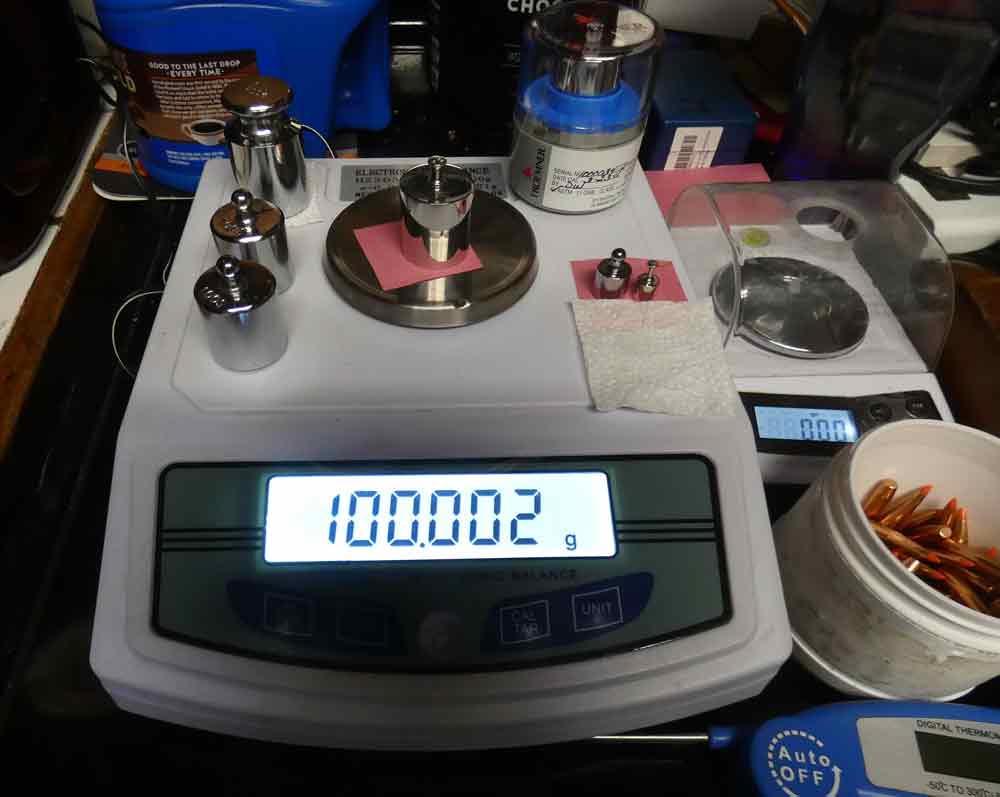

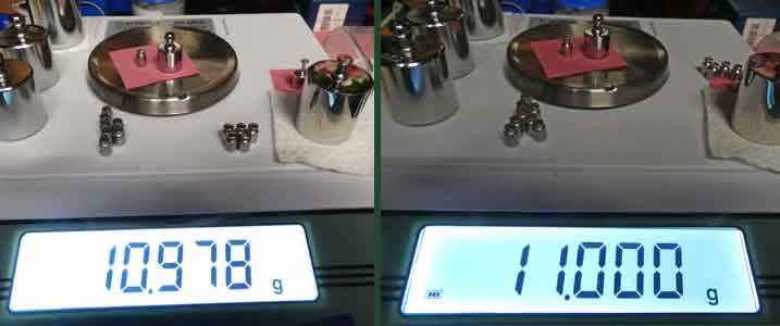

How many try and evaluate scale errors instead of just calibrating at one point?
Here is a 300 gram, milligram indicating scale that calibrates @ 200 grams.
Notice that there is linearity error at 100 grams. I typically get 100.002 or 100.003 but the HVAC is cycling on and off this morning and I'm getting an extra 1 or two counts of "Drift". These readings are very repeatable day to day.
This 300 gram scale is not sensitive enough to trickle kernals. I also have to run it off AC as the rechargeable SLA battery won't hold a good charge.
Sitting next to the coffee pot isn't helping either :)

Look again. The scale pictured is a reloading scale and has RCBS written all over it. It reads in grains (MOA), not those communist grams (MIL). :ROFLMAO:

Shown are my reference standard, working standard, and three test weights measured with this process.
Two 100 gram and a 200 gram.
By repeating measurements it's pretty easy to compare 100 gram weights to better than +/- 0.002 gram with this cheapo scale.
Not good enough for a lab, but for home use by a retired metrologist, not bad.

My 100 gram weight has now drifted to 100.001 grams indicated. Been sitting on the scale since this morning. Hope it drifts back up a count.
Temperature is up to 72.3F. Maybe I have a negative temperature coefficient.
Never mind, back to 100.002

Here's a couple on the scale (10 plus 1 gram).
If you got a bad set, could you tell?
The worst one on the left is what? About 0.34 grains light?
