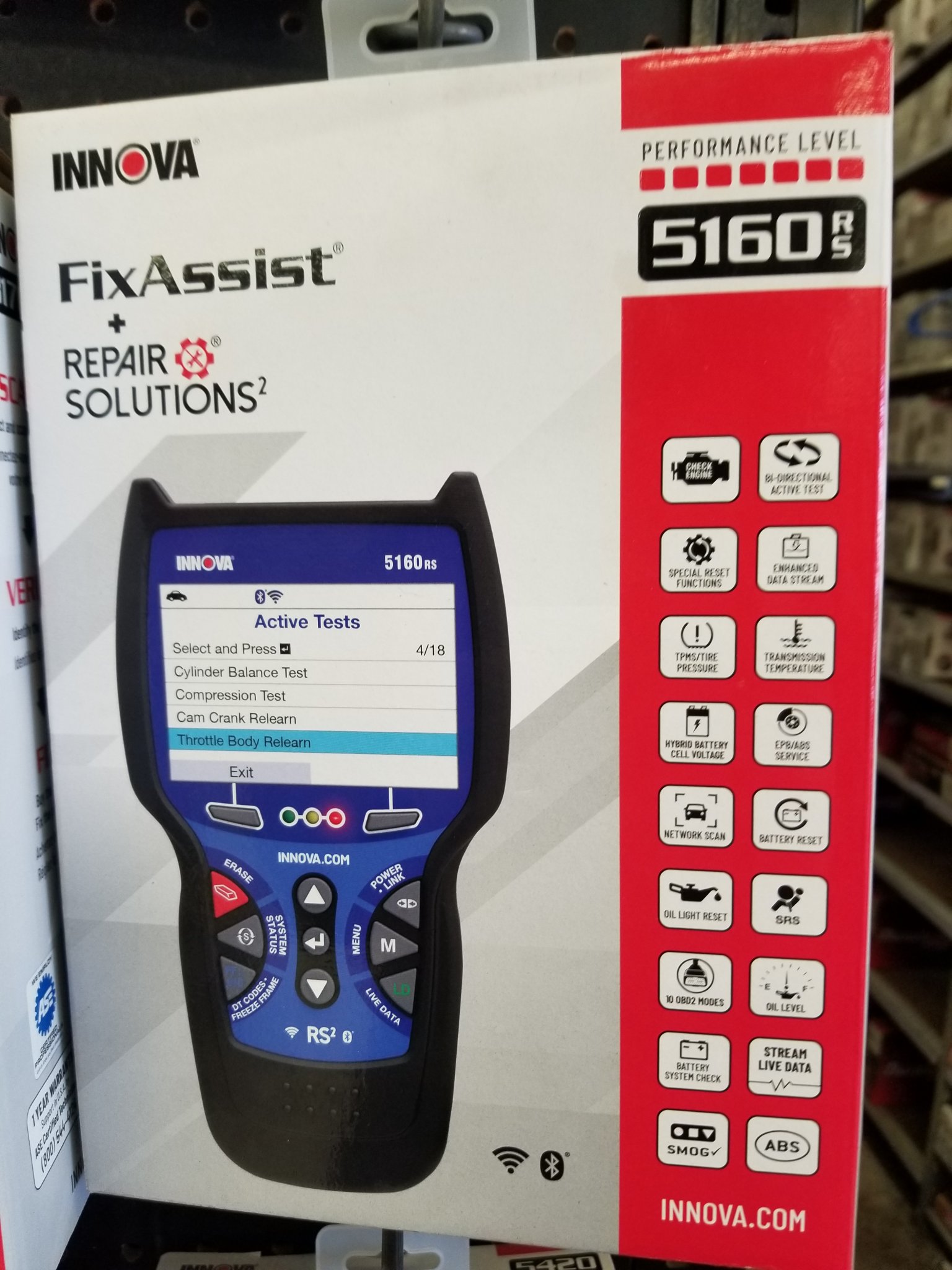

I also need to buy a scanner. For the money I've settled on this. $350 at autozone. Gets great reviews.
