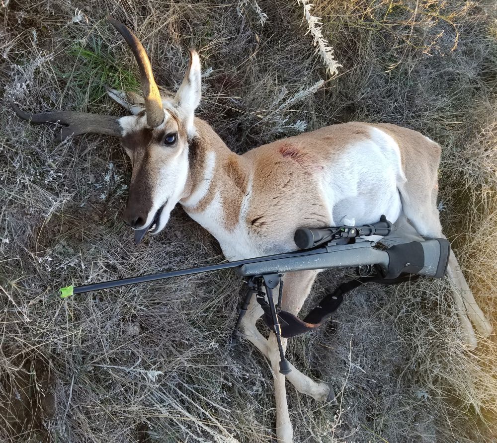

I shot 2 antelope one morning with an ultra light 6mmBR I built with 95 gr nos bal tip bullets
6mmBR 1.2" 95 gr Nos Bal Tip moly 29 gr IMR4166 2800 fps chrono 27" barrel
The small primer pocket is so strong, the load work up is on the primer piercing, not the brass expanding.
