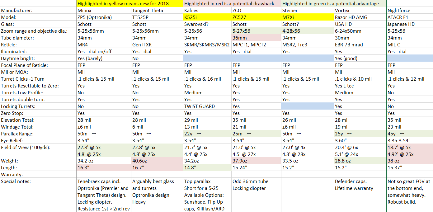

You seem pretty convinced on the ATACR's, nothing wrong with that but I will tell you the 5-25 really struggles with FOV at the bottom end and both the AMG and Minox ZP5 have better FOV at the bottom of their mag range (but the NF picks up in FOV as you advance through the mag range), may not matter for you but just wanted to point that out along with the fact the NF weighs more.
Here's a quick and handy chart to help you compare specs:

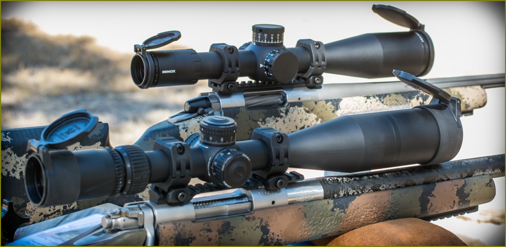

AMG in the foreground and Minox in the background
Here is the Premier LT 3-15x50, man I miss this scope!
Sir, what rings and height are you using in that picture with the Minox ZP5 TAC 5-25x56 w/ MR4 R?
That was when the ZP5 was on my Bighorn TL2 with medium Palma barrel and I used ARC M10 .94” low rings, but recently I moved the the ZP5 to the Winchester M70 with PROOF heavy Sendero contour and the Tenebraex cap was touching so had to use some Seekins 1” I had sitting around it it clears fine. I prefer ARC M10’s and their medium 1.1” would work well too. So it’ll depend on your action, rail and bbl contour
