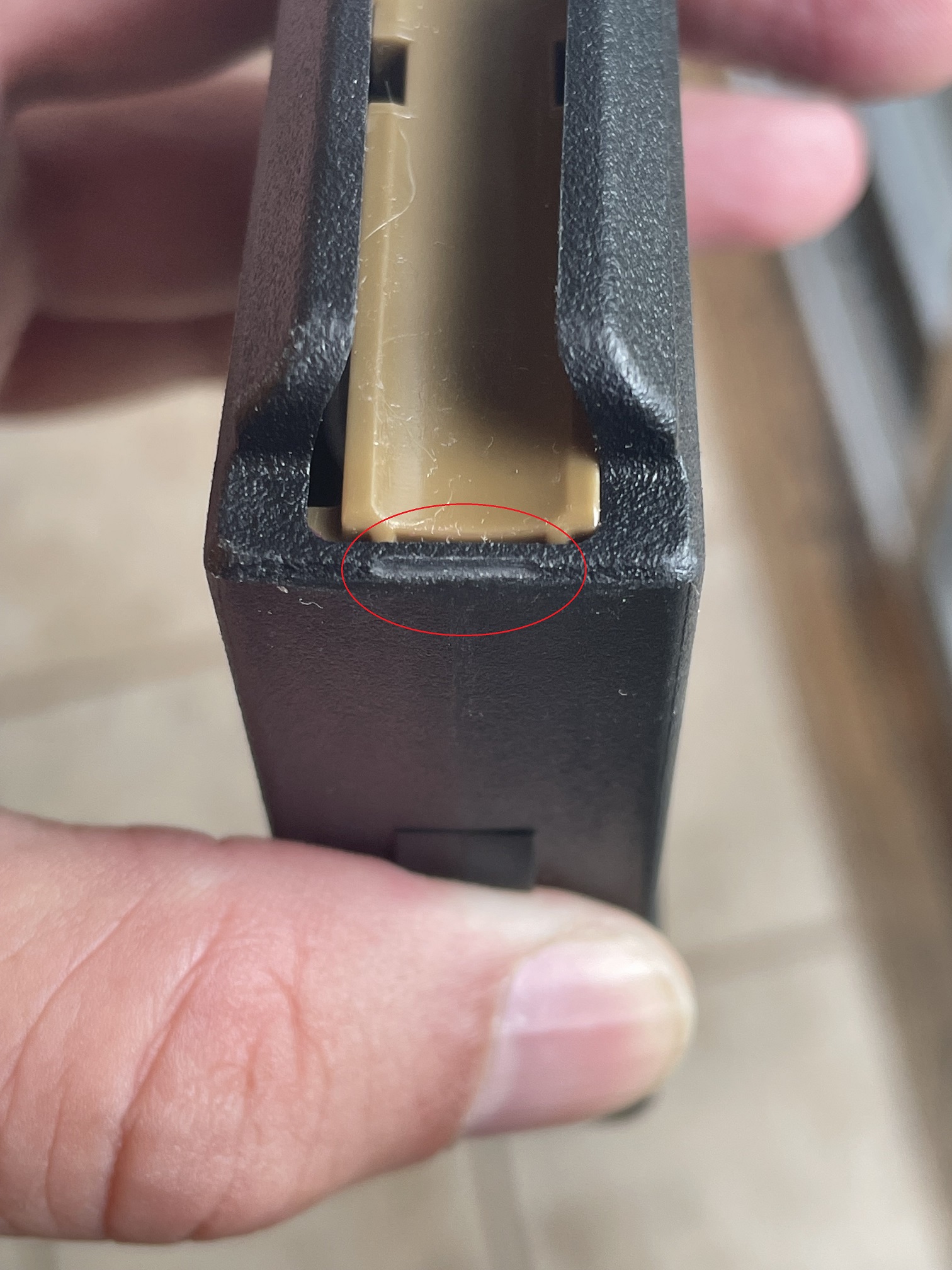

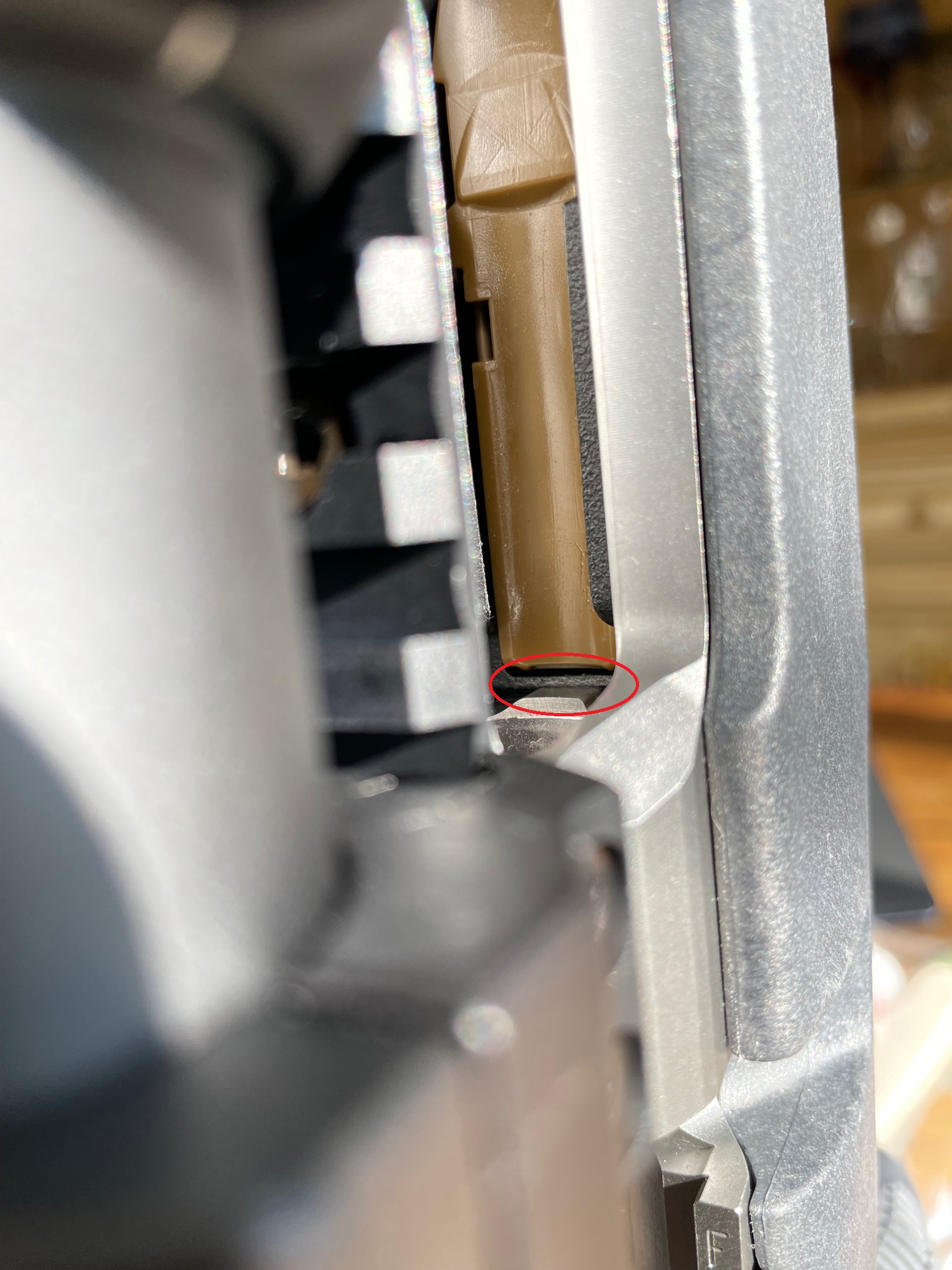

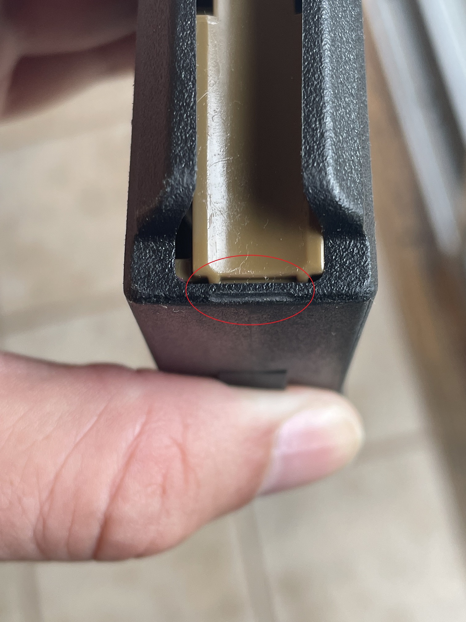

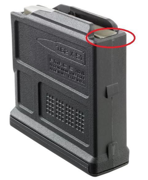

Hoping someone can help here.
I have a brand new seekins ph2 hunter .308. At first when putting the empty pmag5 in the gun, it sometimes would slip just past the metal mag stop on the receiver in the mag well and then would not release if I hit the mag release button. I am not sure if I was pushing the magazine in too hard or what as I don't have another to test with at the moment. It since has worn the magazine a little and it seems to function fine now. I am trying to find out how far the mag stop should extend over the rear edge of the magazine as I am worried my was not extending far enough possibly causing the issue in the first place.
The PMAG5 has kind of has a beveled rear edge and I think that was what was causing it to slip by the mag stop every so slightly. I'm worried that maybe the metal mag stop should extend further over the magazine and was machined to short.
I was wondering if anyone with a short action could take a look at their rifle with an empty magazine in and let me know. I have attached some pictures of what I am referring too.
One picture is of what a new magazine looks like and shows the slight beveled edge at the end.
Second and third pics you can see some wear to that beveled edge on my magazine where it came in contact with the mag stop. Now that this has developed, it kind of made its own straight ledge in the beveled area and the magazine no longer fails to release.
The final pic is showing the mag stop with an empty magazine in the rifle. My concern is maybe the mag stop should be extending further onto the flat non beveled rear edge of the mag.

To any who have had their bolt/action updated by Seekins....do you have any idea what they are talking about wrt to replacing a "breech plug"
I have a custom gun I bought essentially new and the guy used a Seekins Havak as the action.
I called Seekins and asked why they couldn't just send me the new bolt and I will have the headspace set as I'm about to put a new barrel on it.
They said its because they want to set/check headspace (which I can have any gunsmith do when they put on the barrel) and they want to replace the "breech plug".
I'll be darned if I know what they are talking about wrt to this plug.
Anybody?

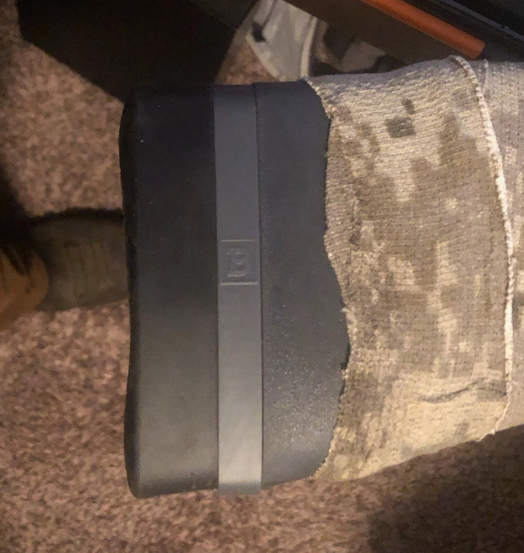

Has anyone here added length to their PH2 stock? The PH2 checks all the boxes for my next hunting rifle except that I’m 6’5” and the factory LOP won’t work for me.
6'4", I feel your pain. First I got some spacer online I thought would fit but didnt, did an okay job blending it best I could by hand. Then I had a buddy 3d print one where the shoulder of the pad fit into the spacer and the side that went into the stock fit against the threaded mounting bosses inside the stock. Works super slick, we have some work to do blending the bottom profile but I said it's close enough for me.
Does he want to 3D print another one!? Sure do wish more manufacturers would consider provisions for LOP adjustments. I’d rather have adjustable lop the an adjustable cheek piece.
Hell I’m 5
5’10” and the lop is too short for me too. I bought some generic aftermarket spacers but hell if I can get the pad off. They use some tiny ass hex nut to hold them on that I nor the local farm/fleet store has anything to address. I had to use a bore scope to figure that out after no flat/philips/Allen/torx head worked.
I’d like to kick whoever chose that hardware squarely in the nuts.
