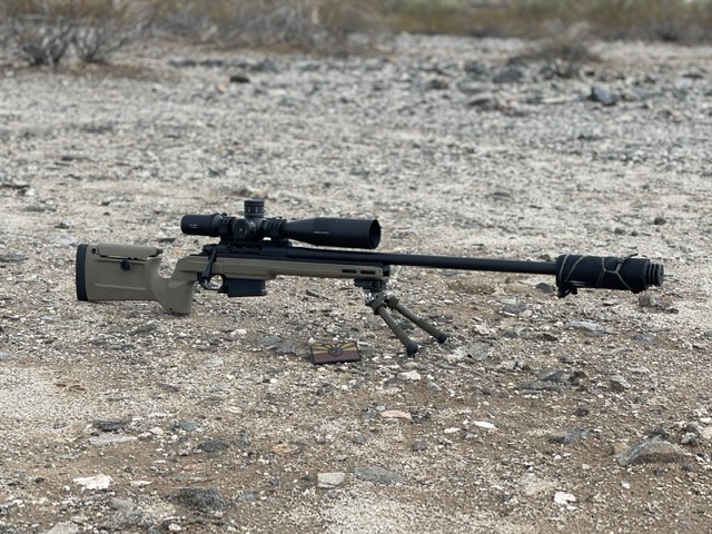

Placed order for a PH2 in 6.5 prc with cerakote and paint job on stock added. Super pumped for it. This will be first long range hunting rifle. Was quoted 10 wk wait. So we’ll see how it goes.
Is anyone needed to add a stock pad/pack on the newer stock or is comb height sufficient assuming using low rings.

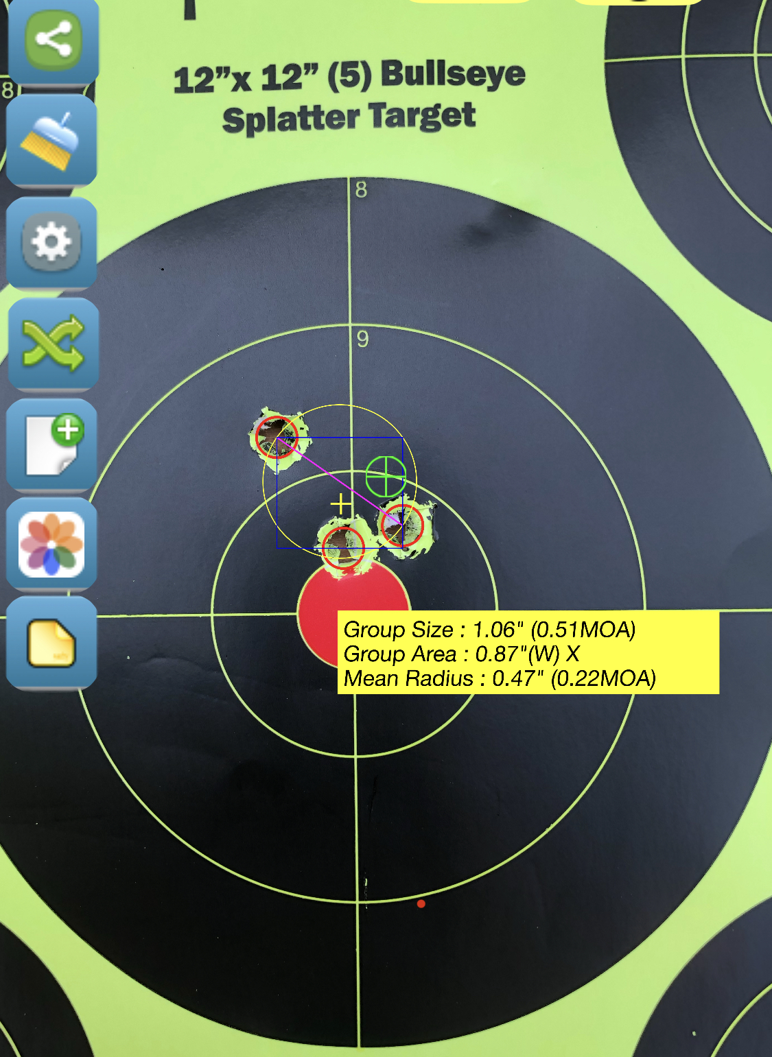

I hit a crazy good node at 79-79.6 grains of H1000. I had a speed dispersion of 14FPS between these 4 loads. Its average was 2905.
I will start working on load development this and next week.

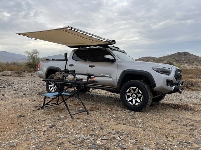

Took my rifle to make sure it’s still zero at 200 yards

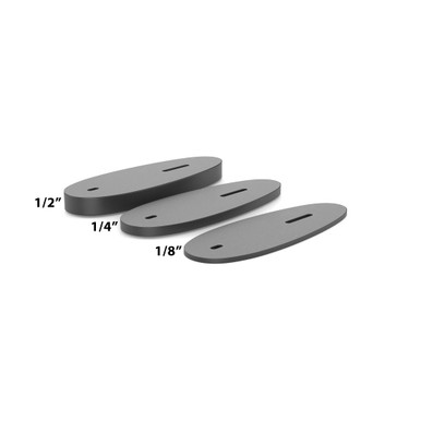

Anyone have any hot tips for lengthening the the LOP on the PH stock? seems like for those standard butt pads there should be a standard spacers available?
Like these?

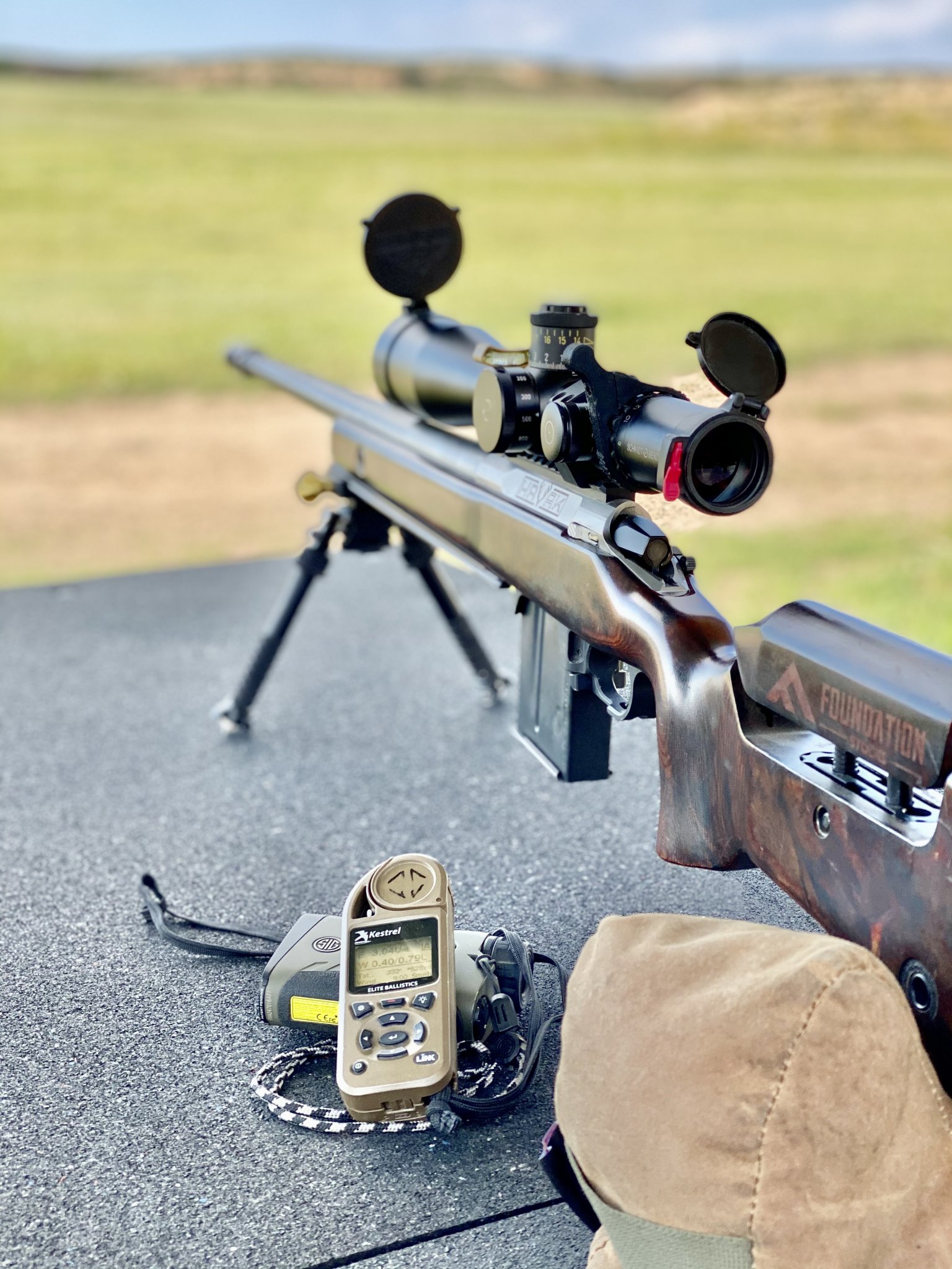

I put mine in a Foundation with a KMW bottom metal. A couple washers for clearance and done.

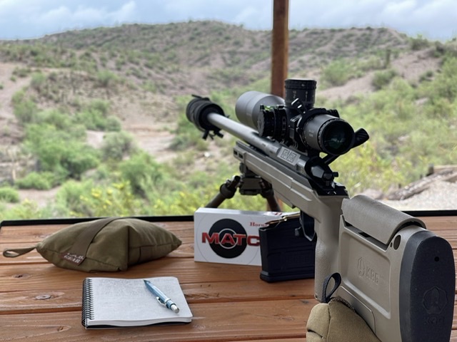

I’m entering the Seekins game with a 6mm Creedmore. Anyone with this variant care to share their loads?
Looks like for distance it prefers the 105 and 108’s? I ordered some loaded 108 ELDM to try for now.
Need to find bullets and brass in stock.
also need a good set of does. Have had good luck with Whidden dies for a 260rem.
Open to suggestions.
Dune,

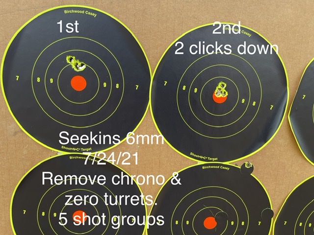

I have a PH1 in 6cm and I got great results with Berger 105 under 40.6gr H4350 avg 3090 w/ peterson brass. I could have easily pushed it harder but the groups at 500 were under 1/2 moa. I've actually just started running factory 108 eldm because it was so consistent and my time is worth more pulling the trigger than reloading. I've taken the factory 108's out to 1000 and it held 1 MOA. The Seekins is one of my factory guns I own. I question why I spend so much on custom rifles when that rifle is turn key perfect. When this barrel burns out i'm going to send it back and have them chamber up a 6.5 PRC and a 6CM barrel as well as get a new bolt head and mag for the PRC. I have little doubt you'll find an accurate load with ease.... the plus is if you dont the guys at Seekins will make it right, amazing customer service. Good luck with your new rifle, and of course post up your results.
My PH1 6 Creed shot the Hornady Factory 108 Match ammo extremely well out of the gate. As for loads, I've tried the 105 Hybrid and found a good node at 39.5 gr of H4350. I worked up to 41.6 gr, which shot extremely well, but the bolt seemed a little sticky.
