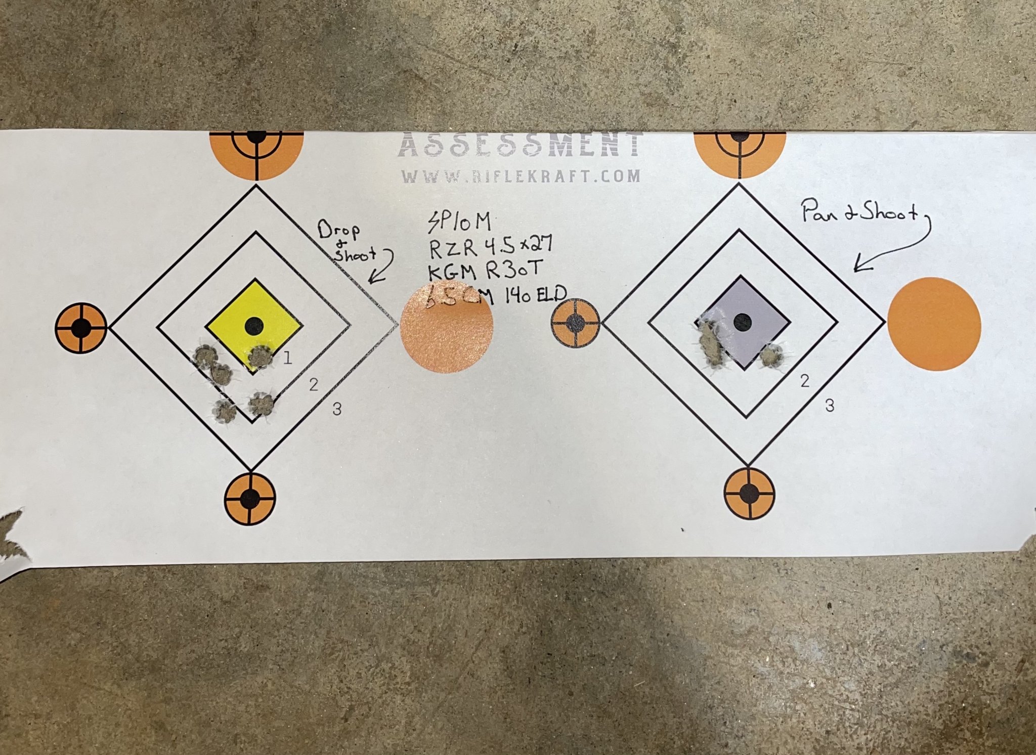

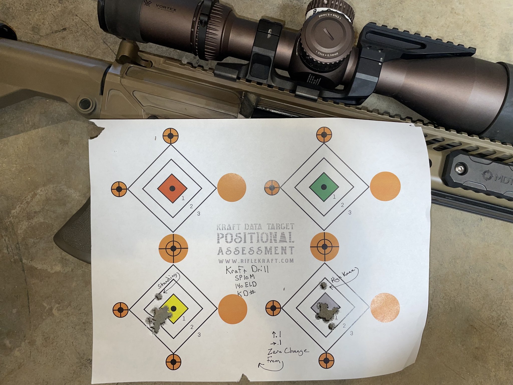

Took out the Seekins SP10 today for a test run. Fired 34 rounds of 140 ELD reloads. 10 rounds doing the drop test then two sets of 12 for Kraft drills. Seekins mxm mount holding a Gen 2 Rzr 4.5x27.

No to both questions. Vision is good to go.

Just looks like a zero that’s slightly low left, then adjusted up .1 and right .1 to me?
The first 12 shot group pretty much encompasses the drop test spread
Drop test (10 shot) was preformed first then the 12 round Kraft drill on the yellow target. Scope adjustment was made (.1up-.1right) and the second (12 round) Kraft drill was then shot.
The Kraft drill with a large frame gasser is tough to clean. Those who shoot gassers regularly know the struggle. Those who only post the 1/2” 5 shot group that where cherry picked from their 1/2” all day long gasser are only fooling themselves.
