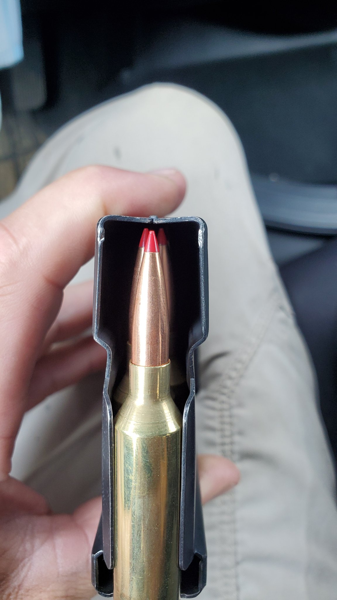

For hunting and factory ammo I’d seriously consider the 270WSM
Ammo isn’t hard to find and very mild shooting with some good ompf without the stupid long OAL of the 6.5PRC.
This mag actually has a bent in front and still has plenty of clearance, about .050. Granted these are 140eldm set for a .020jump in a .155freebore 6.5prc
