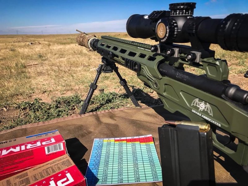

My 20 inch 6.5 creedmoor curtis vector is handy AF. I run a suppressor on mine. I find with a 9 inch can it gives the rifle a manageable length and weight especially when humping up and down the rockys or in the bush. I am still getting really good velocity out of my barrel because I am higher altitude and using rl16, cci 450, and 130's. All these give me a good little boost on top of using my suppressor I am averaging 2785 fps. Because the Vector uses a switch barrel design I can swap barrel on the spot if I feel the need for different calibers, lengths, or profiles for the appropriate situation. IMO 20 inches for a 6.5 barrel is great for all around use. Decent velocity and handiness.Wondering the same thing. Thinking about doing a short 6.5 creed

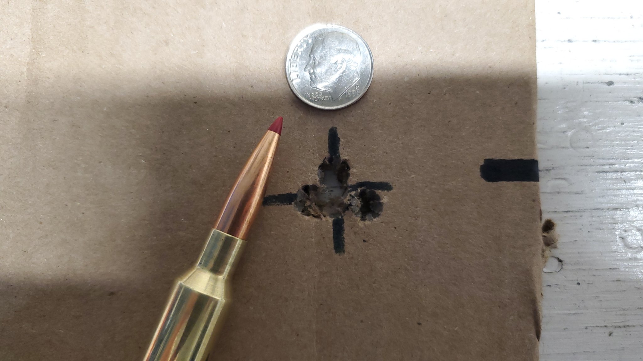

I have a 6.5 CM in an AR-10 platform, 18" barrel, shooting with Omega can.
Loading Hornady brass, H4350, ELD-Match 140gr, CCI 200 primers.
My charge weights and velocities on a recent trip to the range were as follows:
40.0 2510
40.2 2496
40.4 2510
40.6 2554
40.8 2554
41.0 2554
41.2 2574
41.4 2564
41.6 2594
41.8 2599
42.0 2614
42.2 2609
42.4 2666
42.6 2650
42.8 2704
Found good nodes around 2554fps and 2600fps. Feeding from mag so can't seat to lands, however tweaking the seating depth led to a nice group at 2554fps. Going to try 2600fps and see if it yields equally good results.
Hope that's helpful to someone!
