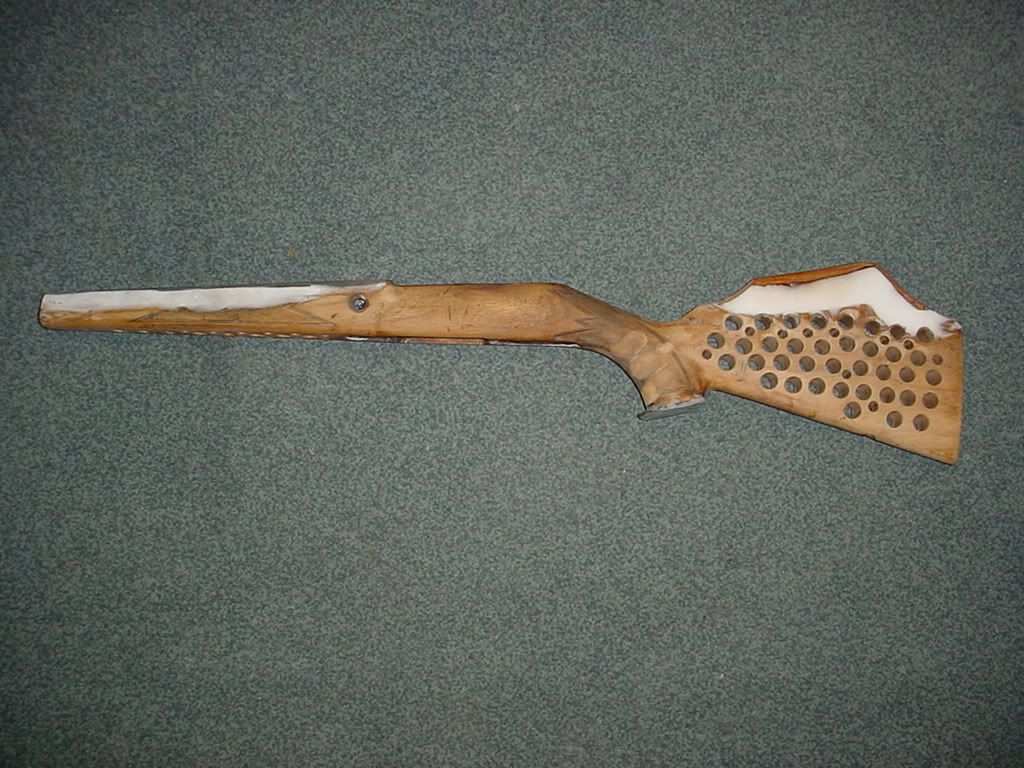

    I would glass it, just use a very light glass that goes well around corners. Very light twill woven glass or carbon works well. And if there is a bubble or two, so what, sand them off. Then paint with epoxy filled with talcum powder or baby powder at a push.This will sand easily. Just do not stick a wooden stock that is just epoxy glass coated in a curing oven to cure...
    Advantage of glass or carbon covering is that you could even drill holes in the wood for weight saving.
    This one I did years ago, filled with clear epoxy to see the carbon.
