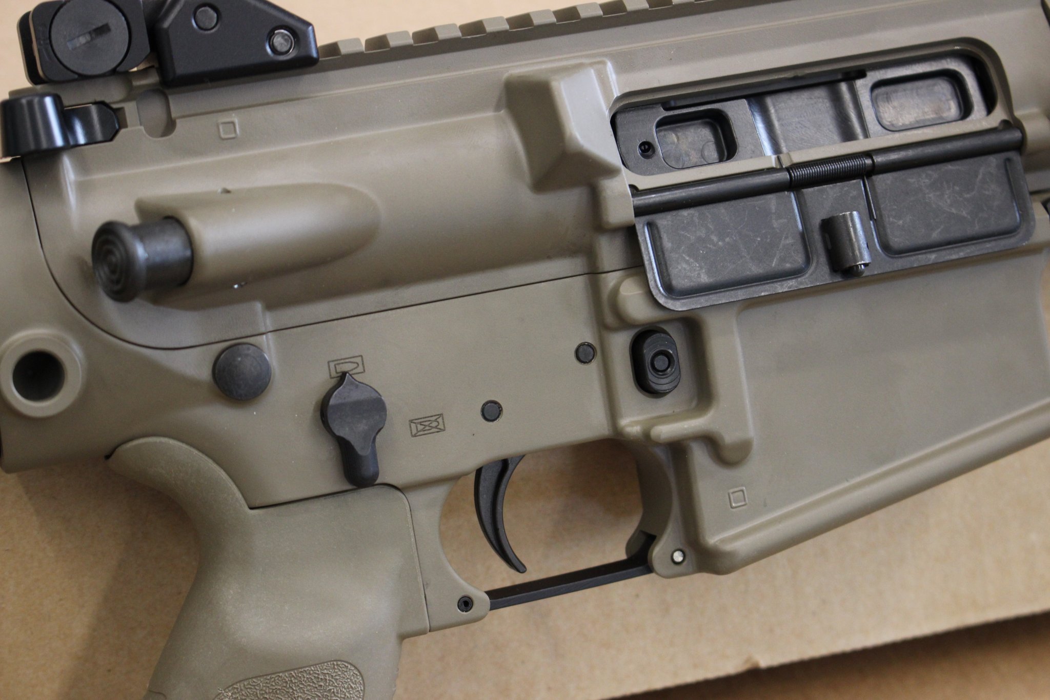

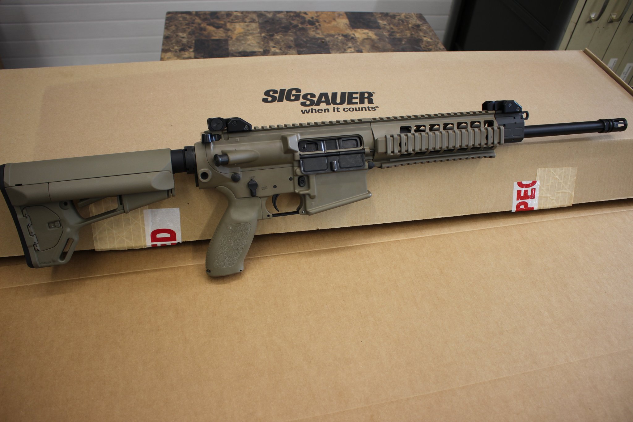

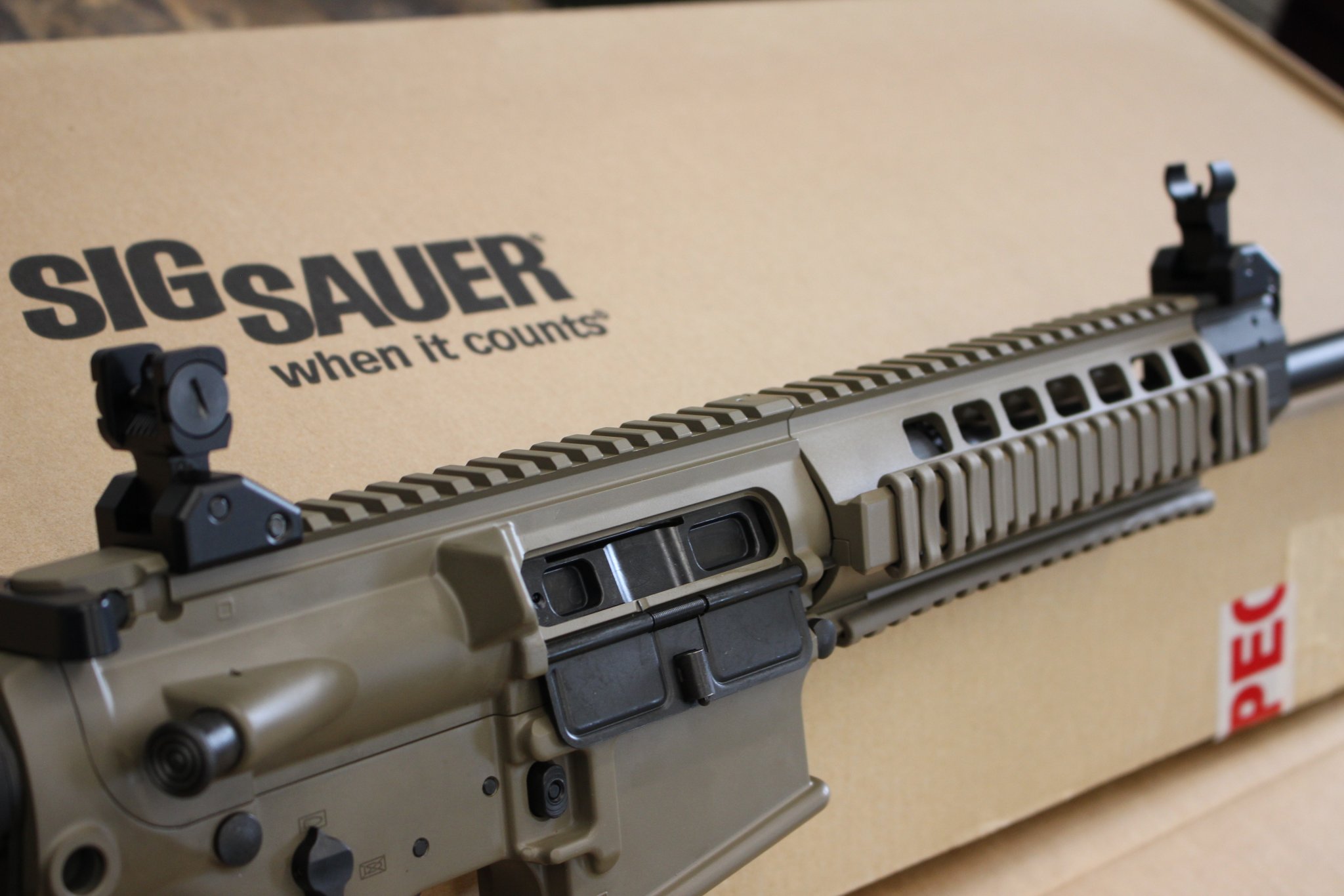

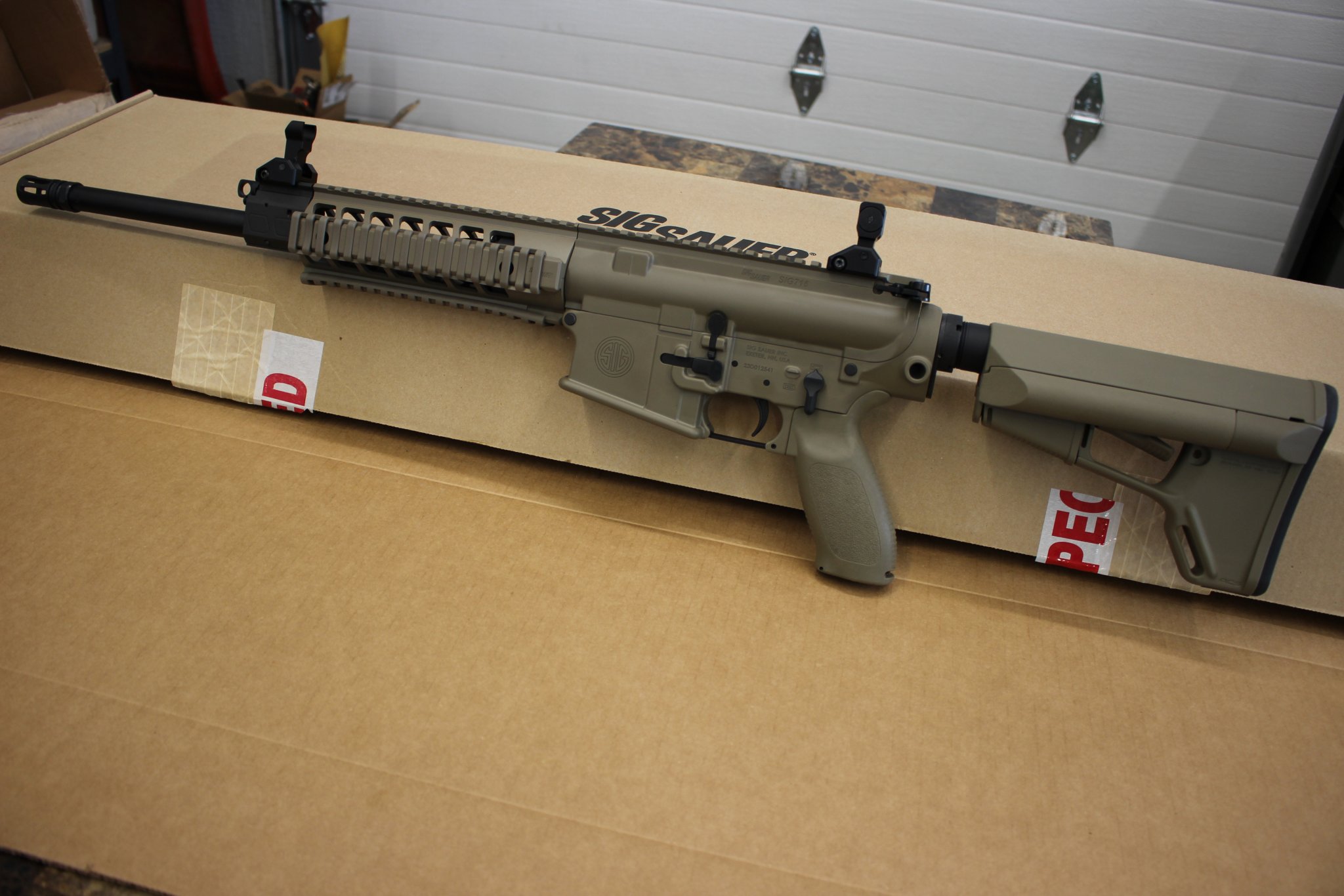

Hello all
So its been a while since I've done any kind of build...
But here is what I have...
I just picked up a nib...Sig 716 PR
Gen 1 rifle
It has all the bells and whistles
Magpul furniture, sights,etc
H2 buffer
My goal.....
A CQB than can reach out and grab when needed!
I've been looking at POF,LMT,LWRS...
But his Sig presented itself at a good deal in a trade...
So basically I'm looking to put together a nice solid build
New trigger
Forearm[lighter/longer)
1-6 or 1-8 optic
Possibly different furniture..haven't decided...
Possibly an 18 inch barrel
Nice brake... can compatibility
Has anybody done a build similar to what I'm thinking?
If so.. what are the do's and don'ts I should be aware of?
And lastly... is this Sig a good base platform for this type of weapon?...or...
Should I maybe think towards one of the others I mentioned?
I've owned sig piston rifles before and they ran like clock's
I'm just not sure as to what can be changed(barrel, guards,etc) on the Sigs...
Any insight or thoughts would be welcomed and appreciated!

Going to be hard pressed to change the barrel. I wanted to put a longer barrel on mine but but SIG make impossible to do so. Don't get me wrong it's a great rifle but just can't upgrade it much.I sold mine and went to new builded.

I recently purchased a slightly used Sig 716 and am really loving it. Mine is the Gen 2 version, so it's a little lighter than yours, but otherwise pretty similar. I've been getting good accuracy out of the existing barrel, so I don't think that's really going to hold you back.
To me the two things that really need to be upgraded are the trigger and the stock. The trigger is OK (better than mil spec.) but is one component that is critical to getting the most out of the gun. I have LaRue MBT triggers on almost all of my guns. At $80 it's a no brainer upgrade. Don't have any experience with Trigger Tech and don't know if you're looking for single stage or two stage trigger. Geissele is another option, although more expensive.
As for the stock, I'm generally OK with a gun that requires a high cheek weld, but the Sig is ridiculous. You're basically going to be putting your chin on the stock to get a good sight picture. I happened to have a LaRue riser lying around, and that works pretty well. Getting a fully adjustable stock would be even better.
With respect to brakes, mine came with a decent muzzle brake, so no need to change it out. If you plan on getting a suppressor, than obviously get one that's compatible with whatever suppressor you're looking at.
Finally, with respect to a scope, really depends on what you want to do with the rifle. If you want a CQB rifle that can reach out to 7-800 yards I think you're really talking about a 1x8 or 1x10 scope. If you've got good eyesight and will be shooting mostly at steel you can probably get away with a 1x6.
Otherwise, I think you're really good to go with the stock rifle. Once you start talking about trying to replace the barrel, all the furniture, etc. you might as well just spend the money to get a GAP or a JP LRP-07.
There is not much you can do to the Sig 716. Lancer makes a handguard, you can change out the stock, grip, and trigger. That's it. Everything else is proprietary. I've looked and researched for days. Even the bolt and barrel is a strange marriage of ArmaLite and DPMS.
